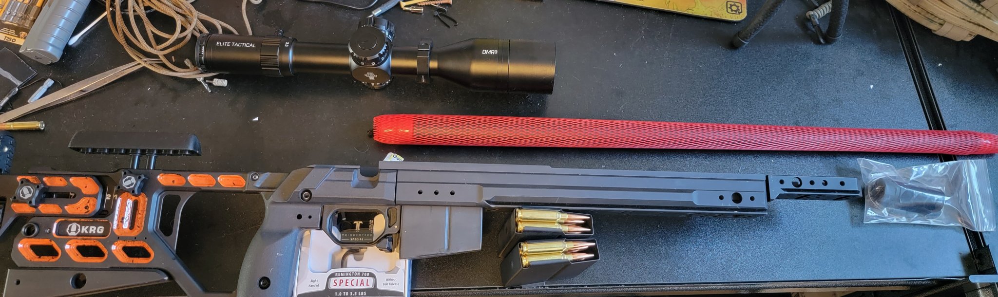

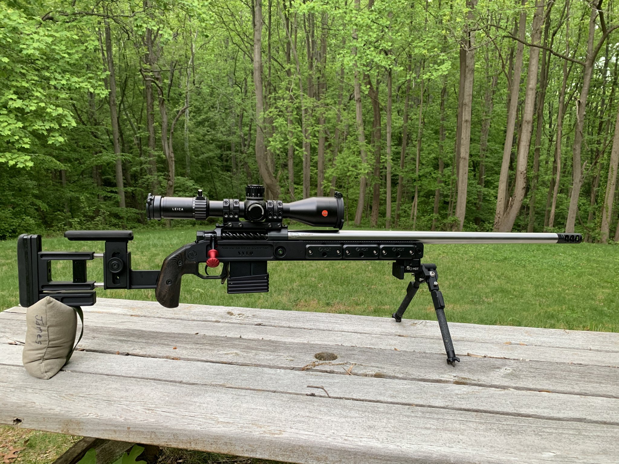

Proof of life from my FFL.
I went a little counter-culture with my options but I dig the look.

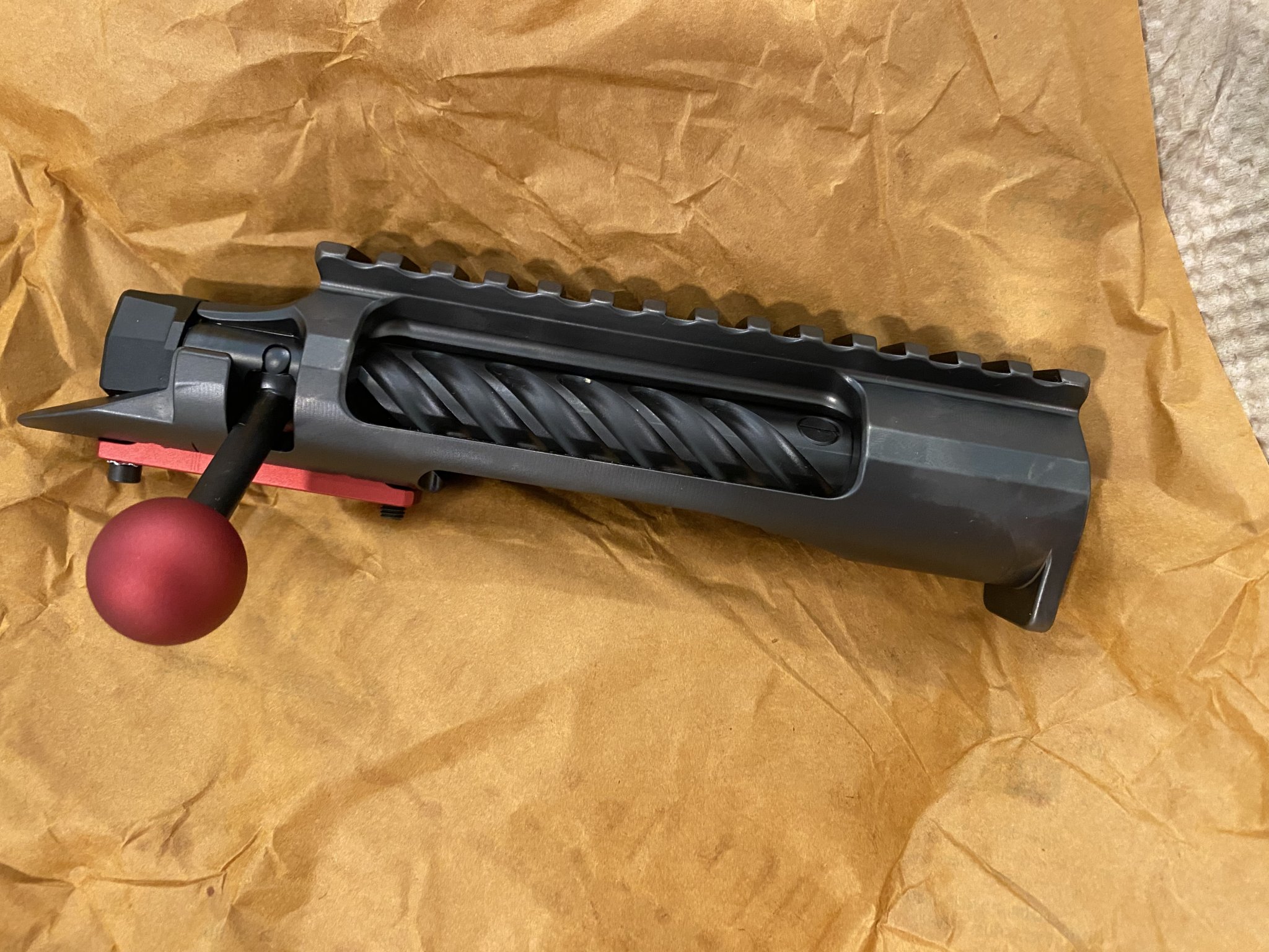

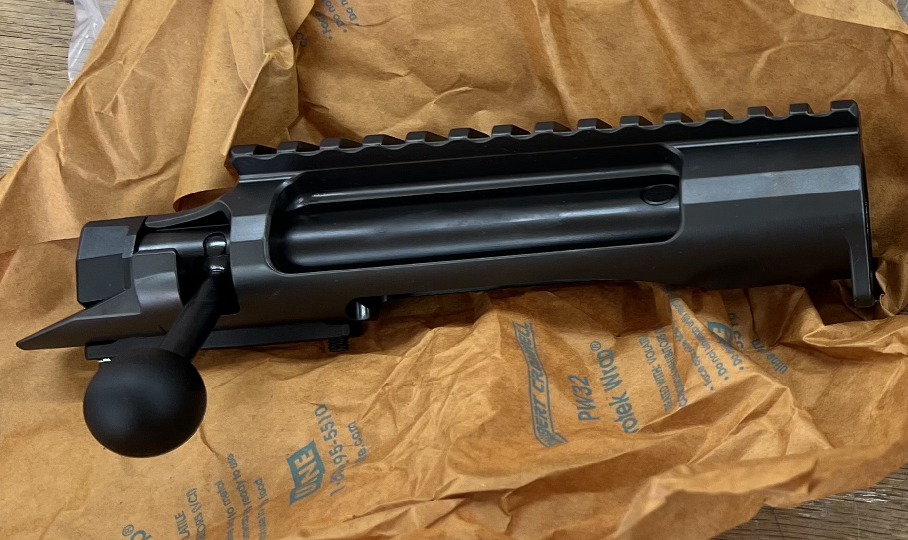

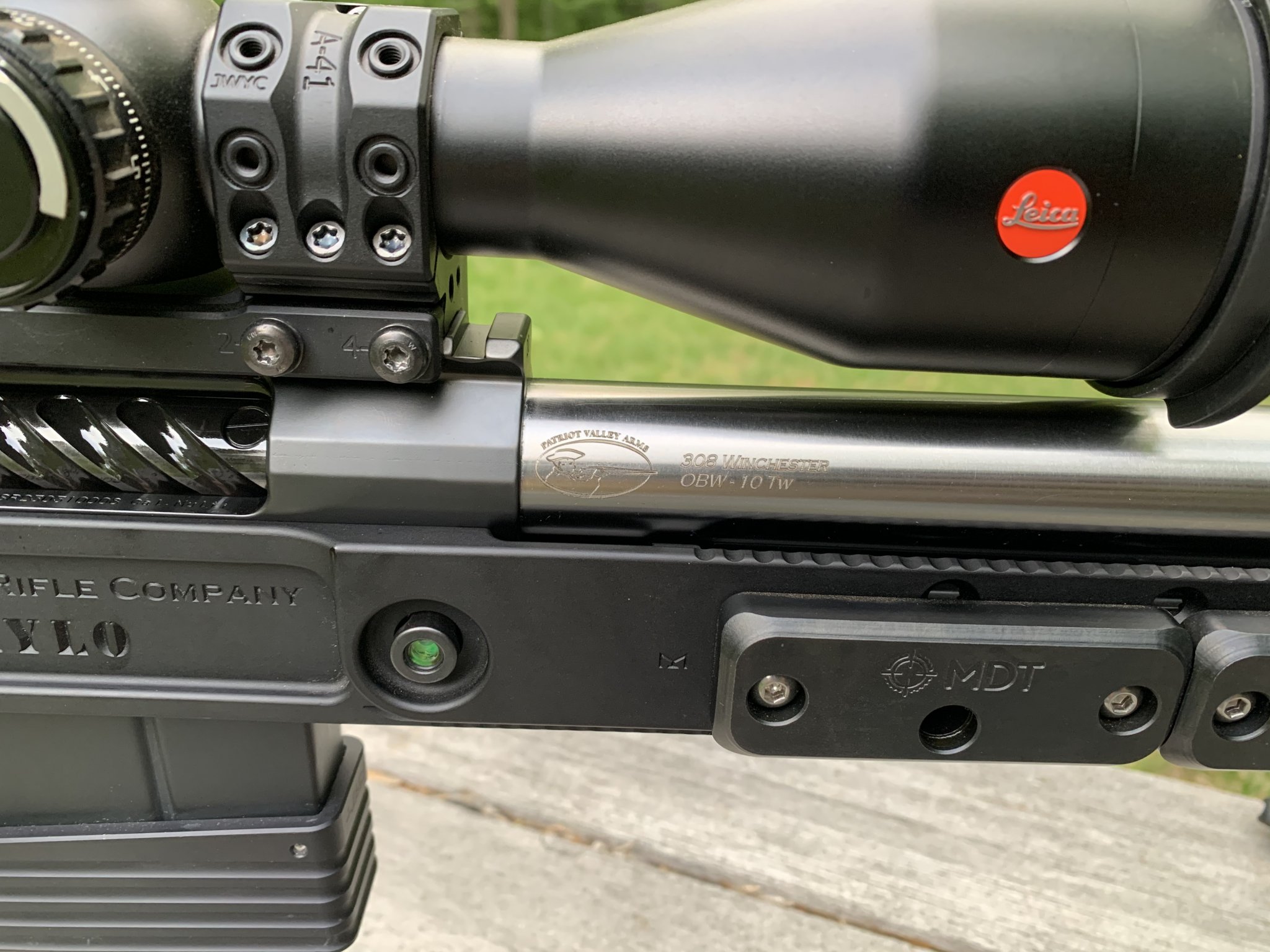

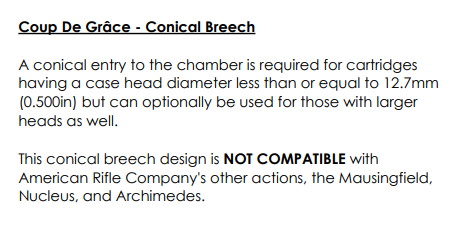

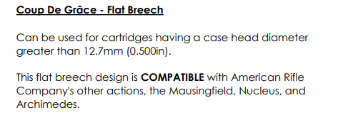

Apologies if this has been asked/answered already, but in terms of the conical breech for the CDG, does that only matter for the smaller caliber boltheads (308 and under if I understand right) if you are running AW mags? So if you are going to run AICS, or another center feed mag, could you use the a traditional flat breech profile? Related question, can I use my existing Nucleus barrels on a CDG (308 and smaller caliber)?
@epeet The action doesn’t have a feed ramp so it needs the conical breech. The big magnums sit high enough that they will mostly feed straight in. At least this is what I understand from Ted and others posts.
Not what ARC told me. They told me a Nucleus or Archimedes prefit will fit the CDG, but a CDG with conical breech will not fit a Nuc or Archimedes.
I could be wrong but I thought somewhere Ted mentioned that it would screw on to a CDG but won’t headspace correctly. Or maybe I’m remembering wrong and he said it would fit but without the comical breech it won’t function and feed…not going to sort through 3000 posts though to find it lol
Reactions: lash
That was the impression they gave me. As long as it’s a magnum it should be fine as they don’t have to have the conical breech to feed.
Barrel Details
Free install with any action purchase!
Important - For Archimedes, Nucleus, and Mausingfield actions. Not recommended for use with Coup De Grâce action.
Okay. Then I guess it remains to be seen once someone actually tries it. I have no pre determined opinion on it other than what I recall seeing posted here.

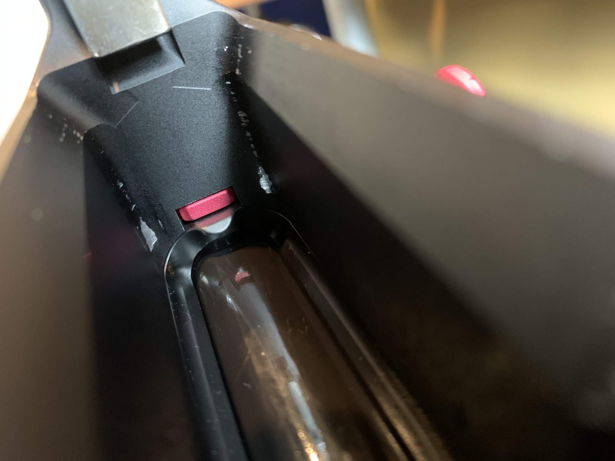

Ultimately it would be cartridge/bullet dependent. With long bullets the meplats would contact the breech face at a very shallow angle, so the cartridge would likely stop dead.
Reactions: lash and pingunit
I wasn’t trying to start a crap storm. I think you’re correct, that if you want it to feed well it needs to be a conical breech. I’m just curious how it actually feeds with a flat face.
Because of the 6 o'clock lug cutout and no real feed ramp directly in front of the magazine, smaller diameter cartridges may ride low in that lug cutout once they exit the magazine and present the tip of the bullet below the chamber and then the bullet tip will hit the flat breech face stopping the bolt, especially if you're using a single stack AICS magazine. The conical breech gives the bullet tip a ramp to find the chamber even if it hits a bit lower than the chamber.
A lot is going to depend on case diameter, bullet weight used and CG/OAL of the cartridge, and magazine follower and feedlip geometry. There's a chance your particular caliber/bullet/OAL/magazine combo may let the bullet tips find the chamber even if you used an existing flat breech barrel taken from an existing Nucleus/Archimedes build, but ARC has said the conical breech is pretty much mandatory for the smaller diameter .223 sized cases that use the .378 bolt face and the conical breech is highly recommended for .308 diameter cases that use the .473 diameter bolt face. The magnum calibers can typically get away without the conical breech as the chamber diameter in the barrel is so large it's very easy for the bullet to guide itself into the larger diameter chamber even without the conical cut.

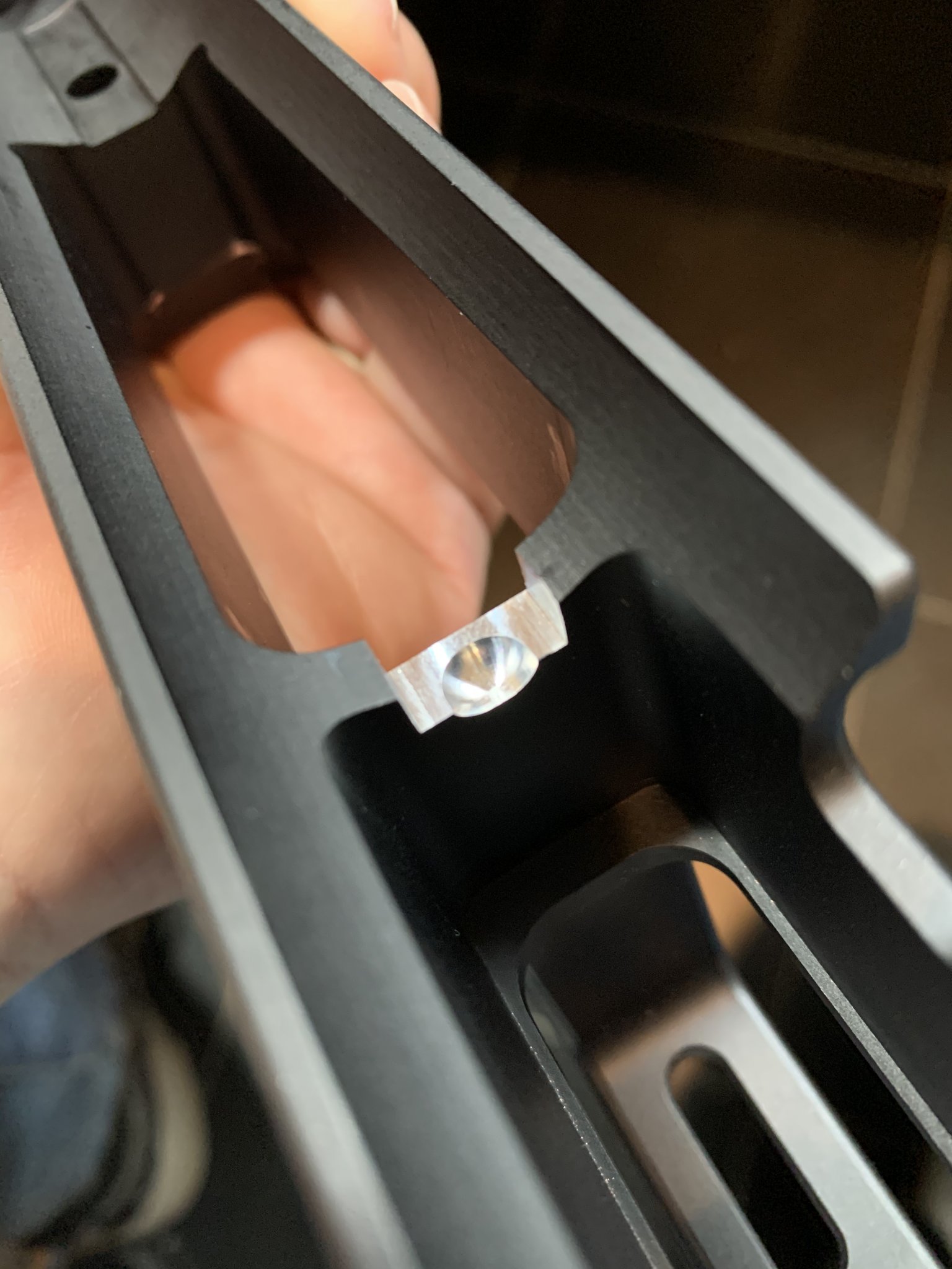

Mine is an older Xylo so heads up for anyone with an older version. It needs a considerable relief cut to clear the trigger hanger.
Also the AICS tab (included with action) is not a drop in for the older Xylo. It would require milling the slit deeper & wider in the chassis.

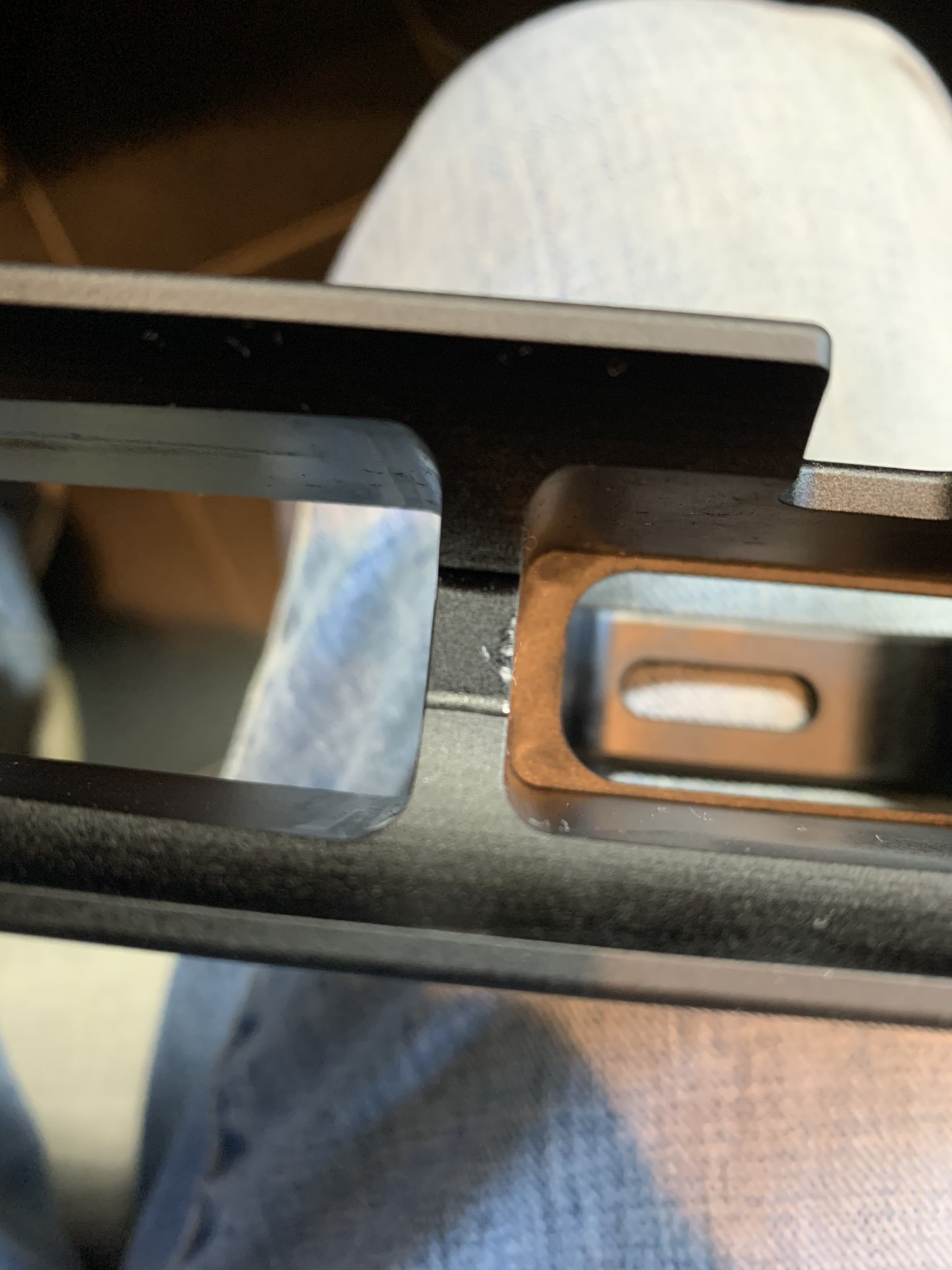

Here is what my unmodified inlet looks like. I’m running AW’s, but will show the tab for Anyone that may need to fit it.
Here is the main offender at front of trigger pocket. Back of action was about .175” high at rear action screw.
This is the minimum mod required. And shown installed. Not much room to spare with that cut.
View attachment 8135988View attachment 8135986View attachment 8135987
Here’s the finished rifle. Probably won’t get any rounds down range till next weekend, but it feeds 14 308’s from the AW perfectly. I can load the mag through the huge port or just throw a round on top of the AW and feeds singles like butter. Beveled the back of the AW follower so it doesn’t act as a bolt stop.

Firing pin protrusion on my example is .046 & it is not adjustable.
Pin fall is .250 with zero cock/decock on close.

In regards to the conical breech and AW mags…. Took mine out Sunday and it feeds like butter from AW. Might do the trick mentioned above here and chamfer the back of the follower because the follower stopping the bolt has me all thrown off… too used to AICS I guess
Thank you for sharing. Interesting, I considered positively that lock on empty mag. Haven't got the chance to test it yet, together with the chance of loading a mag from the window...
