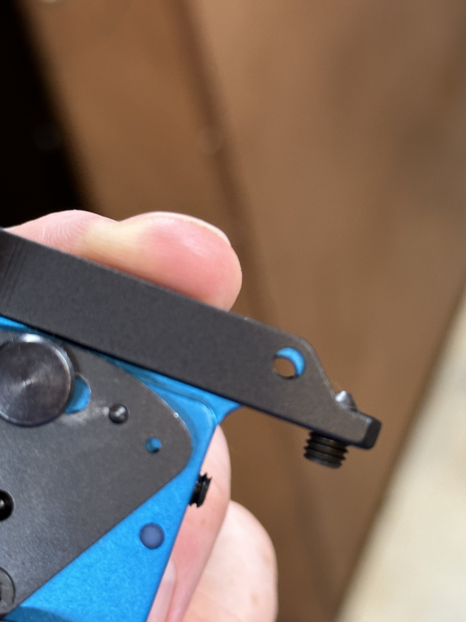

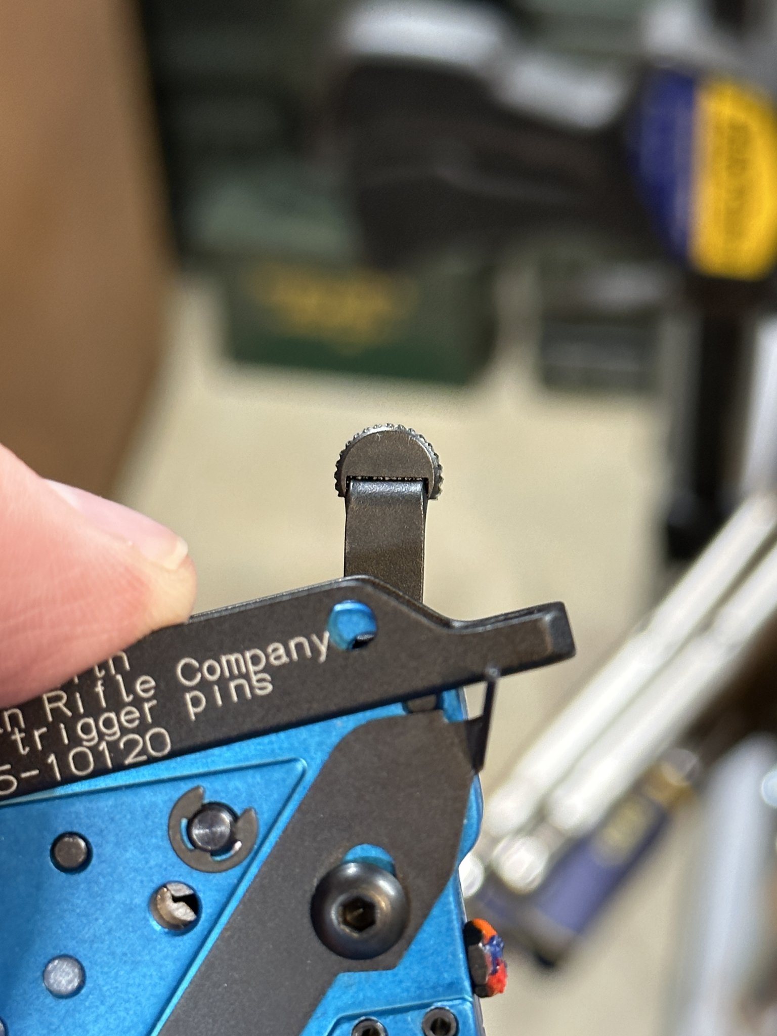

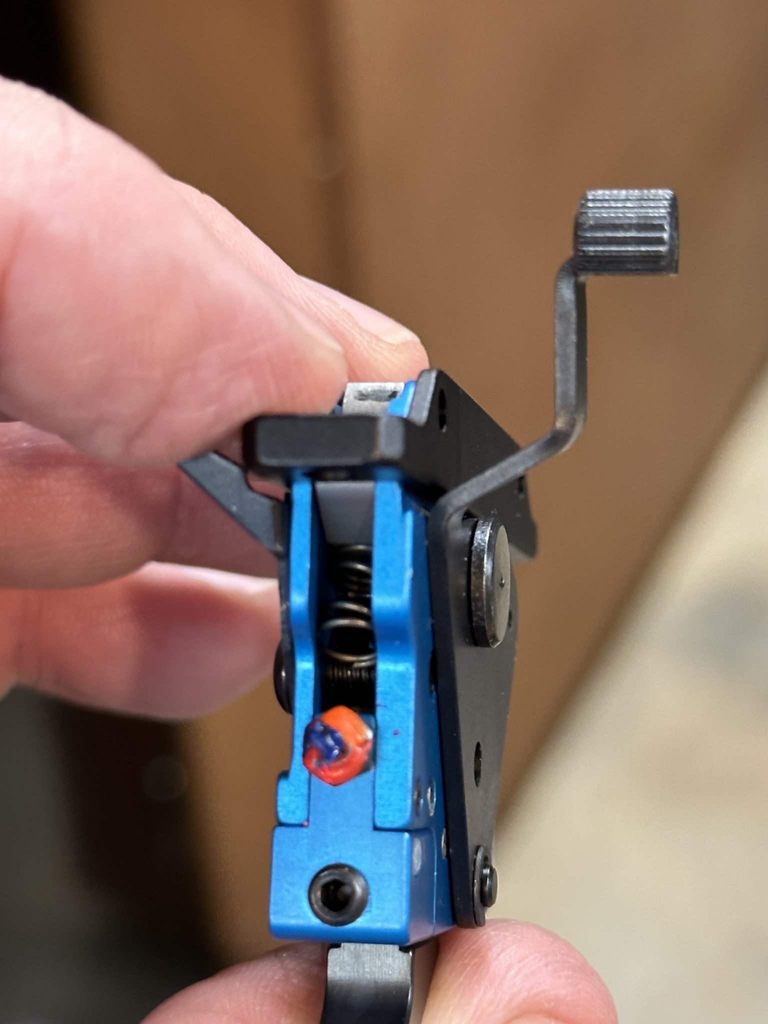

I was at my local club match today and a friend let me run a few rounds through his CDG because I want to pick one up and I was really impressed, but he did tell that on a stage when he was closing his bolt and the firing pin followed resulting in a dead trigger. I believe he said it only happened twice, another guy from a different squad also said he had something similar happen. Just seeing if anyone else has came across this and solutions to avoid it. Both are using the pivoting bolt handle, one using a Bin n Andy trigger the other a TT special.
As the owner of the CDG in question, Following KIBAs advice, I put the medium sear back in the trigger and adjusted the sear engagement and have not been able to get the striker to follow on closing.
This is interesting, I've had my Deviant with a Bix n Andy TacSport trigger do this randomly a couple of times also. Thanks for posting this @33jeep.

What’s an acceptable amount? Just measured and I’ve got .006” fall
With a sample of one & one trigger, I couldn't tell you. With as much drop I had initially, I'm surprised I didn't have a lot more light strikes.
I just adjusted out 'any' movement on bolt closing. (the cocking piece will still sit below flush)
