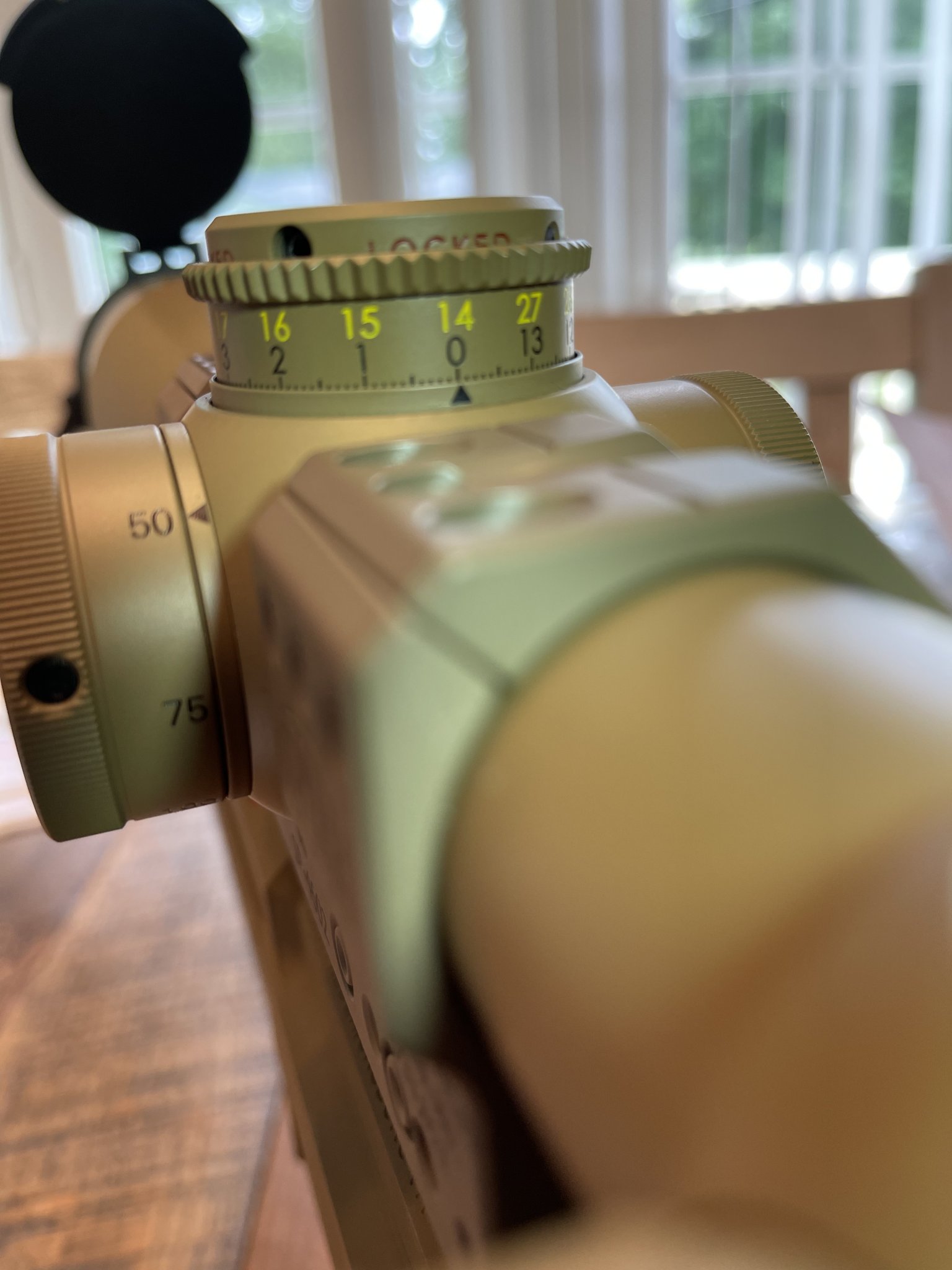

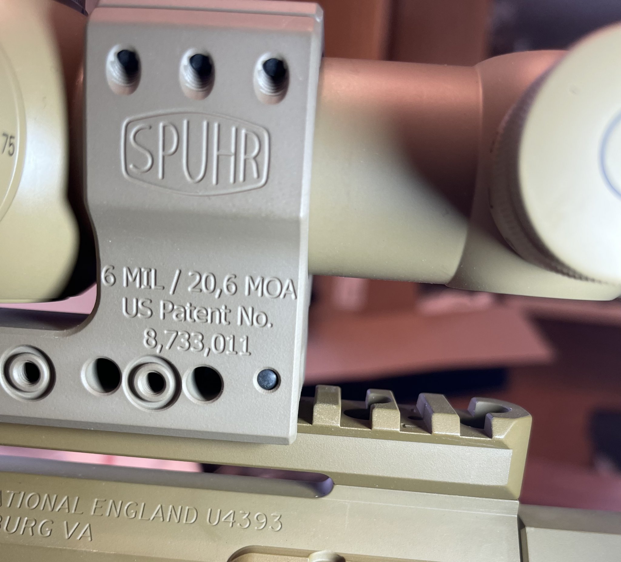

All right guys. Been around here since 2002. I read a lot and look at the pics in the pit. Last year around Christmas time I bought a fancy rifle and fancy scope from peeps on this site. First weather, then Covid, then life got in the way. Finally today all the stars and planets aligned and off to the range I go. Set up a target at 50 yds to get on paper. Removed the bolt, aligned the barrel with the bulls eye. Look thru the scope and the crosshairs are low. I cant get enough out of the elevation turret to align the crosshairs with the bulls eye. More pics added for scope and mount. Sorry about the size of the pics!
AI AXSR .338 LM. Any help, advice, guidance or sorcery is welcomed.
All was not lost. My AR15 with the Rare Breed trigger runs like a champ.

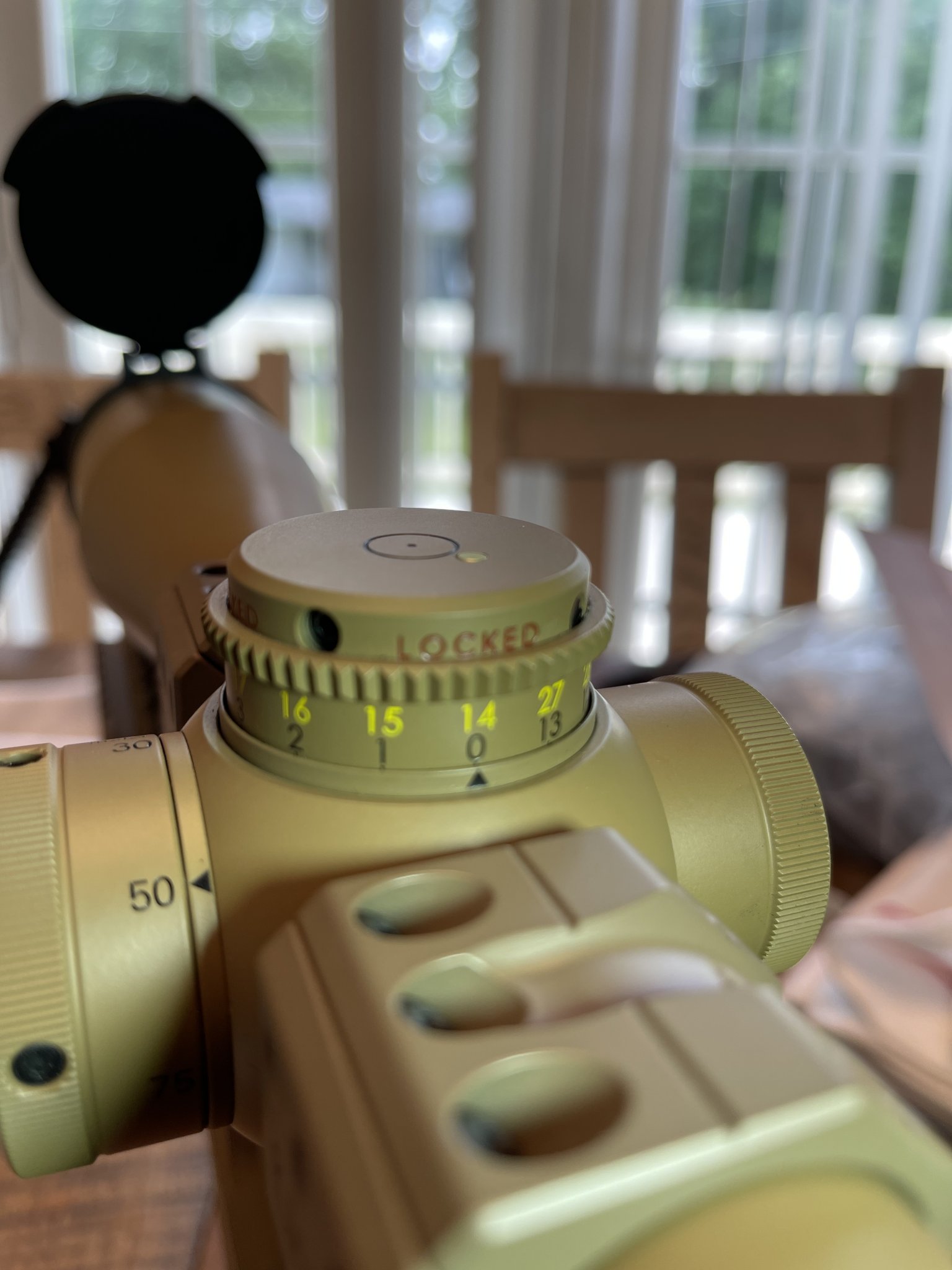

Are you familiar with how to use the zero stop on that scope?
A 20moa base shouldn't have you running out of elevation. I suspect your going to need to adjust the zero stop. I'm not familiar with that scope, so I can't help you there.
Do you have the manual?
Try this video.
Looks like you'll need lock the turret, loosen two screws, unlock it, then rotate the turret enough to get the extra elevation you need, then retighten the screws.
If someone who owns one of these hops in with different advice, follow it. I dont have one of these, and am just making an educated guess based on how it appears to work.
Reactions: camocorvette
Yeah this shit never happened with my GAP Rock and the 10X Leuopold scope on it.
A question:
In your pic, the turret's zero is aligned with the index. Is that the limit of it's rotation? Does it stop with that -0-, in that position?
If so, that's a pretty solid indicator that the previous owners zero is still where the zero stop is set.
Reactions: hafejd30
So, if I'm understanding the mechanics of that design right, it should be an easy fix. Loosen the 2 screws first, turn the drum counterclockwise about a mil or two, then re-tighten the screws.
Now the erector stem will not have moved, but you should have enough additional elevation range on the drum to get it to zero now.
Once it's zeroed, to set the zero stop back to -0-, just loosen the screws, spin the drum clockwise to -0-, and re-tighten the screws.
Unless someone who actually has one comes along with a correction, I think that'll work.
Nice rig, as others have said, you should be able to get a 100 yard zero with 50 or 60 MOA rail/mount combo with that scope. You want to be slightly above barrel line of sight at 50 yards to be close to 100 yard zero.
I have a different turret on a SB, a double turn. Probably different. Read the manual carefully if I recall there are some warnings about removing the turret top when the screws are loose. Might not apply to your SB.
Was just typing out how to reset everything, but looks like you have it. If not, PM me. I’ll send you my cell number and you can FaceTime me or something. I have several S&Bs with that turret. I can walk you through how to zero it.
If the crosshairs are low, you have to dial “down” to get them to align with the bullseye. Not up. Just making sure you were dialing the right direction. Two full revs of UP won’t help you unless you already got Down far enough to zero.
Covid and all that shit didnt stop you...you just jumped so deep into the deep end of the pool it has took this long to get back to the surface........
Damn nice gear.
Did you say .338 LM?
I hope you have shot something before this.
Reactions: ken226
Sounds like he was against the zero stop and couldn’t dial down. He needed to reset the zero stop to add enough to dial down.
