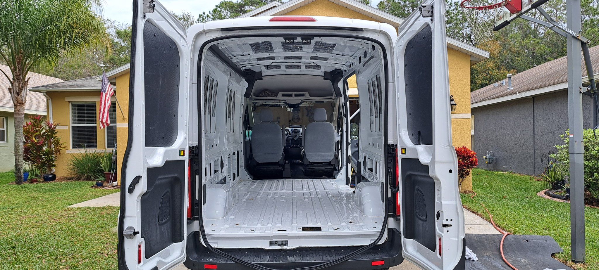

It started off as a work van with all the metal bins and roof racks installed.
45 minutes after arriving home with it, it was empty except for the floor mat.
Next morning, it looked like this.

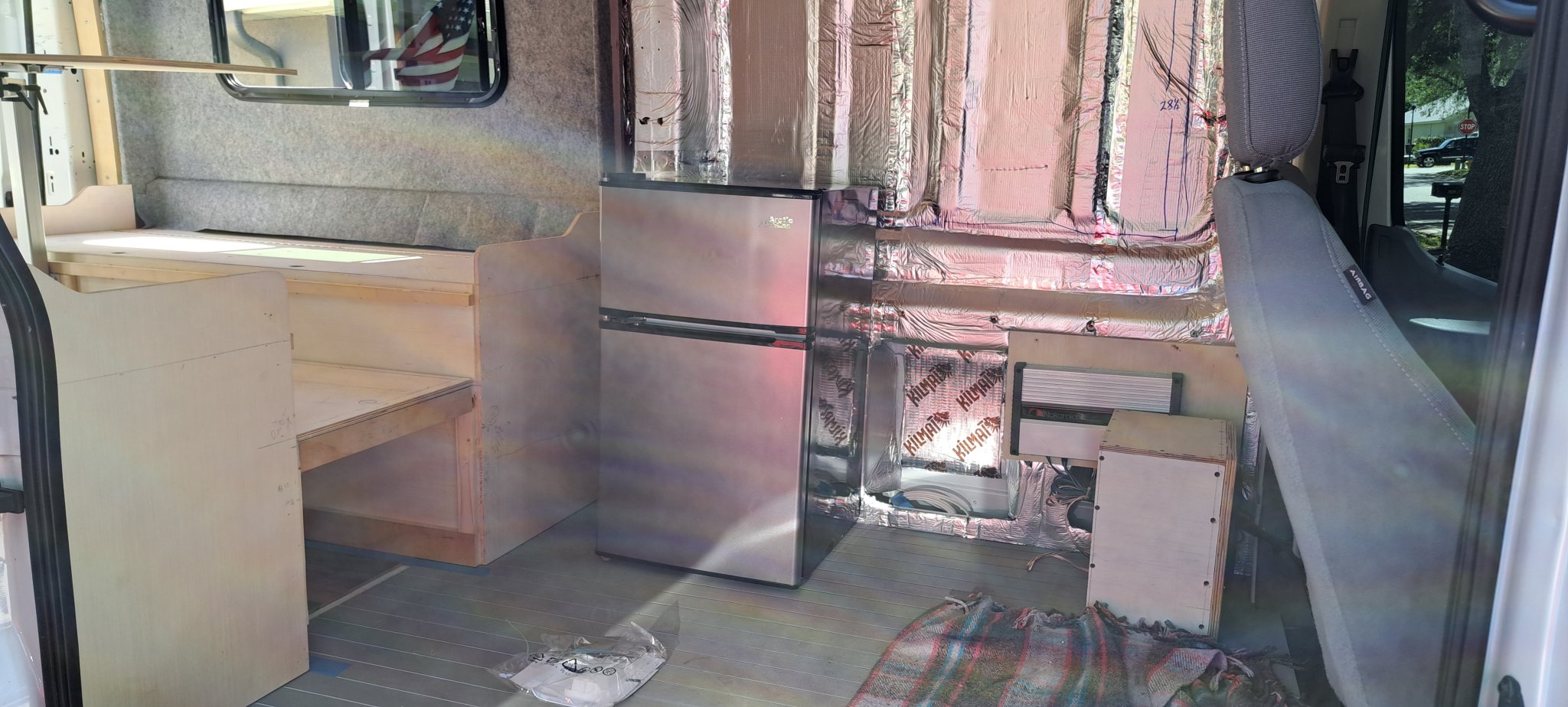

The walls have the kil mat, a layer of adhesive foil backed foam and any place with large air gaps has rock wool. In addition to the above, the roof has 2" foam board sandwiched between it and the tongue & groove ceiling.Interesting. I own a small service company and have similar. I'm never gonna look at it the same way now. Are you considering insulation? We have a product in marine industry called Soundown that I've used.
The area above the cab has the kil mat and adhesive foam. It will get stuffed with rock wool before final trim.
Floor has kil mat, foam adhesive and 1" foam board between the furring strips. 1/2" ply on top of that.
To say it's insulated, might be an understatement.
An older photo showing some of the insulation and the test location for the fridge.

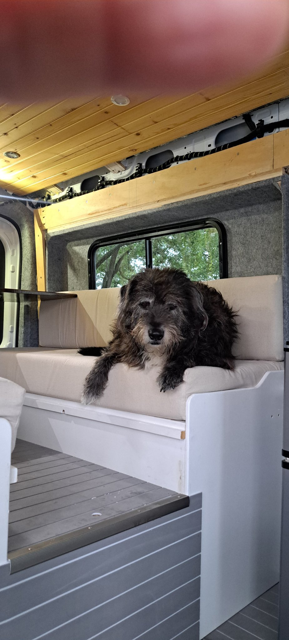

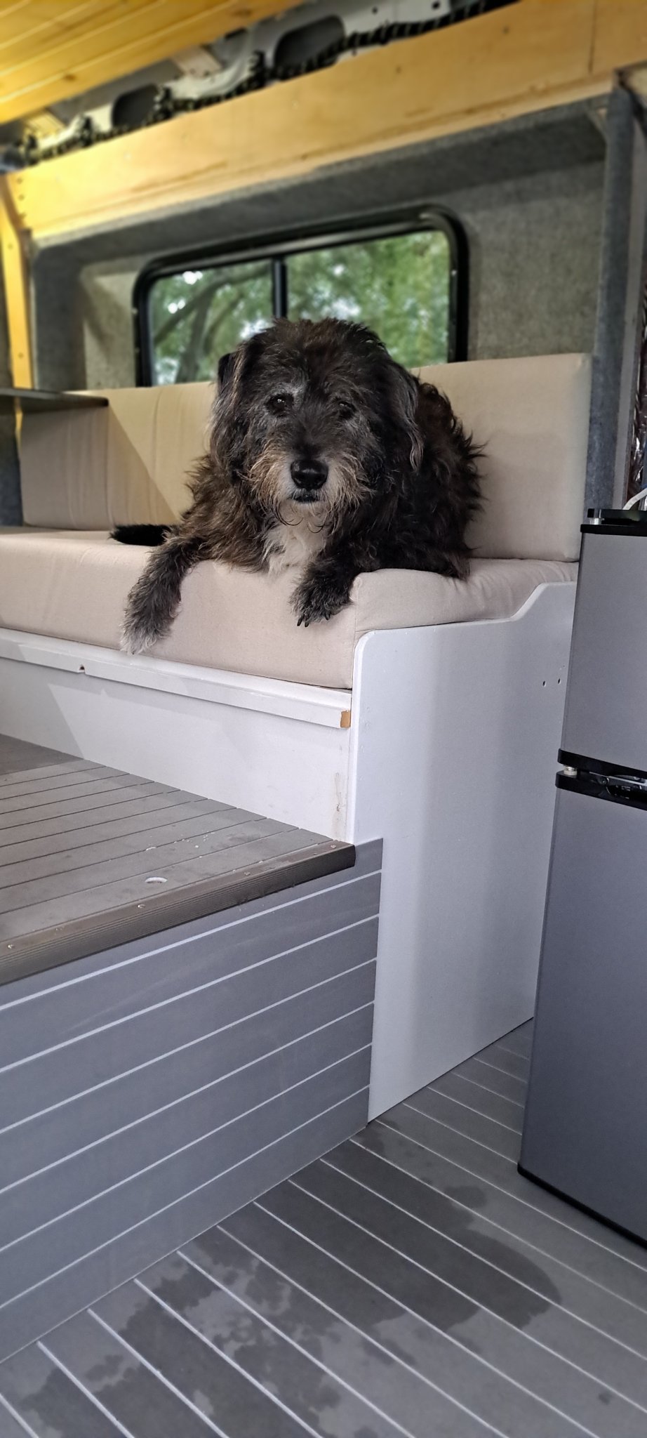

The benches/bed/table setup.
And the hair factory.
Final insulation and trim work still left to do before installing the last section of ceilingView attachment 8439284
We used boat decking foam so Cherry could roam around without slipping. And, her sloppy drinking doesn't hurt it. The cabinets will cover the edge of the horizontal foam.
Still need to do some paint touch up over the staples/caulking. Apparently, my finger was dirty when I blended it in.
The little hole in the foam you see is a finger hole to access the clothing drawer.
