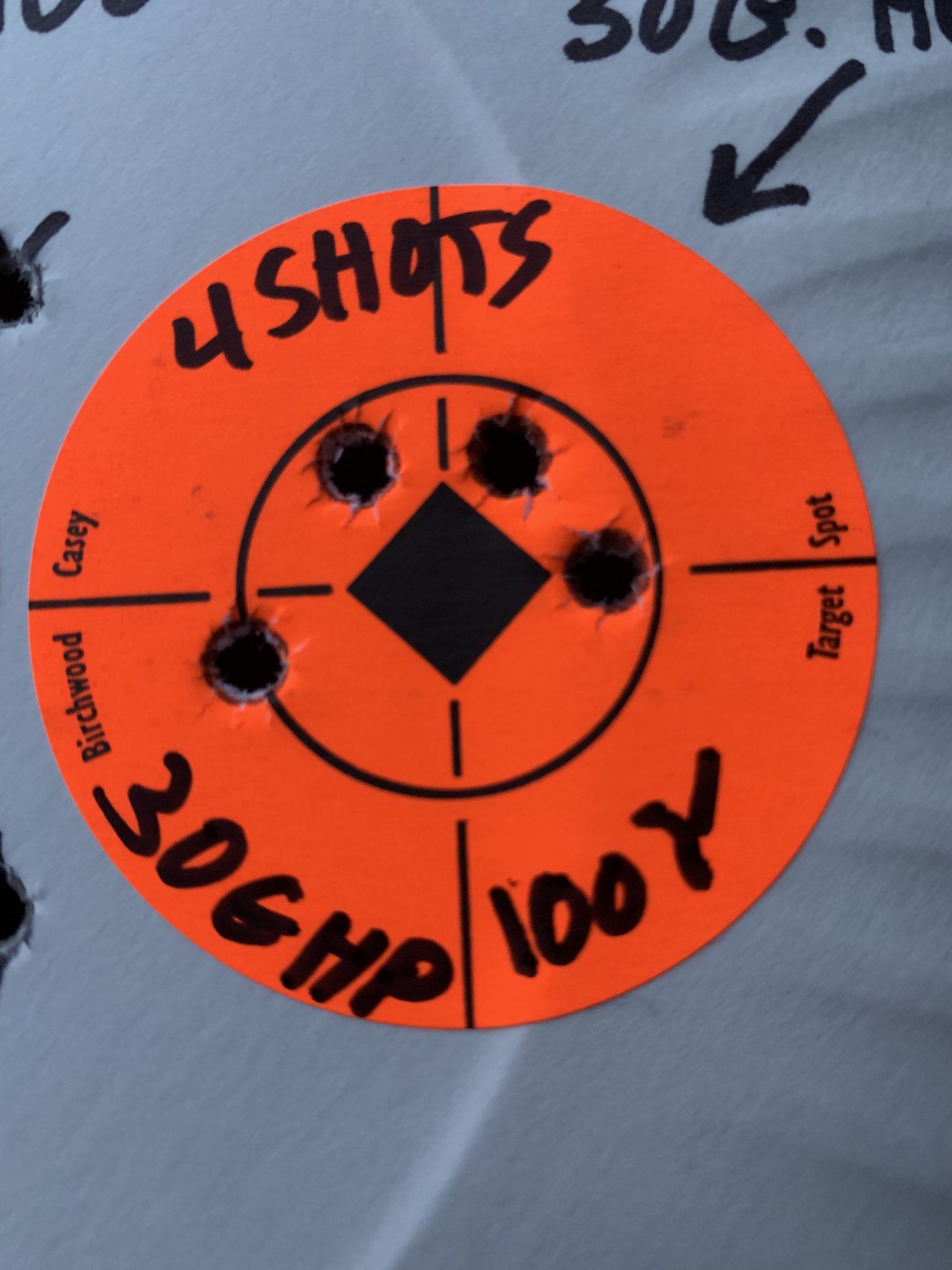

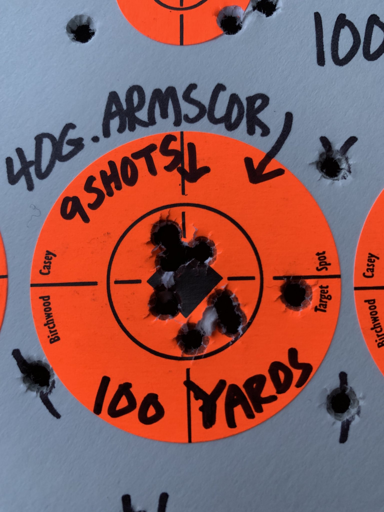

I’ve never heard of any 22 magnum shooting that poorly. My bolt shoots 1” at 100 all day long . With most ammo
What is realistic accuracy out of a factory 22 mag rifle at 50 and 100 yards?
I’ve had a few tell me they get 1 hole groups at 50 and less than an inch at 100, but I feel those are the exception and not the rule.
I have a 22 mag now - first 22 mag rifle ever and am trying to establish a baseline of what is realistic.
thank you
Reactions: rookie7
All day long? :D
Wize adze.
You just wanted me to add my usual snarky comments, didn't ya' 'squatch? ;)
Okay....
Hey! Nice wallet groups, how did it go with the other 37 shots?
I see some strays on the adjoining bulls that aren't quite so "all day long".
There's two of y'er bullseye's, what happened to the rest of the target?
I know, I'm a wize adze too. :)
