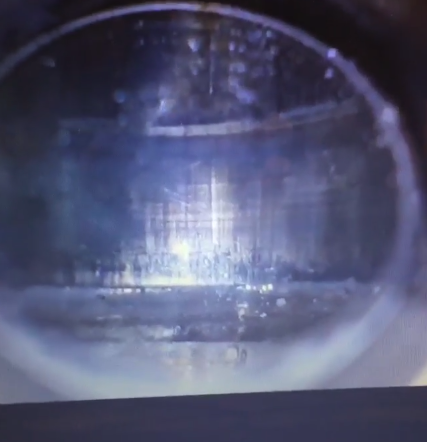

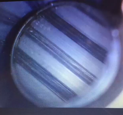

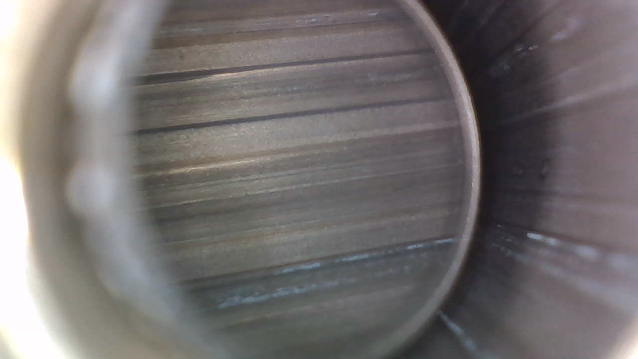

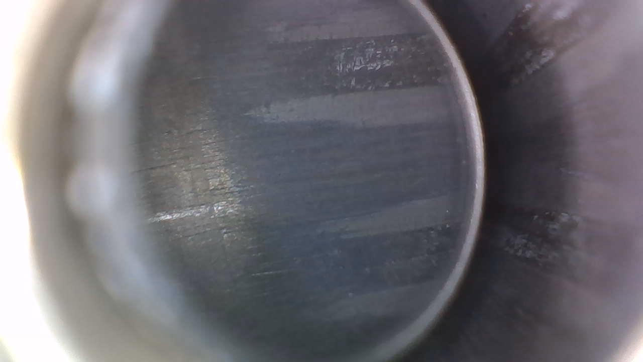

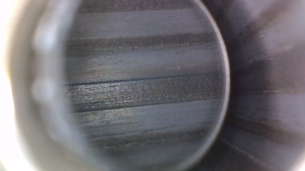

Pardon the potato quality, pics taken with my phone of the laptop screen and sent on facebook chat and now copied over here so a few steps removed fromt he source quality lol

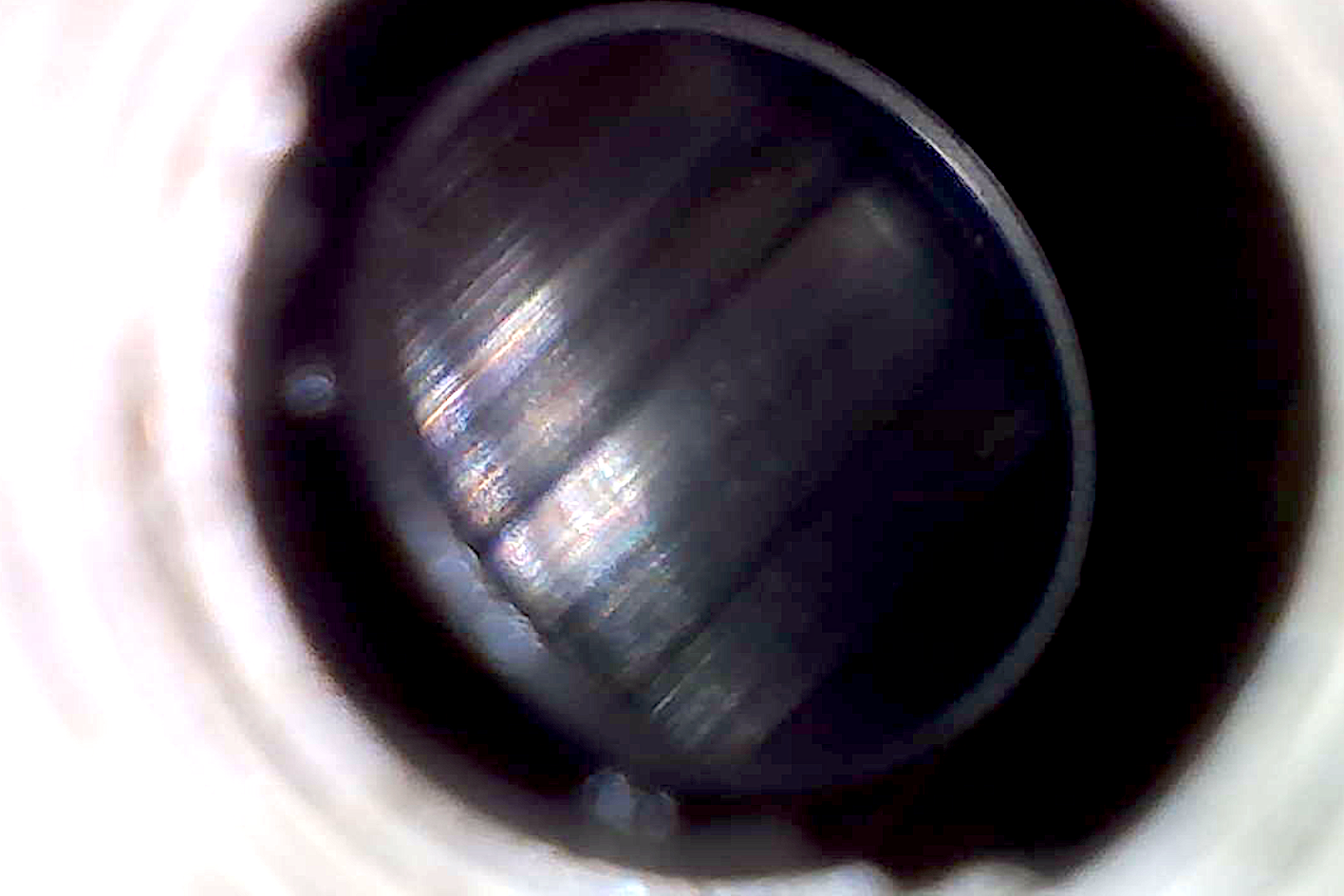

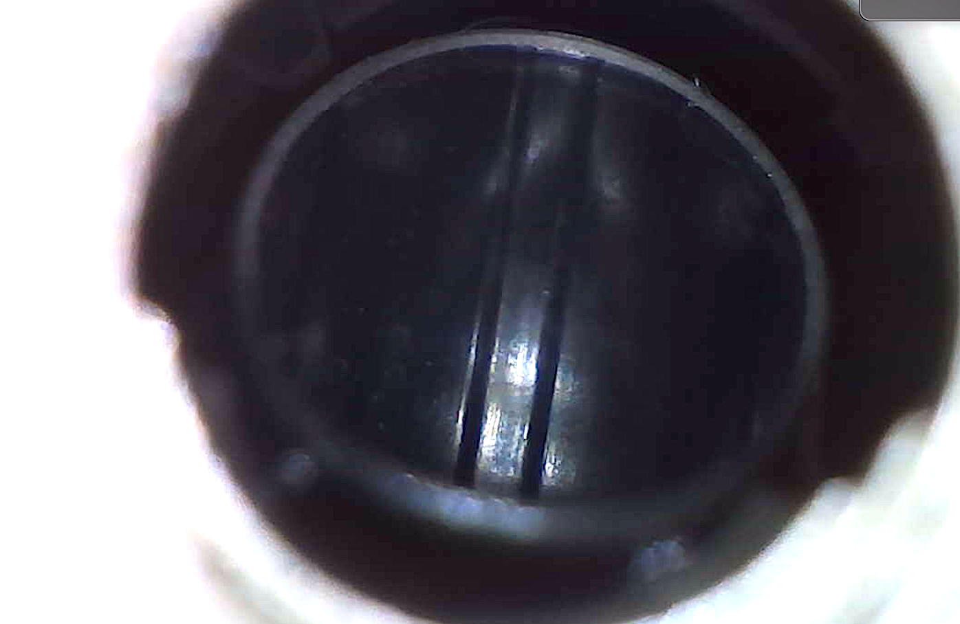

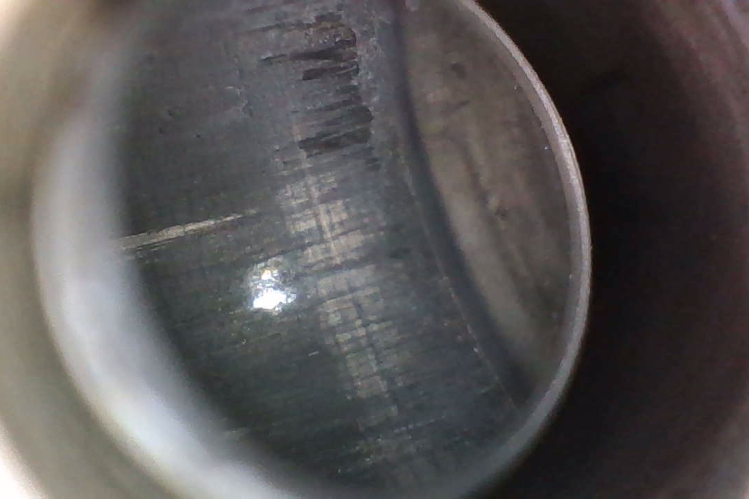

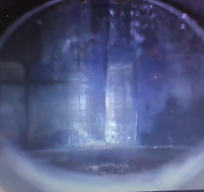

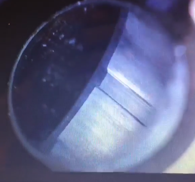

Found my new keystone 223 wylde barrel has a sort of wonky chamber in addition to being the length and threads I didnt order.
Freebore with the lands all the way removed
7120177
Lands not all the way removed on the opposite side
7120186
But with my generic brass forming load it shoots well enough so Im not gonna fuss with sending it back.
7120173
I guess I ought to care about and take better care of my shit ar upper...

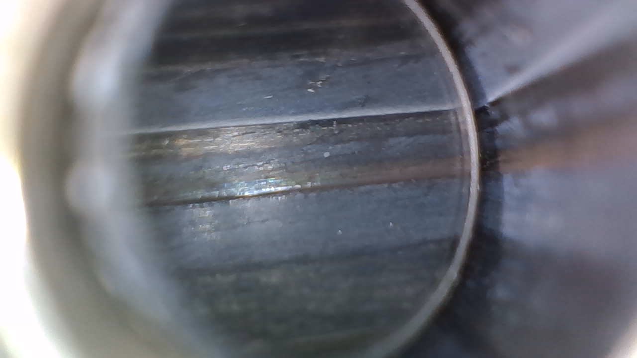

Varget fouling in dasher at the chamber end
7120180
Spick and span at the crown
7120183

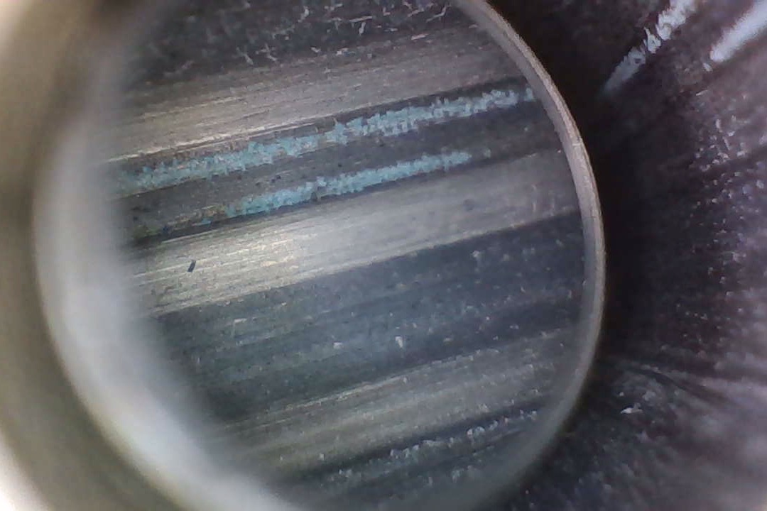

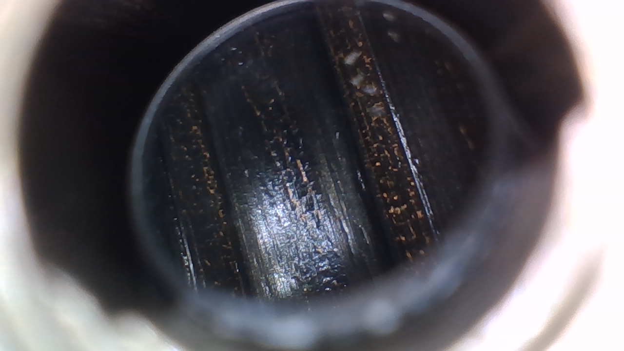

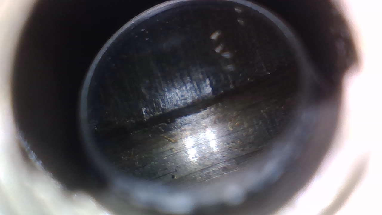

Ordered one yesterday right after I saw this thread, Teslong came in the mail today.

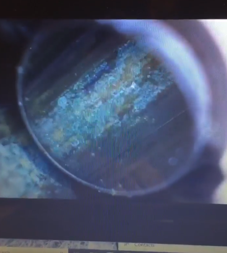

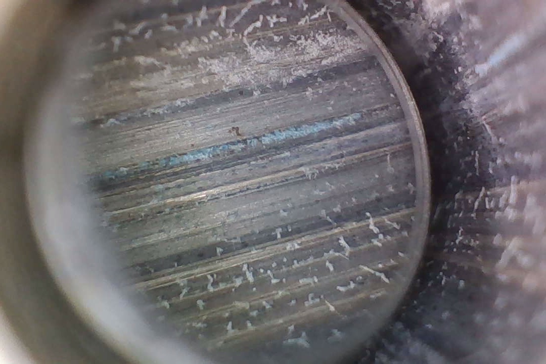

Found some copper residue as seen by Boretech eliminator that has been sitting in this barrel for at least 1.5 years. Some white squiggly stuff in the barrel too (don't say it). Perhaps it's from running to many dry patches?
Also found something that looks like a lead or carbon deposit in the free bore areas. It's each of the lands, so I'm wondering if it's carbon or possibly something else. Weird. I'll clean the barrel and provide more pics.

Everybody has a Teslong Bore Scope but us I-Phone owners....
Any suggestions on cleaning? I will go at it with a nylon brush ... but with what solvent?
Newer shilen 260 prefit.
Approximately 1500 rounds but honestly abused a lot less, no desert heat blasting and blazing away chasing misses.
This barrel currently has about 350 rounds in it since last cleaning.
Throat
About 3 inches in
About 10 inches in

I received my bore scope yesterday and am impressed. I played with a little this morning. It is a great tool. Scoped a 6mm-06 Broughton 5c and a CZ 455.
7121607
7121608
