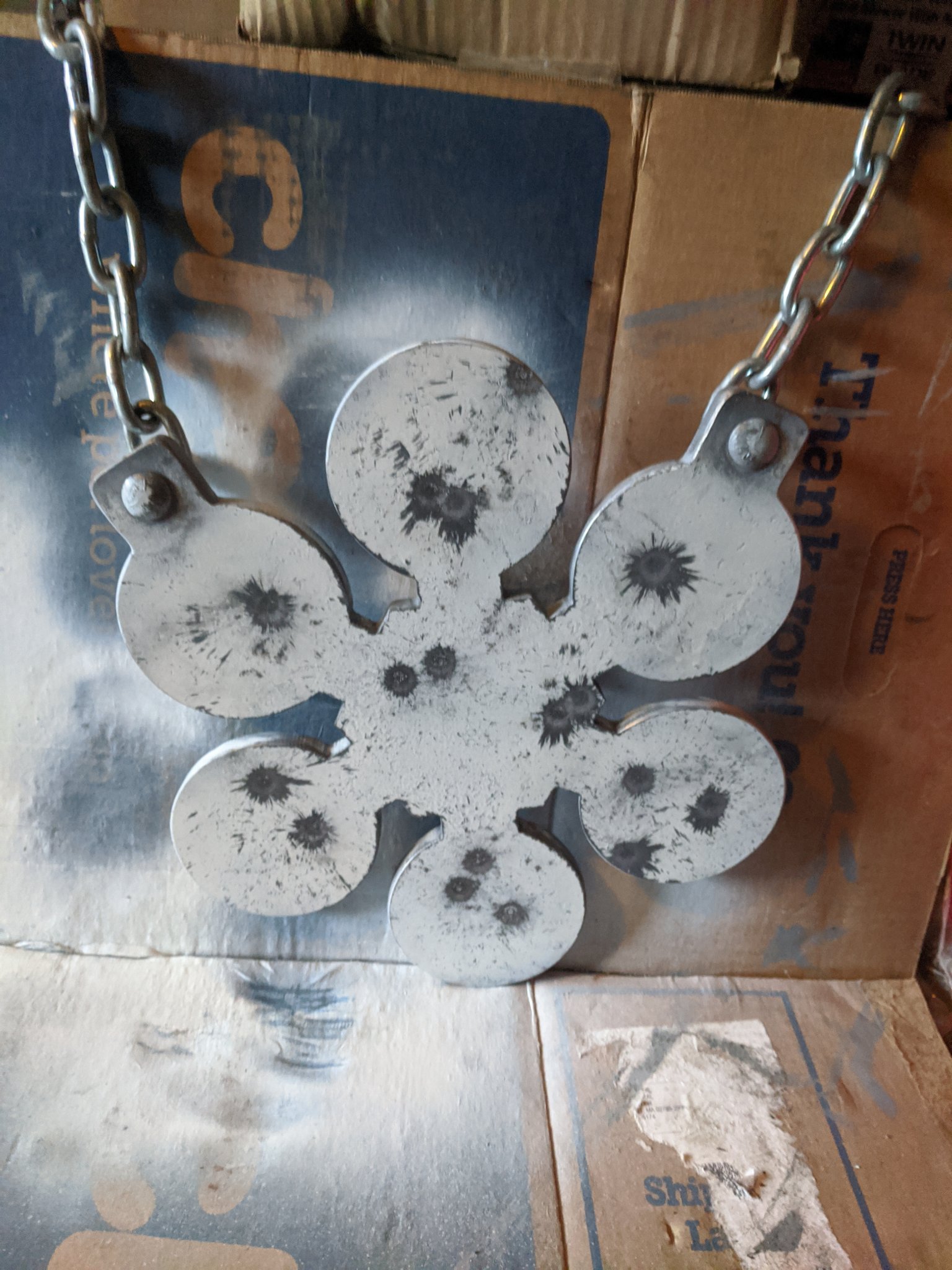

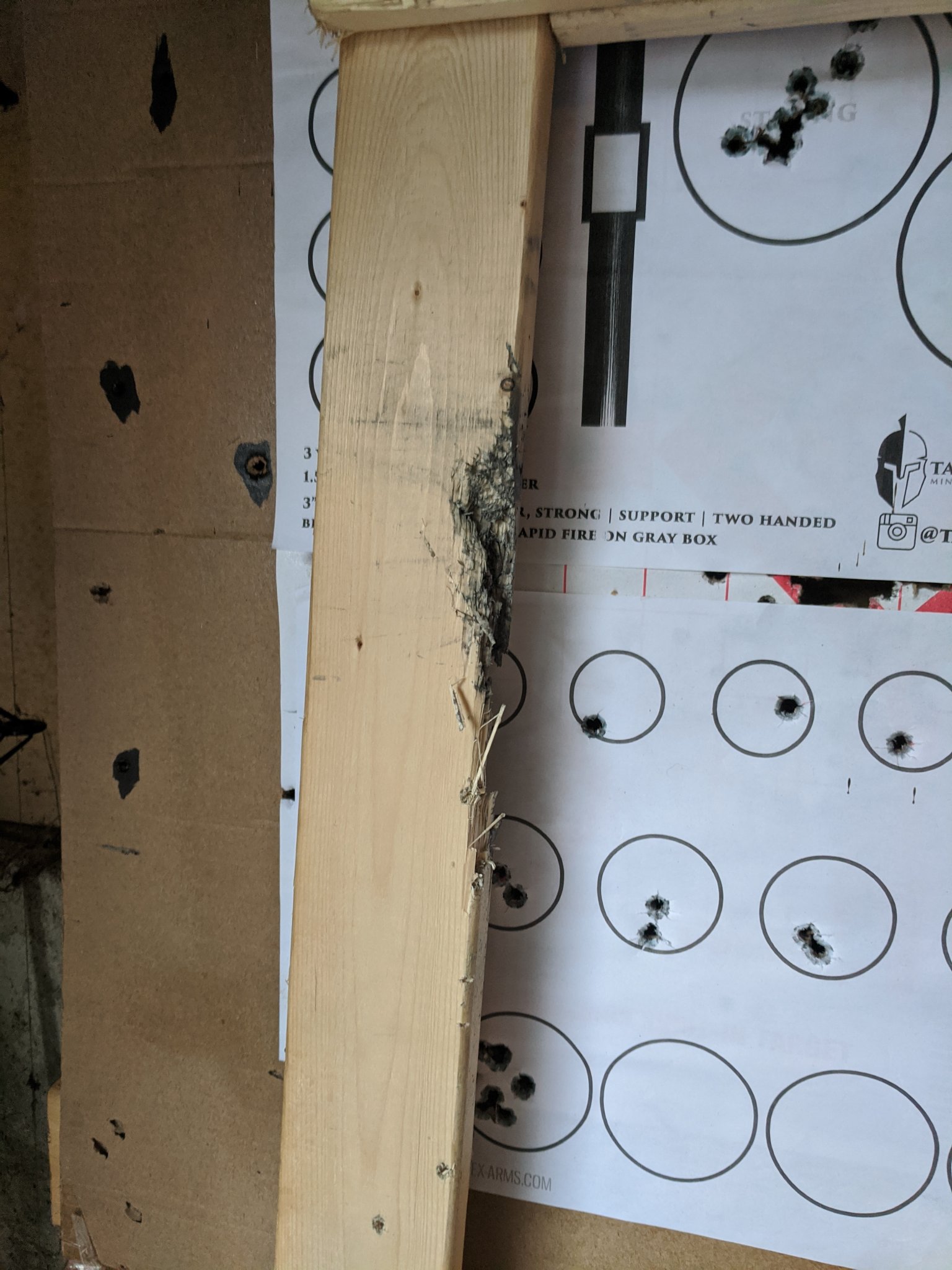

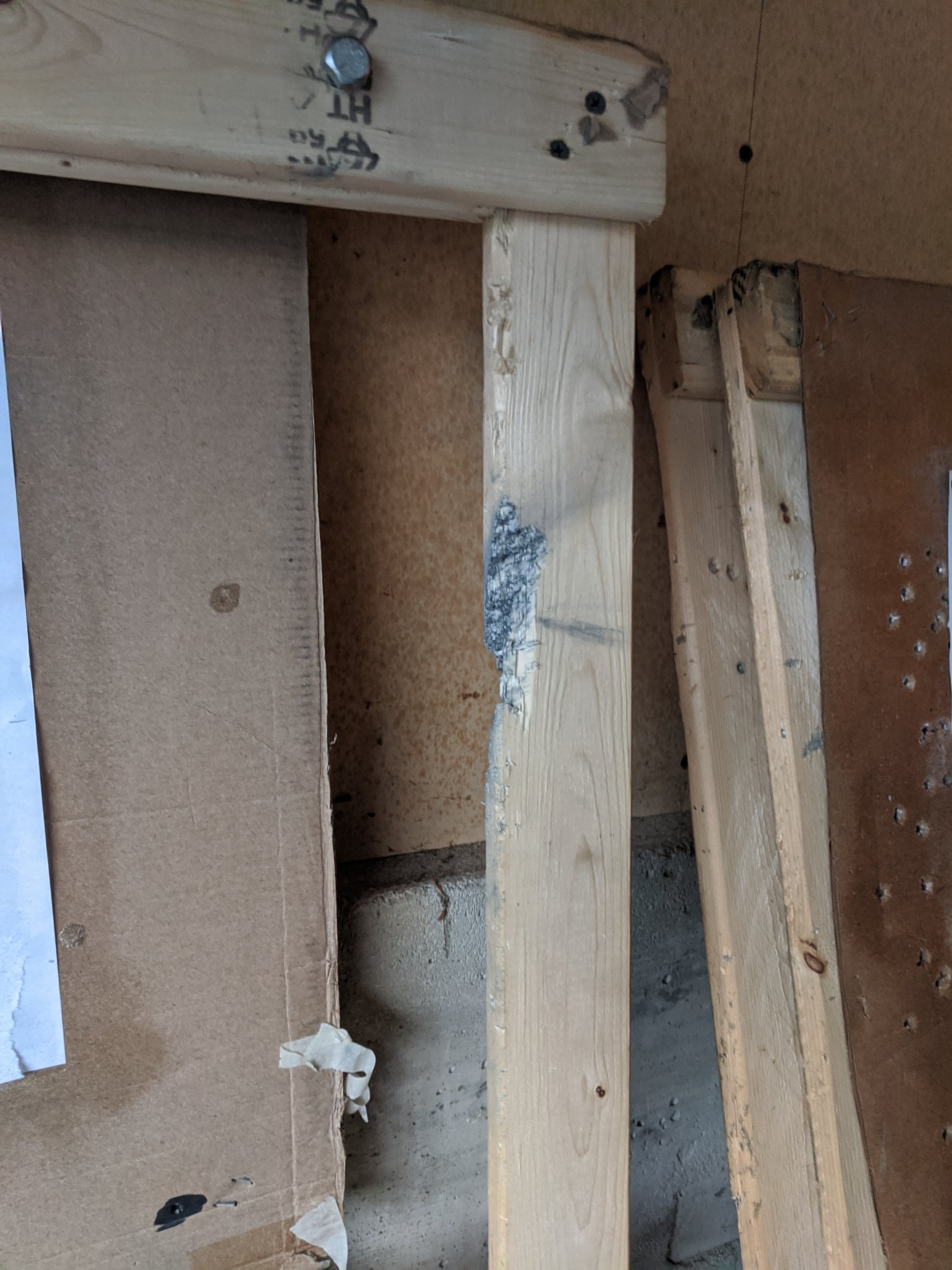

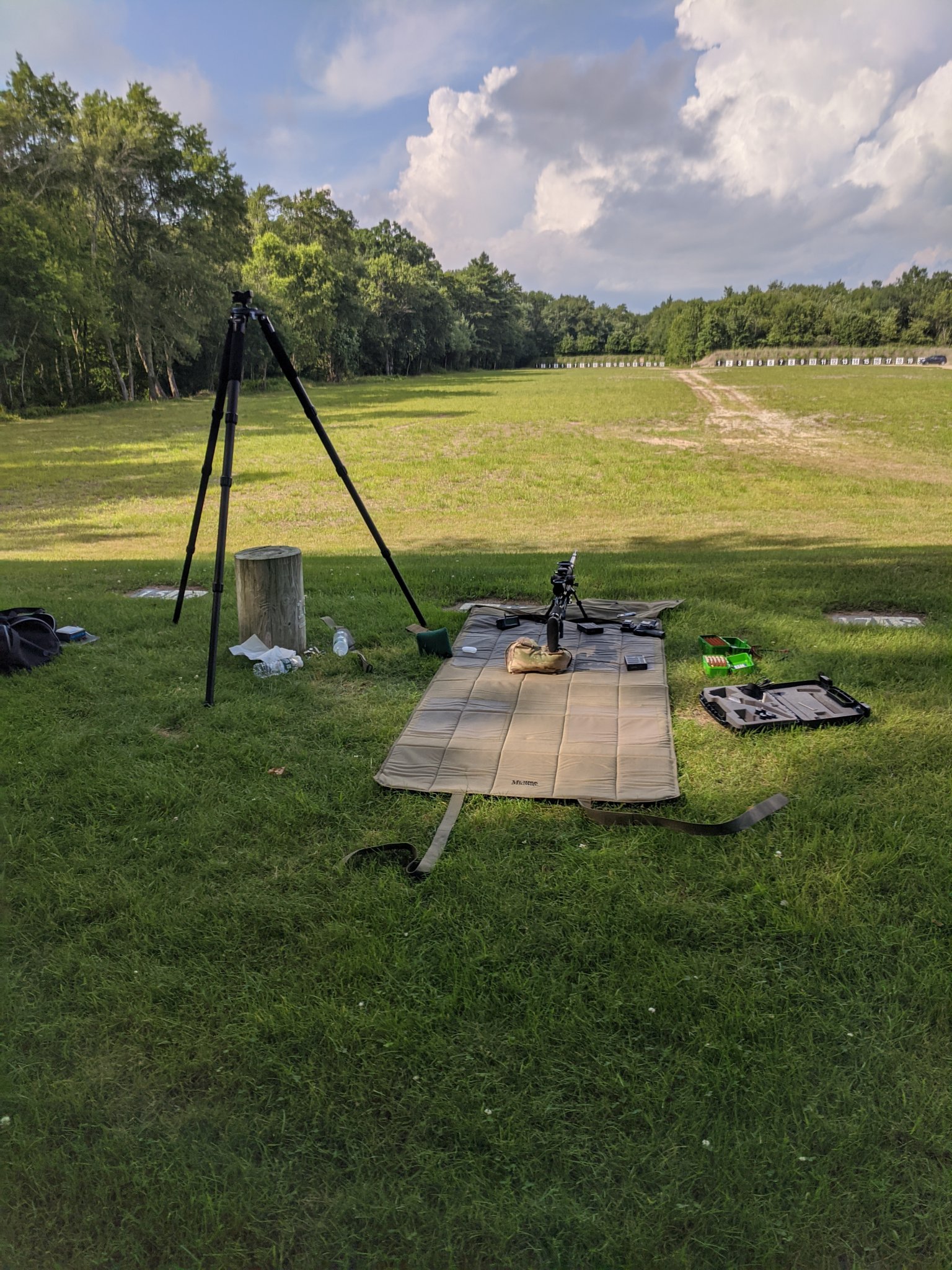

Nice, have the same setup. Today's the first day I was able to get out and really try it out. I only have 300yds available to me. I have this cool steel a buddy gave me. They're 4" round circles (a lil more than 1 MOA) the best I have. I tried to tag each one under a par time. The shrapnel was really tearing apart the target stand. Going to build one a lil wider out 2x4's.

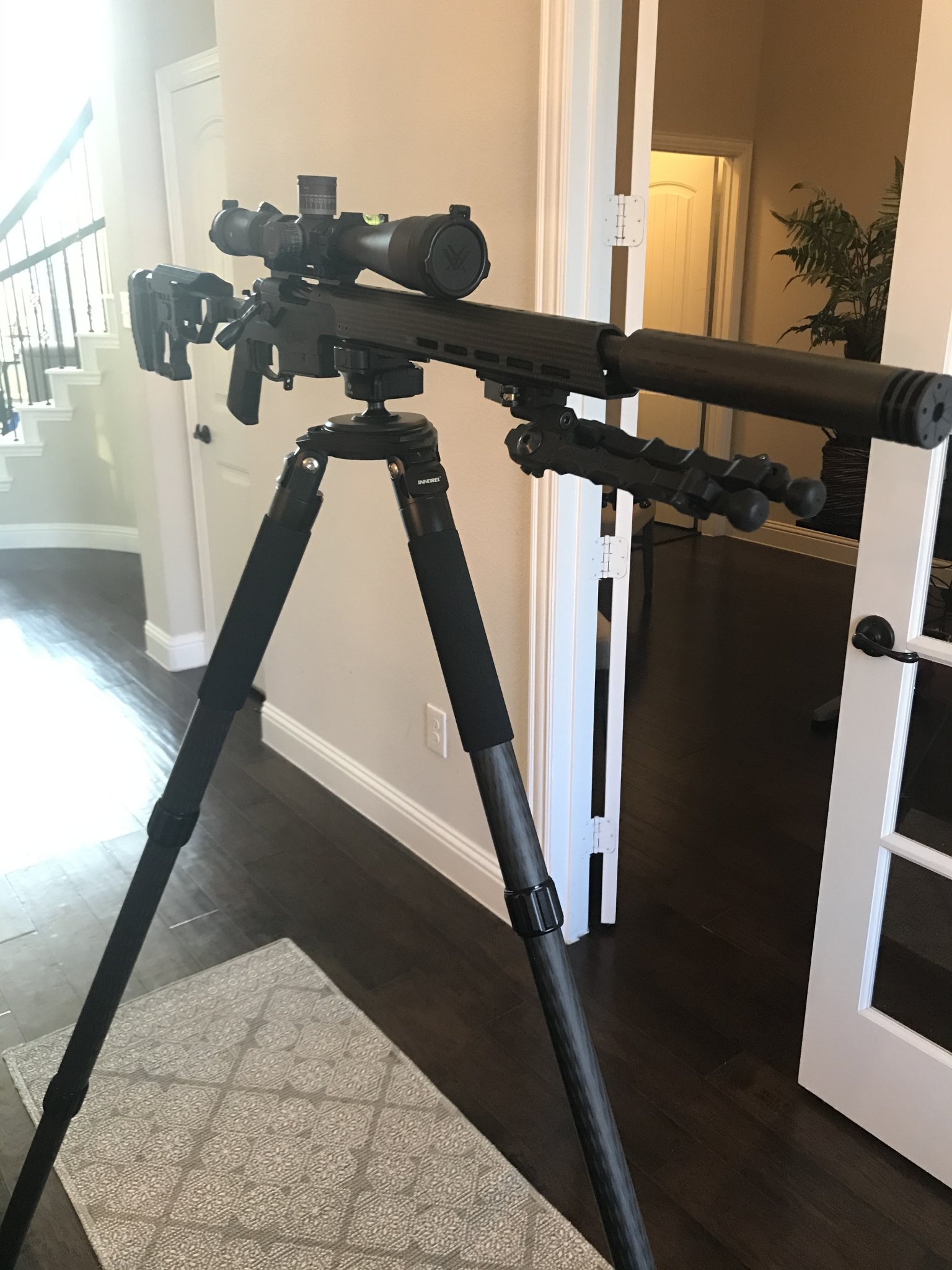

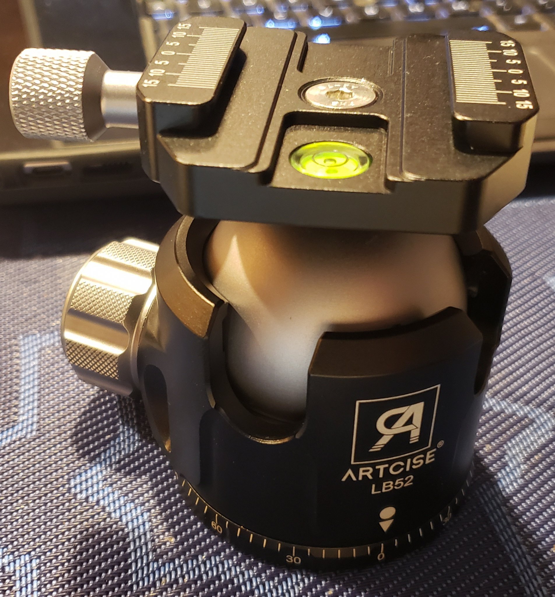

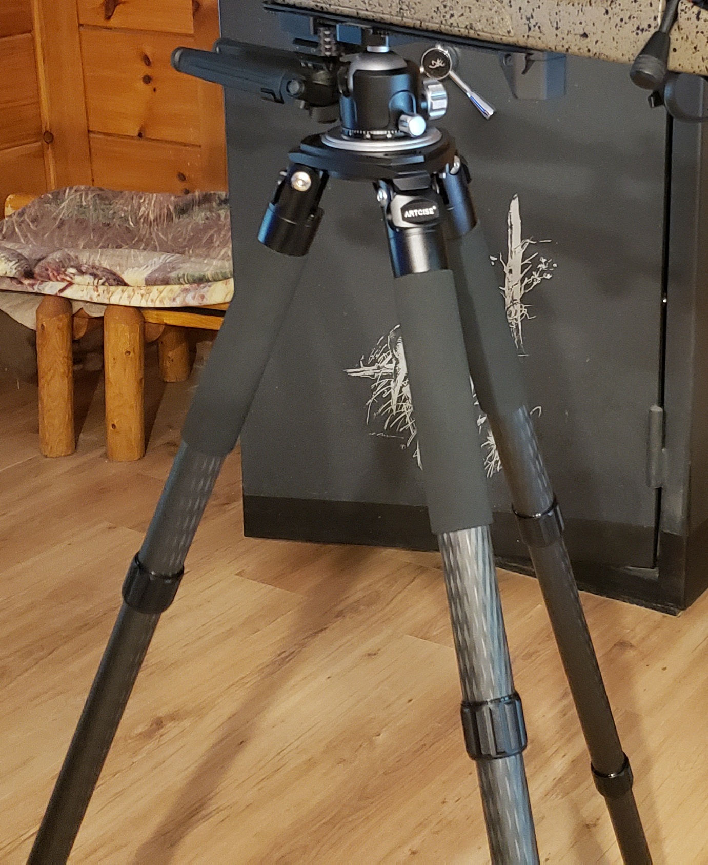

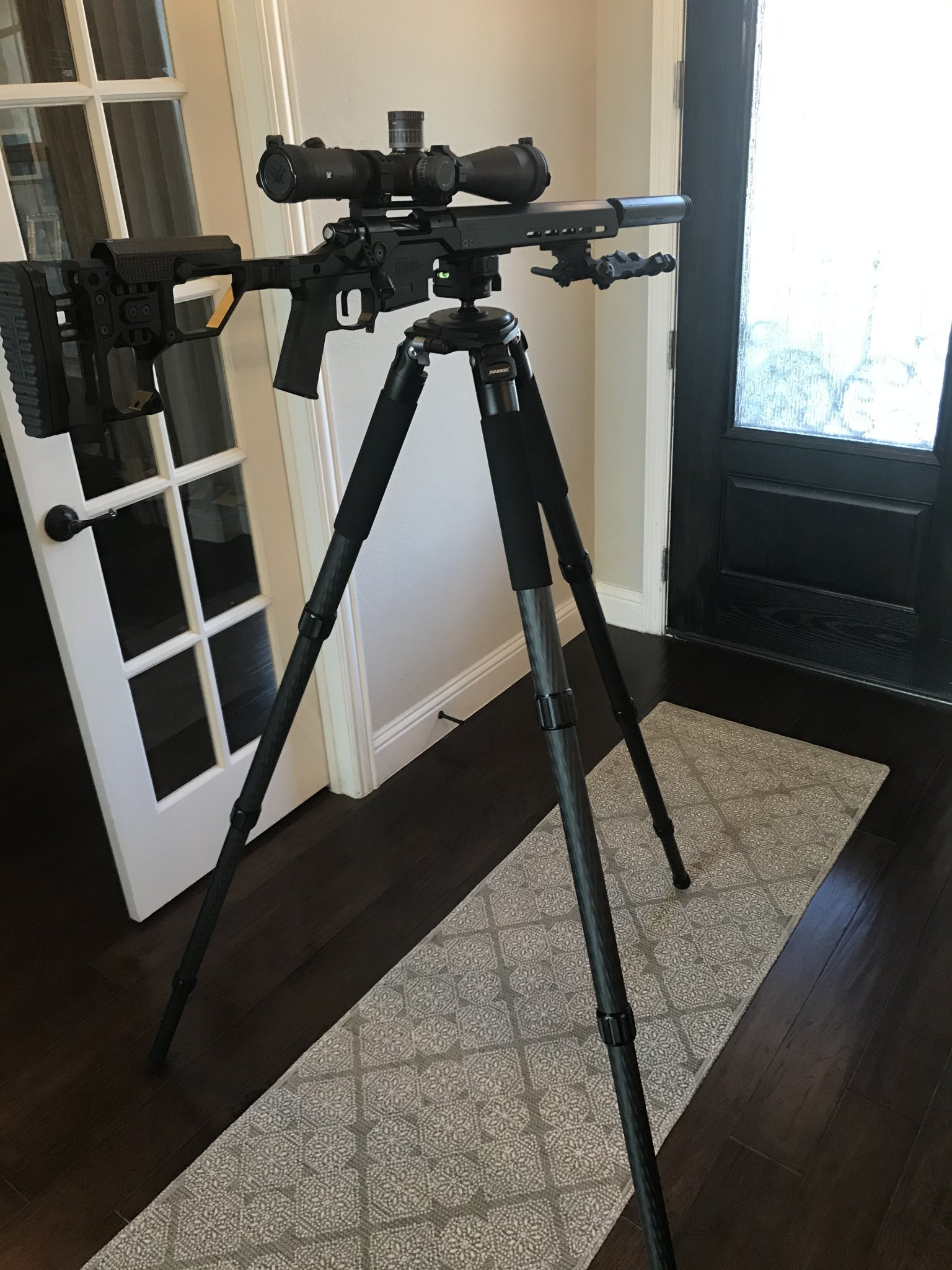

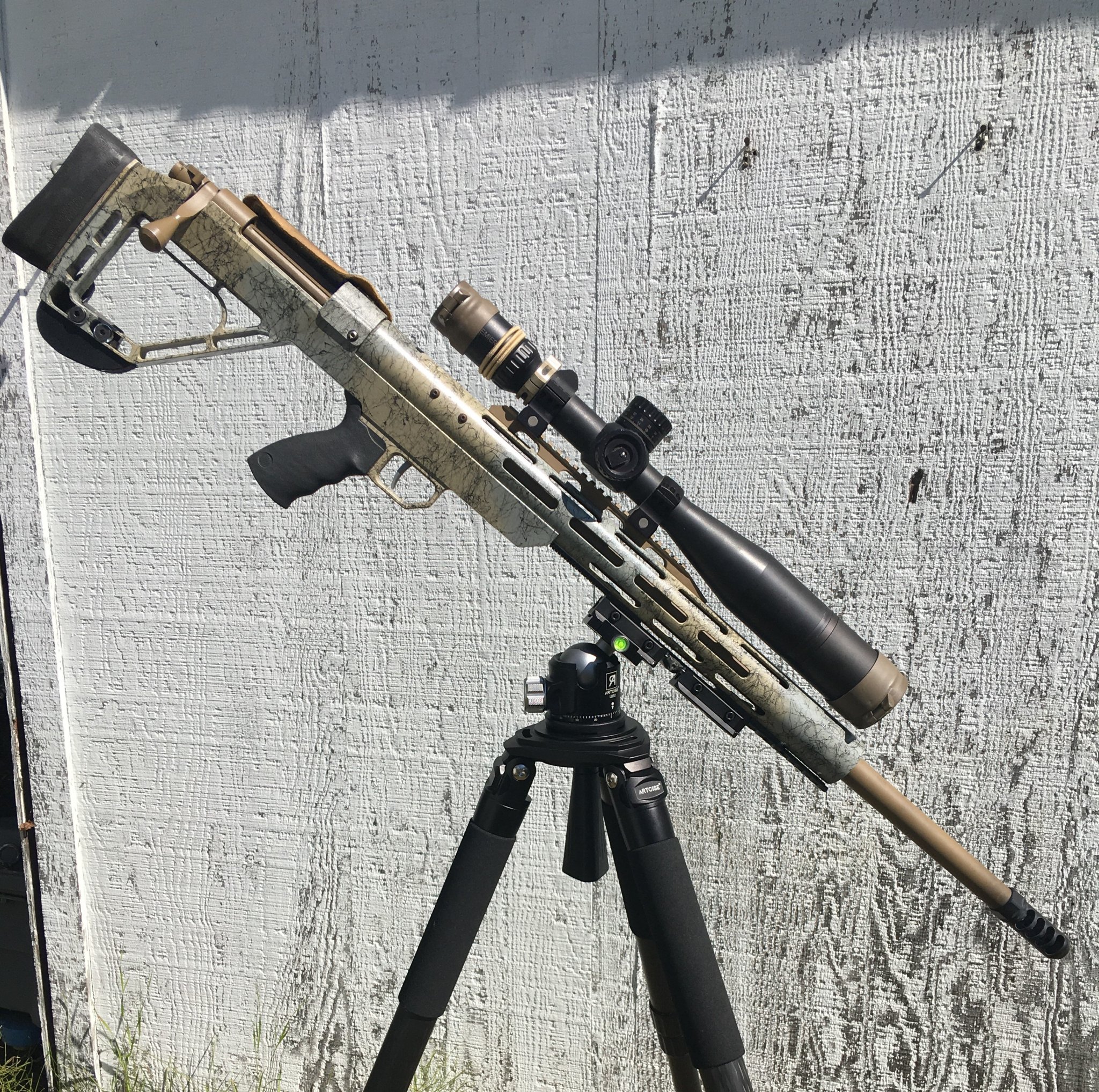

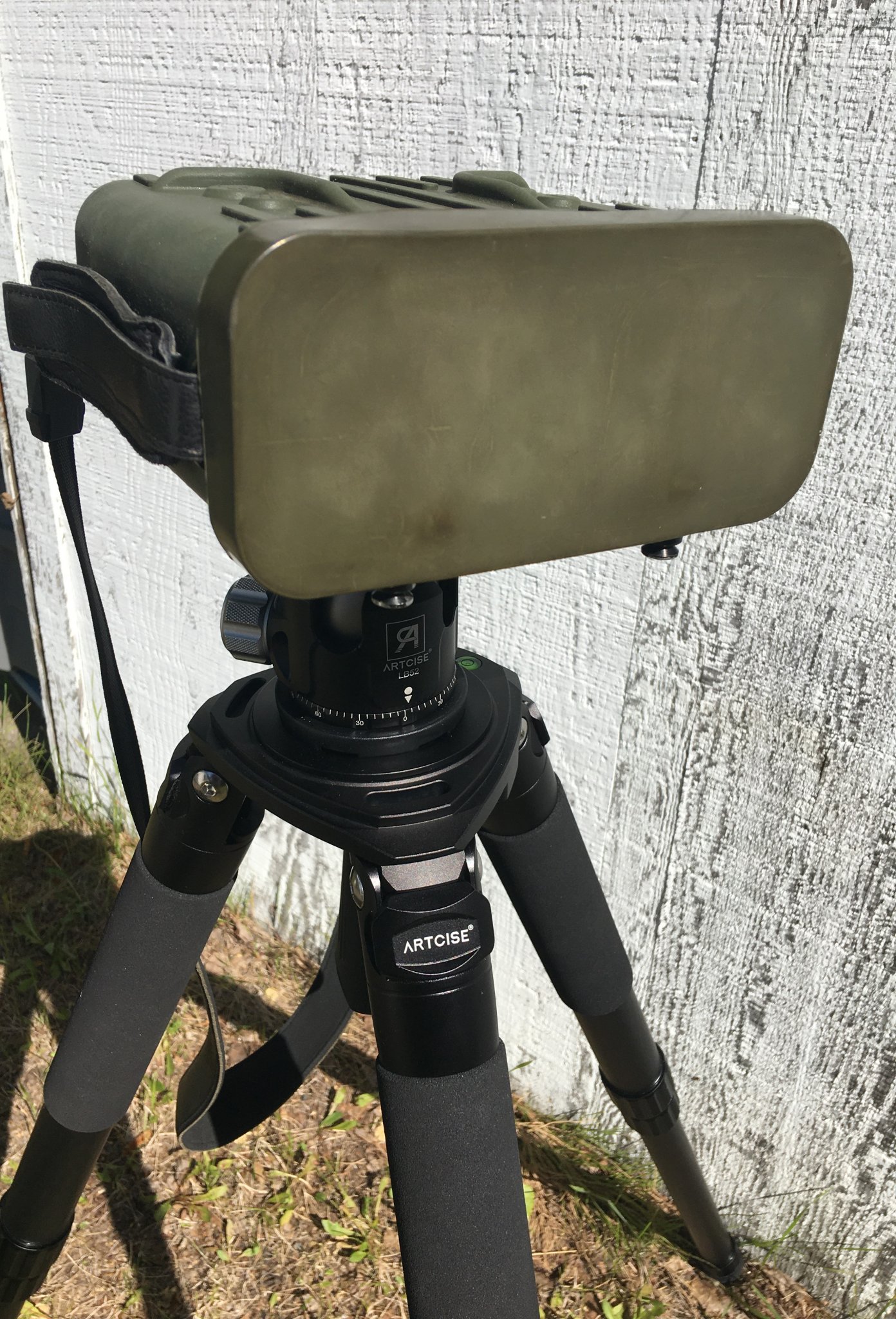

Thought I'd toss this in the mix:
This was an “accidental, well, nearly so” purchase. Originally I ordered another brand, but due its sudden rise in popularity there were none to be had. Thought I’d take the chance as Amazon backed the purchase and sure glad I did. Turns out that this tripod is well made, carefully thought out, exceptionally sturdy, and backed by the company, Artcise, who appear to be aggressively striving to satisfy their customers. Even better; they actually deliver and on time. Just now that in itself is somewhat of a miracle.

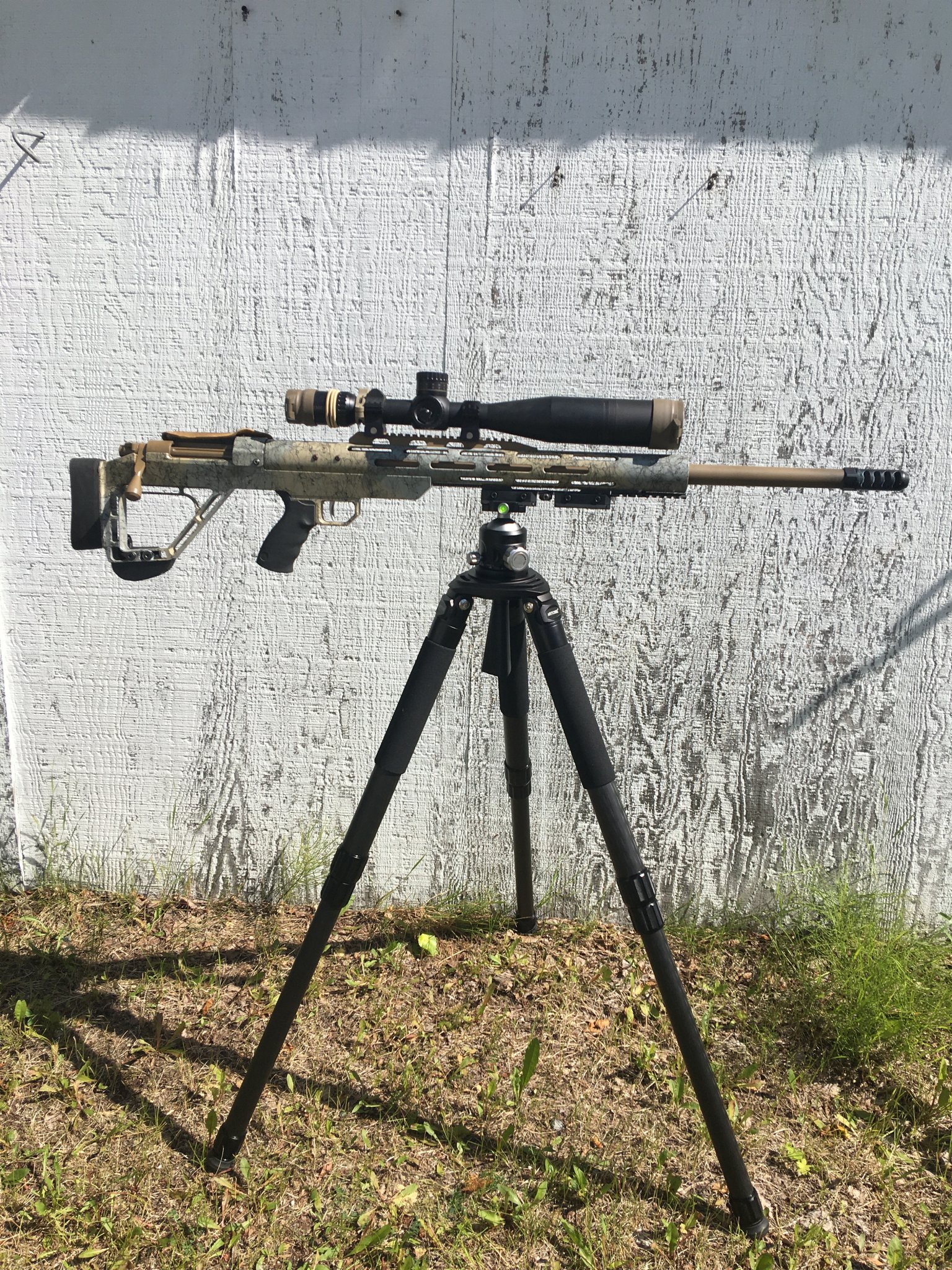

The rifle weighs over 22 pounds which admittedly softens the recoil, but I’ve now shot it several times off this setup and I’ve never shot off a tripod more stable. Using it as a foundation for six-pound laser rangefinders and cameras of similar weight is like they’re mounted on a hundred pound anvil--or your house foundation. Yet, leveling base, head, and tripod weigh but seven pounds 11 ounces, so it’s well within my requirements as my use dictates. I’m really pleased with this entire setup.

Actually, that looks to be the same exact tripod as the Innorel rt90c. I am sure Innorel is not the original manufacturer, too. They source the tripod and just brand it. But by looking at the rubber feet, leg locks and the base that is identical to the rt90c. So yes a good deal for the money.
According to their ads (and I'm unsure how significant this is) the Innorel has eight layers of CF and the Artcise has 10. It all may be "gilding the lily", as we've seen here the Innorel has worked well for many--hence my original order--but I know my Artcise works perfectly for me.
LOL! For all we know it may be Innorel competing with itself.
The tripod, ball head, and fluid head offerings seem to be mirror images of each other as well.
Yeah its crazy to look at all the budget tripod companies and notice that its all the same product. But hey if anything happens to it they take care of it. I got my full leg replacement in less than 10 days from them. And i repaired the failed one so now I have a backup.

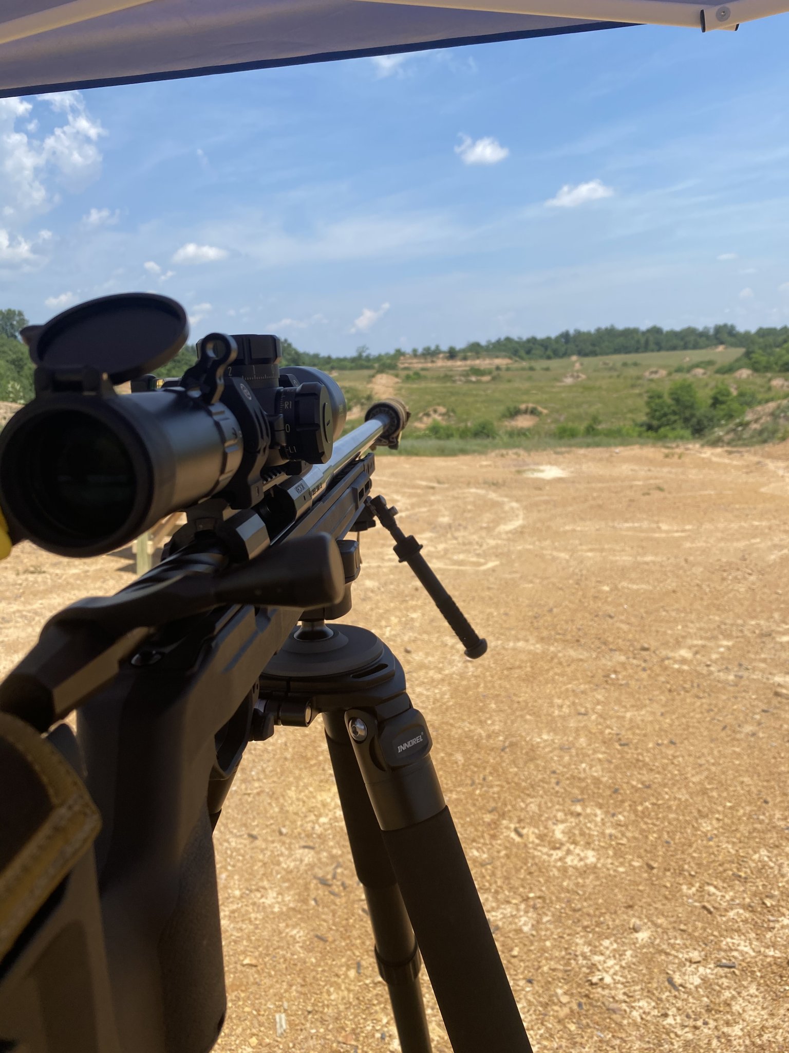

My tripod just showed up along with my Midwest adapter plate I’m very happy with the fit and finish of both products. Midwest was excellent to purchase from and very fast shipping. Plate made it here before the tripod. Anvil 30 should show up tomorrow. Thanks everyone for all the info on this tripod setup
I think it will work perfectly for my use.

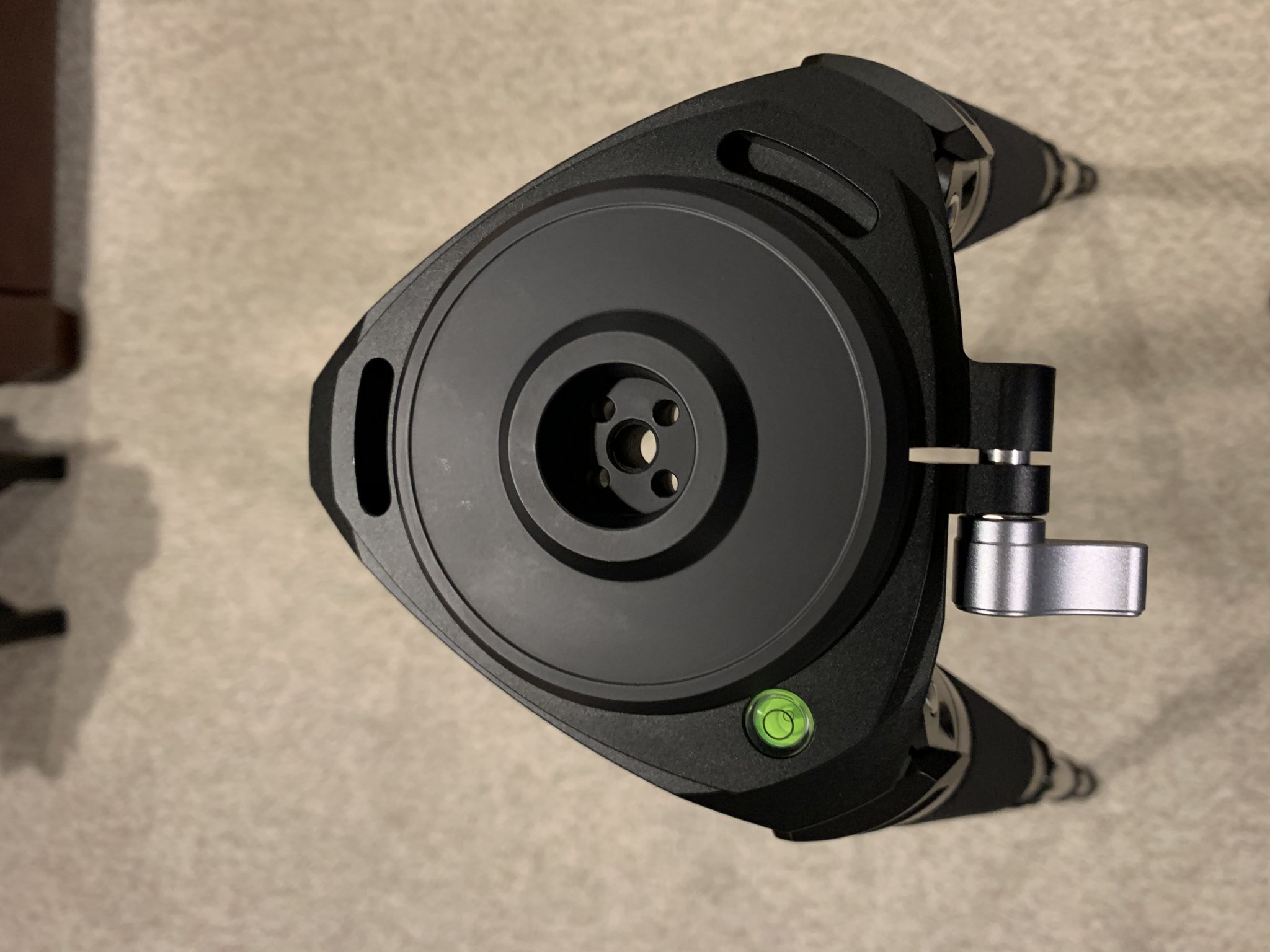

Been following this thread but I'm confused. What does the head do that Midwest offroad sells? Does it just offer a better mount for the RRS Anvil?
Basically
Standard you only have one screw in the middle. Nearly impossible to get an anvil on there tight enough with just the center screw for it not come loose eventually. Midwest plate fixes that issue so you don't have to worry about it ever coming loose.
So as mentioned the Anvil with the standard plate will mount only via the 3/8 stud. Which can allow the assembly you loosen upon panning.
The anvil has a tapered mount which so does the mount I offer so you can mount via taper and 3/8 screw I include or the 4 socket head cap screws (included) or a combination of both .
I have done a few aadapters using the mod 3 plate for those thinking they will upgrade to a RRS tripod at some point
Here's a video showing why the taper mount is much more rigid lock up of anvil to plate next to using the original RRS tripod mounts
