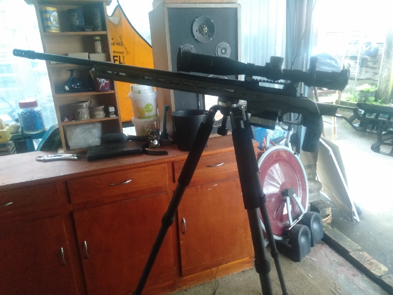

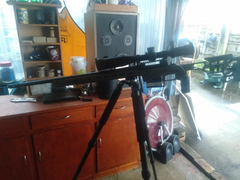

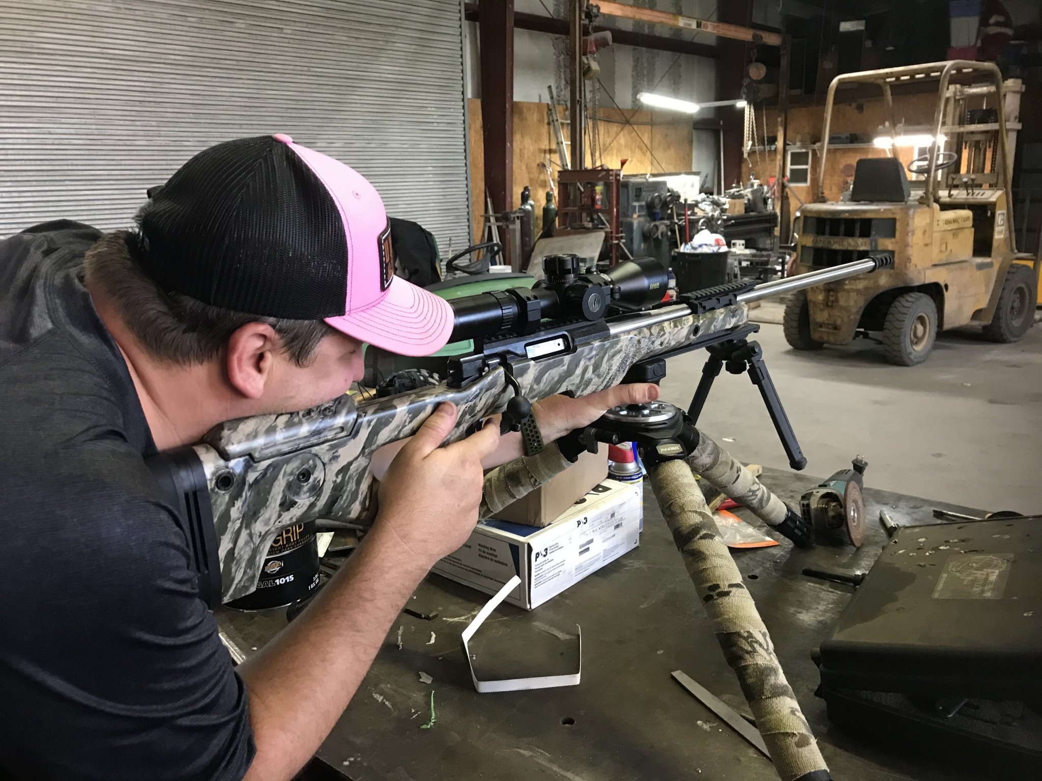

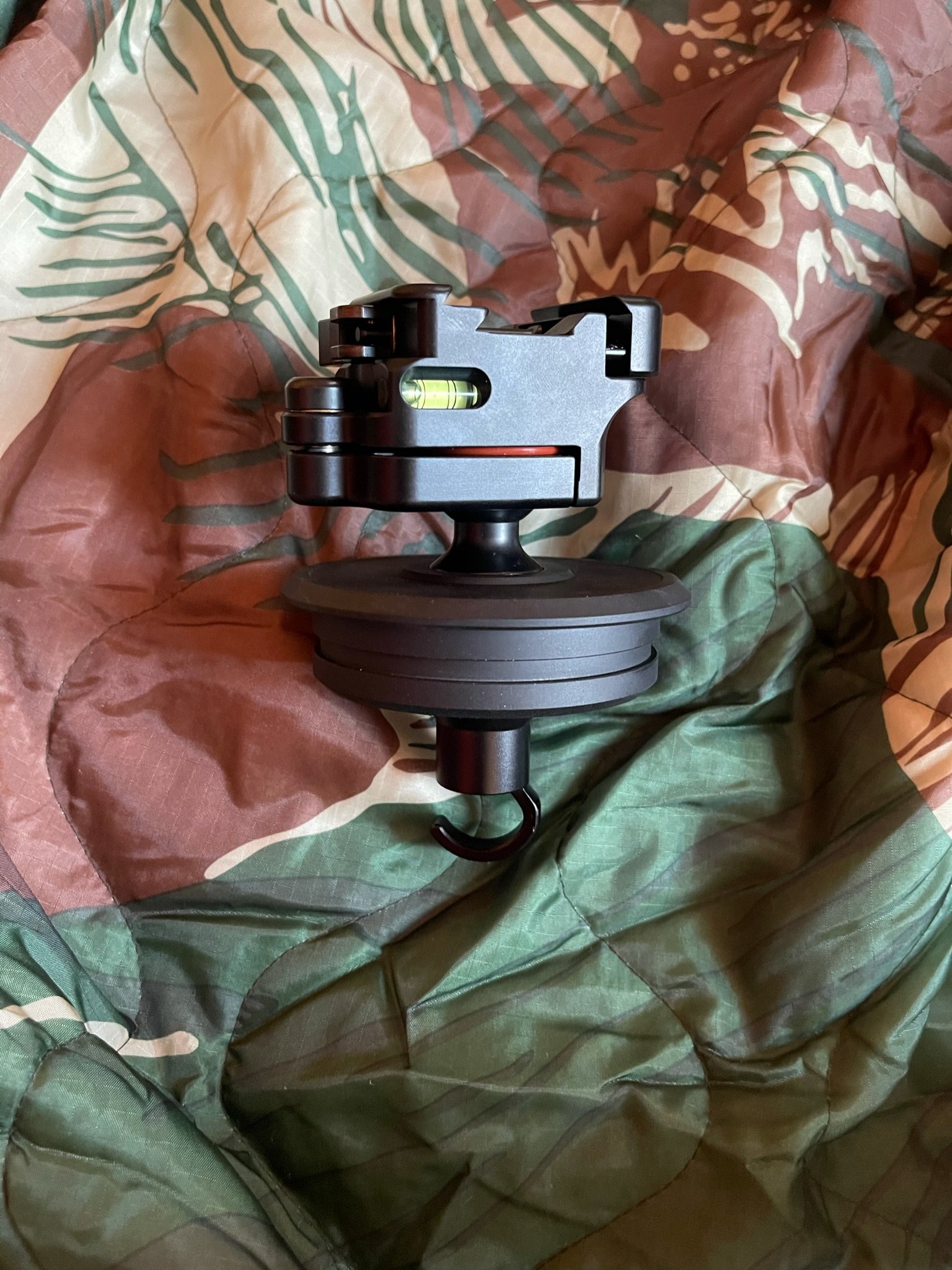

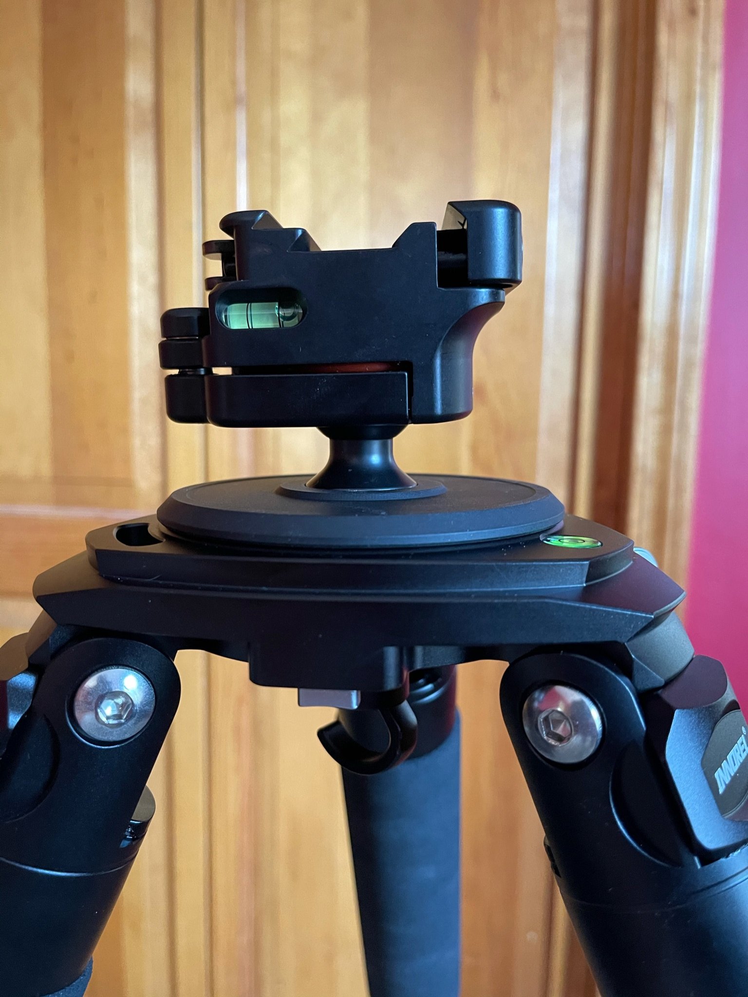

First attempt at a homemade adapter.

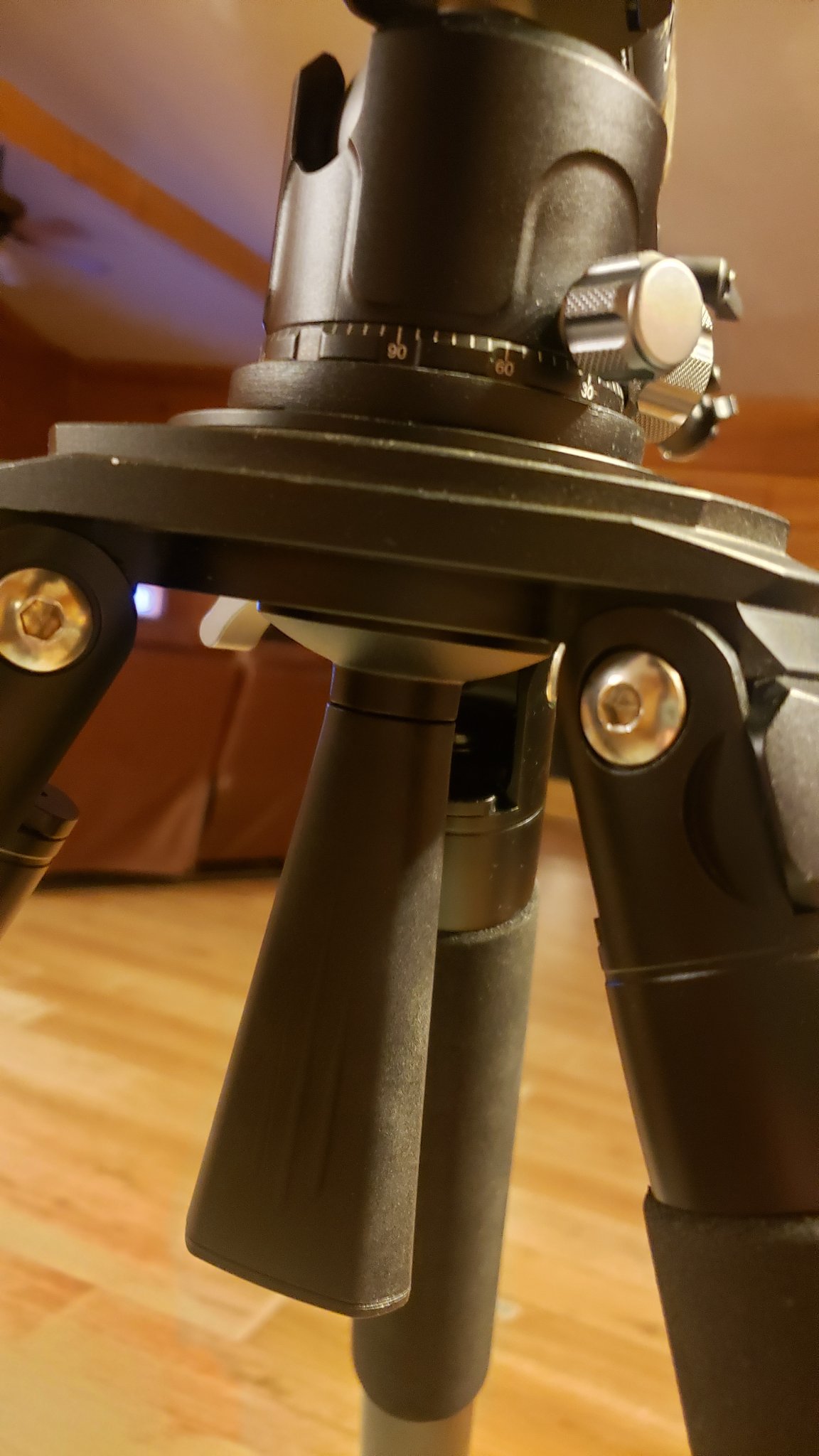

Simple fix for this condition.... Unscrew the handle from the base, you will see a snap ring that holds the round friction portion to the grip. Remove the snap ring (you won't need it). Separate the two pieces and insert a heavy duty O-ring, then reassemble. Now I have sufficient friction I can move the base without it being too difficult. It solved the either "loose or tight" problem with plenty of friction in between.
Thanks for the tip. Base works much better.

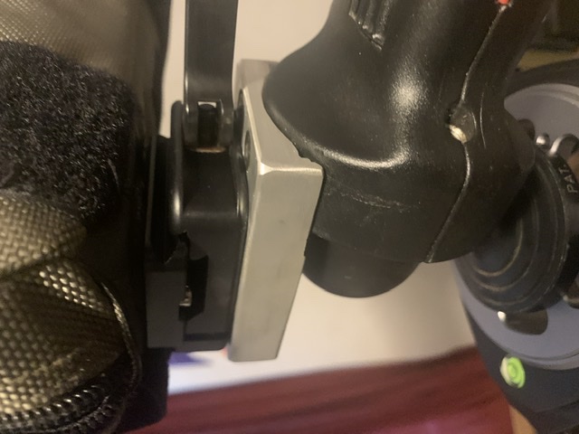

I made o conversion for the 322 to hold a rrs sc lr clamp centered over the ball. I can tell you that 90% of the wobble is in the rc2 clamp and tge fact its not strait over the ball. the 322 locks up pretty good

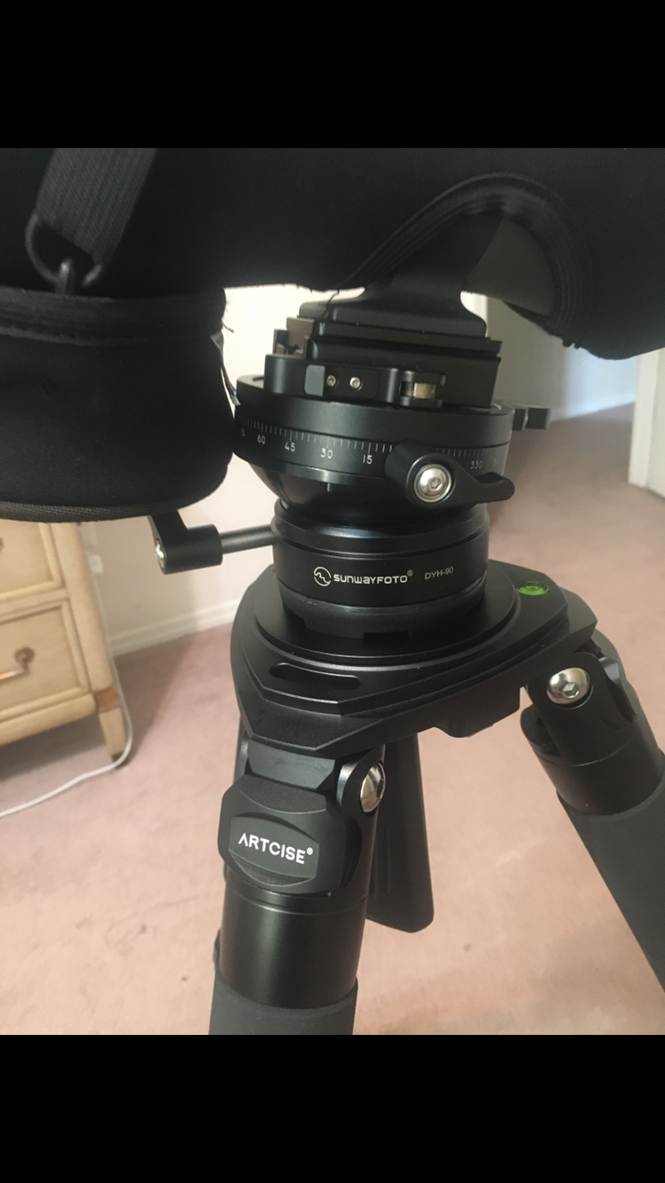

I ordered the artcise since I found one of the open box models. Not specifically for shooting off I went with a leveling base that had pan for my spotting scope. I usually run just the flat plate adapter for the bowl, but I was trying to get it to point high enough to see Jupiter last night.

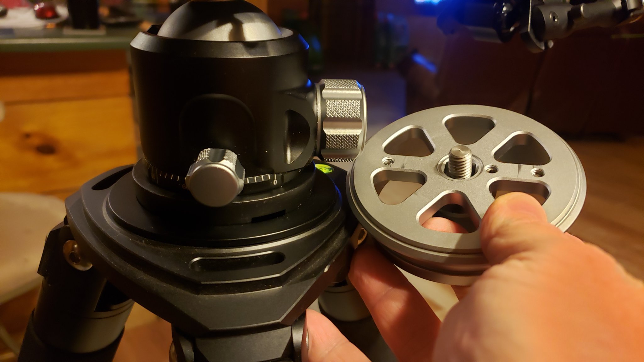

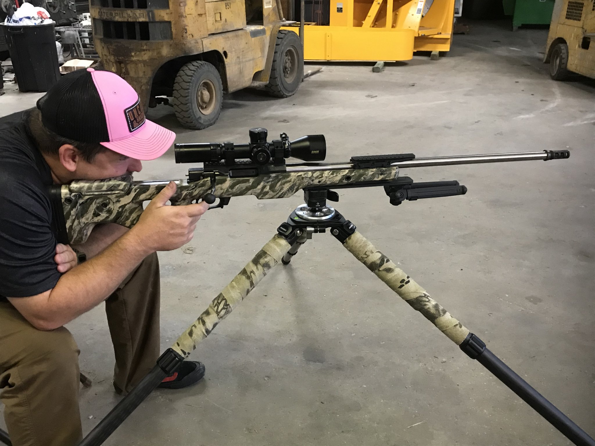

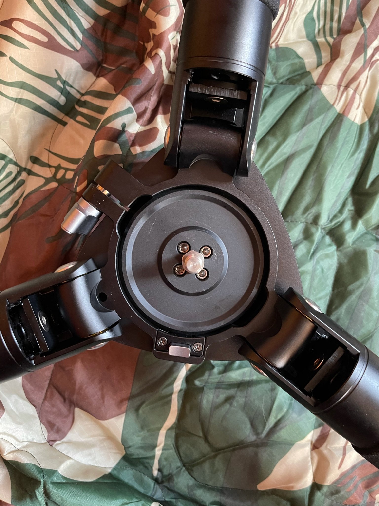

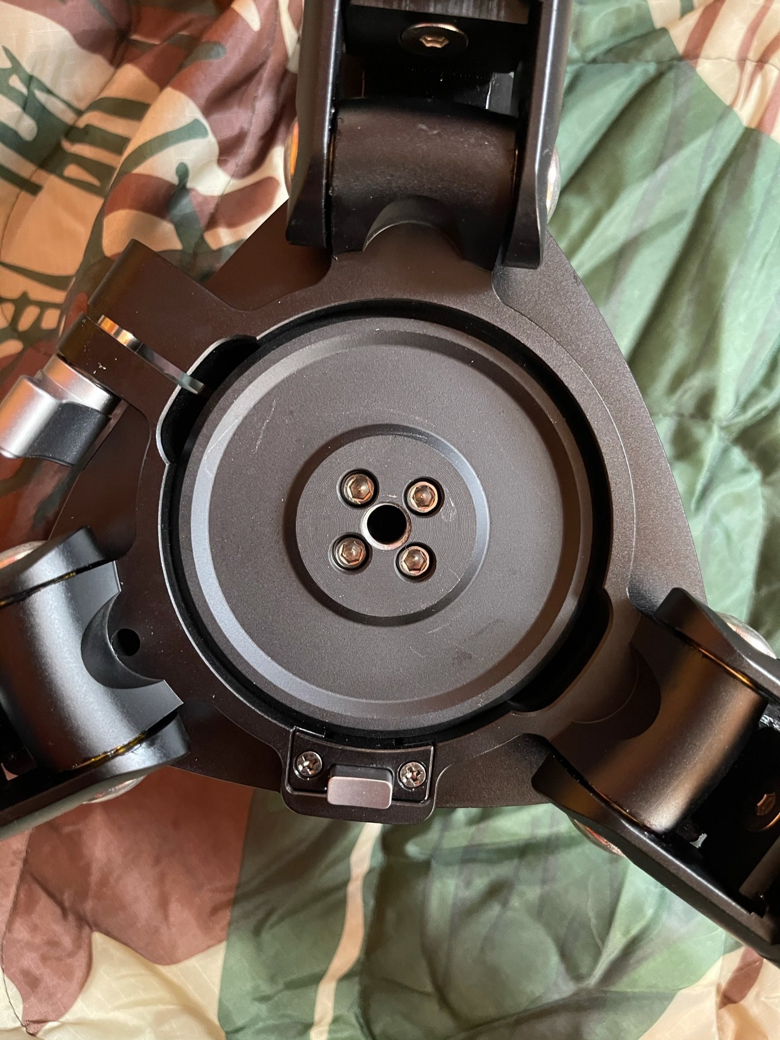

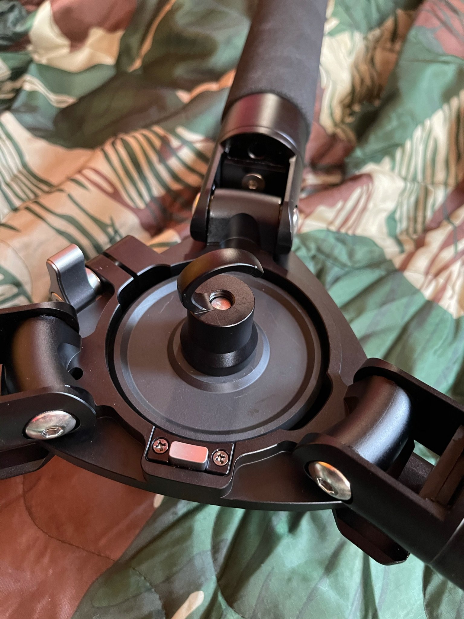

It's pretty intuitive once you have all the parts in one place, but pictures of how the RT90/Anvil-30/MidWestOffroad outfit works never hurts. I went the four bolt route and use the center hole for the weight hook that comes with the RT90.

Looks good . I know I don't include instructions. .
You can use the included set screw and twist it tight . Or use the 4 bolts . Sometimes you get lucky and can use both.
The center hole can be used to remount the hook or using the set screw separate the 2 halves if needed.

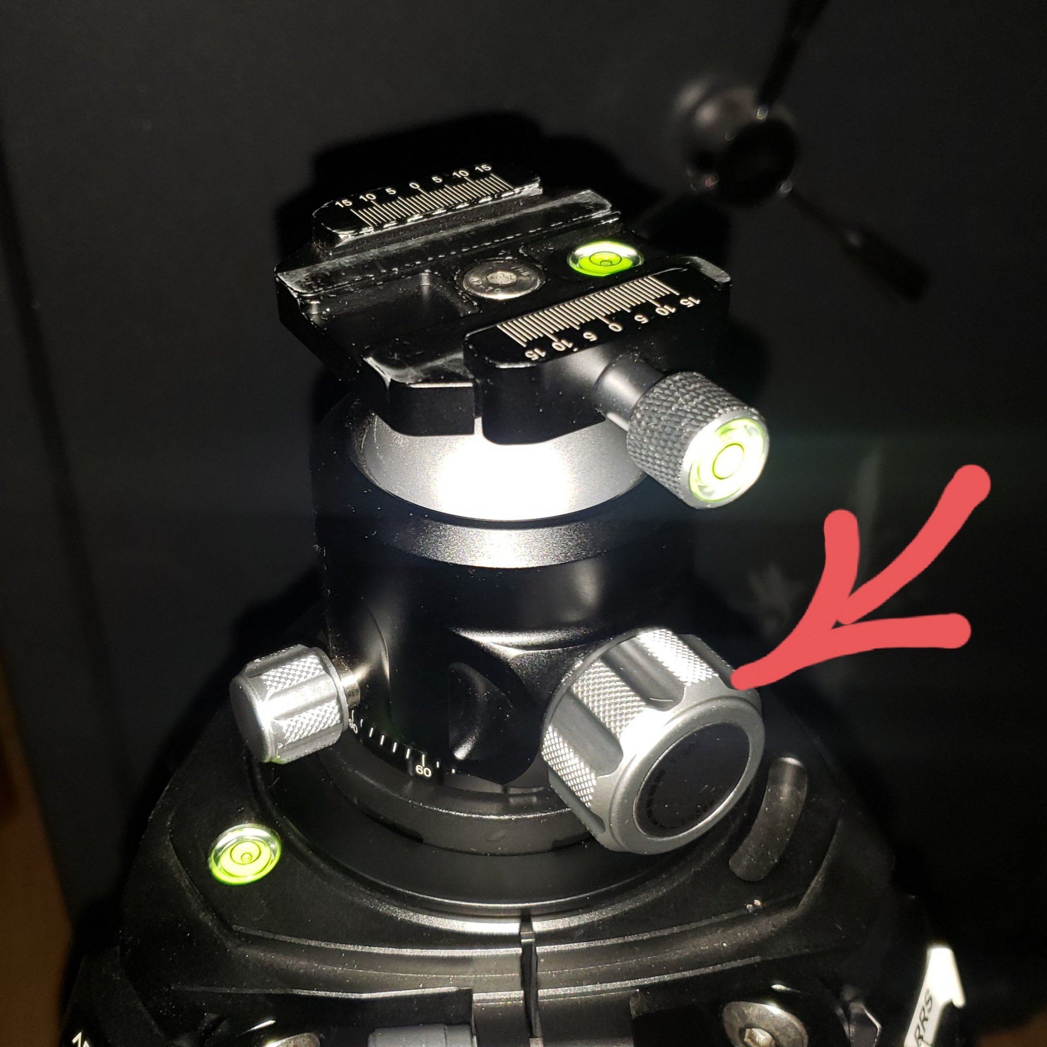

It is much more stable with the bottom pivot vs the non pivot base. There is too much flex in the non-pivot base and the ball head. For the money I believe it is hard to beat. Note:I have never shot of any RRS tripods or ball heads.View attachment 7482618
Thanks, man. So is it easy to set in place, yet move to another position, and have it stay there like the Anvil 30?
It's as easy as turning this knob. Then you can pan and tilt till you are set then tighten the know. Again I have never used an Anvil but my tripod and ball head cost the same as just the Anvil.

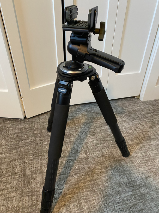

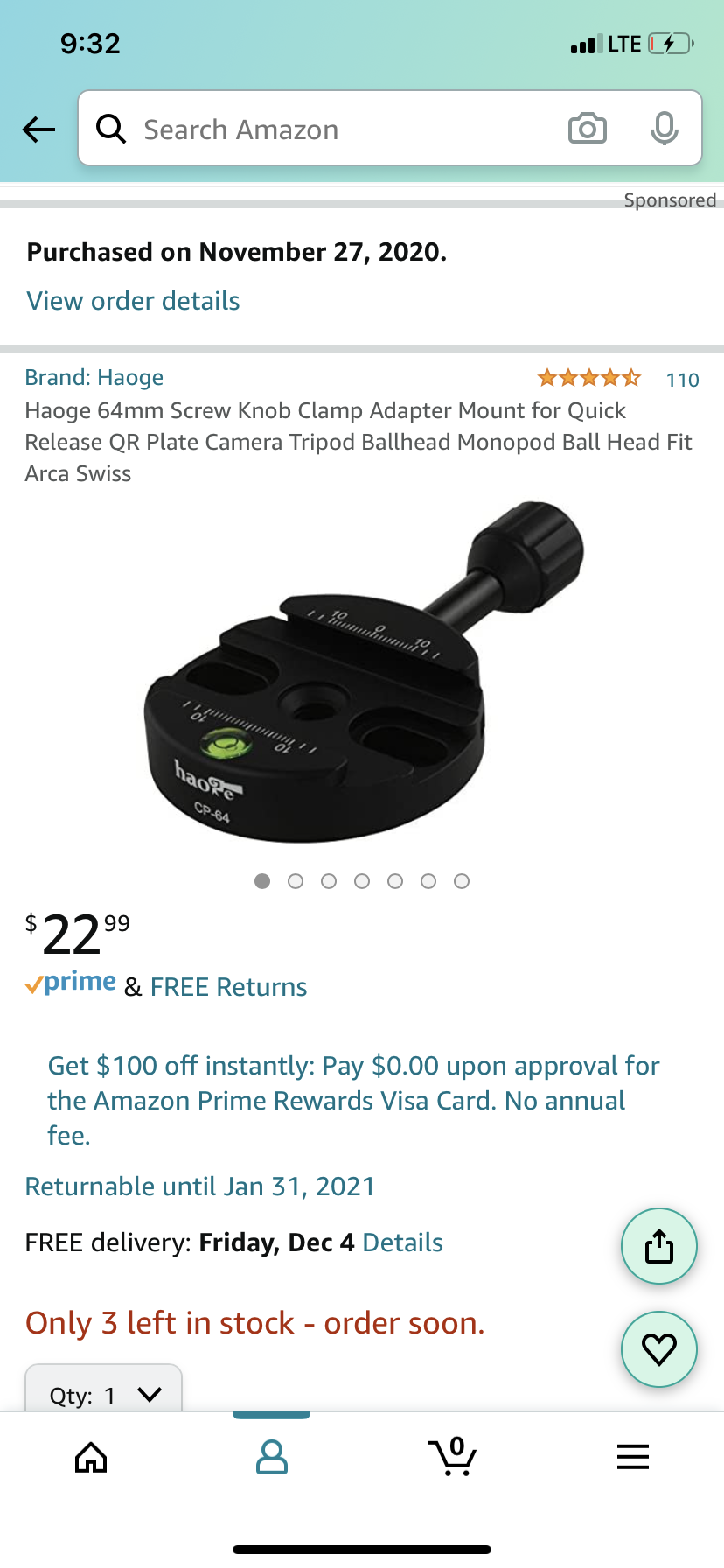

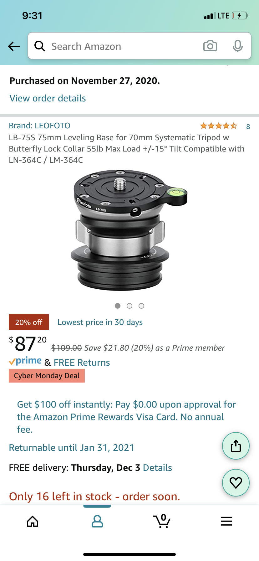

I needed a second setup for night hunting, so I ordered this combo. I’ll report back when I get it together. I’m currently using a PVA with a RRS leveling base that works fine, but is not worth what it costs. I’m thinking this will be in the same ballpark for much less.
Wow—100+ lb weight rating? How much does that tripod weigh?
Also—do you prefer that head setup over a ball head? I find a good ball head will easily hold a 20lb rifle securely at any angle with minimal torque required on the locking knob, but always open to new ways to do things.
I never looked at the weight. The rifle weighs over 25 pounds with the simrad attached, so that’s of little concern. I had a 52mm Ballhead before the leveling base and I did like the tension knob placement on that unit. However, the leveling base has a lower center of gravity and imo it’s more stable. I’m trying that Leofoto leveling base for the ergonomics. Sometimes getting a hand on the TA-3’s stem between the legs is a pain in the ass when you have cold weather gear on and you’re in a hurry.
Cool. Looking forward to hearing how the setup works out. Please keep us updated on the ergonomics.

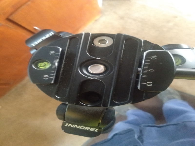

Any difference between the Inorell RT90C and Antcise AS90C? Guess just rebranded.
I shoot with the guy who owns two vets and I’ll say the other tripods he’s selling are pretty dope, especially the new two piece with the lock adjustment on the top of the legs. The 40 mike mike is good, but it’s probably a rebranded RT90C or whatever the manufacture wants to call it that’s week.

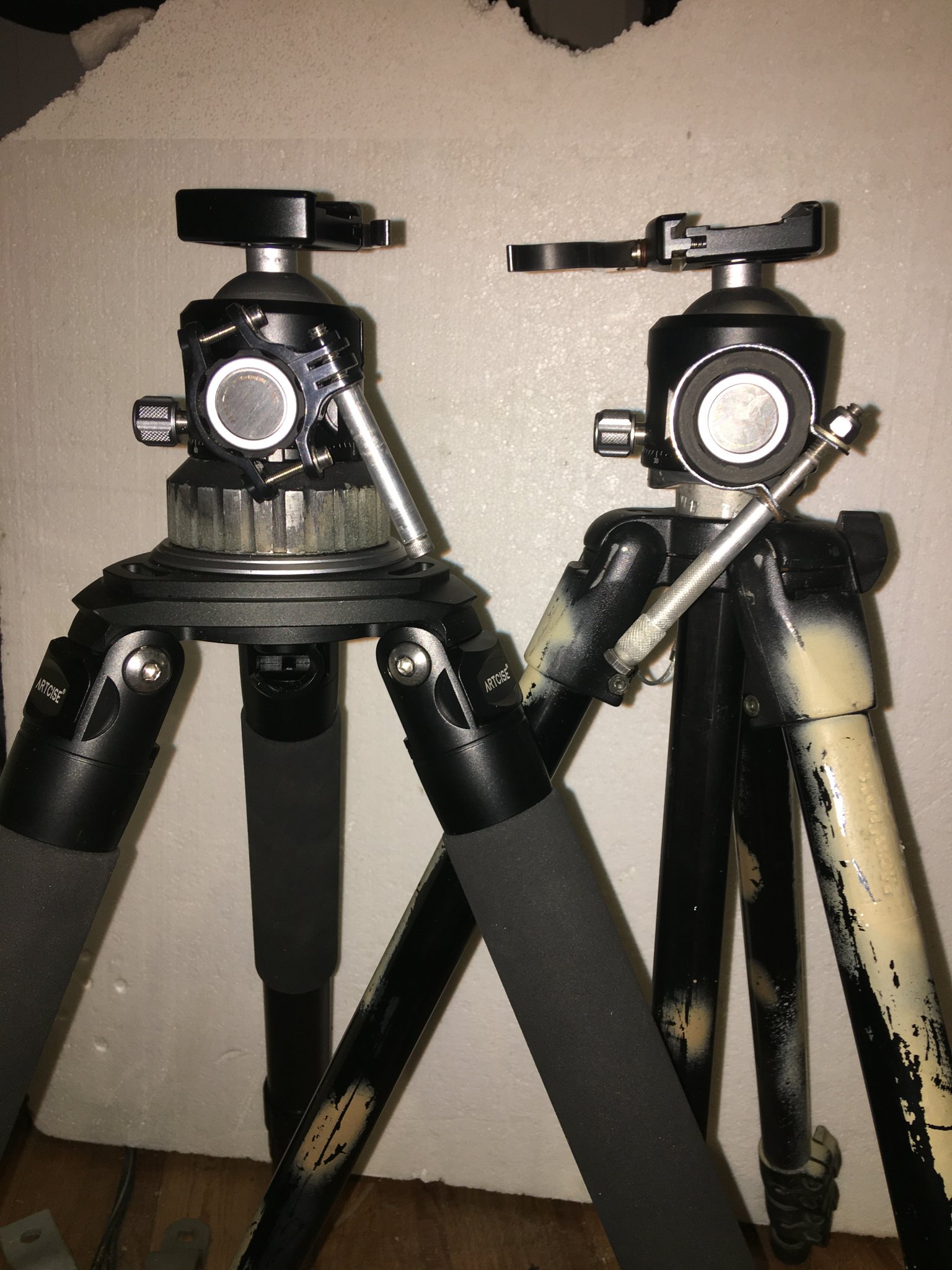

I have the Arctise AS90C, a 52mm from Arctise, and the exact same 52mm from Innorel. Upon receiving the first of these I was very pleased with the smoothness of the movement and its constant and predictable clutching. Long story short I put these levers on one night and alas, they really work well. I've used them for all sorts of things; rifles (from 9# to 22#, 270 and 338LMAI), cameras, rangefinders, and even a table top. Here's a photo showing "too tight" on the left and "too loose" on the right. The arc is around 300* no need for a full revolution which makes them very fast and simple to operate.
I have the Arctise AS90C, a 52mm from Arctise, and the exact same 52mm from Innorel. Upon receiving the first of these I was very pleased with the smoothness of the movement and its constant and predictable clutching. Long story short I put these levers on one night and alas, they really work well. I've used them for all sorts of things; rifles (from 9# to 22#, 270 and 338LMAI), cameras, rangefinders, and even a table top. Here's a photo showing "too tight" on the left and "too loose" on the right. The arc is around 300* no need for a full revolution which makes them very fast and simple to operate.View attachment 7486953
left one a repurposed Go-Pro mount? Brilliant!
Found the same deal for Cyber Monday. I am going to give it a try as well. I like the thought process behind the ergonomics. If it doesn't work out I will send it back and save my pennies for a RRS ball head.
