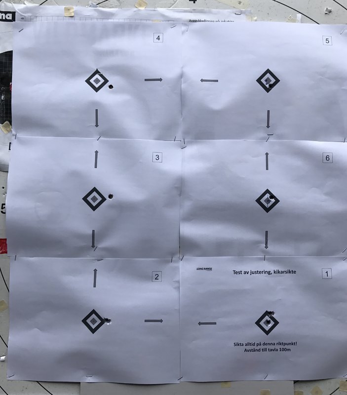

Hi!
Much appreciate som thoughts on the results from my first boxtest on my new Razor AMG mrad version. The box was mounted with a plumbline and measured distance between the dimonds
(300mm horizontal and 210mm vertical). Dubble checked turret settings each time (3.0 side and 2.1 vert), distance was the 100m line on my local range. I have not verified the range but target was on the normal stands.
Will shoot it again, but my inital fear is that the horizontal clicks are off by almost 10% ....
Or am i worrying needlessly? :)
I don't shoot box test anymore because of the results you are seeing. You need to take a look at Killshots scope test and try to duplicate it best you can. By shooting the targets you are introducing human error. Not knocking your shooting ability, just fact. I don't have a setup like KS but I've measured, with a tape, 50 yards exactly and strap my rifle in a gun vise to perform my tall target test. Works fine.
If your reference measurements are indeed correct and a stiff wind didn't pick up between your vertical and horizontal shots, or you didn't suddenly start pulling to the right.........................yes I would agree it appears your wind-age turrets are off.
Hard to say without having a reticle to measure how far apart the dots are. Were the diamonds exactly 3 mils apart?
Yes when i measured with the reticle on the diamond left of POA, it lined up perfectly with 3.0mrad. The hits are about 2.5cm right of the diamond which translates to 2.75mrad or 9.2% difference...
