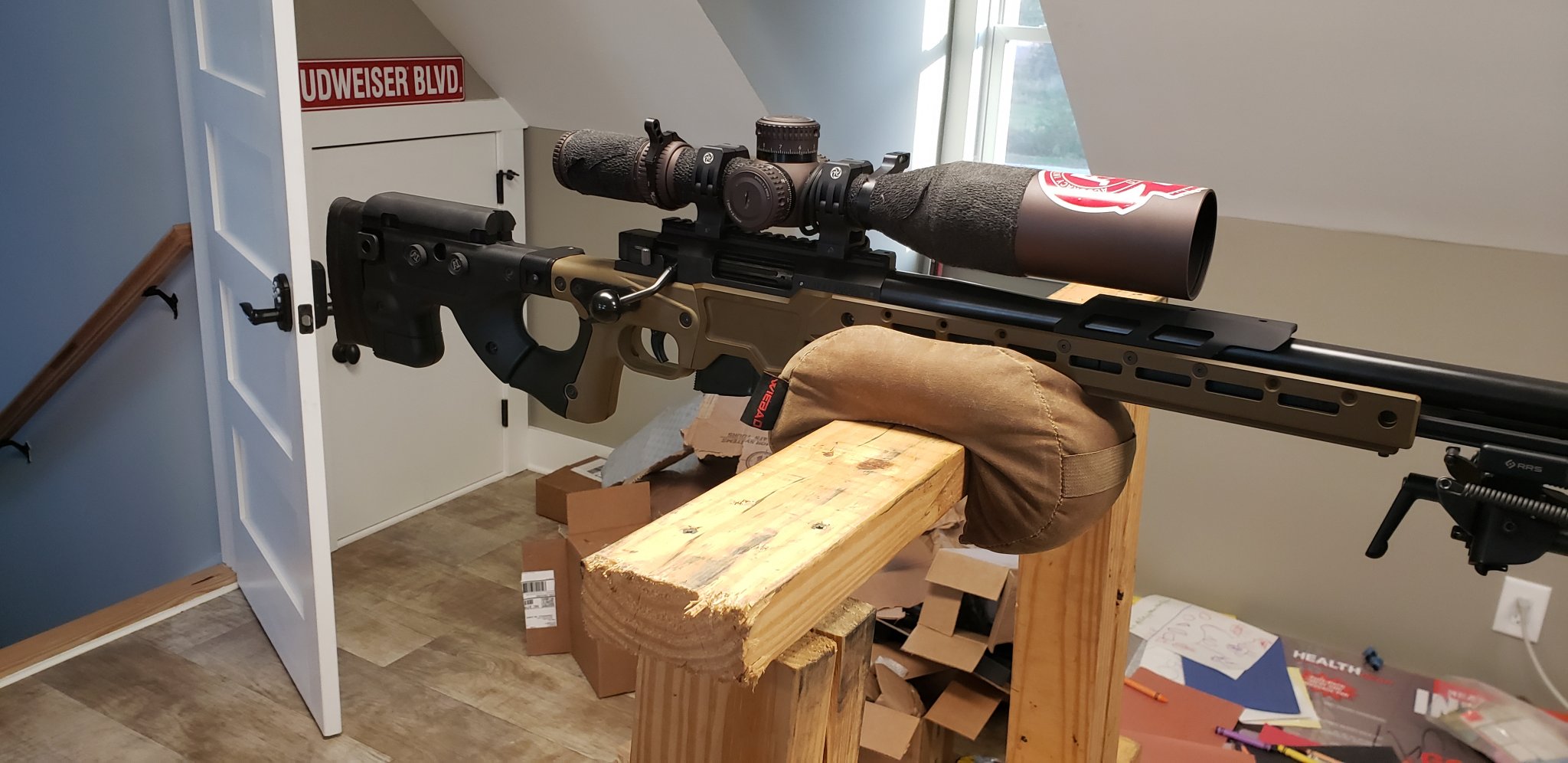

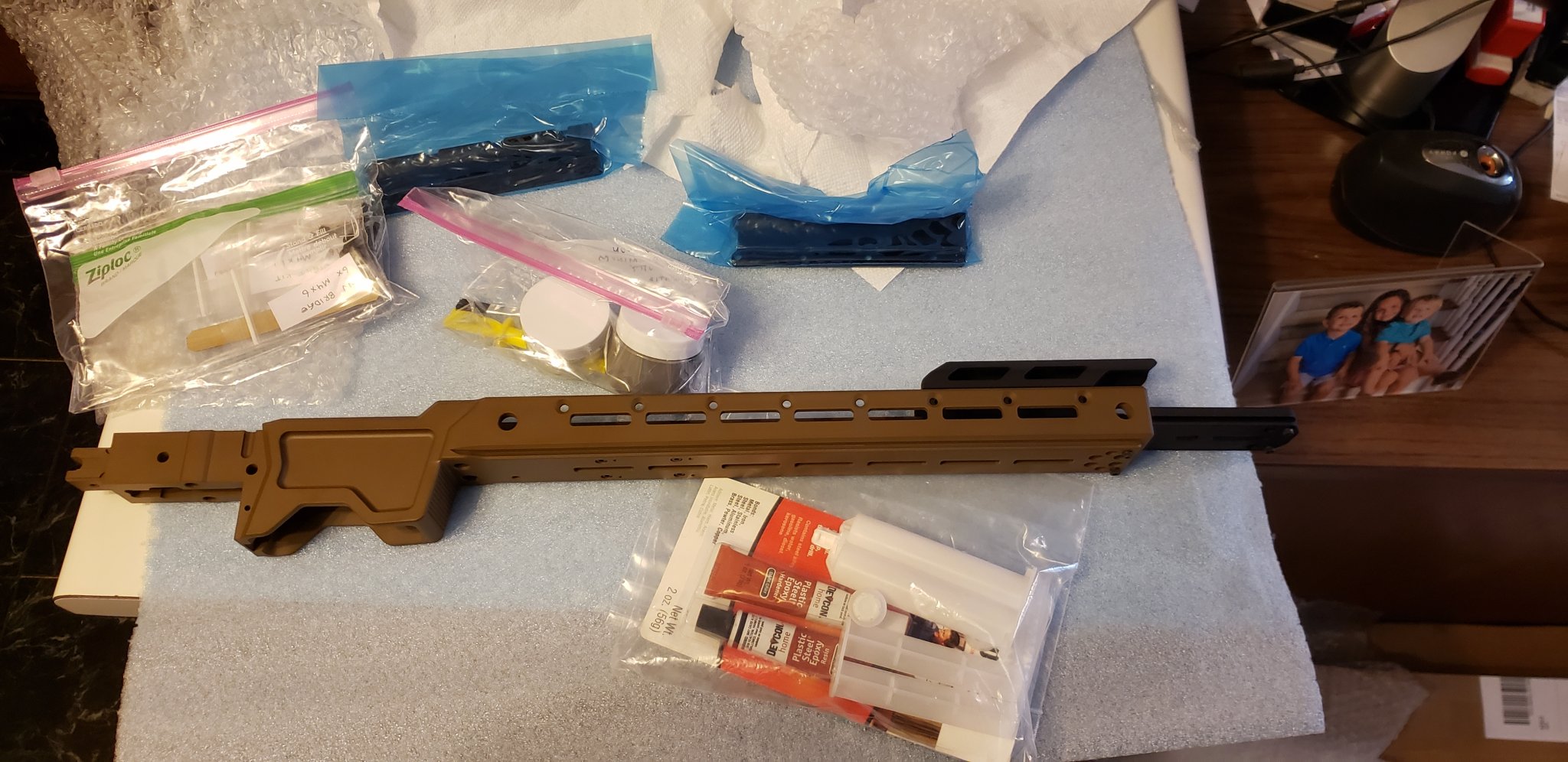

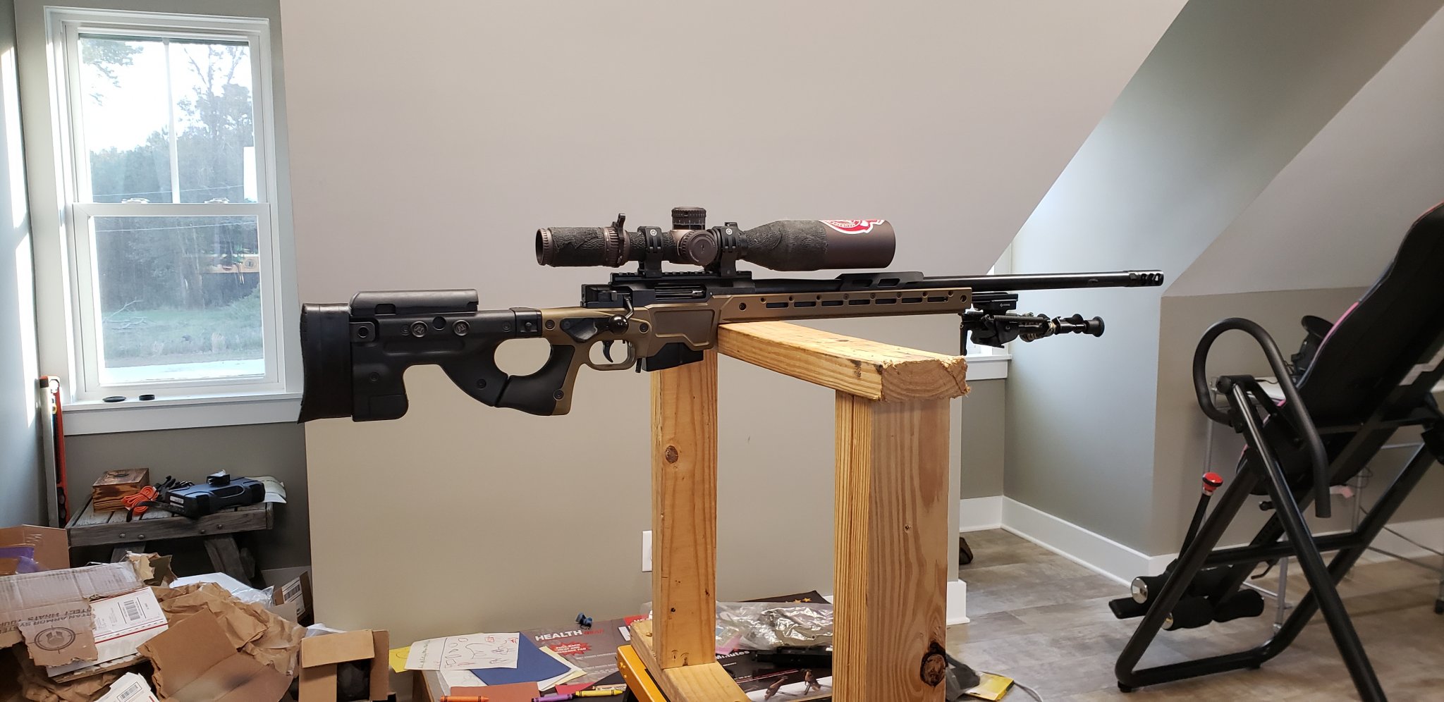

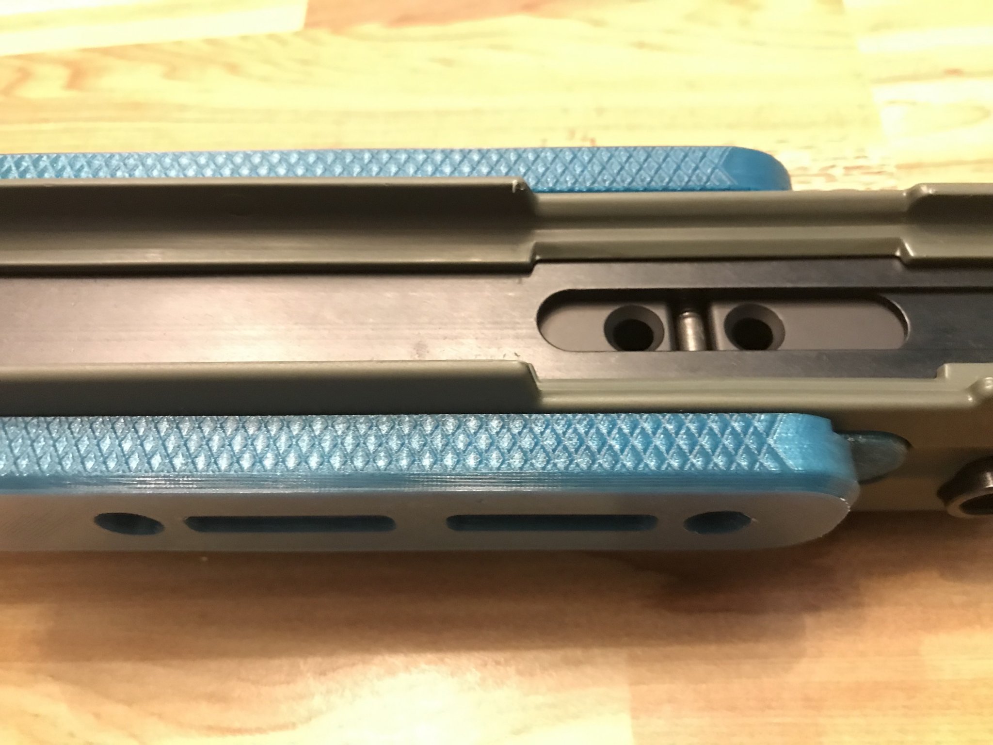

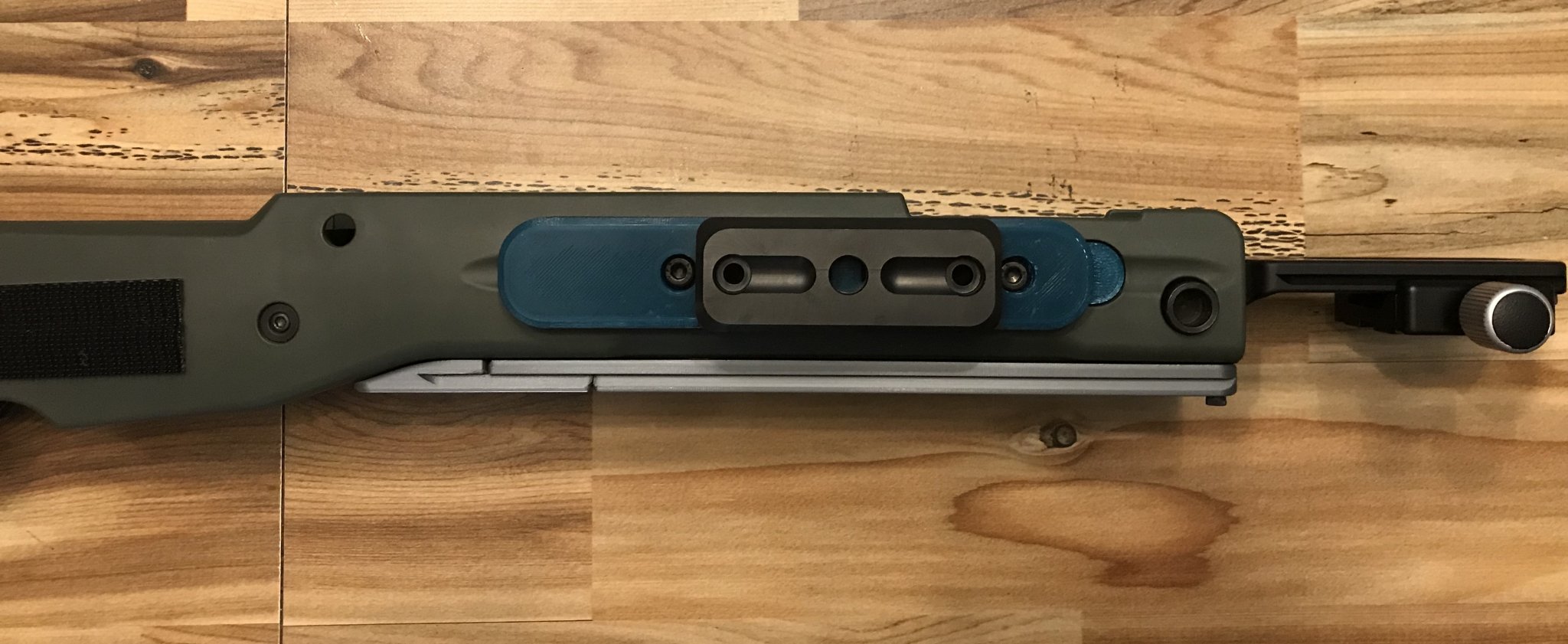

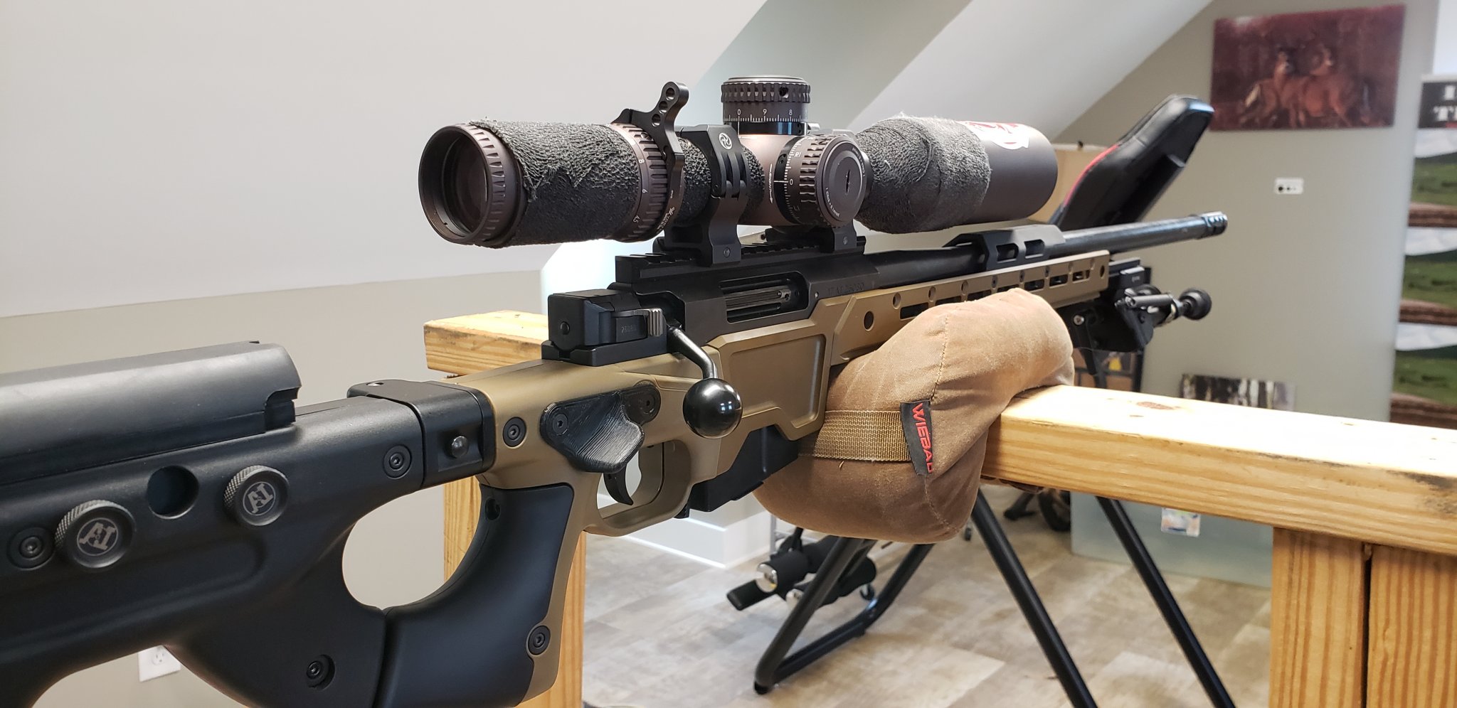

Chassis #2 is painted and out in the wild. Unfortunately it got painted Dark Earth instead of green, but you get the idea. I just got mine back in sage green, along with the 3rd one also in Dark Earth for @BLKWLFK9
I also just received the spigot and NV bridge back from getting anodized, along with the 1.5# internal weight from getting black nitrided.
I have to de-bond the raw aluminum chassis I have, and put the freshly painted one together with the accessories. I will also try to take some comparison pictures of my action in an AT, AX, and Obsession chassis to show how they ride on a Game Changer.
@BLKWLFK9 thanks for going through the install and being the first person beside me to bond one together on your own. (Chassis #2 was done at the AI shop by a tech, so that doesn't really count haha)
Looks pretty damn good! Anyone that has ever wanted a modern forend with the old school thumbhole rear buttstock, this will be your jam. It will also work with the tradition AT pistol grip buttstock (fixed or folder), and of course the AX buttstock.

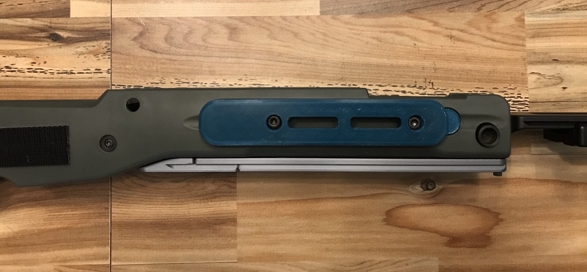

I've been putting in a lot of work on revising and improving the chassis for a production run. One of the big changes I'm thinking about doing is the switch from M-Lok to AI KeySlot. There are a few major reasons:
- Less interference with M-Lok pockets, which restrict the space inside the forend for a 1.25" straight taper barrel and all the accessories
- Ability to have thicker forend walls, which increase stiffness. Initial FEA is showing ~18% increase in vertical stiffness vs. the prototype.
- More space for internal weight --> goes from 1.5# on the prototype to 2.0#
- More robust NV Bridge, which is easier (and cheaper) to machine
- Users will already have AI pic rails if needed
- AI KeySlot tested to be stronger than M-Lok
- M-Lok is a pain in the butt to attach accessories to with the barrel in place, and can cause issues with barrel removal due to protruding screws
I will design a set of external weights for the chassis that will also work on the AX forend.
The only real downside is a limited accessory selection, but in reality what accessories are competition shooters using besides external weights and a 2-round quiver?
So what do you guys think? Other than not being able to use MDT external weights (and having to use proprietary external weights), do you think there are any downsides to the AI KeySlot interface? Would you rather have a more compromised overall design in order to have M-Lok?
