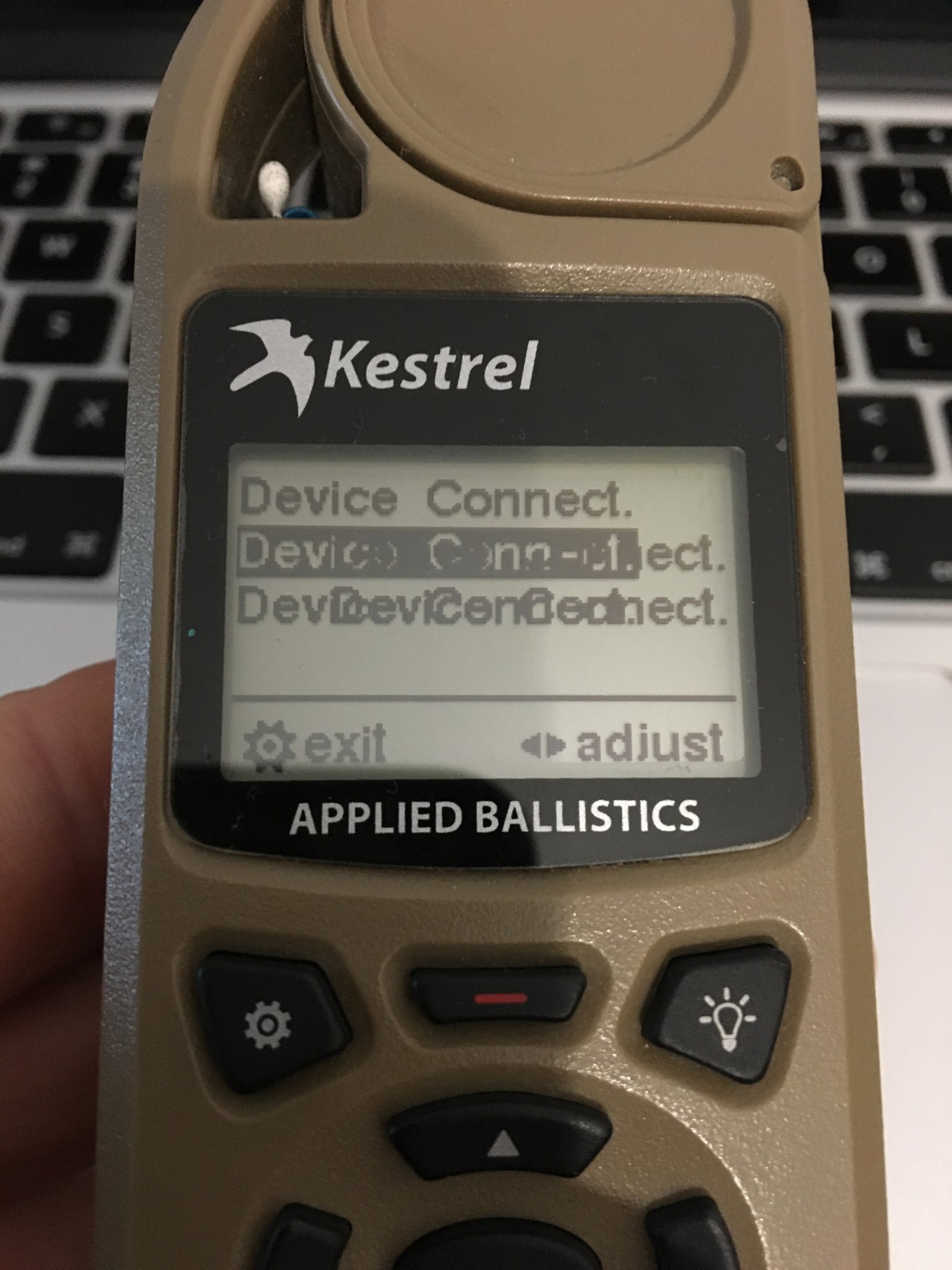

FW 1.42 is being released today which will fix the following bug that was introduced with version 1.41:
When scrolling on the Kestrel from a G1 or G7 drag model to a pre-loaded custom curve and then back again, the original BW and BD was changing. This version ensures the initial G1 or G7 bullet attributes are preserved in this situation.
Please back up your gun profiles prior to doing any firmware updates with the Kestrel.
Still working on the iOS 14 problem. So far, if you do not select the single target screen the app will work, but selecting Single Target will not bring up the screen and may crash the app.

I add a new bullet SMK 190gr today. And Kestrel gives me wrong solutions, I found a problem, its bullet length - 308 Sierra SMK gives me BL - 0.210inch, its to small.. should be ~1,350 I added a profile via Kestrel iOS app 240build
What fw is on your kestrel, what phone are you using and if you press enter highlighting BL is auto calc on? I just created a profile using that bullet and got 1.353
I use:
- iPhone 6S
- latest iOS 14.0.1.
- Kestrel iOS app build 240
- Kestrel FW 1.42
Yes, I have BL auto calc on. I use metric system on it.
And this old problem (look at the picture wasn't resolve) I saw it on another device too.

You need to turn off "BL auto calc". This is the problem of elevation calculations. In most cases BL auto calc gives wrong lenght of bullet.
