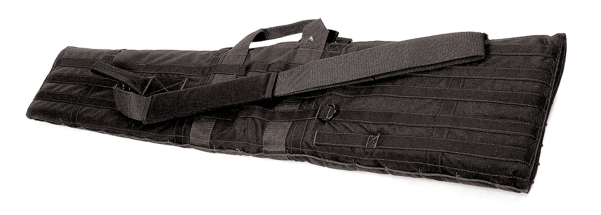

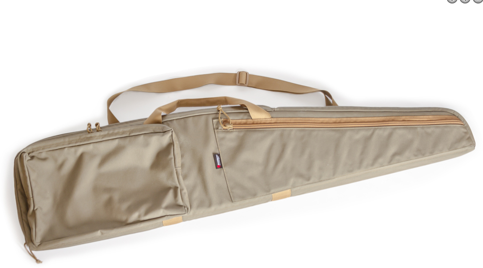

    Basically, I think this ideas been done pretty well by Armageddon Gear, except for different materials:
    Full zip is nice for cleaning and drying.
    When you say full opening is nice for drying, I immediately go back to my duck hunting days. All my friends had to have the fully sealed waterproof floating shotgun sleeves. Which is a nice feature on paper until they left a wet gun in there for a little too long and it came out covered in rust. I've always preferred a soft case made of more breathable materials. Both valid sides of the coin!
    Agreed,
    Then perhaps 86 the external pockets and let the purchaser specify what LxWxH they want. This is obviously a great product from a great company at a great price (and there are others too.) Overall concept here is sacrificing some economy of scale for specific crowd-specified characteristics.

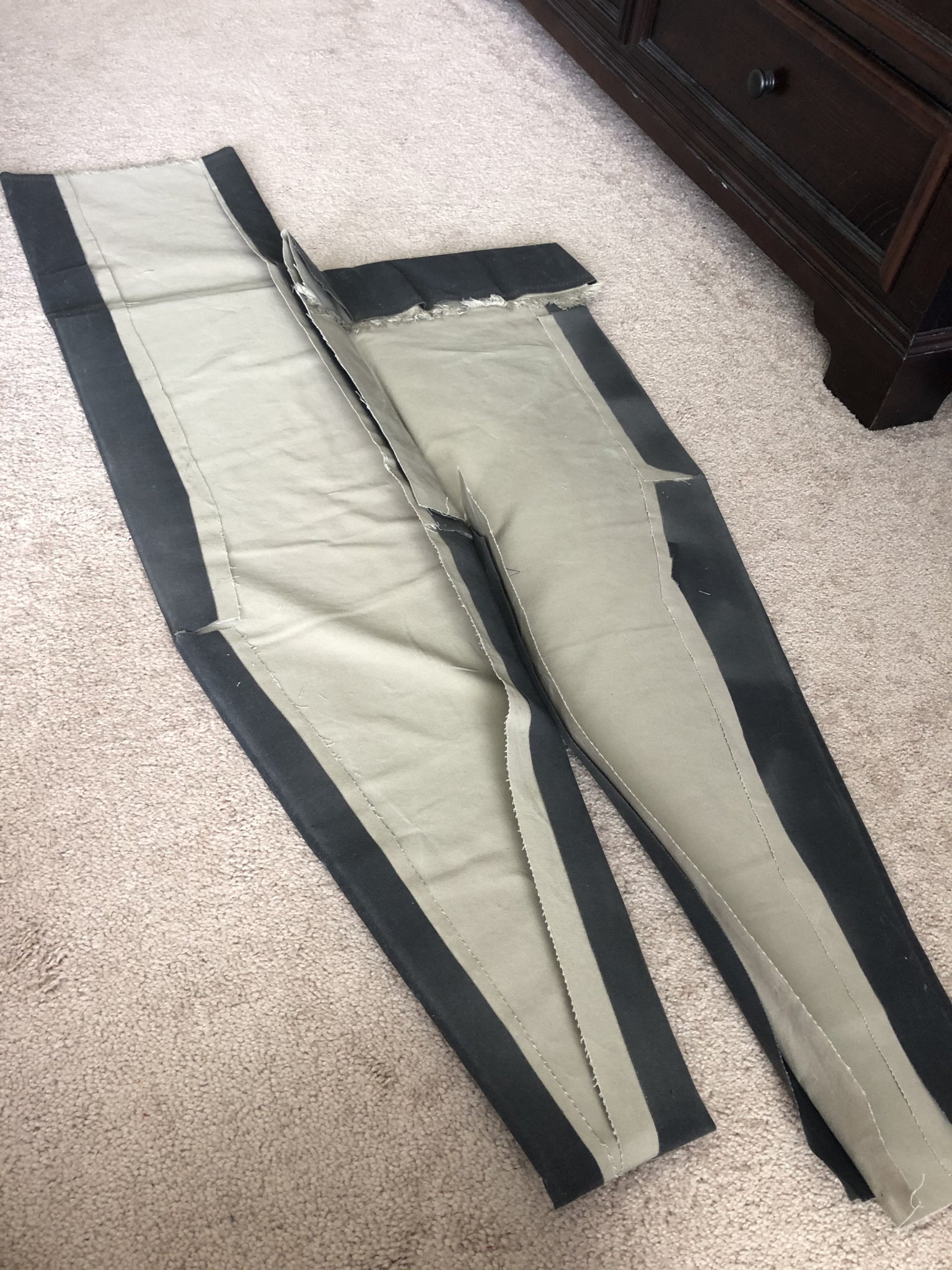

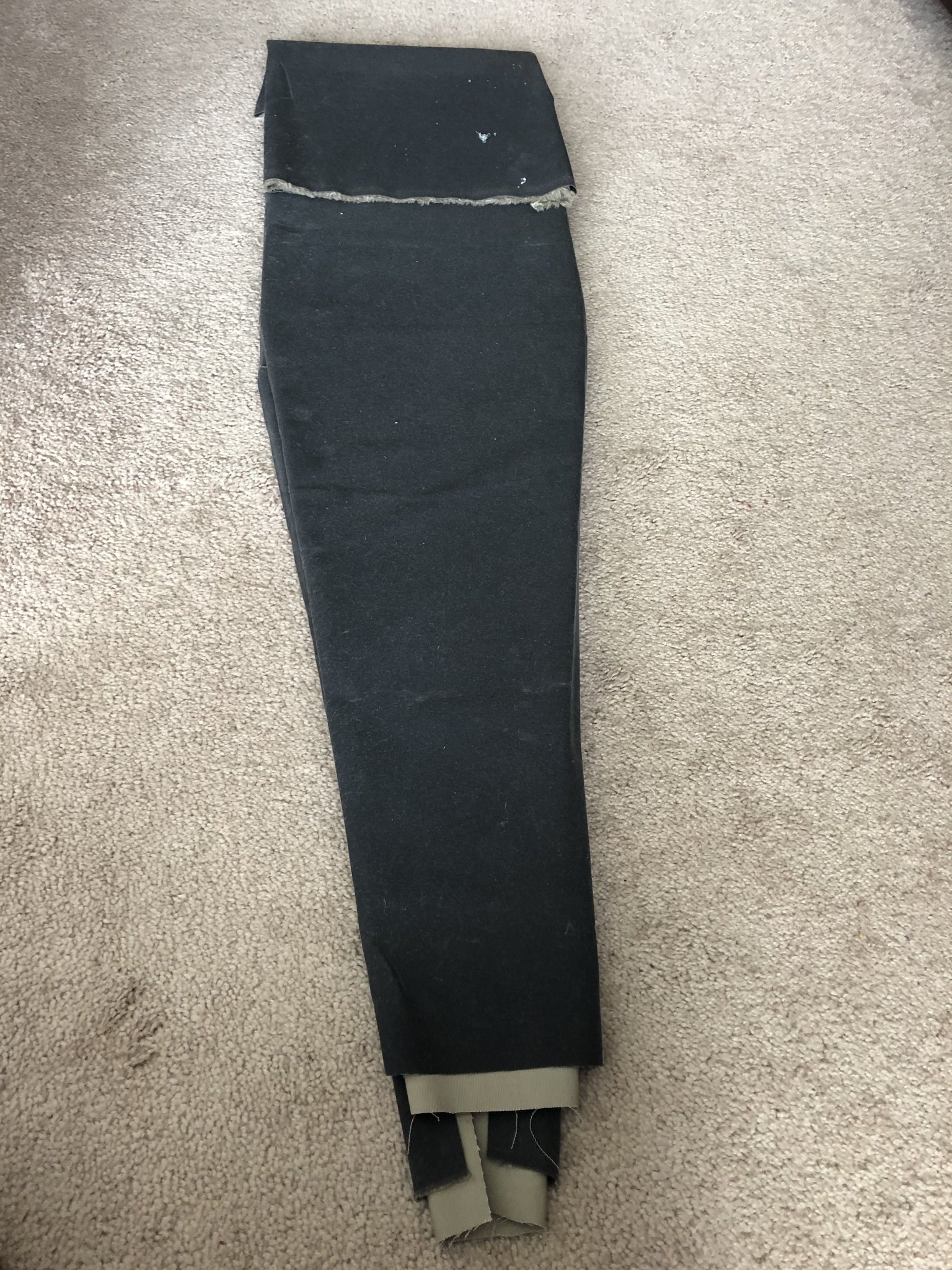

    That is close to the latest thing I’ve been tinkering with, it’s wax canvas exterior with a layer of foam in the middle and thinner canvas duck interior (similar to Carhartt pants type material.) I should have made it a rectangle shape instead of tapering down on barrel end. And added at least one more side for some depth, it would reduce the overall width some.
    I definitely like the materials though. Just some examples of the thought process...
