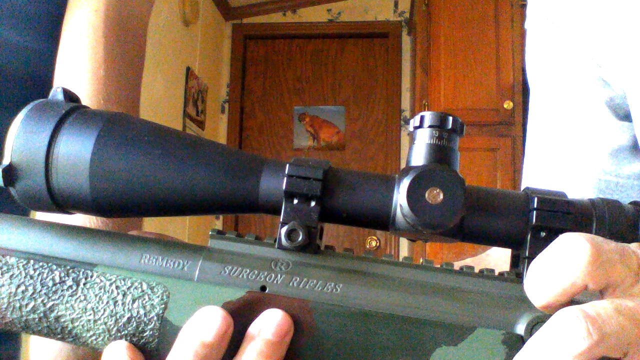

OP, I can't see the pictures due to my IP, but I hope the slippage is the source of your problems and not the rifle. Hopefully you can regain your thread as well. Common courtesy is an uncommon virtue around here.

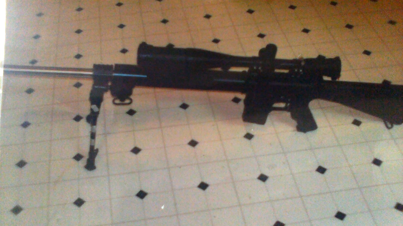

All that "money" and your rocking crappy wall paper with linoleum in what looks like a manufactured home roof line? Plus most of those 1/2 moa or under groups are 3 shot groups, not 5 and all conveniently by themselves without other groups around them and I highly doubt they came out of that AR but more likely out of that Surgeon....

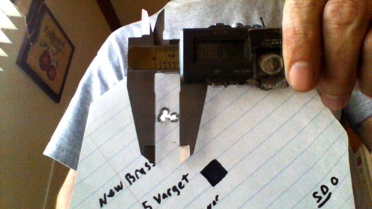

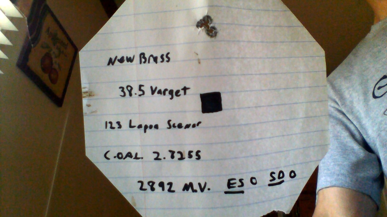

Who said its my home? Those groups r from a savage 12 LRP 6.5 creedmoor!

Wait, wait, wait...I hate that this has nothing to do with OP's issue, but I am stuck on LV's first picture where the SD and ES both state "0". Holy shit. That is impressive!!! I just thought they'd fly through the same hole with those numbers. It looks like your Les Baer shoots great, it should, it's a great rifle. But to go and make an overgeneralized statement about JP rifles was not copacetic. JP makes hyper accurate gas guns too. We don't even know if it's OP's rifle, and with the recent issue he found, it appears to be his scope mount. So just chill out. You got some excellent stuff man, go shoot it.

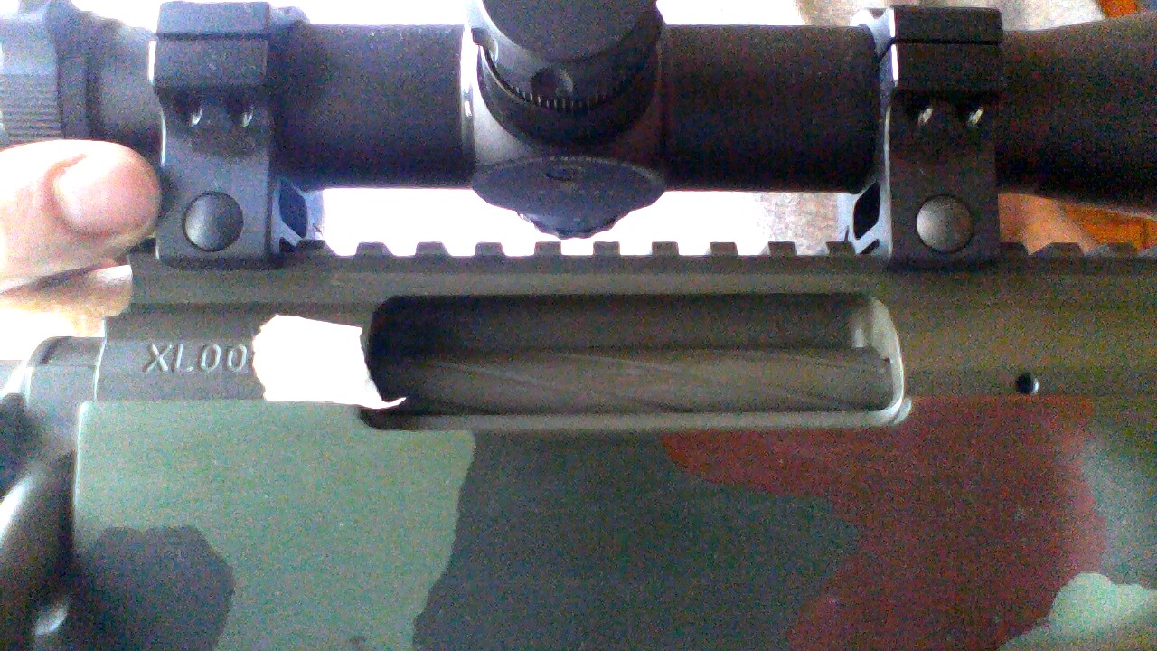

Good catch, timelinex. I don't know if I would have caught that as quick as you apparently did. It definitely looks like there was "sliding" or slippage with the scope in those rings. Please give us an update once you try a different setup.
After taking off the rings, its extremely apparent under there that they were sliding. They slid a good quarter inch! I called the manufacturer of ARC rings today and he reassured me that 50 in/lb is where it should be vs the 40 in/lb that I had it at. So I cleaned all parts with alcohol, put some loctite on the screw and clamped it down to 50 in/lb. I made sure to put pencil marks everywhere, so if it slides at all, I'll know. If it still slides, I'll send these back to the manufacturer and get different rings.
I'm going to the range tomorrow, so I'll try to give an update then....
Human error! Wind.. came right out of the Chronograph ES 0. SD 0 .
