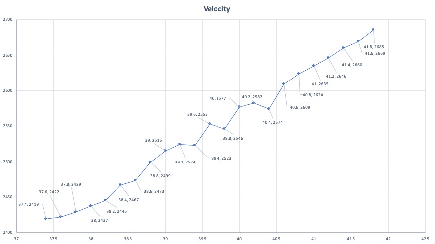

I went ahead and shot all 69 rounds of this ladder over a magneto speed chrono and then took the data to MS Excel to graph it. The attached .jpg should show my chronograph results.
I know at this stage I should be looking for flat spots which are the velocity nodes to zero in on for future test. I feel like most of my results, and these ones in particular, are crap and unrevealing.
This is what I do identify here:
1. possible velocity node at 39.2-39.4gr(2524ish fps) & maybe something going on at 40.2 gr (2582fps).
2. very erratic velocity behavior between 39.4-40gr.
3. stead climb in velocity from 40.6gr-41.8gr (2609-2685fps) <- which is unfortunate, since I was hoping to grab a flat spot in the +2600fps areas.
As said, "velocity nodes" with small sample size (i.e. number of shots per charge weight) are a statistically insignificant artifact and don't really exist.
As you increase the data set from like 3 shots at a charge weight to 30 or more you will see those flat spots disappear.

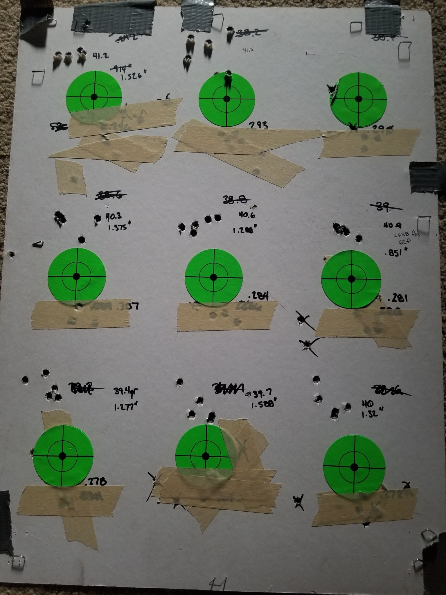

So I got out to the range to just shoot, as suggested, without the chrono on my LMT AR-10 in 6.5CM at 100yrds. I loaded 147gr ELD-M with loads of H4350 ranging from 39.4-41.5gr. The brass was primed with CCI-41. Essentially, each series increased in charge weight by .3gr.
The attached picture below shows the groups starting with the lowest charge weight starting at the bottom left, moving to the right.
**Don't bust my balls too much, I tried shooting my best :)**
During the test I was shooting 4 different series round-robin style at a time.
Personal Conclusions:
-Shooting during and after dust probably wasn't the best choice.
-I will be swapping out the 7lbs (total) factory LMT 2 stage trigger for a Geissele SSA-E 2 stage (2.8-3.9) total.
-Seems that the charge weight of 40.9gr of H4350 had the tightest POI of all the groups shot. Velocity was recorded, separately from the groups, at 2638 fps at 62 degrees F.
-Thinking to trying load from 40.6-41.2g in .1gr increments to see if I can replicate and or narrow down a tighter group.
Please drop some of your suggestions below! Let me know if you think this bullet/powder combination should be scrapped or if it's worth continuing.

I would shoot 40.4 again to see if it will repeat. If it does, I would start a seating depth test. Edited to add that the 7lb trigger may very well be the reason you’re seeing horizontal stringing.
John
Hondo,
Can I ask why you are suggesting 40.4gr specifically? I'm curious to hear what your thoughts were. I was thinking of redoing this to see if there are any changes seen, or whether I can replicate what we've already seen here.
I'm probably going to do the trigger swap as soon as I get home tonight. I had the SSA-E sitting around from a prior AR-10 that I sold off.
Hondo,
Looking at the pic again, I think it’s 40.9. I think I misread your handwriting the first time I looked at it.
So, I’d shoot 40.9 again and if it repeats, start a seating depth test. Berger suggest .040” intervals for their test. I use .025” because it’s a single full turn on my Forster benchrest seater and it has produced good results for me.

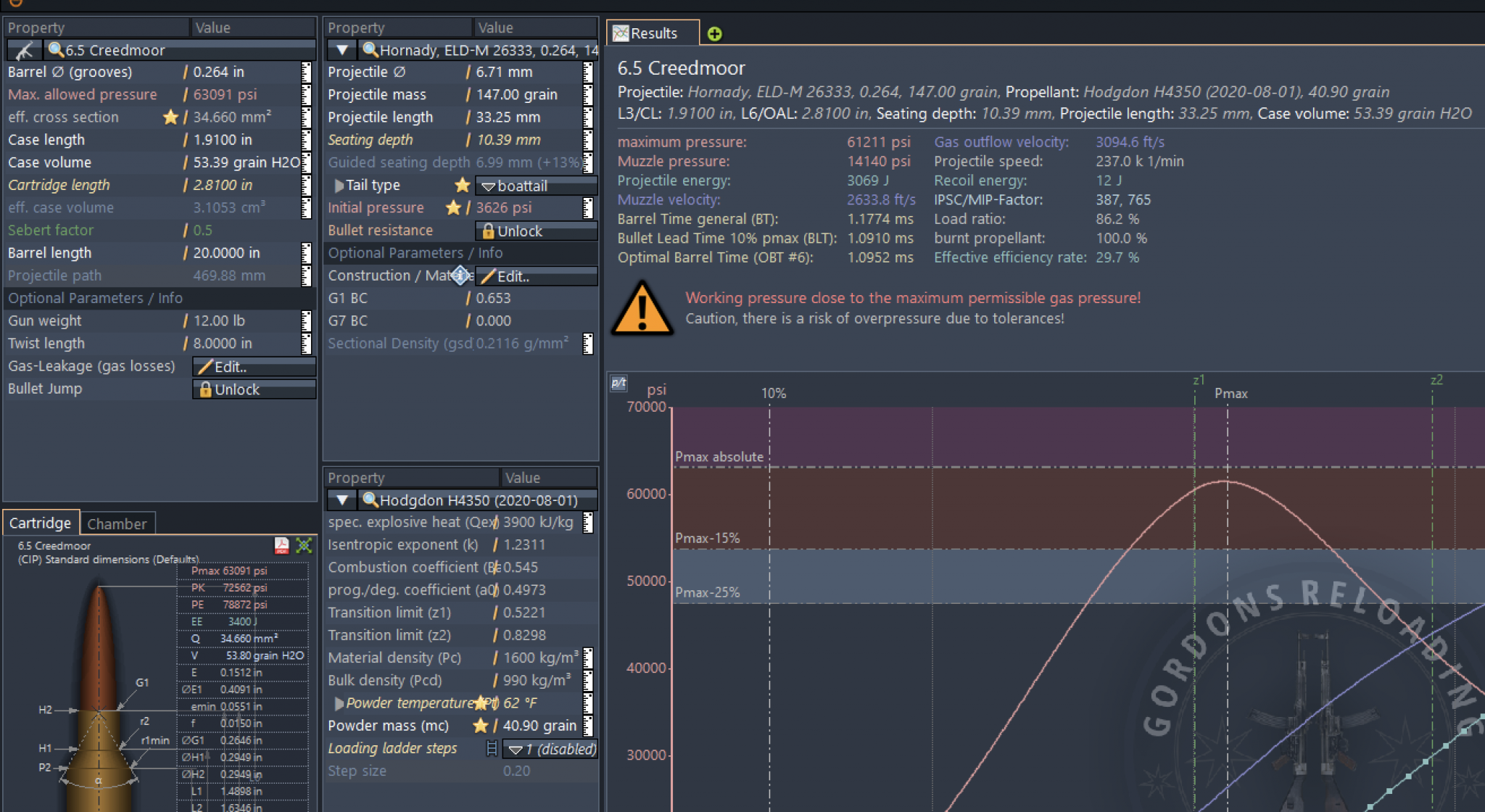

GRT is a fun program to use. I've taken a break from it for a little it, but I'm about to go play with it some more. I'm curious to see what it says my current chamber pressure is at. 40.9gr.
I think setting realistic goals is something that I've failed to do. My frustration with this sport is a product of not doing that, though I am a glutton for punishment. The more obscure the punishment the more I seeming willing to jump at it.
Look at the groups you produced at 40.6, 40.9 and 41.2. The POI center of all three of those groups are pretty much the same place in relation to the POA. AND the best group popped up right in the middle. I would consider that as pretty strong evidence on what load to go with. Next try your seating depth test and see if tweaks in depth change what you see on paper. And yeah, a 7 lb trigger is not going to help with precision shooting.

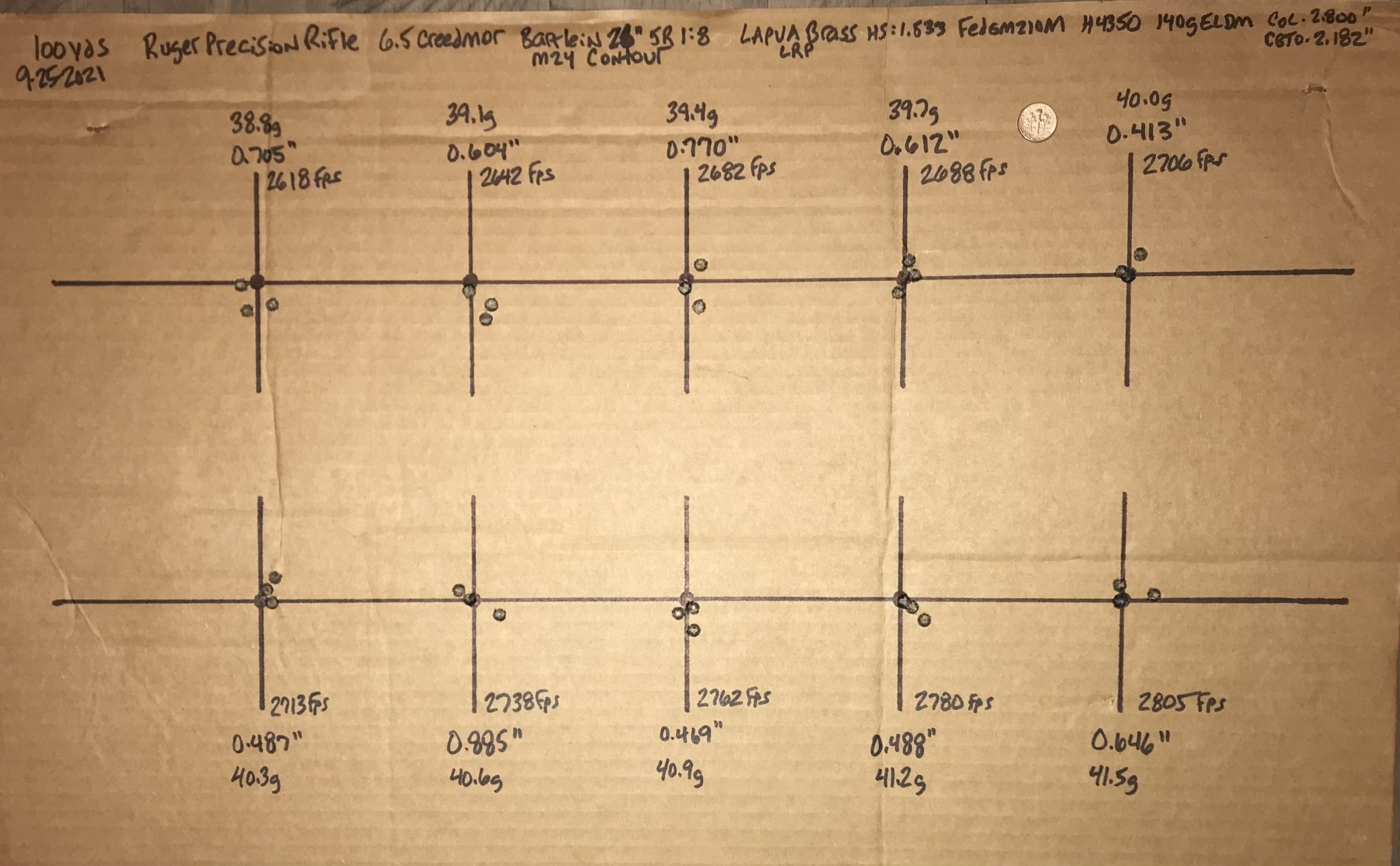

this is 3 rounds out of my bolt gun at 100m. It is 175 308 FGMM. Factory ammo is very good.
What you might do as well is find a factory ammo that your gun loves and duplicate it. Try Hornady Match 140. Hornady even gives you the load data on the package. If it gives you the velocity and accuracy and doesn't overpressure your gun (it won't), then your load development is done. Just duplicate the load.

Let me make it simple for you.
Use the chrono to find out;
1.) your max pressure
2.) where the velocities you are looking for are
Then run an OCW around that.
Example:
- You run however many rounds rounds, 1 shot each from 37.5 to 43gr.
- Stop when you get pressure.
- You want your rifle above 2600 fps? It's looking like 41.0gr to 42.2 has the velocity You're looking for?
- OCW from 40.8 to 42.2. See what works.
- Tune seating depth if you give a shit or have to.
I've tested volume/neck length/chamfer/neck tension/partially sizing the neck to grip the bullet/ and a few more tricks. Keep it simple.
This is really what I'm about to do, and hopefully finish with my next range session. I'm going to repeat groups in the 40.2-41.2 range. Assuming I see repeated good results, I will be settling on a charge weight. I might play with seating depth...depends how I'm feeling.
I'm feeling good about the fact that I just swapped out that 7lbs factory 2-stage trigger for the 3lbs Geissele SSA-E.
I probably won't be able to hit the range until early next week. Once I do I will repost the progress.

Hey does anyone here use GRT for reloading? I've been playing with it for some time. I was curious to know what anyone makes of the calculated chamber pressures when compared to case head and primer condition.
I didn't see any ejector smearing or primer cratering.
The load I plugged into GRT is the 40.9gr H4350 that head repeated POI results from last range session.
