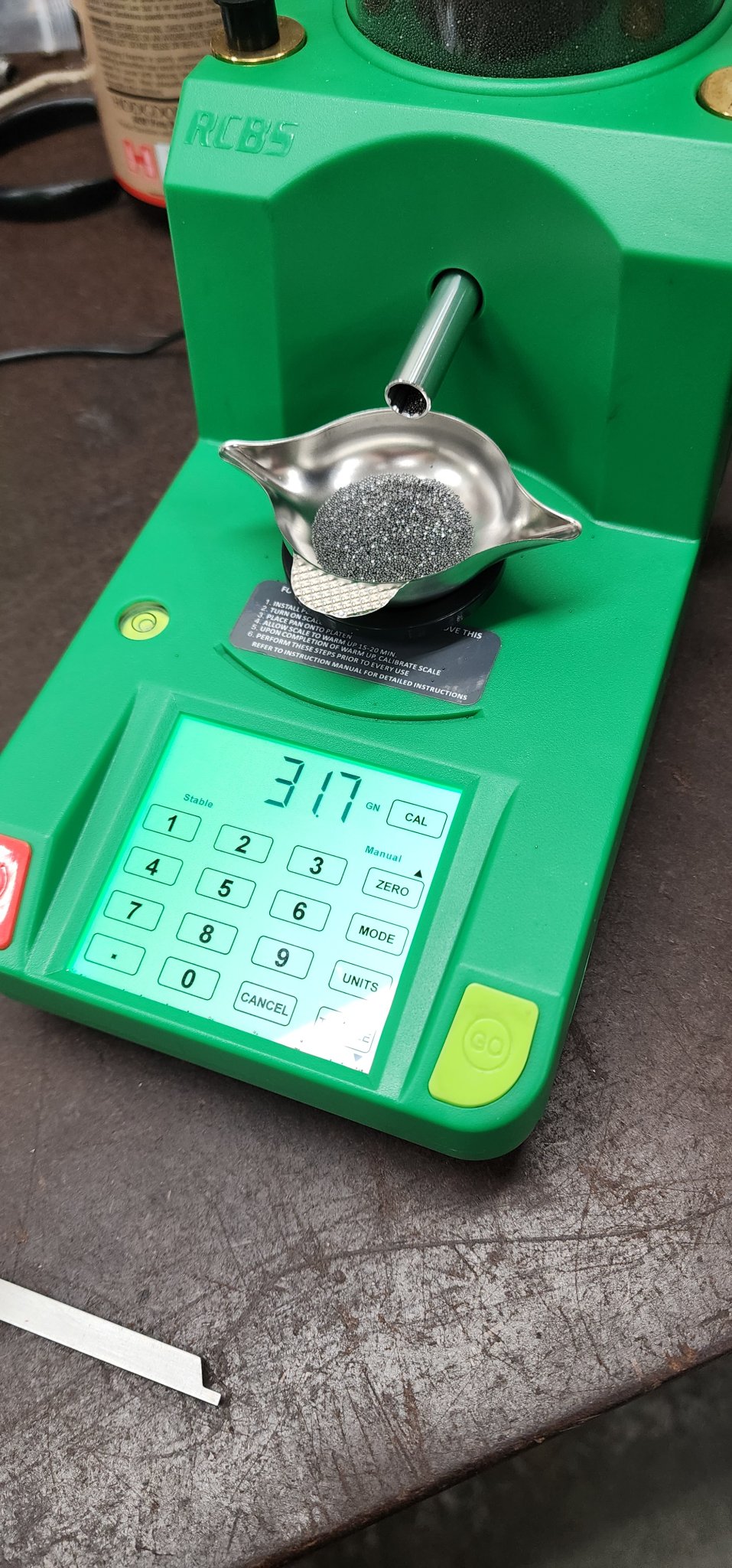

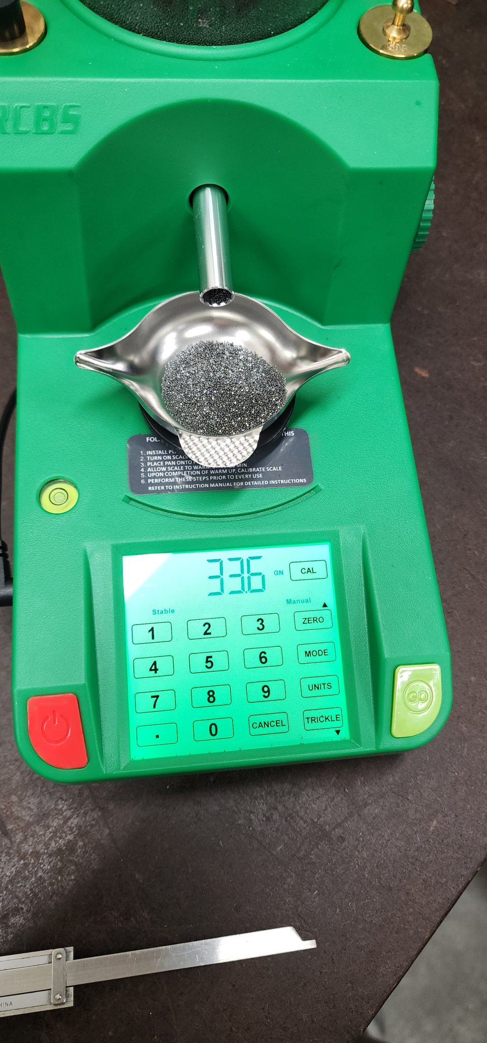

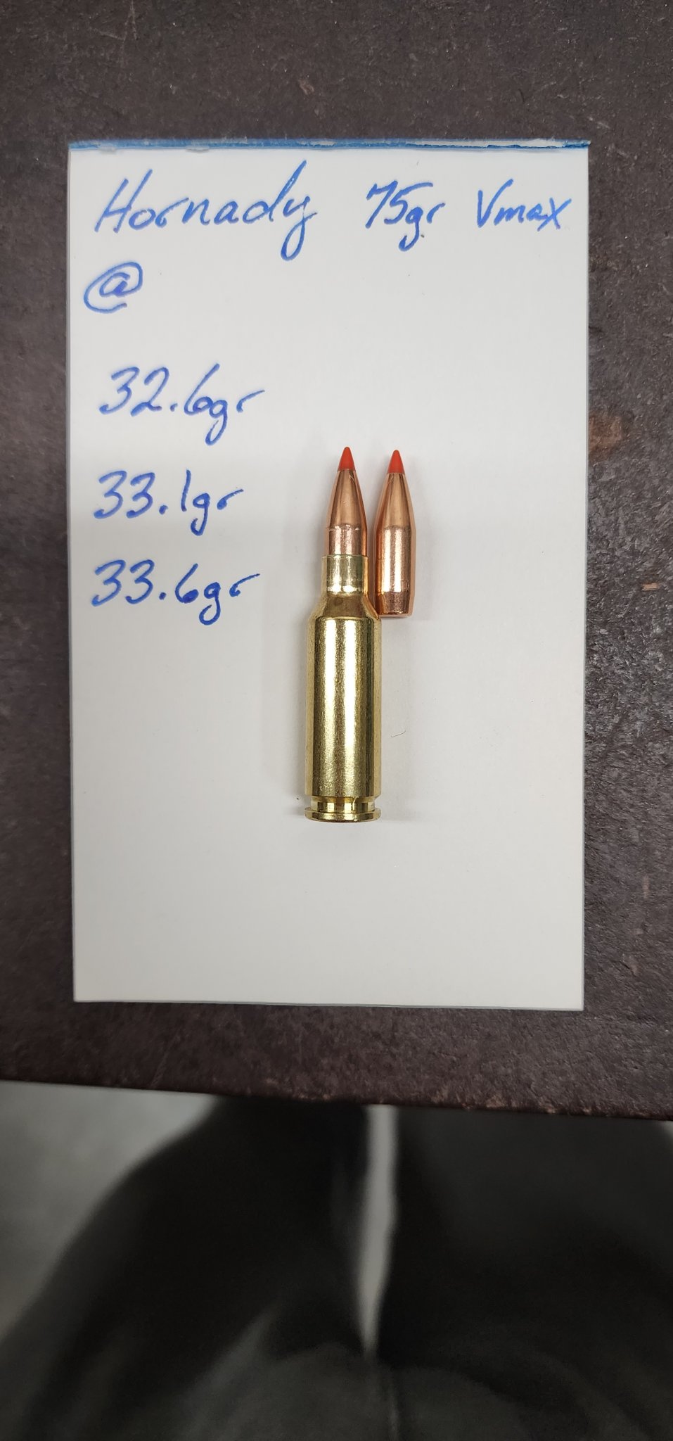

I loaded up 50rd last night with 87 VMAX to get some initial rounds down this new 22" RTR barrel..

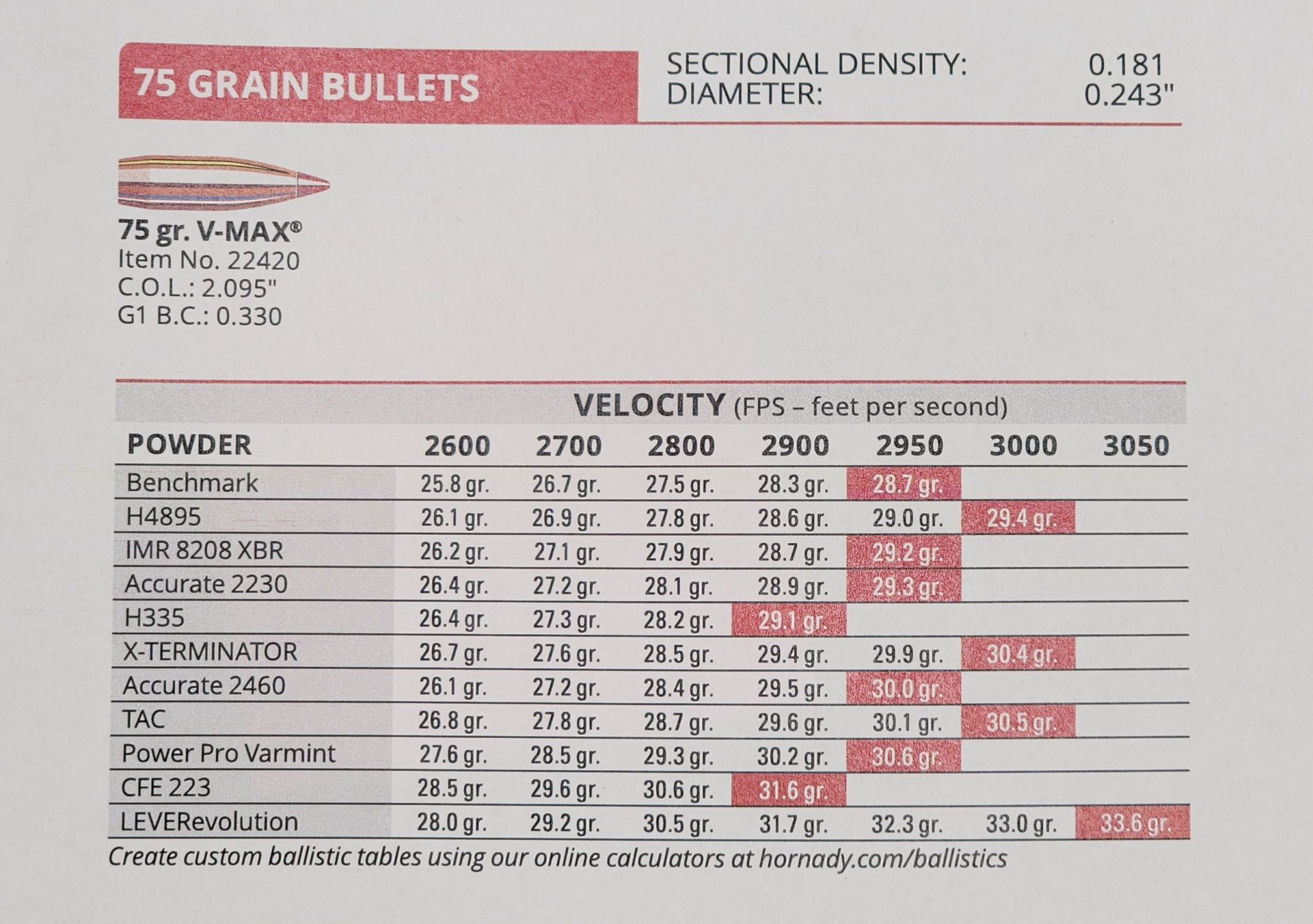

I used CFE223 which is the closest powder to Lever I had on Hornady reloading data for 87 VMAX. I dont have any Lever and just trying to get some rounds down this barrel so this will work for now. Ive seen a few people getting really good results with 87 VMAX/CFE223 in the 29.5 - 31.0gr range.
I loaded up 10rd each 29.8, 30.1, 30.4, 30.7 and 31.0
We will see how it goes..

H4895 was the next closet powder to Lever on Hornady 87 vmax reloading data for 6 ARC after CFE223..

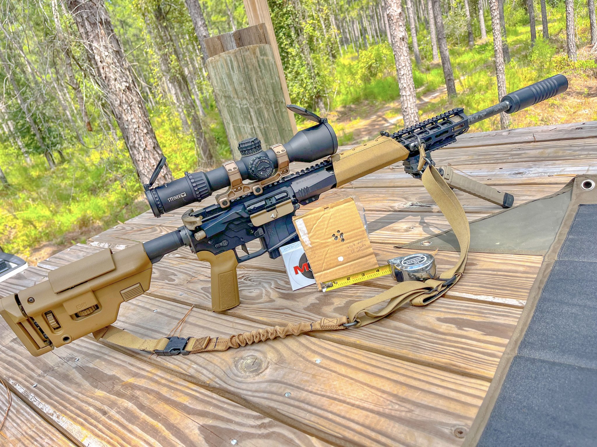

Just got back from putting the first rounds through this 22" RTR 6 ARC @ 100yd. I will start out by saying it impressed me way more than I expected.

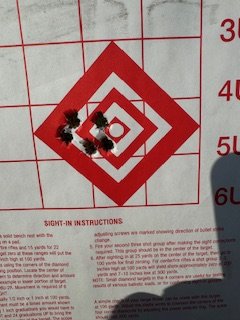

I shot the first 5rds to get a rough zero and tune my gas which was stupid easy. Im using the Rubber City adjustable gas BCG which is my go to favorite over an adjustable gas block for a few years now. I started it off all the way in then backed out 1 full turn. I shot 2 rounds that both locked back on empty mag then the 3rd didnt lock back. I opened the gas key 1/4 of a turn more and shot 47 problem free rounds all locking back on empty mag. That was the extent of tuning my gas. hahah
After I shot these first 5rd out of the gun i proceeded to shoot for groups with each charge weight. First charge 29.8gr I only had 5 left so I shot a 5 shot group but all the rest I shot 10 shot groups with and they really surprised me.
I pulled a few shots going to fast but all in all, Im very happy and cant wait to continue load development now that I have a starting point.
Ill probably play around with 31.0gr with the other 50pcs of virgin brass I have primed. Probably load up 3 batches 31.0gr and play with seating depth a little and see how they do and go from there. 31.0gr was the highest I tested today and ZERO pressure signs... Pictures below of the brass. Not a mark on the case head, nice round primers.
Here is the first 5 shots out of the gun tuning the gas. shot to the right out of the group is shot #1 out of the brand new barrel and the next 4 were into a 0.5" group....

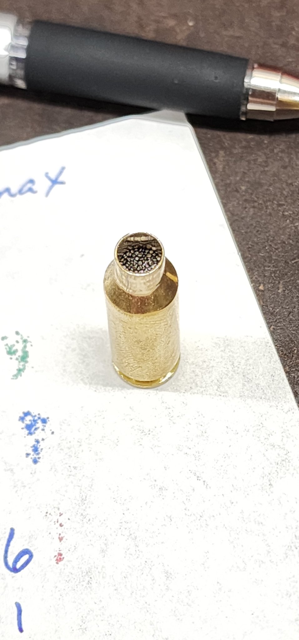

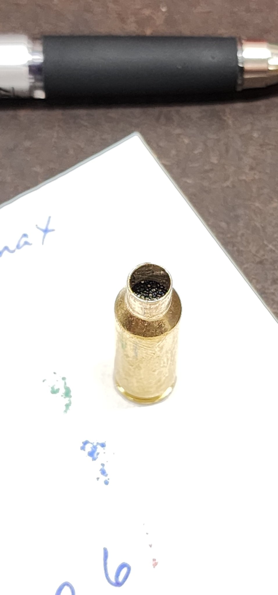

Here some pictures of the brass. The 2 pics of case heads are from the hottest charge I tested, 31.0gr looks absolutely perfect.

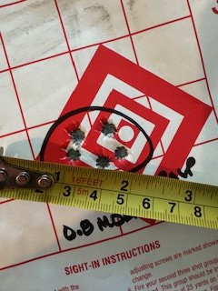

I finally was able to focus on my notes and put this together on my target with the burger 108gr Elite hunters. The 28.4gr group wasn't bad just low on velocity where as the 29.4gr was just a bit bigger and right were I want to be velocity wise out of the 24" barrel. At seated depth of 2.252-2.260" COL (the tips vary so I use the comparator number of 2.650") I am .085 from the lands. With the duramags it seams like I have some wiggle room to go longer? Kinda tempted to seat them at COL of 2.275" for a .070" jump if it fits in the mag. Other wise I'm tempted to seat them a little deeper for .090 and .095 jump. Just not sure which way to run because as you'll see below the other two bullets seam to like being .050"-.060" off the lands.
This target shows my Barns 105gr matchburners on the right, and the hornady 108gr ELD on the left. The Barns were jumped .050" and did not like it compared to my first test with had them at .060". So I'll load them up again at .060" and .065" just to see. The Hornadys were interesting. The factory ammo shots about 1"-1.5" groups but they have a .045" jump. These were tested at .050" and I'm tempted to try them again at .055" and .060" to see if they tighten up even more.
Your groups are kind of like mine. I too am working with factory Hornady loads and reloads, both with 108gr bullets. I hope that you find success in tightening those up. Good luck and keep us posted.
Ya we'll see how things go Thursday at the range. But here's what the Barns 105's did for me on the 1st outing with two tight groups half a grain apart. I truly believe it's in the bullet seating that gonna make or break it.

Took my 6ARC out for the first time this weekend. LMT MARS upper/lower. Proof 18" CF barrel converted by D. Wilson. Kahles 318i. Geissele SSA-E. JP bolt. I only shot factory Hornady Black 105 BTHP. The gun flat shoots. 2642fps with 3.5SD from factory ammo in an 18" barrel. Zeroed in 3 shots then took it out to 591 (4mils) . The range only goes to 640 and it was bloody hot out, so I called it a day. Smacking small steel targets was too easy from prone on bags. I know I've only scratched the surface - looking forward to a real test with the rifle soon.
I scrubbed my 6 ARC clean this morning after the first 50rd put through it the other day. Loaded up a seating depth test going longer as well and tested 10rd each of 2 higher charge weights of CFE 223... 31.3gr and 31.6gr.
The original seating depth I tested the other day is just hammering. Going longer just opened up the groups but the first 2 groups going longer were still 0.75moa.
This is the first 5 shots out of the cold clean gun. The high shot was the 1st shot out of the clean cold bore then the next 4 went into this 0.25moa group.
Im done with CFE223 and 87 VMAX. This load is great.

I think someone at Horndady is smoking meth! Decided to see what the max charge of 33.6gr of leverevolution looked like in the case and well.... there is no freaking way a 75gr vmax is gonna fit with the powder half way up the neck. The base of the vmax sits almost down to the beginning of the shoulder.
So I poured some out till I got below the neck and came up with 31.7grs which looks like this...
To top it off the recommended COL of 2.095" is jammed into the lands on my gun.
