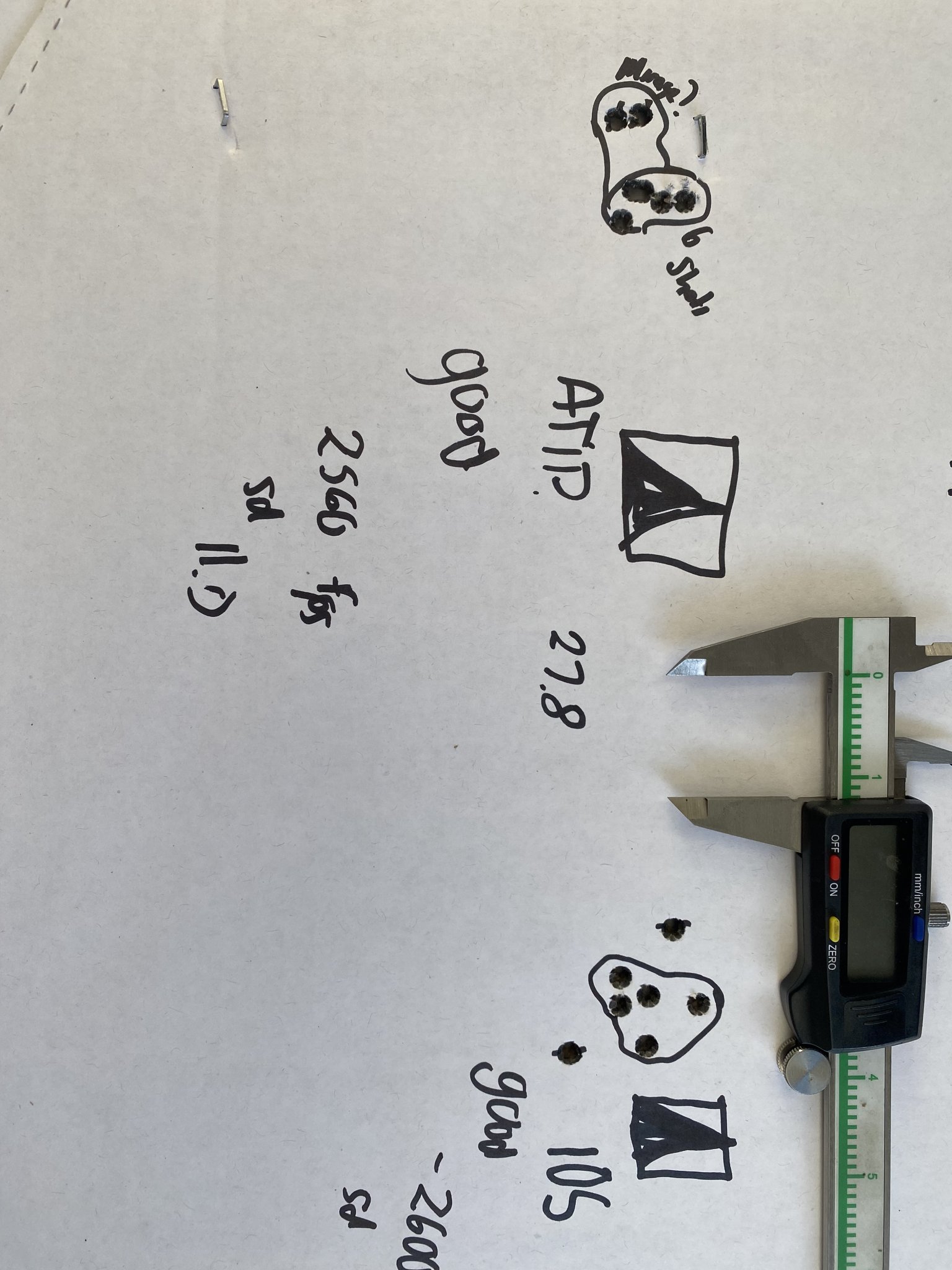

106 ATIP and 105 VLD hybrid bergers with 27.8gr of Lever behind hornady brass and CCI 41’s. For some reason every can of lever I’ve tried is way over velocity versus the hornady book. Really bad mirage and it was 98 degrees in the sun so the fliers are on me. Overall good to go for me with velocity and SD. No pressure signs so next week I’ll be taking this out to 1200 yards to see if it retains its accuracy.

I have been using mp501 in mine. It seems to run right around cfe223 and lever. I shot some 90 tgk with varget this morning but it didn't seem to like varget. That would be a first for me. LOL.
Suprised Varget didn't do well. Not many things I can't get to shoot Varget well. Maybe it's the bullet?
I got 300rd down this barrel now and it's printing some really nice groups consistently. AR Comp looks to be the powder for these 85 SMK. No pressure and 27.1gr is within 20fps from my 31gr CFE223 load but WAY better temp stability and better accuracy.
MP540 is producing some really good accuracy and ES/SD's but slower than AR comp. Gonna test it a little higher and see if I can get it in that 2850-2900 range with good numbers and accuracy.

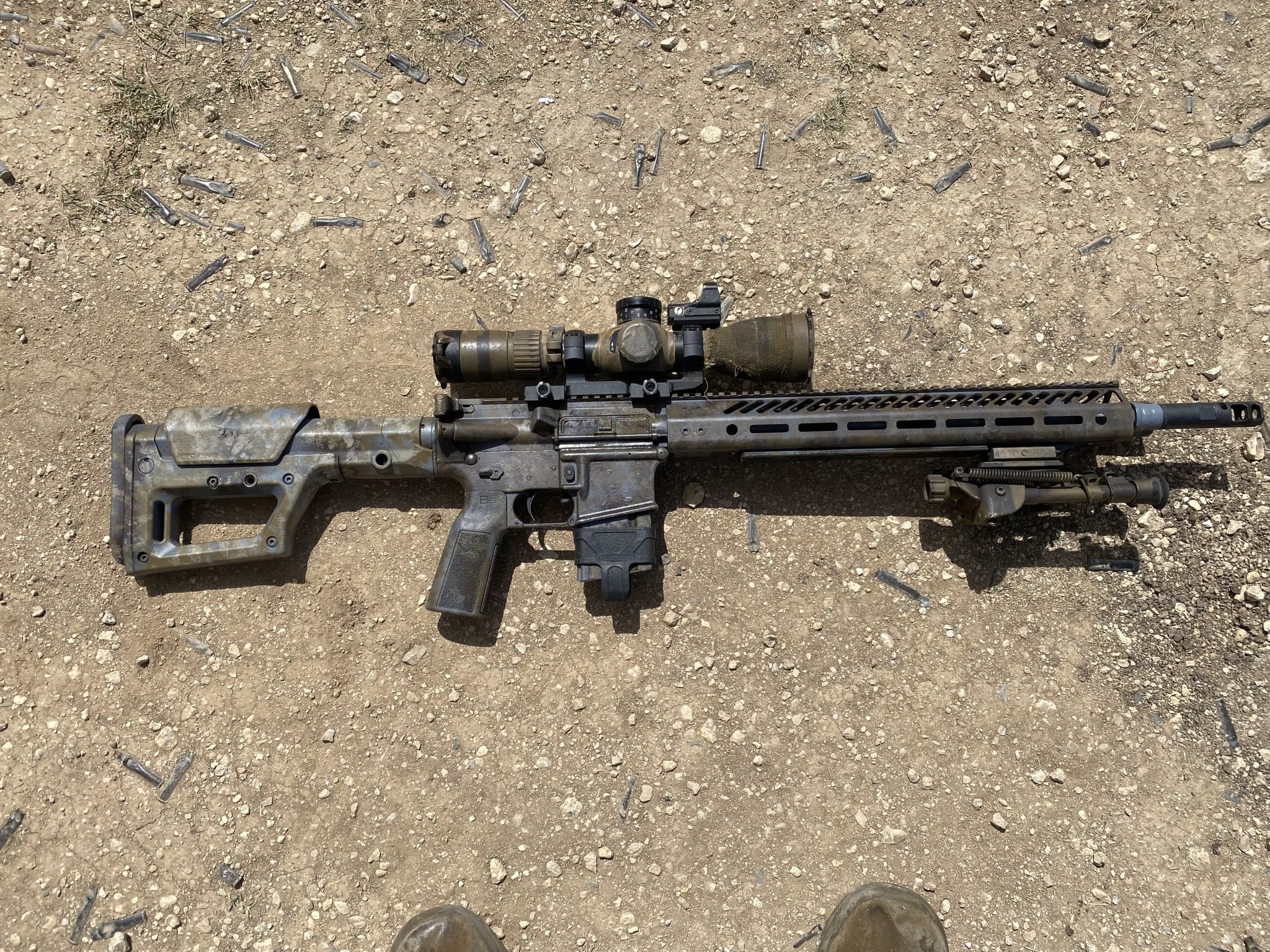

I have a 22" Proof heavy weight and a 16" Faxon lightweight.
The 22" is faster and more accurate, but the lightweight Faxon is accurate enough for hunting out to 450 yards or so, the furthest I've shot that one.
