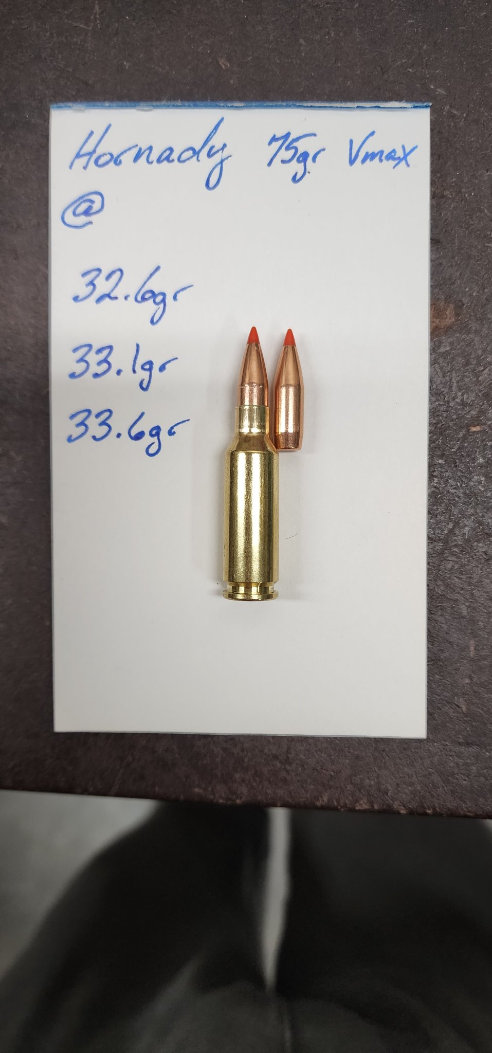

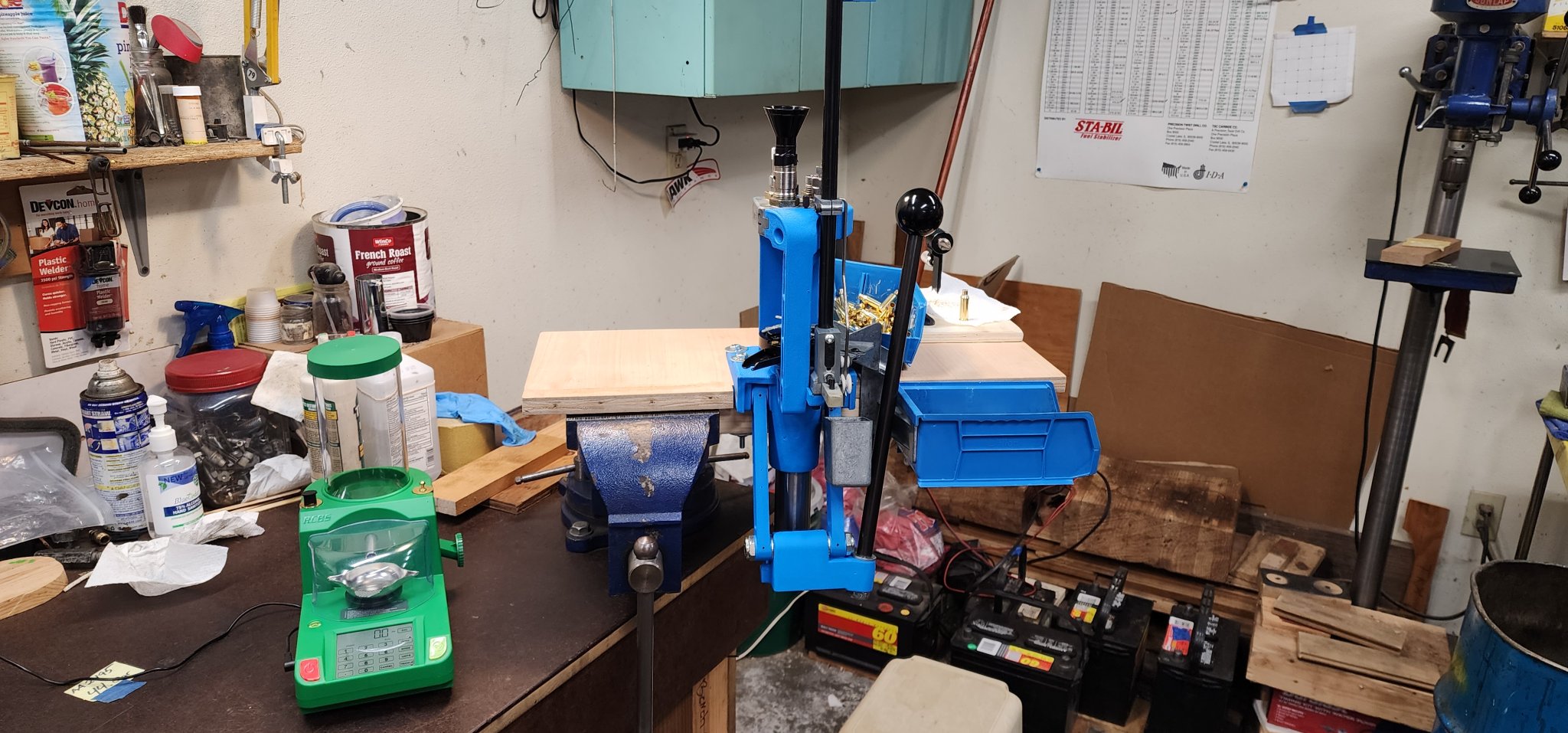

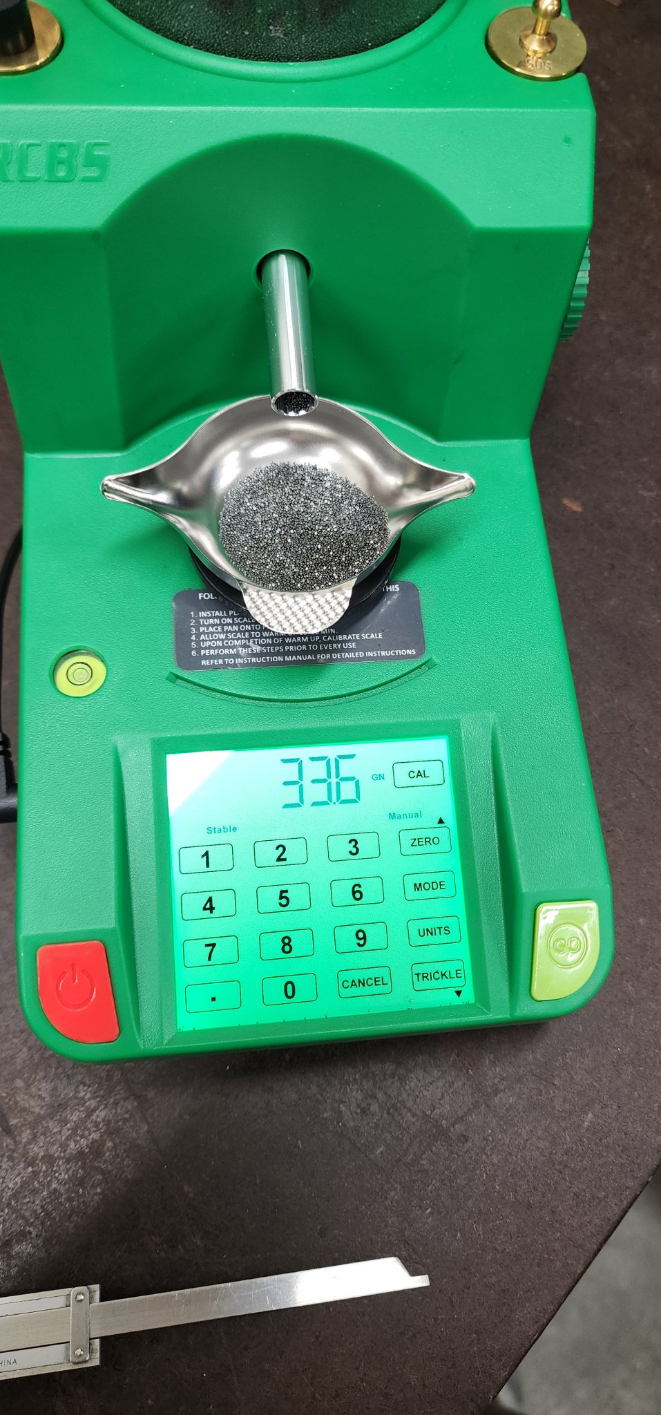

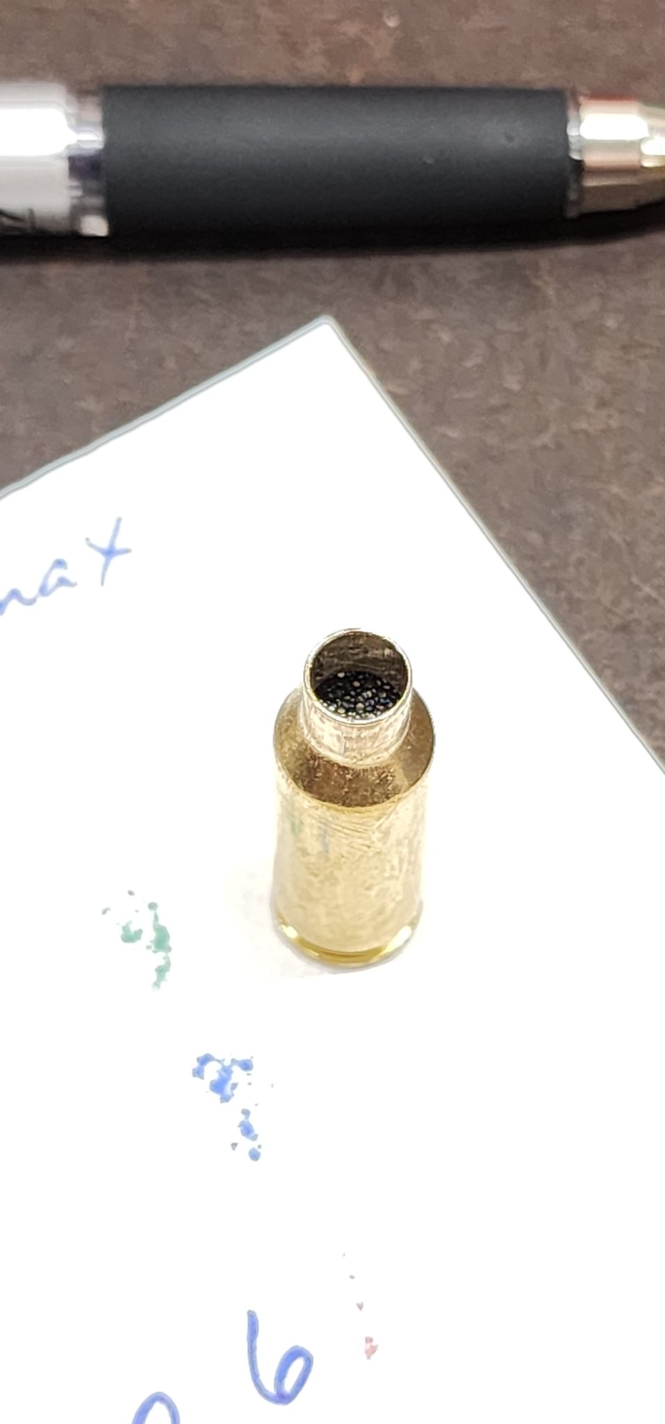

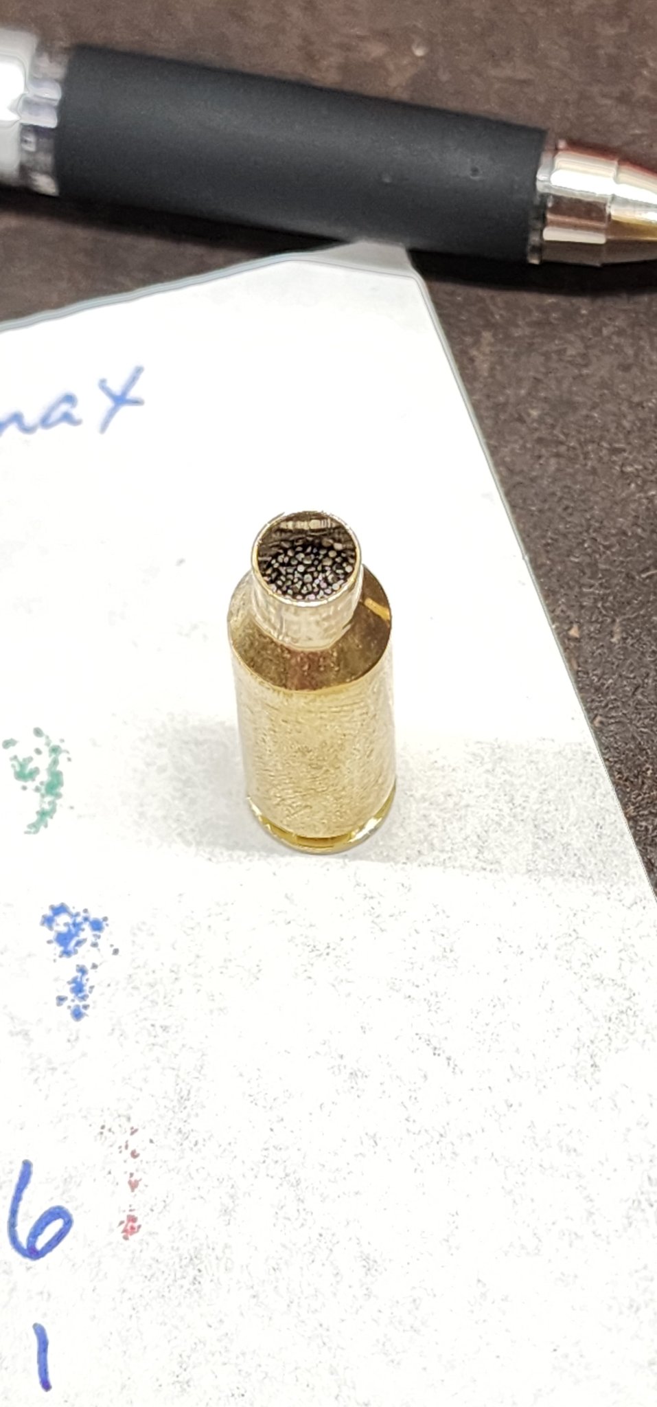

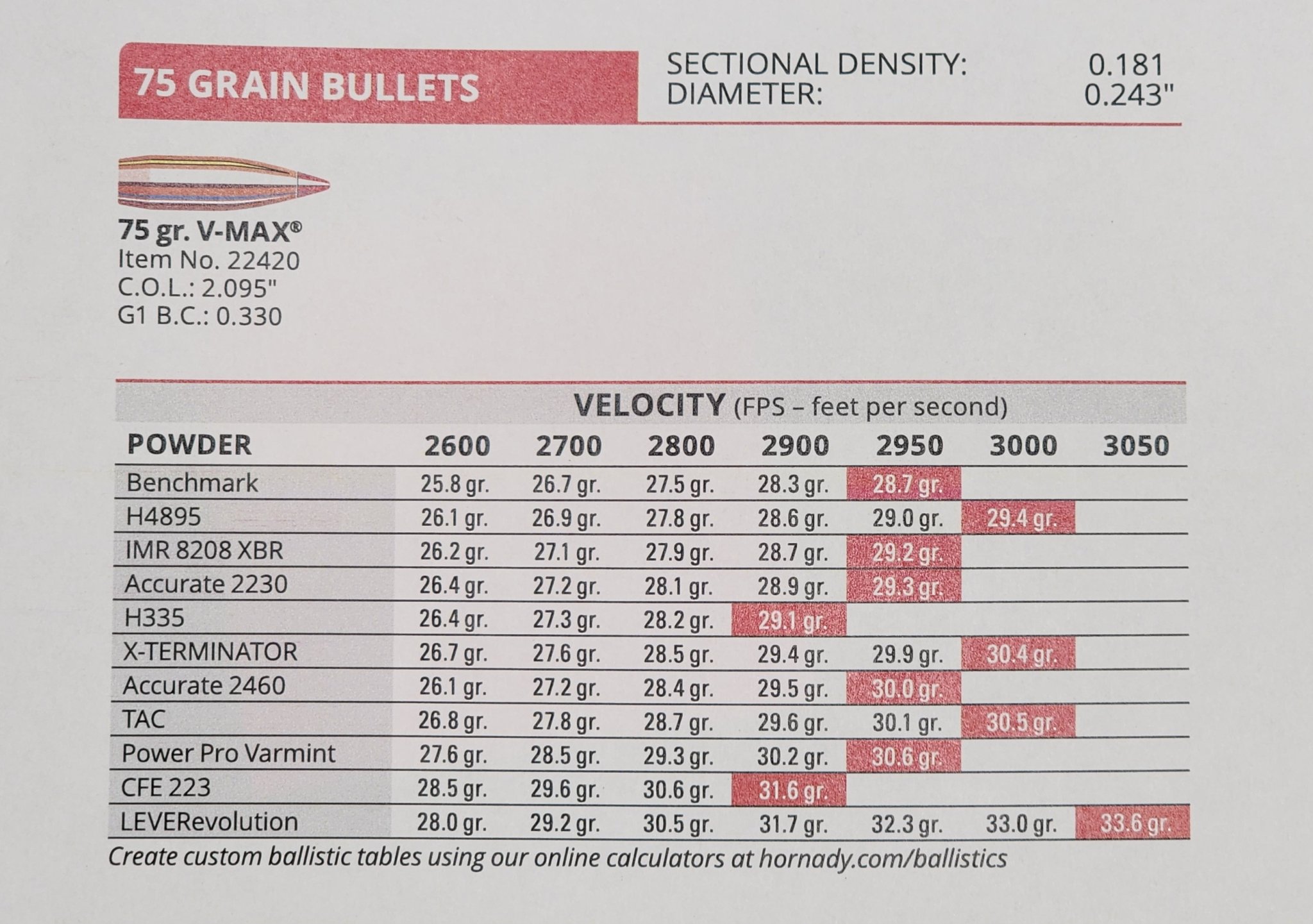

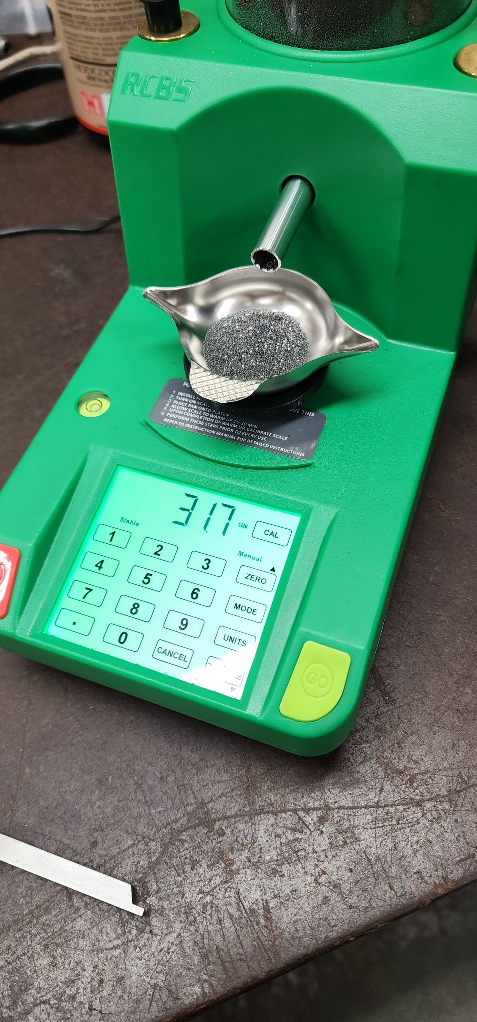

I think someone at Horndady is smoking meth! Decided to see what the max charge of 33.6gr of leverevolution looked like in the case and well.... there is no freaking way a 75gr vmax is gonna fit with the powder half way up the neck. The base of the vmax sits almost down to the beginning of the shoulder.
So I poured some out till I got below the neck and came up with 31.7grs which looks like this...
To top it off the recommended COL of 2.095" is jammed into the lands on my gun.
Did you try it with a long drop tube?
Reactions: LongRangeAggie
No I didn't, I used the manual powder drop funnel in the dillon 550. I did however tap the case on the bench a few times to see if that would settle/condese the powder. I also tried a once fired unsized hornady case but the result was the same both times.

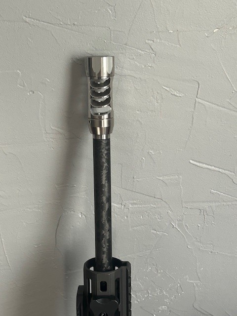

So, today, I received a notice of a recall with 6mm ARC and 22 ARC carbon barrels. After looking into this a little more and then calling and speaking with someone at Proof, I think that I may have found that variable. Apparently, their supplier of the barrel extension had not done something correctly with those extensions. It has affected the hardening and as a result, you might see some chips within the lug of the barrel extension. They told me that many upset people were complaining about accuracy issues and have found that these chipped lugs were contributing to that. Sure enough, I had 2 lugs that were chipped and would have affected the BCG going into battery properly or tight or snug. I have sent in my information for the recall and will be sending my barrel back to Proof for rework. I am hoping that this will fix the issue.
Because, if you will recall, when I got the barrel, I was seeing or did see sub-moa groups in the very beginning. Not any more. Again, I am hoping that this will fix that and get me back to where I want to be. Fingers crossed.
My Rainer Ultra match with the soft barrel extention just never wanted to shoot. I bought a cheap Faxon while I was waiting on a resolution with the rainer barrel and xcaliber make a barrel. It shot pretty well and the xcaliber did also right out of the gate. The faxon I still shooting well and holding head space at a little over 200 rounds.

So a guy on another forum was trying to tell me his 6 ARC 26" bolt gun shoots within 50fps of his buddies 6 BRA and 6 Dasher with the same bullet. Claiming 2850-2900fps with 105-108gr pills...
I dont see any way this is possible and staying within safe pressures... Not to mention we are talking about 5gr H20 difference case capacity....
I started looking through this thread and I see guys loading 105/108 pills in 6 ARC 2850-2900 with charges of 30-31.5gr Lever... Running the numbers in QL for these bullets and powders, these are WAY over SAMMI max pressure of 51996psi.... This may be why we have read so many reports of bolt issues and maybe even the reason why we are hearing about extension issues. Not sure on that one, but seeing the huge difference in factory 108 ammo speed vs what a lot of people are loading got me to thinking and plugging in the numbers..
Example from some loads I read in this thread guys are shooting
31.2gr Lever
95 Berger Classic Hunter
22" Barrel
2900
QL says that load is 60,000psi.. Thats 8000 psi over max...
29.7gr Lever
108 ELD
24" Barrel
2936
QL says that load is 57,363psi.. Thats 5300psi over max...
I believe the Hornady load data for bolt guns is rated at 62k psi
Agreed, but the info I posted above is AR loads guys are shooting...
Now for a bolt gun, that is true, but unless someone is making a custom 6 ARC bolt gun reamer to get the bullet up out the case, you can only fit so much powder in that case...
The Hornady load data for gas gun with 108-110 for Lever is 29.7 for max charge. 29.1 for CFE. With 103-105 it shows max Lever at 29.5 and 28.6 for CFE.
Which makes zero sense... Plugging in that exact info off the Hornady reloading data for gas guns 108 ELD with 29.7gr Lever into QL says 58556psi and velocity QL outputs matches Hornady reloading data...
I'm thinking QL is not 100% accurate. It's a great guide, but not exact. I haven't had a chance to load yet for my Arc. I am still shooting factory ammo and just haven't been out much since I built the rifle. I have several 108 ELDM and a handful of 106 Atip to play with. Lever and CFE on hand in 8 pound jugs. My CFE is from one of the first year of production lots so unsure how much it has varied over the years.
