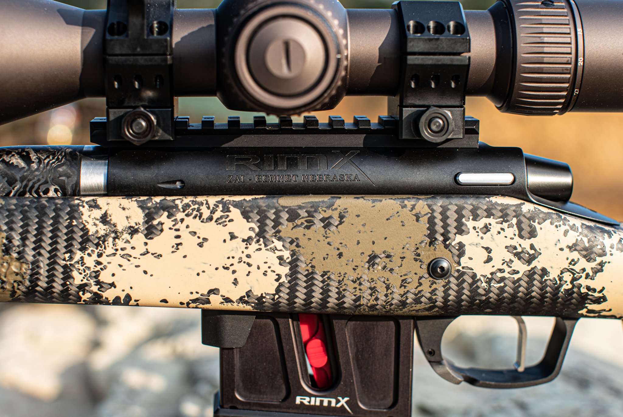

Introducing the RimX action from Zermatt Arms.
www.rimxaction.com
- Remington 700 Footprint
- Integral Recoil Lug
- Nitrided, chromoly reciever
- Nitrided bolt body
- DLC Coated Bolt Head
- Non-protruding, fixed extractor
- 6 o'clock firing pin
- Tool-less bolt disassembly
- Interchangeable bolt heads
- 22 LR / 17 Mach 2
- 17 HMR
- 17 WSM
- 7075 Aluminum 10 round magazine (anodized)
- Pre-fit, shouldered barrels available
- $1150 / ea. Includes (1) magazine
Check out the website for more information regarding the product!

Looks like a great option. The magazine looks like a slightly altered Vudoo mag, are you partnered with them for magazine production? I saw @RAVAGE88 talking about their partnership with Curtis too so that would be cool. The rimfire world seems to be more collaborative than centerfires.
Reactions: Jeffd
That is correct. Action and (1) aluminum magazine. Barrels will be available through your gunsmith or dealer of choice just like a center fire custom build.
We have the programming done and I'm cutting myself a couple barrels this weekend for the 2 actions I have on order.

Weight? Will it be about the same as the vudoo and bergara?
Not sure on the others weights, but we're just producing actions and magazines. So it's going to be tough to compare without a barrel attached.
If I had to guess, I'd say about 34 oz's because there is far less material removed in the ejection port and magazine well.

A question regarding barrels
What’s the cost for the prefit barrels and how hard is it to change (ie 2 grub screws like the CZ455/457?)?
I love swapping barrels on my CZs so this is very interesting

It's a shouldered barrel. So you swap barrels just like a centerfire action. Shouldered barrel, torque it on. No grub screws.
Reactions: Frankr and BWB
When you buy a shouldered barrel that means it has to be headspaced from the factory right? So I'd just request it to be headspaced for like Lapua/SK ammo versus Eley.
This action has a tenon print just like a TL3. So Smith's can make prefit barrels that will headspace when torqued on without the action in hand.
Now, what chamber they cut into the barrel and what they set headspace to is an entirely different topic that can be discussed to death. I have my own custom 22lr reamer I had made and I designate the headspace I want it set to...
What 22lr reamer your Smith uses is between you and them. Might be a Bentz, EPS, Lilja, Win52D, PTG Match, etc..

If this is a firing pin driven rimfire with a bayonet fire control assembly can you dryfire this or can you damage it like the older Rugers?
