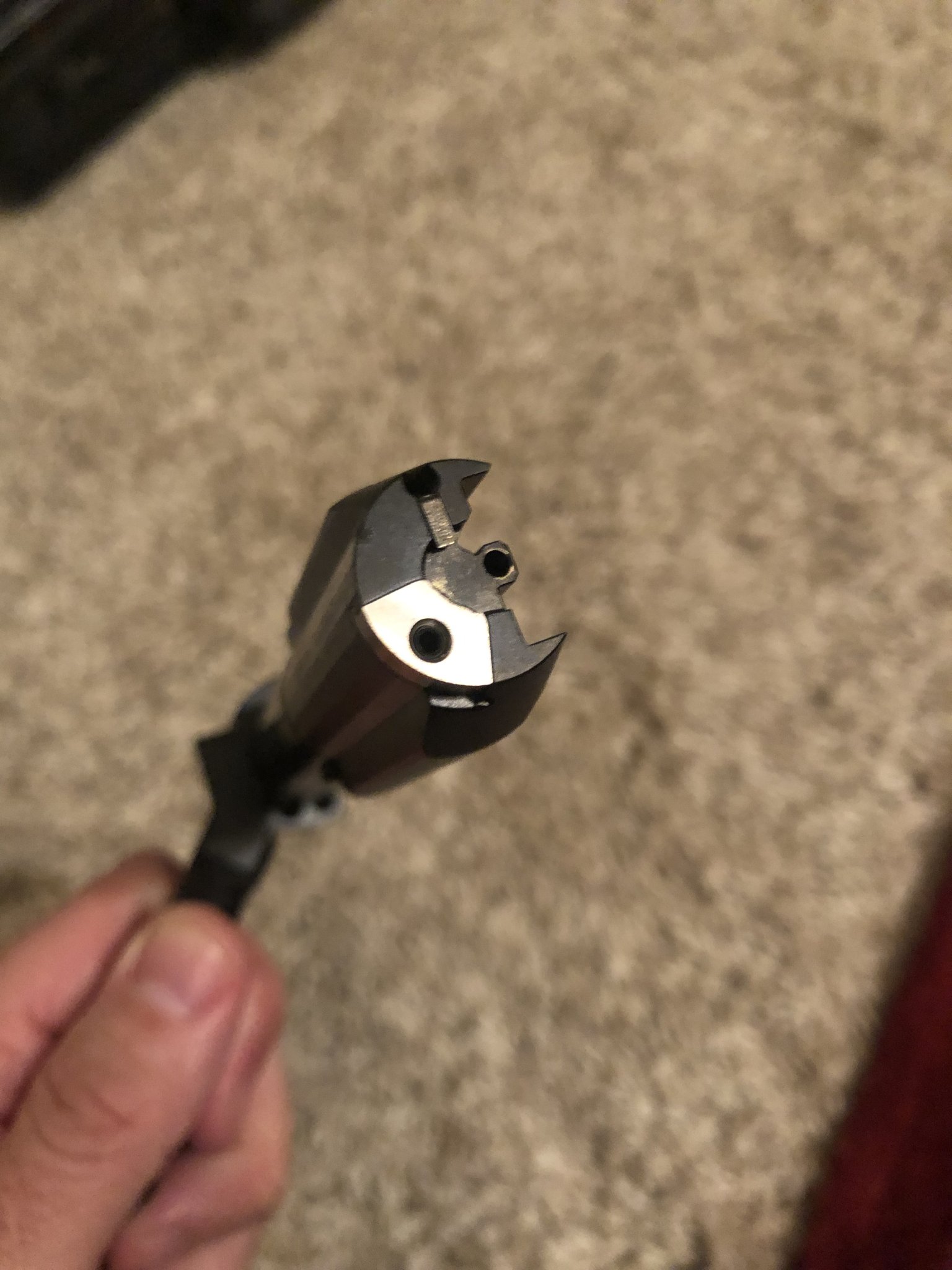

Quick question regarding the RIMX bolt closure. Mine seems to require (fairly stiff) excessive force to close the bolt with no round in the chamber. It has a 1k plus rounds through it, but I have no others to compare it to. Jewel trigger if that matters..... Just wish to make sure nothing regarding the barrel headspacing that can cause this.

Everyones *Fairly Stiff* is different. If you take the bolt pieces off and use the No Go Gauge that came with the receiver and it tests out you are good to go. Your build has been shooting fine for 1K+ rounds. Does it feel different with ammo cycling? I would thing if it was a stiff closure on an empty chamber it would be a TIGHT Closure on a loaded round.
Things to keep an eye on and clean after every outing is the Bolt Face and Breach Face. A minor about of buildup there is a big difference in bolt closure. In bad conditions I have wiped mine off during a match. My build has almost 2K rounds through it now and it has been butter smooth since day 1. there is an occasional tight closure on a loaded round, but nothing anywhere near a tight closure on an empty chamber unless it was a gummed up or dirty breach face.

Hi Defender, thanks for your response and the "NO" Go Gauge stops bolt closure., double checked today I believe it may be the sear engagement with the Jewel trigger, though all your points have been taken onboard.(y)
