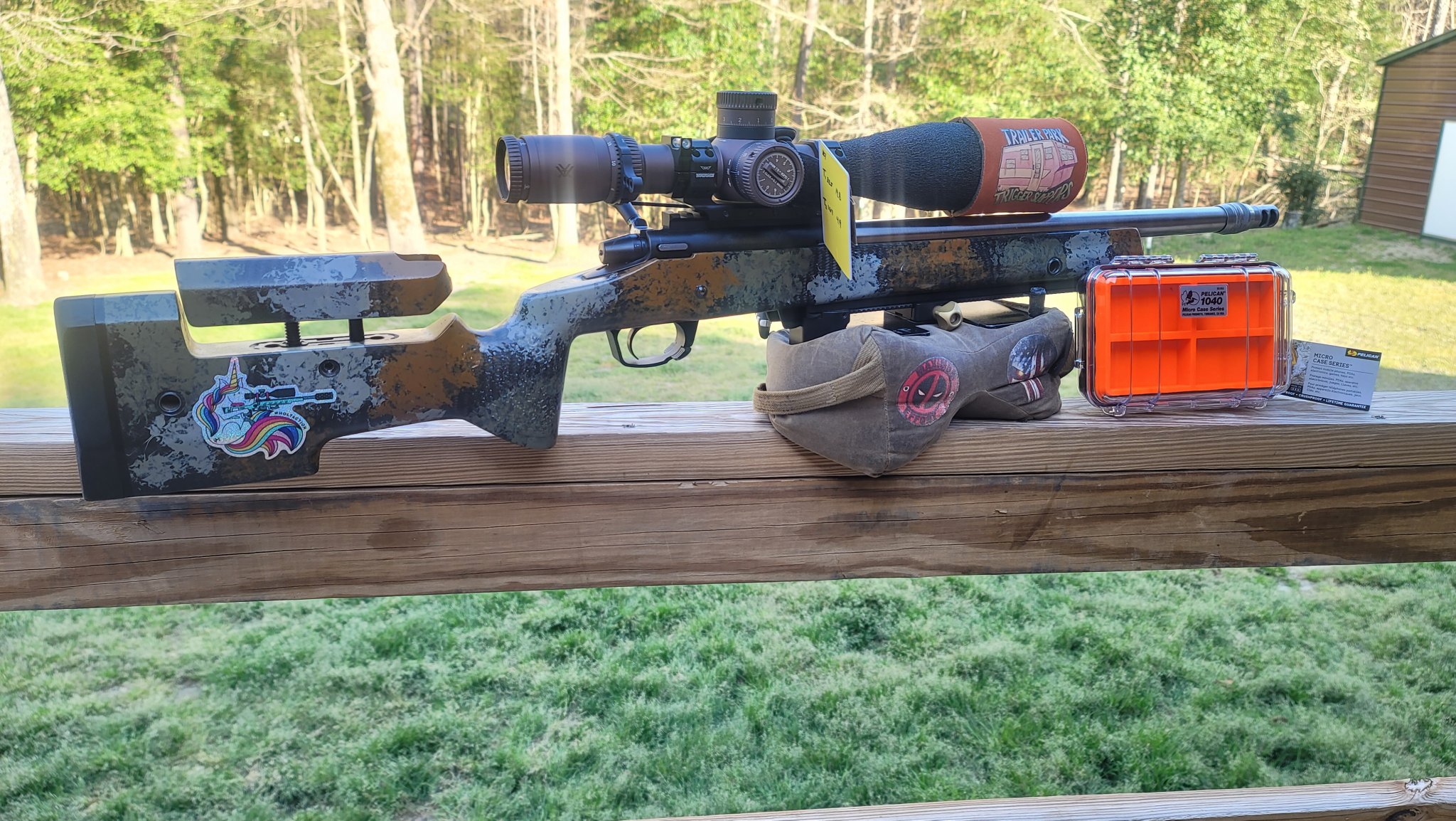

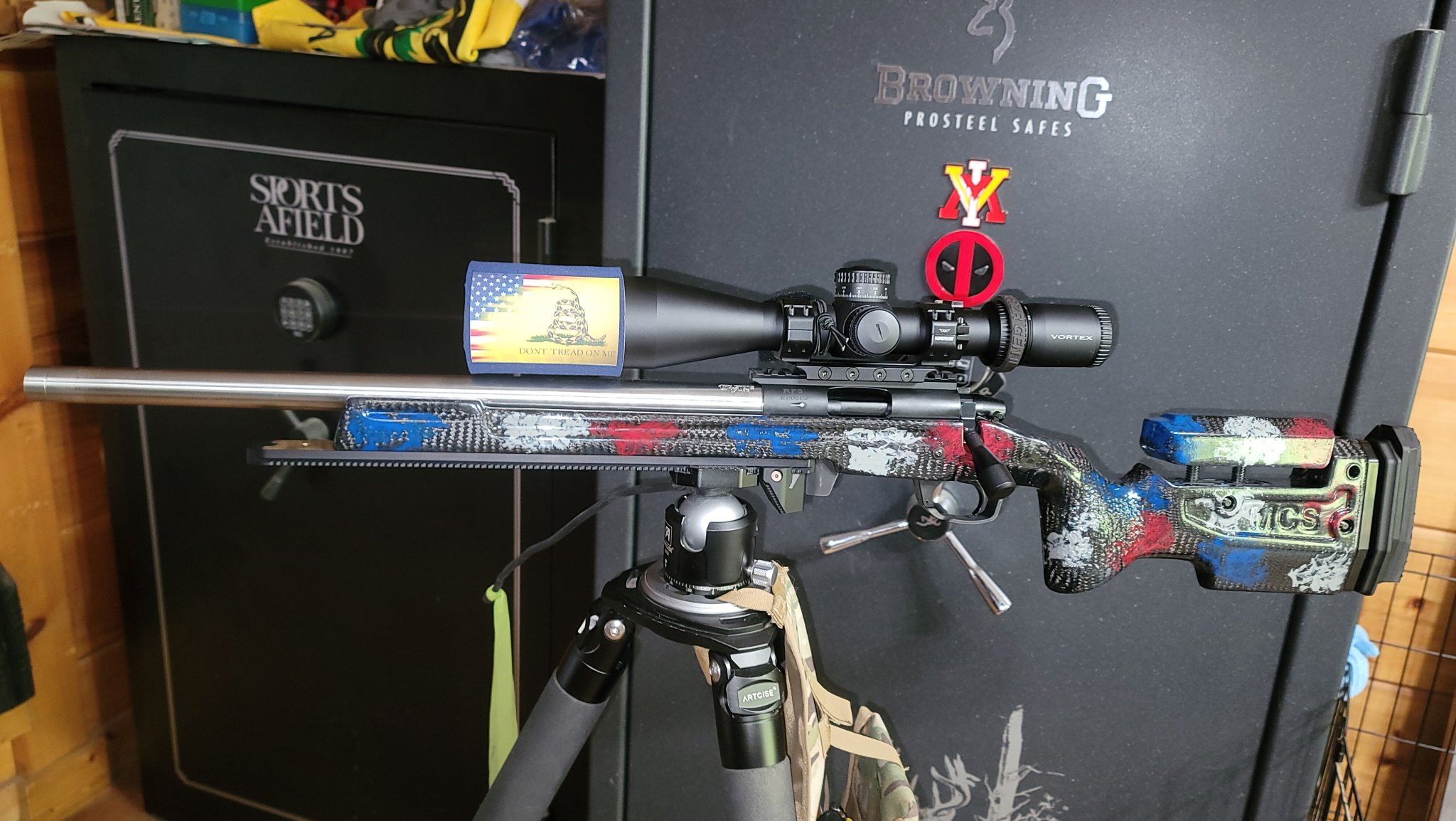

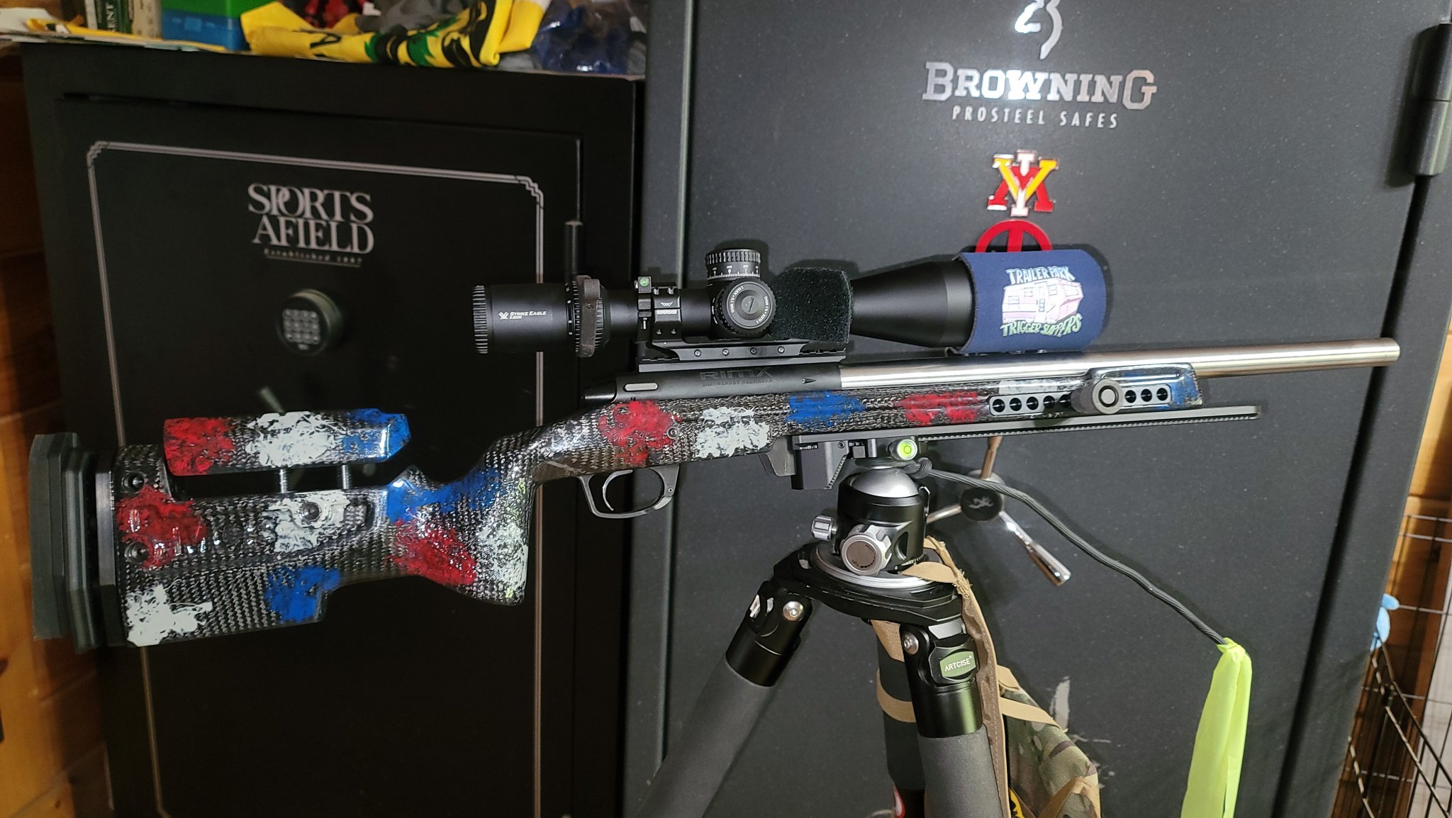

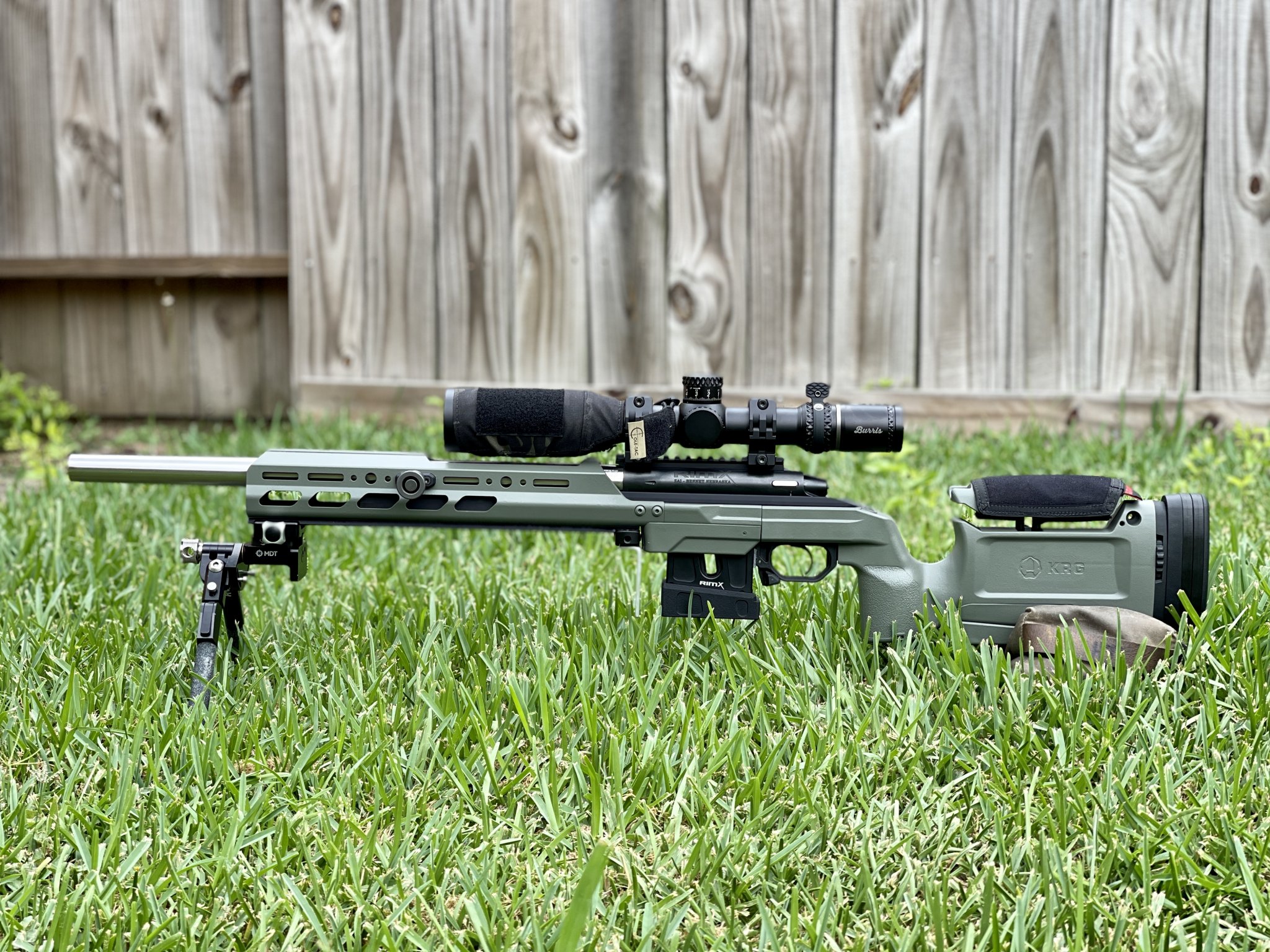

I change configurations more than I do my underwear. Took my Krieger truck axle off and slapped on my TS Custom/Primal 26” barrel after getting it chopped to 21”. It’s basically a VCC contour now. Why? I don’t know why. Guess I’m in the experimenting mood. New glass is arriving this week as well. Finally stepped into the ZCO arena. Next range range day is Sunday. I’ll let you know how the chopped barrel shoots.
I hope you don't lose accuracy. If that barrel was made to finish @ 26" there's a good chance its going to have a looser crown back at 21" than it did at the designed finish length. Why didn't you go back with the tuner? Either way its a nice looking rig.
Reactions: 021411
A tapered bore definitely crossed my mine before hand. The barrel at 26” with a tuner was good to go. Make no mistake about that. I personally didn’t care much anymore for the actual length than performance.
With all that said and to satisfy my curiosity and yours, I will head to the range late this afternoon to do some lot testing. I’ll update good or bad.
Reactions: Boxerglocker

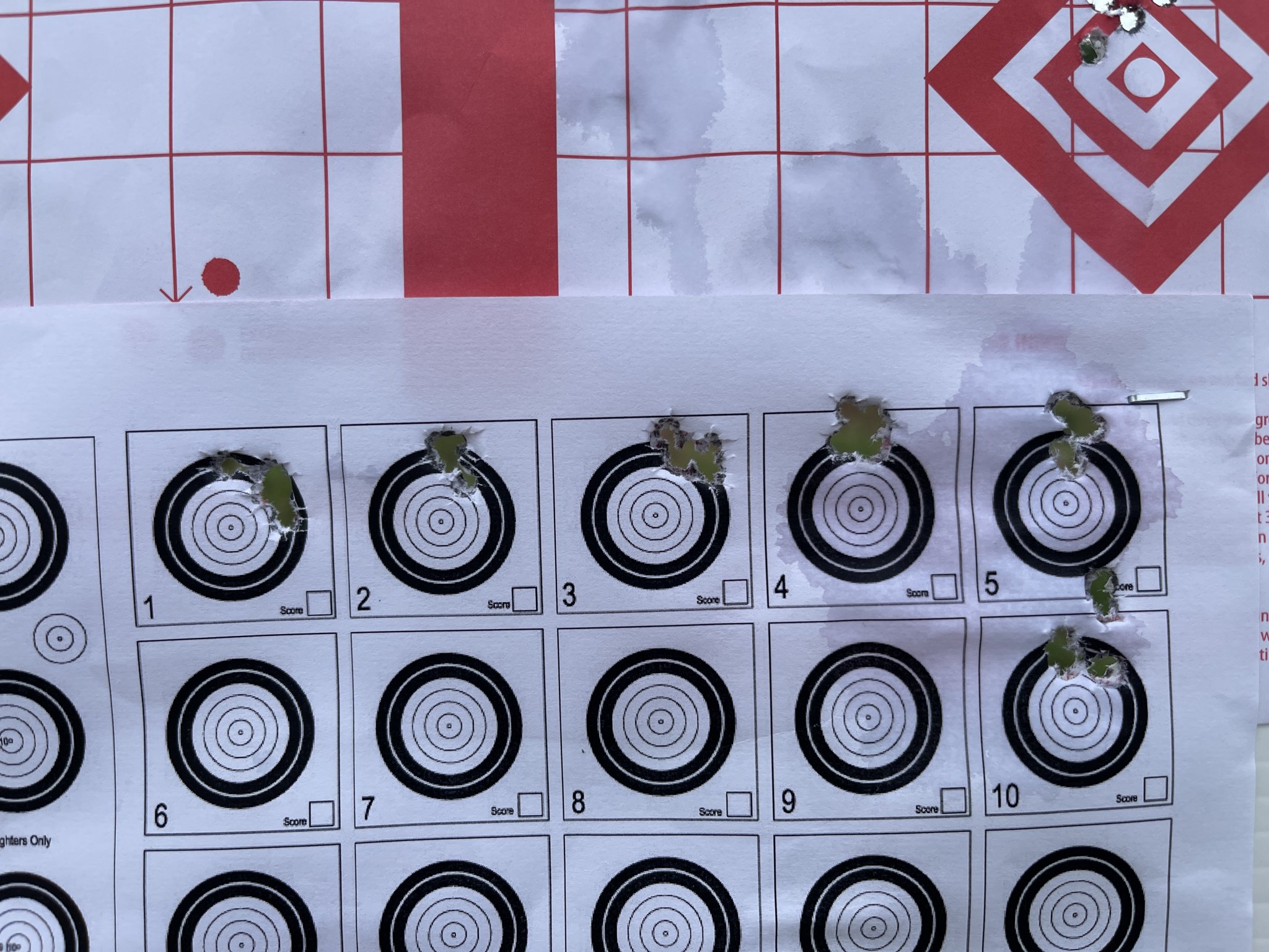

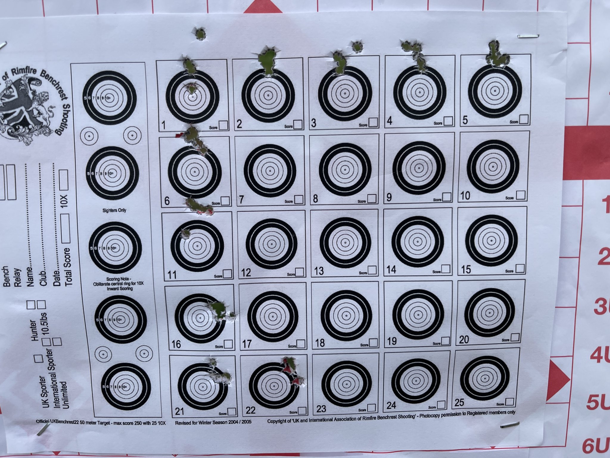

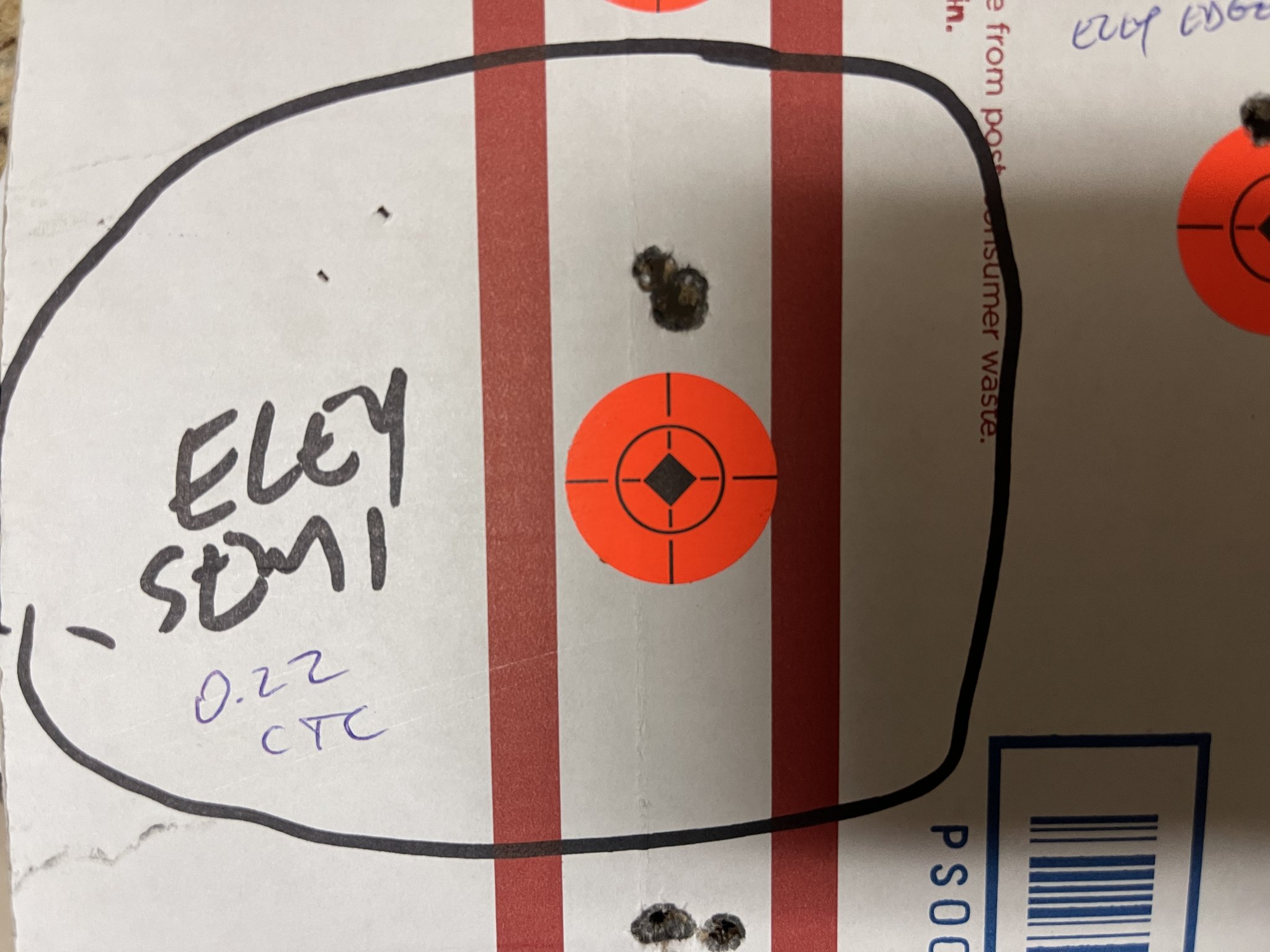

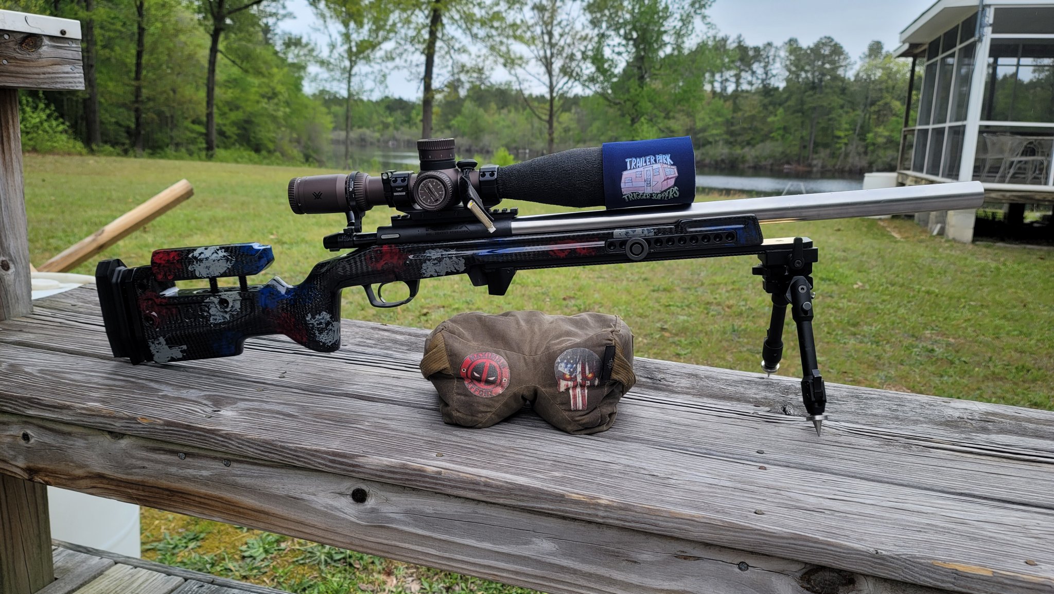

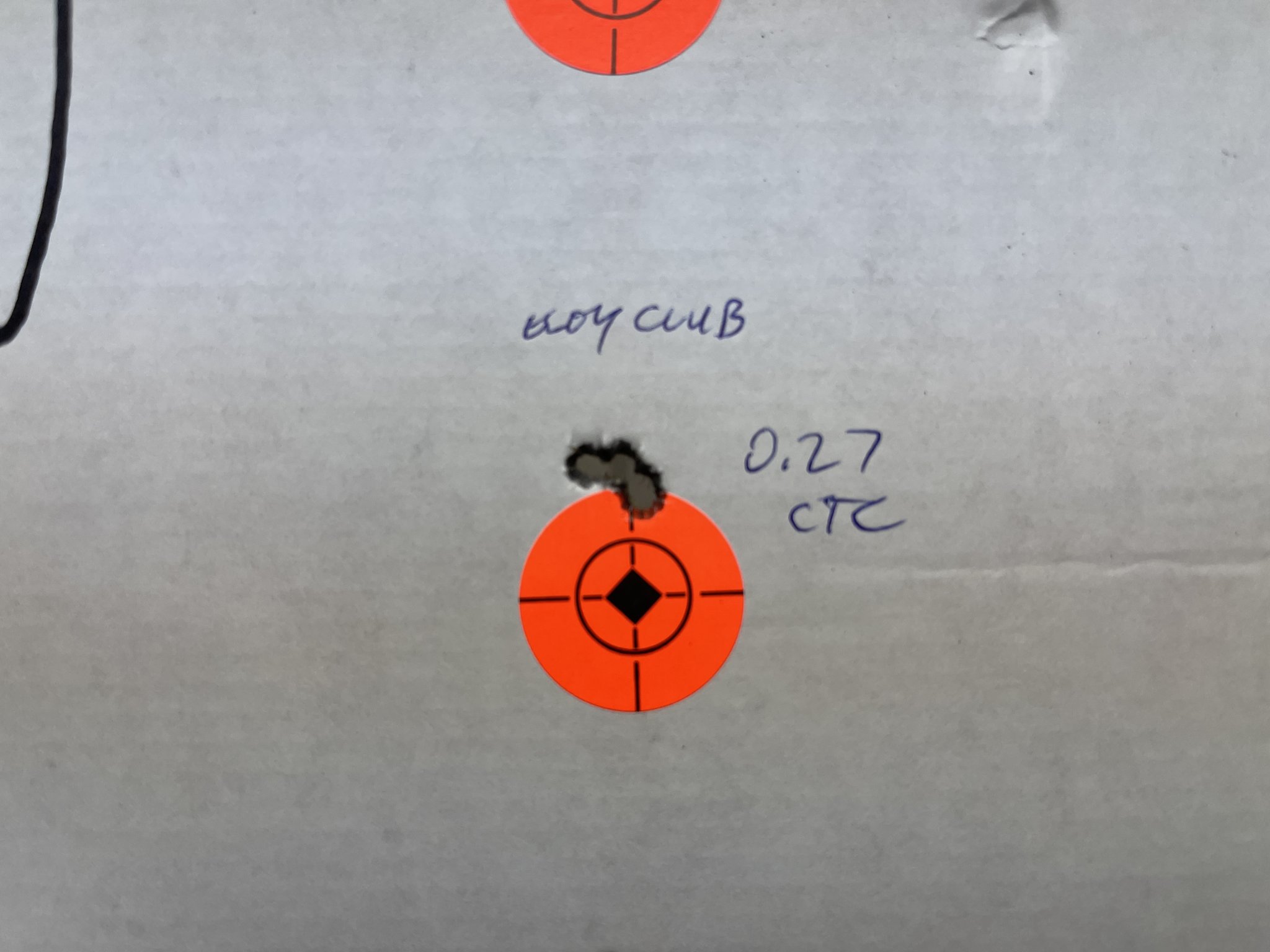

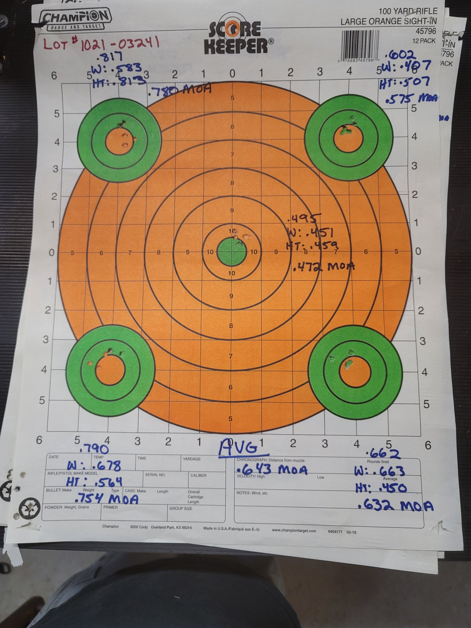

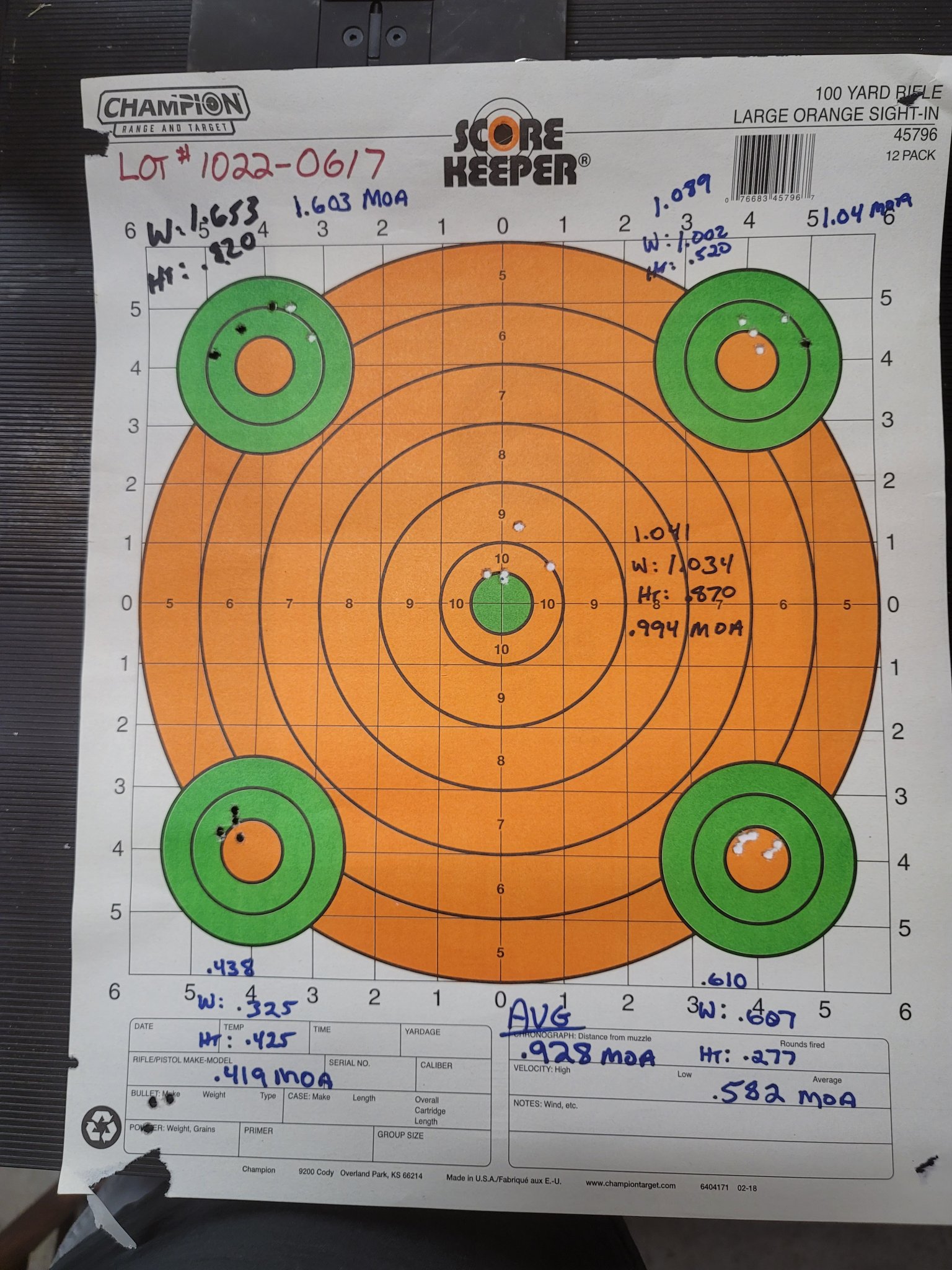

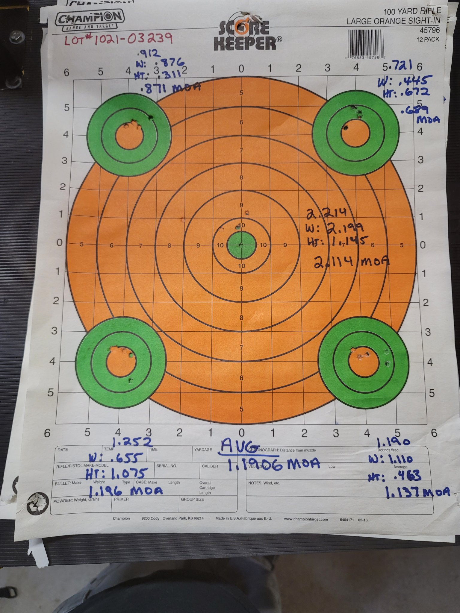

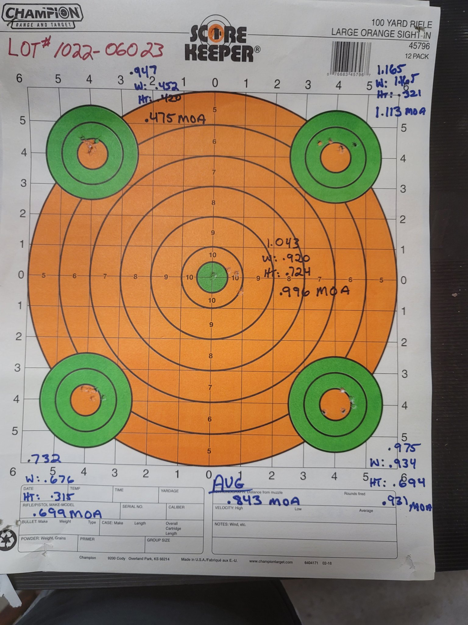

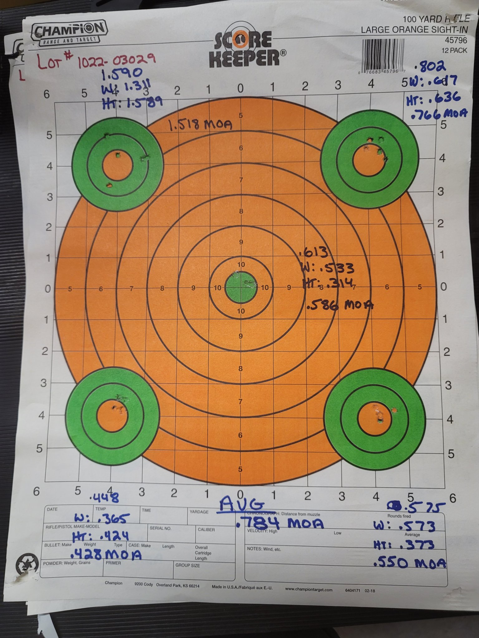

@Broncolou Just got back from the range. The range trip was successful. First and foremost I needed to see if the new cocking piece from Zermatt solved the light strikes with the Eley ammo. Yes it did. Out of the 150rds I pumped through, I only had 1 light strike at the beginning of the session. The rest were 100%.
Next was accuracy of the chopped barrel. It’s perfectly fine. I was sloppy on my rear bag but meh. I’ve not a 6x5 kinda guy. I’m in “The Grid” camp.
I didnt re-zero. Got close and dialed wind. There was a 5-6 mph right to left. Shots were at 50y.
Disregard Box 1. Box 2, 3, 4, 5, 6 were 5 rounds each of different lots of Eley Semi Auto Benchrest. The velocity averaged 1110. I saw no more than an SD of 7 with the lowest being 2 with 10 rds per lot.
The split screen pic was with Eley Edge.
I’m good with the accuracy. Again I don’t care about 6x5 or whatever.

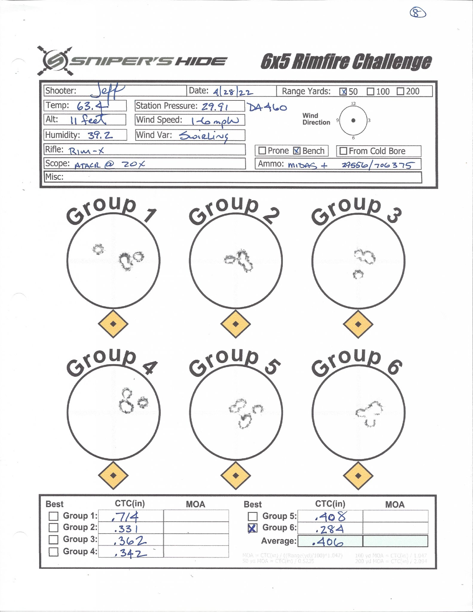

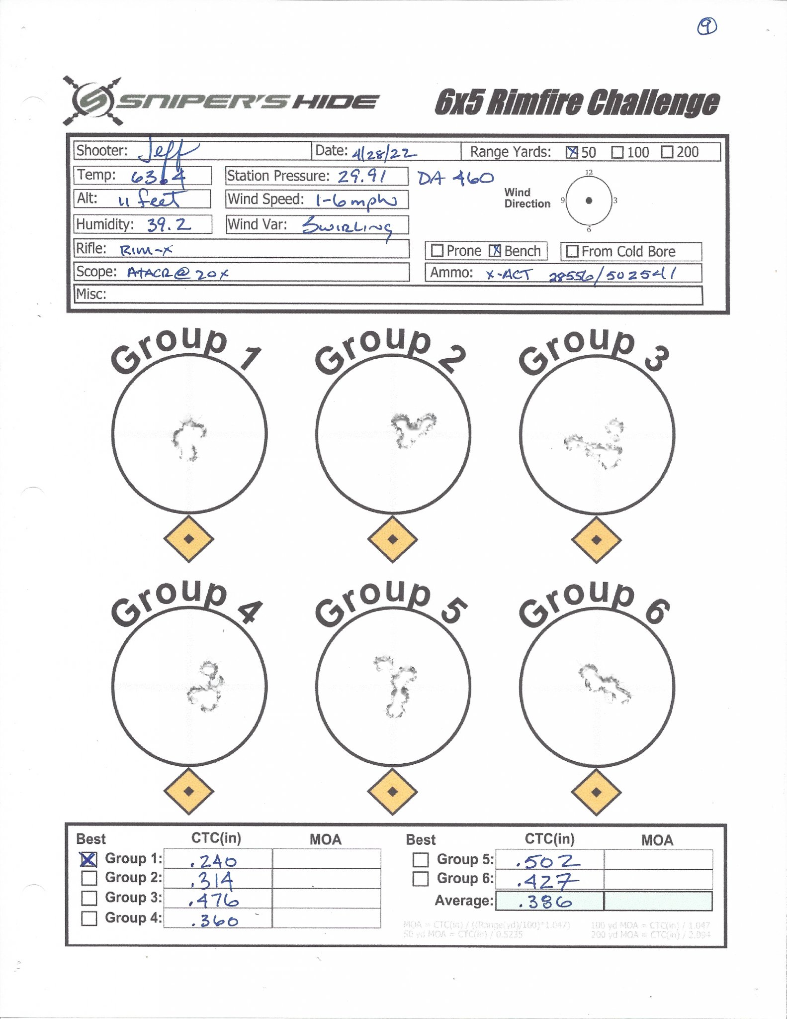

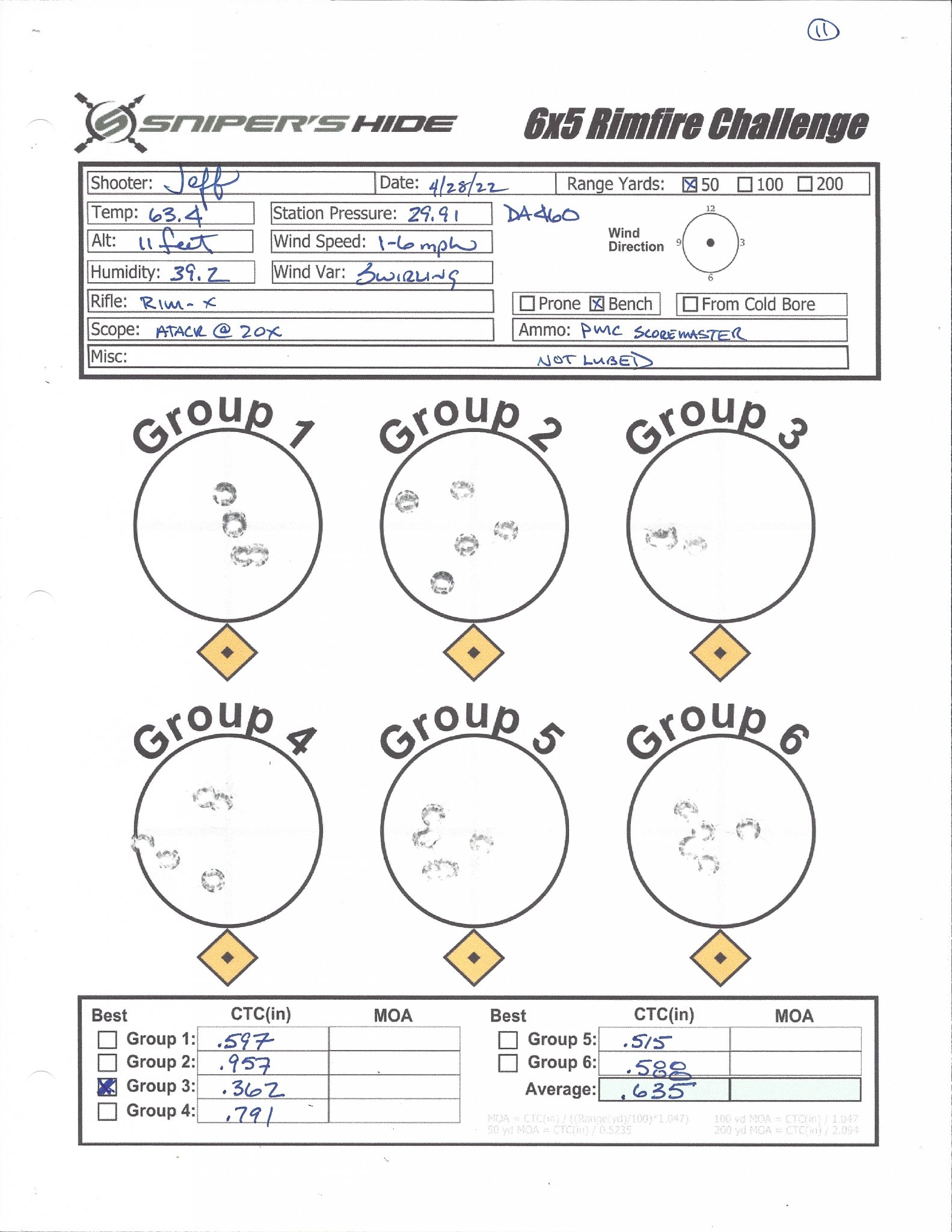

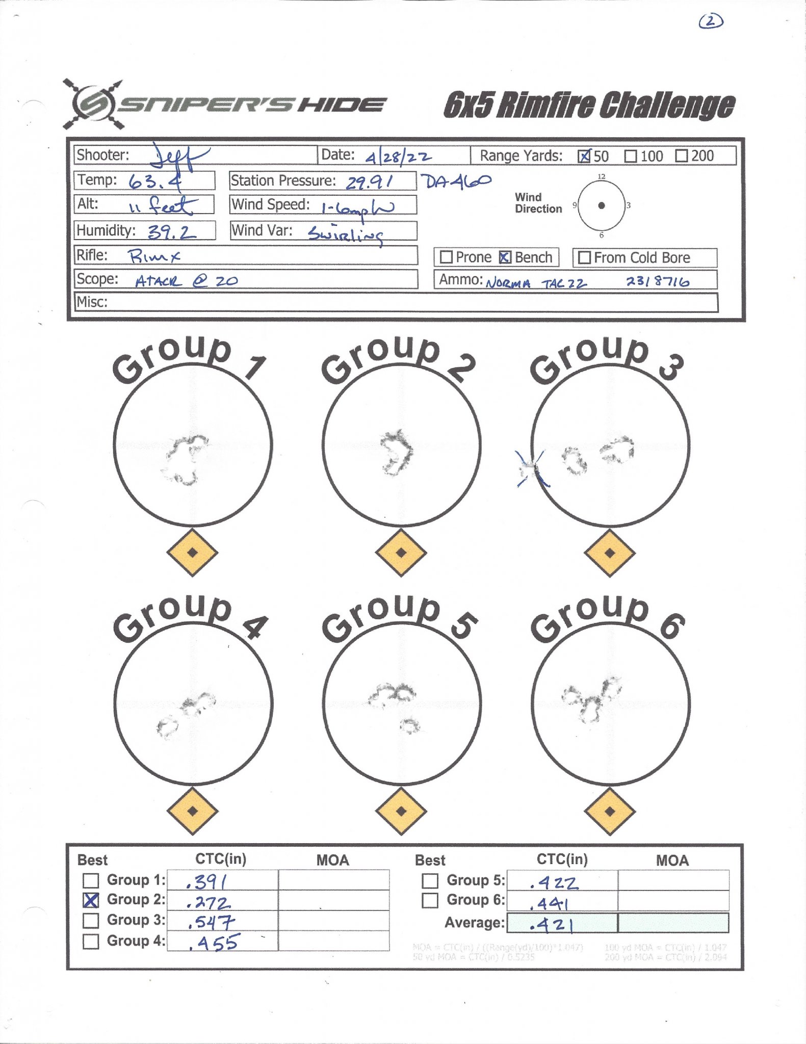

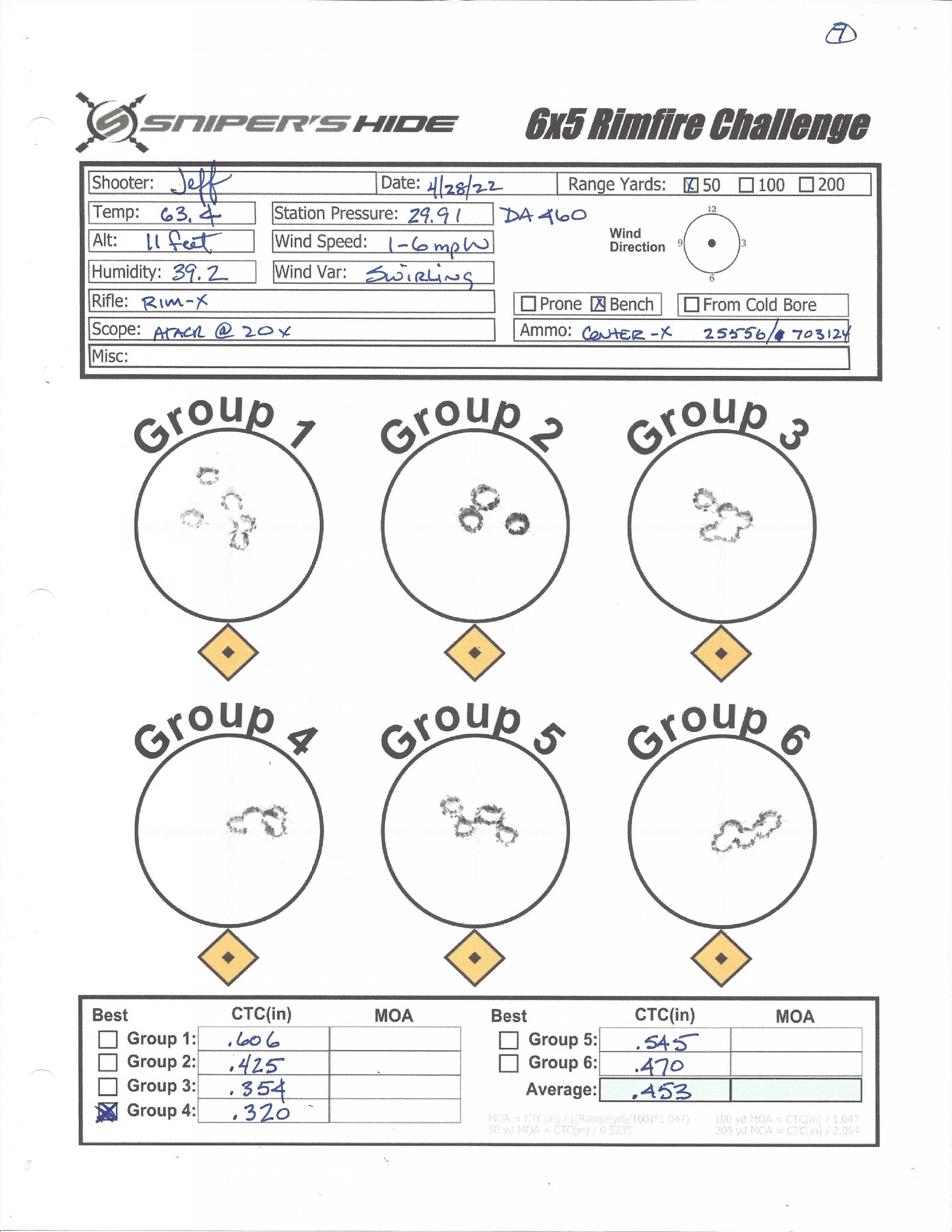

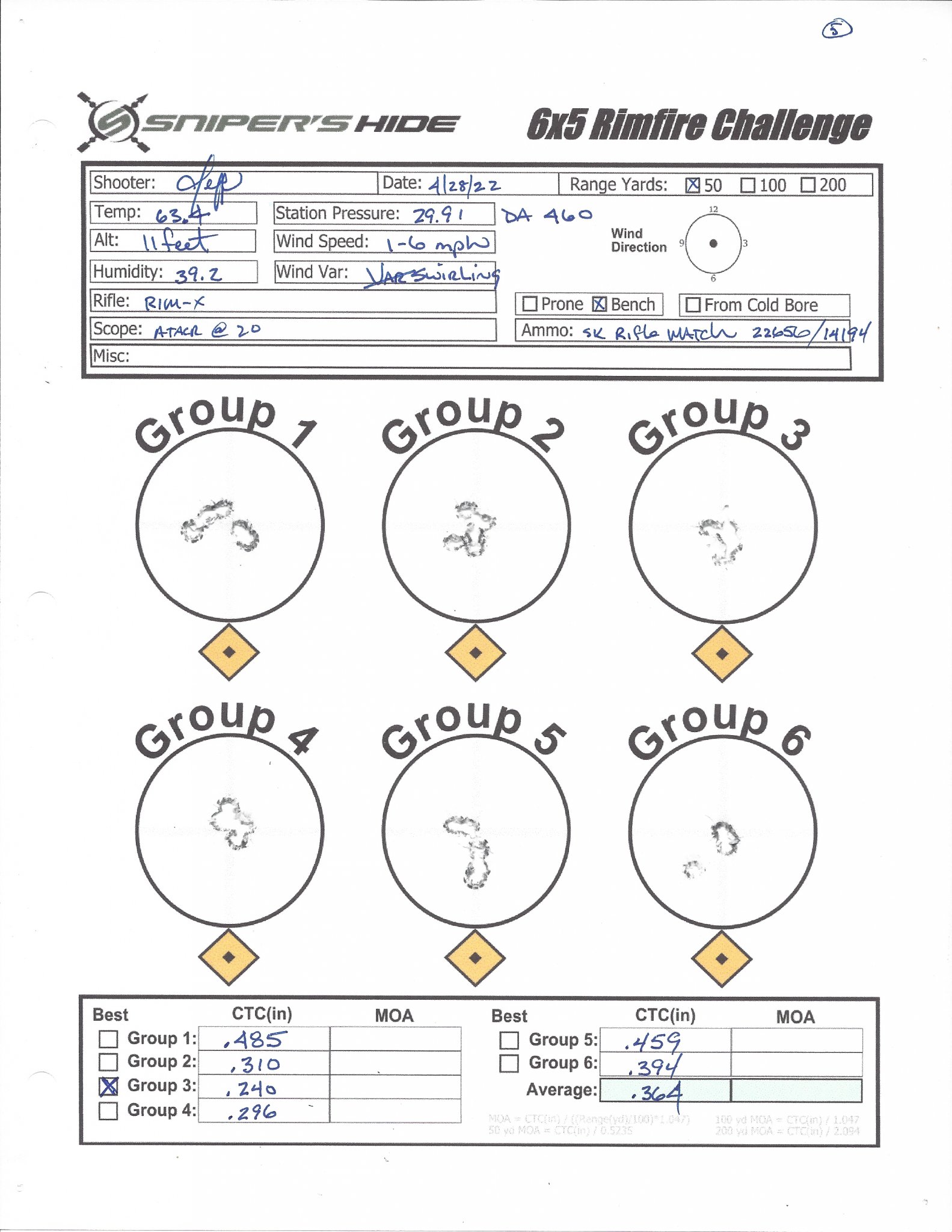

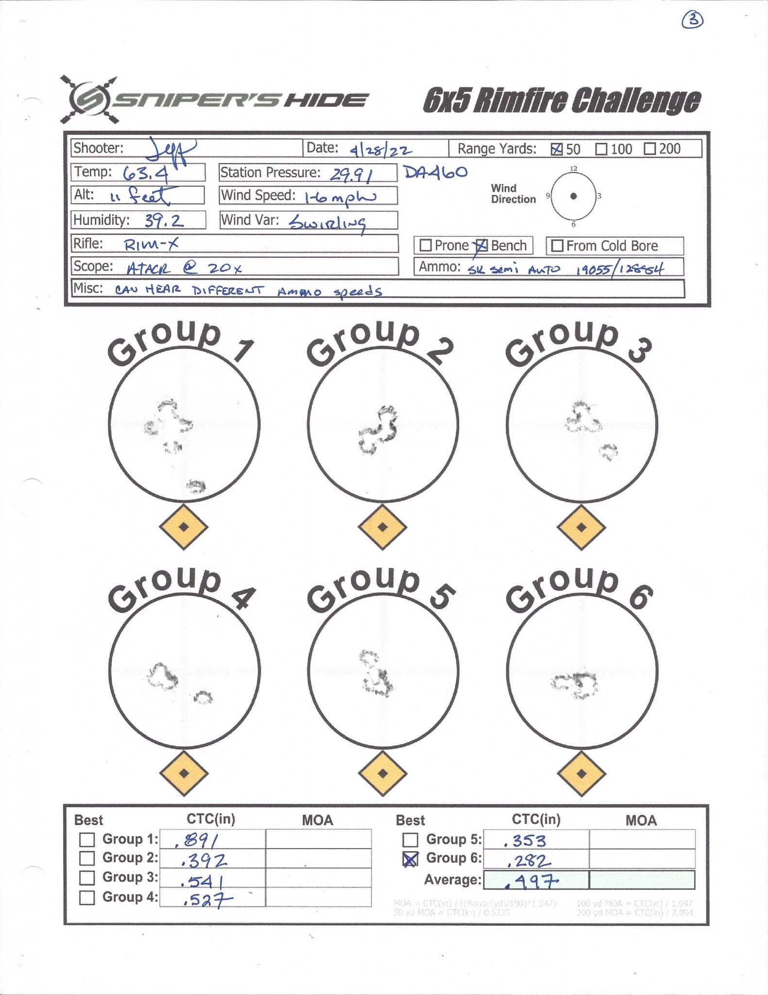

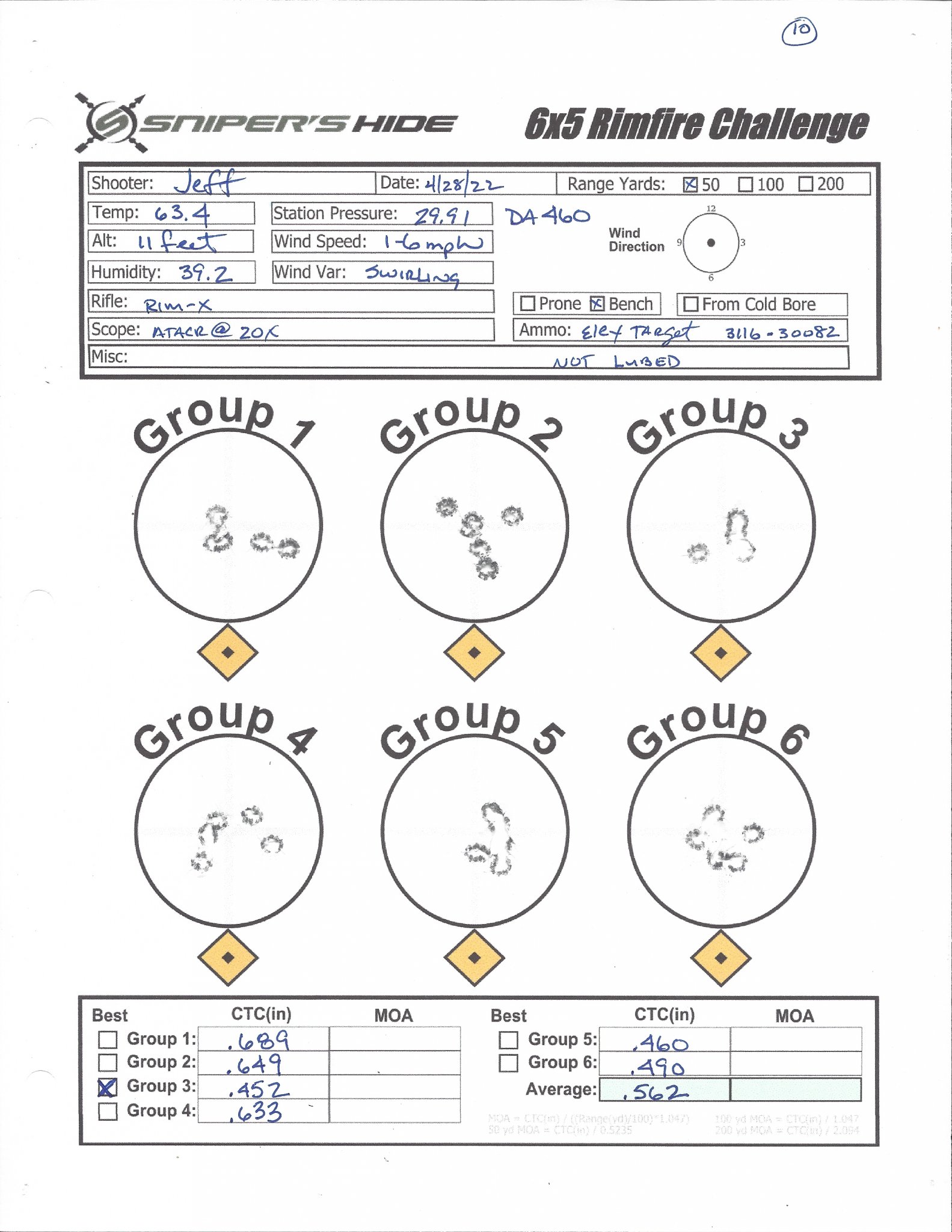

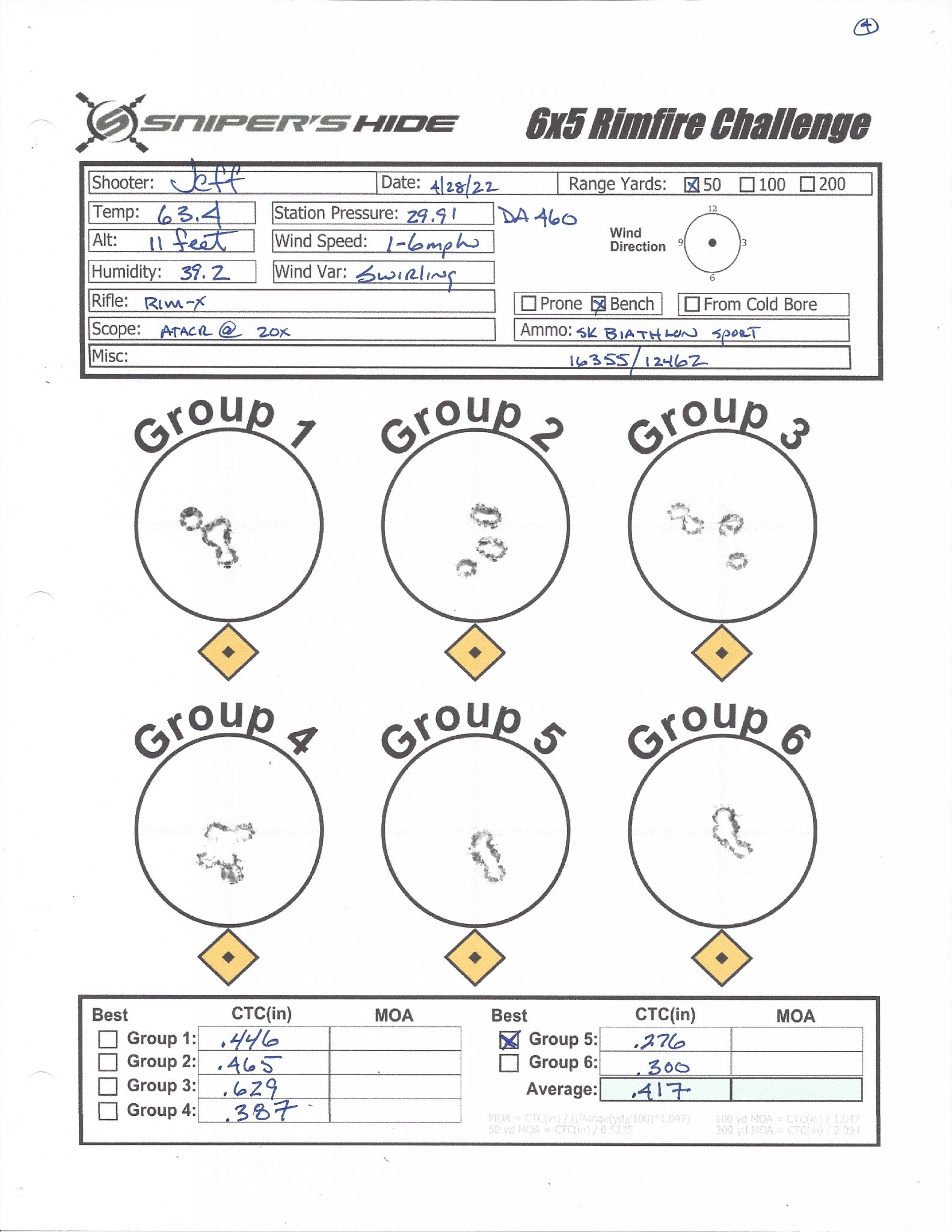

Now go run a 6x5 and tell us how it shoots!

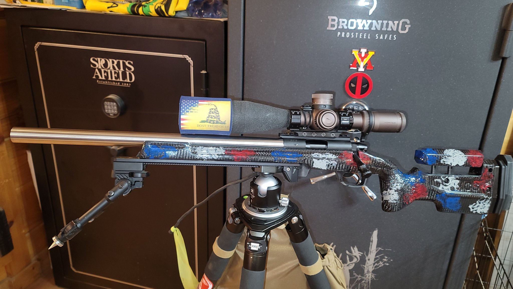

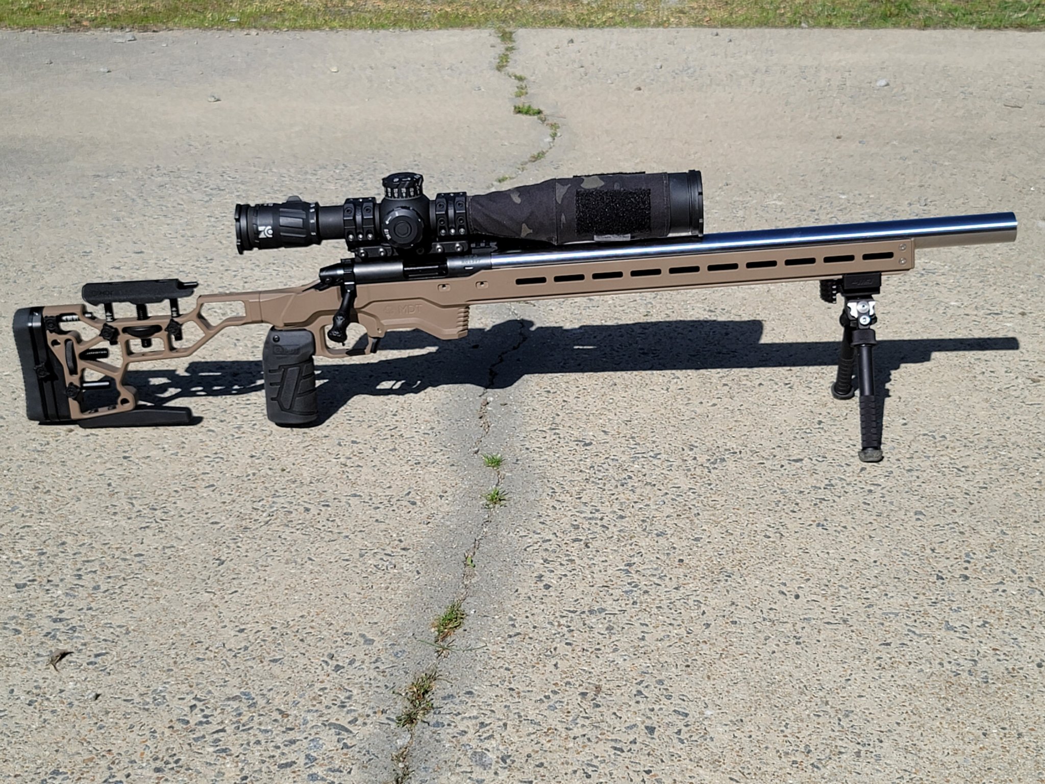

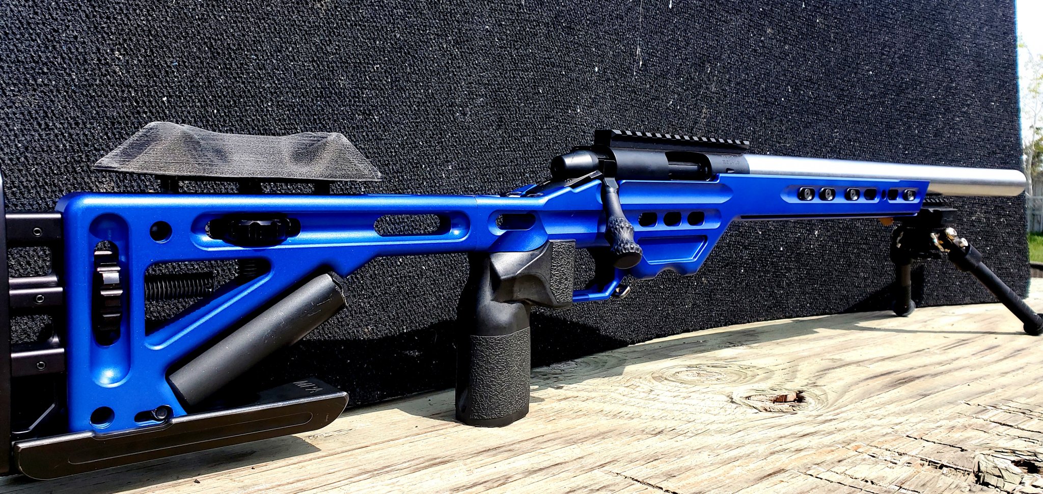

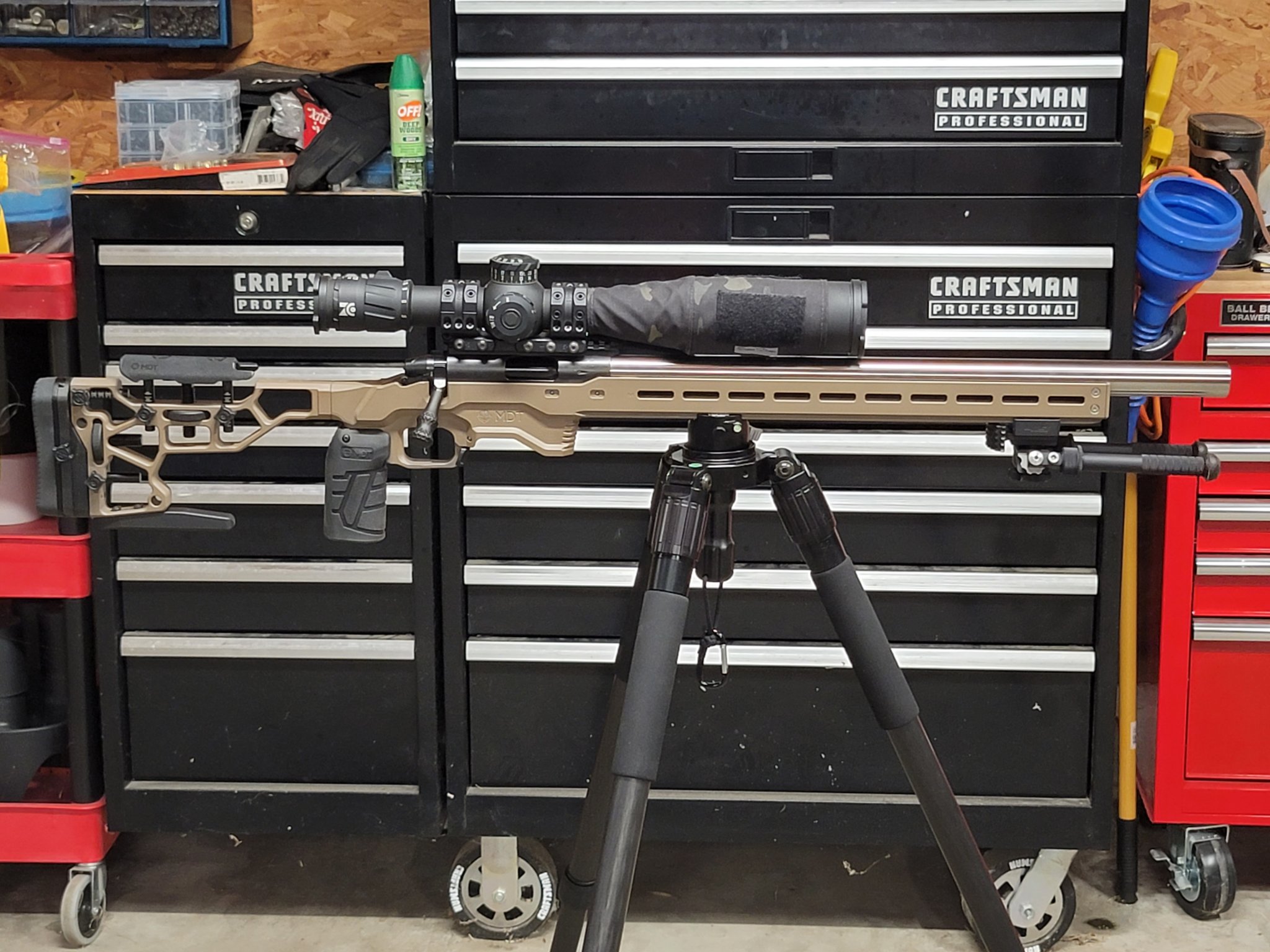

I'm new to the site. Not sure what the 6 X 5 is. I guess it's six, 5 shot groups? Anyway here's some pictures from lot testing. I tested 6 different lots of Eley Tenex, 5 groups each at 100 yards.
DPG Rim X
Krieger 23" 1.25" straight
MDT ACC chassis
Trigger Tech2 stage Special
ZCO 5-27
30 moa rail
Spuhr 6601 20 moa/1.18"
I'm happy :D
Looks solid for sure. I ruined a great shooting barrel on my 455 cutting it down.
I’d be pretty happy with that accuracy for sure.
Yeah that sucks. I know the barrel is definitely capable of small groups. On one of the Eley Edge groups had I kept it together and not pulled a shot it would have been in the 0.11+“ or so. The capability is there with the right lot of ammo. Yeah yeah but can it do it all day and where’s the 6x5!? I’m just taking capability.

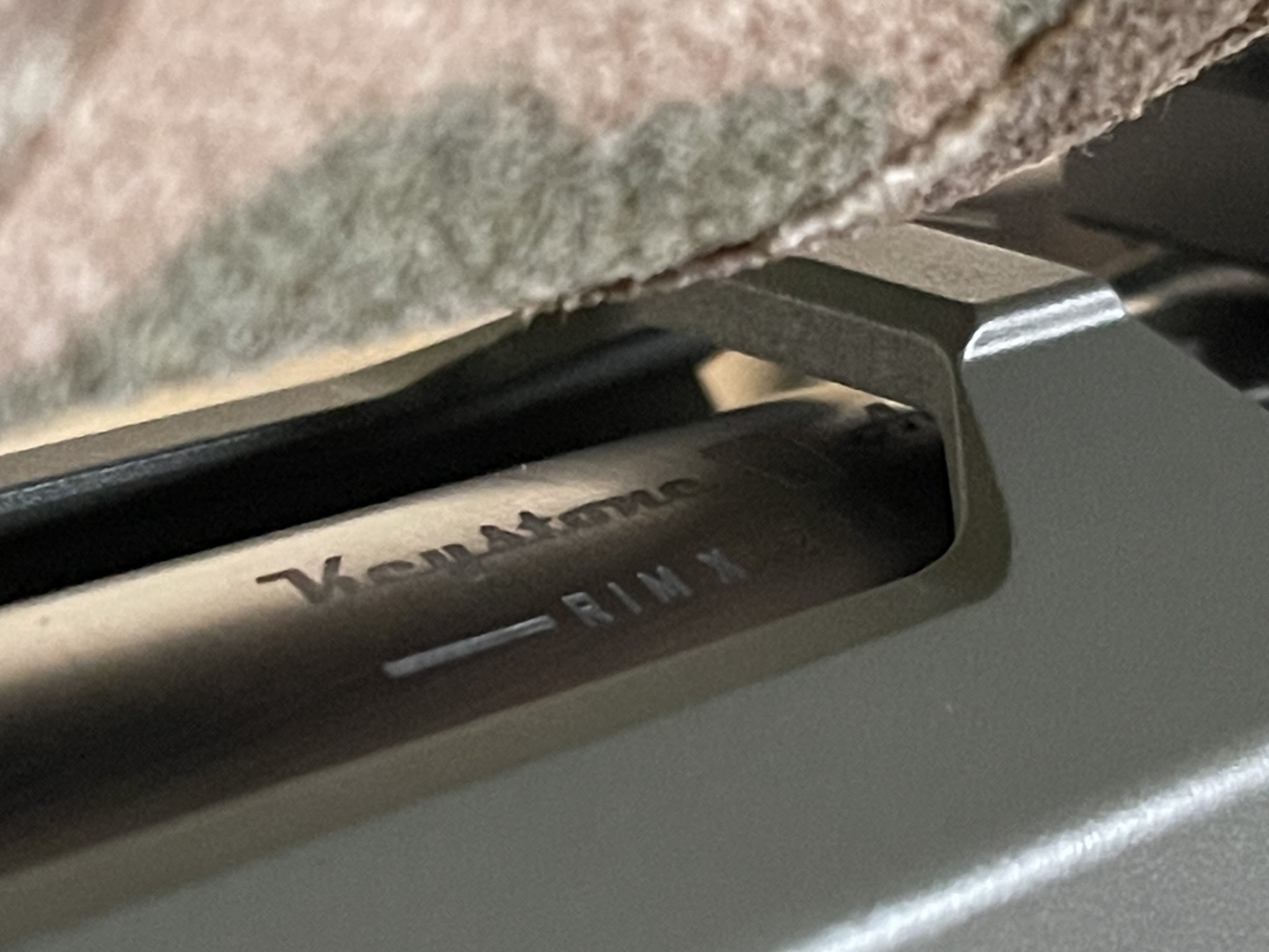

The Keystone GM with the Eachus chamber is an absolute hammer. Got to the range this afternoon and went to work. I didn’t do any special barrel seasoning routine or break-in. IMO if the barrel can’t shoot it can’t shoot. I shouldn’t have to pump 600 rounds through it first. The groups above are are within the first 100 rounds. They are not cherry picked. I shot a 5 round group and moved onto the new ammo. Again, no fouler shots in between new ammo. I went to town. The CX group was within the first 15. I shit you not.. Sorry 6x and 10x guys. I know the capability is there to shoot small groups with good ammo. I’m a grid convert and dialed in that way at the end of the session. Whatever batch the barrel blank came from its awesome.
RimX is amazing. 22" GM barrel 1.20" straight from Keystone. no idea which chamber but it shoots great with SK RM. 🤣

Hi Guys,
My outing in the back yard last week, wanted to try some different kinds of ammo with this Rim-X and Keystone GM barrel, results below. I probably shouldn't have been shooting on this day because a storm was approaching and the winds where swirling, but when ya have the itch ya got to shoot! :D This photo of the rifle just has the thread protector installed, but I shot these with my Thumderbeast Ultra 9 can installed, it's so quiet, bullet impacting the bullet trap is louder then the report..... LOL
Here we go....... I didn't clean the barrel between ammo, just loaded up the next kind of ammo and shot it.
Target 1 = SK STD PLUS
Target 2 = NORMA TAC 22
Target 3 = SK SEMI AUTO
Target 4 = SK BIATHLON SPORT
Target 5 = SK RIFLE MATCH
Target 6 = SK LONG RANGE MATCH
Target 7 = CENTER -X
Target 8 = MIDAS +
Target 9 = X-ACT
Target 10 = ELEY TARGET
Target 11 = PMC SCOREMASTER
My action and barrel came in on Thurs, put it together yesterday and managed to hit the range briefly in between storms(mostly). Could only shoot 45yds. Was having some extraction issues I chalked up to my unfamiliarity with the system.
