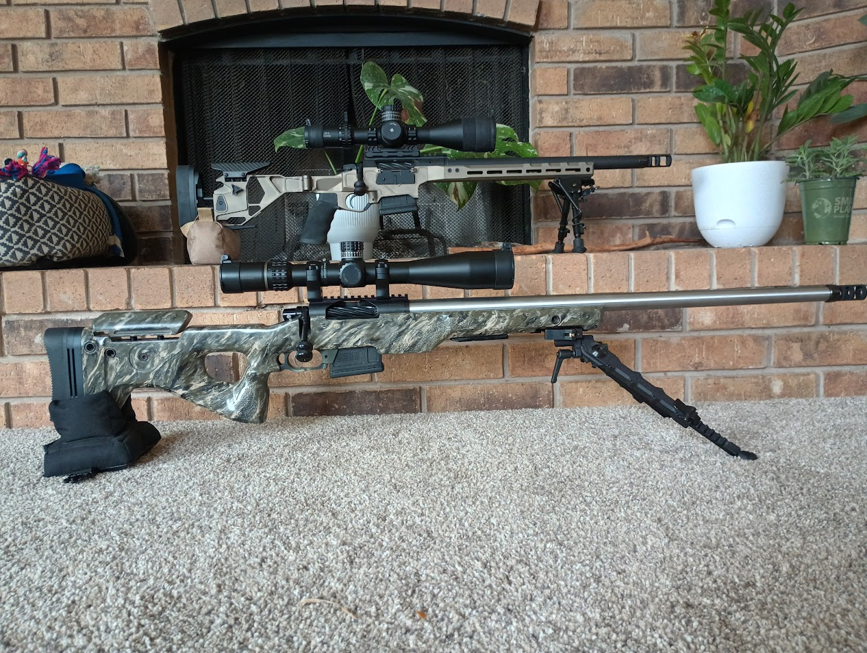

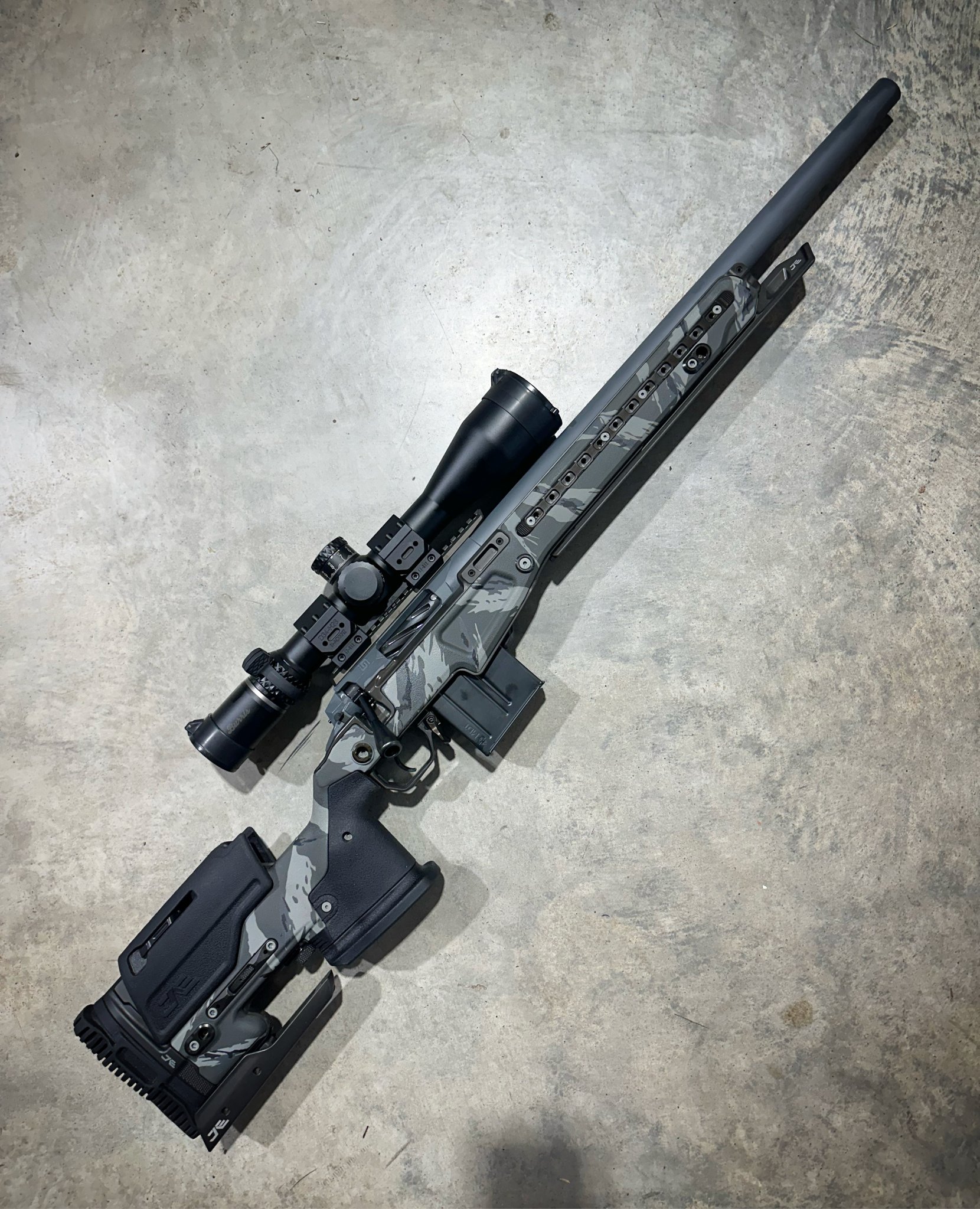

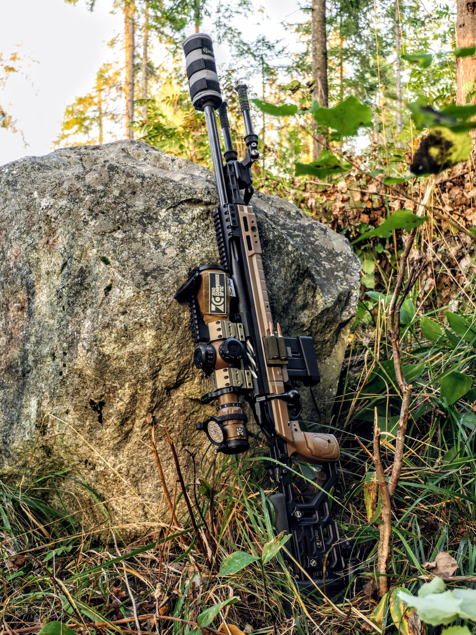

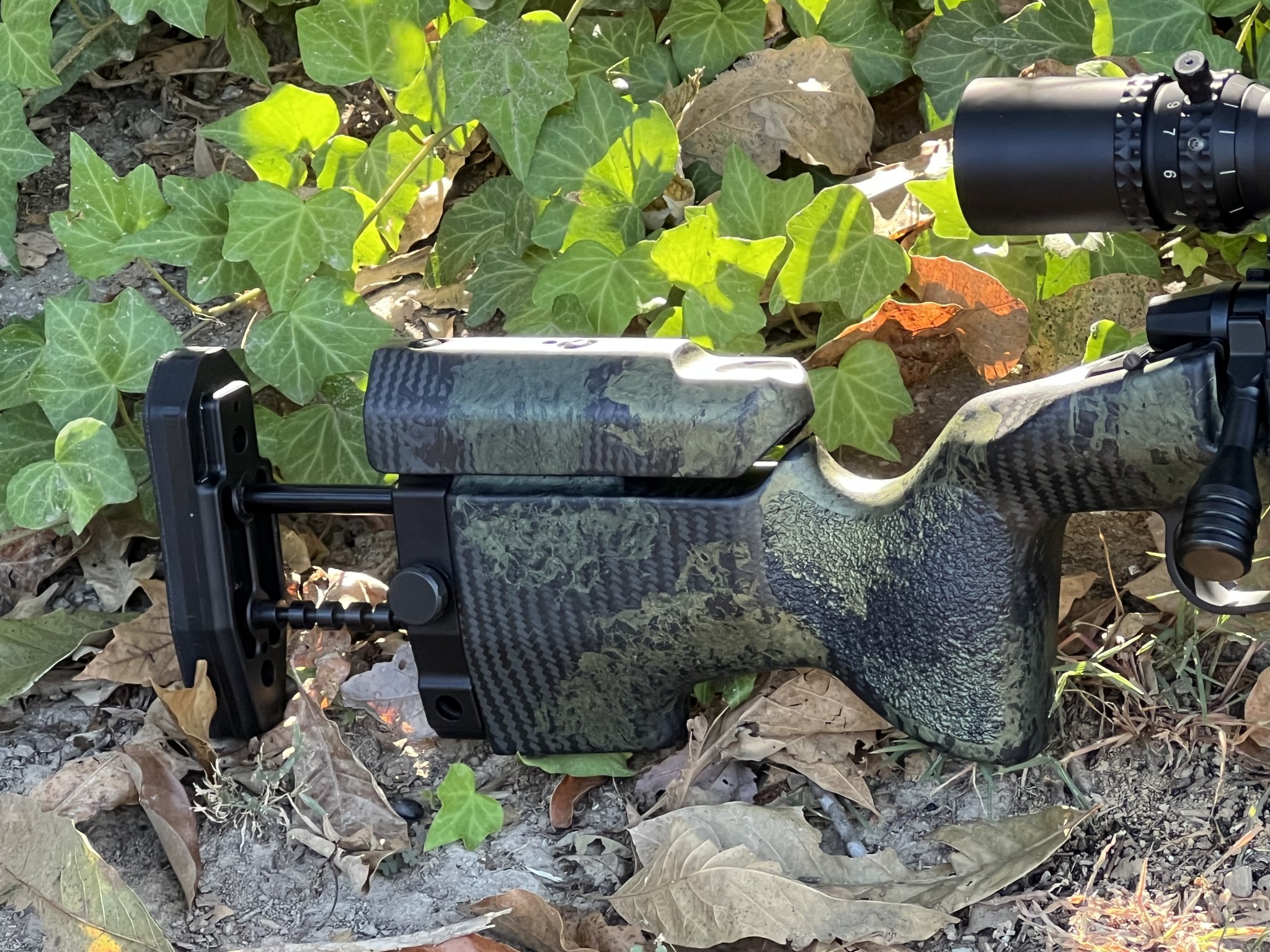

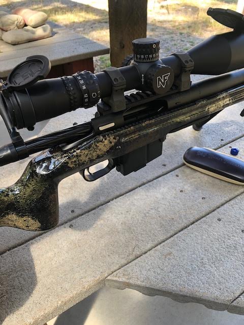

First bolt action build. Seemed simpler/easier/(not cheaper), than putting an AR together. Everything literally fit together just about perfect. 6.5 CM, Zermatt TL3 LBRP action, Bartlein Heavy Palma/1-8 twist/24"(Done by Southern Precision Rifles), Manners Pro Hunter with Hawkins M5 bottom metal and a TriggerTech Diamond single stage. Put the thing together, went to the range, bore sighted it and this was literally the first 3 shots (Factory Hornady 140 ELD-M) through the thing.

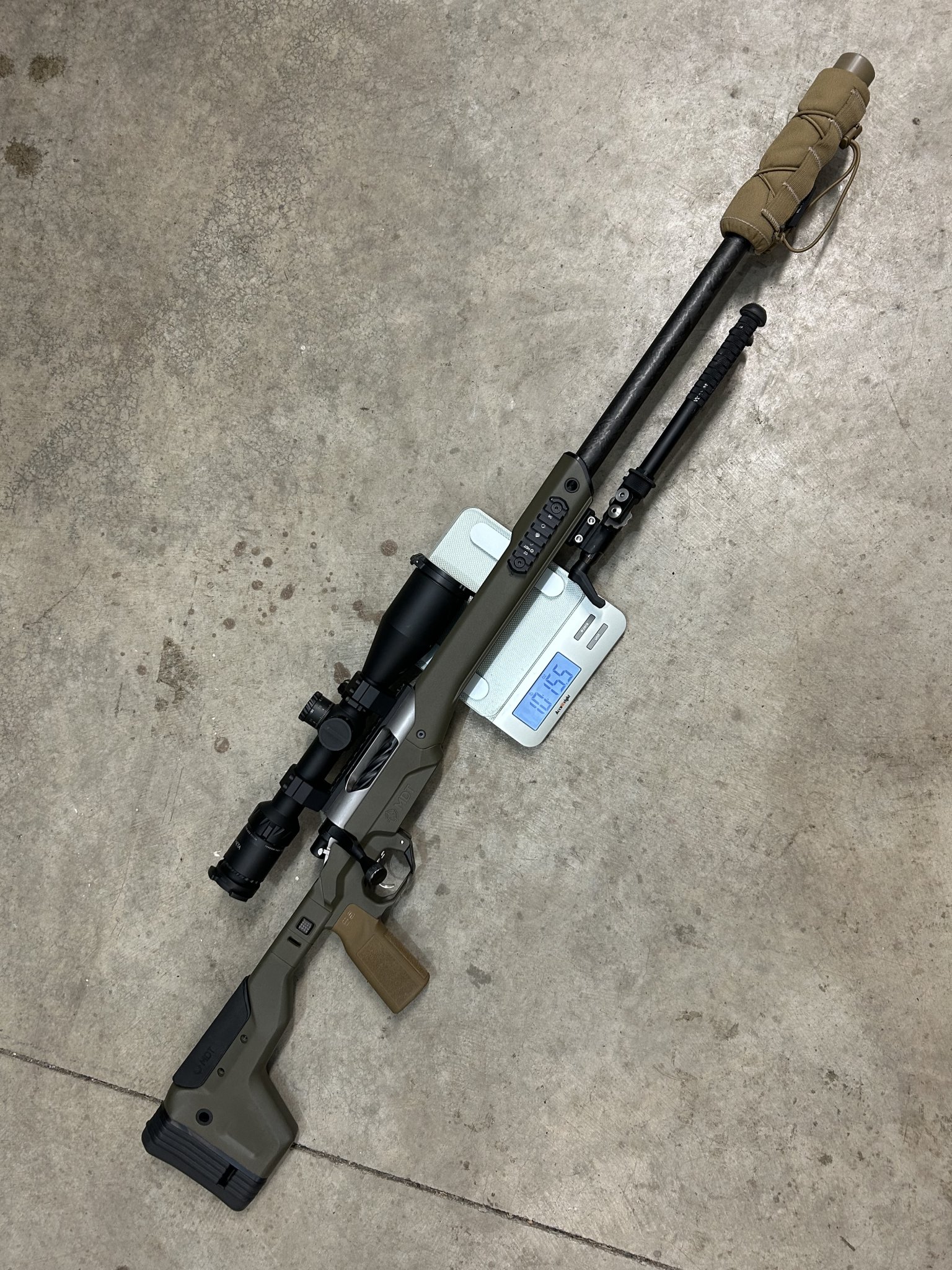

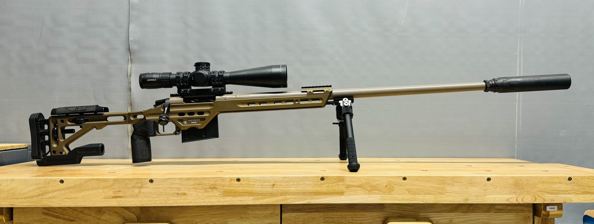

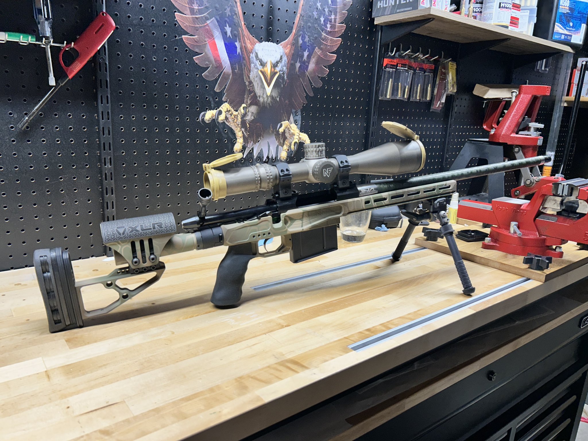

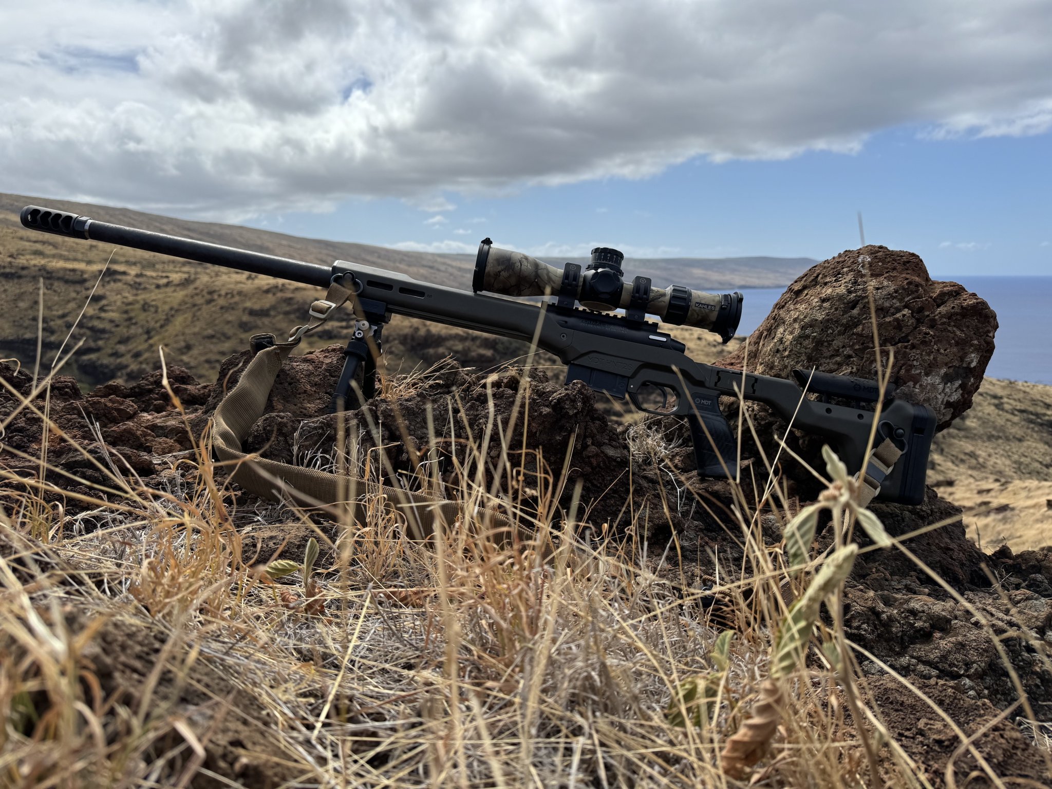

My 7-300 PRC at the moment (also has a .300WM barrel to swap back and forth with). Still getting stuff together to start playing with it this winter. Right now it is serving as a test bed for my loaner Zeiss S3.
-Older Prague OK Surgeon 1086
-27" Bartlein 1:8, heavy palma, with Area 419 Hellfire
-McM A5
-Surgeon bottom metal
-7-35 ATACR in Nightforce ultralight rings

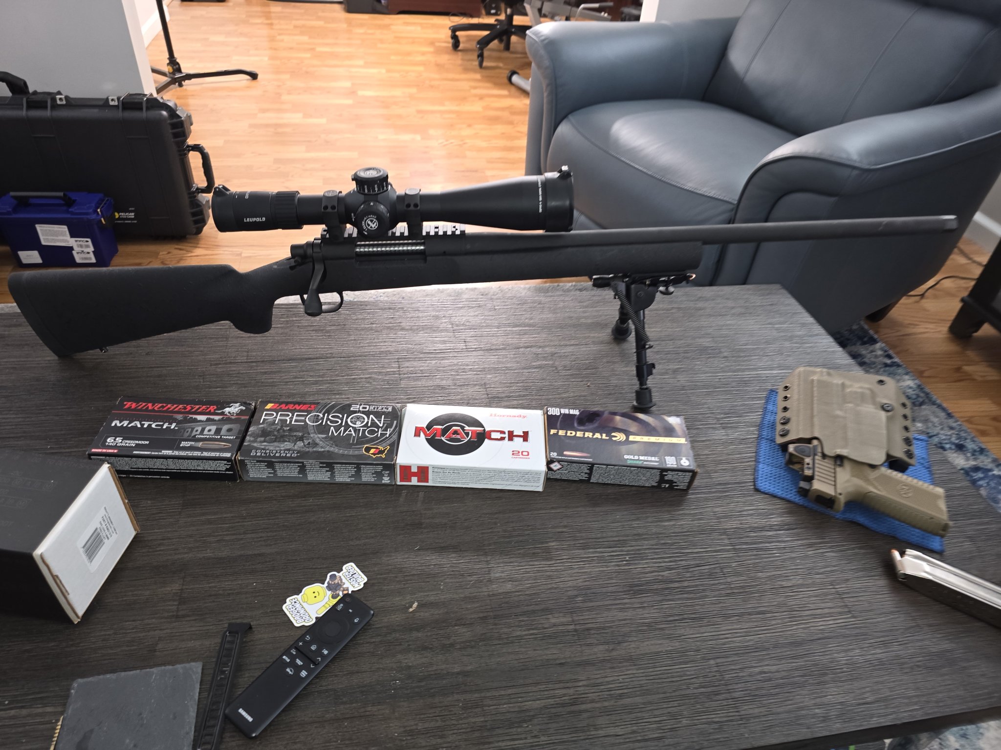

I would recommend swapping out the barrel and chassis. I had a savage that was terrible and for 1400 extra bucks I got a one hole gun. To me it was cheaper than struggling to find ammo that would shoot etc.
Below

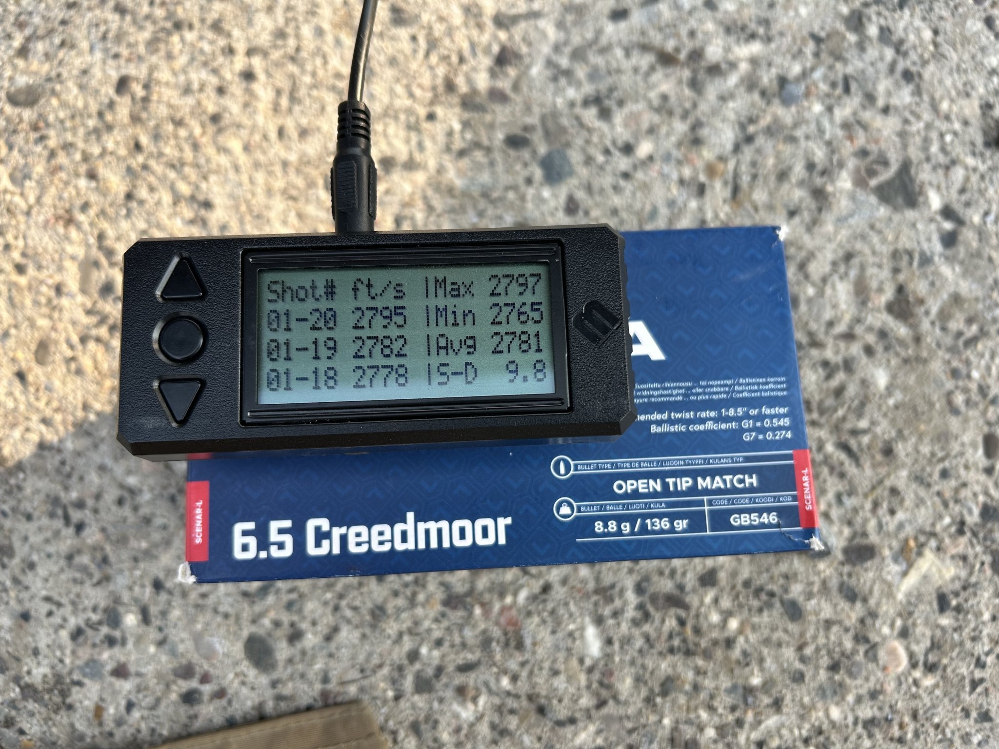

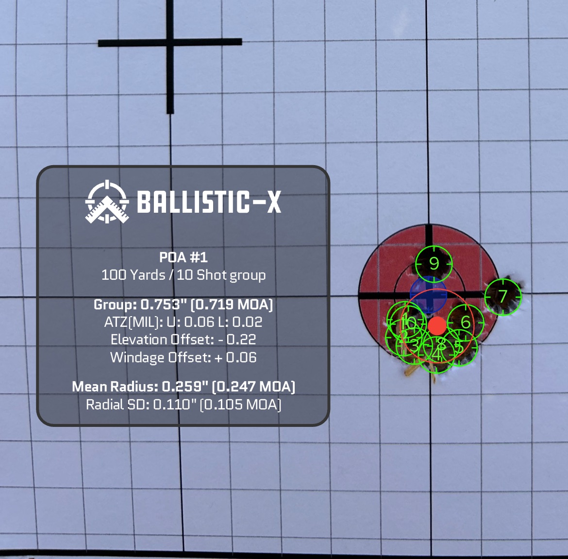

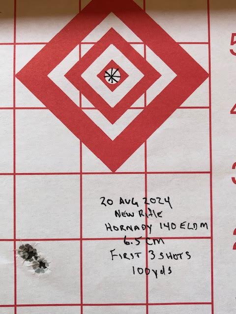

Picture is factory ammo, but honestly it shoots everything under 1 moa easy. It was a 3-4 moa gun prior to the smith work.

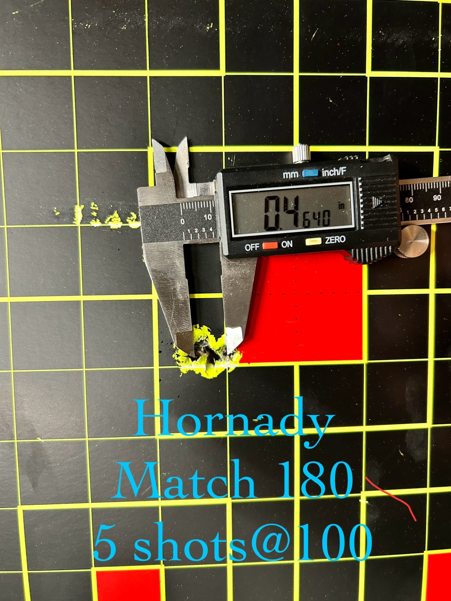

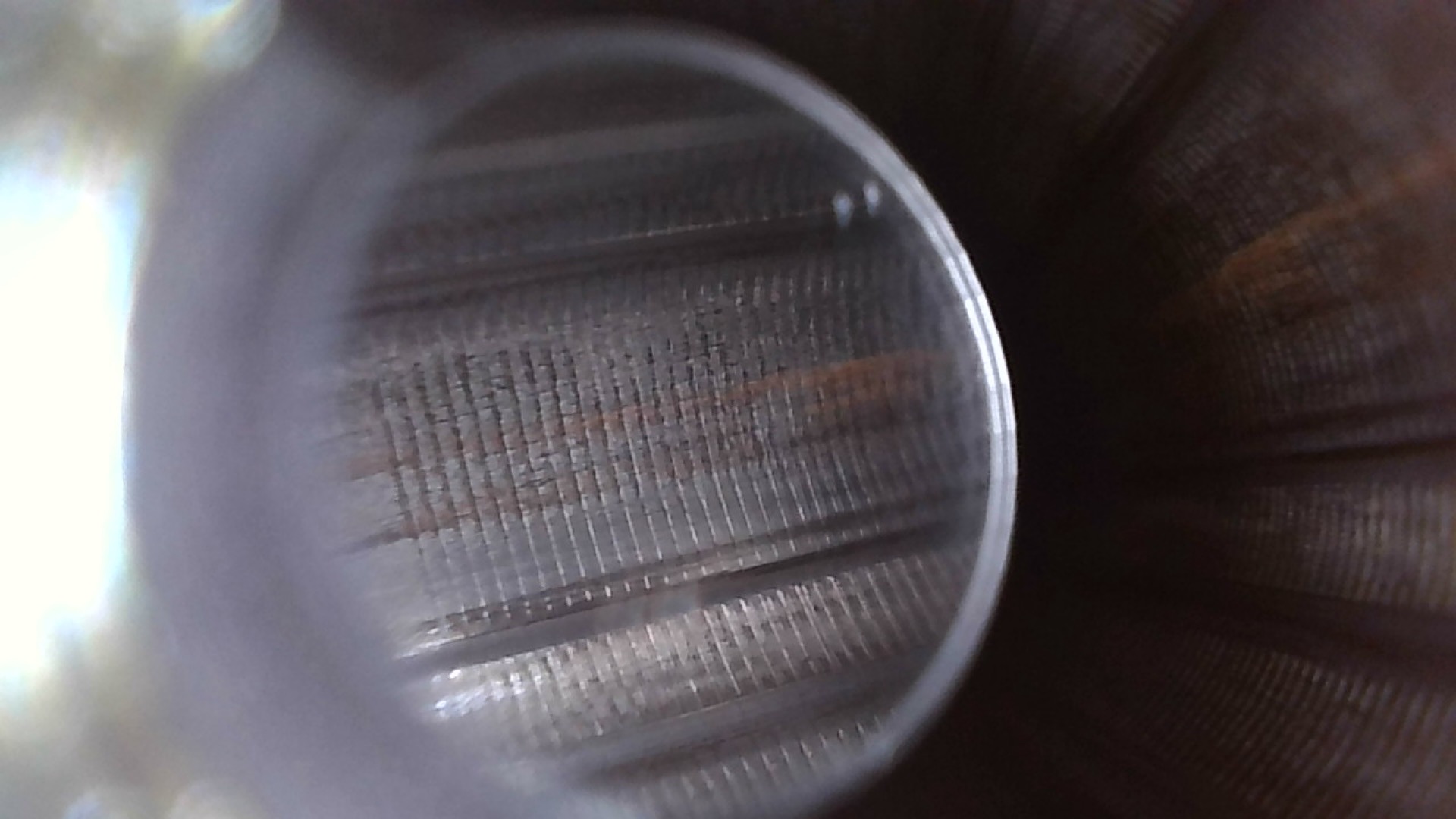

So i was able to borescope it tonight and it looks horrible . Really bad machine /chatter marks. Looks like barrel swap in order for sure , but why change the chassis?
Is the barrel steel or carbon fiber? It’s difficult to tell

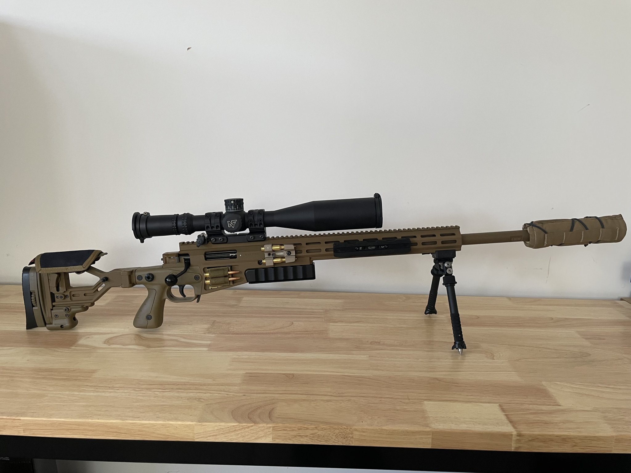

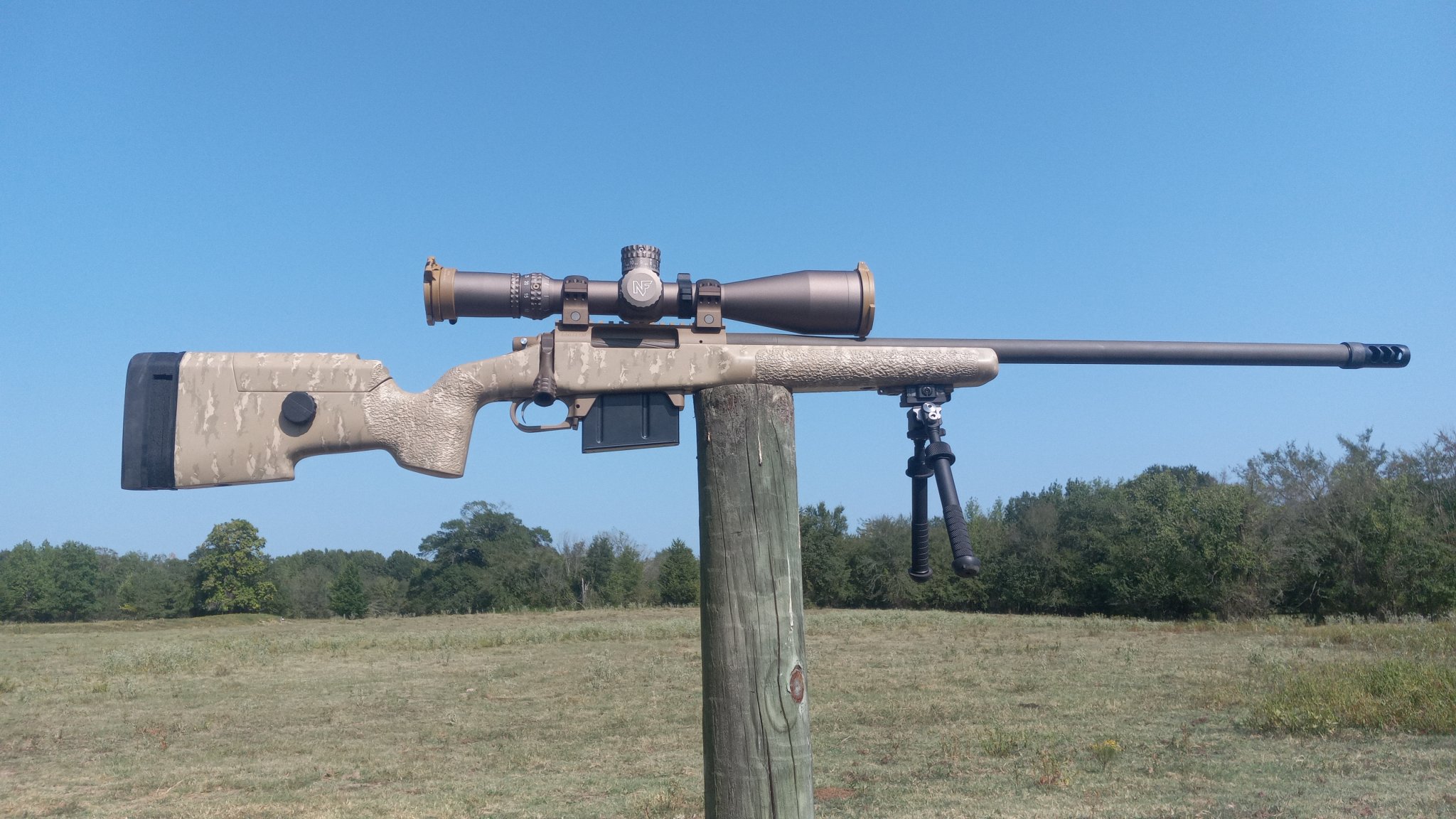

Remington 700 police in 300 win mag. 24" threaded barrel and leupold mark 4 hd 6-24.
Probably going to send it off to Badger to get bottom metal for aics and do a 300 prc conversion at local gunsmith. View attachment 8485850

So i was able to borescope it tonight and it looks horrible . Really bad machine /chatter marks. Looks like barrel swap in order for sure , but why change the chassis? View attachment 8485771
If you are on a budget keep the current stock and see how it shoots with a new barrel. My savage had a stock that flexed like Walmart Tupperware. If a stock flexes it could cause accuracy issues if it hits different parts of the rifle and barrel sporadically.

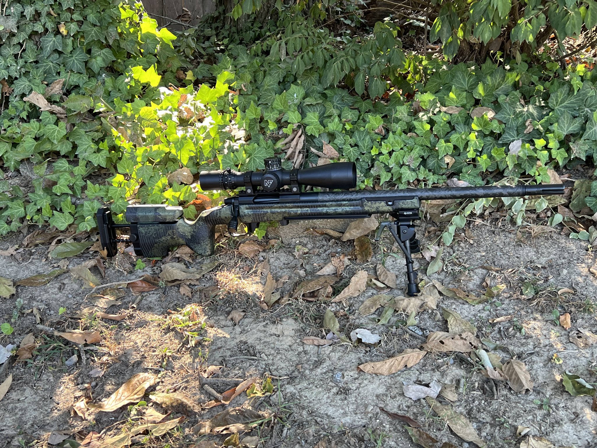

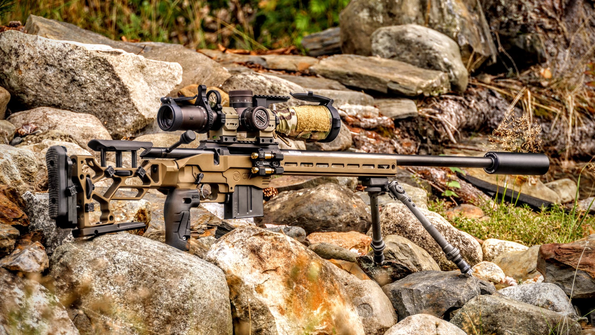

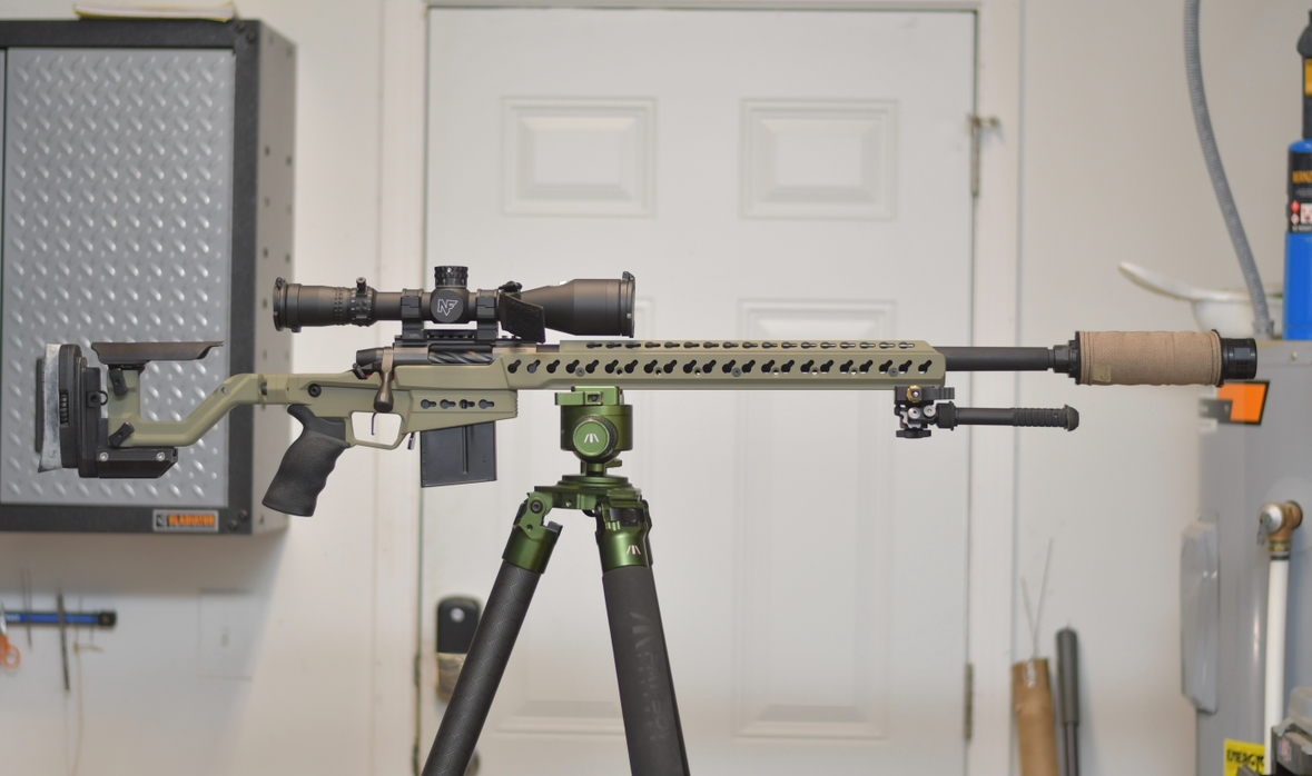

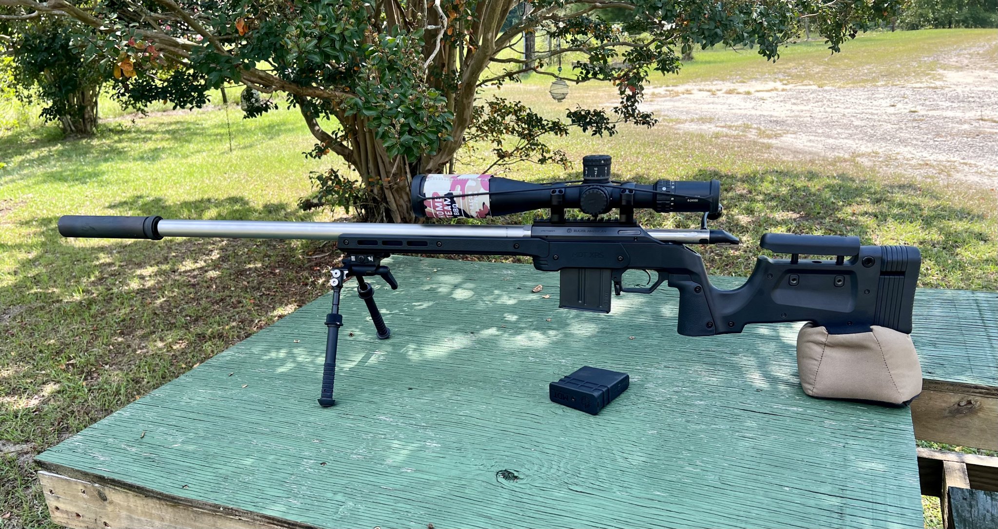

Put together a 6ARC build for fun with parts cannibalized from my 22LR and an extra Origin action I had laying around. Running a 20" 1:7.5 Benchmark spun up by Blue Mountain Precision. The brand new barrel is running 2671fps with factory Hornady 108gr eld match which was a pleasant surprise.
Man, I usually dislike all black rifles, but this is an exception! And Razor Gen2 master race! lol I really like my G2s. Not the absolute best scope ever but nice, love the 2c reticles I have, and big eyebox.
What’s that plate that’s right before the magwell? A weight?
Reactions: CollarChoke
Started life as a Ruger American Predator in .223 Remington. Only remaining thing that’s Ruger is the action.
-Ruger American action
-Preferred Barrel Blanks 1.125” diameter 26” barrel chambered in .223 Ackley Improved
-MDT XRS chassis
-MDT .223 metal magazine
-Timney trigger set to 1.5lbs
-Atlas Cal bipod
-Glades Armory bolt handle
-Arken Optics SH4 GenII 6-24x50 in Arken rings
-Silencerco ASR brake with SWR SPECWAR 556 can

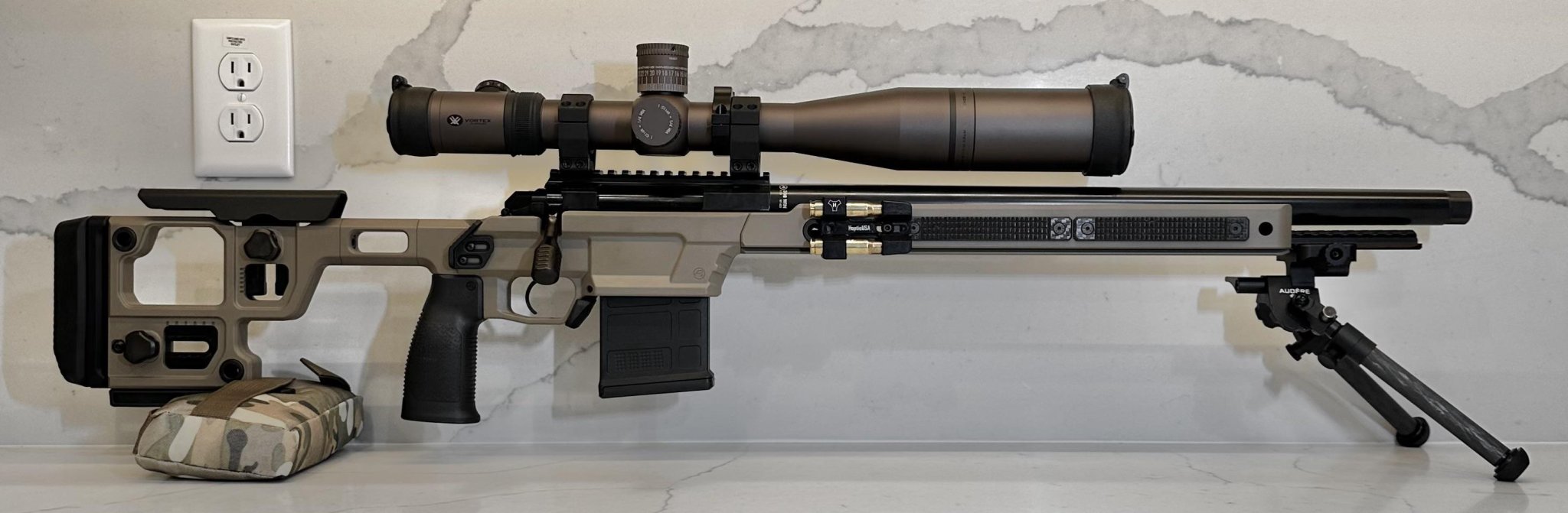

Here are my two centerfire rigs:
Top - Seekins Havak Hit
18" MTU 6.5 CM barrel cut (poorly) by Straight Jacket Armory - later fixed by local Scheels smith
Trimmed the nose off of the cheek rest so I can remove the bolt without folding
Crosstac MK109 brake
Arken EP5 (hate if ya want, it works with my eyes nicely)
Area419 bolt knob and extension
Harris knockoff bipod
Timney Hunter (stock)
Ergo Deluxe grip
Bottom - Custom Kelblys Atlas Tactical
27" Hawk Hill 1:7 heavy varmint chambered in 223 Wylde
KMW Sentinel stock (bought here on the Hide, great transaction - hit up Terry Cross to see about a pic rail and he had one in the mail that day)
Trigger Tech Special
Burris XTRII 5-25x50
Accutac SR5

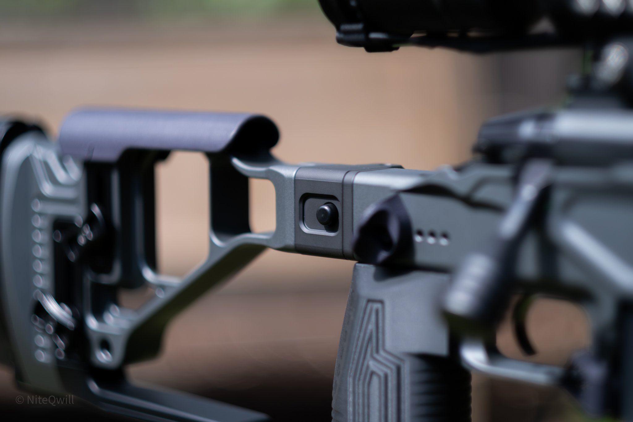

MDT HNT26 locking folder both directions (Do not like it locking in the closed)
7 SAUM
MDT muzzle brake
Kahles K318 scope
Just added an Old Balls buttstock since my kids also shoot this hunting but recoil is pretty mild.
