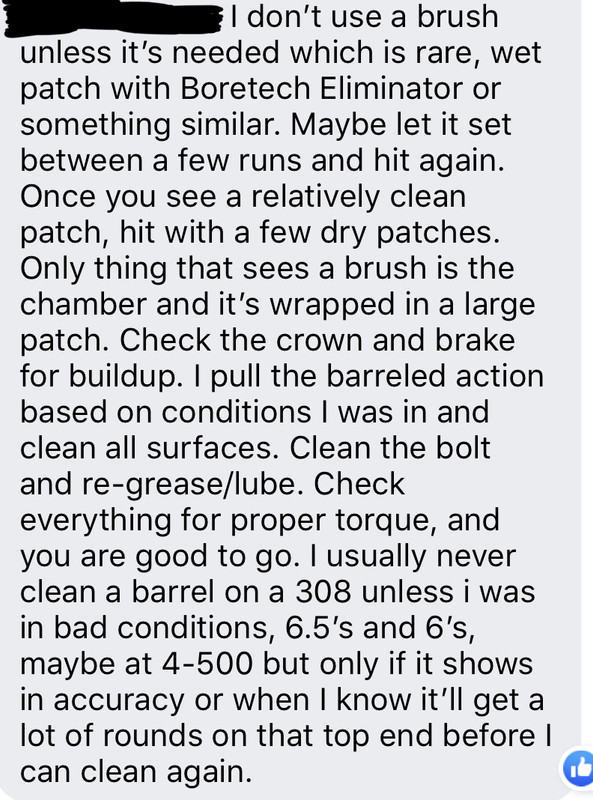

I more or less follow this

Everyone can do what they like but I'll follow what Jacob told me in person. Clean when accuracy falls off or after a couple thousand rounds.
I've got at least a 1k since last cleaning on the gun I used for a week at RO. In January, I canoed a doe head at 150 yards from an out-of-position rest. Not time just yet to clean...
You will not understand because you choose not to do so.
In the unlikely event someone reads this thread without their mind being closed on the subject:
DO NOT PUT DIRTY THINGS IN YOUR BARREL UNDER THE IMPRESSION YOU WILL END UP WITH A CLEAN BORE.
To do so in akin to wiping your ass with used toilet paper and hoping to to finish clean. You will finish with a mixture of different crap.
Proper cleaning is not push pull. Clean, unused patches are pushed from chamber to muzzle and removed from jag prior to pulling rod back.
