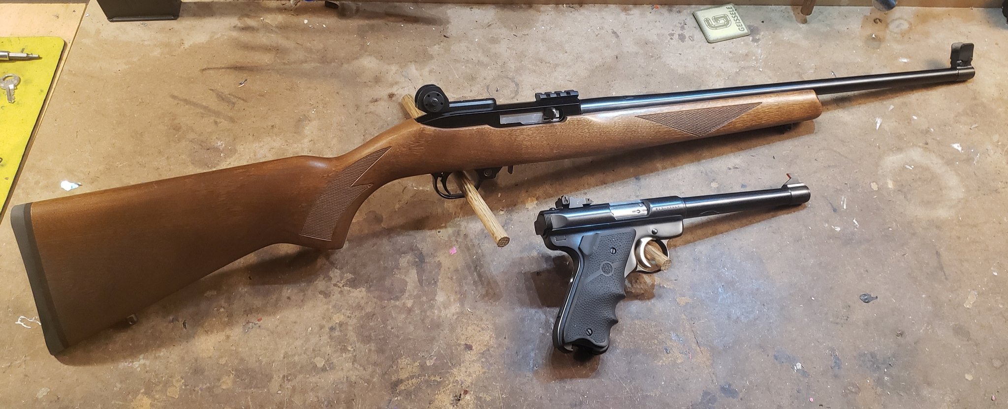

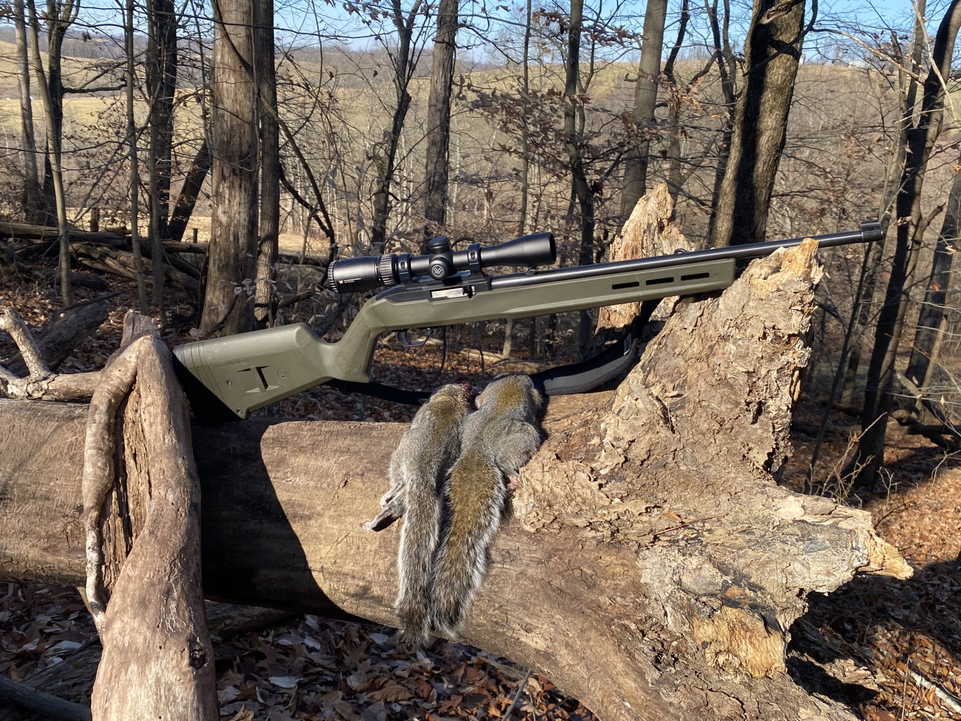

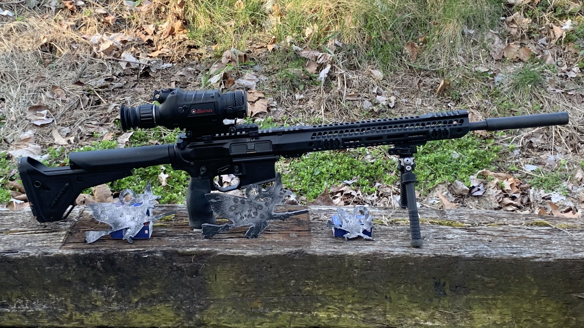

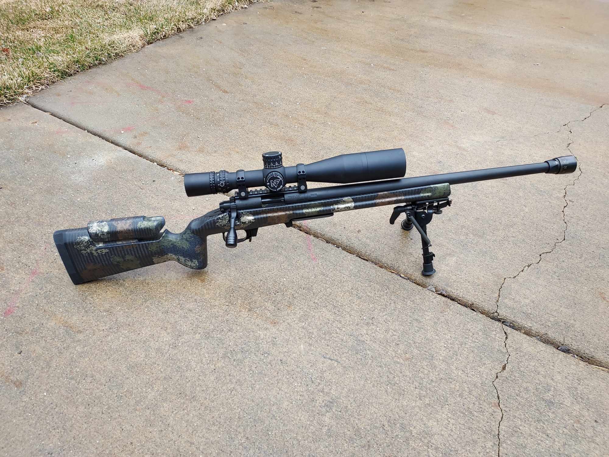

I updated the 10/22 above with a new stock, a good companion for my MK II Target.
Join contestI like the paint job.Sun is finally out in SoCal, took it out today for a spin.

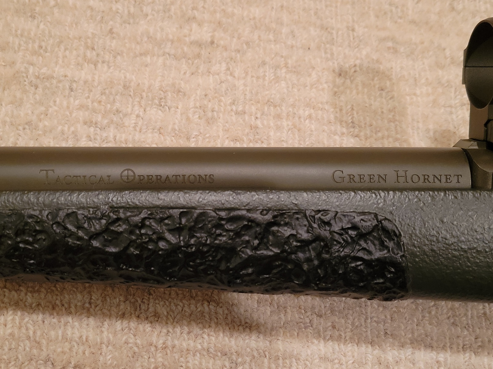

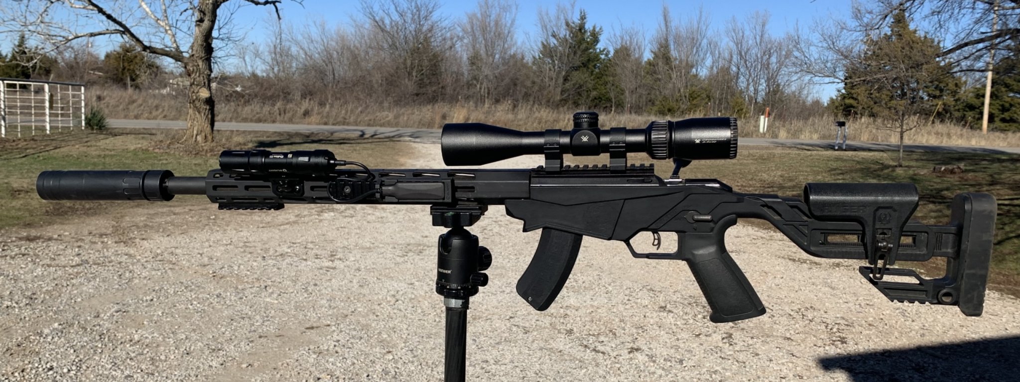

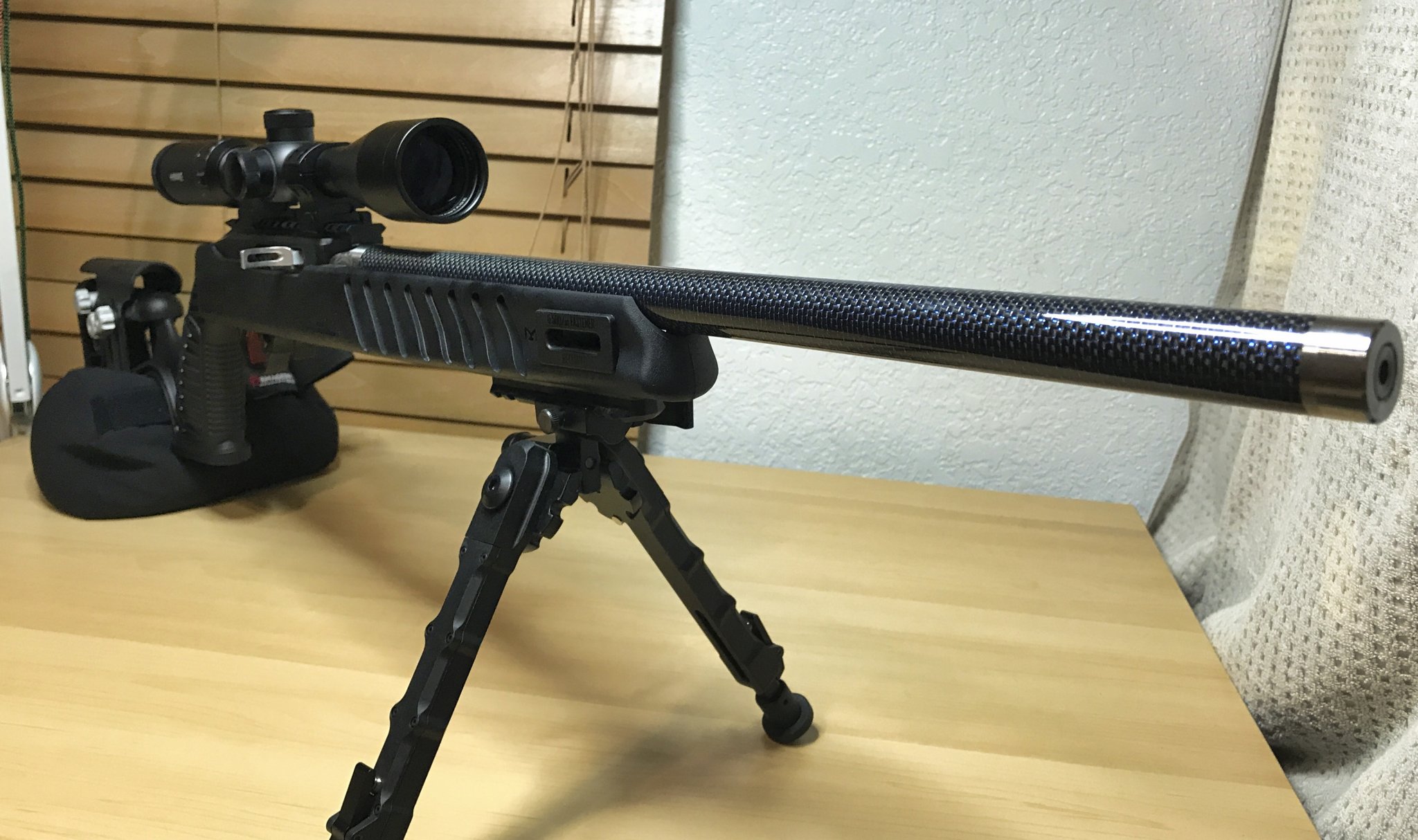

Did you recently get your Brimstone trigger or have you had it for a while? I’ve had one of mine in for a couple of months now.Put this together for one my grandsons. CST Centrix ELR receiver, KIDD bolt, TK skeletonized charging assy., Brimstone trigger, Summit Precision threaded 18" CF barrel, Luth AR MCA-22 stock and cheap bipod.View attachment 8332996

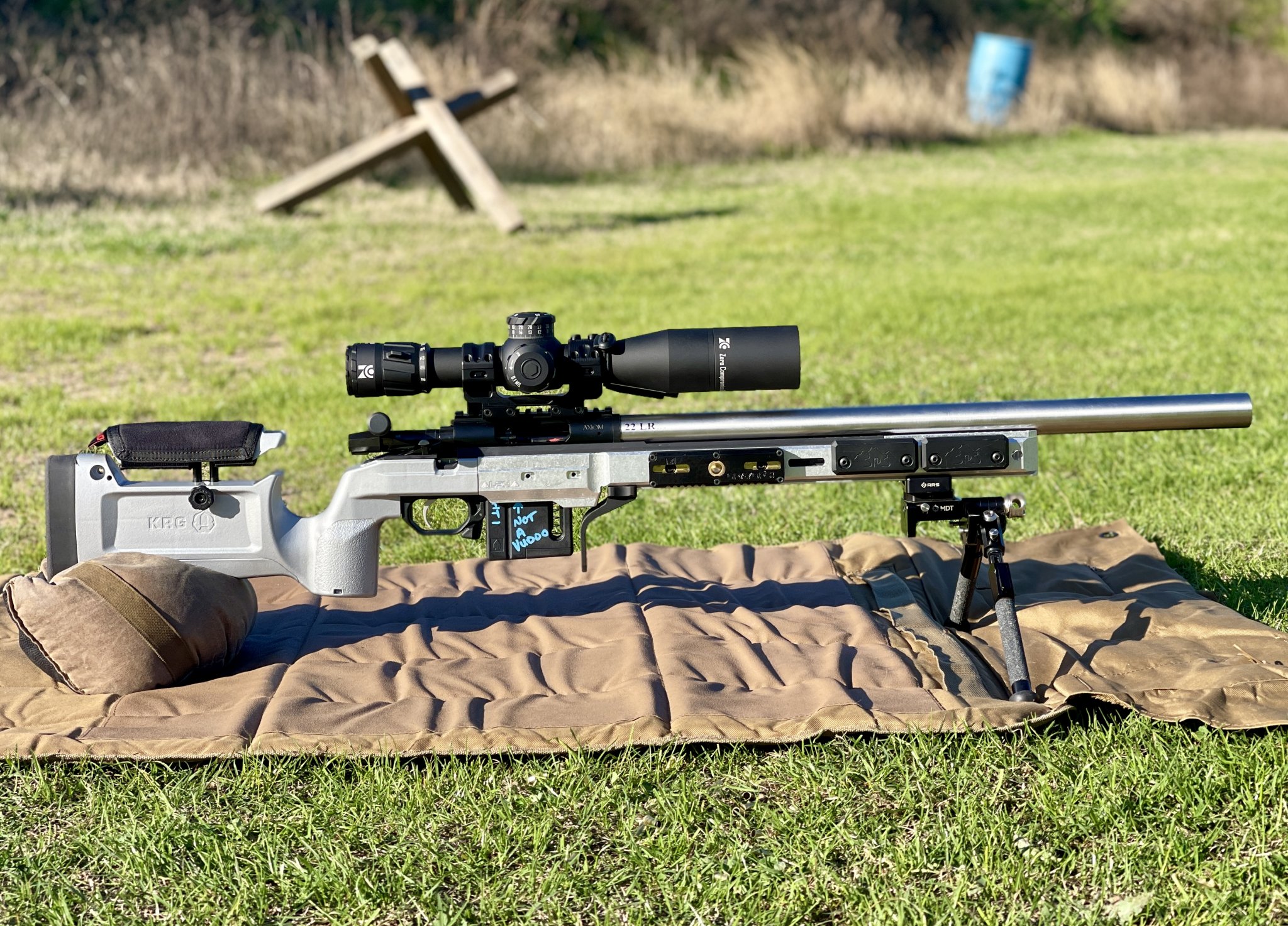

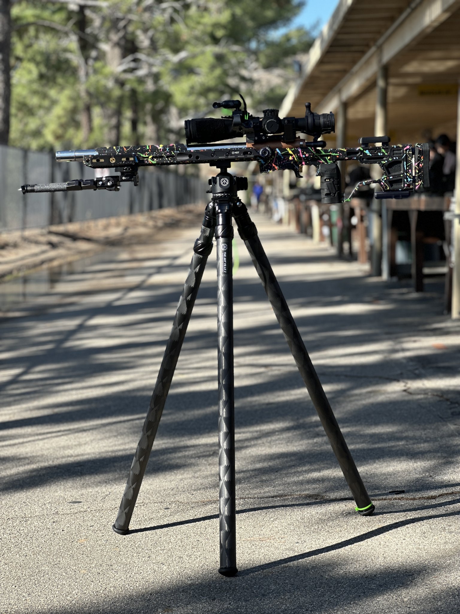

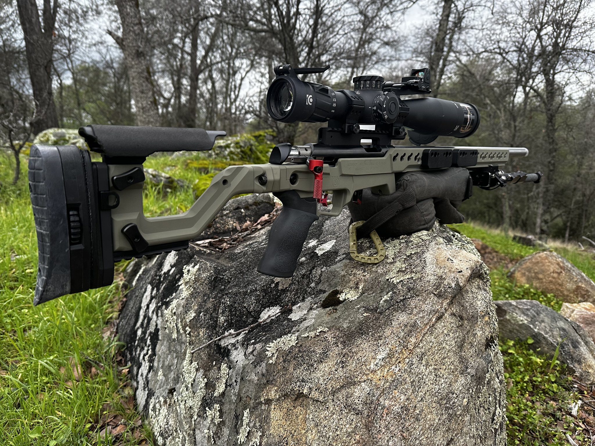

What is the butt stock restMy new 360 just in from the builder. Woox, Mullerworks, EC V2, Atlas, and B&A trigger.

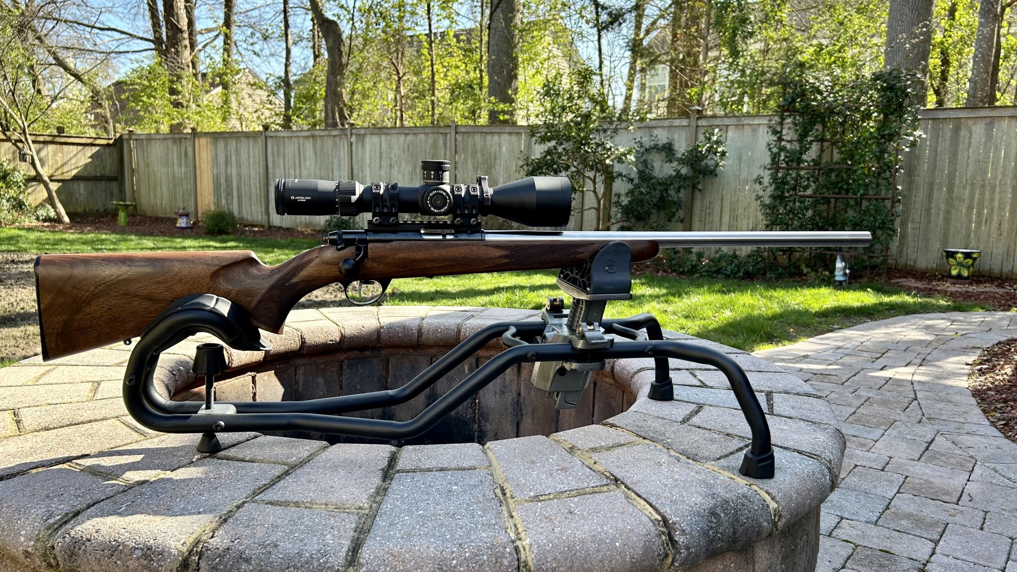

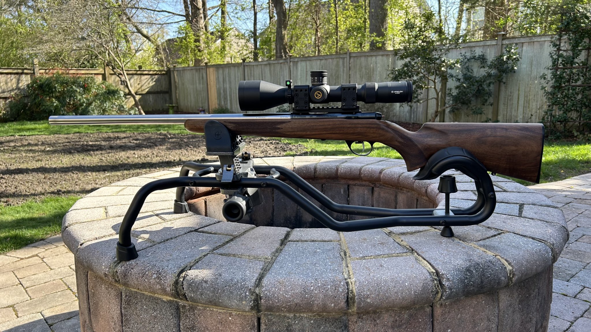

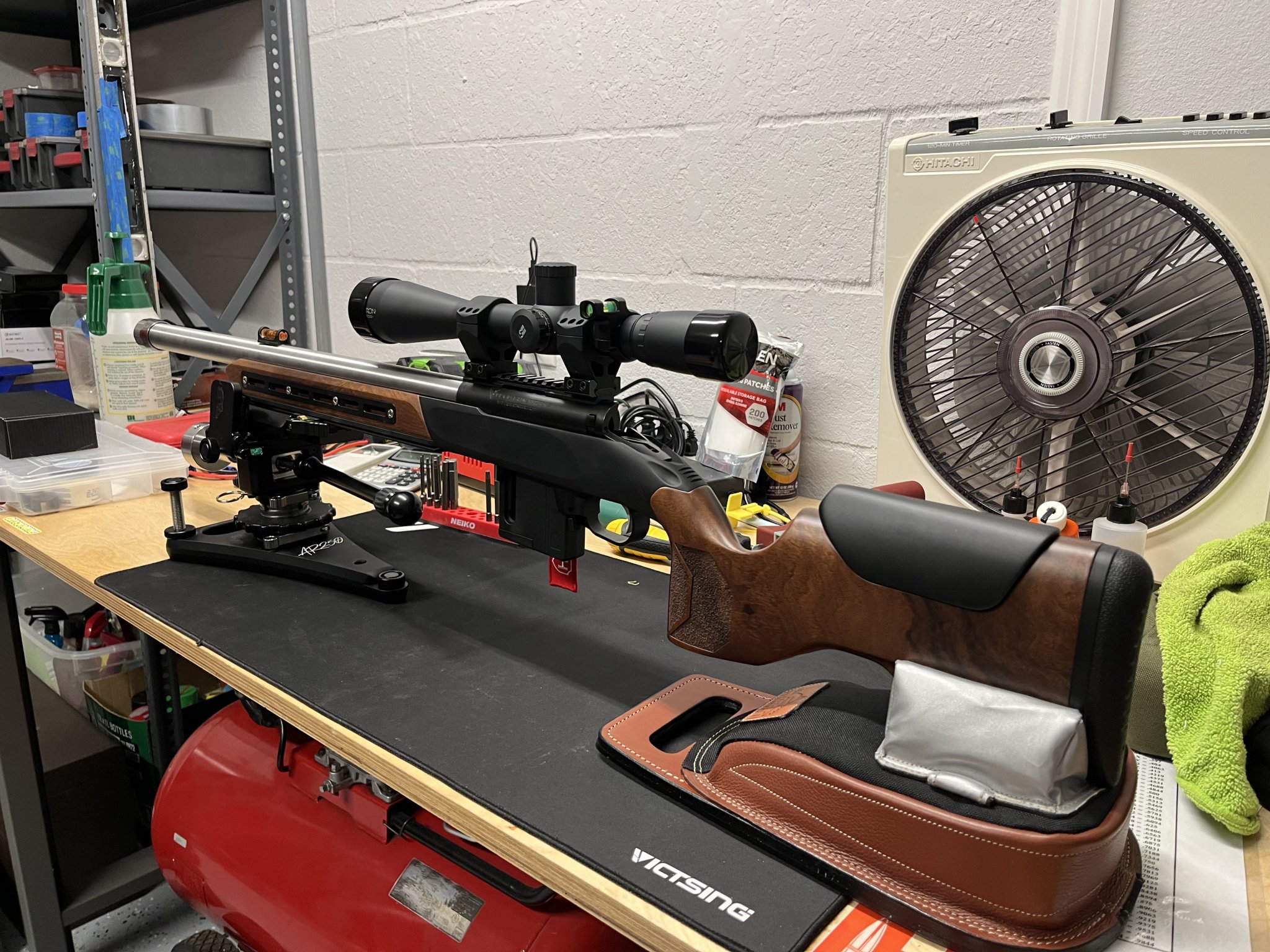

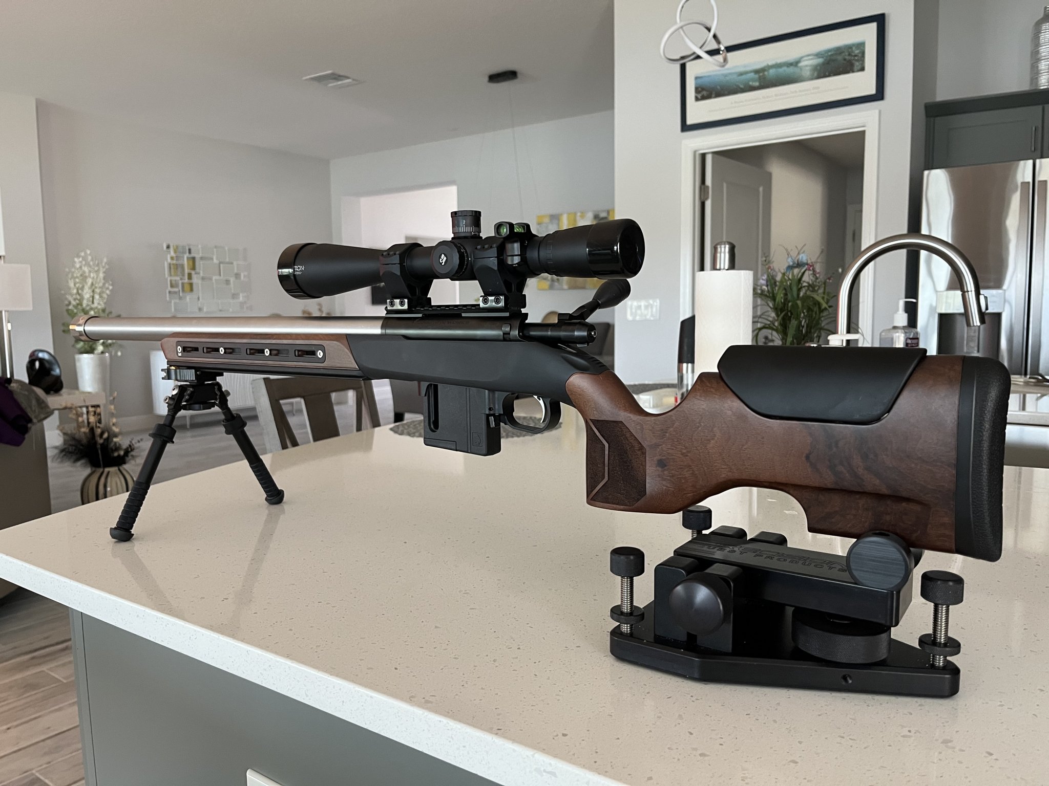

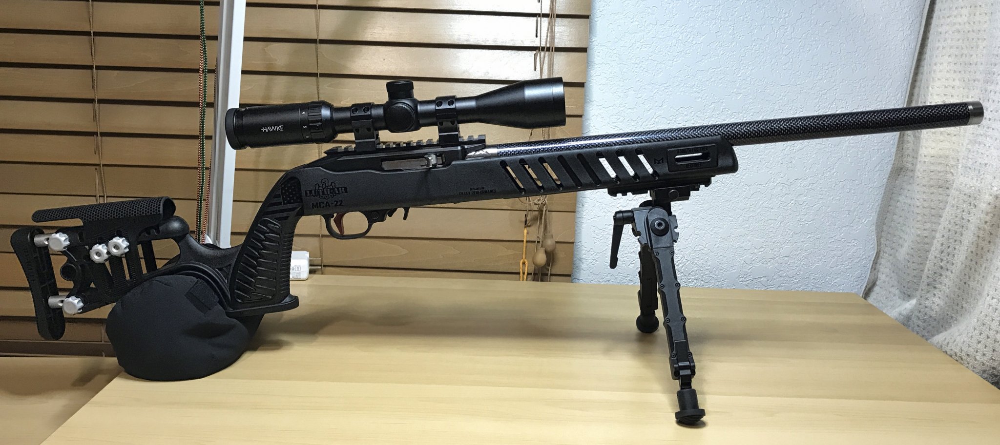

Does Curtis make the 22 conversion or is it something DI does? I have an older Curtis action sitting around and you’ve got me thinking.New barreled action from DI Precision. Curtis Axiom with the rimfire conversion kit. 1.25” straight Krieger at 23”. 21 pounds as pictured.
Curtis does for the Axiom, Valor, and Scout. DI cuts the tenon like a Vudoo instead of a cone breach.Does Curtis make the 22 conversion or is it something DI does? I have an older Curtis action sitting around and you’ve got me thinking.![]()

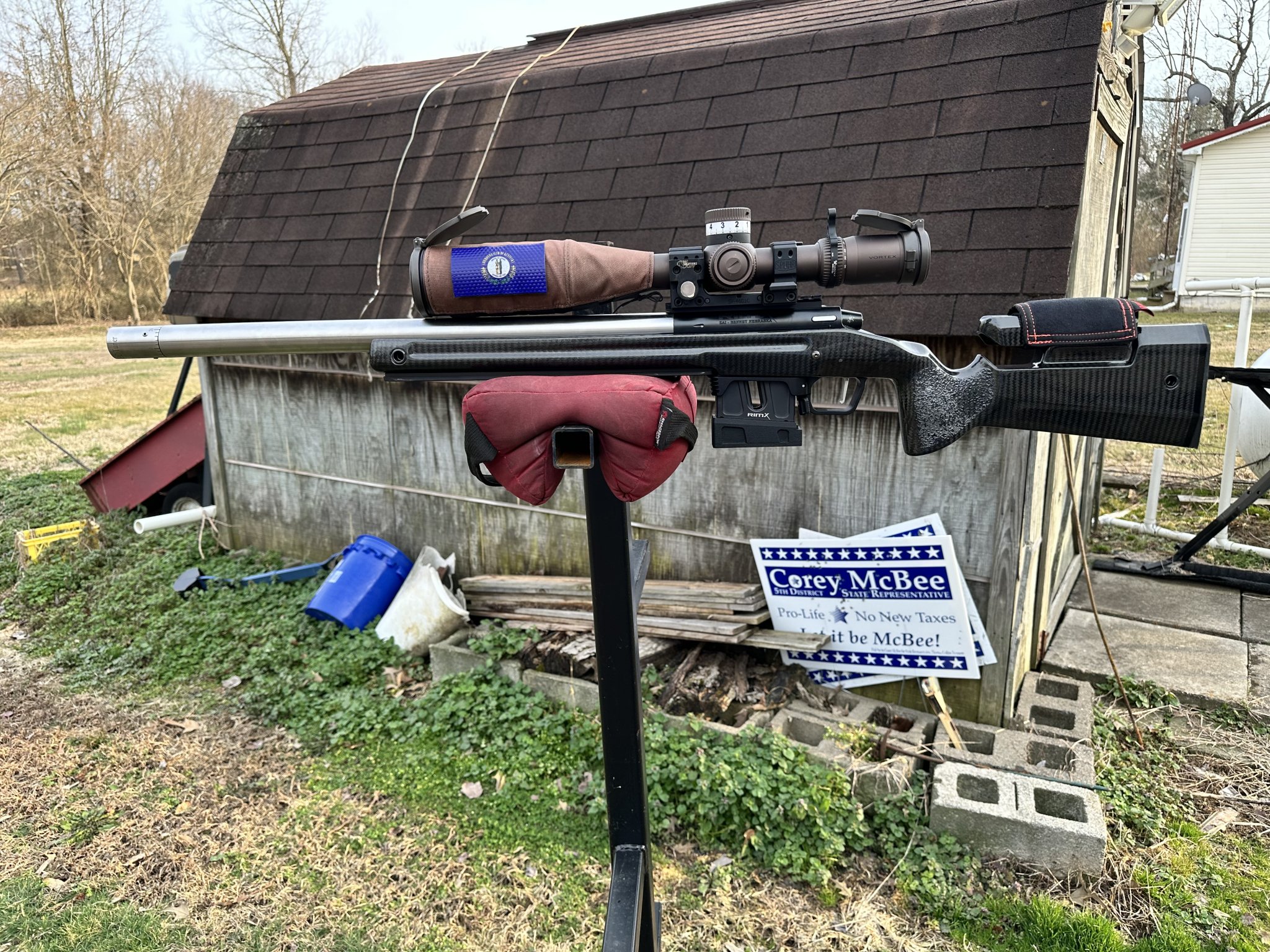

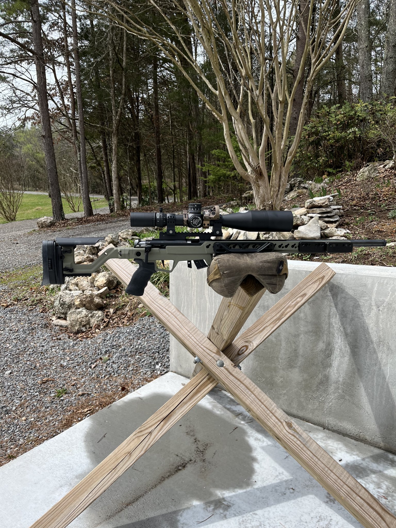

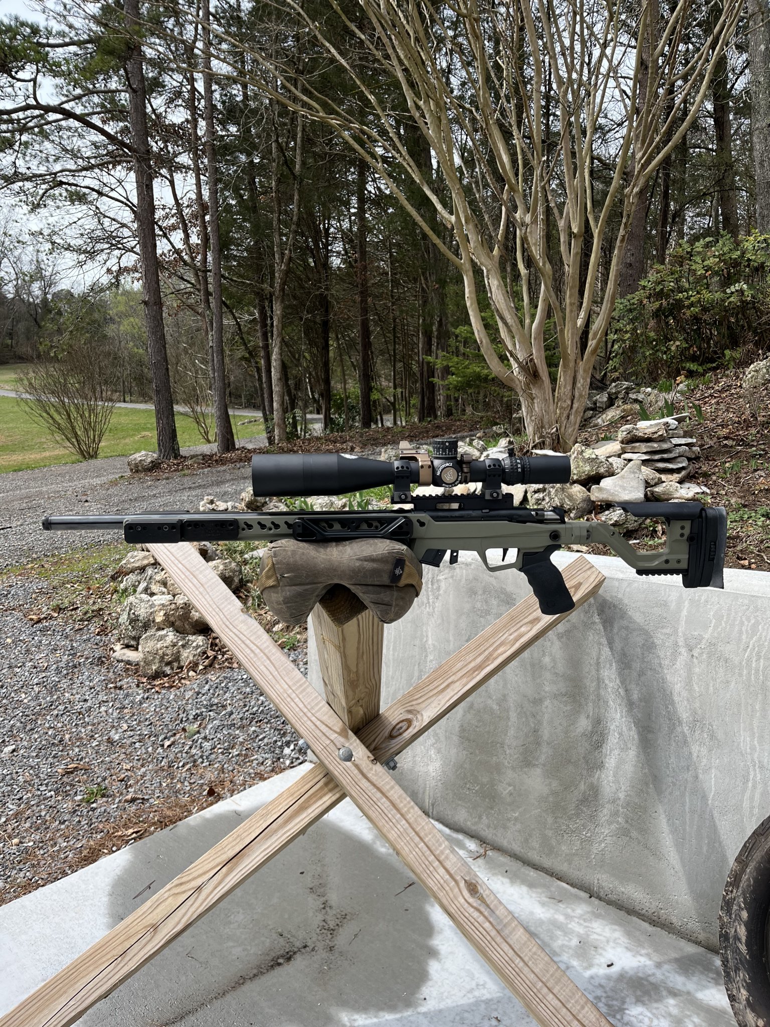

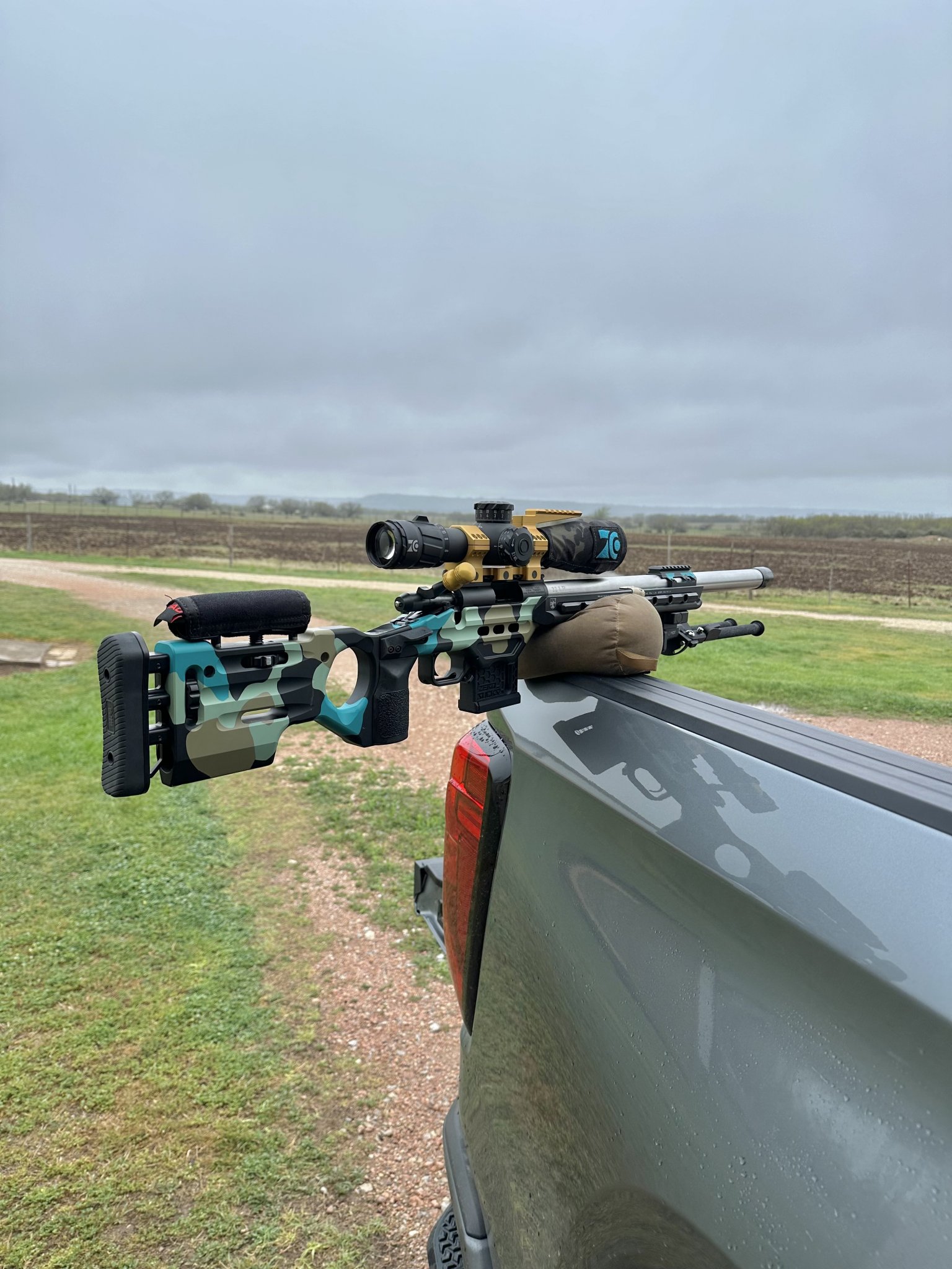

WOW,,,, I LIKE IT!!!After years of waiting for a chassis that will work with the Fortner, we are off to the races. Still waiting on bag rider and replacing the grip.

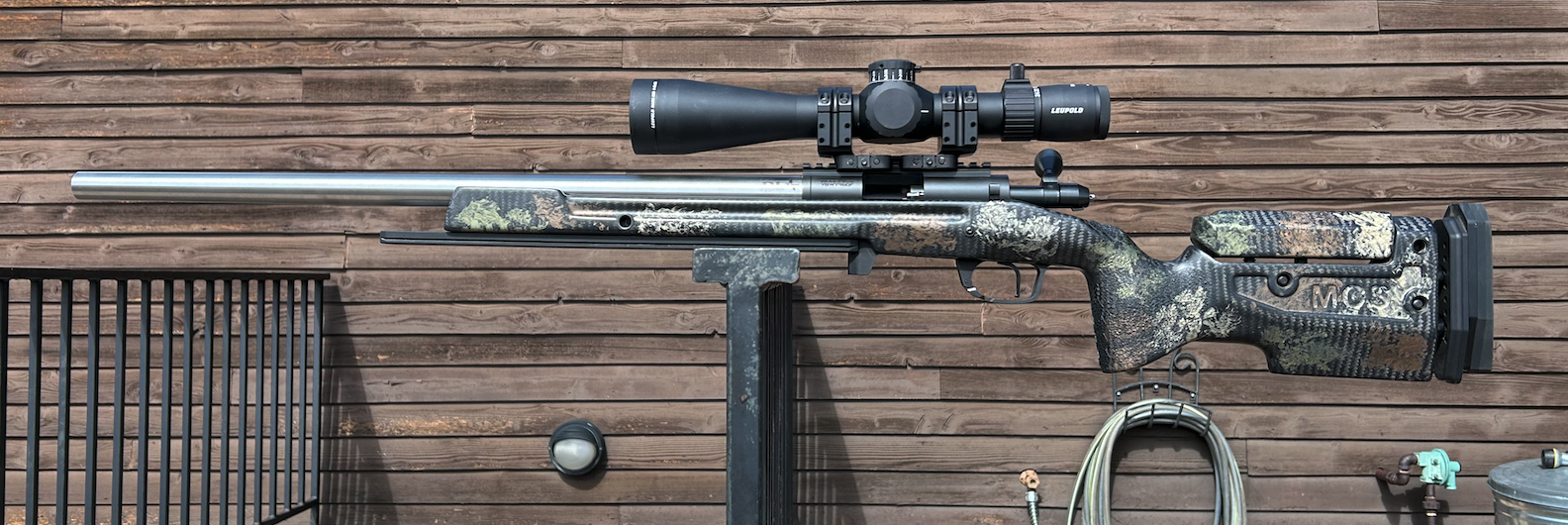

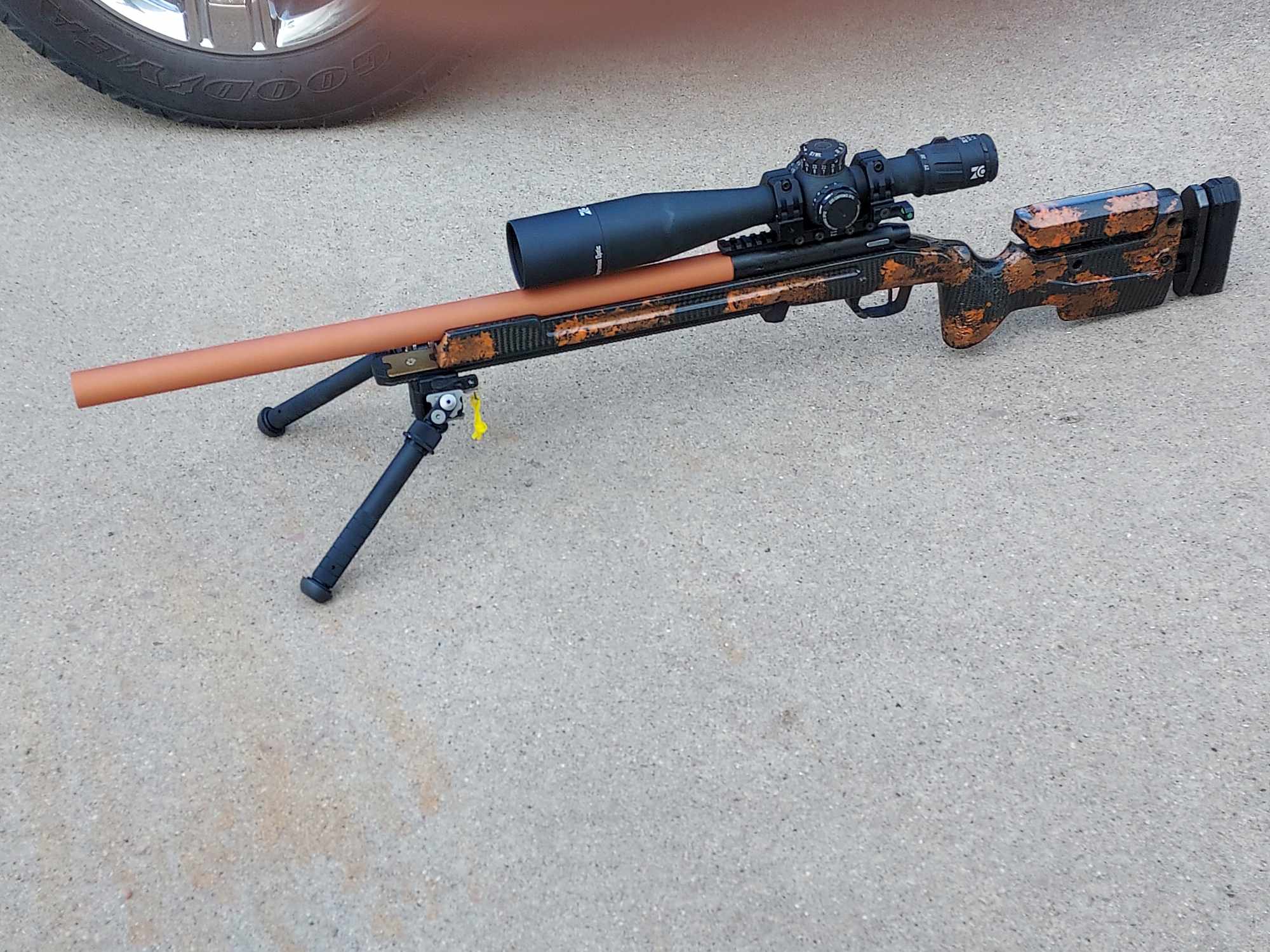

I tend to swap stock to see what happens. I really dig the Manners LRH with a 1.25 barrel channel.

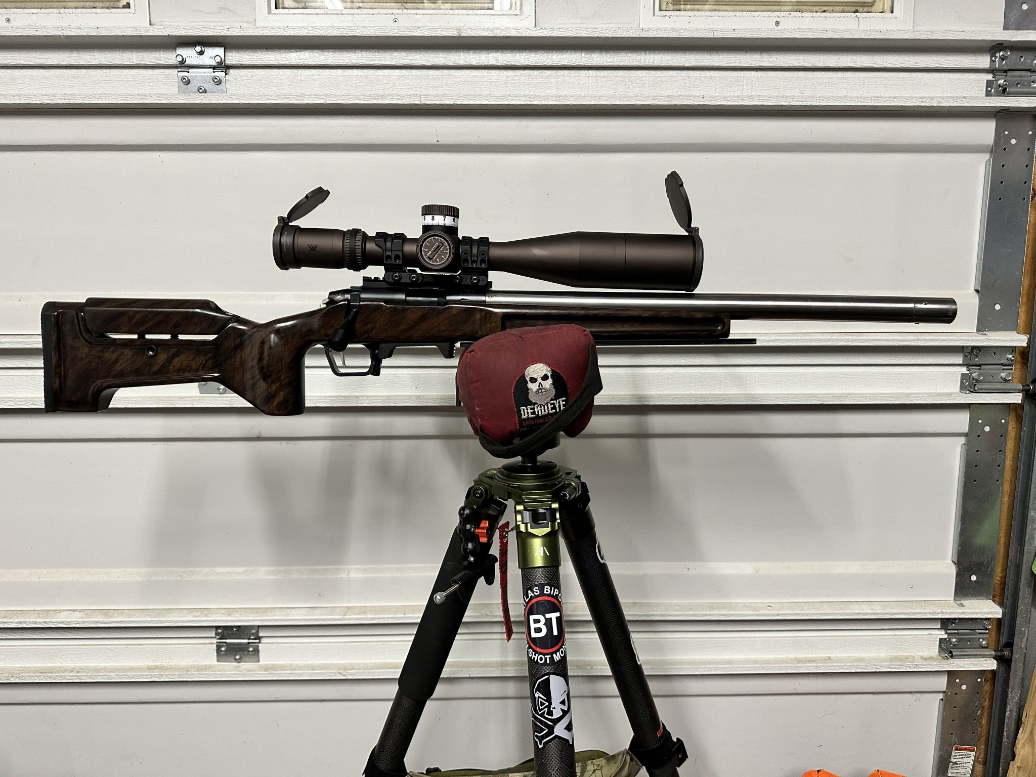

Same BA just swapped to the Foundation Revelation.

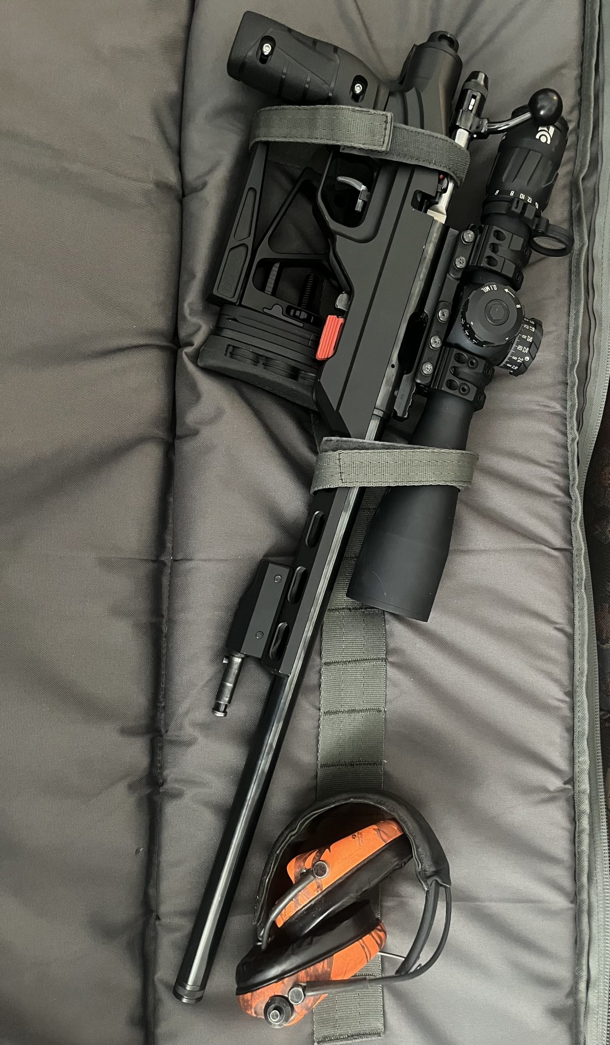

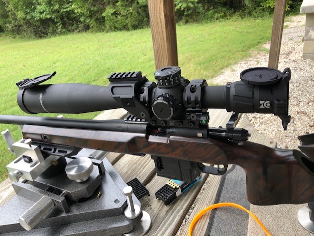

It is 50 MOA total. 30 on the scope rail and 20 in the SPUHR mount. I can dial past 400y with a 50y zero. I don't know what the max is out of it.Sweet set-up Defender32, can you tell me how much cant you have in your scope base as well as your rings? I'm guessing a total of 50MOA between the two???
Also with 50yd zero how much elevation can you get out of your turret before it's maxed out?
Thanks
Sweet, thanks! I'm getting ready to build pretty much the same set-up on the new Matrix Pro II chassis and figured 50 MOA total would work. With 50 MOA I'm pretty sure I'll be able to dial to 500-525 yds...It is 50 MOA total. 30 on the scope rail and 20 in the SPUHR mount. I can dial past 400y with a 50y zero. I don't know what the max is out of it.
Who is the chassis made by?After years of waiting for a chassis that will work with the Fortner, we are off to the races. Still waiting on bag rider and replacing the grip.
Vudoo 360/DI Precision chamberedSpecs on the build?
You mean V22S, correct. I don’t think they make a 360 RB/LP.View attachment 8375990
Vudoo 360 RB/LP
24" Kreiger MTU
Manners PRS-TCS
TT Special - 2 stage - Flat shoe
Leupold Mark IV 6-24x52
16.5 lbs w/o bipod and balances like dream
LOL…nope it’s a 360 action with right bolt and left port…they do make them and it is a repeater not a single shot.You mean V22S, correct. I don’t think they make a 360 RB/LP.
Are you left or right handed? Nice rifle!LOL…nope it’s a 360 action with right bolt and left port…they do make them and it is a repeater not a single shot.
Right handed but like being able to see the chamber area without breaking position and thank you!Are you left or right handed? Nice rifle!
I also have a 360. It’s a RH version. I probably would have bought the RB/LP but there was/is no mention of it on the website.LOL…nope it’s a 360 action with right bolt and left port…they do make them and it is a repeater not a single shot.
I had mine built by DI Precision as they offered many options that Vudoo did notI also have a 360. It’s a RH version. I probably would have bought the RB/LP but there was/is no mention of it on the website.
Are you saying they modified it, or? By the way, really like your rifle.I had mine built by DI Precision as they offered many options that Vudoo did not
No I am saying they offered it as an option along with a barrel longer than 22" and a faster twist rate....Vudoo did not offer these options. I run RB/LP on my f-class rifles so it felt comfortable and being able to see the chamber area was a bonus....I really like it too!Are you saying the modified it, or? By the way, really like your rifle.
