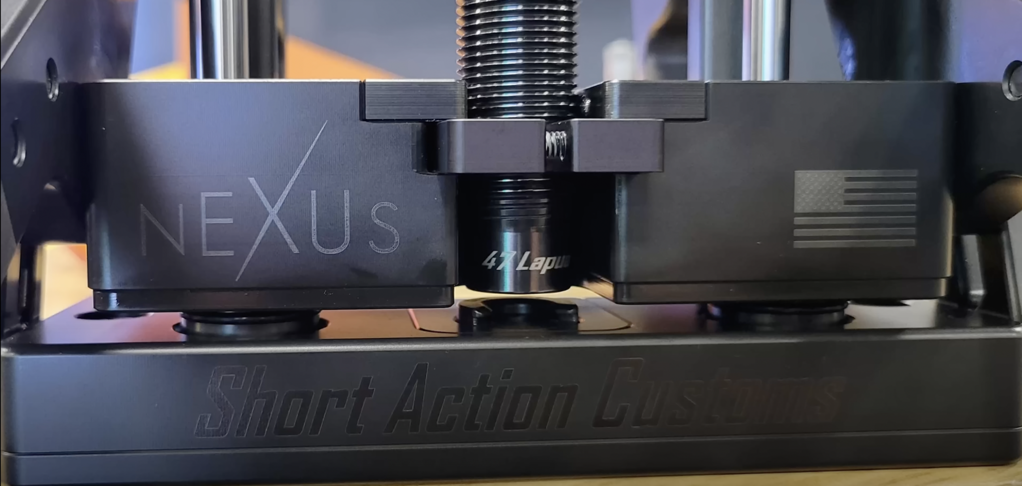

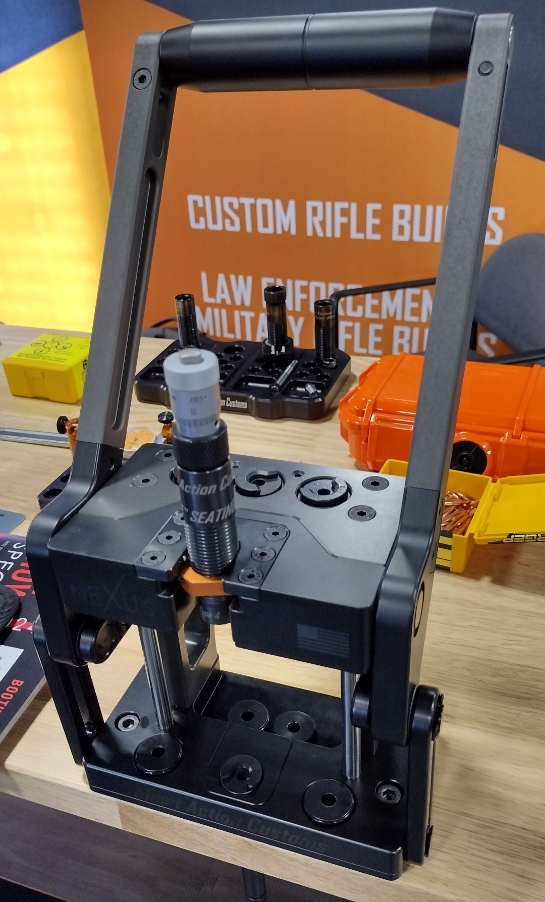

It takes up a lot less bench space than it seems in photos. It's a work of art, and solid as a rock.
Agree but I do like the idea of having the area of the press that holds shell holder being firmly on the bench instead of hanging off like most presses. A buddy got on the pre-order, but as much as I want to I don't know if the features are enough for me to dump my coax. Never say never though I suppose.
It is a very well thought out machine and that in of itself is sometimes motivation enough to buy one, personally speaking.
The only concern I had/have is not being able to size all the way down to the .200 line on the brass, if the die isn't allowed to touch the shell holder.
But, I believe they said their shell holders are .010 lower on the case than industry standard shell holders. So that should alleviate that concern.

I was at SAC about a week before SHOT picking up a barreled action they had finished for me. Sitting on the same table was one of the new presses. Of course it caught my eye and I was all over it. ;) Anyway, Alan gave me lots of info and answered my questions which I had a bunch of. ( I've been reloading for 45 years) It is very solid and well thought out. I believe Inline fabrication is making mounts for it.
Yes, there is a hole for primers to come out, so you'll need a mount or drill a hole under it. The different height shell holders eliminate the shaving of dies. Trying to talk myself into buying one.
In the 'bolt action reloading' video I'm pretty sure he mentions screwing the die down to touch the shell holder when sizing.
One of the biggest designs of the press is that you specifically don't touch the shell holder. It has hard stops to prevent this. As well as shell holders that are cut shorter. So you likely won't be able to touch holder if you wanted to and still get correct shoulder set back (unless using a micrometer type).
The pressure he mentions when sizing is from brass inside the die.
Maybe I miss understood what he meant by, "the shell holder and the die are not under any pressure, unless you're sizing brass" that's at 0:40. I'm not sure what else he could have meant though.
Means the friction inside the die with brass in it. Which in turn pushes the die and lock ring up until the ring hits the flat above it.
If there was pressure from the die touching the shell holder, it wouldn't matter if you were sizing brass. You'd have pressure regardless.
You get an extra 10 thousand of sizing on brass with his shell holders. So I don't think there is any concern of not sizing at the .200 line. Like others have said there hopefully won't be any more die cutting or shell holder shaving to achieve more sizing. I've ran into that a lot in my life it sucks so this would be a huge bonus just not to deal with that.
One of the videos not sure where he has a full length die and has rod all the way down and he was able to pull the die out because there is no more die shell holder contact. That is one of the bigger selling points you get perfect camover from press not die and shell holder.

Initially I had issues getting consistent shoulder bumps with my zero press. I set up my dies the way people typically do, run the ram up and screw the die down until it touches the shell holder then go a little past that. During sizing, I noticed the die was no longer contacting the shell holder at the top of the stroke, there was a visible gap. I kept playing with the die until I got consistent contact with the shell holder WHILE sizing, and my shoulder bump issues went away. I’m willing to bet a lot of people aren’t actually getting shell holder contact while sizing. I’ve found that relying on the mechanical stop of the press typically leads to variation in sizing.
In order control the amount of sizing and maintain consistency, people typically use shell holder kits (Redding, Area 419). If you buy these kits for all the shell holders that come with the SAC press, you’re looking at $200+, so that is one justification for the press if it works as advertised. Like others have mentioned, I think SAC really dropped the ball by not making this press work with arbor dies. With their release of the infinity die, it would have made sense, plus it would give people another justification to buy the press if they could sell their arbor press and consolidate some equipment. I still think this press could be used with arbor dies with some pretty simple accessories.
All that said, I like the SAC press concept and will be getting one. Can you get the same results with a Rock Chucker, a standard die, and some shell holder kits? Yes, but I’m so far down this rabbit hole I don’t really care at this point.
This video illustrates it better. You'll see that he removes the die from the press when it's locked down.
