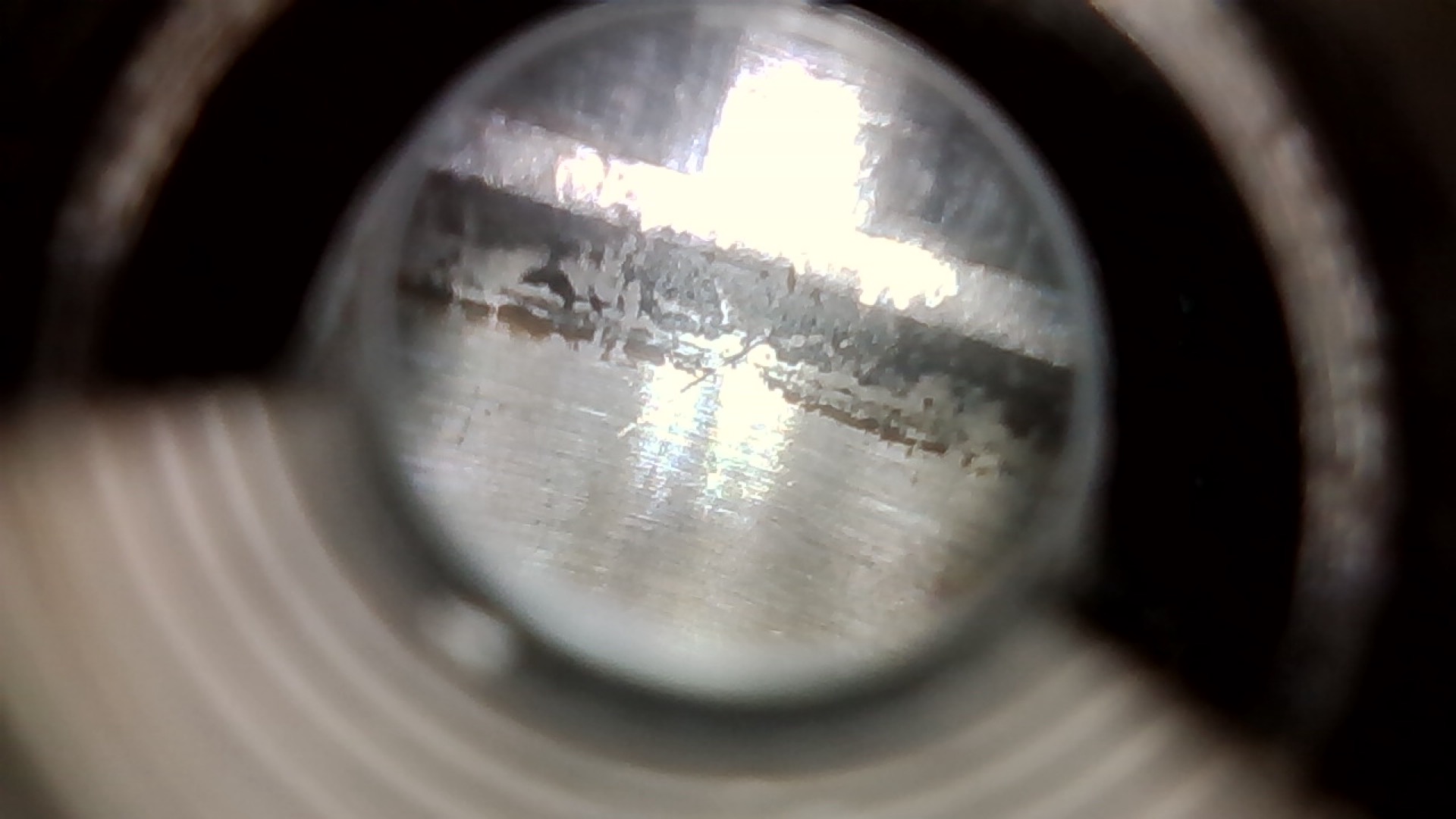

Hello everybody just want peoples opinion on my issue. So was cleaning my tikka after shooting 40 rounds for the first time. I used wipe out and soaked and also g96 and also clp 2000 foam. Many many patches and also bronze bore brush with bronze core. It made the whole barrel spotless and immaculate. However i noticed there is a circle of crud where bullets comes out the neck of case the carbon ring I believe see pic. I tried scrubbing so much other than spinning the brush on a drill which I do for my cheap rimfire. What chemicals are there that is strong enough to remove this ring.
You need to soak a patch in C4 carbon remover and let it sit on that carbon area for an hour or so. Pull the patch spin a stiff nylon brush with C4 on it in the carbon area and repeat if needed.

Sorry bad spelling this is what I used works well but want something better. Someone told me and I’ve bought jb bore paste in blue and red and kroil. But I have no clue how to use it. Is the kroil used after the jb blue or red?

Ok will take ur advice and put away the teslong seem to go crazy when you see stuff left. I guess just like reloading I over do and think things. Good advice it will probably save me money also in long run.

Did you look through the bore with a bore scope? I have used just about most of the stuff mentioned in this thread. I could get the barrels clean, but to get it looking "new" clean with no carbon in the lands. I have never been able to do.... nor will I waste an hour to keep on scrubbing.

Yes I used a borescope before and after. I was skeptical when a fellow shooter told me about it and how easy it was but he’s a good friend so I decided to give it a try. Glad I did
