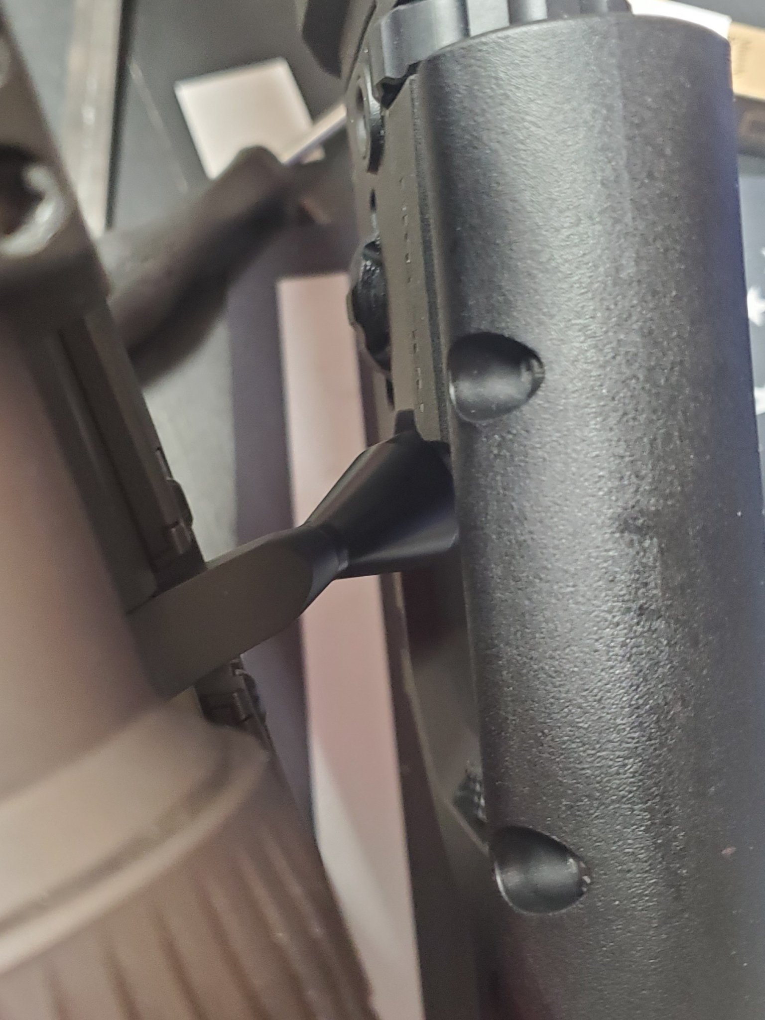

Has anyone replaced their bolt knob with either the round or hour glass knob? Turns out that the magpul pro 700 chassis won't fold over the original bolt. Was hoping that one of the two may allow it. Looking for dimensions. I like the action too much to use a different action, and I like the chassis too much to use a different stock/chassis.
I have the round and the one you have, I do no think that it would work any better. It is just as long. Are you looking to transport when folded? could just take the bolt out? I am not sure any other action would be any better, but I am not familiar with the chassis you have. I can tae a picture of them next to each other when I get home.
Some of the issue is that the Zeus bolt is straight rather than swept. I threw a Defiance action in and it fits as it should. I bought the chassis because it does a bolt side folding. If either of the alternatives to the factory bolt were slightly narrower it may work. I originally was looking at the ball knob anyway to mimic the AI bolt knobs (sort of). I'm looking for a measurement on the ball one from the seam (were it meets the bolt lever/arm) to the bottom of the ball and the max width. Same for the hour glass one. TY I appreciate it!!

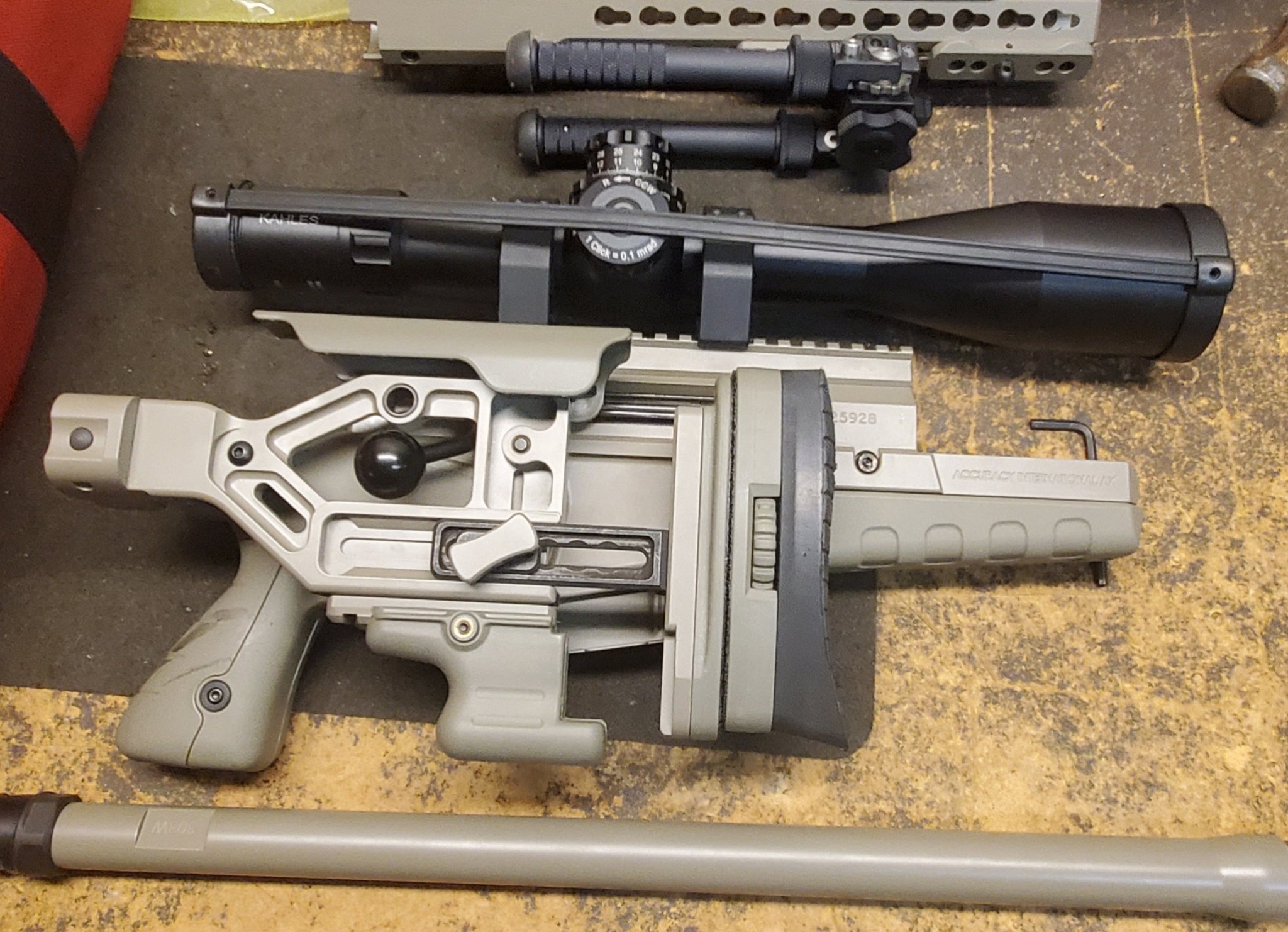

My Terminus Zeus is on its way here. Have a 6 Dasher barrel and it will go in a KMW Sentinel.
TT Diamond to make it go boom.
As for folding chassis, I know there are some lefties in this world (my goofy wife) but why would anyone design a folder without hinging it the opposite direction of the bolt?
Not sure what you mean? Are you saying folders should fold away from the bolt or only the bolt. Benefit of folding over the bolt is the over all width is reduced and the bolt is secured. The magpul chassis actually can be swapped to hinge either way and set up for right or left use.
All AI folders that I have, rifles and chassis, fold left and IMO folded is folded. Maybe some later models of AI do fold over the bolt handle but I like the old AW. You're increasing width when folded no matter which way it goes.
I see no advantage to folding over the bolt in my case.
Yes folding increases width no matter what, but folding over the bolt negates the extra width of the bolt if folded to the opposite. Its all preference. AI AX fold over the bolt as seen her on my ax...
