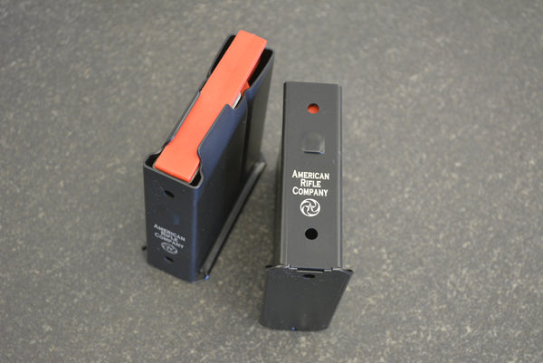

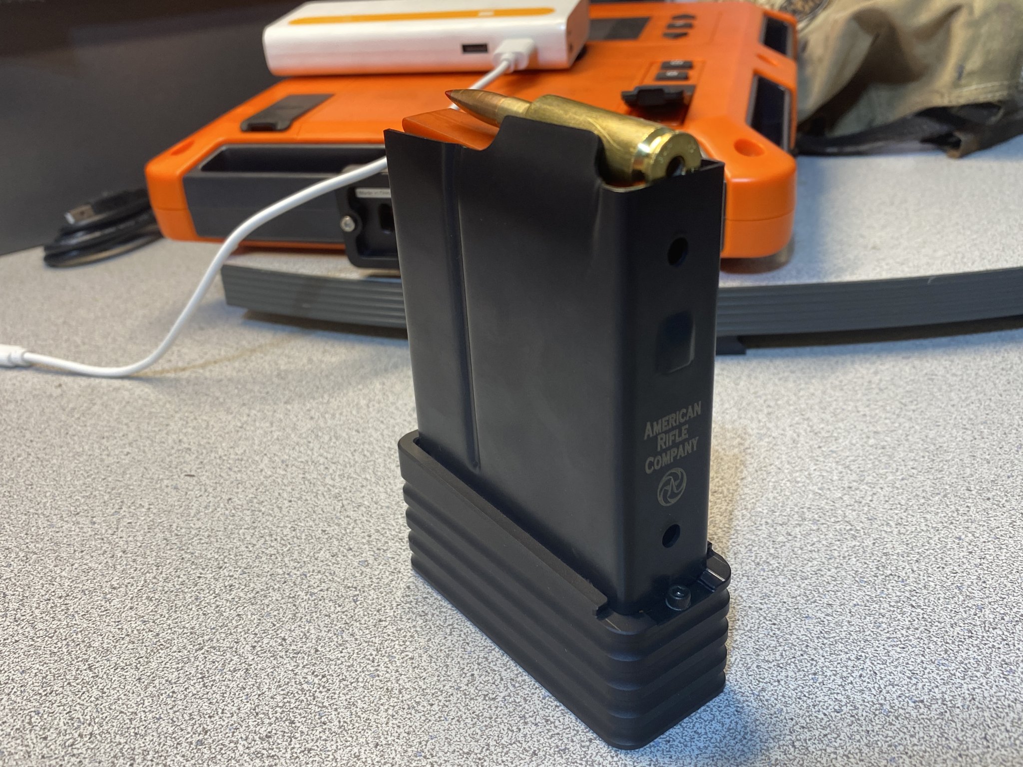

I need to give some of these mags a try... where would I buy that combo set or is this a buy a mag buy the follower and assemble myself?
I have mine running AW mags really smoothly with 308. Not a single problem in over 200 rounds.
I can't get the AW mags to work with 6GT yet though.
Reactions: Dooby
You can get them from Long Rifles Inc.
Scroll to the bottom of that page and you'll see the follower for them. Joel said they'll come assembled with the follower if ordered together.
Ordered mine on Fri. Gonna be selling my AW mags on the exchange here later today as matter of fact.
Thanks for the info. I will look into the followers if I have issues with the Zeus and the 6GT. Any idea if feeding is an issue with the extensions?
Reactions: Kanati
So the Vector has trouble with AICS mags and the Zeus has trouble with AW mags? Or just with 6GT+AW mag combo?
The Zeus will work optimally with AICS style mags. I'm sure there are people on this thread that have no issues with their AWs feeding because they have the right combination of bottom metal or chassis, but that unfortunately is not my case.
Joel is a big advocate of the ARC mags I mentioned above so I'm going to try them.
I need to figure out how to tune the mag lips to get the 6GT + AW to work, I haven't given up yet.
