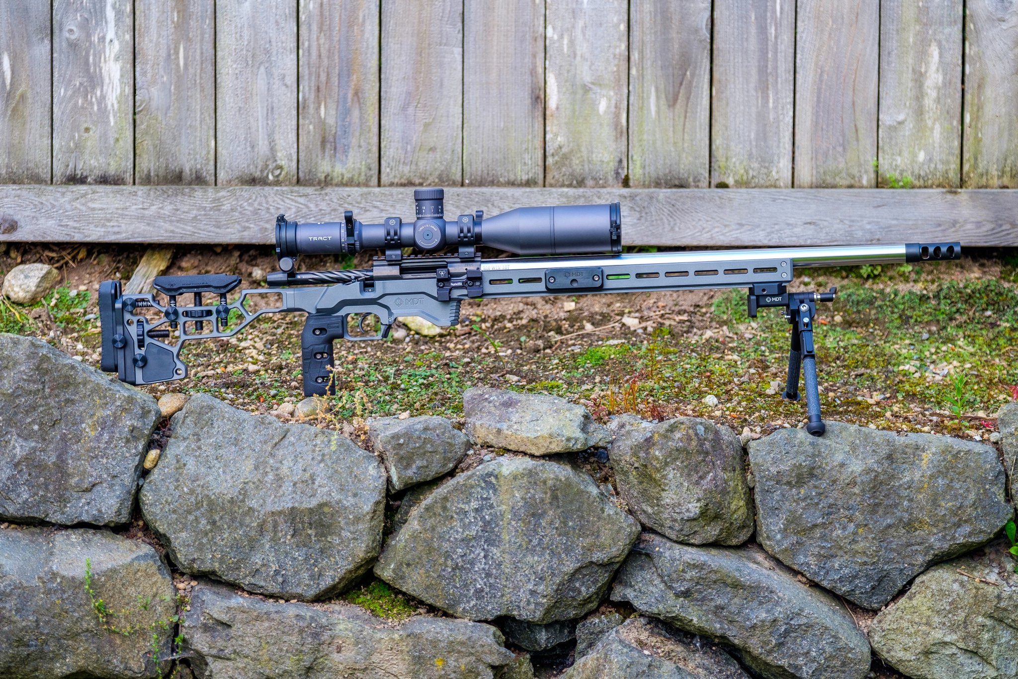

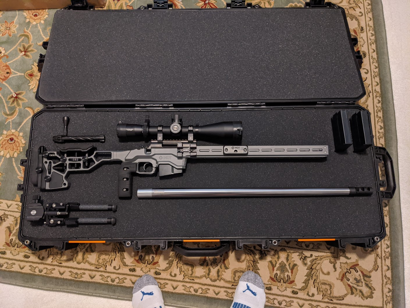

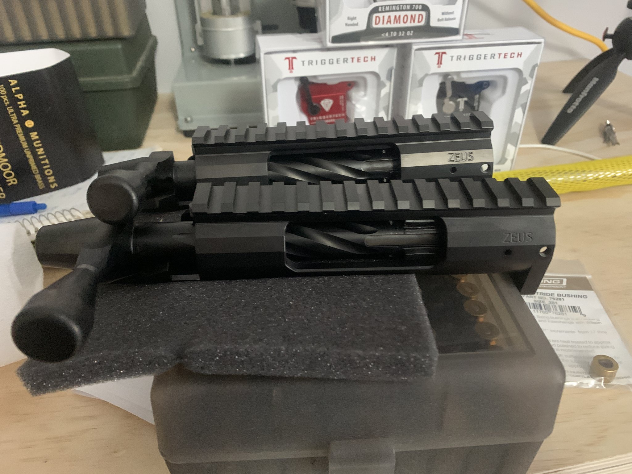

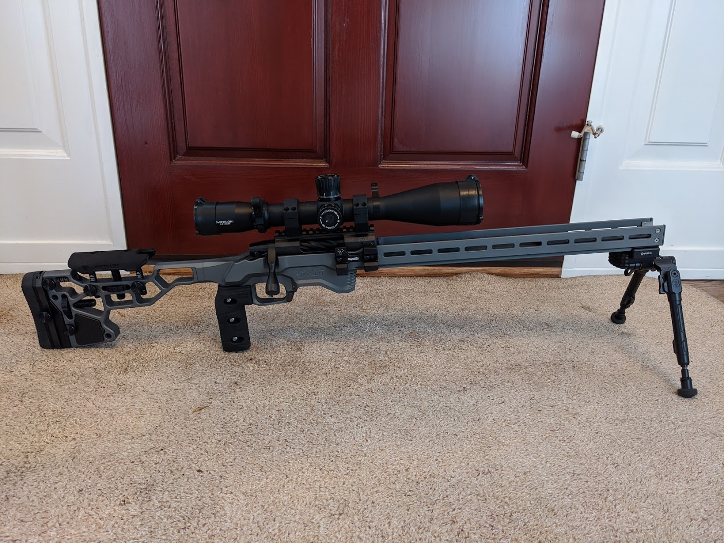

Well after an extremely painfully long wait on shipping my Zeus finally showed up!! Was the last part of the build I was waiting on and it’s finally complete!!
zues action
Ks medium Palma 1:7 twist 25 creed barrel
Trigger tech diamond
Mpa comp chassis
Currently wearing an atlas but have a ckye pod on its way
Heathen brake

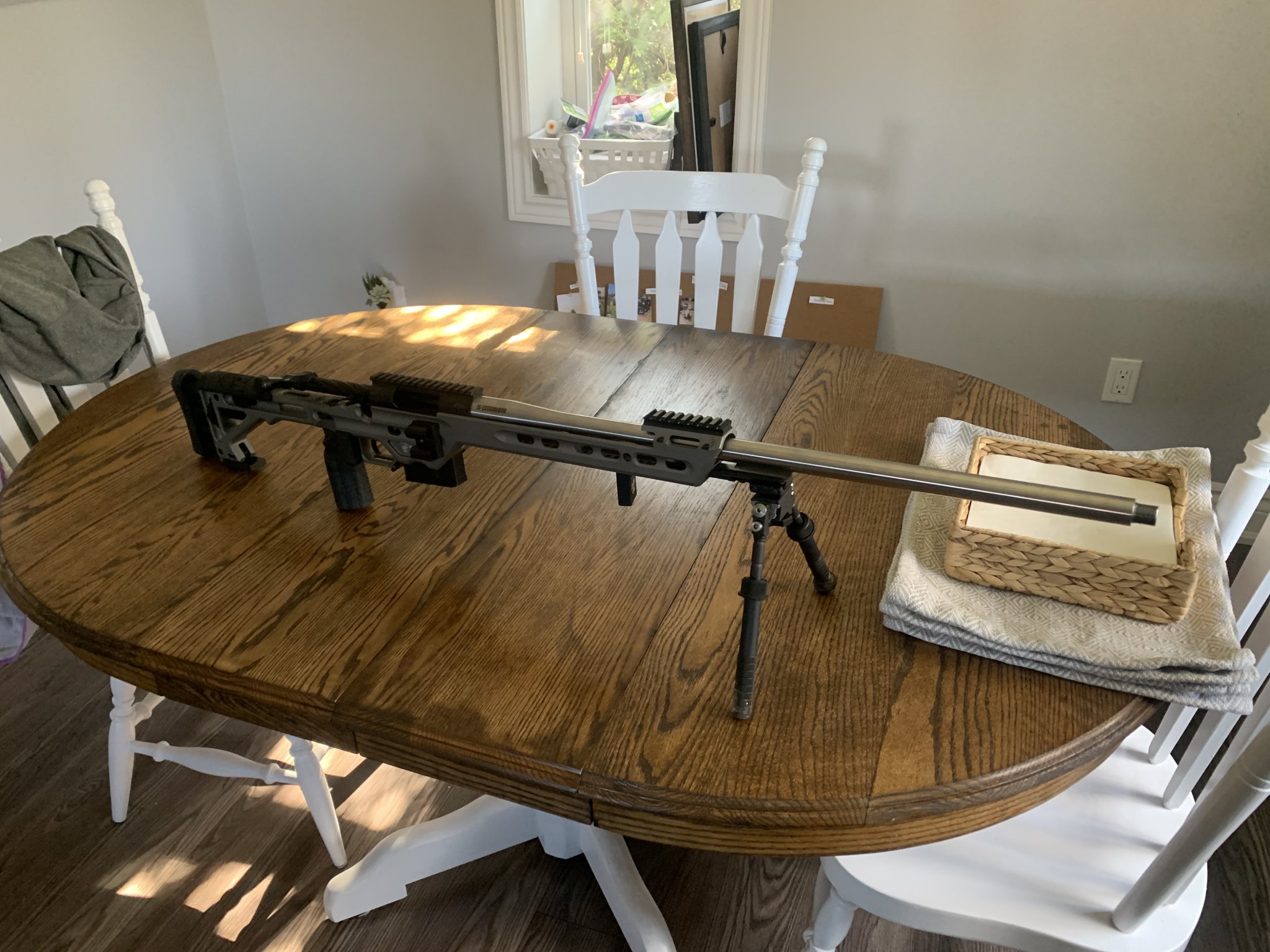

how do you like the mdt? I was debating between the mdt, mpa and krg. The second Zeus is going in the mdt but it hasn’t arrived yet.
I love my MDT's. I wish they had a "lighter version" for my rimfire rifles. I had an ACC for my T3X, my T1X. Sold those, to get new ACC's for my Vudoo and Terminus. This is my "lightened" ACC.
It still takes a good total weight of about 16.5lbs to balance.
My new one with the heavier back (steel weight/buttstock) will probably be 20ish to 21 lbs when done.
Big things I like - integrated arca rail. Great positive mag/barricade stop that I can really grip/push into things. Full m-lok on the sides for any accessores, and then internal weights for balance.
I also find MDT's vertical grip and thumb shelf on the chassis to be the most comfortable.

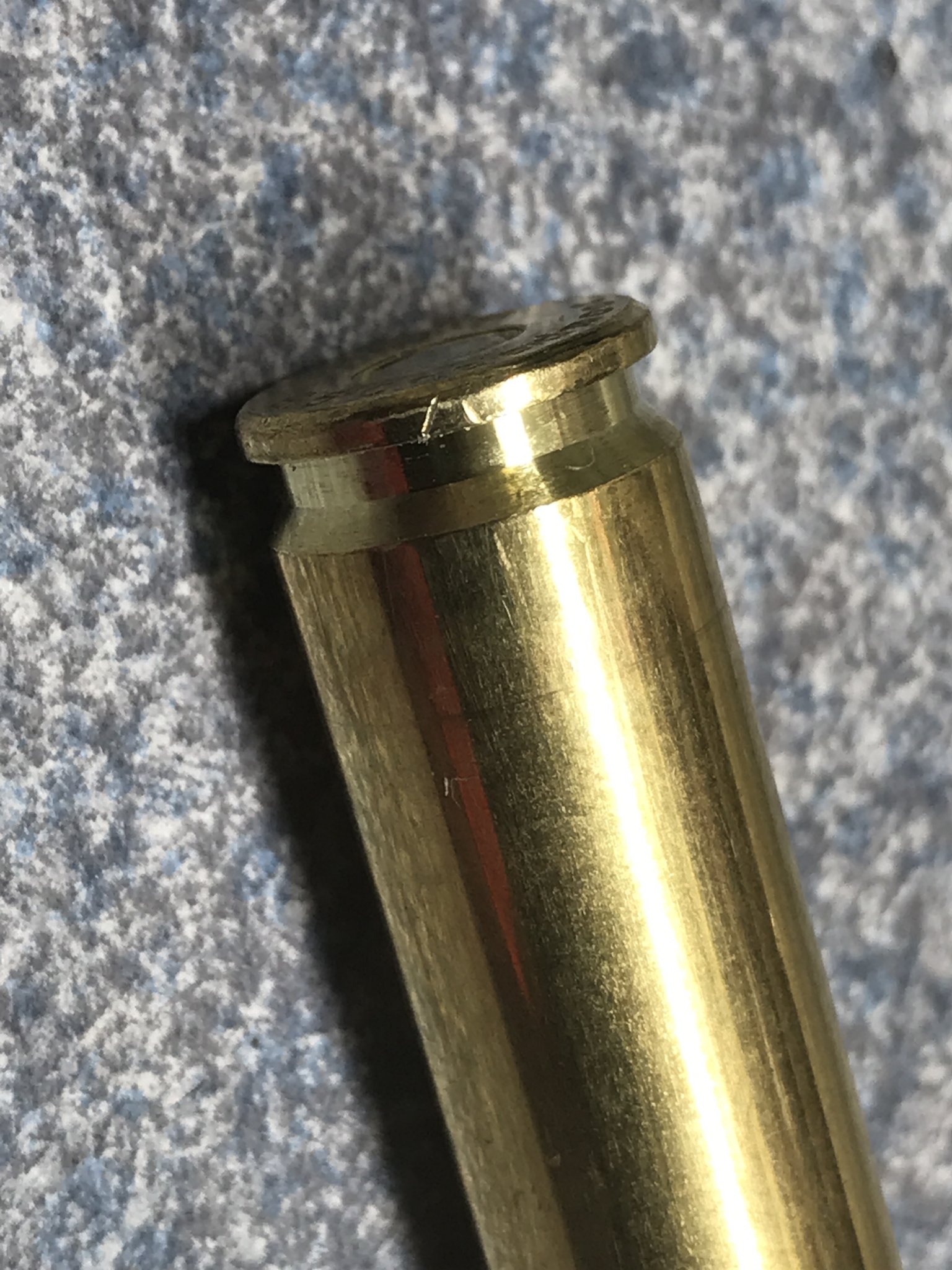

Is anyone else getting a burr on the rim of the brass from the extractor? I assume it is caused by the extractor. It is brand new lapua 6.5 CM brass to begin with. No other problems I love the Zeus action. It is a slight burr I can feel on every case fired, it is not there beforehand. Thanks
Reactions: Dolomite
Got a picture or is it just enough for your fingernail to catch on?

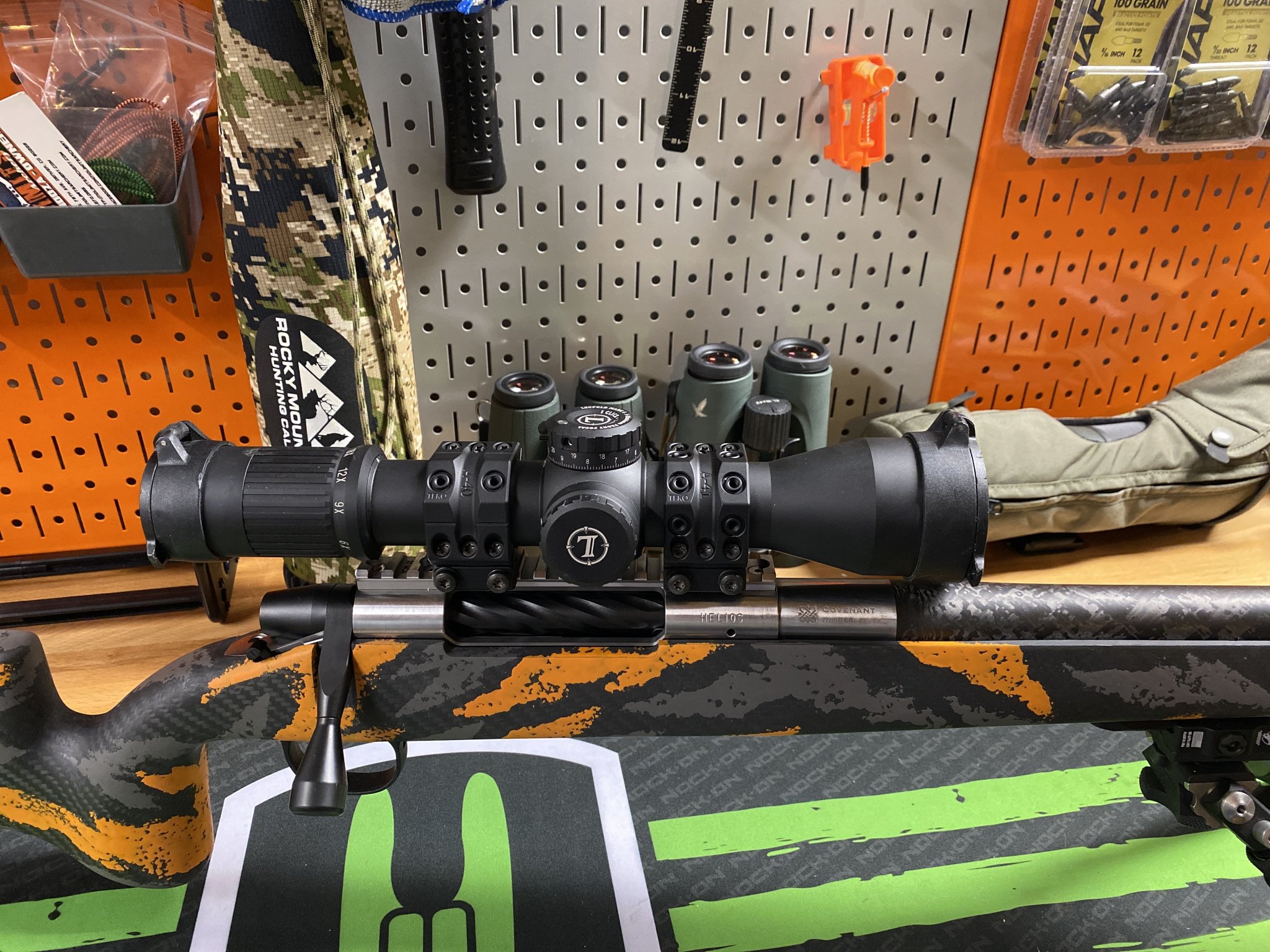

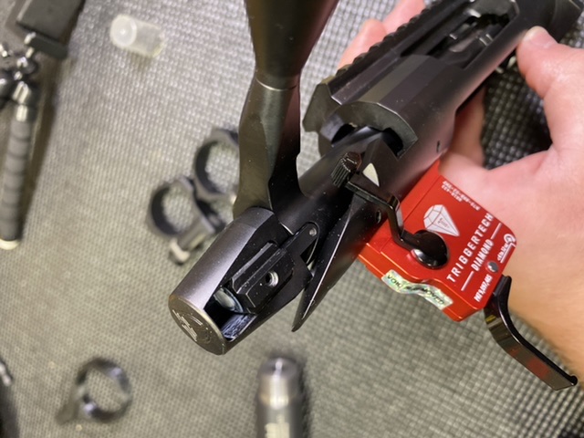

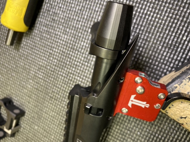

Alright boys, WTF am I doing wrong here. Insert bolt and it’s hitting the rear tang. Only one real way to insert it so I don’t appear to be doing that part wrong. This is a brand new bolt and action.
Rotate the shroud roughly 45-60 degrees clockwise.
Find a pic showing the shroud logo in relation to bolt knob and you'll see why
Happened a few times with my Tikka's. You rotated the fire control system too far.
Oh god I tried the method in the video to reset the cocking, and I failed so horribly. Destroyed the edge of my wooden top craftsman, and when it slipped I would bang/scrape it onto my craftsman box. Was a frustrating, frustrating evening doing that.
What I ended up doing, is just stick the shroud into a vise, and cock the bolt like you would do normally. Was super easy and simple.
Yeah, that method isn't fun, but it does work in a pinch. I actually have an old Mag light with a very thick metal loop for hooking to a belt. It works perfectly for this. Honestly, you could even use a shoe string or paracord, but if you have girl arms it will be tough.
My main issue was the shroud slipping as I started rotating. Since the cocking piece is a bit slanted, it didn't quite grip as much as I wanted to as I was cocking it. Maybe I needed a grittier surface, or rub off the lube/grease on that area.

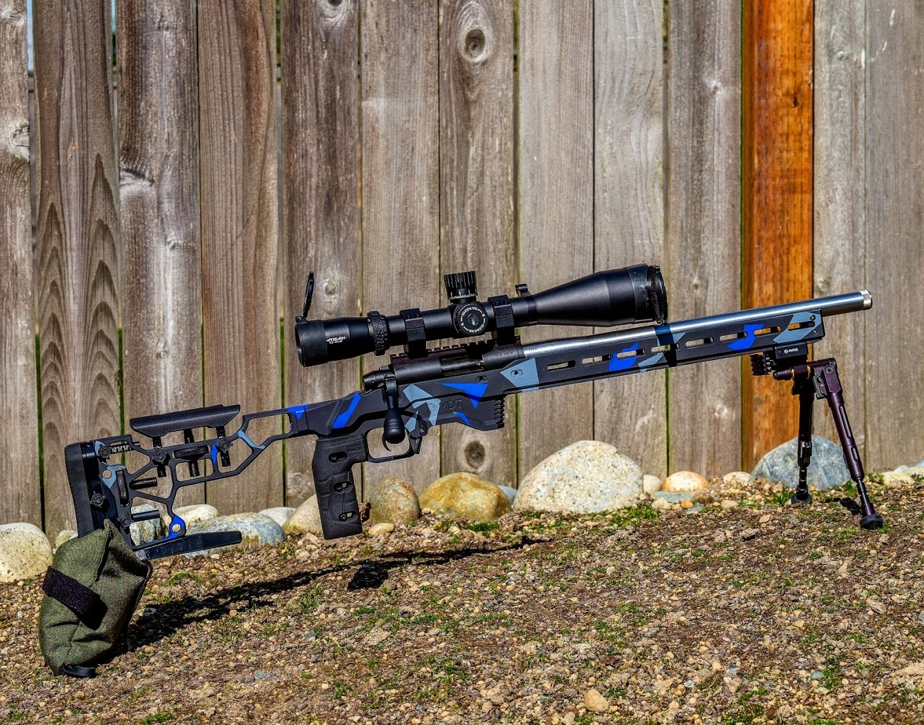

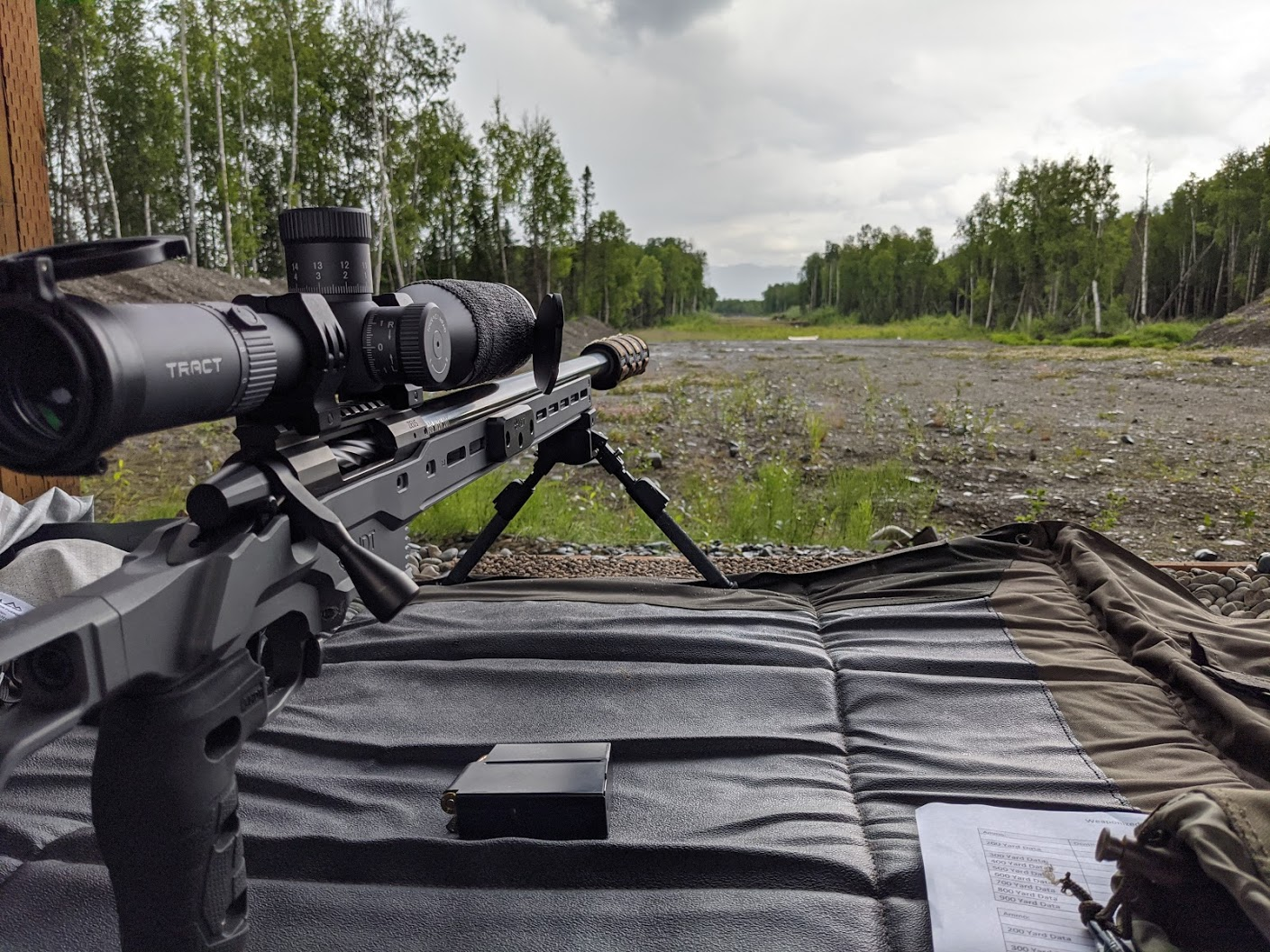

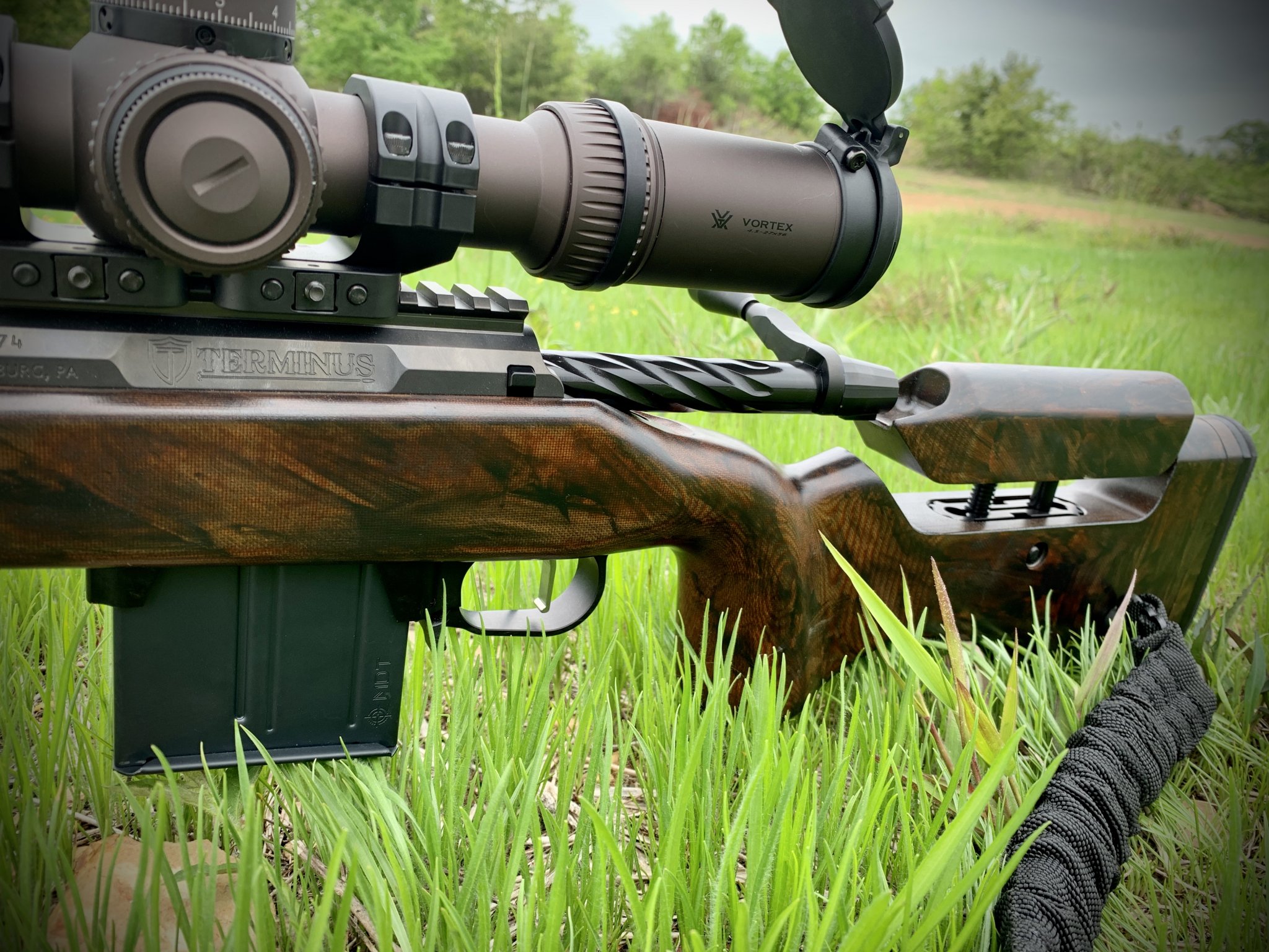

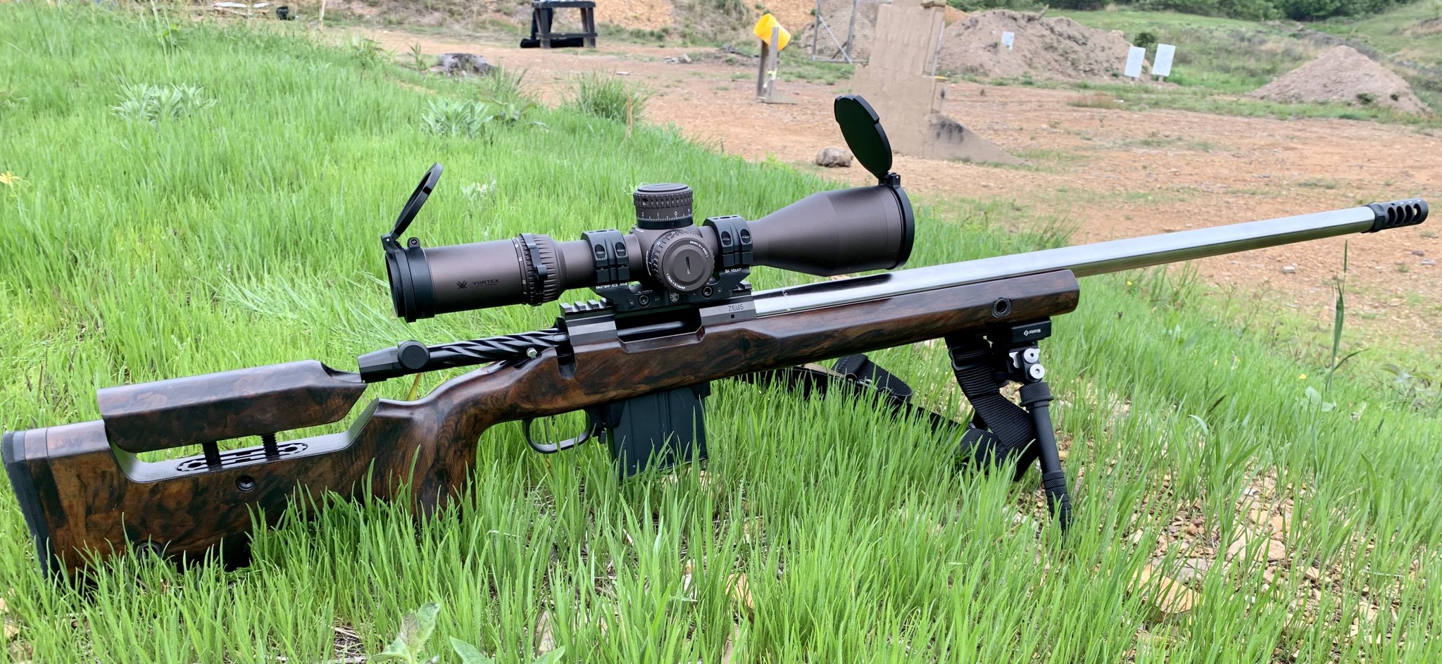

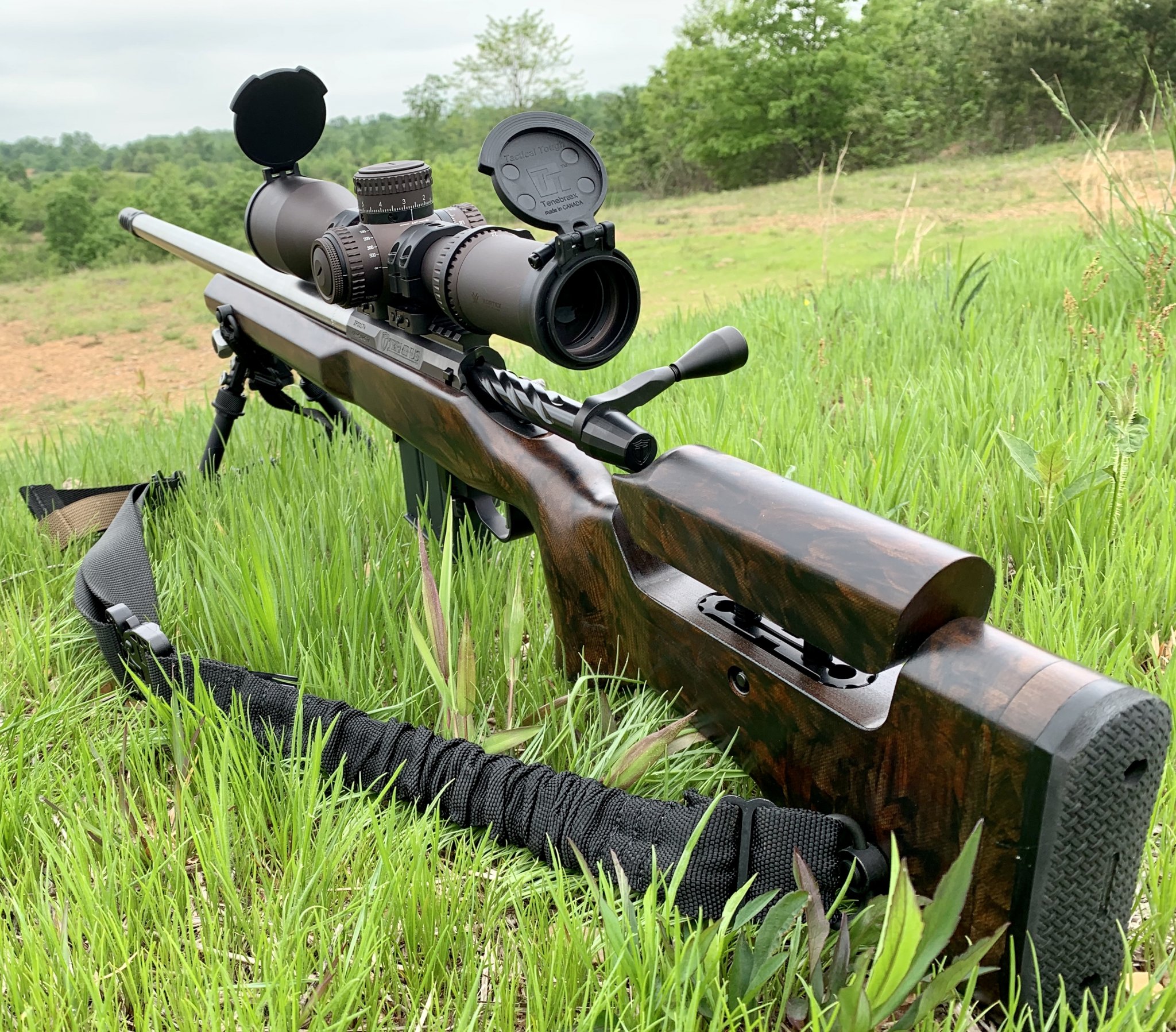

Did some shooting up in central CA last week. Great rifle, 10.5 lb tack driver, barreled by Kampfeld Custom out of Idaho.
Terminus Zeus in 6.5cm
20" proof
NF 2.5-20×50 with Tremor 3
Manners CS
TT Special
Big shout out to @Joel Russo for making ridiculously badass actions!

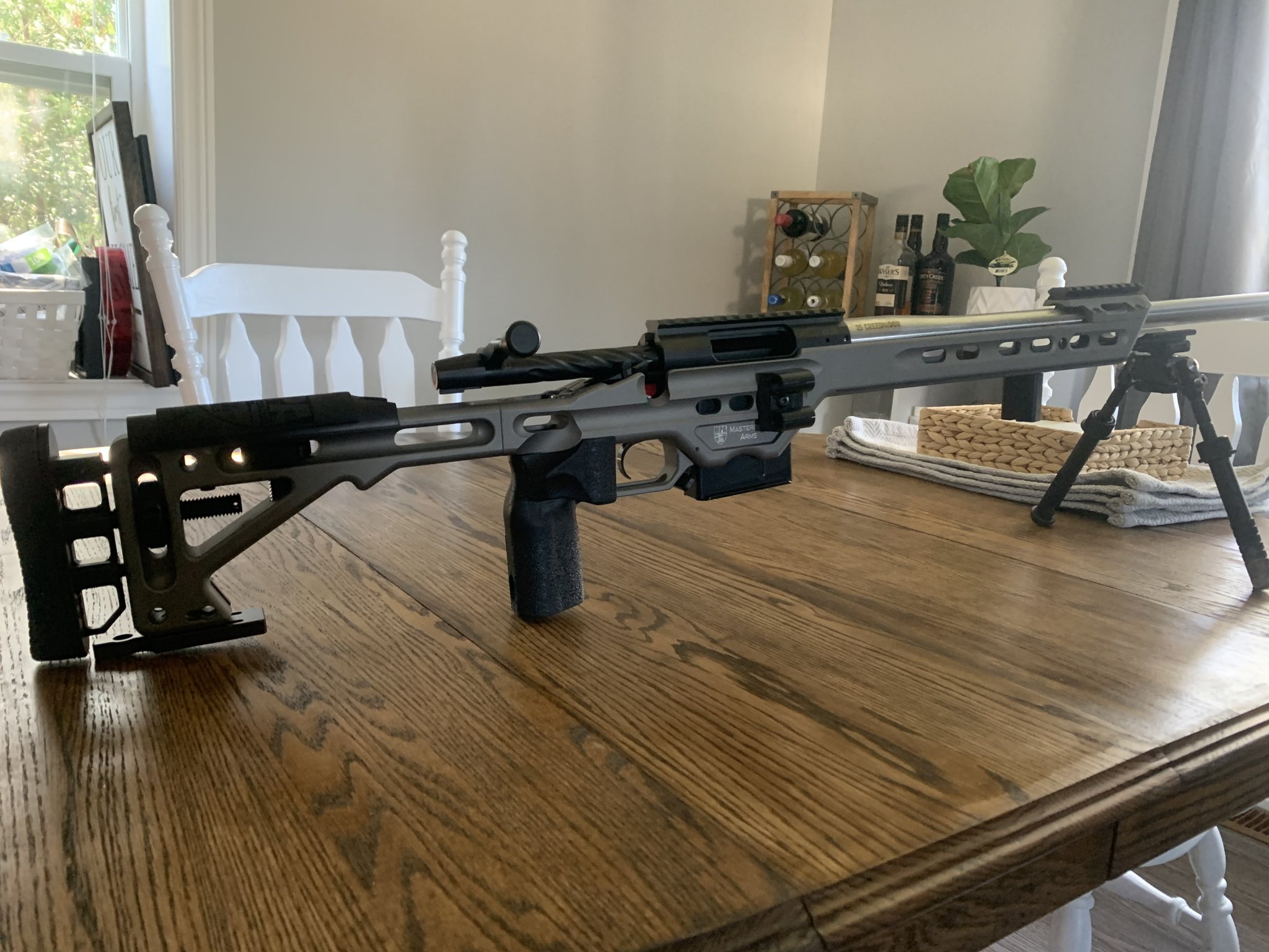

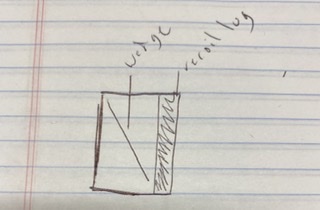

Anybody using the MPA with wedge lock? Seems like the small is to small - When used it will begin to twist instead of sitting flush against the recoil lug. The large appears to be to big.
That’s how wedge lock works. It twists so one side of the barrel is against the lug and the other side is against the chassis.
The only time it won’t twist is with thicker lugs. It’s still twisting, just not as easy to see.
Sounds good. It basically looks like this so I didn’t know if one side hitting it was an issue but sounds like it’s working properly then

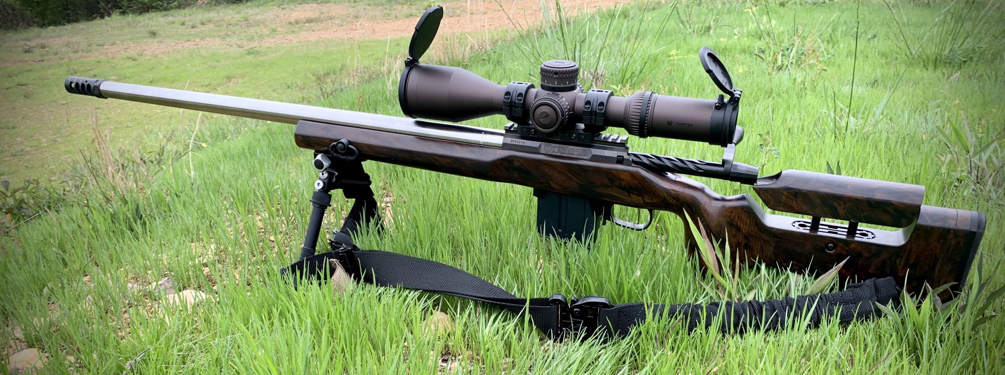

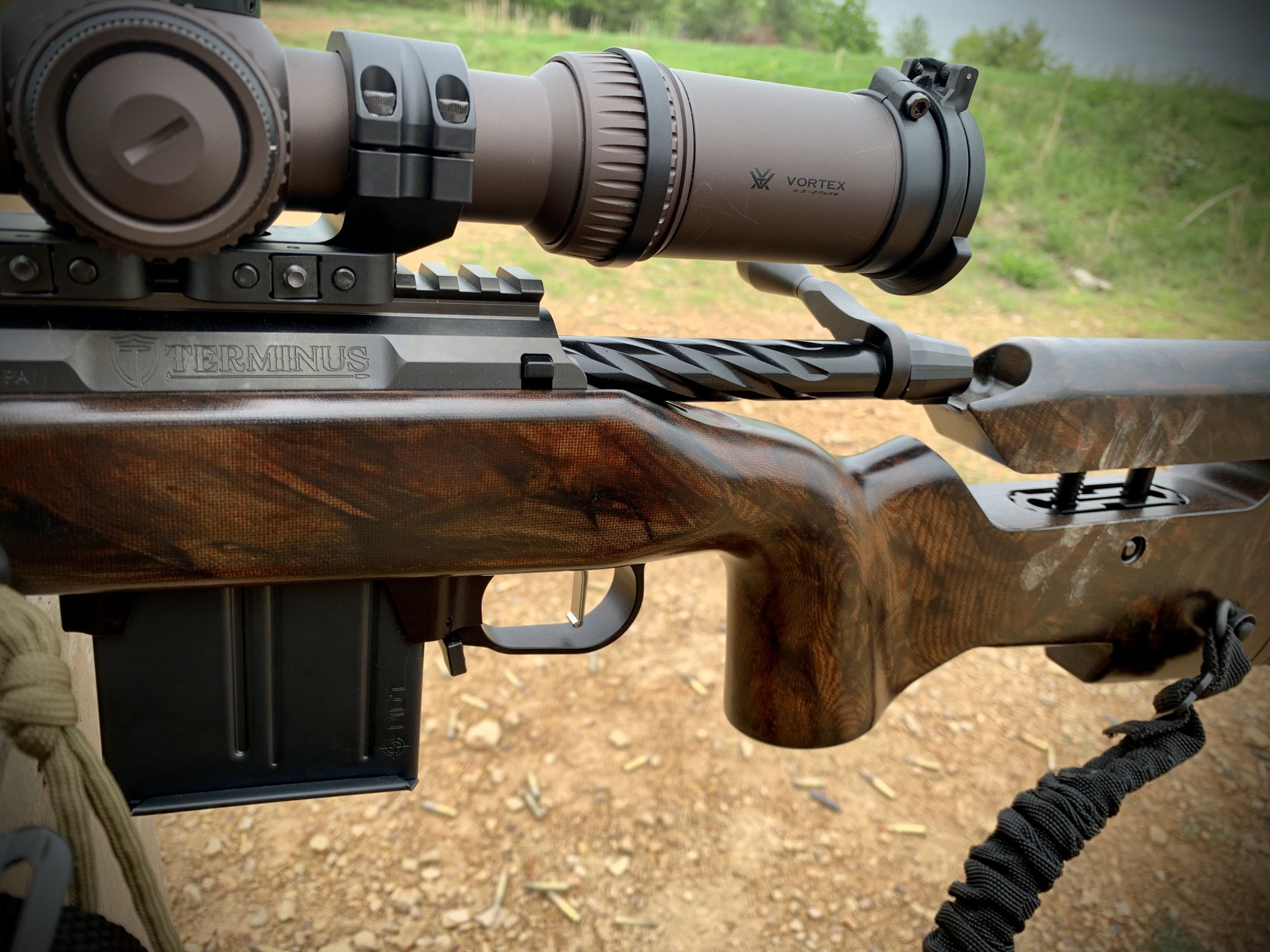

Love mine...Bartlein spin bugholes, APA GEN3, foundation stock, trigger tech.

Thank you. That rig is an absolute dream to handle and friggin hammer. The only thing I would like to add to it would be a cheek piece bc my face gets sweaty! Any suggestions?
Check out Hoptic USA they have some pads that are cut that might work or you can trim 1 to fit.
I would go on the XLR website and buy some spare sheets of foam for a couple bucks and make your own off a template, that's what I did, its low profile but keeps the keep from getting sweaty. I can take a picture later when I am home.
Another option is to get a Weibad pad that you velcro around the cheek piece, it adds height though. I run one on a Manners and do like it but the lines and flow of the Foundation just doesn't seem right with the weibad on it.

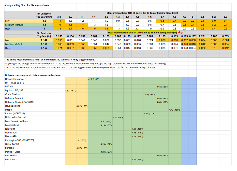

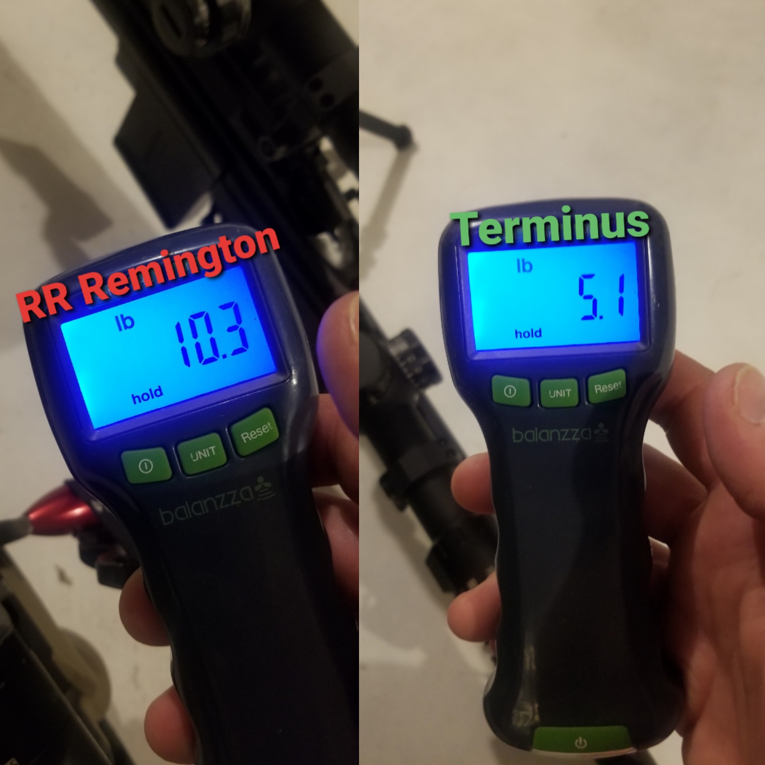

Anyone running a Bix&Andy Tac Sport Pro? What sear height did you get for your Zeus? I don't have my rifle with me to do all the measurements but wanted to order a Tac Sport Pro to try out. I currently run a Huber 700.
I had heard that having the right sear height can affect how heavy the lift of the bolt is. Right now my Zeus's bolt lift is around 8.5lbs. So I was wondering if switching / timing the trigger would help.
Around 9 minutes he goes over how to measure, its the calipe rbody resting on the outside of the cross pin and the depth gauge going down until it touches the cocking piece. Thats how you select the proper height.
It might get lighter over time as things "wear in", but it may take some time as the whole action is DLC'd. Unfortunately, a slightly heavier bolt lift is a trade-off of running a 60* vs 90*. The Terminus/Curtis design is one of the better 60* designs I've felt as far as bolt lift. The steeper the angle on the cocking piece the more "oomph" it's going to take to perform the same function (or overcome the firing pin spring) of a 90* bolt lift. Defiance actions are popular because of what you noticed today. They are also a quality action. In the picture below is a comparison of my "RR" prefix Remington action and my Terminus. The Terminus was a definite upgrade for me.
Would you happen to have a high end custom 2 lug action to measure and compare? Like a Impact 737R, Defiance Deivant, or Lone Peak Arms Fusion? Just curious as to how light the high end custom 2 lug actions are in comparison. Thank you
Using my trigger pull gauge, my Terminus cocks with about 8lbs of force. I wonder if it'll get lighter than that if I keep shooting it.
I believe Defiance Deviant is like 3 pounds. That's what I read and I felt it was super light when running it. I didn't have my trigger pull gauge the day I tried it out.
I ran 350 rounds through it over a 4 day training course and never really felt it was heavy / issues when running stages.
Reactions: HighPlainsMarksman
I don't have any other high end custom 2-lug actions. I have a Curtis Axiom and Badger 2013 (currently at the 'Smith getting built). I have had a Kelblys, and it was a great action. The bolt lift was surprisingly light and bolt ran smooth. I've opted to try 3 lug actions because there isn't a ton of info out about them (and the only one my buddy's have are the Badger). The Ultimatum and Hoplite arms action are on my list but not before the Mack Bros SS action (due to its price).
Thanks for the info! Can I ask what trigger you are running with it and if it's been timed? Thank you
