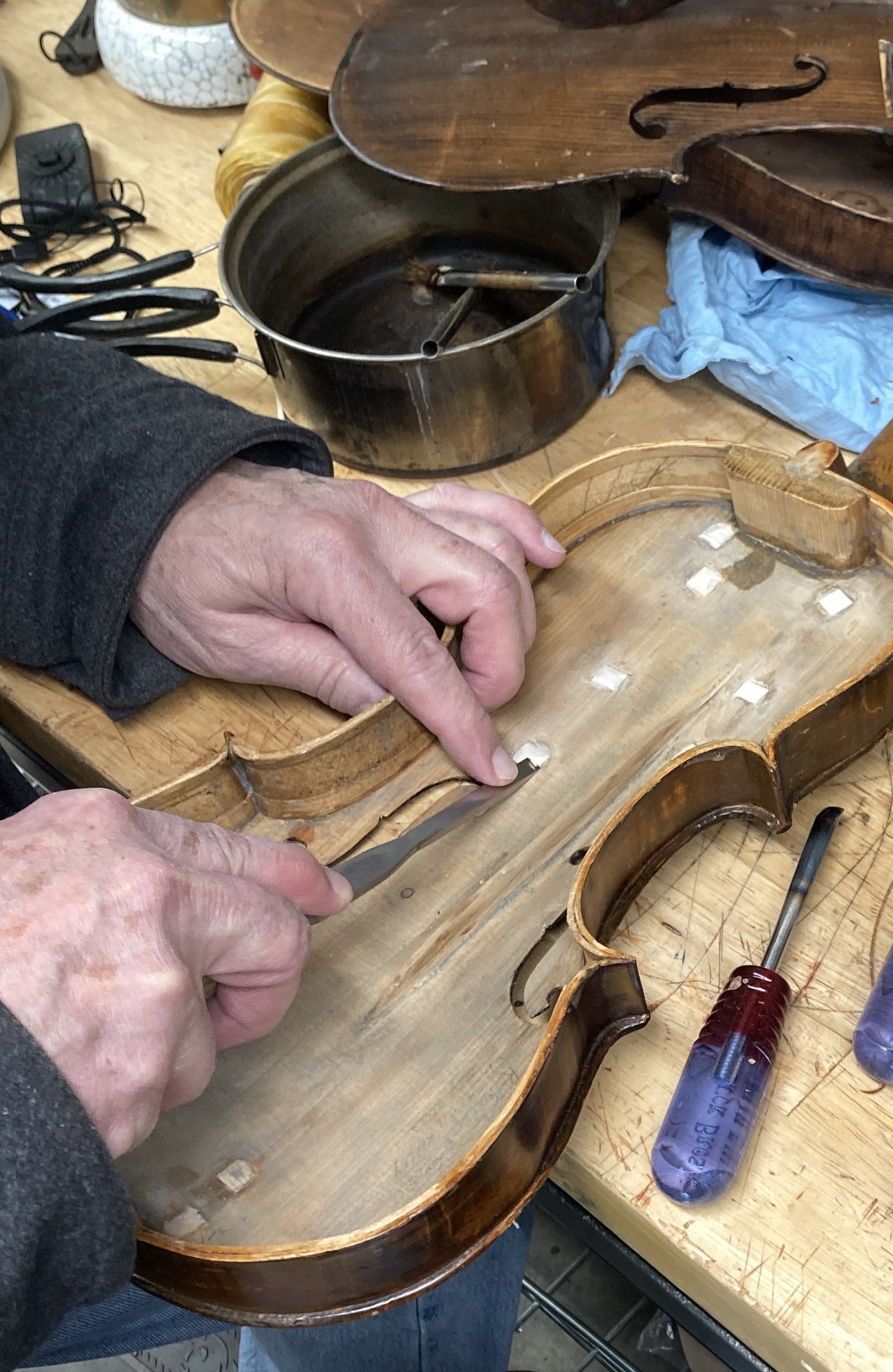

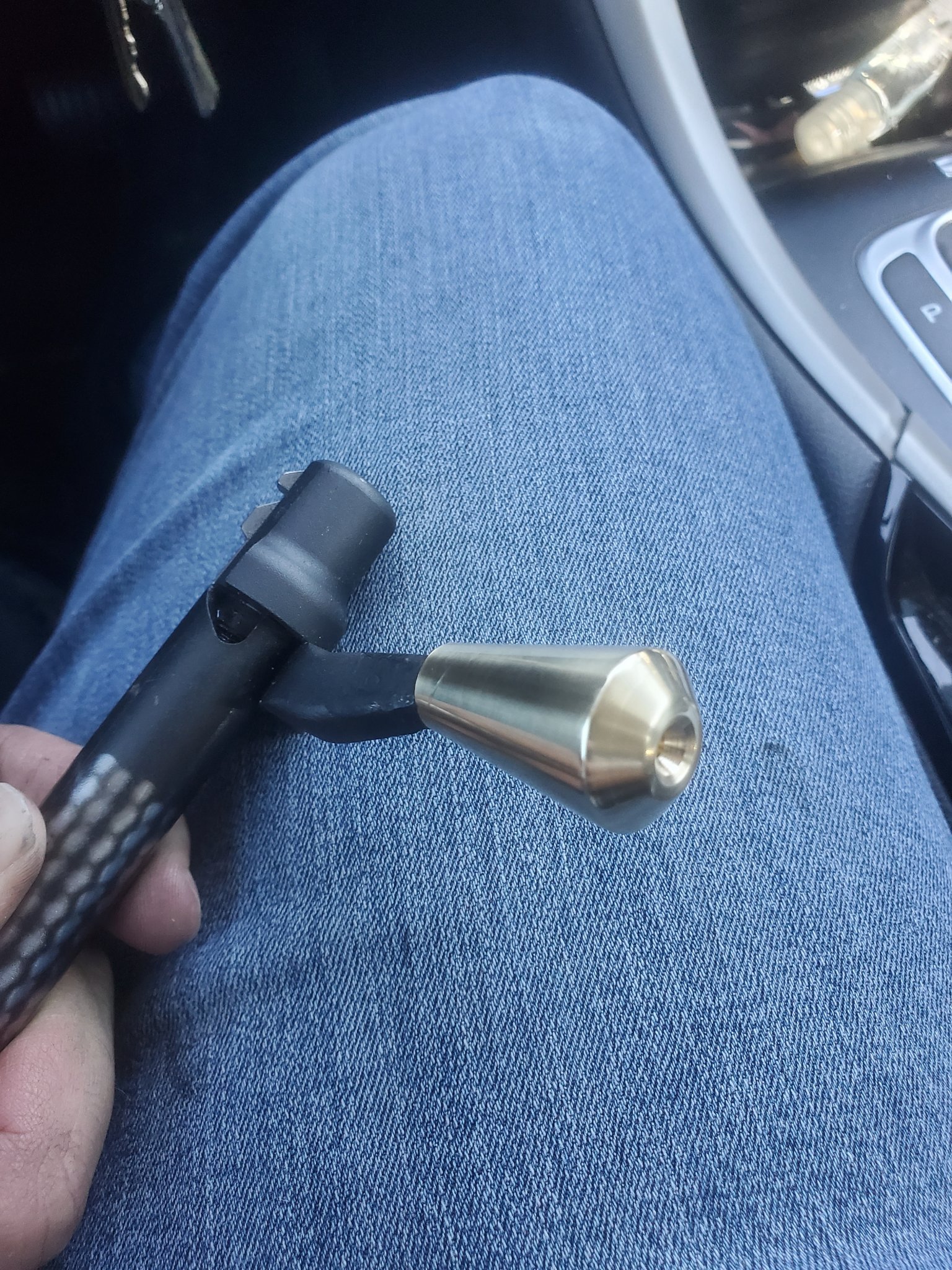

This is for a hand carving chisel on violins and their parts. Many of the great knife makers use A2 a lot. it’s a wonderful blade steel.
O1 was considered and is great. Didn’t have a suitable piece on hand at the moment.
I have made many punches and dies with M2 and D2. My current oven won't get hot enough for M2 though. Both are superb.

Thanks! Yeah i went and double checked my notes to make sure I didn’t mess up. Yep, A2 was what I wanted.

Probably mostly paring. delicate small tedious work. Not general house carpenter type work.
I initially made the back flat on the surface grinder, then lapped it.
For the edge I did close to 30 degree angle, then checked some of the chisels he has reground and they are about 23-24 degrees. I’m assuming that’s his preference for how he uses them.
Also ground the sides flat and perpendicular to the back.
It does cut nicely! I carved some wood, chiseled on a large knot for ten minutes, stabbed a board 100 times, chiseled some more. Still cuts the same and the edge looks perfect still.
I don’t know the best clearance angle. Maybe that changes depending on the intended use?
Yes, blade bevel angle can vary depending on use.
You can even vary the sides of the chisel for different uses. There are as many variations of chisel as there are words in the dictionary.
A pairing chisel should be 25 degrees or less. I have a couple I have ground at 17 degrees.
I keep my American bench chisels at 25 degrees with no micro bevel.
my Japanese chisels are 28-30 degrees with no micro bevel.
My mortise chisels are ground at 20 degrees.
Reactions: Hobo Hilton
Ah! Ok. So I need to regrind this to low 20s then. Thank you @Bigfatcock
Update, he likes how it feels and cuts! Initial impression is he likes it.
Here is it in use. Maybe belongs in the woodworking thread, but since it pertains to the chisel more, here it is.

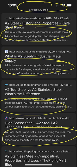

A2 is wonderful steel for a chisel. Ask Lie Nielsen.
@n2ishun probably holds the record for posting the most incorrect information on just about any topic.
Well since you are so perfect.
Please inform us all of any single thing in my post that was incorrect.
Yes, that is a callout on your lazy non-fact checking ass.

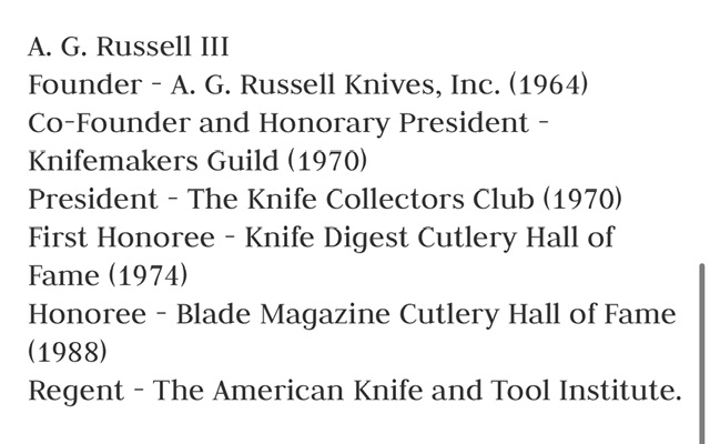

Nope. Let’s set the record straight, out in the open. A2 is a tool steel. A chisel is a tool. In this case, the chisel in question is essentially a knife.
Just in case someone doesn’t know who Mr. Russell is…
Is A2 the best option for a chisel? Eh, ‘best’ is subjective. Is A2 the wrong choice? No, a quick search will show that it’s suitability for blademaking is on par with other tool steels, such as O1 and D2.
BTW, I remember Sorrells from Forged in Fire. Didn’t his blade snap due to improper heat treatment?

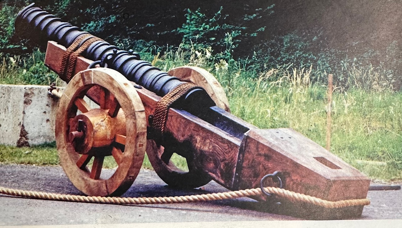

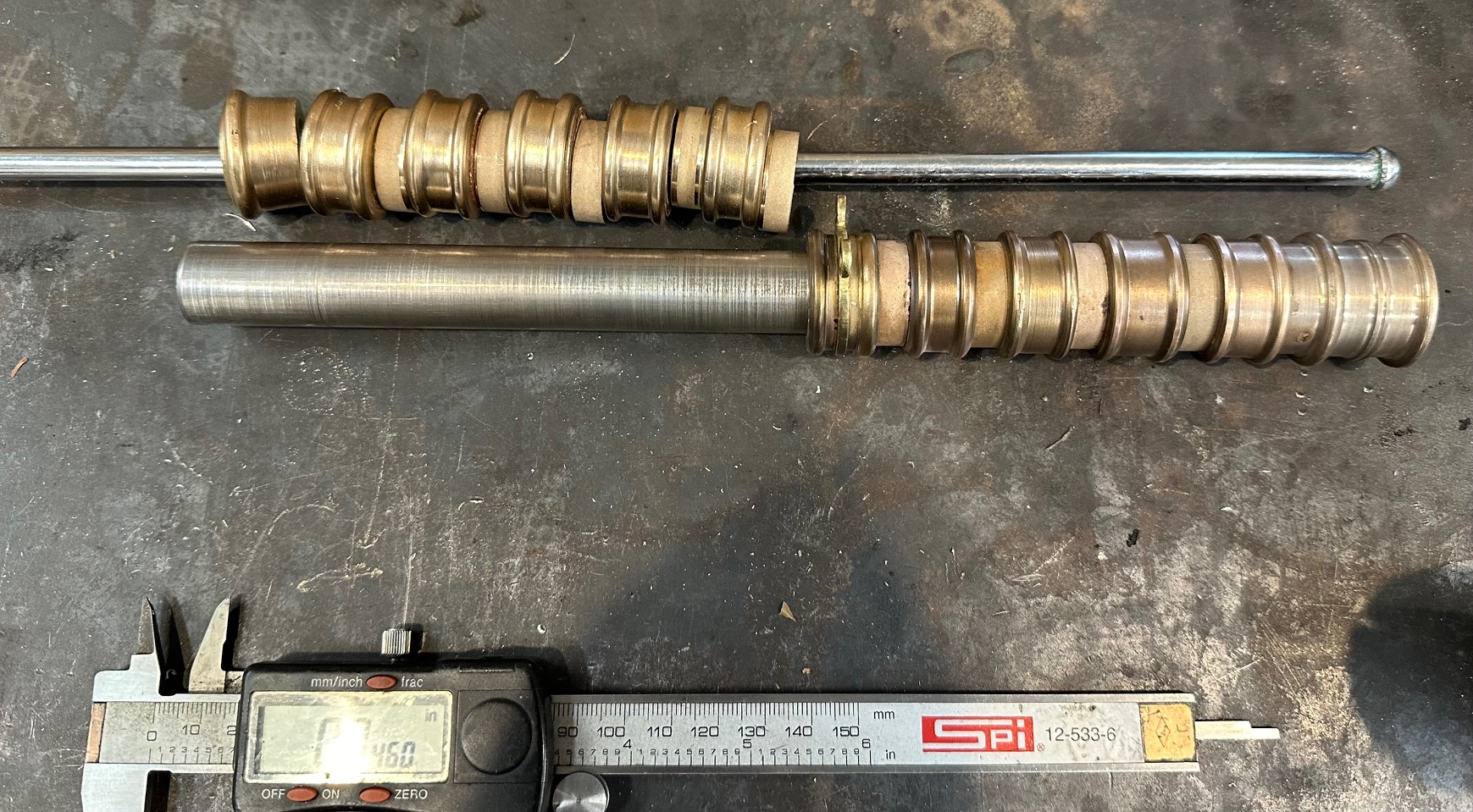

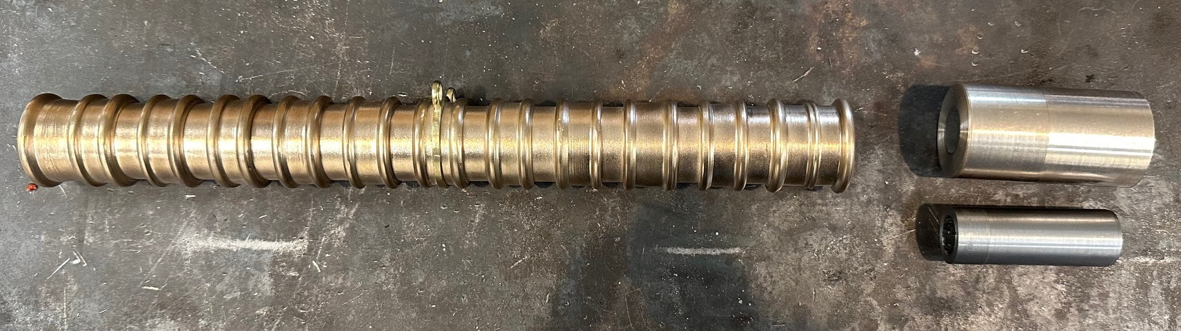

Just a little project I've wanted to do since visiting The Mary Rose ship in Portsmouth last spring.
One of the Port Cannons just seemed like something I needed to make in miniature! These are the big guns that were added to the ship and contributed to her sinking. And was sort of Archaic Technology by the Tudor era. It was made of a thin tube with iron bands shrunk over it. Later, solid bronze cannons were coming into vogue and could be cast. But I liked the idea of making one with shrunk-on bands.
Started by trying to do it over a relatively thin-walled steel tube. But after shrinking on a few bands, the tube started to bow and then compress.

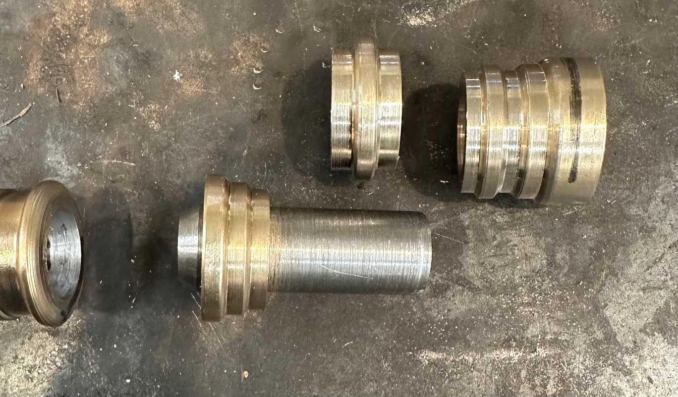

So found a cheap .50 Douglas pistol barrel on eBay... And it was probably cheap because it was bored off center by almost .0625. But for my purposes.... perfect! I was turning the octagon off and making it .750 anyway. So... perfect.

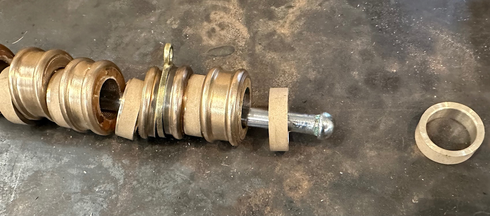

Turned up a series of bands... ribbed and plain. And a muzzle and a breech piece. This cannon is a breech loader so had to make a separate breech. Got almost all the metalwork for the barrel and breech done. I still have to make two 'ring pieces' for the breech. So can't assemble it yet.
Here are various thin and ribbed rings. The 'ears' are for a center 'lifting' hook area. Muzzle is at the left.
More of a close-up. Showing the ears. The first version the tube was a bit over .625" OD and a smooth 1/2" ID. The new one is rifled 1/2" with a .750" OD. Proper barrel. Much safer and a whole lot easier to assemble. The rings are bronze. Decided not to use cast iron. In part because I thought the cannon would look cooler in bronze. And the bronze is stronger and easier to shrink. I can get a good .003" shrink on the bronze... vs way less for cast iron.
Here is the steel barrel (below) next to rings before shrinking on. And with about half the rings (breech end) shrunk on.
Barrel complete with all the rings shrunk on and the initial pieces of the Breech laid out. I can make multiple breeches for 'faster firing.' This will be a fully-functional cannon, BTW. Black powder patched ball.
Here is the breech section in process. Note the bevel that will form the seal between the breech and barrel. These are cut at about a 60 degree andle and will be pressed together by the rear 'wedges' that hold the breech together.
And here is what it will be when done. I have a really cool piece of black Walnut that I pan on using for the carriage. Including the wheels. The finished cannon will be about 24" long and, as I mentioned, will fire!
More as I find some spring time to work on it! It should be a neat one to play with.

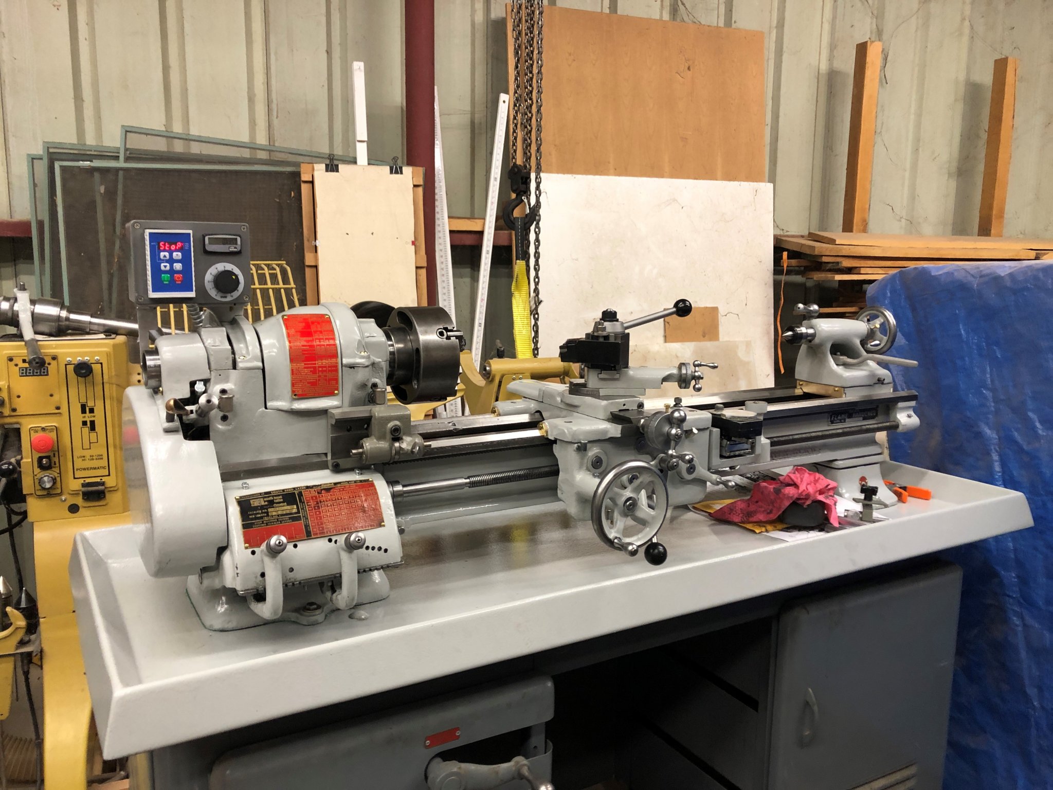

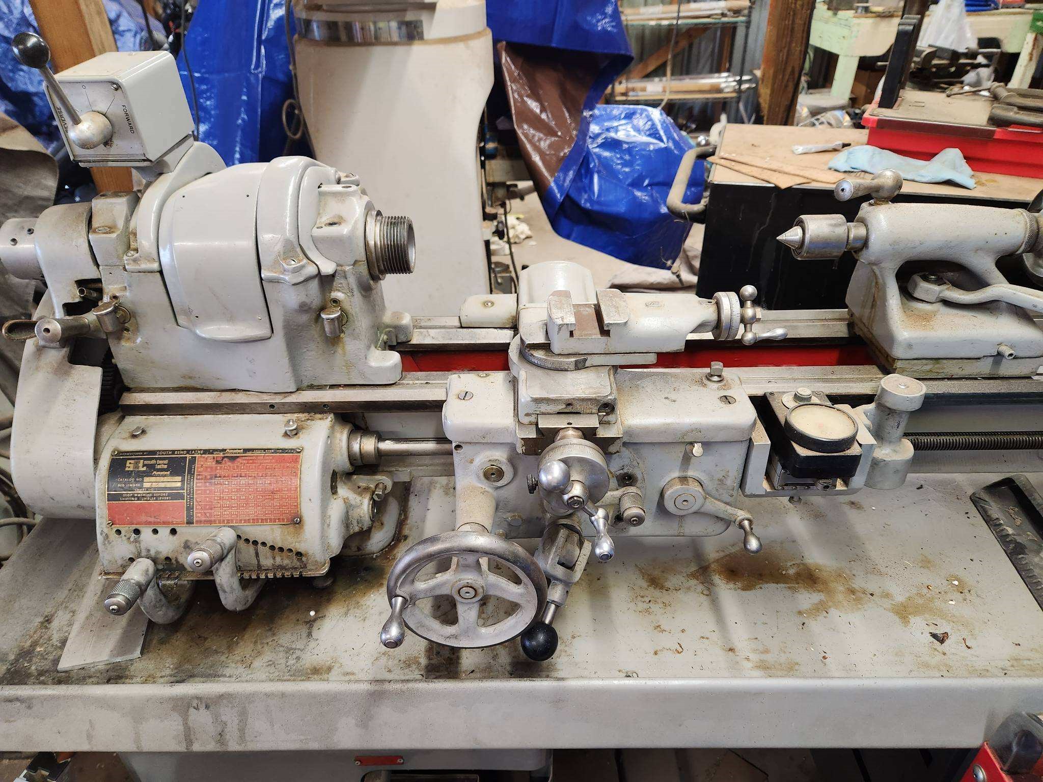

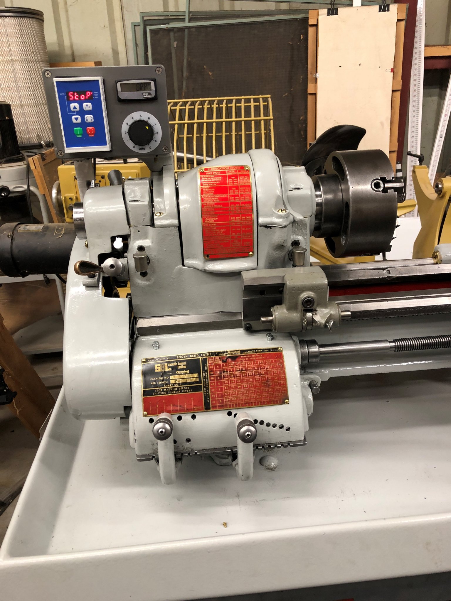

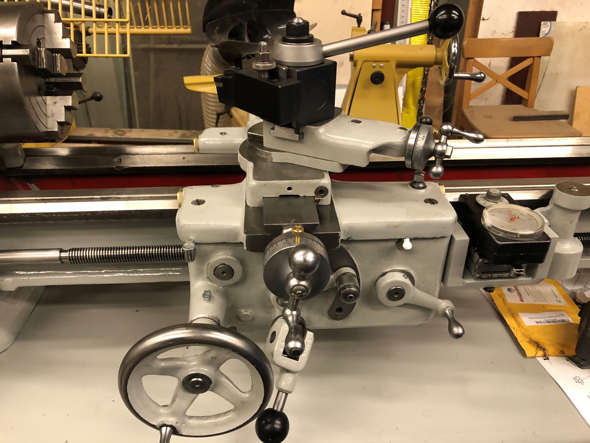

Well pretty much done with the restoration of the SBL 10L. Complete tear-down, clean, refit, paint and reassemble. Fun project but not sure if I would want to do it again. Installed VFD and remote keypad as well as spindle tach and POT. All Aloris tooling and Bison chucks. Spindle runs true with virtually no runout. Final task will be to place in final spot in shop and level. Picture included what it looked like when picked it up.

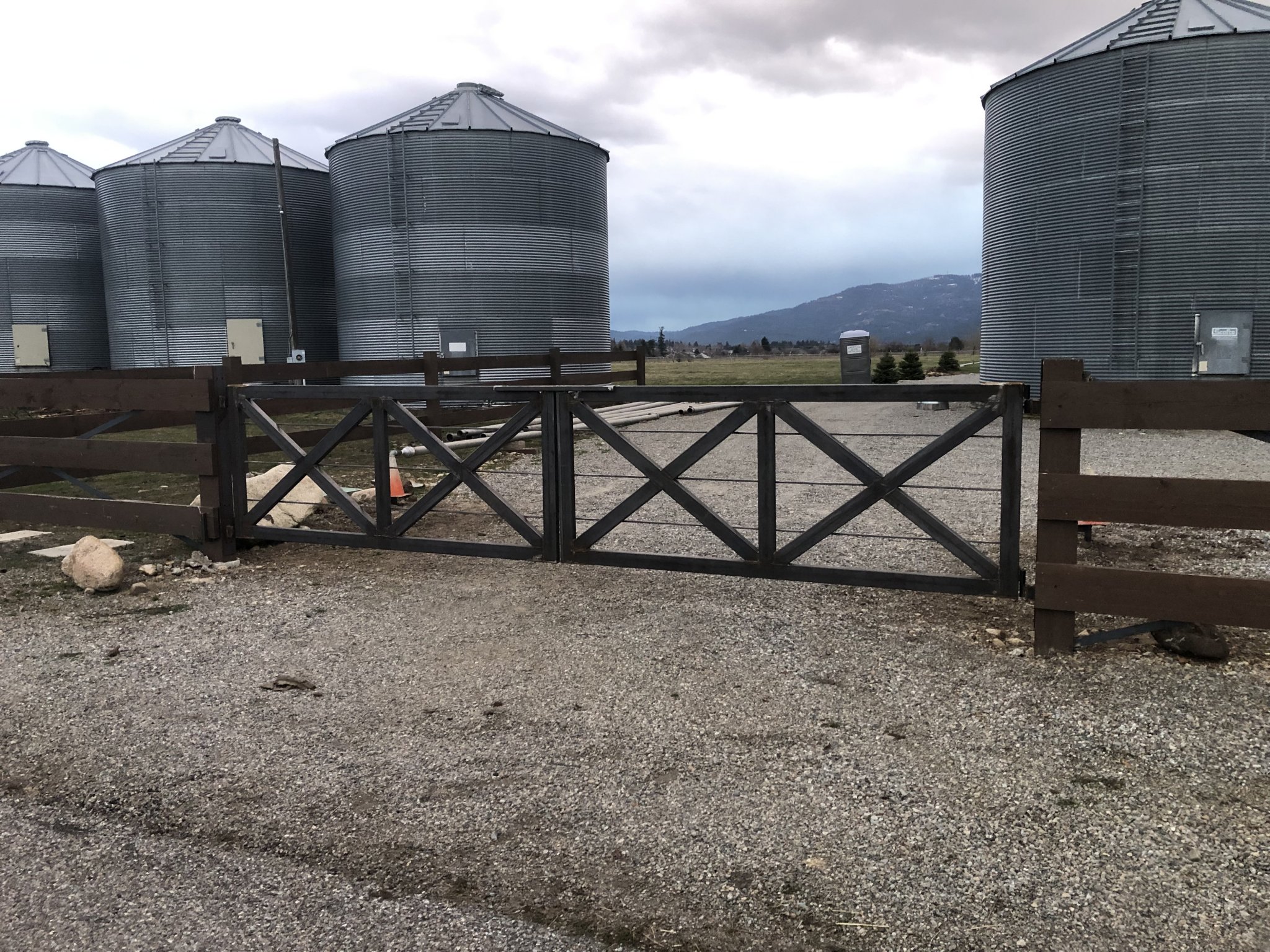

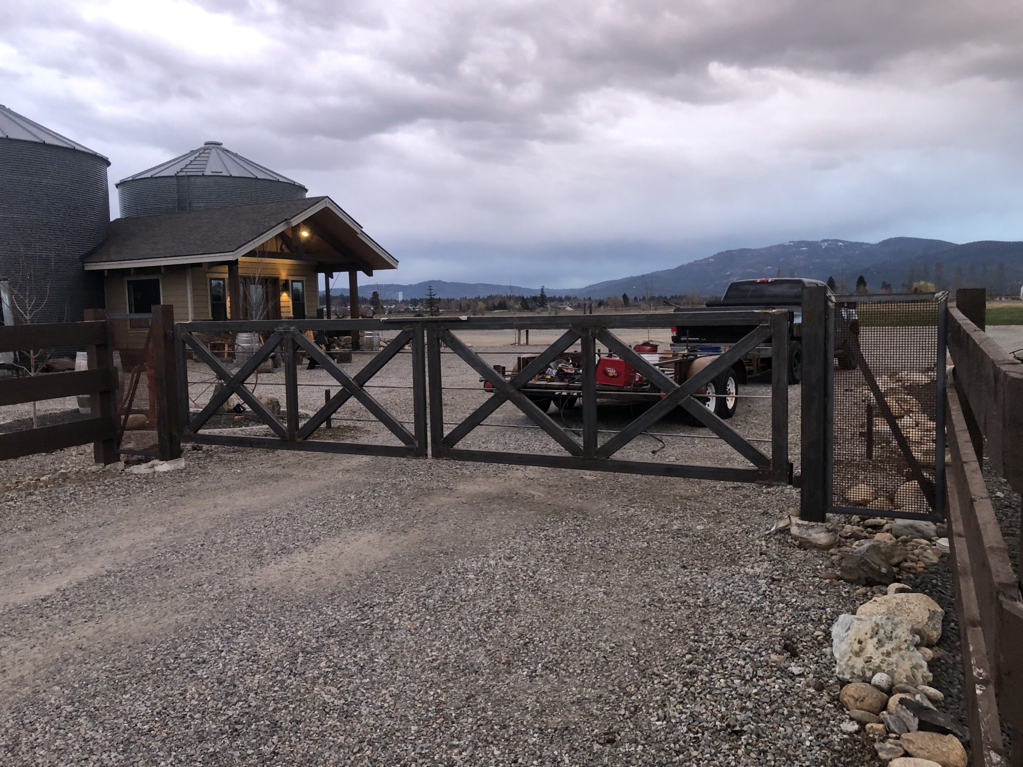

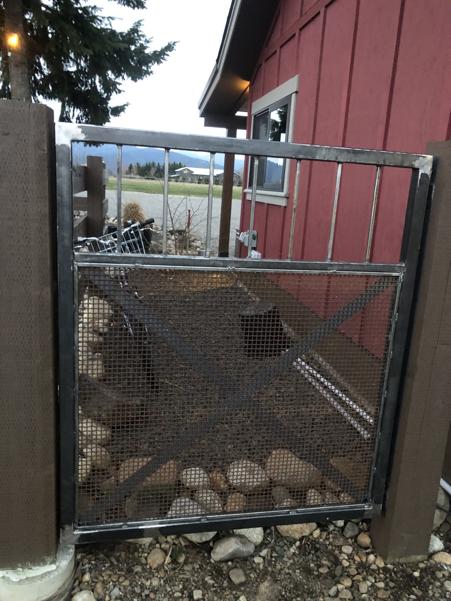

Well, 2 out of 3 main gates and a walk gate complete. 2x4x1/8 steel frames 1/2x1/2x1/16 horizontal tubes. The braces between the steel and wood posts were kinda fun, kinda sucky- 2x2 angle frames infilled with old rock screen. Walk gate is 2x2x 1/8 with the same rock screen. My “3 day project” took just over a week with my little Lincoln 100 series wire feed. Might’ve been a touch underpowered for this job
Going to let it all get good and rusty, then burnish with a wire wheel and clear coat it.

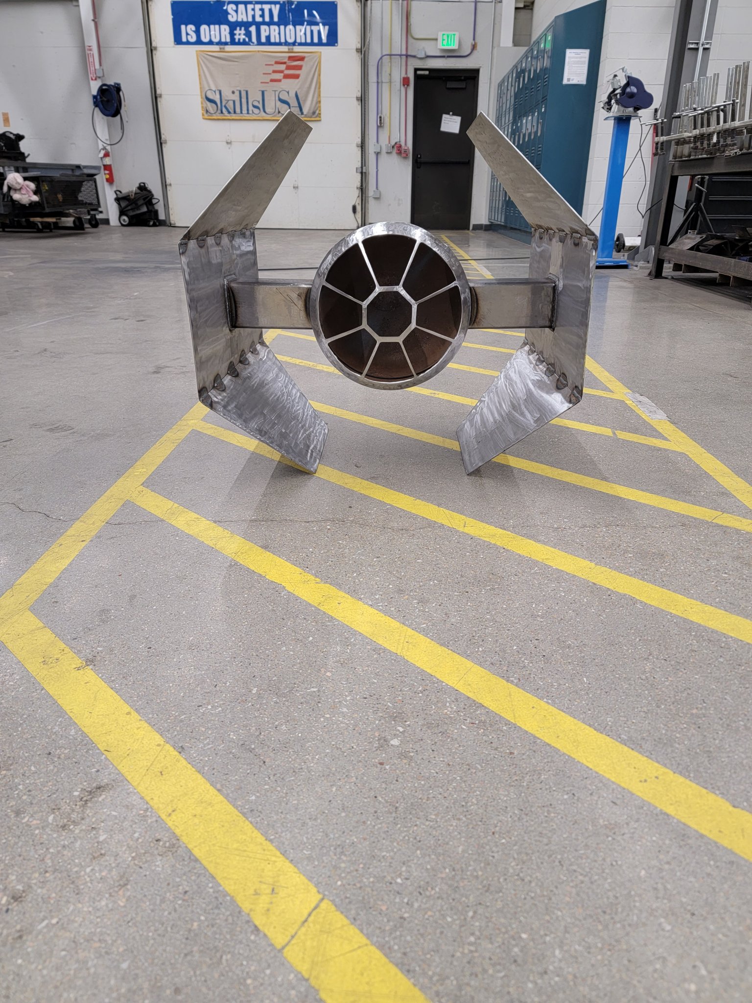

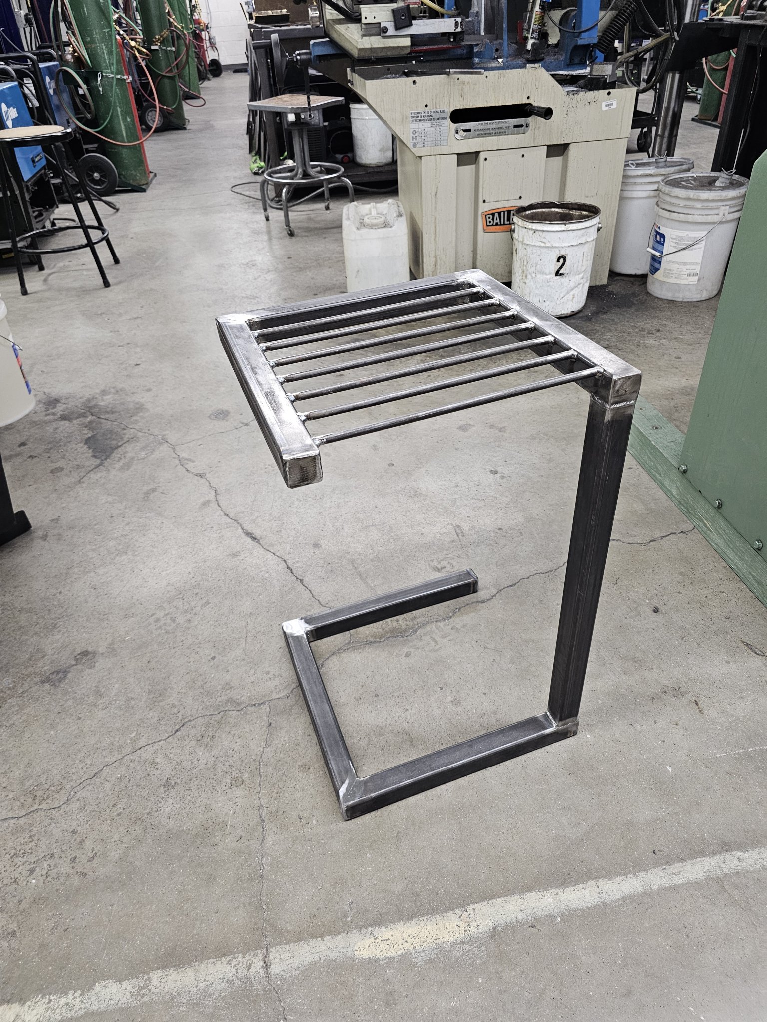

Finished up GMAW 1, with my highschool students so we built a couple of these to test our skills. Came out nice and surprisingly comfy to sit on for what it is.
Not my design, as we watched a video of a guy building one on a short class day. His welds were awful and my students said "we could do better than that!" So i had some material delivered and we went through the video again to make our cut lists. Plasma tabled the end caps and put em together. Not bad for a bunch of kids.
Great job.

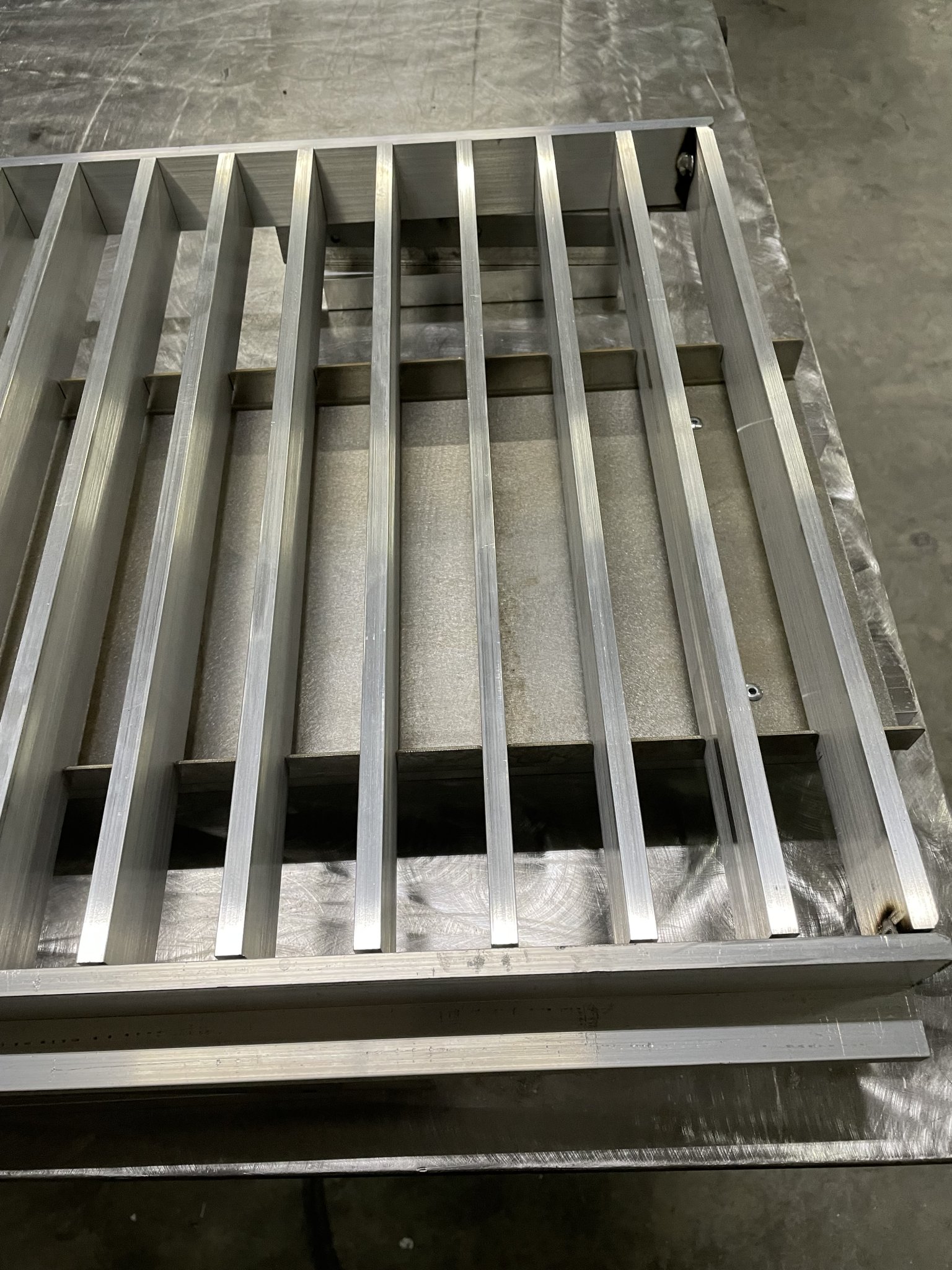

The Great Grate project is underway 🤣

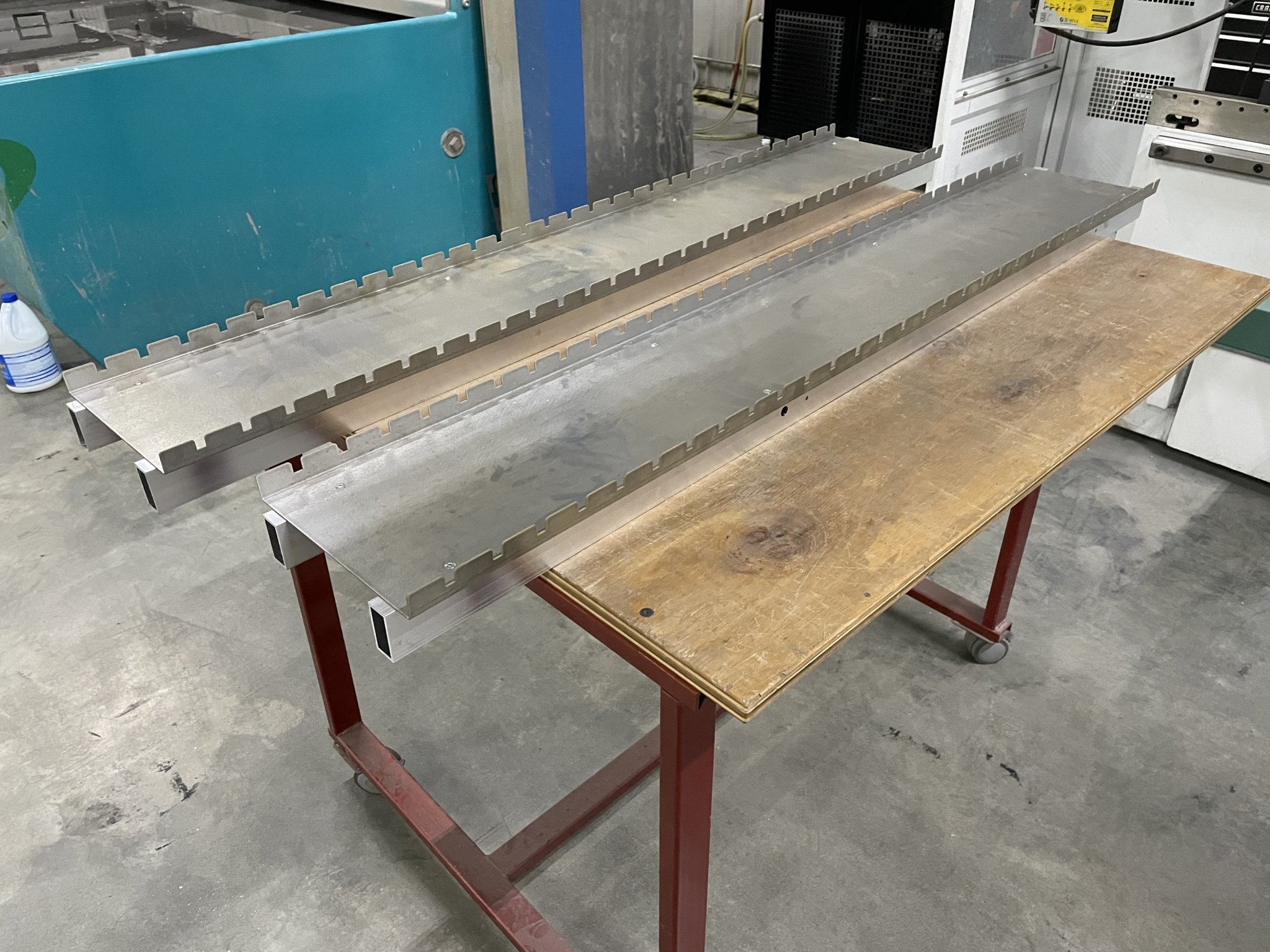

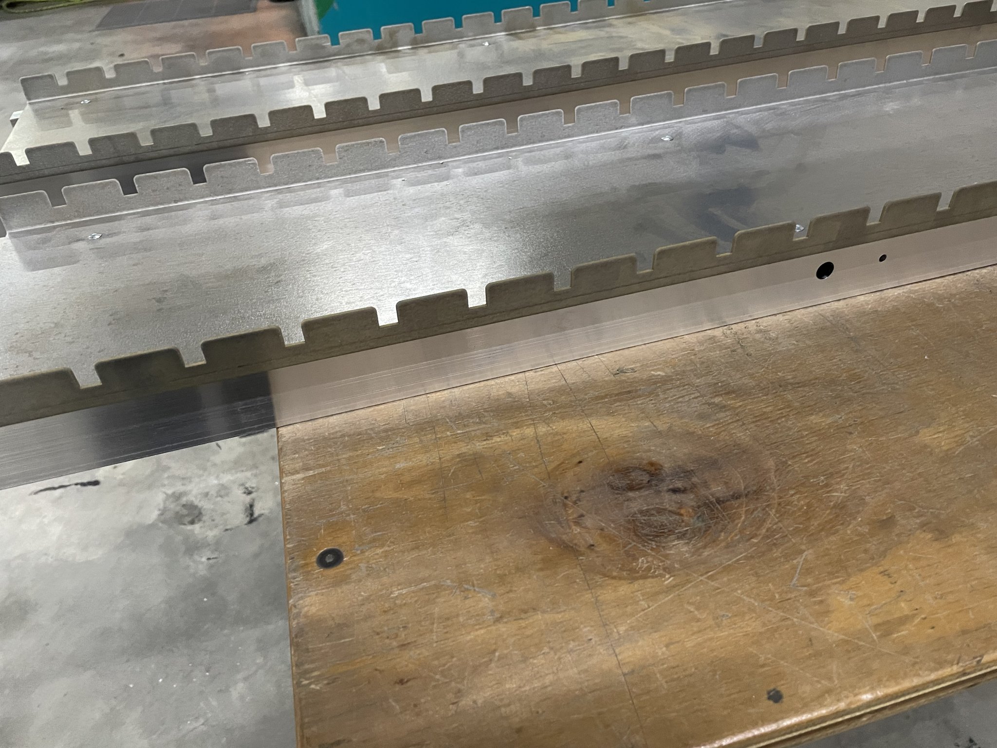

The boss needs some lighter drainage grates for a driveway, so I thought it was a good time to teach the kids about fixtures, and how much they make life easier.
I cut some 14ga sheet and bent to hold all the cross bars. All got welded half way on one side then removed to finish.

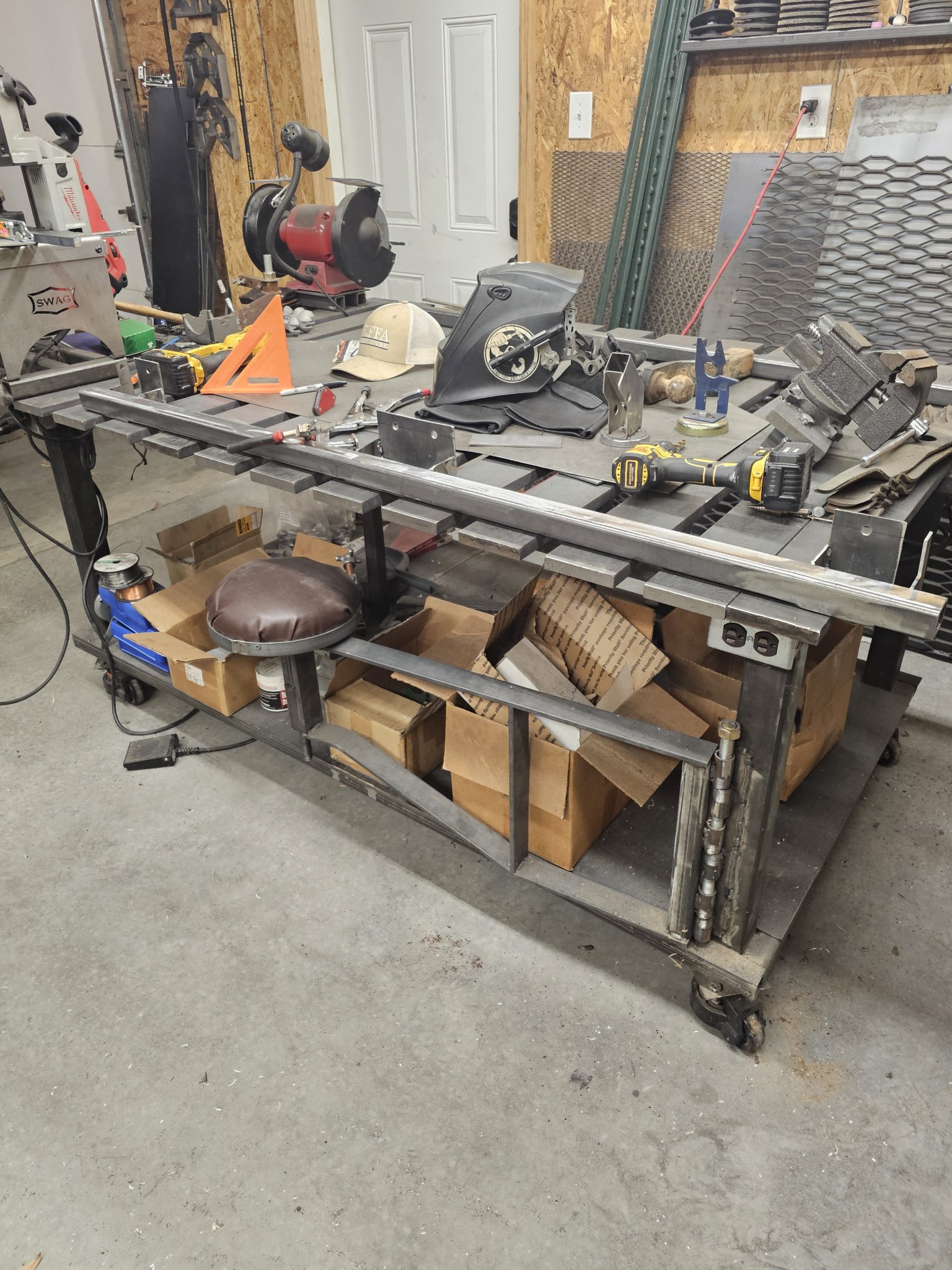

Has anyone gone down this route. I spent the money on the plans, all of $25. And have started the LONG process of printing the plastic bits.
There is no way in hell I am going to pay for a "real" table. I just refuse to spend that kind of money. I think this will do what I want to do, brackets and really rimfire targets.
Just wondering what I am getting myself into, hopefully pick up the steel sometime this week.

Just make sure you can replace the slats, as they'll get cut up over usage. Doesn't look too bad a setup, considering cost.
I think that warrants its own thread. What are you doing here, man? Get to work.
It will be a bit before I get started, I have a few more weeks of work on the kids truck, after I finish that I will get started. Only thing I have done so far is started the printing of the 3D parts. Some of the prints take about a day to finish.

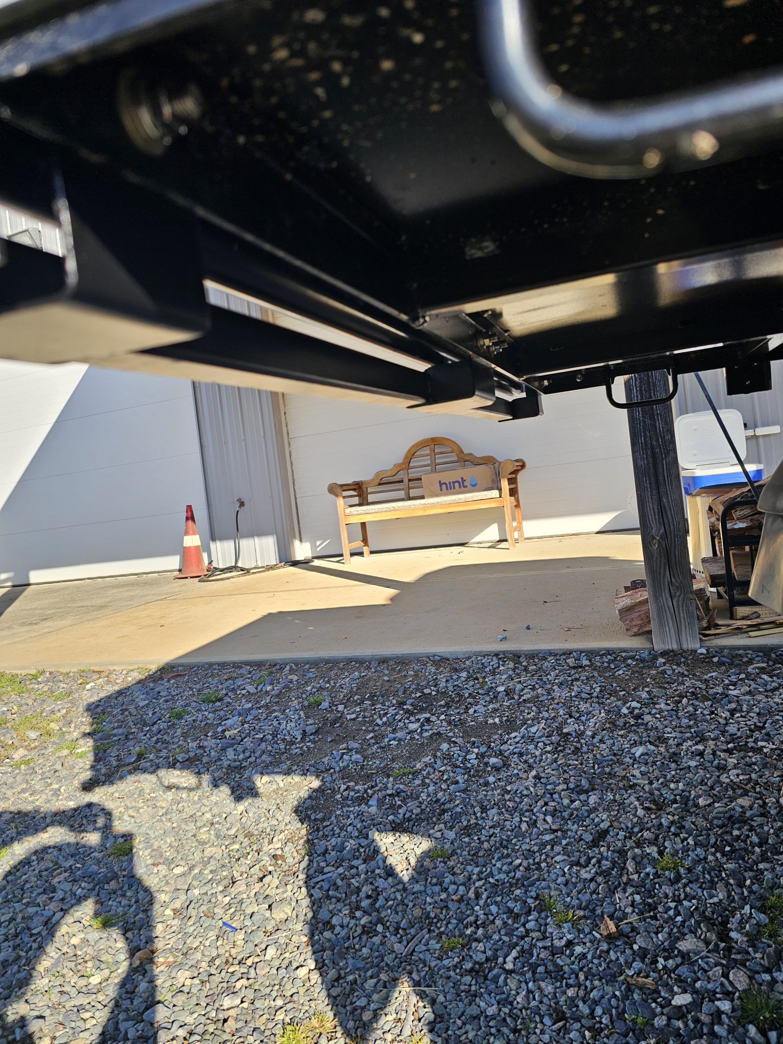

What is the hitch in the bed area used for? Love this pickup version BTW.View attachment 8300686
If you were still curious, i got an answer, Sonni put it in and built a seat to shoot his m2 browning. However when his m915 broke down on a trip he threw a hitch in there and used the Scorpion to haul his 5th wheel trailer from moab Utah back to New Mexico and that's why you see the hitch there in this picture.
