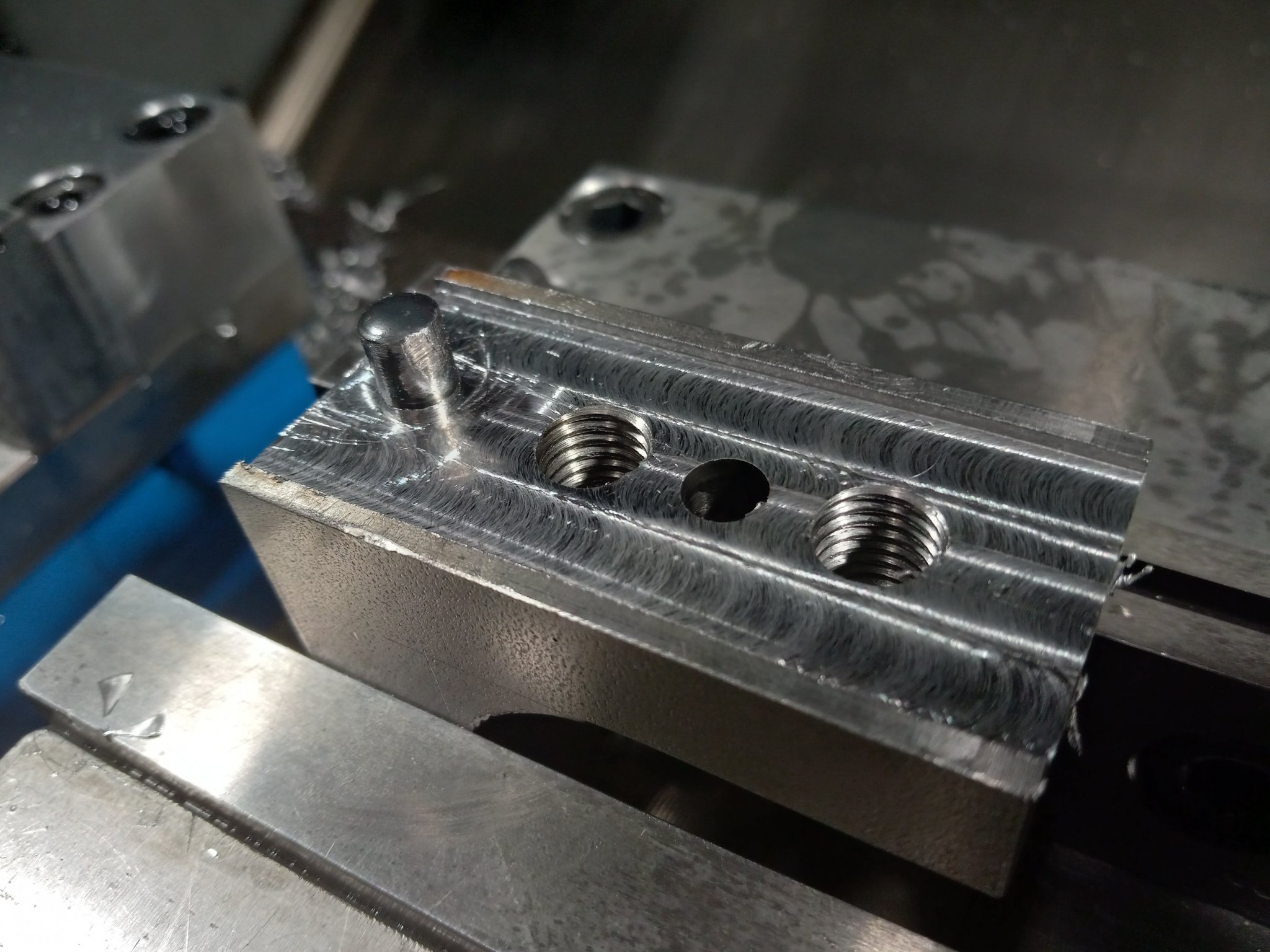

For what it's worth, the dowel was pressed before the channel was milled

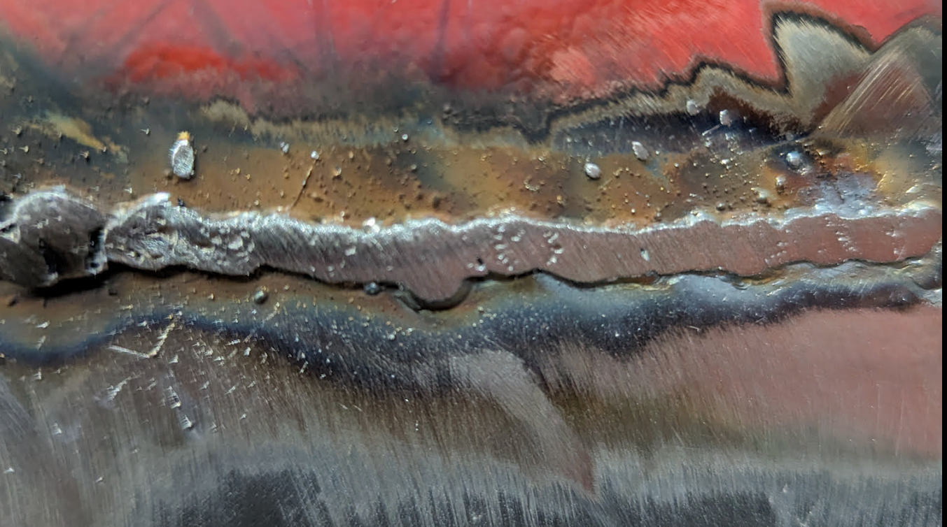

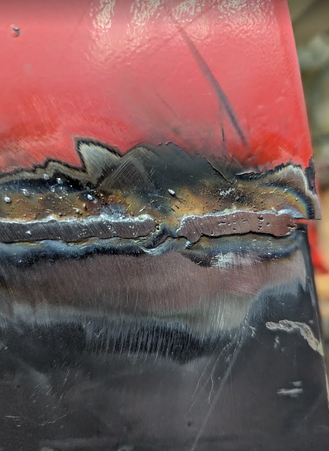

Ok collective, what do you think is going on here.
Now to sum up my welding skill. I can stick it together and it will not come apart. It ain't gonna be pretty, but it will hold.
I am finally doing something where I want it to be "pretty", This is something I have noticed working on my VW bug. I have not welded anything this thin before very often. And on the thicker stuff I never bothered to look. Weld, paint. If the paint boils off, wait a min or two and paint it again, back on the road.
This I want to be halfway nice.

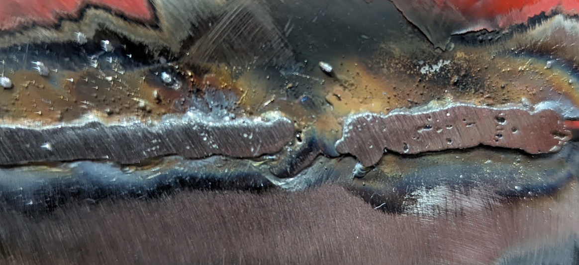

I noticed this when I was grinding down the welds. Still a bit of an issue blowing through the metal. The machine is set as low as it will go, and I am using 030 wire. I have some .025 I might give that a go and see if it helps with the blow through, but truth be told, I am not sure if I should go up or down in the size of the wire. It basically is a short, so the thinner wire will not take the current the thicker one will, so that is my logic there. The 30 spool is about dead.
Anyhoo, all that and I have these little holes I am noticing when grinding down the weld.
Any help in the why, is it a worry, this is why they invented bondo?
The machine is that new Lincoln I talked about a few pages back, you say your metal is this thick, you are using this wire, and it auto sets for you. Well with those settings I was blowing holes like crazy, so I turned down the voltage, but found I was having the wire "run away" when the arc happened....so you would get a tick, then more wire would come out, tick, more wire then you could start to go. I sped up the wire feed to the end of the "green" arc on the machine, if you stay in the green you are to be ok according to the machine. If it looks too hot, can't do anything about that, it is at its lowest setting.
I don't remember the settings, but shooting from the hip I would say 14.5v and 15 for the wire feed speed, but I would not swear to that. I can look tonight if you think that is the issue.
I am hoping wire size, and going from 30 to 25 will help.
Are you certain you have gas flow? Is it MIG mix your using?
Yes I have gas flow, if you pull the trigger you can hear it. I also got one of those meters with the little ball that will be "blown" up the tube to show just how much flow you have coming out. I THINK it is set to 10. I don't remember the scale, 10cfm perhaps. It is the same one linked a few pages back.

Welding thin material with MIG is tricky. Get some .023 wire and make sure you have the right contact tip for it, Hobart and Lincoln make good wire and run Lincoln SuperArc L56 most of the time. Run short beads and let the material cool before you lay another bead. If you have some scrap thin material, use that on getting the settings right. I like to check my settings on scrap before if welding unfamiliar material. One technique for thin material is to basically run a series of continuous tacks. Another option would be to run silicon bronze wire which requires a lot less heat.
Reactions: doubloon
10 CFH is not enough flow for MIG. If you are using a 1/2" nozzle you should be around 25-30 CFH.
Reactions: doubloon
Like Zia said 25-30 CFM, the porosity is indicating lack of gas flow or contaminated material.
Is the polarity on the machine swappable? MIG with shielding gas is electrode positive and flux core is electrode negative. The wandering arc made me think of that. Have you tried to weld another piece of material other than the bug?
I will bump up the flow rate.

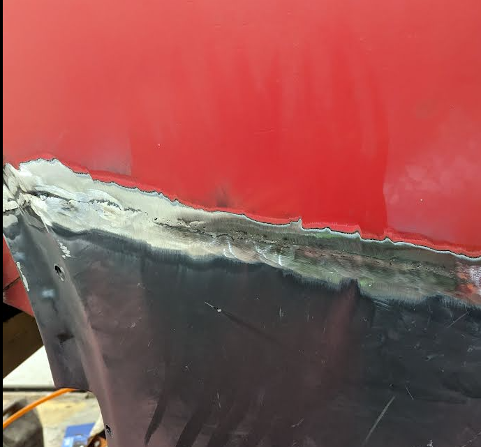

That is basically how I am doing it, just a series of dots, then connect the dots.
I am not 100% happy with it, but it is really the first weld on this car that anyone will see. It is the right rear quarter.

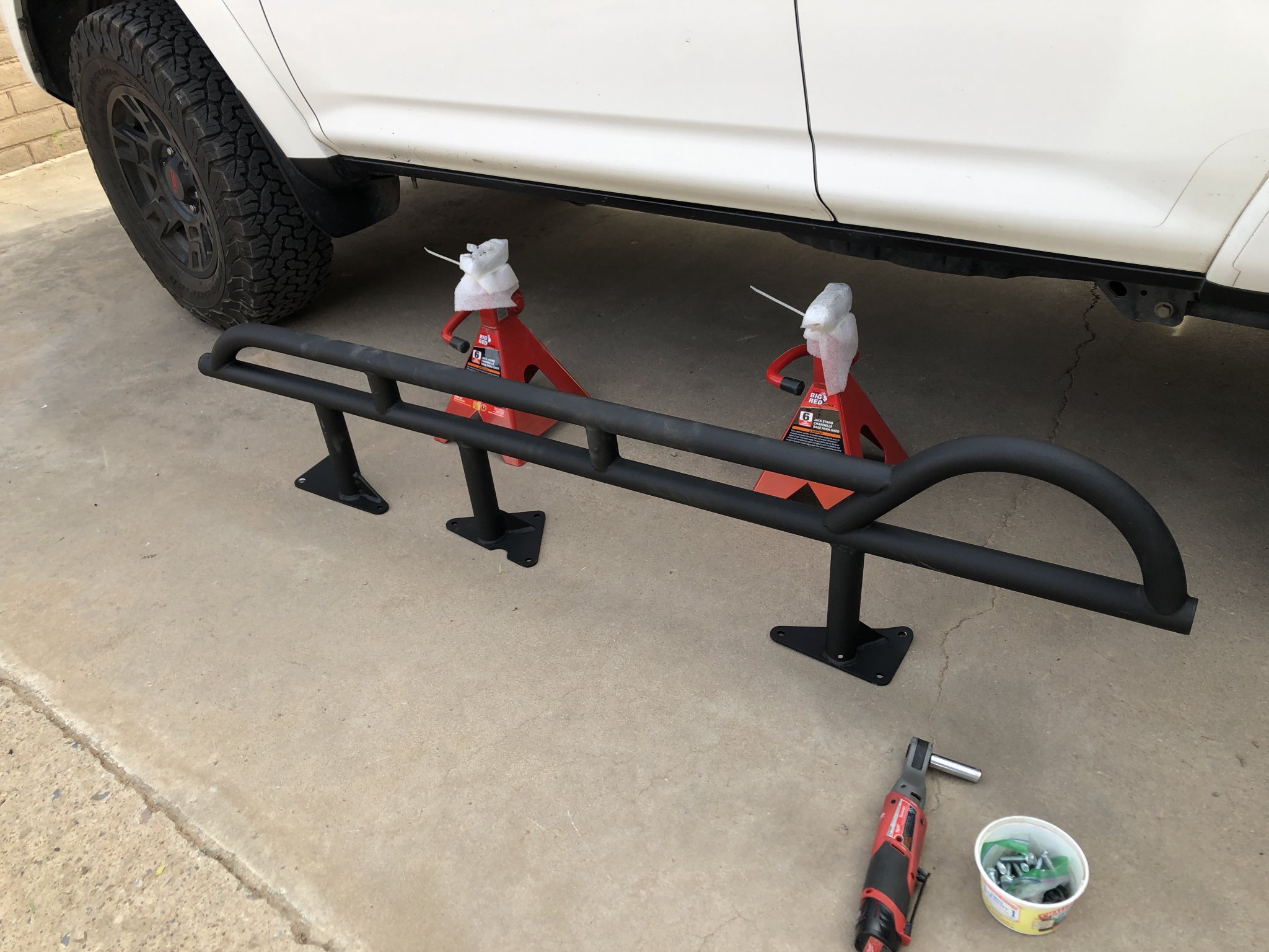

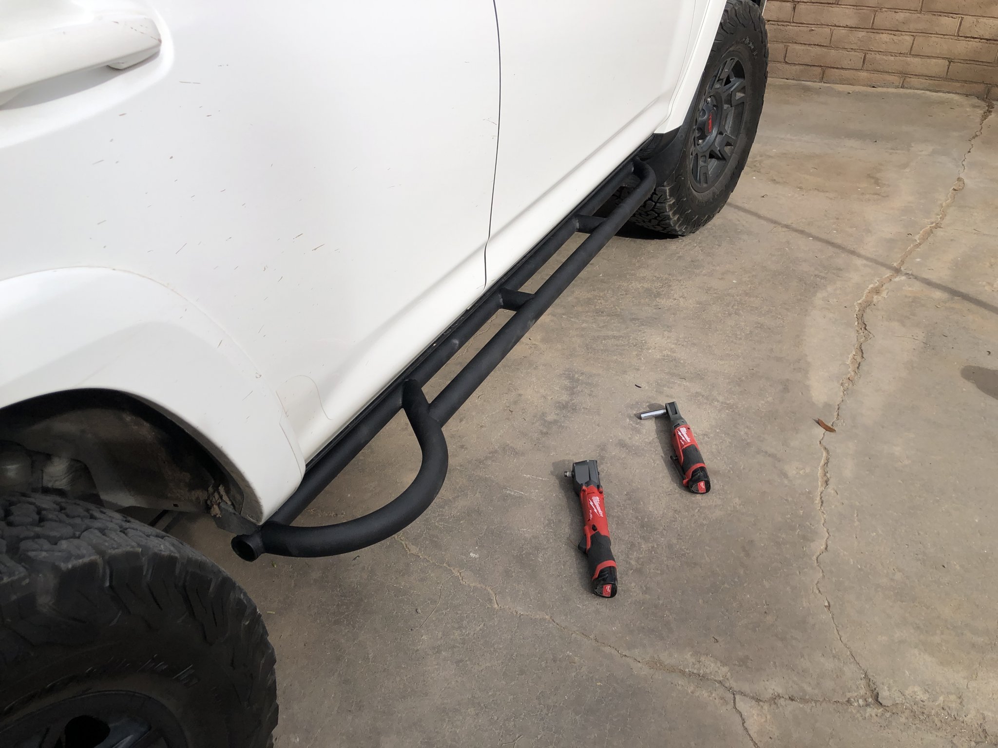

Nice! Any pics of how it's mounted. I have an unused Milwaukee portaband and a little bench saw might be a good use for it. I've seen a couple of kits but never pursued figuring I could make one.
The main means of support is a bar that clamps onto the saws bumper. The studs are welded to the plate. The set screw shown bears against the saw casting as a adjustment point to square the cutting edge to the plate. There is also a small tab on the underside of the plate in the middle of the curved cutout area that fits into the air vent on the saw. Getting that to fit right was the hardest portion of the build.

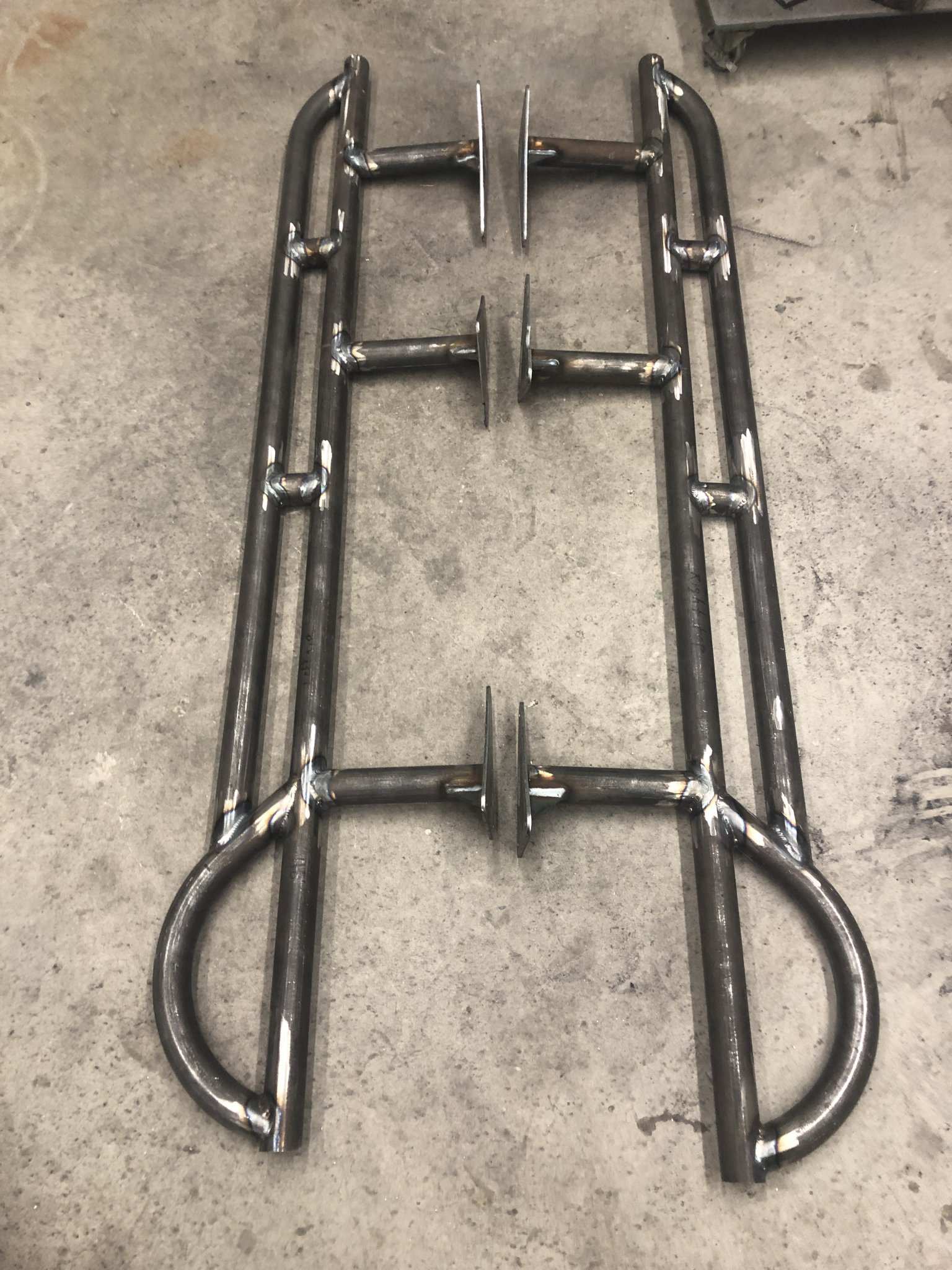

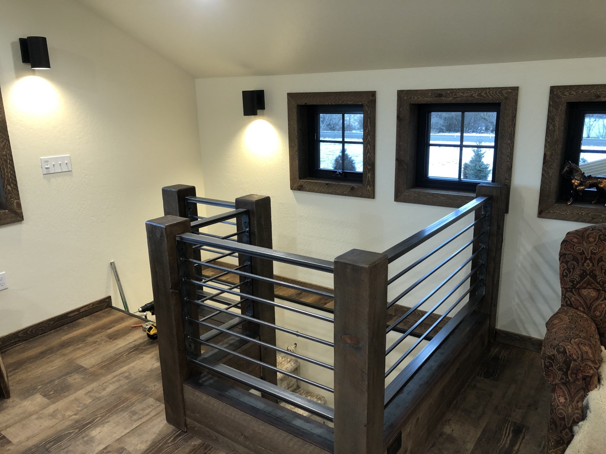

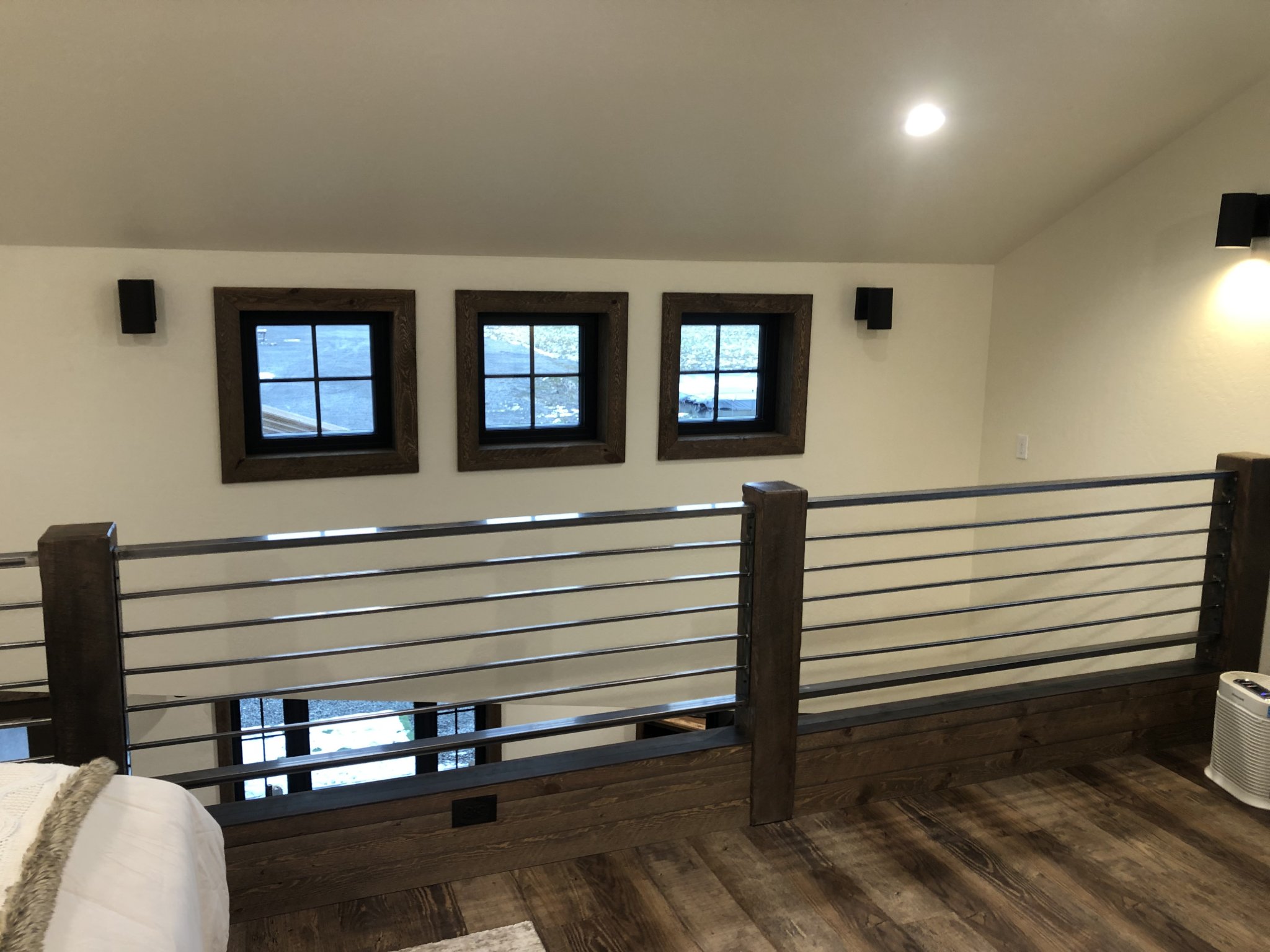

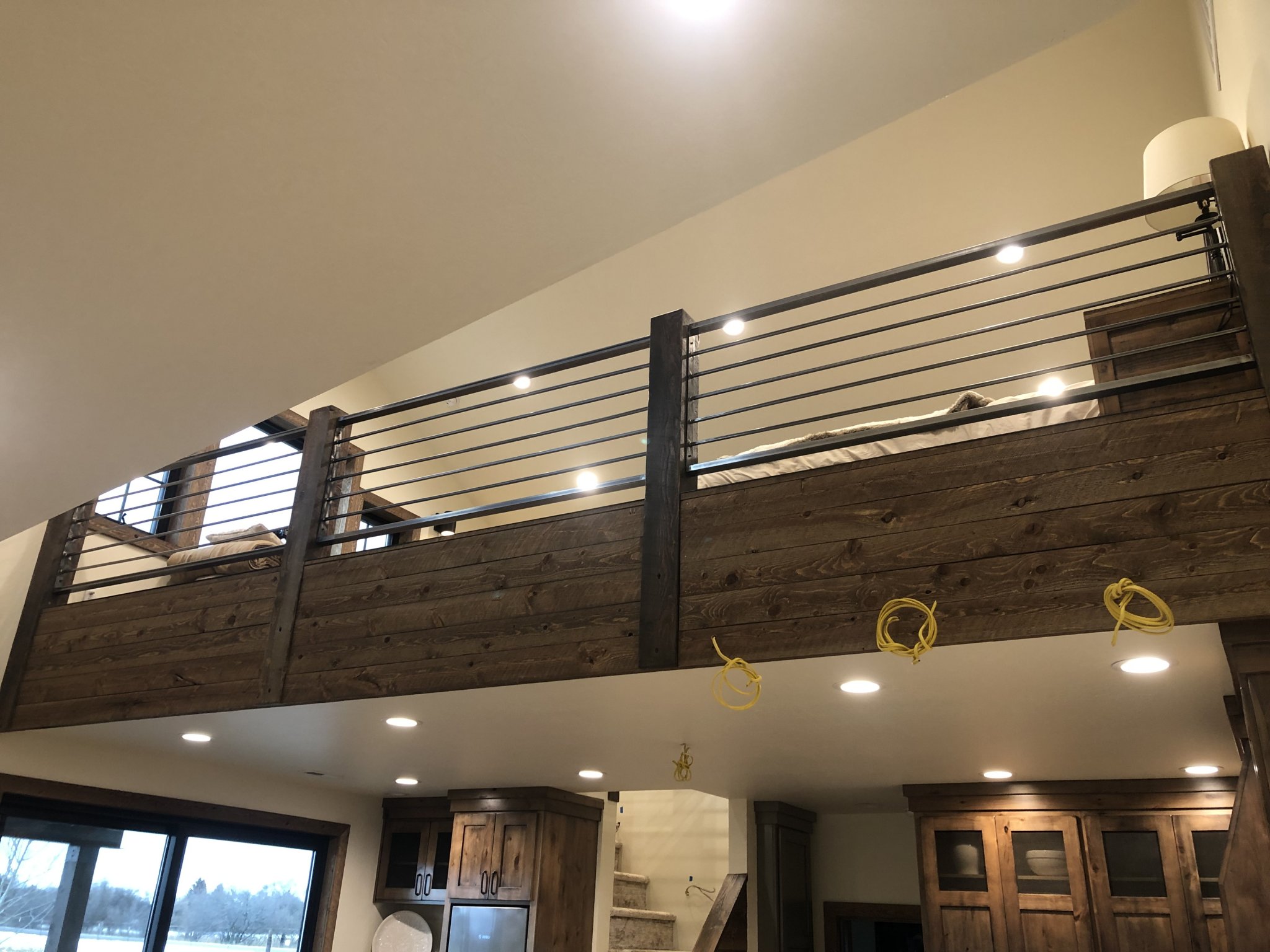

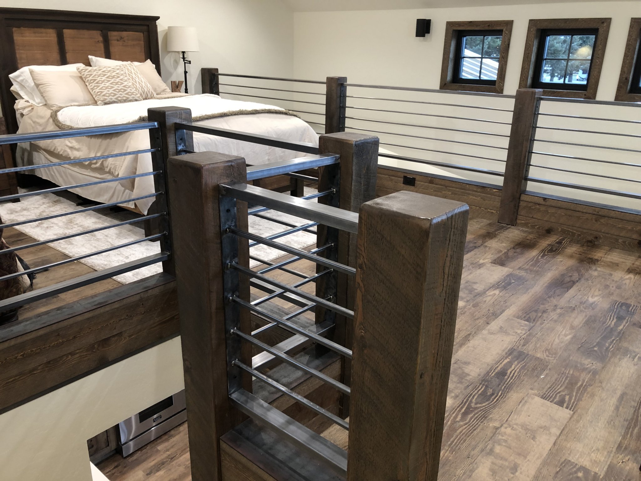

Finally got around to doing the handrails at our place. Turned out pretty ok…
When the wire is thicker than the metal you're welding, the metal heats up faster/first and blows out.

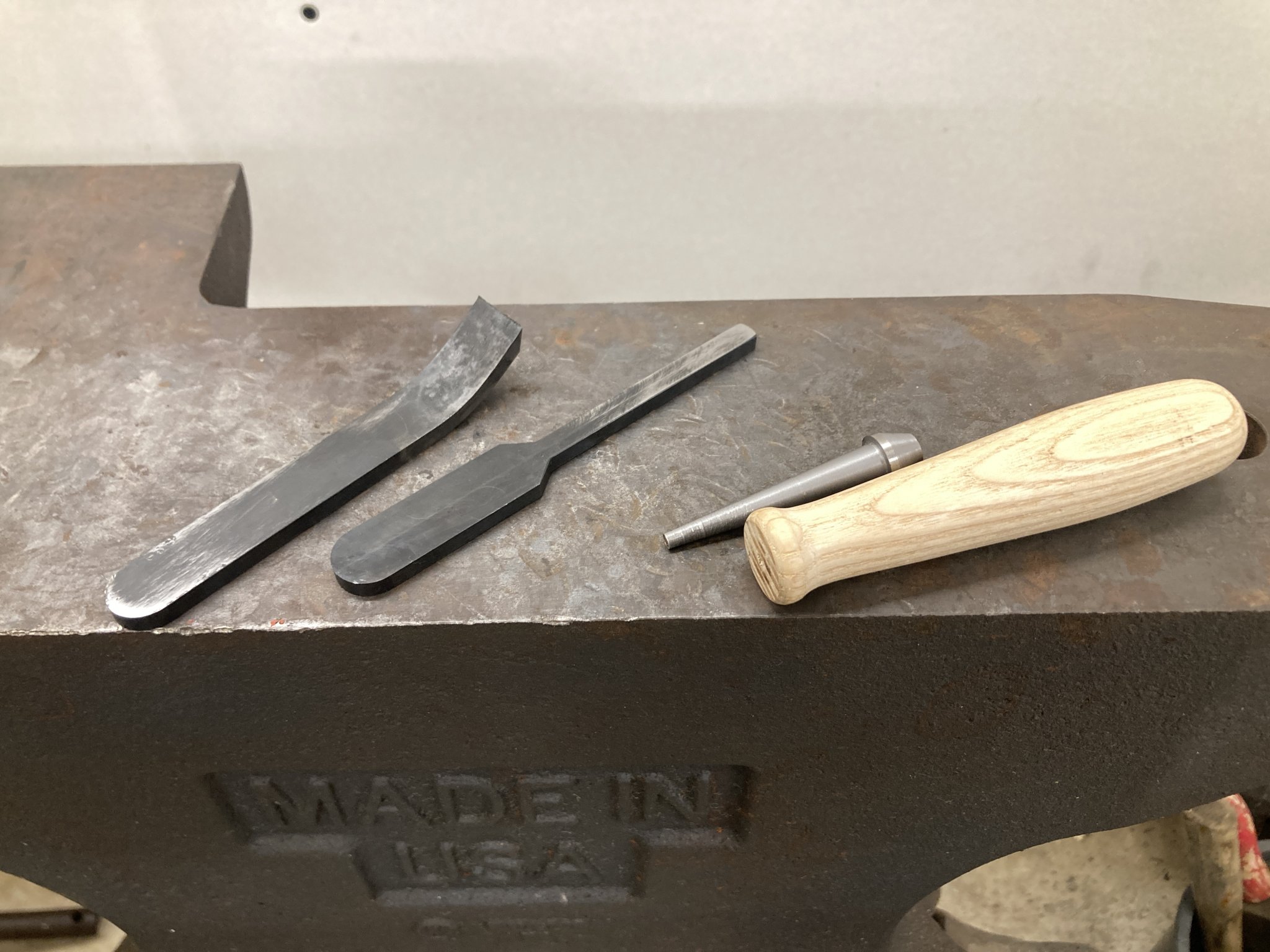

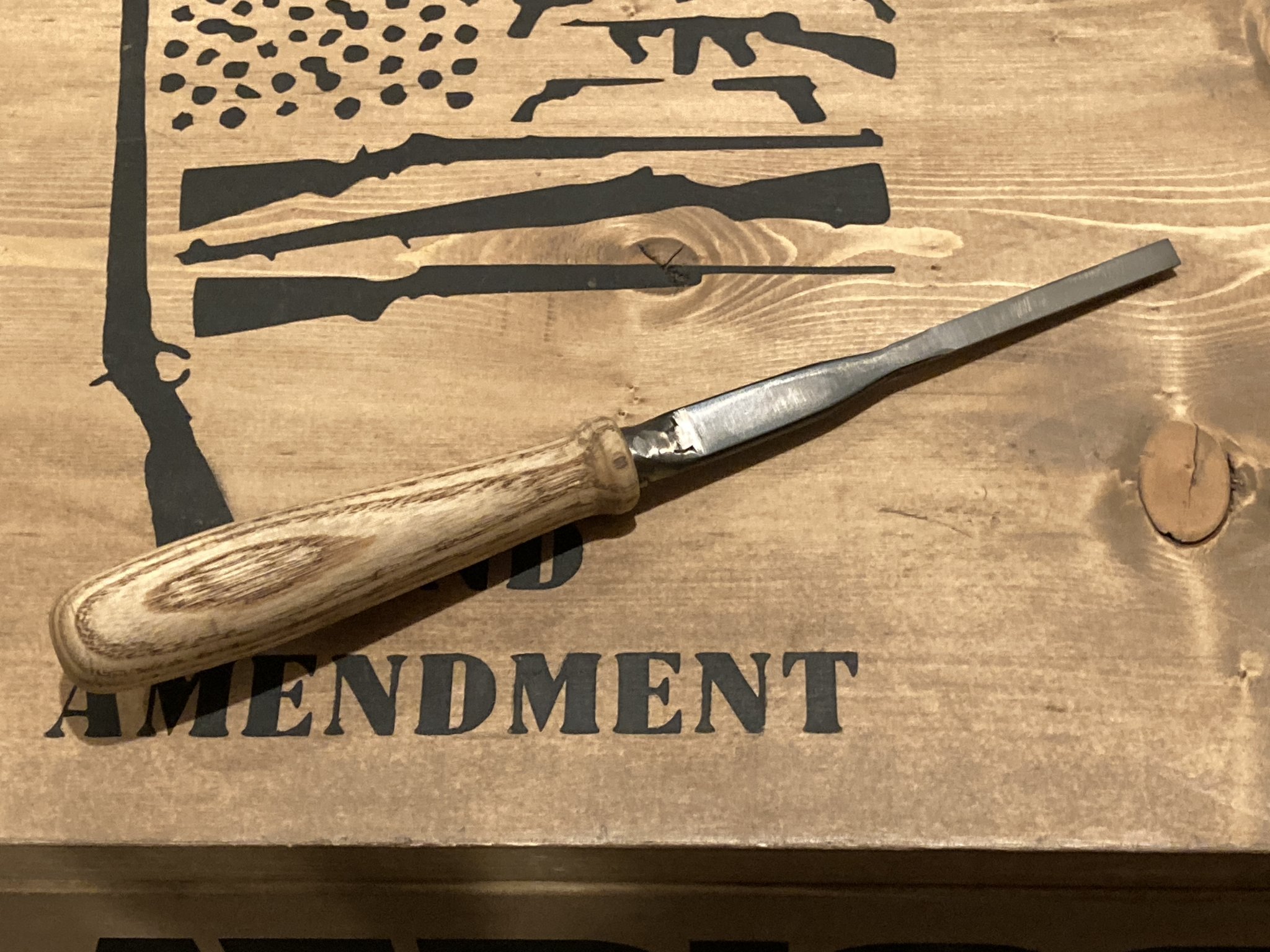

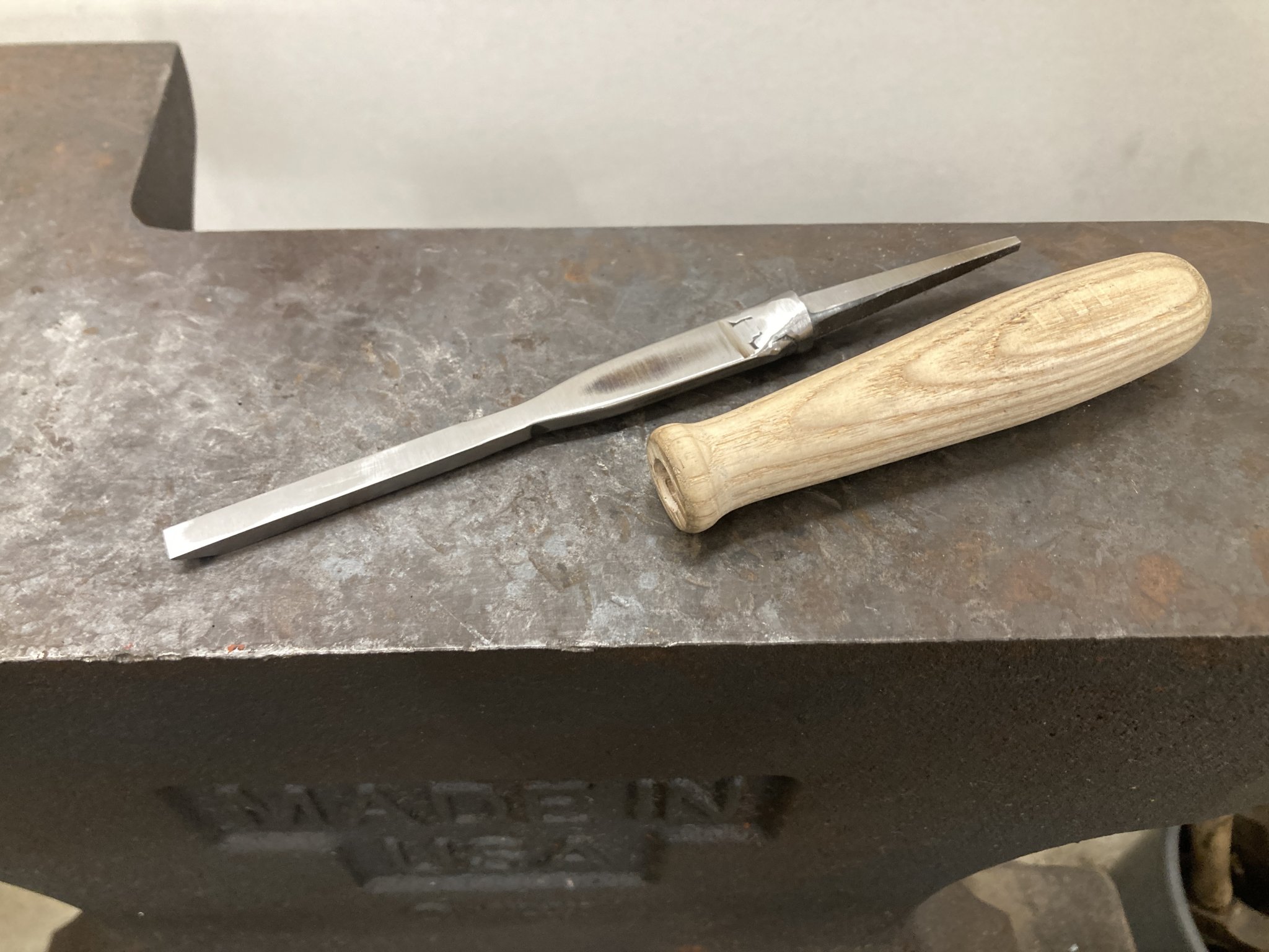

my first chisel.
A little crude in some aspects, and far from perfect. But I believe it will have a good edge.
A2 steel hardened between 58-60rc, hickory (I think) handle.
The piece of steel I had for the chisel was a scrap and too short to make a decent tang, so I made a tang from 4140 and welded it on, then tempered the welded section. Unfortunately I didn’t weld it exactly straight. Rookie.
If it works ok I’ll get longer material and it will be one piece.
The boss wanted a 1/4” chisel that held an edge better than the stuff he has for making bows and repairing violins. So I’ll sharpen this up tomorrow and put it to the test. I’ll update in the future how it holds an edge.
Critique, ideas, and pointers are always welcome.

View attachment 8360892View attachment 8360893View attachment 8360894
A2?
You do know that A2 is "air hardening" right ?
That's why the A is there.....W2 (water hardening).....O1 (oil hardening).
Did you quench it in *some odd* liquid or another ?
If so....toss it and start with something better like O1 or M2, both are ideal for chisels.
A2 is used in car frames (yup) and stamping dies for the most part and is not really a cutting steel like what you're needing.
