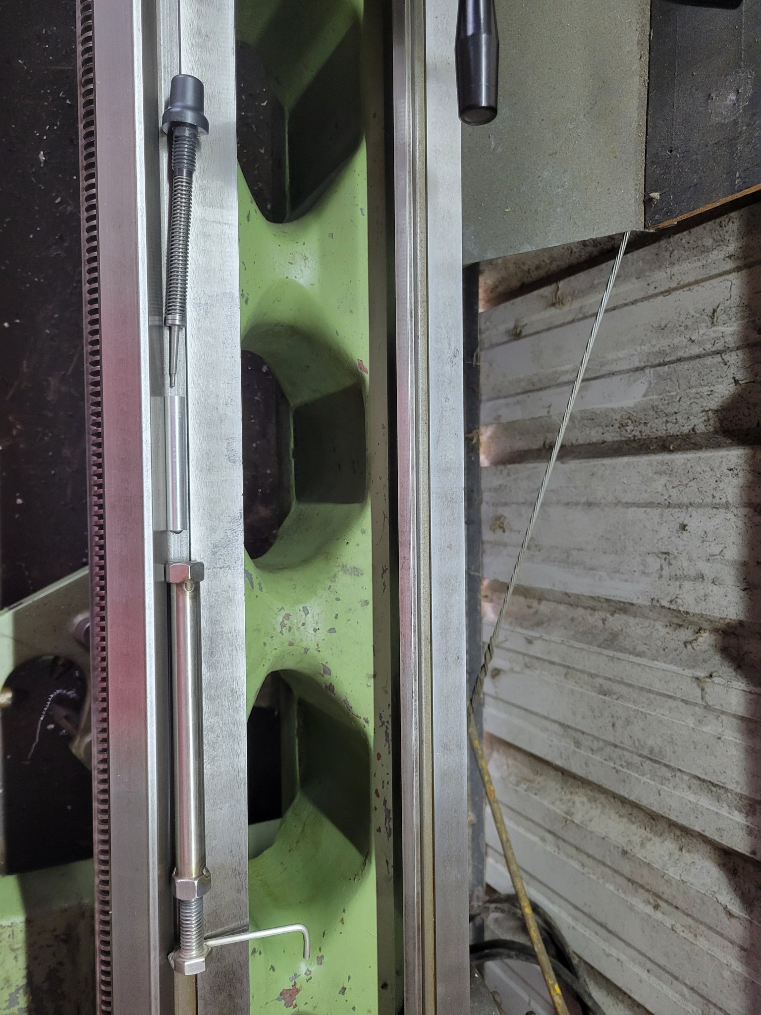

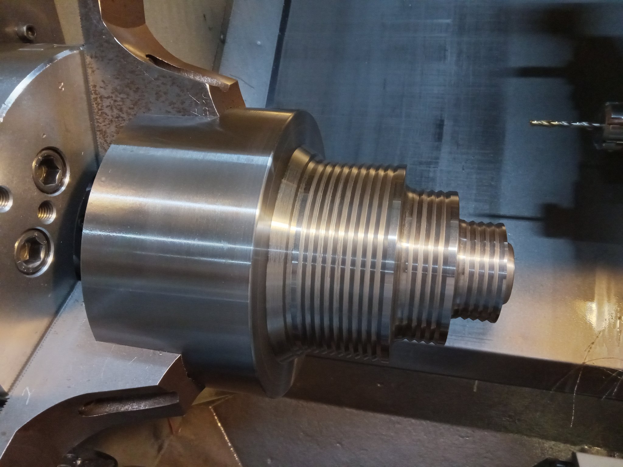

Calling all guys who run CNC machines, I need some advice: I need to re-caulk some joints inside my mills as the coolant has eaten up what is in there. I have used RTV and a number of different sealants over the years. It will last about a year and then degrades to failure. Im currently using Percool 5440 as coolant.
Any advice will be greatly appreciated.
Oil based coolant or water?
One idea is Sikaflex, building supply store should have it.
Or else the black urethane stuff that they glue windshields in with. Auto parts store should have it.
Reactions: lariat
Oil, semi-synthetic.
Another we use when reassembling machines that use straight synthetic oil coolant is Stucarit 309.
Or sometimes called Dicht Gel.
But that’s more for a layer between two parts, like a non hardening gasket.
There was a German brand of caulk also but I’ll have to send an email to try and figure out what it was.
Reactions: lariat

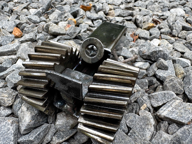

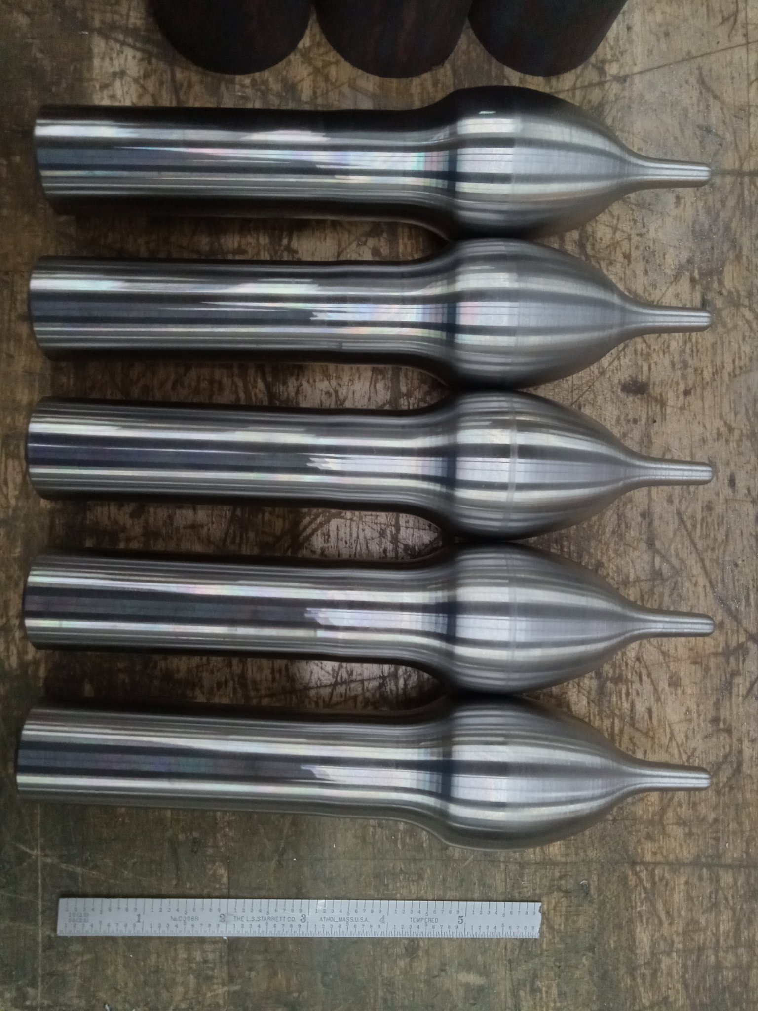

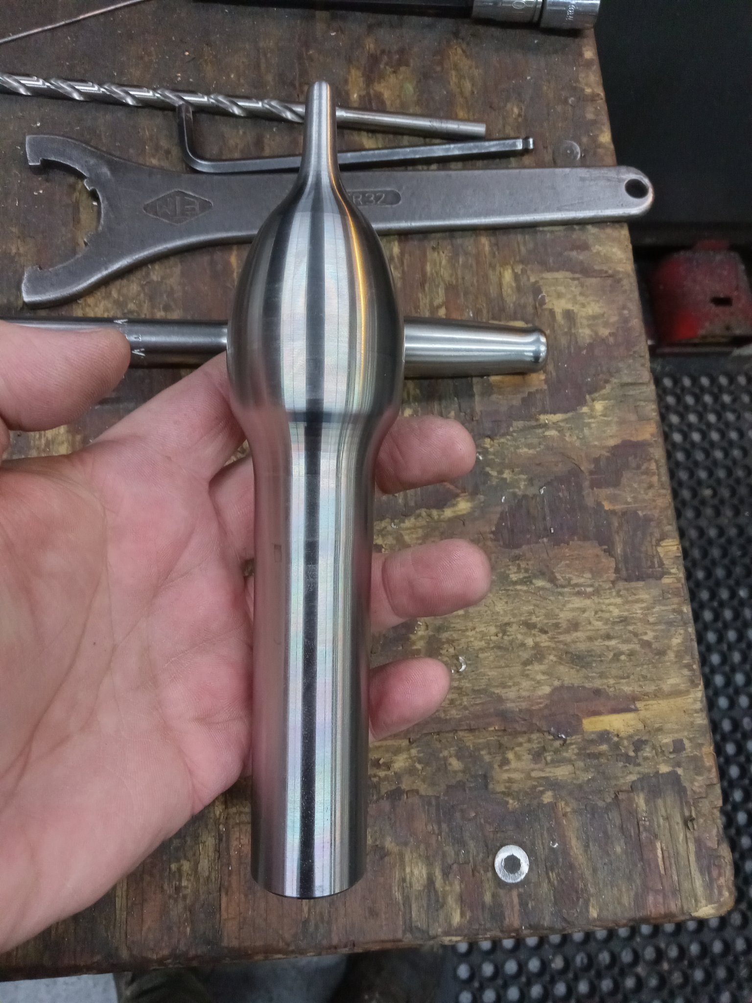

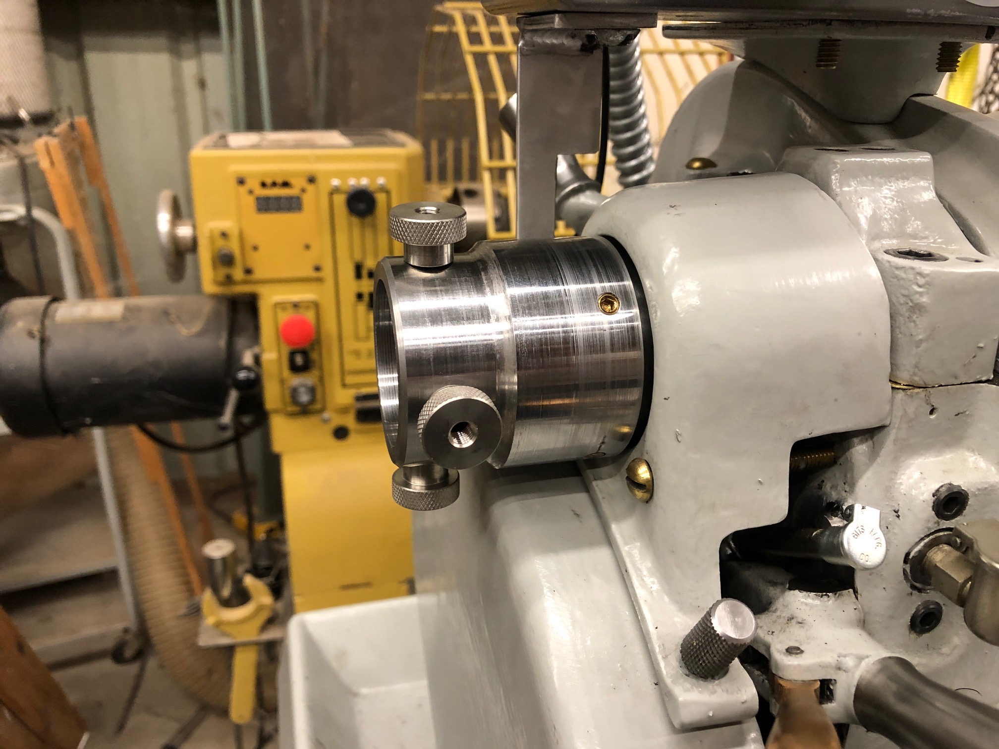

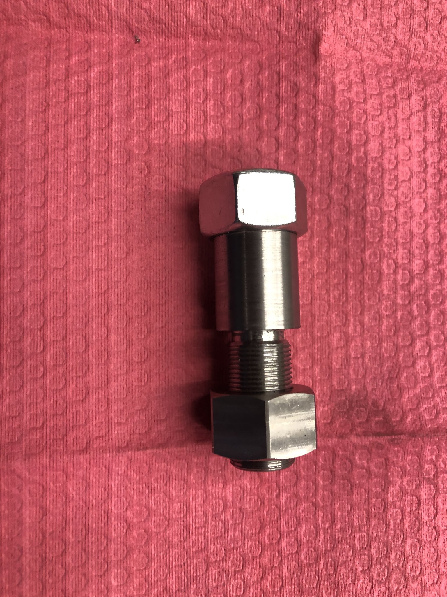

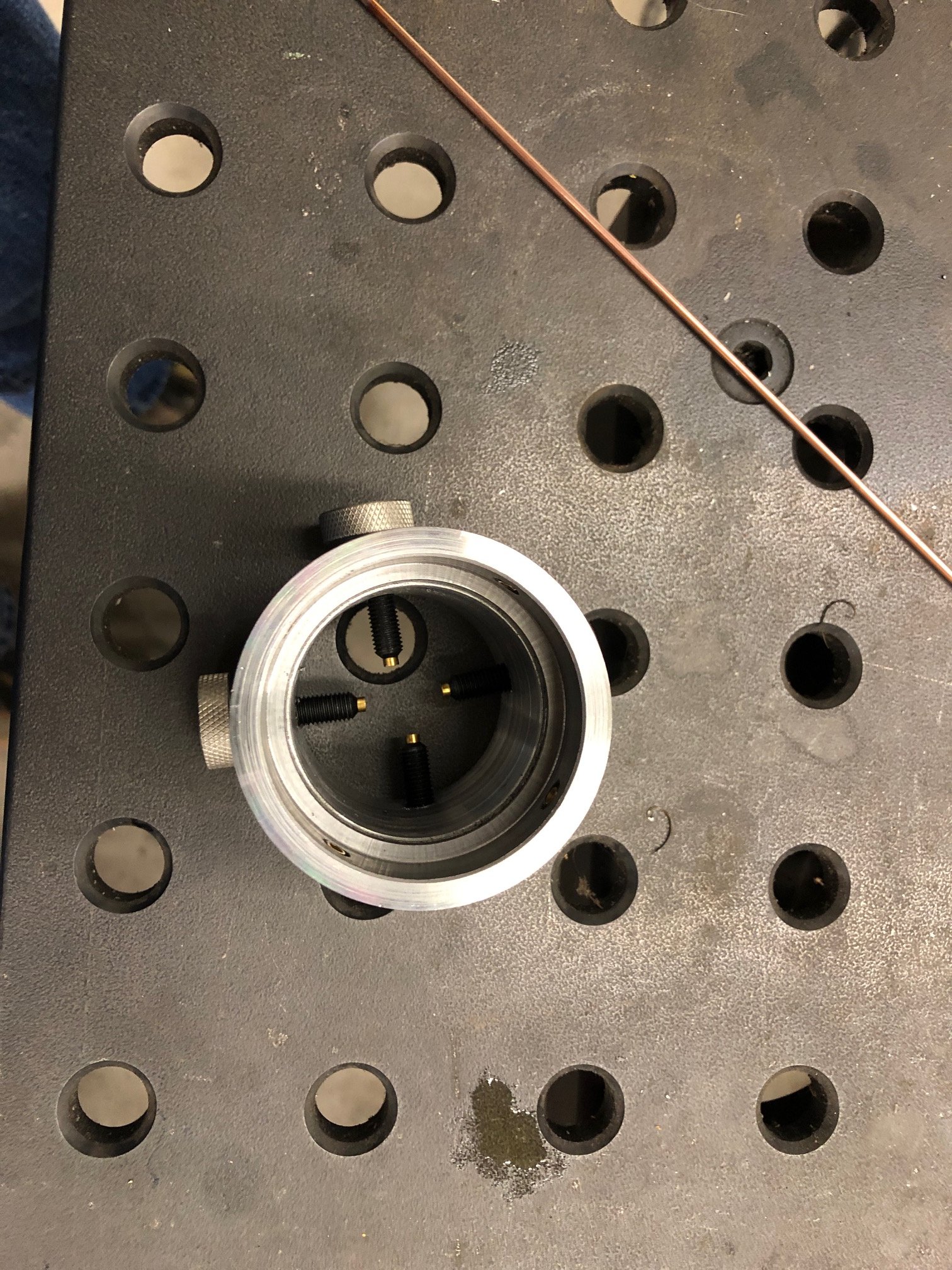

Needed a spider for my SBL 10L so made this the other day.

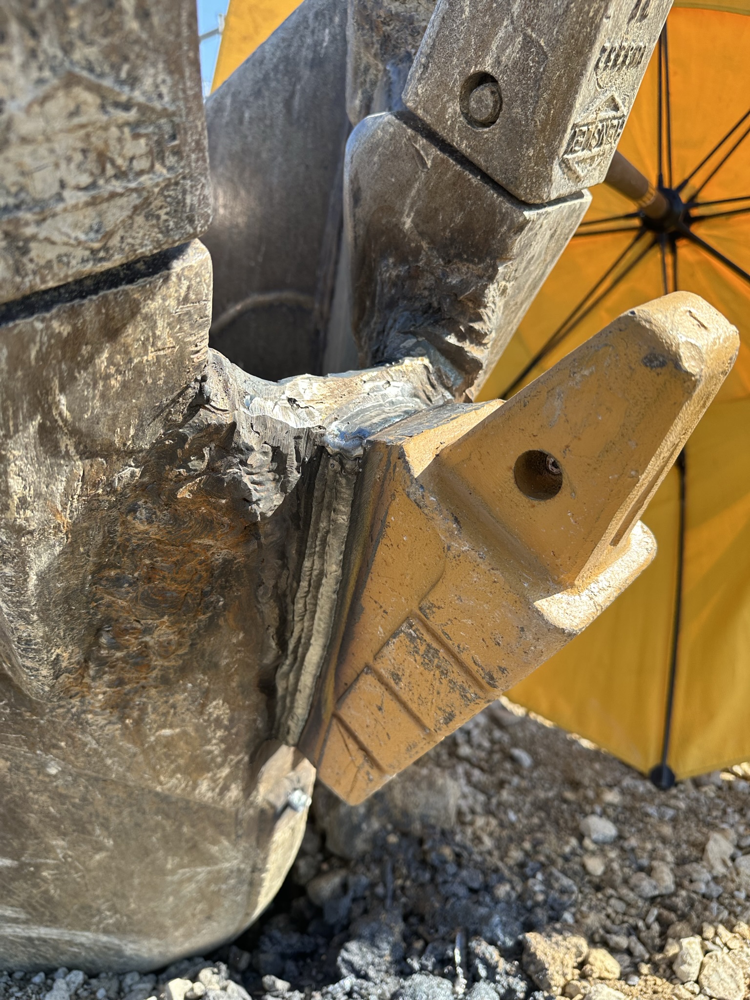

What are those teeth designed to work on?

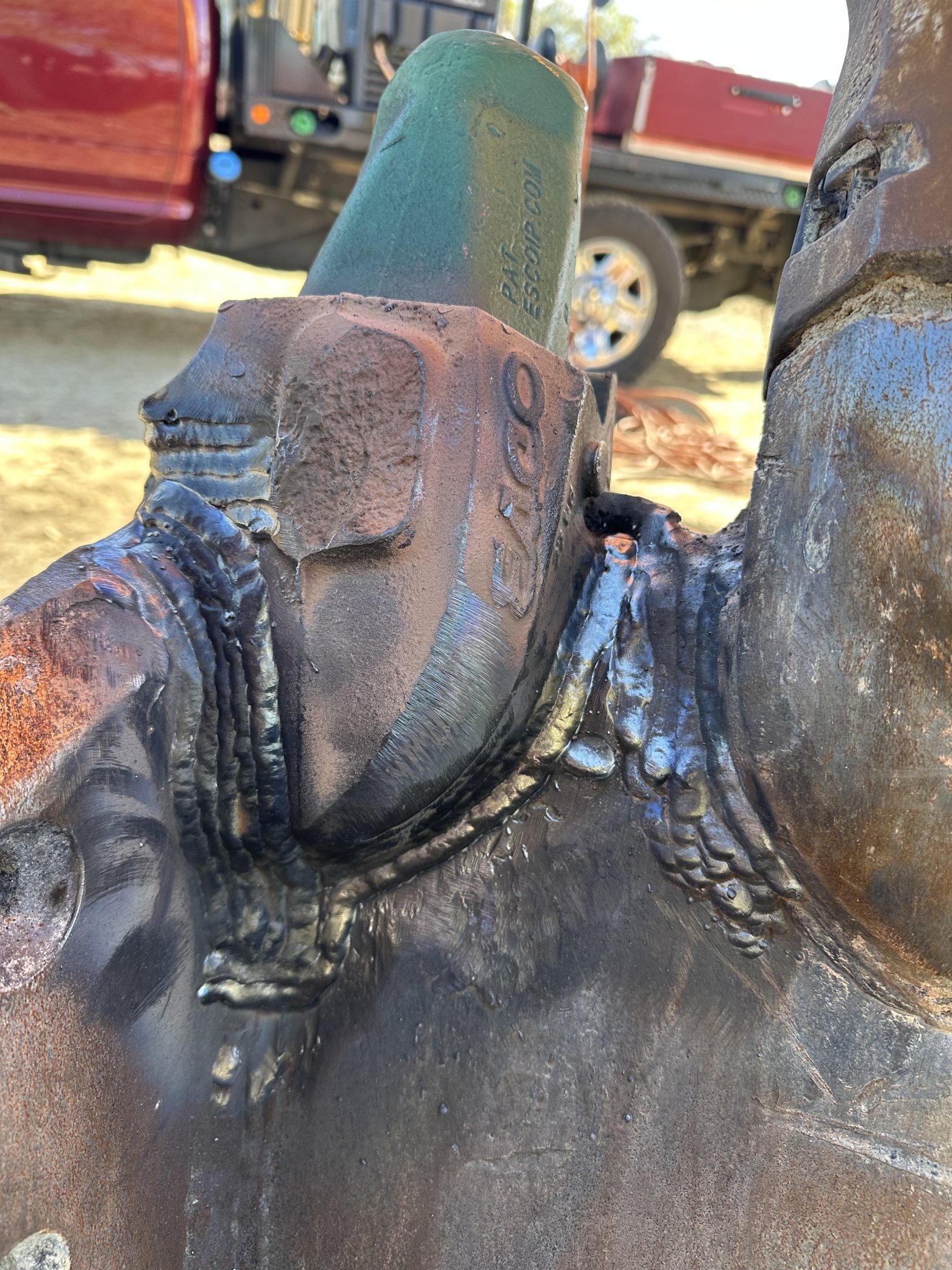

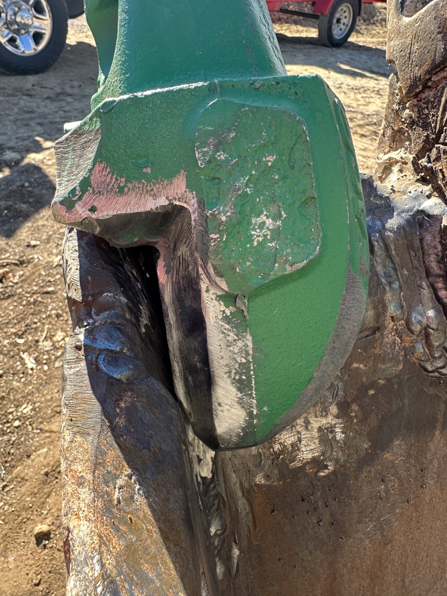

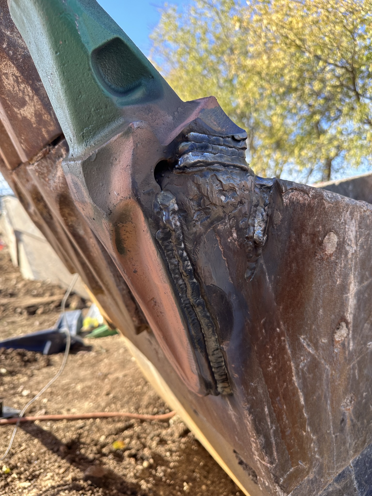

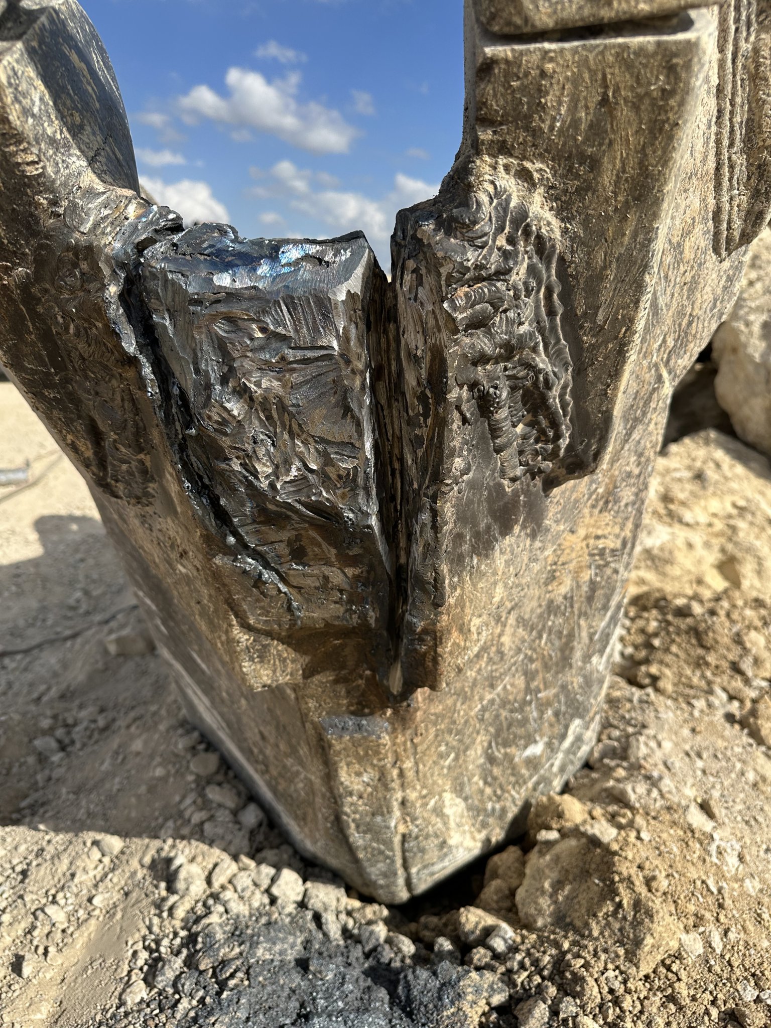

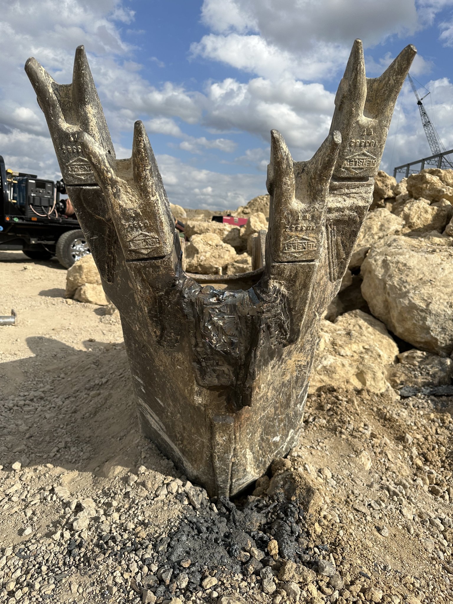

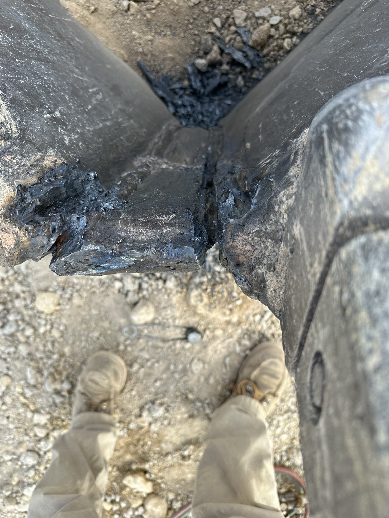

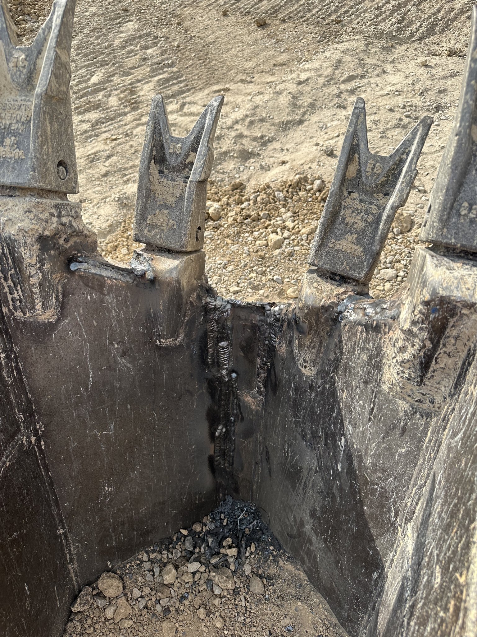

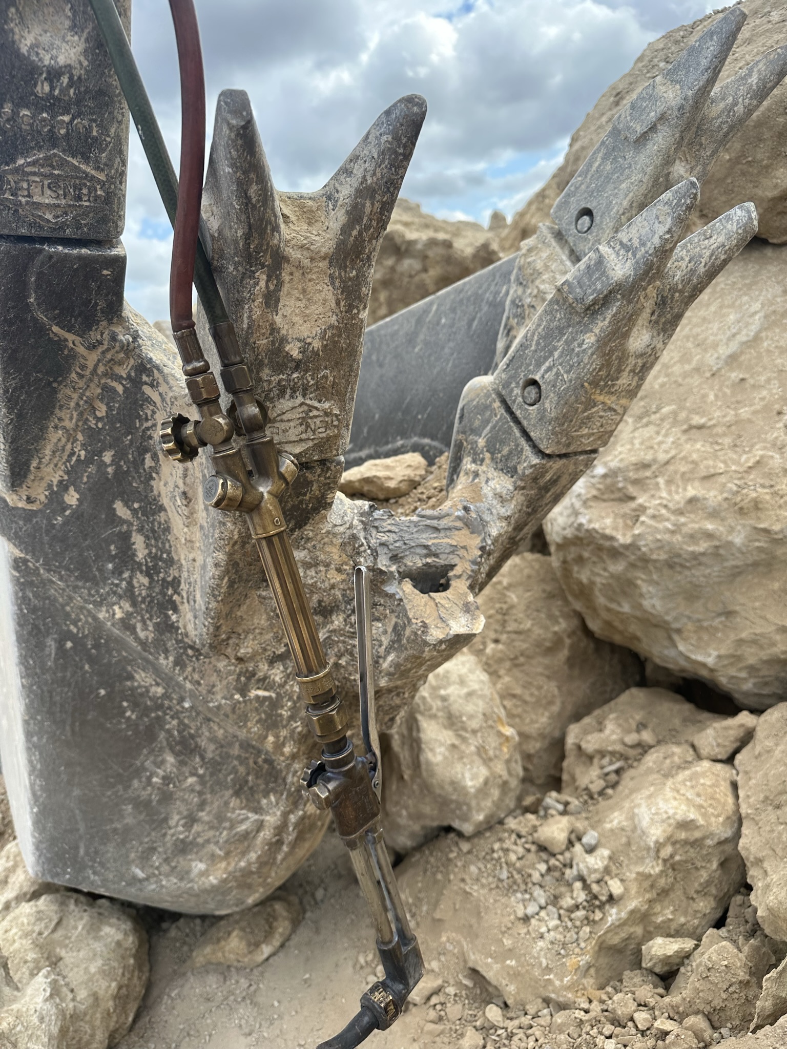

Rock, poor fellas have been digging nothing but solid rock on this job. They are breaking shanks left and right over there. I’ve done a pile of em.

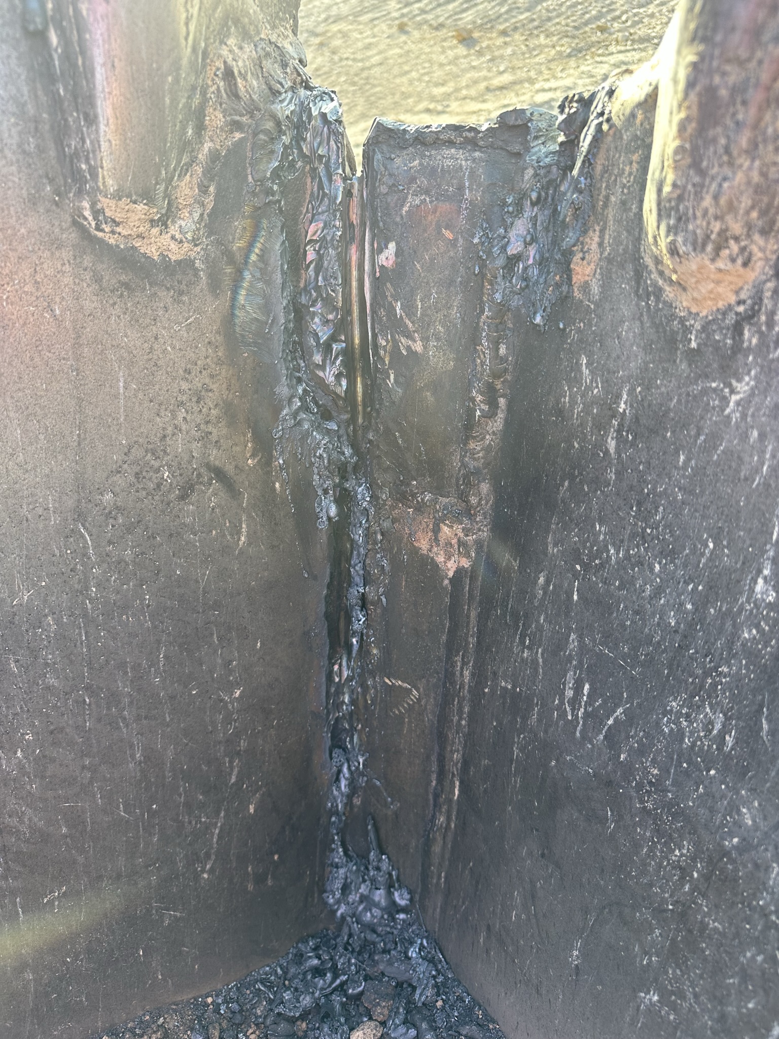

490 komatsu rock bucket, crack in the bucket is probably 18” long and all the way through the bucket. Material thickness is 1.5” or so. Getting the old center shank off was a PITA. never could find the weld fusion line when i gouged the old weld off that held the shank on. Ended up just washing the entire shank off with a scarfing tip, hence the rough finish on it. I smoothed it all out before putting the new shank on. Lots of old shitty weld on these buckets from the previous welder. Ignore the shitty welds. Mostly the reason I’m having to fix all these again. By end of this job I’ll probably end up replacing every shank on every bucket on this job. These messkins runnin the equipment would rather use the bucket as a hammer than using the actual hammer.

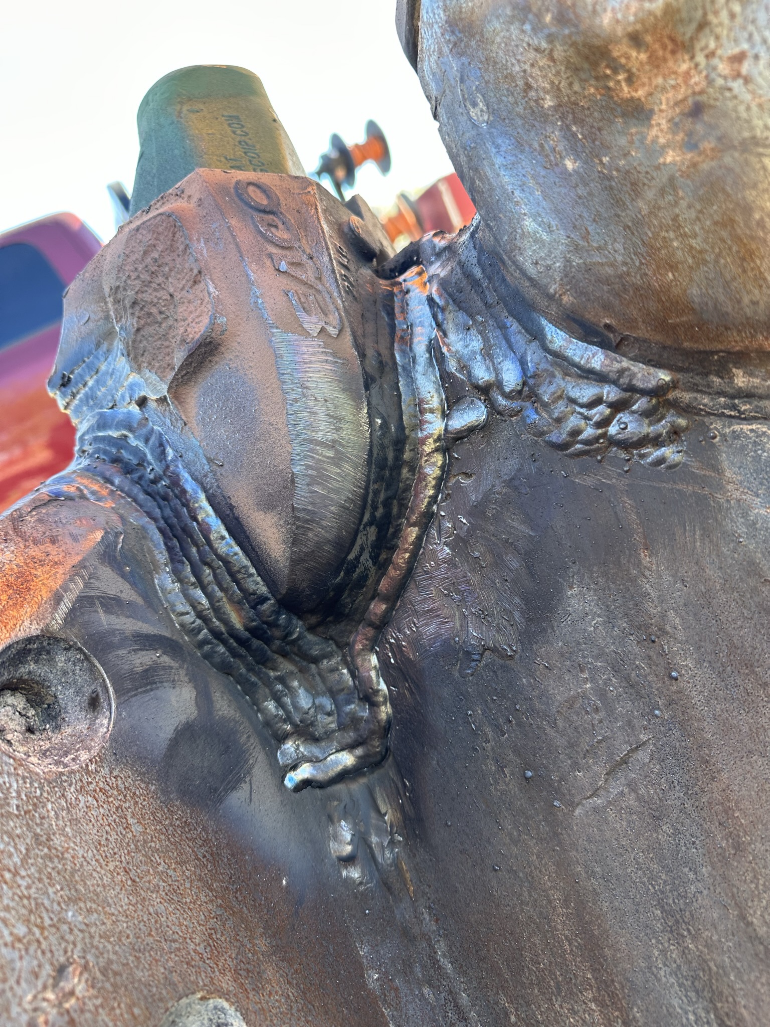

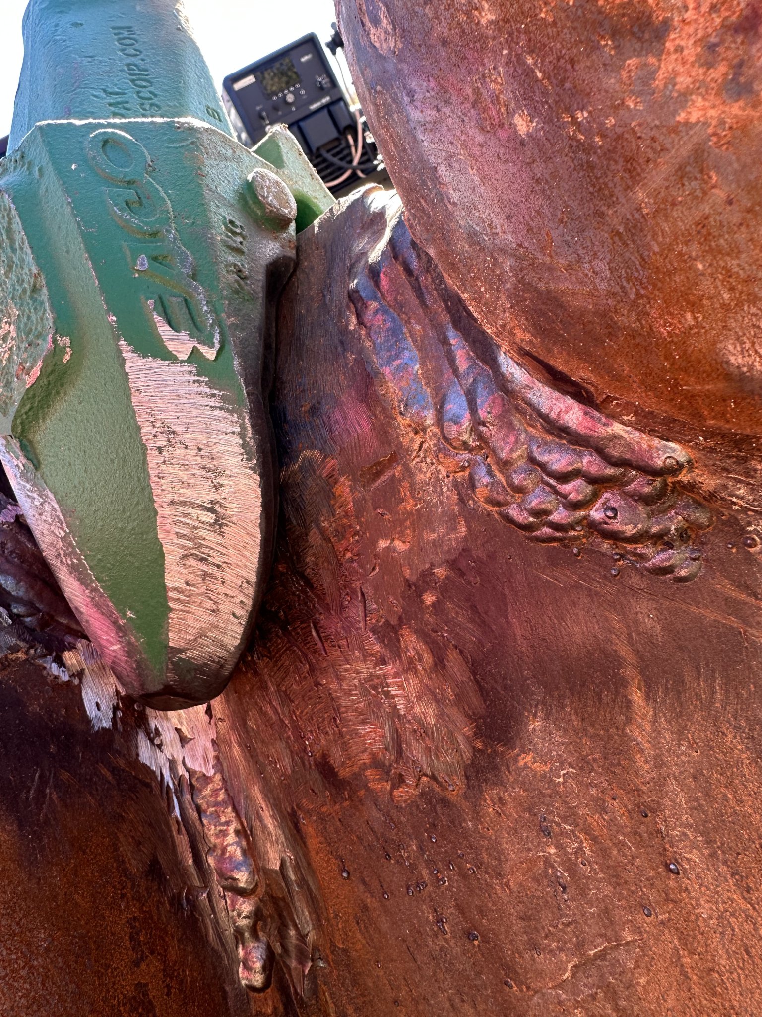

Gouge out 80% of the crack from the front, weld it up, backgouge on the back side til you are completely into good new weld metal and crack goes away. Clean it up and weld for 100% penetration of the crack.
Same machine/wire/settings as posted earlier
View attachment 8563223View attachment 8563224View attachment 8563225View attachment 8563226View attachment 8563227View attachment 8563228
Miller trailblazer 330 efi
Ln25 pro wire feeder
Esab 710x .045 wire
28v @350ipm
Preheat shank to 600, preheat welding area on bucket to 350.

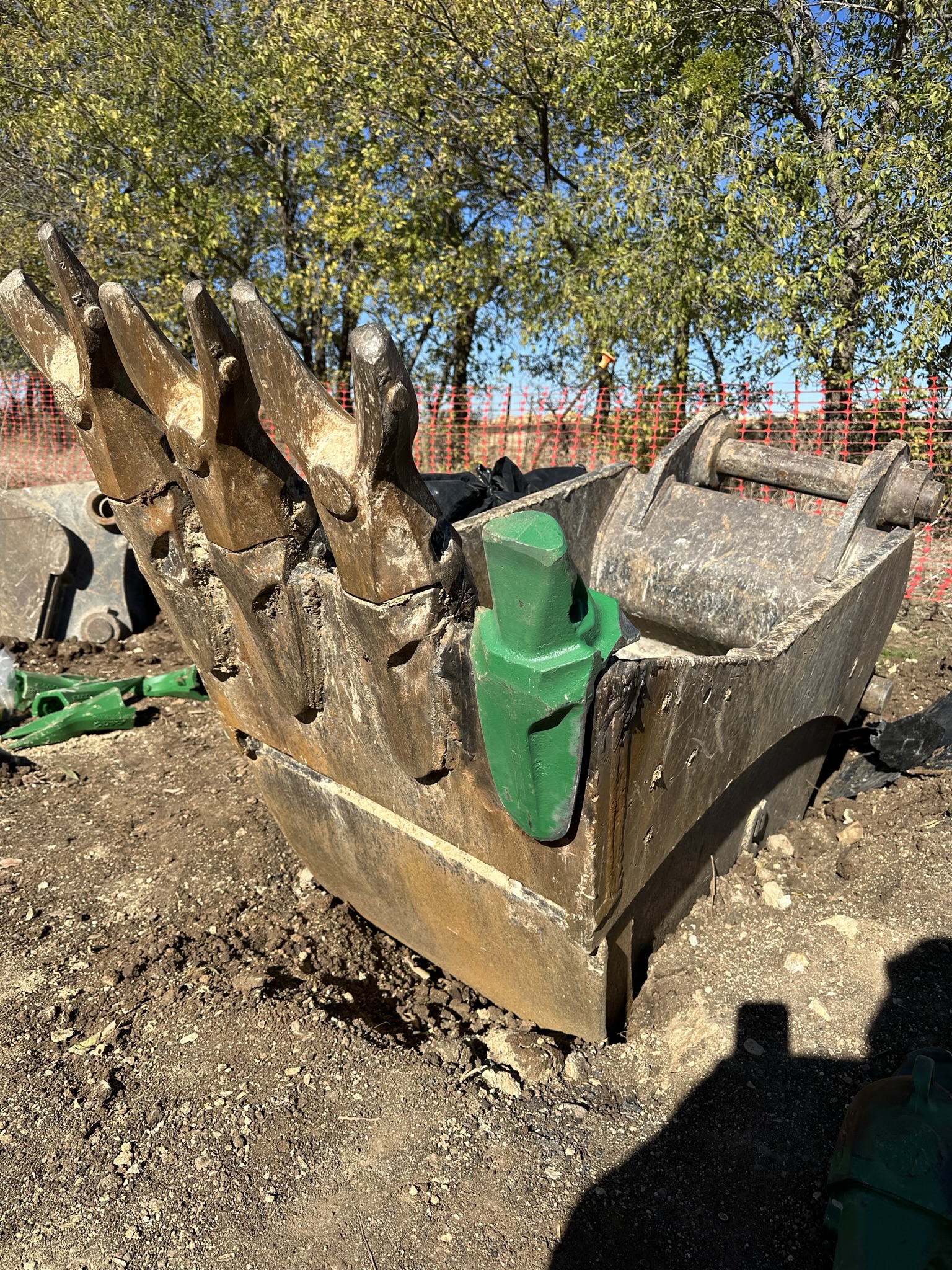

I was a welder for around two years, welded all kinds of equipment and did a shit load of fabrication.
A small amount was field work but most was done in a very massive shop that had large overhead cranes with multiple
trolleys where no expense was spared on equipment.

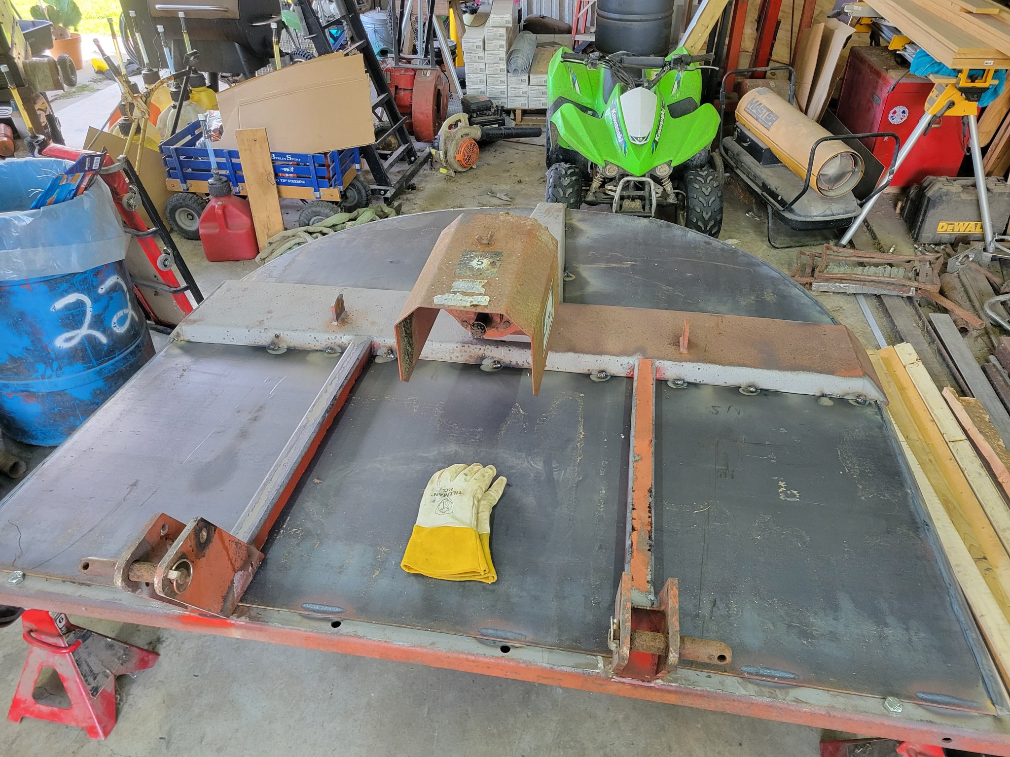

Now I need to replace the cutting edge and the tooth adapters on my small excavator and man doing
that shit in the field in the dirt sucks ass.
Boy was I spoiled.
Boy was I spoiled.
Yea it would be nice to able to flip those buckets around and weld as much stuff flat as possible, but it’s not really in the deck of cards. Welding the inside of the center of that rock bucket wasn’t super fun. Leaning over the sides of it to reach for long periods of time kinda blows. I’m working on getting my air compressor running again so I can run a carbon arc gouging again instead of using the torch.
View attachment 8563280View attachment 8563287View attachment 8563281View attachment 8563282View attachment 8563283View attachment 8563284View attachment 8563285View attachment 8563286
Looks like you probably had as much time or more time in the prep than the actual welding.
An ARC gouger would definitely be better for that job. Hard on machines though. ¼" rods probably wouldn't put too much bind on the little miller.
We do a lot of gouging in my line of work on furnace tubes. Single hand though so we wear out rentals. Usually 500 Amp machines and ⅜" rods. I got to use a big blue 800 one time. It was like wielding a light saber! I hate gouging heavy material with a 300.
Reactions: 458win
For sure. Welding is usually the easiest part of the whole job. Especially running wire, you can lay down a lot of weld very fast. Takes a lot of time to gouge off all the old shit, make sure the cracks are all the way gouged out, cleaned out, prepped, and preheated. Hell, a cold bucket takes damn near 45 min just to heat the thing up before welding. Them big rose buds will burn through some tanks in a hurry.
Okay so I always hear that gouging is hard on machine, someone is going to have to explain to me why though. Running wire I’m running at a constant 200 amps. Why is a 1/4” carbon at the same amperage harder on the machine?
The constant hard heavy loading and unloading on a machine is hard on the windings and the brushes in the generators.
Staying on the conservative side with the size of the rods helps tremendously.

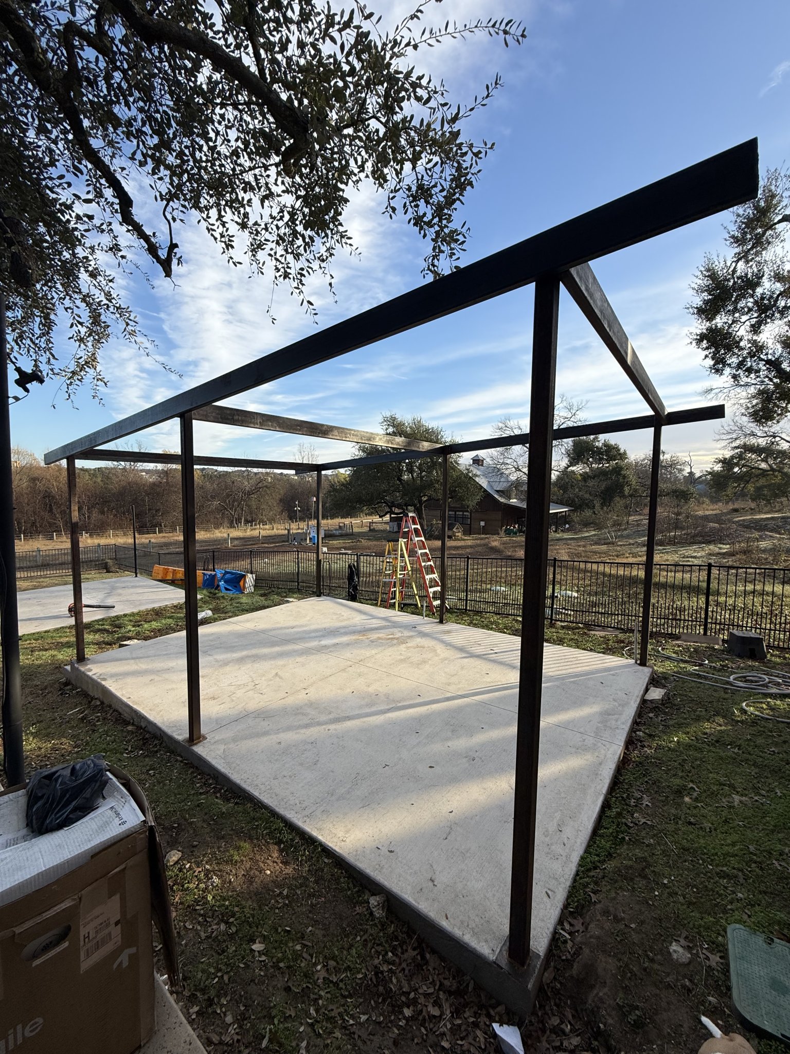

Friend with a sign business asked me if I could build the sign frame for a farm in the Uvas Valley and wound up being a Thanksgiving break project. . Just conceptual drawings and had to figure out how to put it together so it be transported. 10' 6x6 11ga square tubing connected with 108" 3x3x1/4 angle and bolted to clips. The sign face will be 11ga plate. Not particularly difficult but just damn heavy moving it around by myself.
