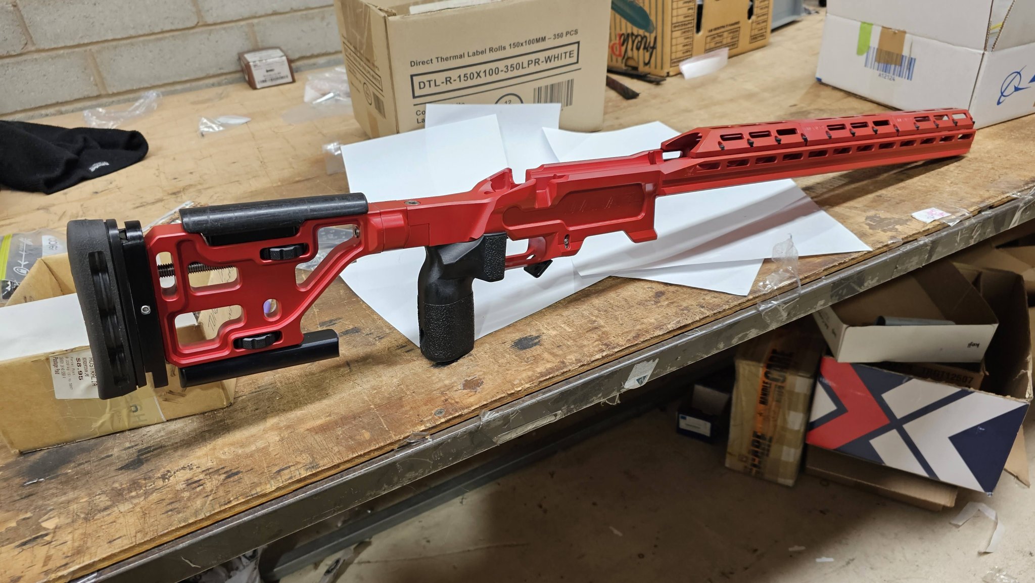

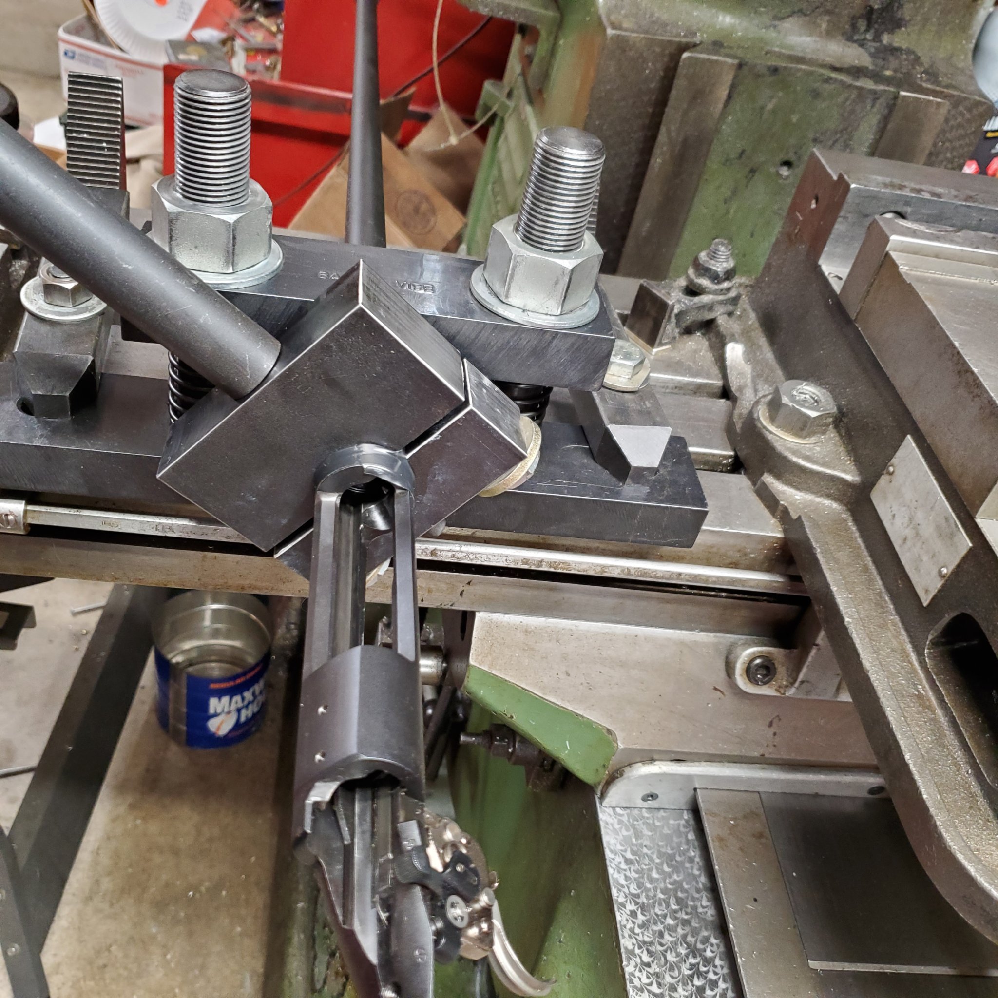

Metal working? I prefer machine tools, only welding if I have to.
Lathes and Bridgeport milling machine fits my gun hobby perfectly...

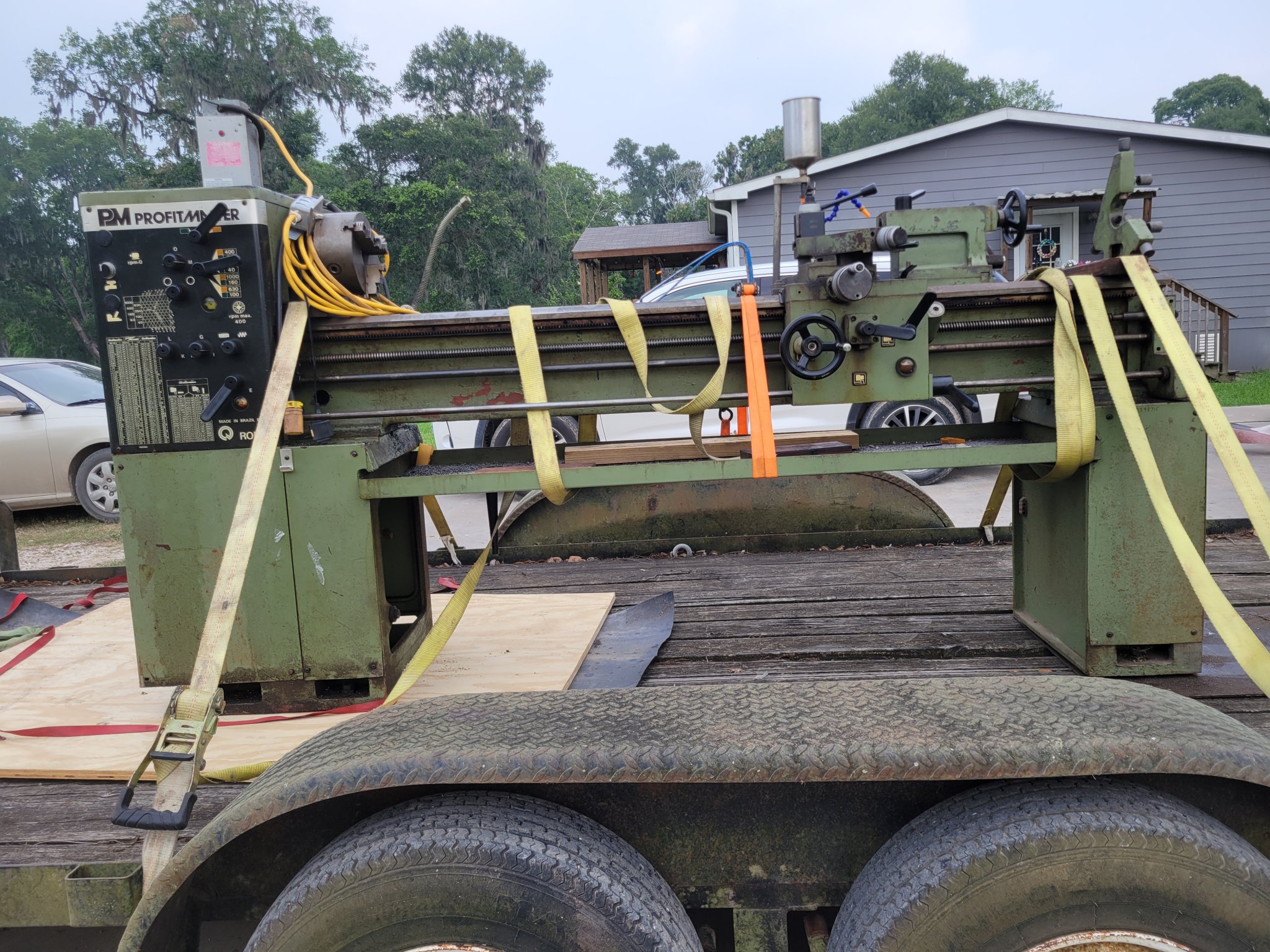

That's a handy sized lathe -what diameter through the spindle? Did it come with much tooling? - there is a way to spend a heap of money without much effort.
1½" through the spindle. It came with all the tooling that he had with it. And yeah, the machine is the cheapest part. I wanted to learn how to build my own rifles so I started down this path. I've spent whole rifles in tooling lol.
I sold my other lathe and tooling to fund this one. This one came with what I had and more. My last one was an 80's vintage jet, 1336PBD. I had gone completely through that machine. All new bearings, seals, and belts. Complete teardown and cleaned everything. When I loaded it up for the guy that bought it I kind of hated to see it go. It was more than capable of doing what I need but this one is a little nicer. All gear drive, and it will cut metric threads. Should the need arise.
Now I'm tearing into this one. Been giving it a rub down with kerosene to clean off all the gunk and grime. A couple gallons in and I'm about through with that. I think I'm going to pull the cross slide and the apron and go through it this weekend just to slick everything up. Then I've got to get it set up. I've got an old arisaka I'm going to rebarrel to a

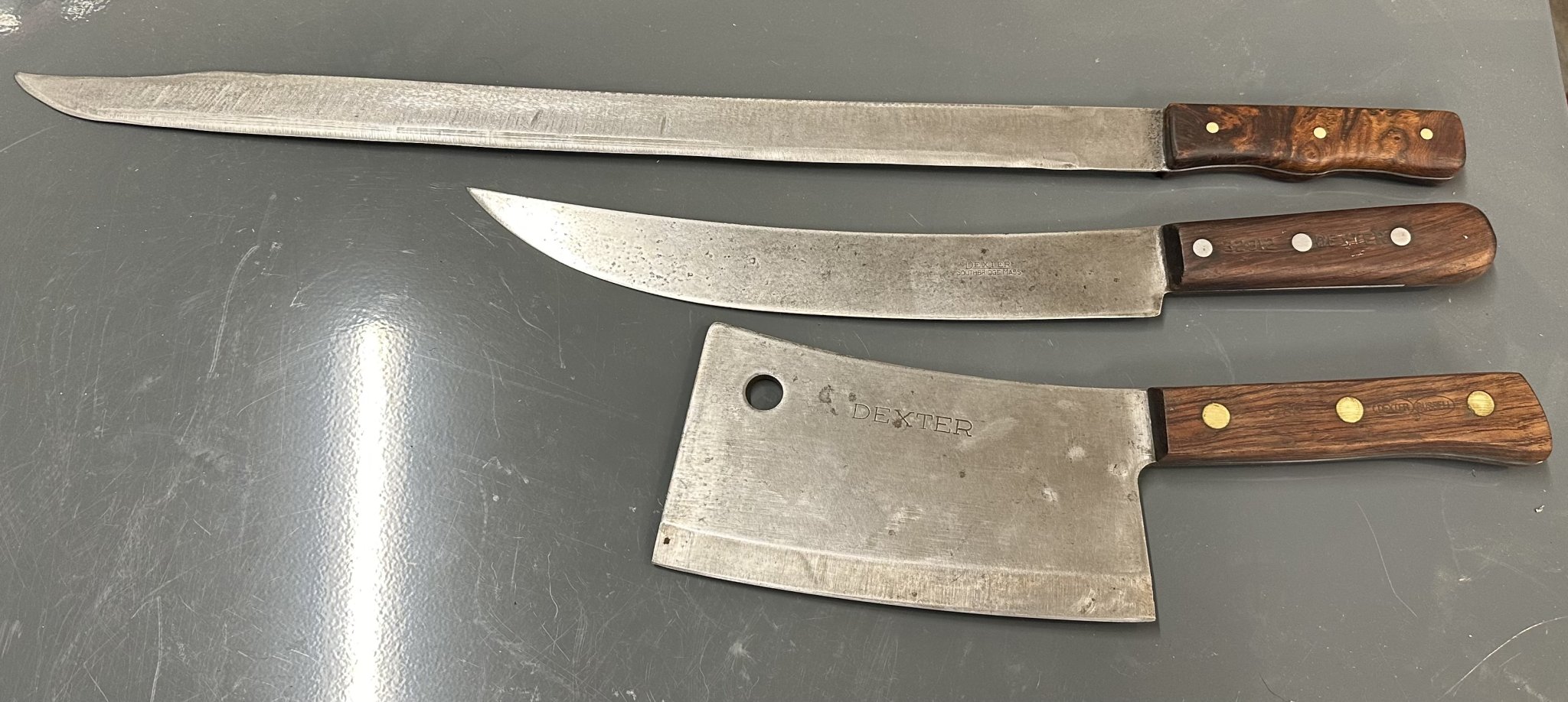

Sort of a restoration of a really cool Trio of old butcher knives. Two are Russell-Dexter. One is unknown, looks sort of home-made. All were really rusty and dull, but cleaned up great!
The long one needed a complete new handle. So I used a piece of desert Ironwood with very cool Burl. Only thing left is to pit a bit of wax on the scales and vegetable oil on the blades.
Love these old kitchen/bbq/hog breaking blades! Cheap at flea markets and really nice to have in the kitchen and use!!!!

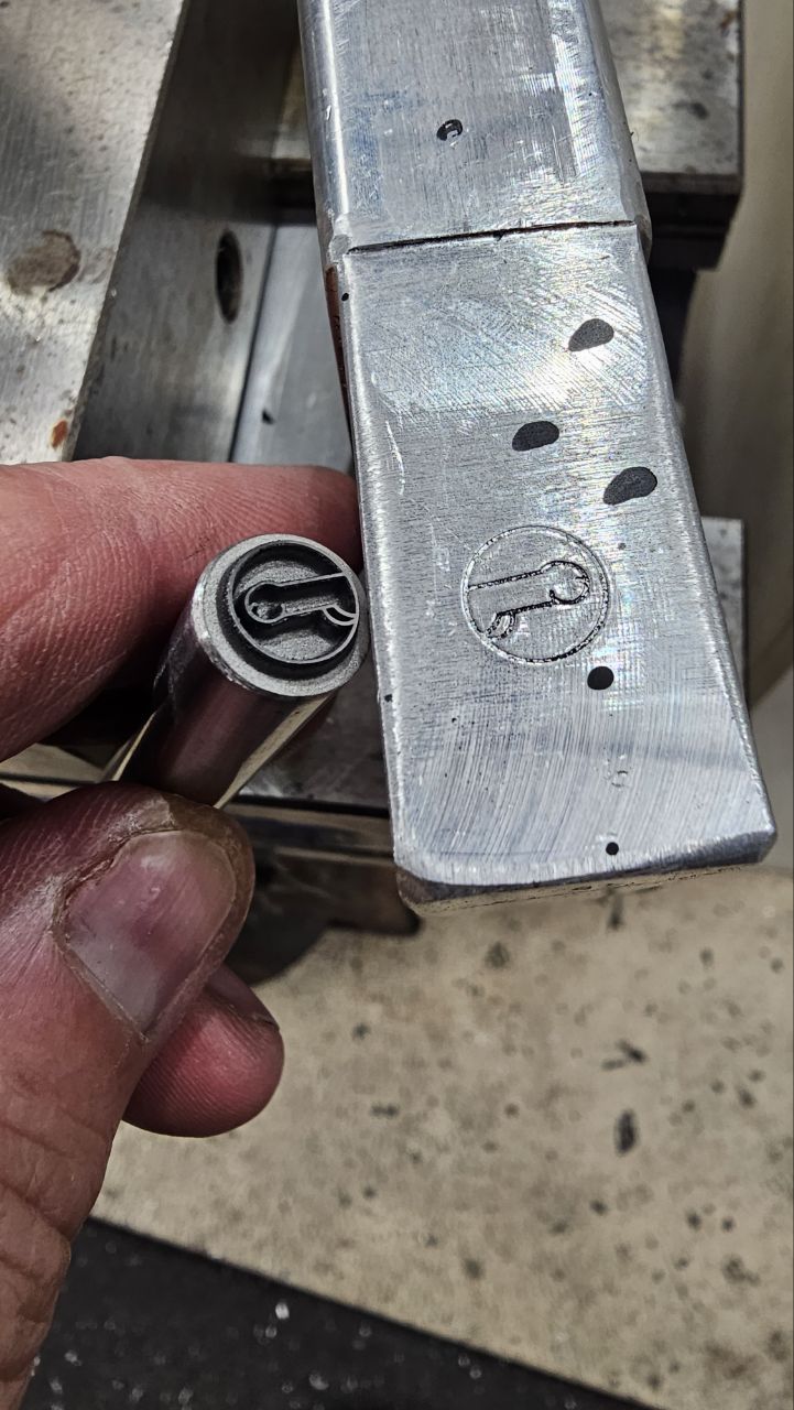

For the punch ? Yeah ill dig one up....
From spain. I provided the artwork. Want me to link the .dxf ?

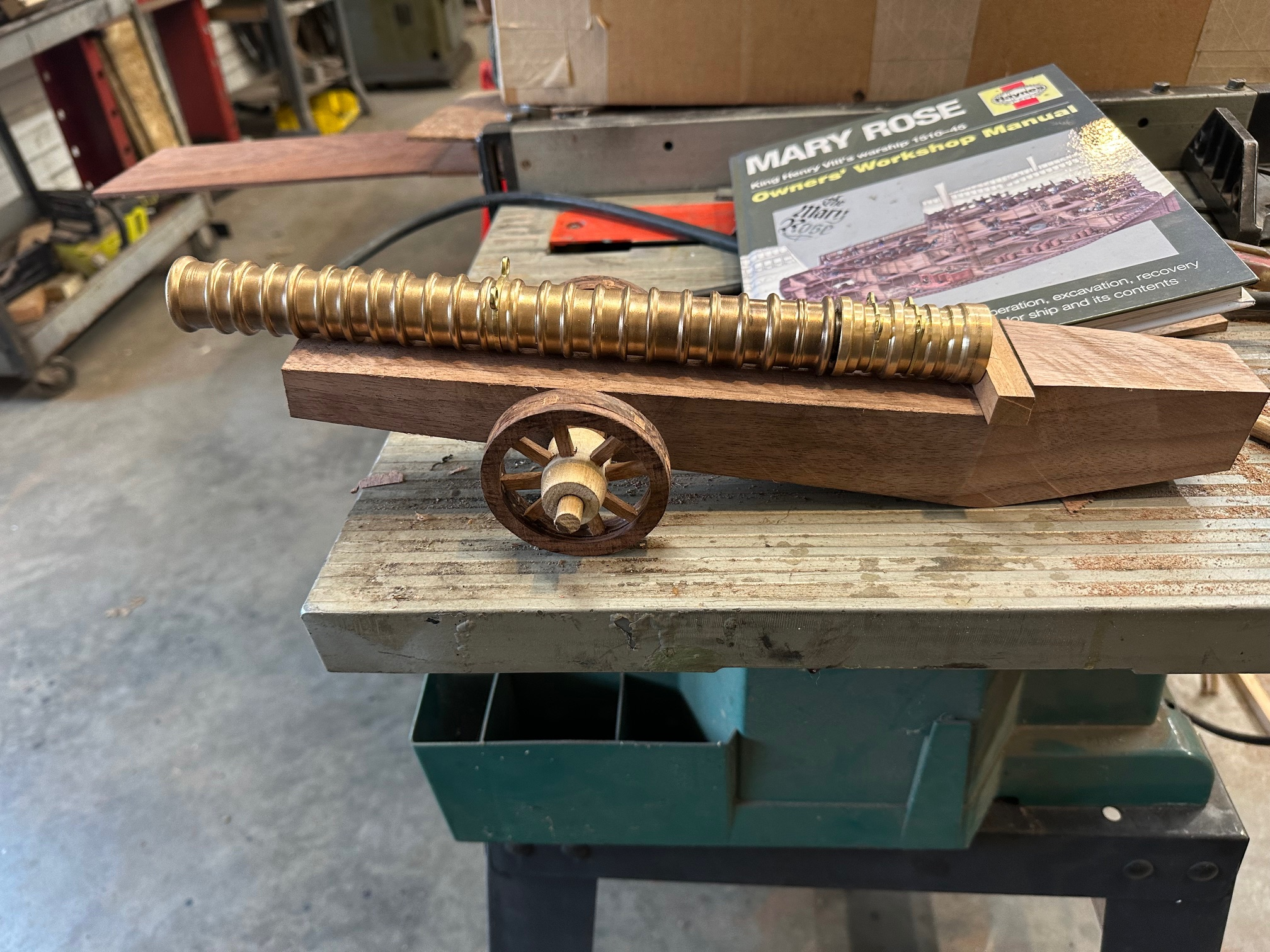

Rainy weekend, so got a bit more done on the Mary Rose Cannon. Carriage is coming into shape. Barrel is done. Wheels were really fun with hole saws and individually-fitted spokes.
It's going to be a stunning (firing) model. .45 cal rifled barrel with bronze rings shrunk on.
Starting to take shape.
Cheers,
Sirhr

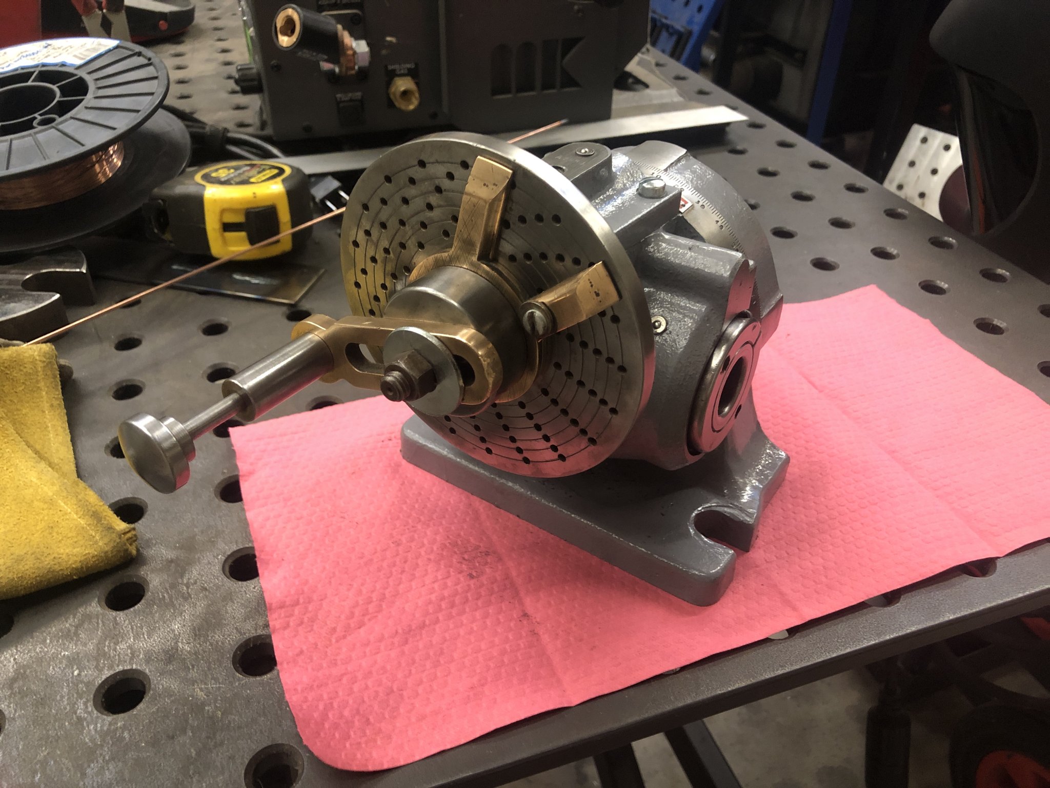

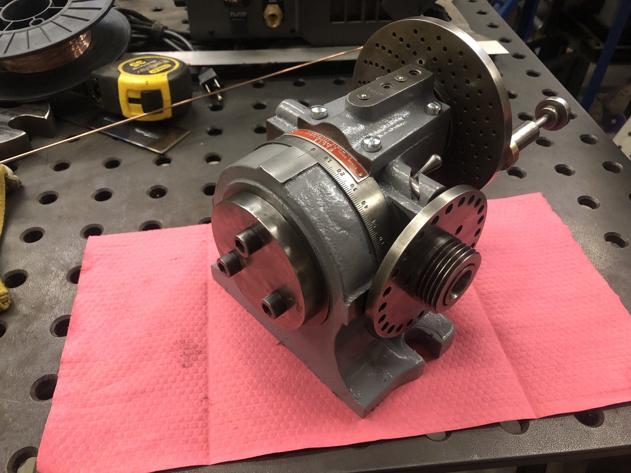

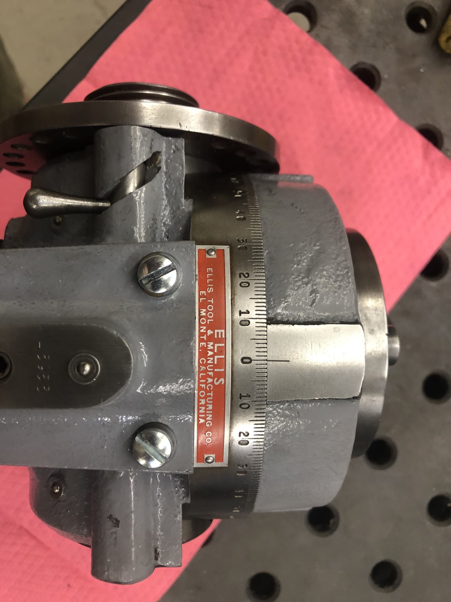

Picked up an Ellis Dividing head off Ebay. When I received it it was filthy and froze up so at first I thought a bought an expensive paperweight. as I tore it apart I noticed that it was in excellent shape and appeared to be very little used or not at all. Cleaned, painted and polished it and after reassembly works like a charm. Plan on mounting it on a ENCO XY table on a Clausing 20" drill press. Just need to get a 4" chuck for it.
Picked up an Ellis Dividing head off Ebay. When I received it it was filthy and froze up so at first I thought a bought an expensive paperweight. as I tore it apart I noticed that it was in excellent shape and appeared to be very little used or not at all. Cleaned, painted and polished it and after reassembly works like a charm. Plan on mounting it on a ENCO XY table on a Clausing 20" drill press. Just need to get a 4" chuck for it.View attachment 8456379View attachment 8456380View attachment 8456383
Is this still available?
Yes, and I agree. I just had to give you a hard time, as I too have been wanting to get either a dividing head, or a rotary table and put dividing plates on it.
You got some good stuff. I respect that.
I know used is usually much cheaper. But we have bought a bit of stuff from these guys over the years. Ajax Tool Supply
Pretty much wore out a couple bison rotary heads, but they were solid and good quality.

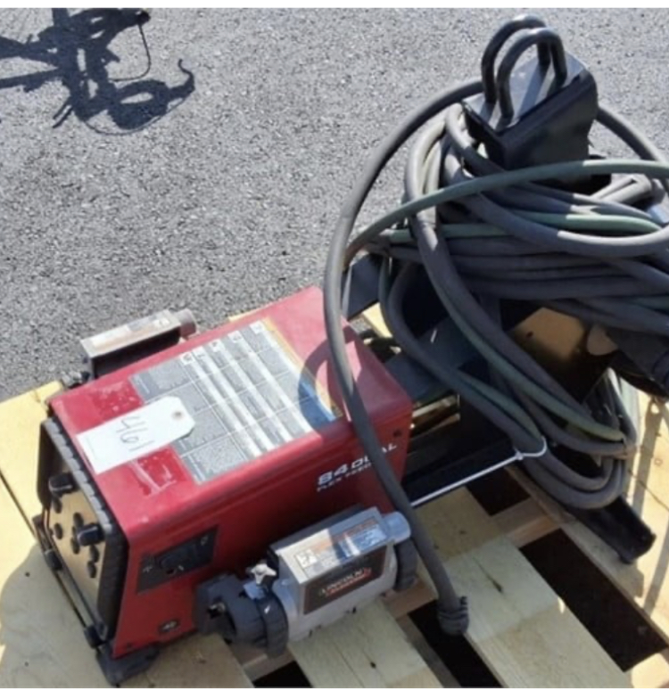

So, I’m not sure if I just scored big or dumped a little money at an online auction-
Lincoln 84 dual flex… something something. I literally know nothing about it and here’s the only pic I’ve seen. Any info or feedback from what you guys can tell?

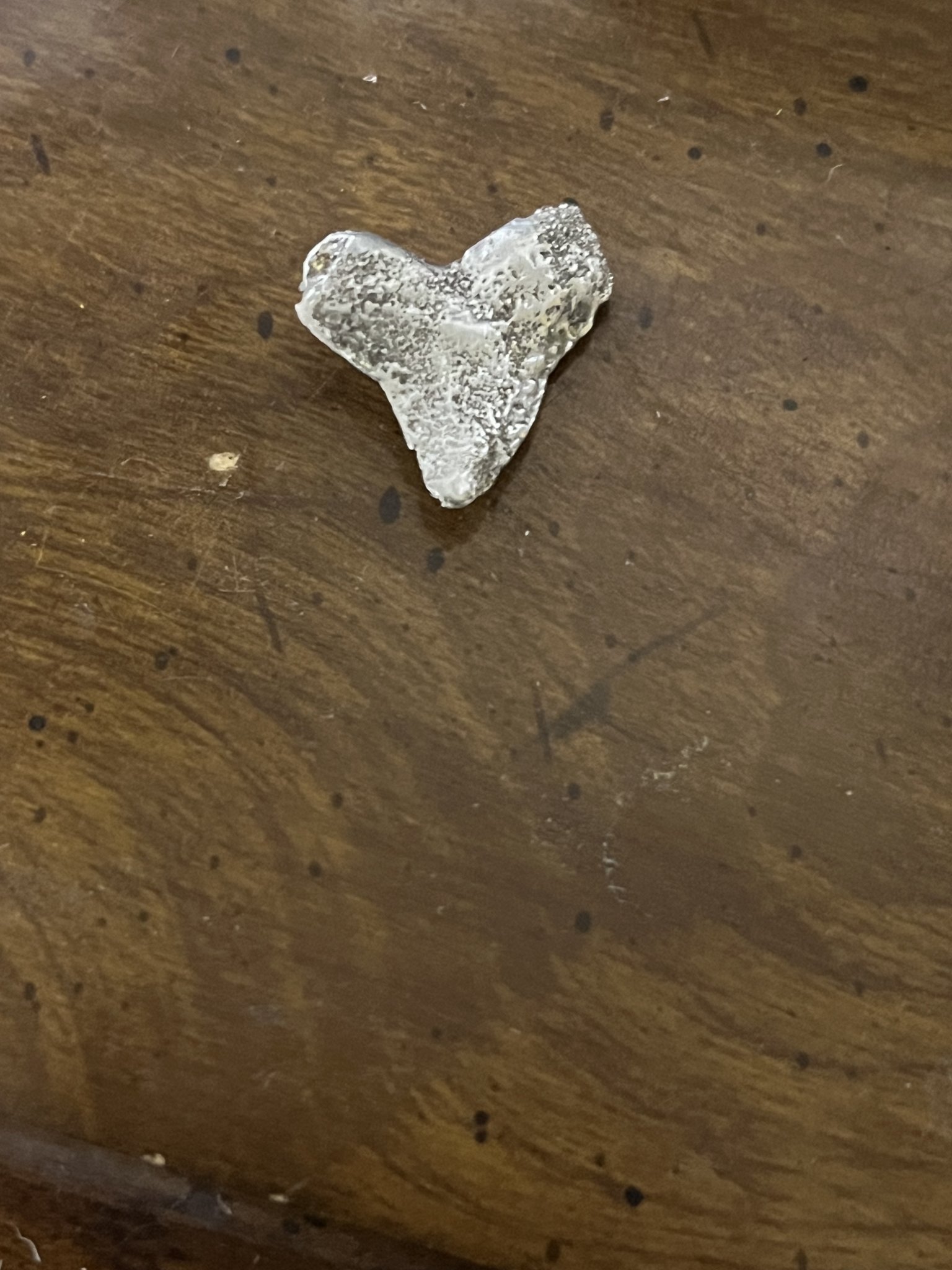

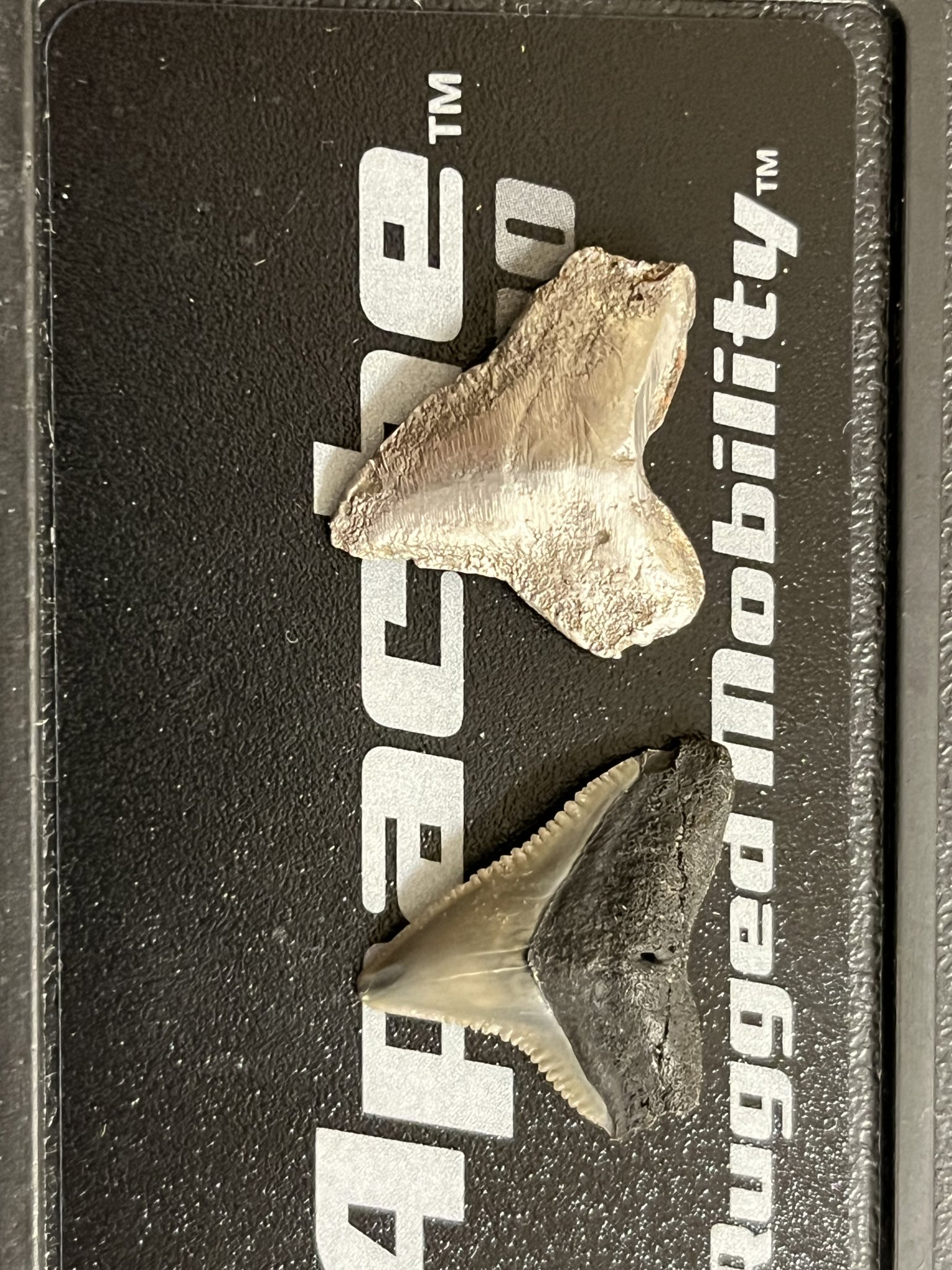

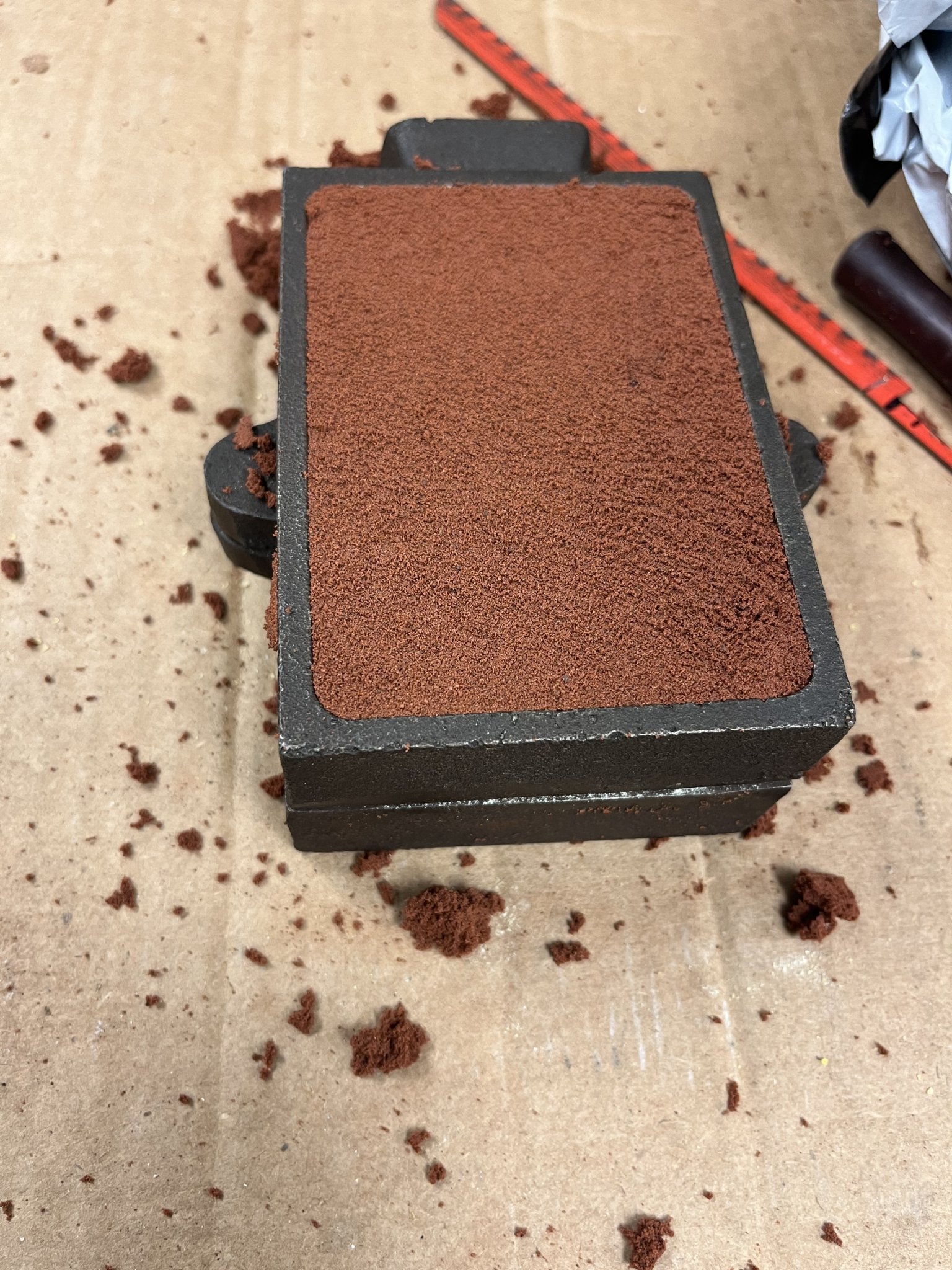

The wiff asked me if it was possible to make a sharks tooth she found into a gold pendant. I said quite possibly, and the rabbit hole magically appeared.
I told her to pick her favorite toof, not including the meg tooth she has cause I ain’t making a gold copy of that 5 inch bastard.
Today was a practice run with a small banged up toof and some cerosafe. Turned out ok, but some refining is needed before I go 14k and the toof she chose
Pretty good for a first try.
Just keep in mind you can melt gold over again a bunch of times.

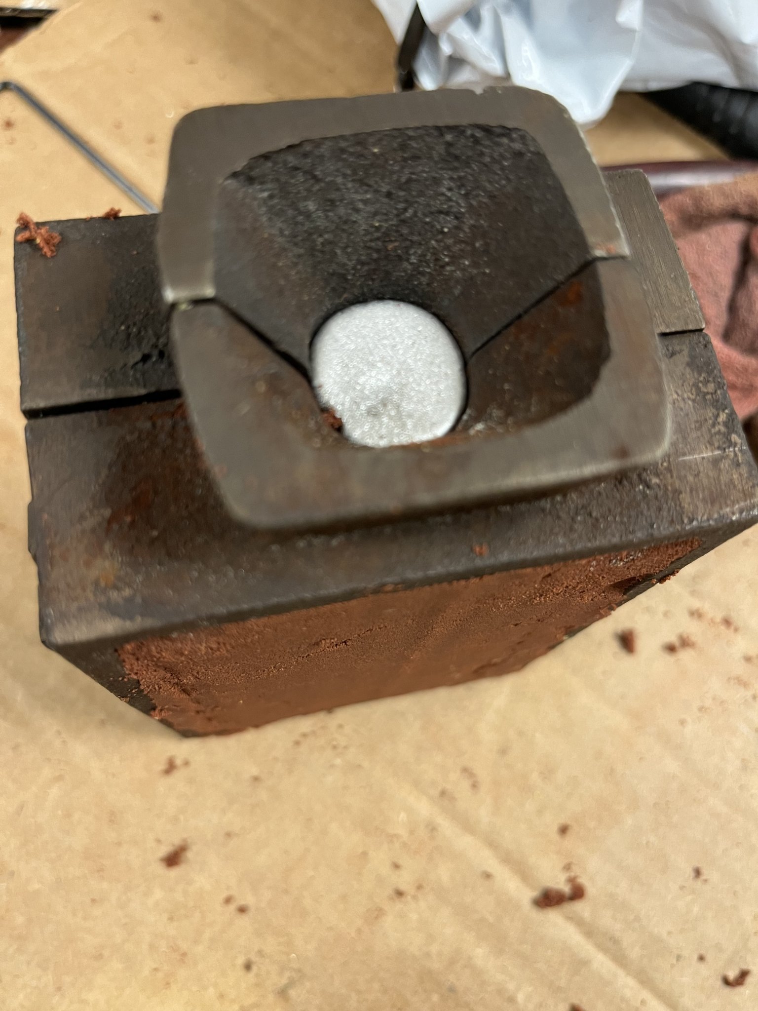

Just playing around today.
Debby does Norf Kakalacki is playing all weekend, so gonna smoke a pork loin and put some real effort into the gold version.

It is a reverse image, just how the toof laid out in the sand.
The reverse side. It is undoubtedly worse as I didn’t do very good prep work in packing the sand into the mold. It was very loose and probably had some grains fall into the cavity when I put the two halve back together. I’m sure it would polish out fairly well like the front did though
Reactions: timesublime
It has been a LOT of years since I've created sand casts, for the aluminum foundry. I get what you're saying, regarding the initial sand prep.
That effort extended there, leads to fantastic outcomes on the back-end of the job. How 'fine' do you sieve your initial layer, and how many layers do you 'pound in there' before filling the back with bulk?

Wife tinkers with the finer arts, carving, jewelry, etc.
She cast a couple pieces in gold, carved the wax in the shape she wanted so a one shot deal but the detail was good when it came out the mould.
Since you have the toof already if you don't get what you want packing sand you could always make a positive of it in something like silicone for easier repetition.
Reactions: roostercogburn98
That was the other “F” in prep work. I only broke it apart with my hands and sprinkled it over the object. I will dig out a screen and get it spread better. The mold is kinda small so I did two very inconsistent layers and tamped it half assed. I did tamp the last layer of bulk fill fairly solid before I raked off the excess.
I believe I probably had some space in the bottom half as well from not packing in tight tight. The mold could have possibly moved a tiny bit
