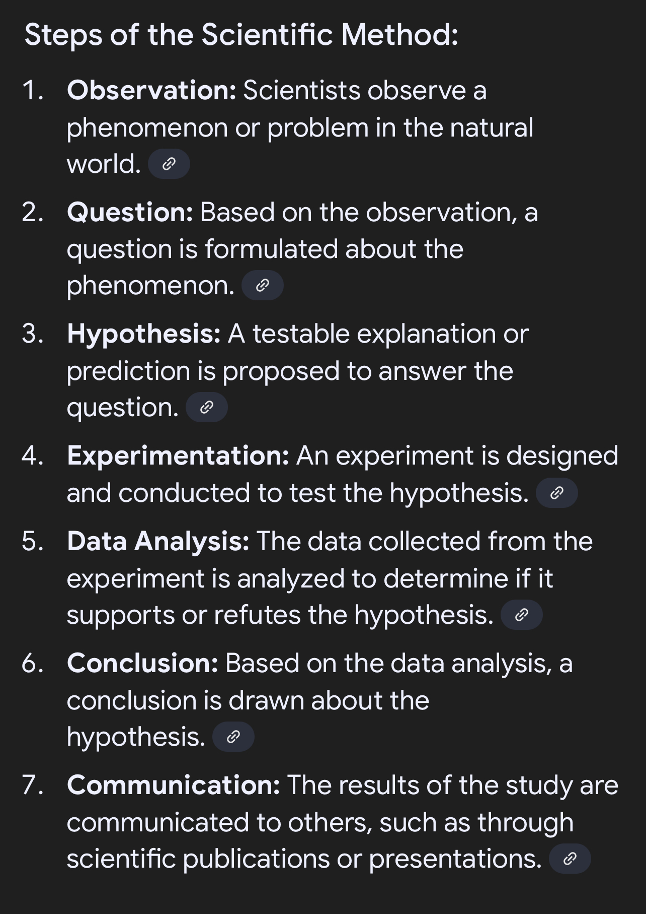

The thing about the scientific method and experimental design are that it/they include control groups and experimental groups and more importantly, test the results against generally accepted statistical analysis methods to determine the significance of the results. So what you have there, in the absence of any such controls or analysis, is anecdotal evidence.
What are you doing right? Possibly nothing except getting lucky.
Can your result be reproduced by another experimenter? We don’t actually know because you didn’t control enough variables and communicate those controls to us (another aspect of experimental design and the SM). Is your result provocative of additional experimentation? Only anecdotally because your data set is so small as to leave significant doubt regarding any conclusion you posit and your test therefore fails to advance our understanding (in other words, we have to start all over again to learn anything real).
It’s cool that you shot three small groups and used thorroclean. It sounds like you are being reasonable and gentle in your methods which it also sounds like SOME of the barrel-damagers weren’t. Do whatever you want with your barrels and your abrasive cleaners. Best of luck to you in your quest to maintain a spotlessly clean barrel.

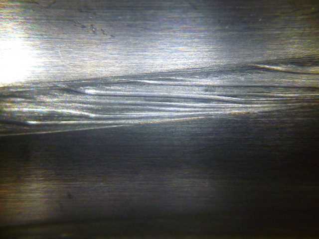

I use this pic a lot. The shooter was honest and told us exactly how he was cleaning the barrel. Using KG2 bore paste, a bronze brush and how often.
Not only did two gunsmiths (one of whom installed the barrel for the customer) replicate his process and we did as well.
End result was the same.
Looks almost as bad as my factory Savage barrel did before I ran Tubbs bullets down it. It shoots a little bit better and fowls a little bit less now, but I’m not sure it was worth the effort. My experience has been, so far, that the more I pay for a barrel, the easier it is to clean. I haven’t had to use JB and Kroil on any of my custom barrels, I only use Boretech Eliminator, CR4, and Slip2000EWL for lube, and they are a dream to clean. I have been known to use JB, sparingly and only on a Kroil soaked patch with a jag, not a brush, on my Savage and Faxon quality barrels. I almost never use a brush, even nylon, even on the lower quality barrels.

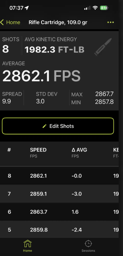

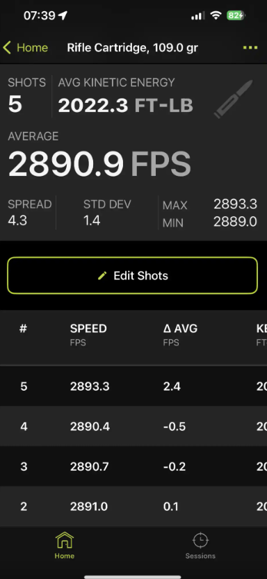

I have used thorroclean and I have noticed no difference since I have started using it. I'm nobodies expert but I have had no issues with it.
To illustrate this barrel speed up after using abrasives, here are some screen shots from THS in July of last year through day 1 and 2. While this speed up doesn't take as many rounds that initial "barrel break-in" does, its still present and repeatable with abrasive use. Since quitting the use of abrasives this had not repeated itself.
Start of day one
Middle of day 1
Start of day 2
Reactions: oldrifleman
