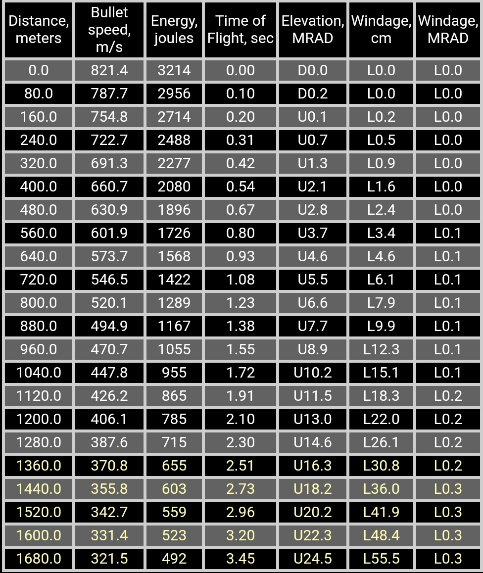

I hope JSchell will come to give his bit but I am going to bite into this.
-It looks like you need more turns in the elevation knob or use the reticle for the last few 2-5mils. depending on load.
Here comes the 6.5 CM heavy load:
Scope height 2.12"
Cartridge: 147gr. ELD Match (Hornady)
MV: 821m/s 2693fps
0.697 (G1 model and 1610m (1mile) is under transsonic so it might not be 100% accurate, blame Hornady)
-> You *probably* need 22-25mil (82-89moa) depending on load to get 6.5cm DIALED to a mile.
So in order to get 100 zero you are going to run close with the 20moa added as those add to one way only. The rails and mounts give nice cant but without good elevation range you won't be able to near zero.
Does it matter so much that you need to hold UP like 4mils at the 100m range? Dunno.
I do need help with this.

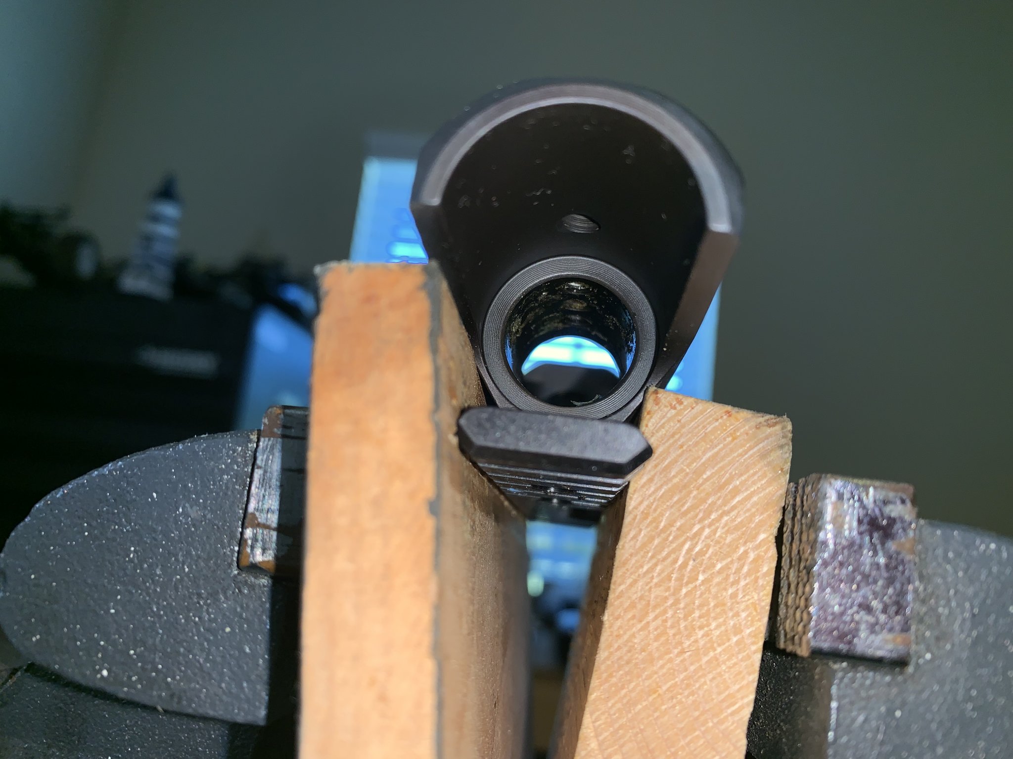

Should work with any 10-22 barrel except the takedown version. I will have to go back to my notes to see how much I took off. I will provide more info when I get a chance. I did not touch the chamber, just reset head spacing to 0.042 with a feeler gage.

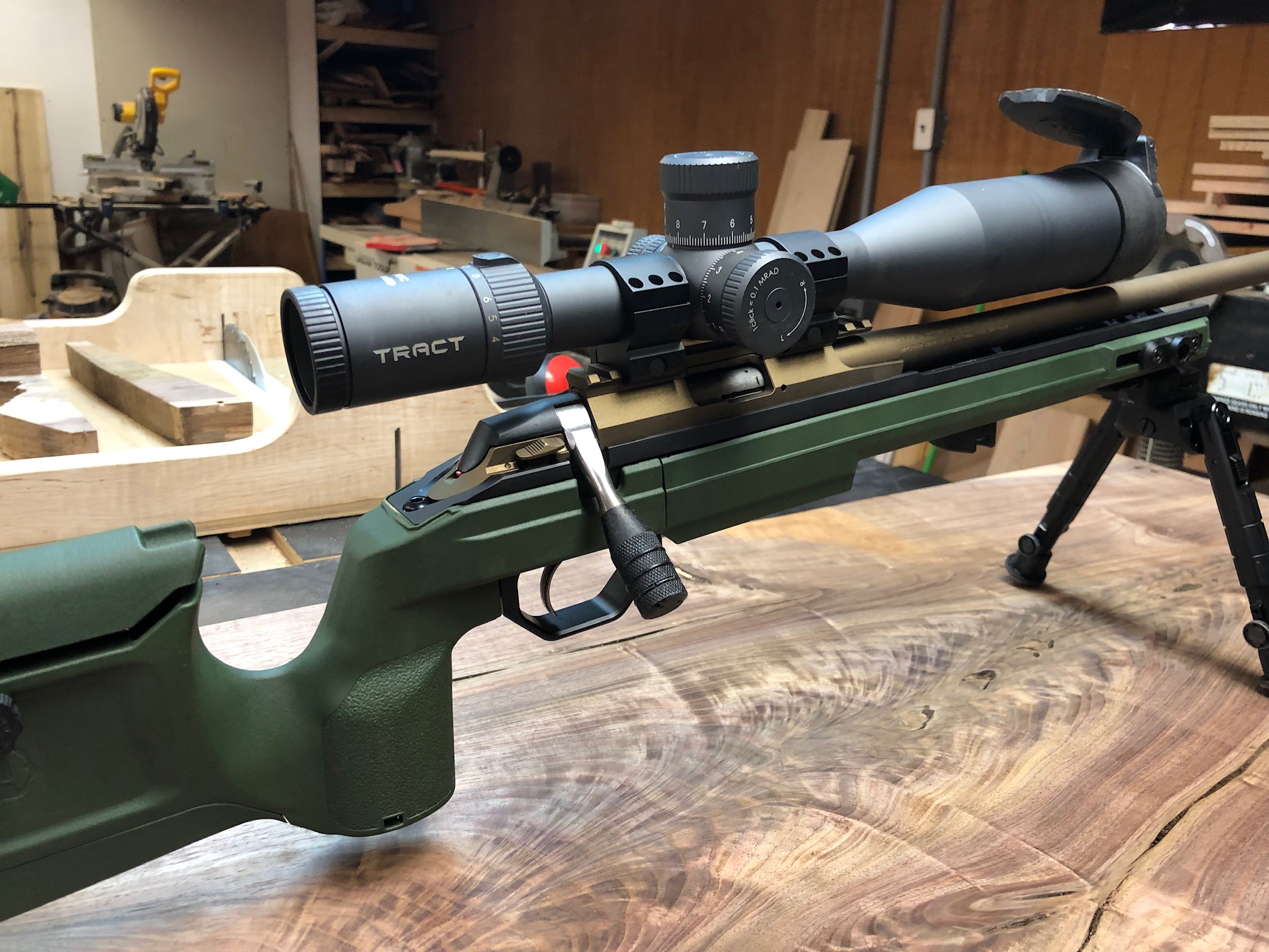

Excellent info and photos. I'll add another data point to this for ring heights and objective clearance.
Area 419 30 MOA rail
ARC M10 X-low Rings at 0.79" high
Vortex Viper PST Gen 2 5-25x50
This setup gives me a gnats ass gap between the objective and the barrel. The stock bikinni cover does not fit. Also, even at this low of a height, I will still need to add a cheek riser to get a good relaxed cheek weld in prone and seated positions. Since I already need to add a cheek riser, I plan on swapping the rings to their "Low" height of 0.94" to gain clearance and ability to add a scope cover.
Fit and finish on the Area419 rail is excellent. It's base is relieved to fit over top the dovetail and does not slip into the dovetail at all. It references the receiver flats on either side of the dovetail grooves. Very nice rail and would highly recommend it. 419 makes good stuff.
Finally if anyone is wanting to try out the factory Tikka "vertical grip" they are $15 on beretta's website Link Here. I added it to an order of 2 additional factory mags and with the grip and 15% off code (BUSA13) it was $70 shipped after tax. If i just wanted the two mags it was $68 since it charged shipping if under $75. It was worth the $2 to try it out. Much more comfortable in the prone position.

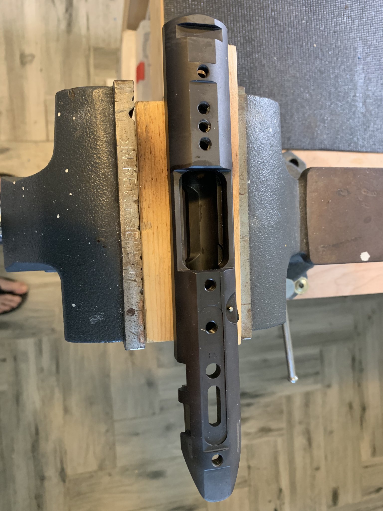

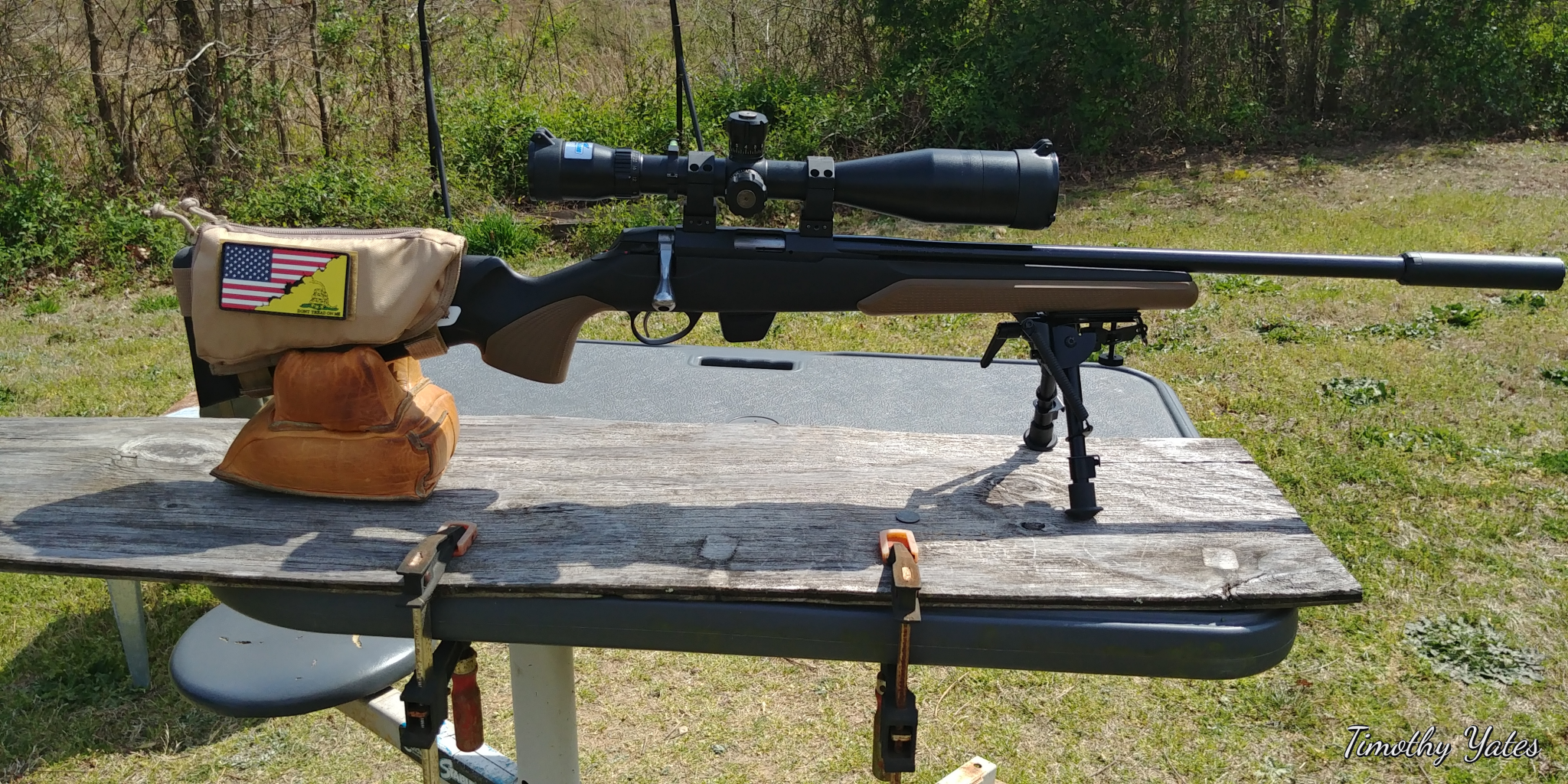

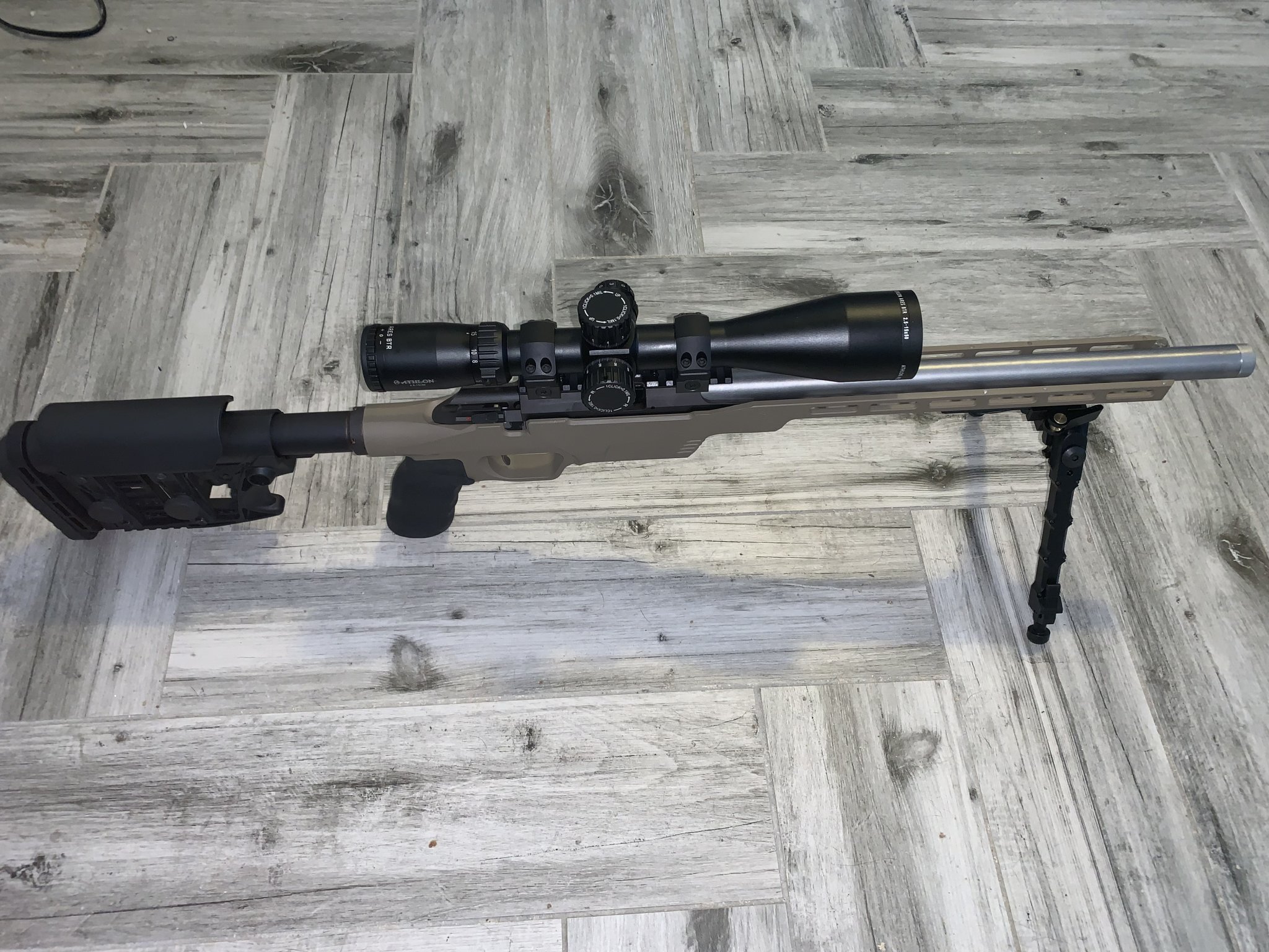

I decided to take matters into my own hands to get a heavy 16” barrel. This is my T1x in an MDT LS XL T3 chassis. The barrel is a SS FJ Feddersen 16.1” threaded barrel for a 10-22. I had to turn down and lengthen the tenon to match the Tikka barrel. I have not put any rounds through it yet. That is on the agenda for this weekend.
@johnkmcguire97, Thanks for posting photos of the stock barrel removed. I was wondering if the 3 set screws just press against the barrel. Looks like no dimple or anything further than just friction.
I only have experience re-barreling Savages and using go/no-go gauges to set head space. How is headspace set on these 22 rifles?
Reactions: proff49
@johnkmcguire97, Thanks for posting videos of the stock barrel removed. I was wondering if the 3 set screws just press against the barrel. Looks like no dimple or anything further than just friction.

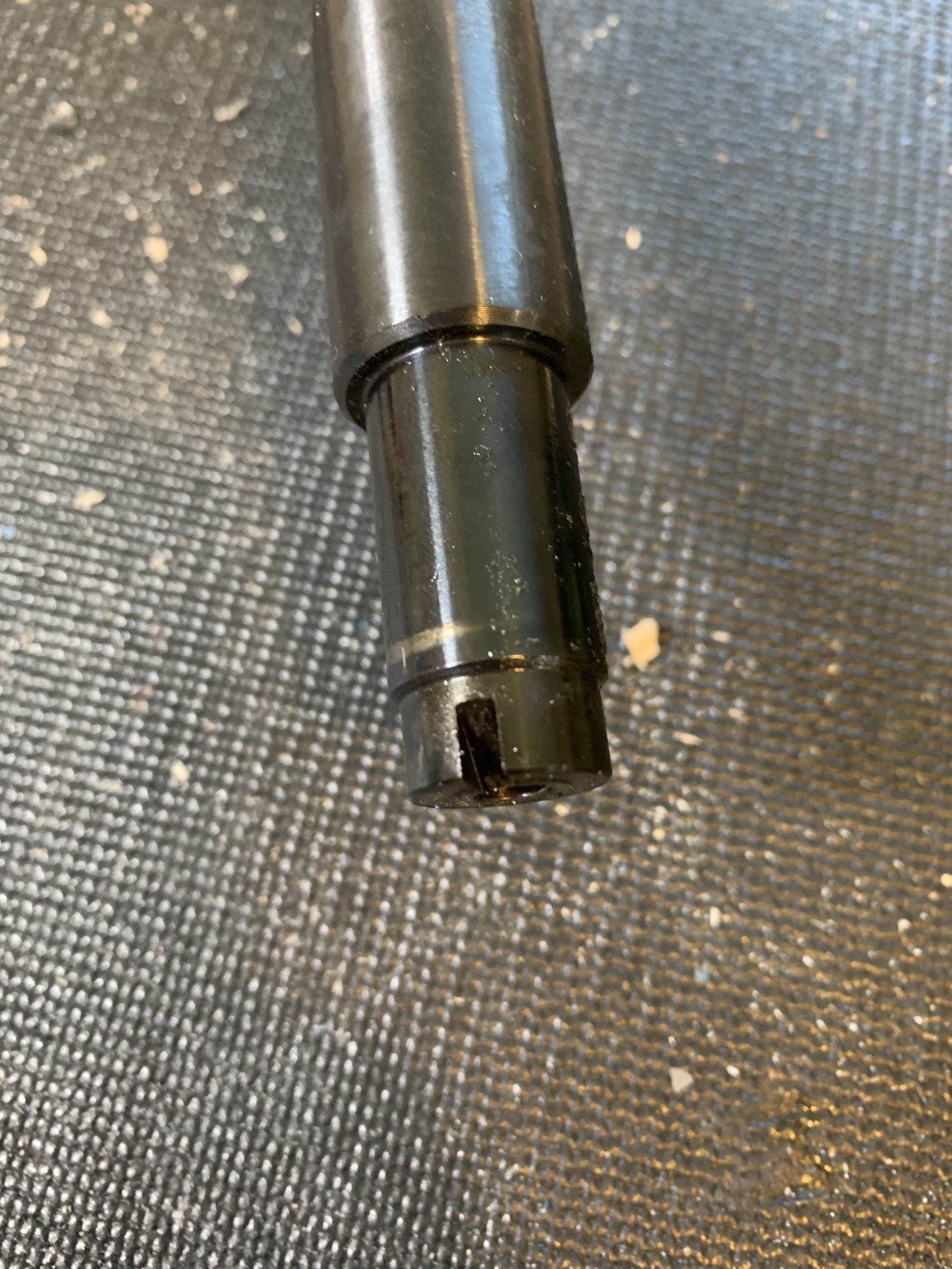

There is not a flat feature or dimples on the factory barrel for the set screws. The tenon of the barrel is simply round. The set screws in my rifle had high temp loctite on them. You will have to heat them up to get them out.
I am no expert, but I found several sources that described the procedure for setting headspace on a 22LR with feeler gages. I chose to use Loctite 620 to bond the barrel in place. This seems to be common practice with bench rest shooters. So here are the basic steps I used:
1. Clean the barrel and receiver with acetone
2. Heat the action in the oven to 200F. I did this because I had a light press fit between the barrel and the action. Heating the action allowed the barrel to slip in with clearance.
3. Butter up the barrel tenon and the inside of the receiver with a high temp retaining compound like Loctite 620
4. Slide the barrel into the action
5. Install the farthest forward set screw and tighten it just enough that it contacts the barrel. At this point I could still move the barrel but it was snug.
6. Insert a feeler gage from the bottom of the action between the bolt face and the back of the barrel and close the bolt. I set the headspace to 0.042”. From what I could find this seems to be the sweet spot. When you close the bolt on the feeler gage, it should push the barrel forward to its final position. That is why the set screw must be just tight enough to put pressure on the barrel, but not lock it down yet.
7. Make sure the extractor clears the extractor cut in the barrel
8. Tighten the set screws and let the loctite cure.

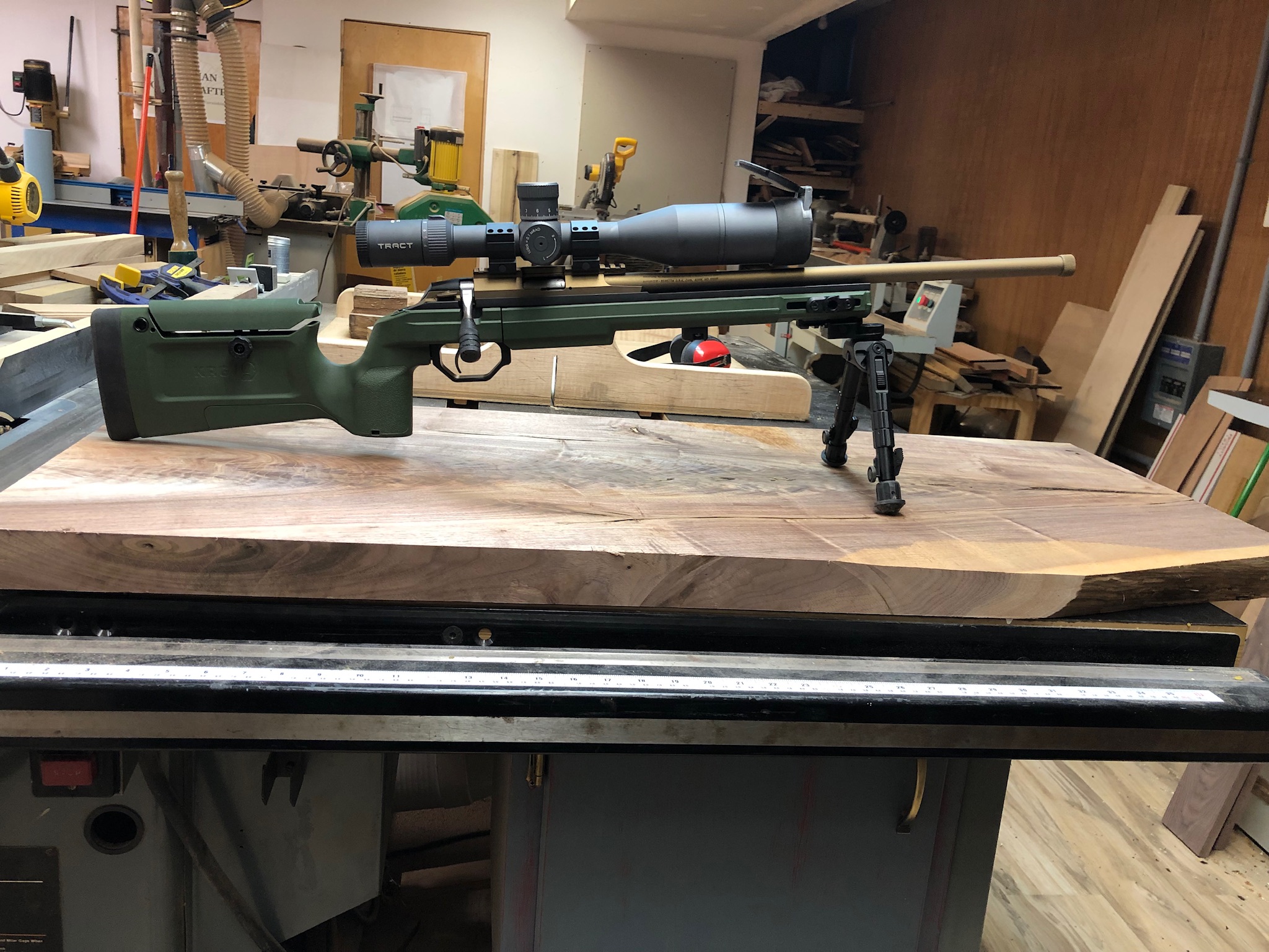

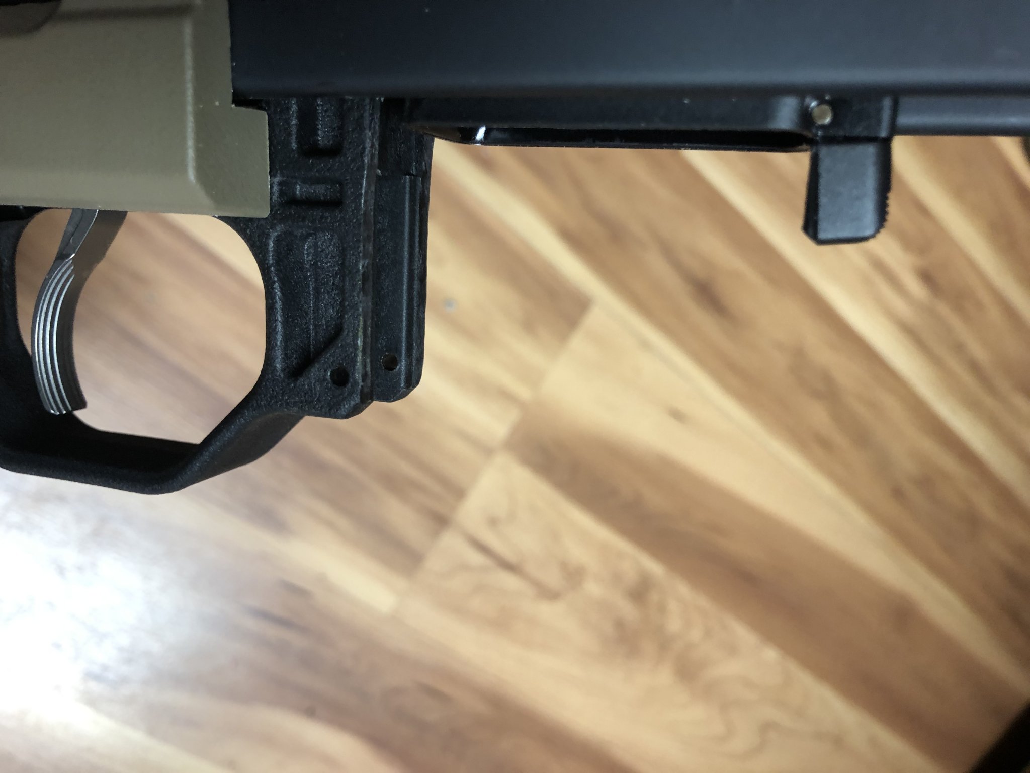

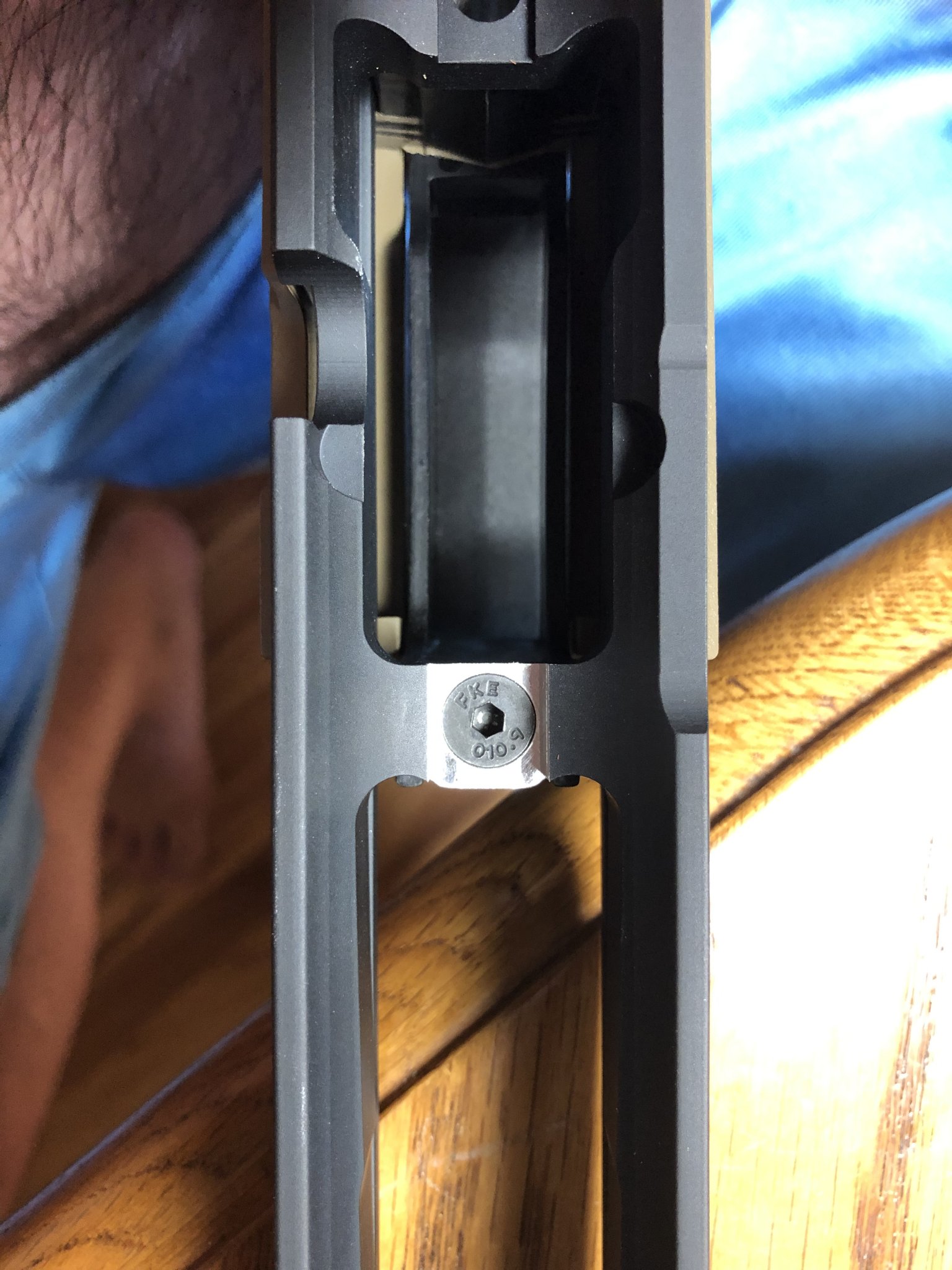

I am not a patient man. When I got the email saying my T1X was on its way to my ffl, there was no way I was waiting for KRG to get another batch in. I ordered up the T3X version, I’d figure something out.

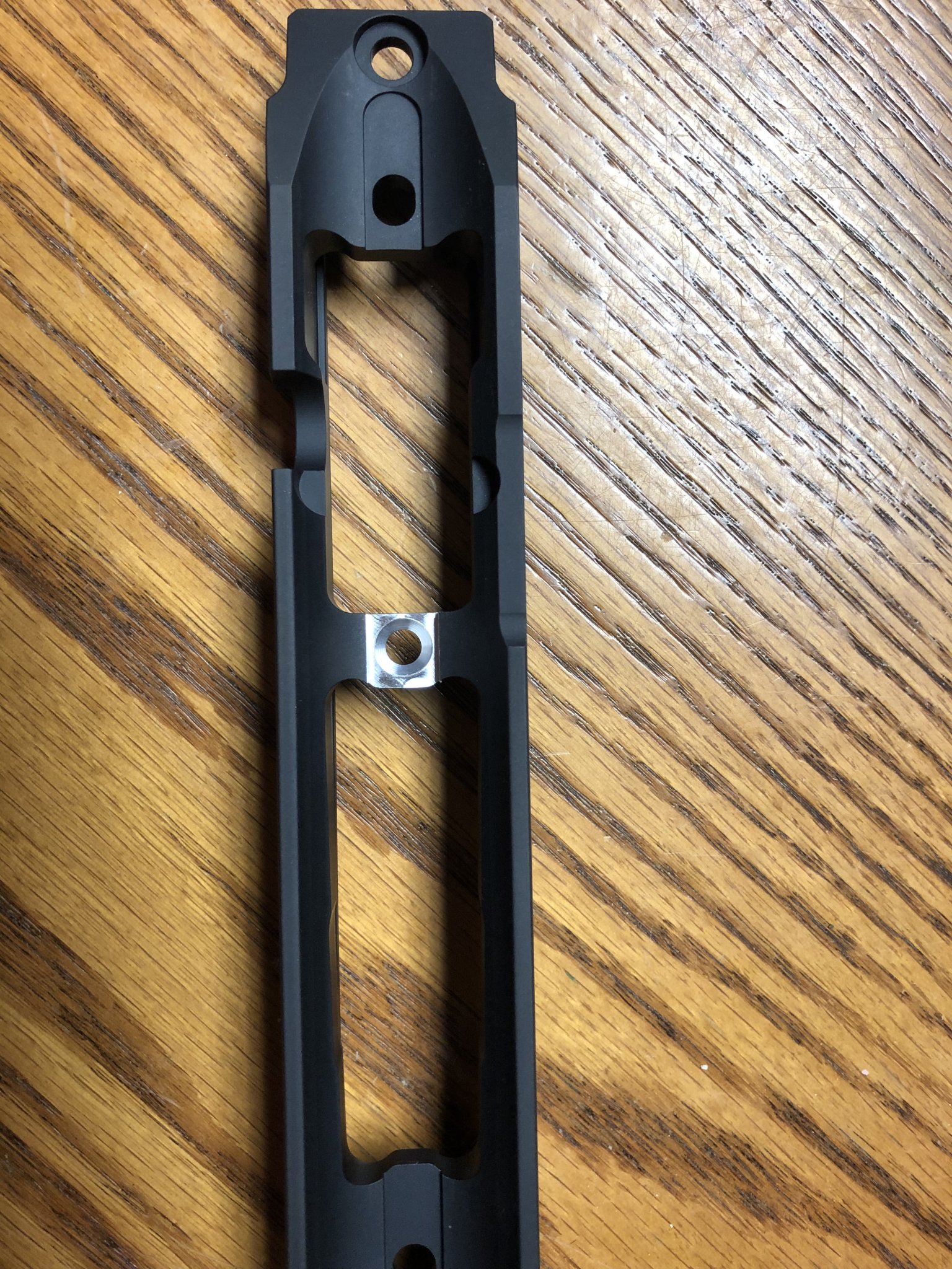

Sat down last night and worked out the plan. Spent an hour or so total today and got it done. Pretty simple if you have access to some tools or are the industrious type...
I widened the slot at the bottom of the chassis’ “saddle” to .470 wide, and cut it .080 deeper. I then cut a 100’ countersink to 3/8 diameter to accommodate a flat head screw for attaching the KRG trigger guard...
I removed and discarded the screw and washer from the tikka that holds the magwell in place. By cutting the chassis to the above dimensions, when you mount the tikka to the KRG the magwell becomes a captive assembly. There is not really an easy way to get a pic of this, but if you had the parts in front of you it would be evident what I am talking about.
All that I had to do after this, was to remove the KRG mag release, and shave off the 2 “rails” on the front of the trigger guard to allow the mag to seat. This material shaves away easily with a sharp utility knife. You need to cut the 2 narrow rails flush down to the top of the magwell. I think these couple pics do a decent job of illustrating this.
In the first image I have started shaving the right hand rail. The second image shows it done...
I’ll try and get a couple of shots of her all put together tomorrow, but I’m done for today. Everything fits nice and tight and functions as it should. As long as you take your time to get that first cut done right, everything should go smooth.

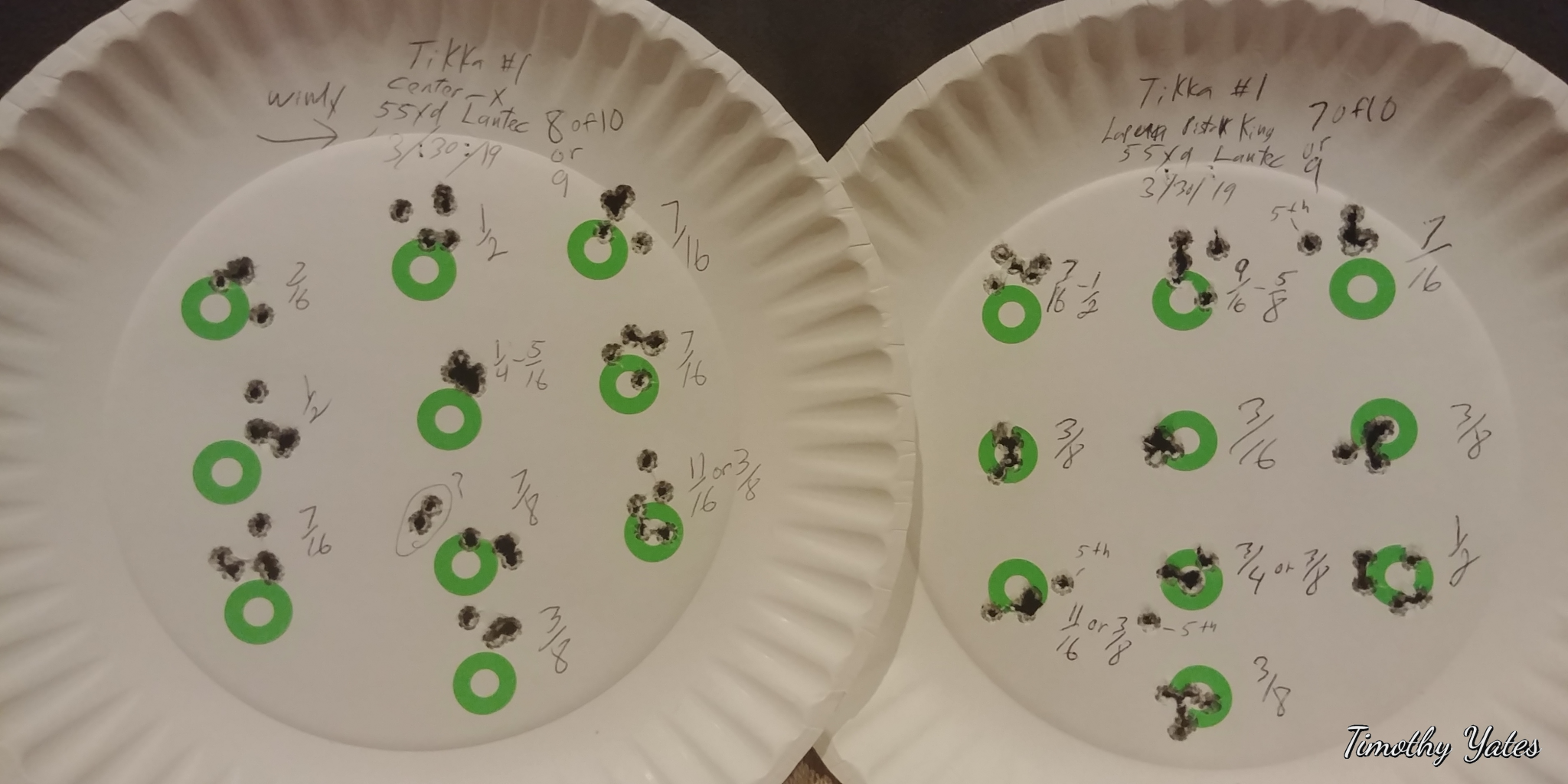

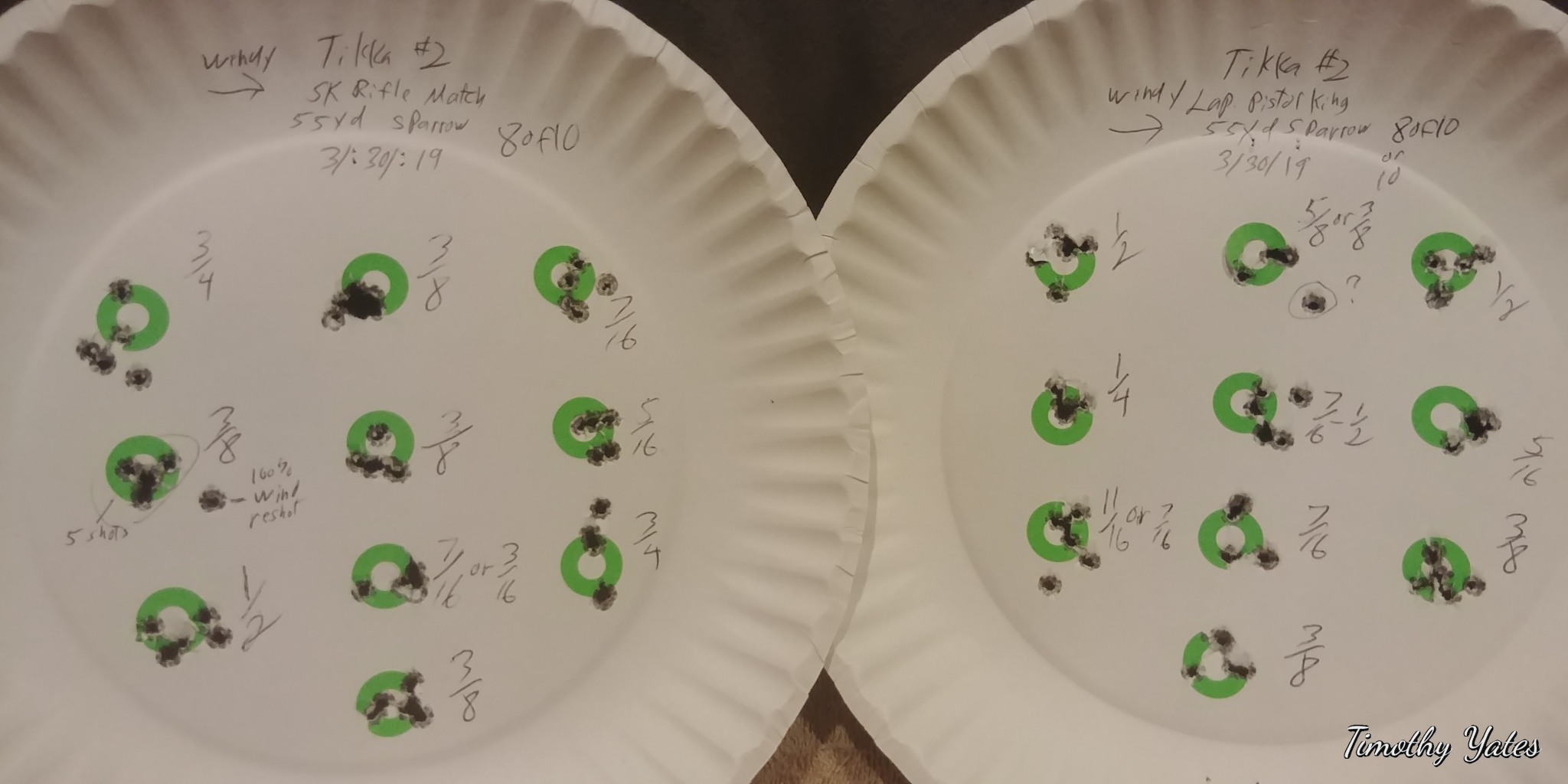

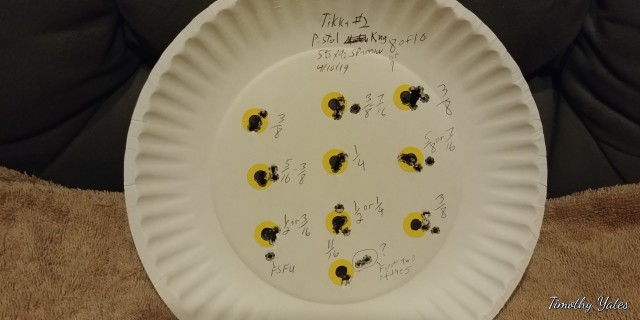

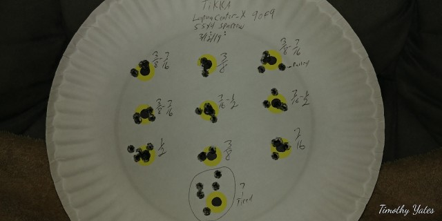

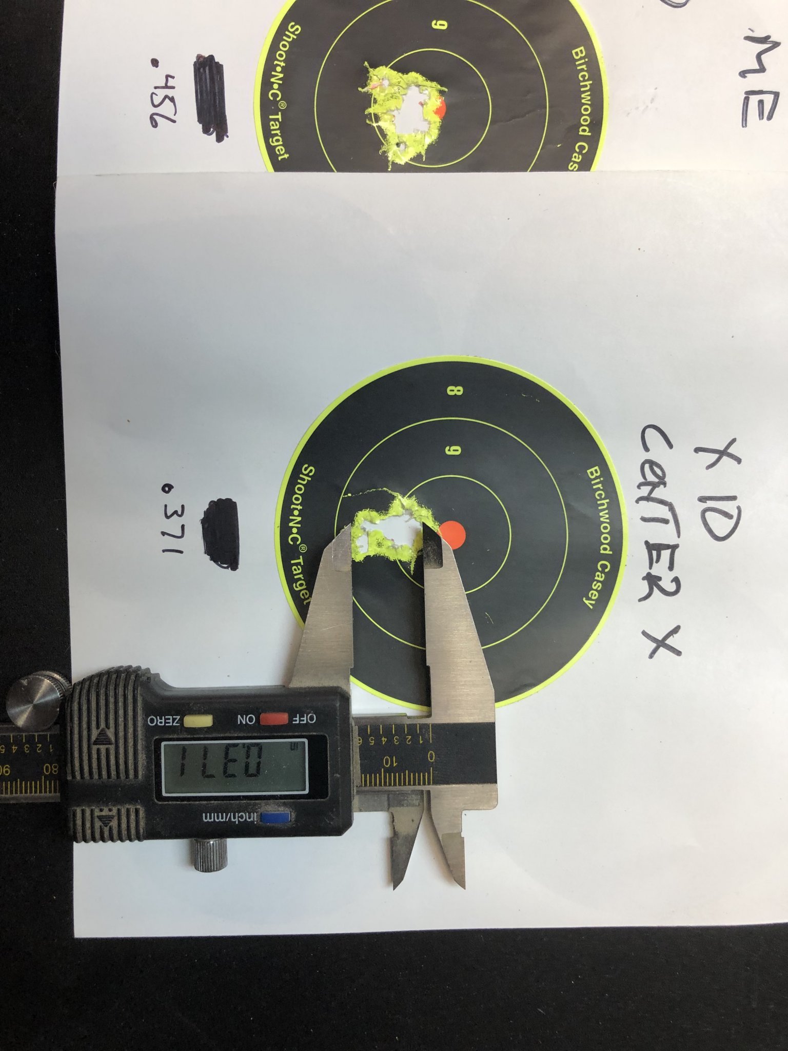

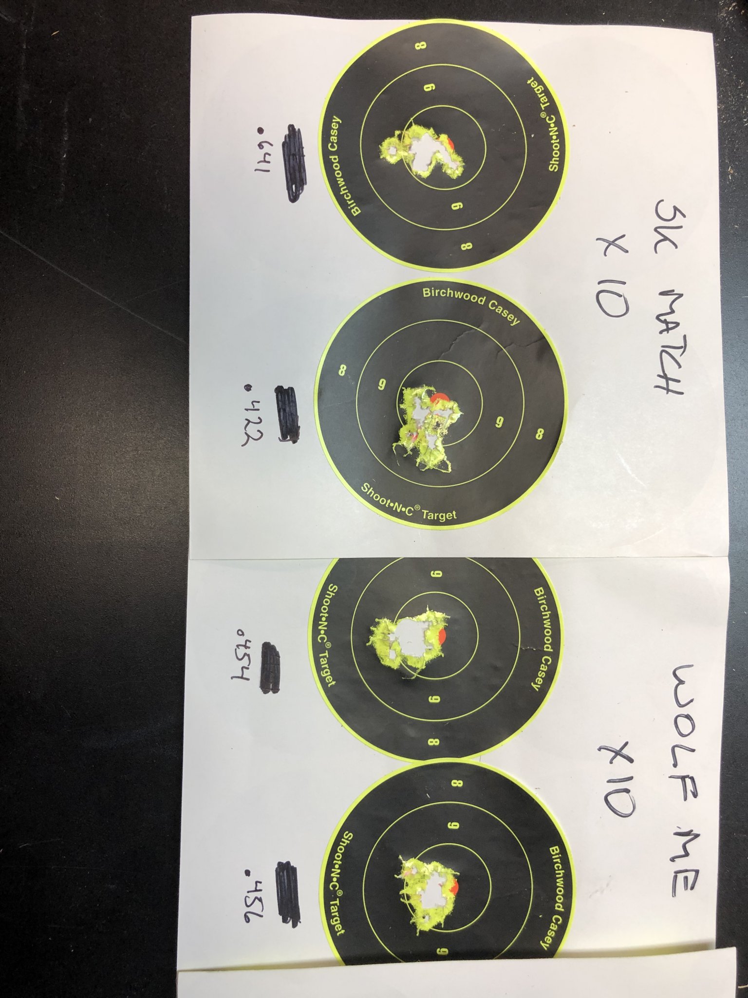

Got out to the range again today and did a little ammo testing now that I have 500 rounds through the rifle. Pretty much everything I shot was shooting well at 50 yards. When I stretched it out to 100 I could see where the quality ammo really made a difference though. I have a 100yd KYL rack that goes from 2” down to 1/2”. With the Eley Edge and Lapua Center X I could hit the 1/2” target at least 6 out of 10 and most of the other shots were close enough to make it move. Here are some of my 50yd targets from testing. These are pretty representative of all my groups and I just pulled a few of the targets randomly for photos. These are all 10 shot groups. I’m ordering a case of the Center X that shot so well. I had a few groups that were actually smaller but I couldn’t get the pasties to come off in one piece.
Edit. I was thinking about these groups sizes and they just didn’t make and sense to me. They seemed wa too small. I checked my caliper and it wasn’t zeroed at .22 like I though it was. Somehow it managed to end up zeroed at .45. I’ll go back and remeasure all these today. If you add another .23 to the grope size that should be it though which makes a little more sense. It’s driving me nuts so I will remeasure the groups and post a new photo shortly.
Okay guys. Here are the accurate measurements. Still nothing to sneeze at. The more I shoot this rifle the better. I will say this. I’m confident I can clean the KYL rack at 50 yards now 9 out of 10 times. Especially with the center X.

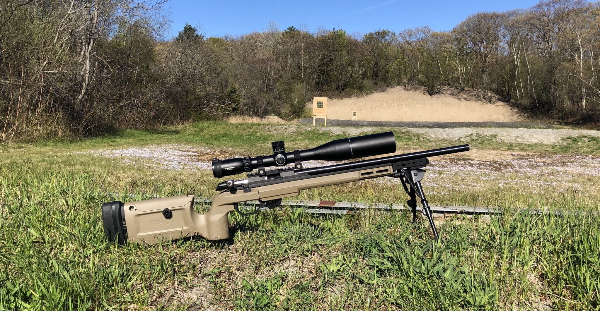

Shot of her in her natural habitat. I’m thinking the sunshade is a bit much, may have to nix that. I clearly need some lower rings as well, messed up my guesstimate on that one...
Performance wise, the jury is still out. Had some real tight groups, then I had some random fliers mixed in that would be out 1 - 1 1/2” (@ 50) Thinking it’s probably the CCI SV that’s the issue. I’ll order up some good food for her and see how she likes that...

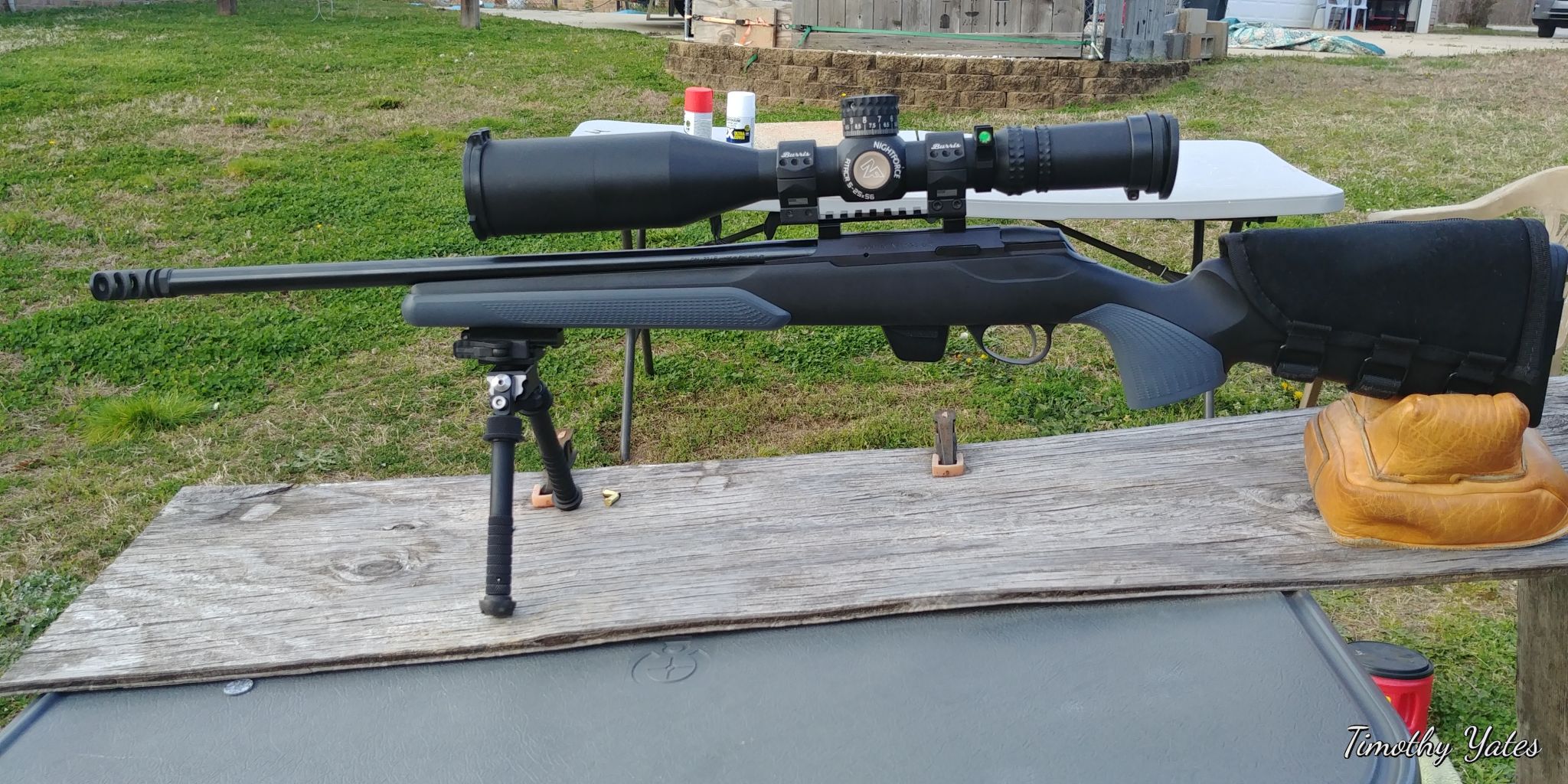

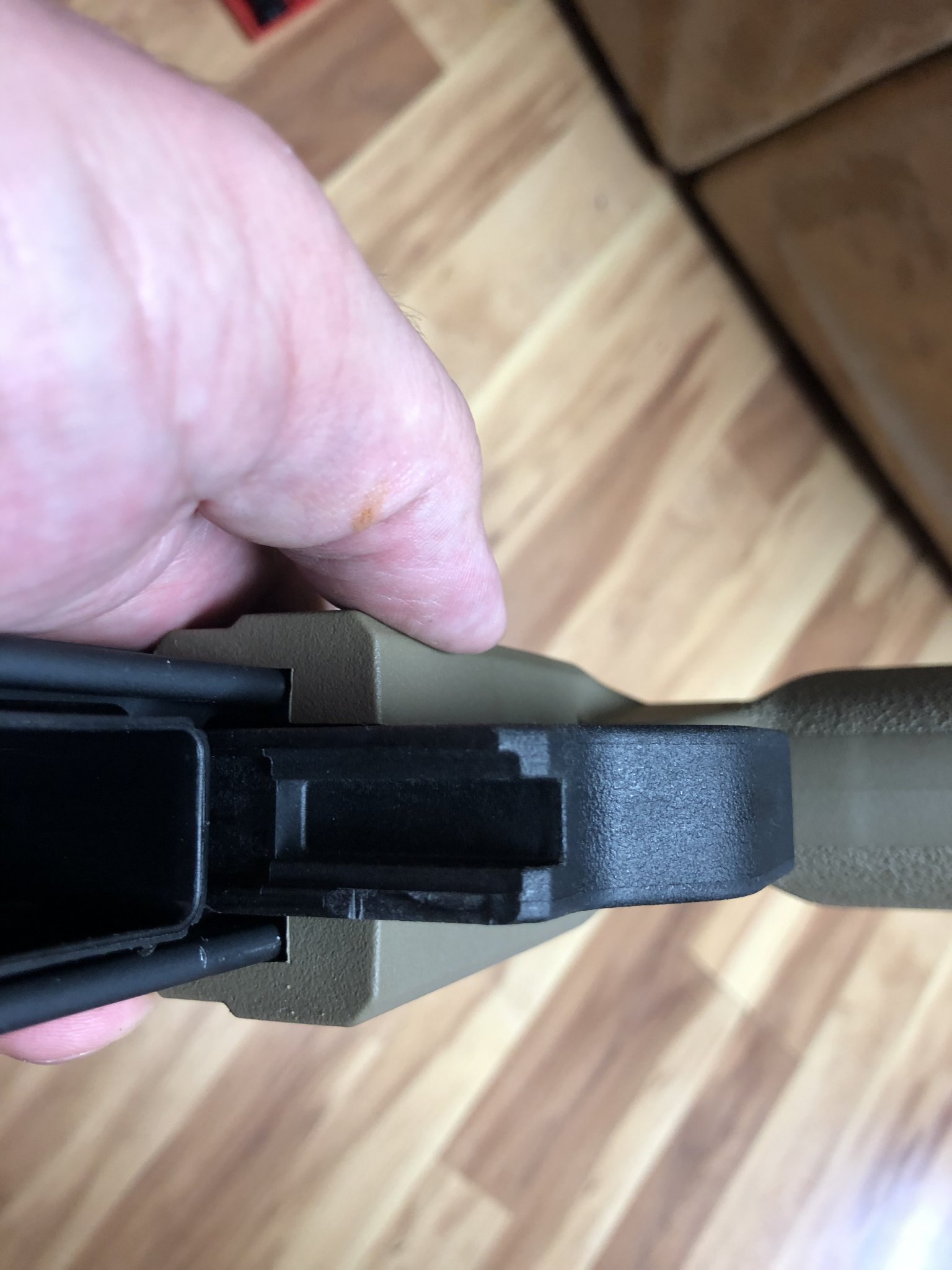

Below photo is me holding the factory grip overtop of the already installed "vertical" grip so you can see how much it adds.

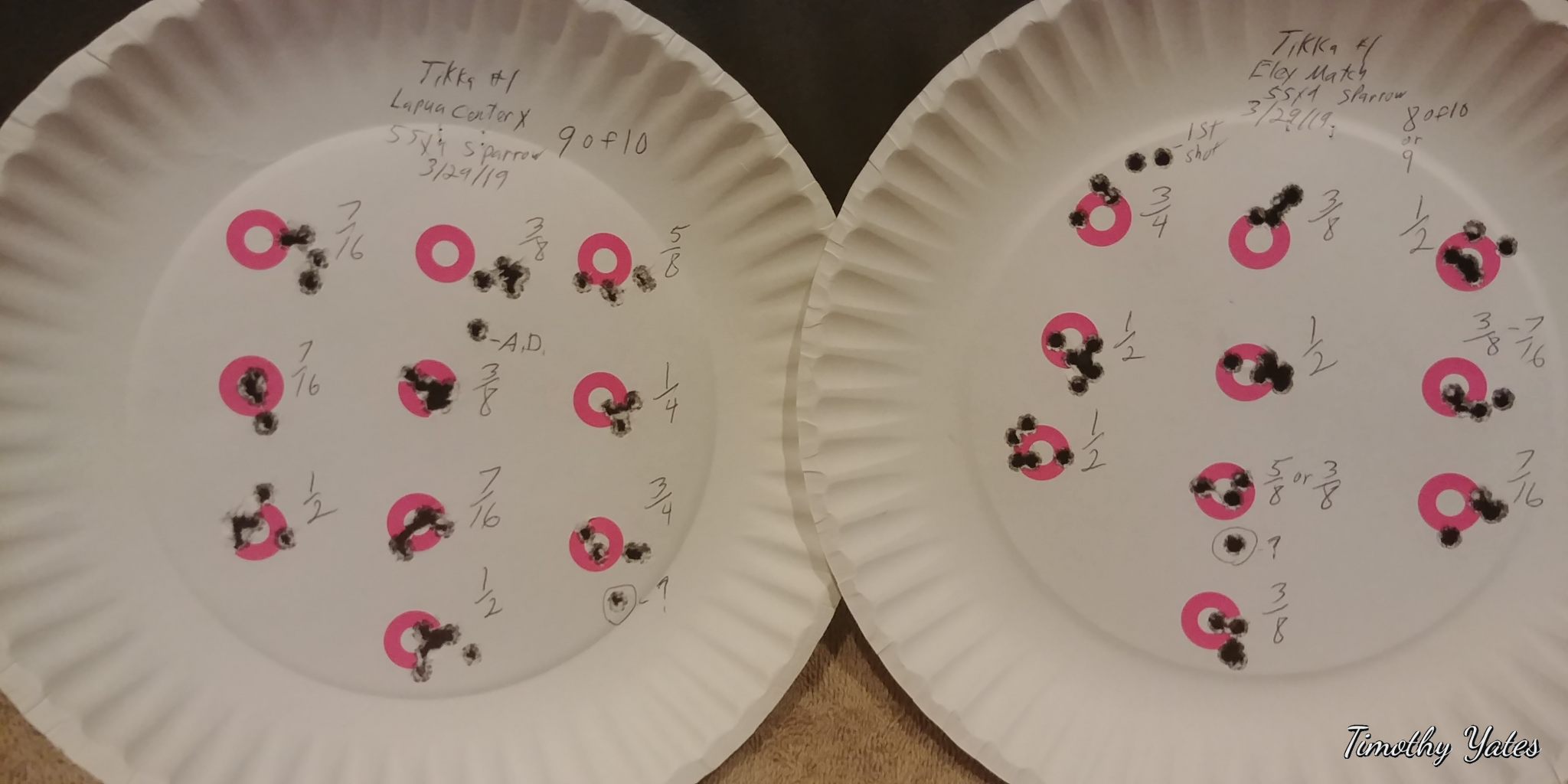

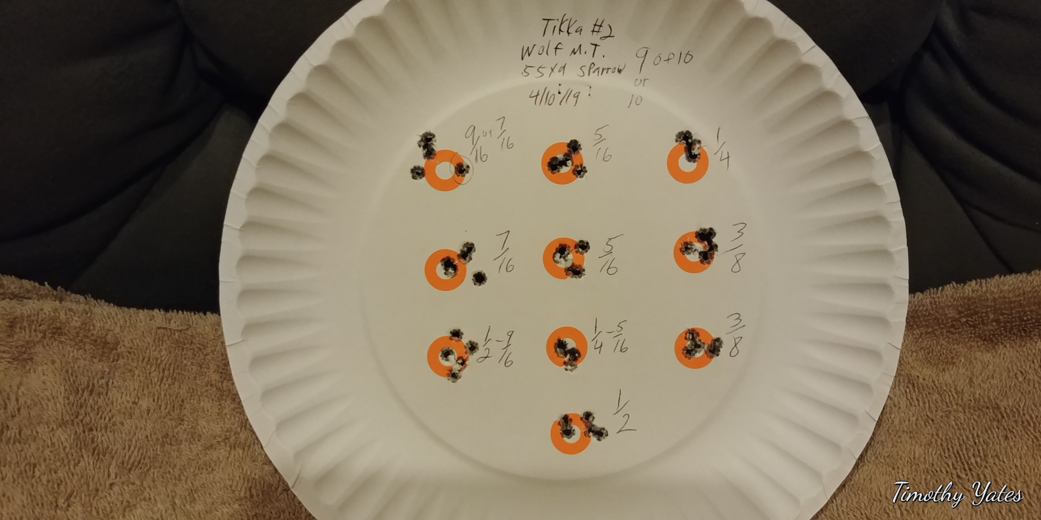

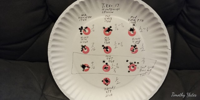

I have three T1x's, one 17HMR and two 22LR. Top photos are groups shot with both of my 22's in different configurations. Below is a target shot with my 17 HMR, all are 10-shot groups with eight different ammo's. Tikka's will shoot.

Hi guys , cheers for the advice ,, I've used a torque driver to set stock screws , had action out , looks to be seated correctly , , tried with out the barrel block too , but magazine would not click in , used two different scopes,just in case that was faulty , but keep getting same results, out of five shots , one hits the bull the rest are in a 2" spread , think I've got the lemon , will try to return it tomorrow
Is it possible for you to take a photo of the barrel/stock gap at the muzzle end?
throwing in my 2c on rail/mounts
I'm playing around with it a bit, have a 0 moa rail on both my T1x and T3x. 40 MOA mount (AD-RECON-S 40 MOA). Tract Toric FFP with 20 MRAD of adjustment. My T1x will not fully zero at 25 yards (and it definitely won't at 50). At 25 yards I hold 0.5 MIL low.
Seems that a 15 MOA rail from Area 419 and a 20 MOA mount would achieve 25 yard zero easily, barely at 50 yards.
I'm QD for now for a few reasons, eventually I'll swap things around and get a proper scope on the T1x though that does achieve zero.
Getting the bolt back together is a bitch. Anyone have any tricks for getting everything depressed all the way and the pin through the shroud?
take a bit of time to inspect the extractor. the extractor pin was too tight on mine, it was actually binding inside the extractor and it interfered with the rifle's ability to chamber a round smoothly. I also took the time to put a bit of a radius in the extractor where the rounds sliding up the boltface would have an easier time getting into battery.
getting the bolt back together is a bit of a trick. Tikka put quite a heavy firing pin spring in the rifle, and it must be compressed in order to reinstall the retaining pin. I ended up putting an old sneaker in my lap, using it as a pad so I had something to compress against without damaging the breech end of the bolt. BE CAREFUL NOT TO DAMAGE THE COCKING INDICATOR AND BOLT SHROUD. best if you have another pair of hands to start the pin and tap it into place while you are compressing the bolt.
Very Nice! I love the FJ Feddersen Barrel that I have on my 10/22. If anyone from FJ is following the thread, please offer this configuration for the T1x for those of us that don't have lathes...
Reactions: Tufelhundin
I sent an email to Fred Feddersen with a link to this thread and suggested he consider making barrels for the T1X. Considering the issues he had with fitment on the CZ rifles, I don't know if he'll be interested in building a new 22LR line.
