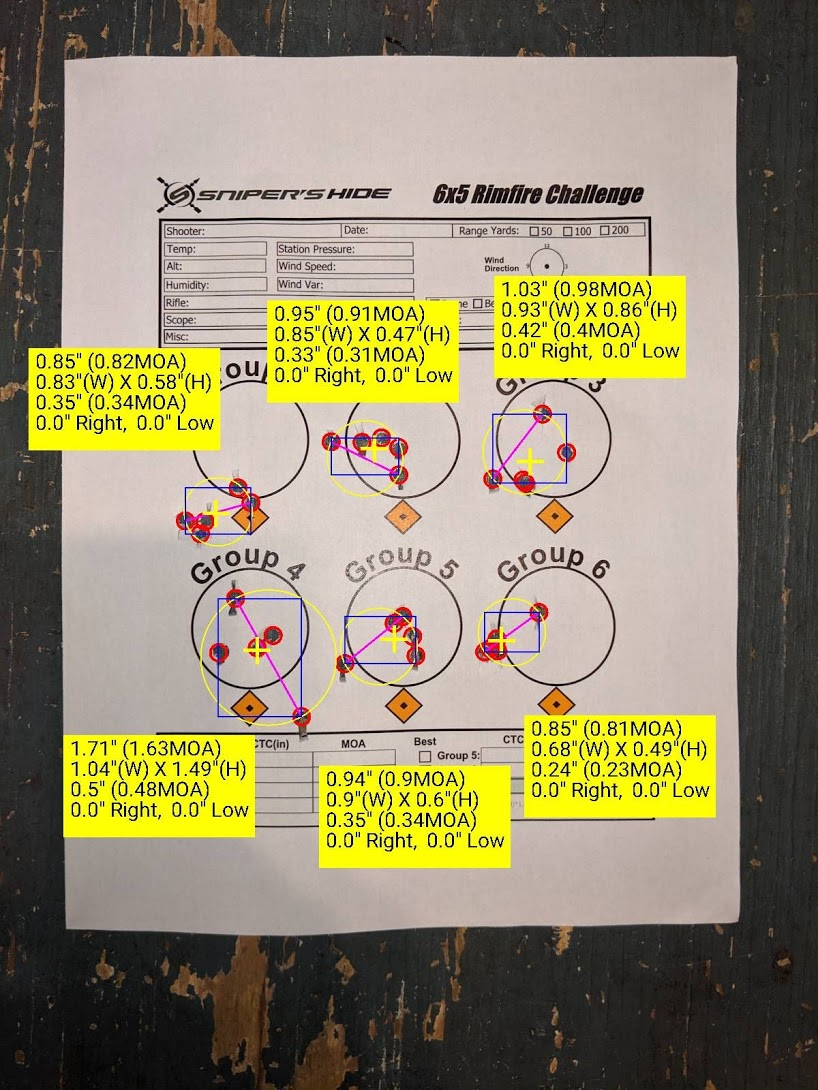

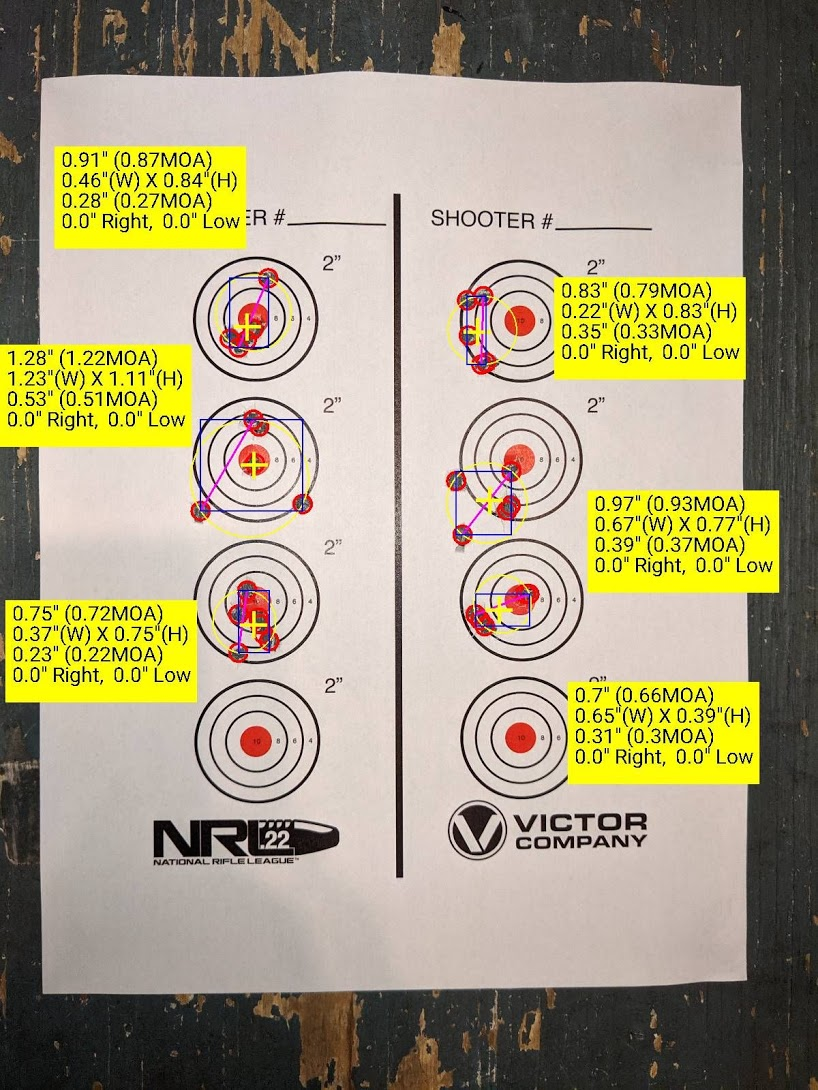

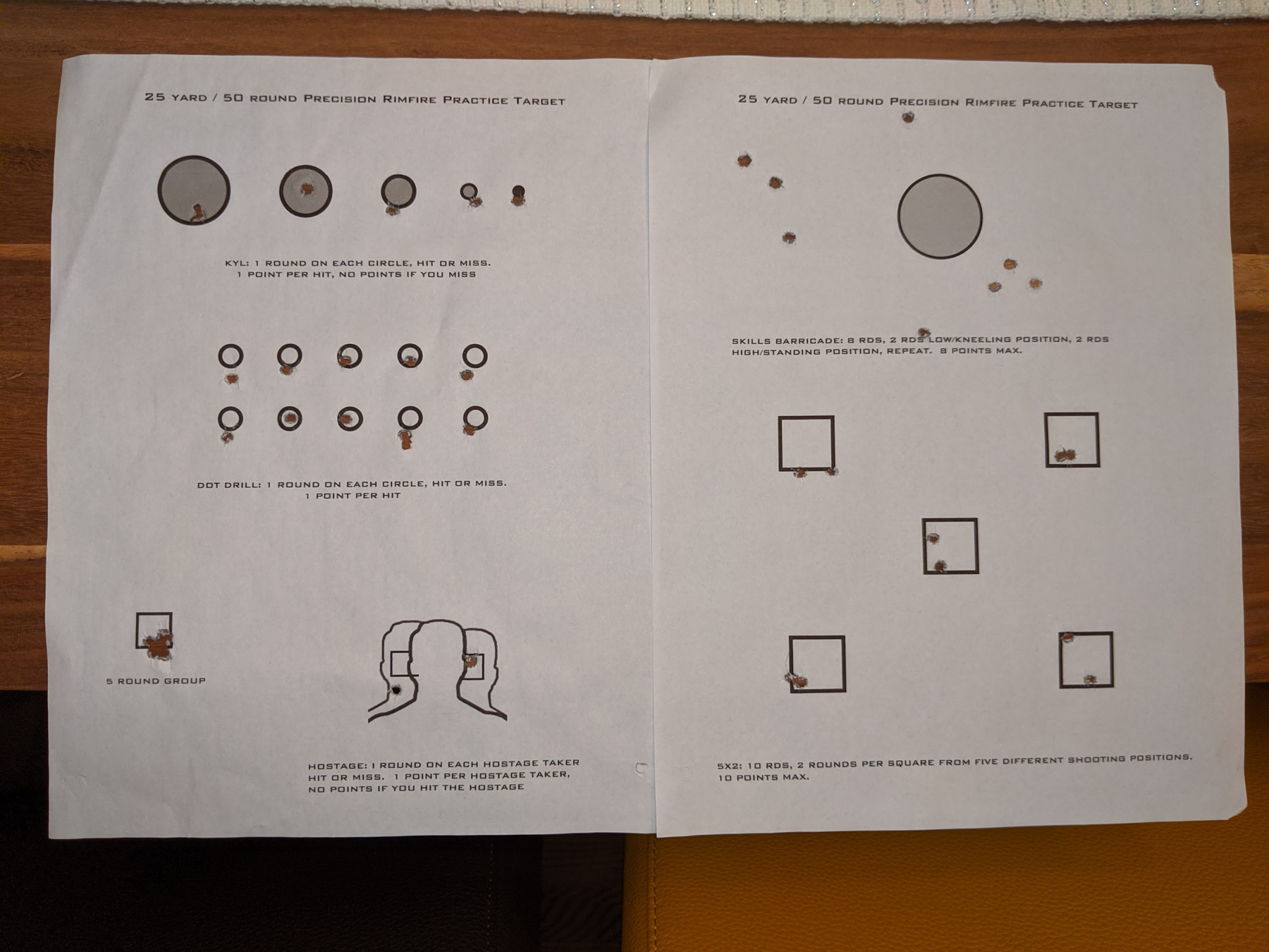

Good job! What ammo are you shooting? I love the nrl22 matches every month.I did my first NRL22 competition today. I did a practice match previously, but this was my first official NRL22, and I finished 3 out of 7. Not that great, but a lot of learnings! Had issues where parallax wasn't set correctly, I set it in some general area where 50/75/100 would be in focus and I was alternating strong and weak side, so I was missing right on a stage on my weak side since I haven't ever practiced that very well. And then I'm also just bad at standing shooting... need to practice that. All the prone stages (not weak side) I did fine. Learned to basically do everything with holdovers. zero at 25, aim a teensy high at 50. 1mil at 75, and 2mil at 100.
All the stages I didn't feel using cheaper ammo hindered me. The targets were never small enough. 1/4" @ 25 I made every hit.
We did do one stage using the NRL22 scoring ring, which maybe having a tighter shooting ammo would've helped. I need to find an ammo with the same BC/Velocity just lower quality. I am thinking maybe Eley Club and Eley Match would be my pairing combo. SK+ and SK RM would be another pairing combo, but RM never shot well out of my rifle.
I then came home and printed out a NRL22 practice guide. I am pretty sure I know what I need to work on... though oops, now that I'm reading it, that top right target was supposed to be on a barricade. I did unsupported standing/kneeling, it was really hard... I did standing/kneeling barricade for the bottom set of squares though, that one I don't have a problem with.

All good, I was just curious. I shoot sk rifle match. I've never tried the eley. The bullet lube doesn't bother me though. Good shooting!!I'm shooting Eley Target. It performs more or less the same as SK+ for me, but I couldn't stand all that oily feeling when loading SK ammo and need to remember to bring a rag with me to wipe my fingers. In terms of prone 100 yards. Eley Target/SK+ gets me around 1" @ 100 yards. Eley Tenex gets me around .7" Though for NRL22, the targets are always 1.5-2" at 100 yards so I don't really need to shoot anything expensive.

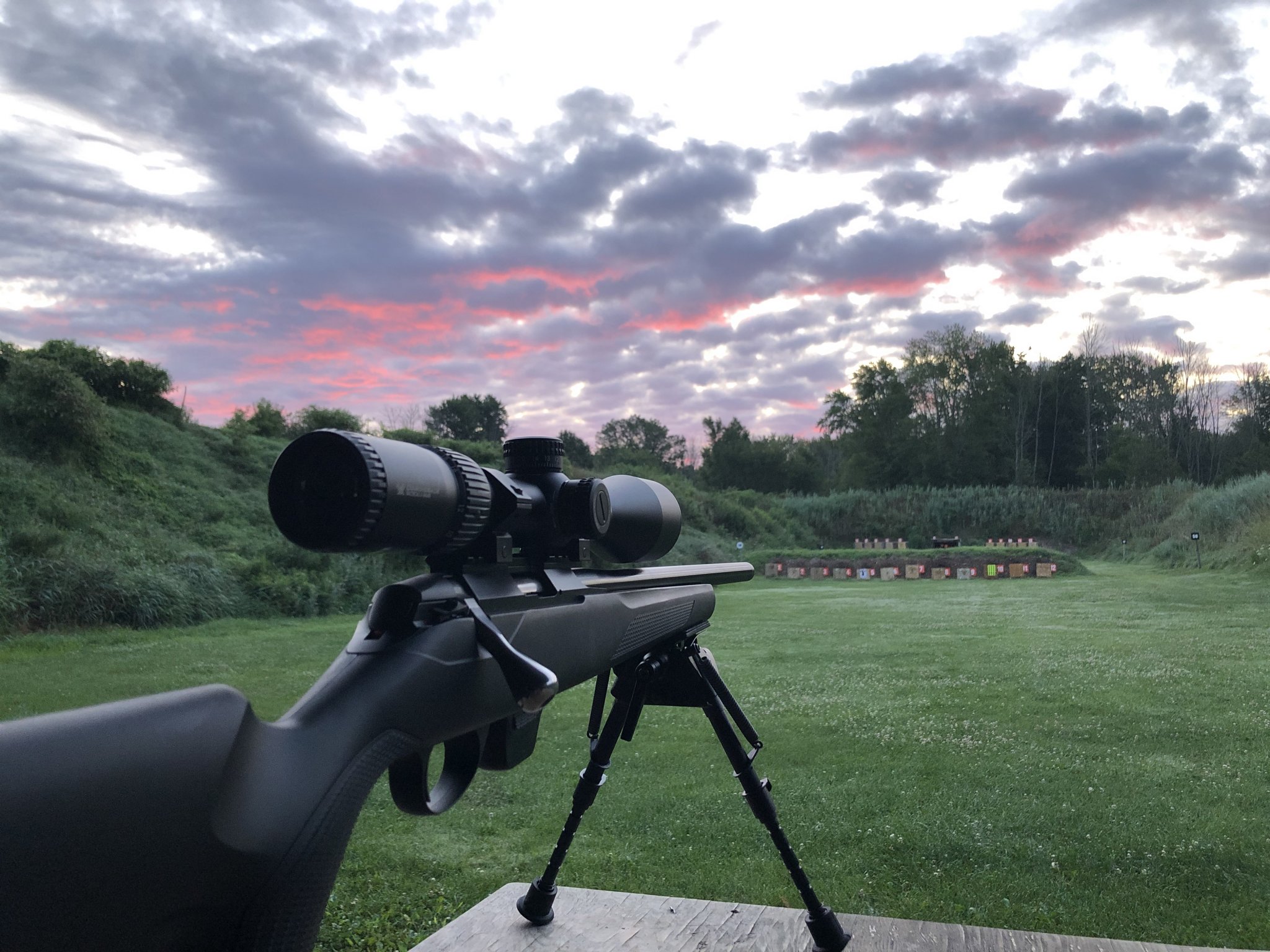

That's awesome! The T3 and T1 bolt handles are not interchangeable.First, thanks go out to everyone for the great T1X info in this thread.
Really considered the CZ 475 AT-ONE or the MTR Varmint over the T1X in the beginning. Locally the CZ’s are pretty rare though. Found a 17 HMR version of the AT-ONE and I really wasn’t impressed with the feel. Seemed to be quite a bit more of my own work (and parts) to get it up to the Tikka stock level.
Ultimately I picked up my T1X from Scheels in Johnstown, CO this past Friday (they had multiple in stock). Intent is to have the first version of my trainer rifle build complete for next Sundsy’s range day. Bravo chassis will need to wait a bit though.
For the first version of the rifle, I ordered the vertical grip, wide fore end, 3 mags and the T3X butt pad from Beretta. Paid the extra shipping to have everything delivered this coming Tuesday. Found the 419 15 MOA rail on Amazon - should be here Tuesday too.
Installed and epoxied in the fore end picatinny rail yesterday, then mounted my spare Larue Harris bipod and removed the plastic bedding block so now the barrel is fully free floated. I have a spare Vortex PST G2 5x25 FFP for the rifle, though with the long sunshade, it looks a bit goofy - we’ll see if it stays.
Also dropped the trigger pull weight down to ~1/4 turn above the bottom of the travel as it has a bit better feel. Trigger spring replacement will follow, but my best guess is that it is about ~2 pounds or so.
Unsure about which bolt handle to go with, so I’ll leave it stock for now. Does anyone know if the T3X bolt knob is a direct replacement on the T1X? I’ve read through this complete thread and haven’t seen anyone comment directly on that topic.
Like everyone else, I too look for a heavier barrel and am very curious about the 10/22 barrel usage. Hopefully there’ll be a manufacturer that will build them for us.
I’ll post a pic after all the parts are installed. More to come after I shoot it next Sunday.

@rwatson708 attached the pdf for the practice.

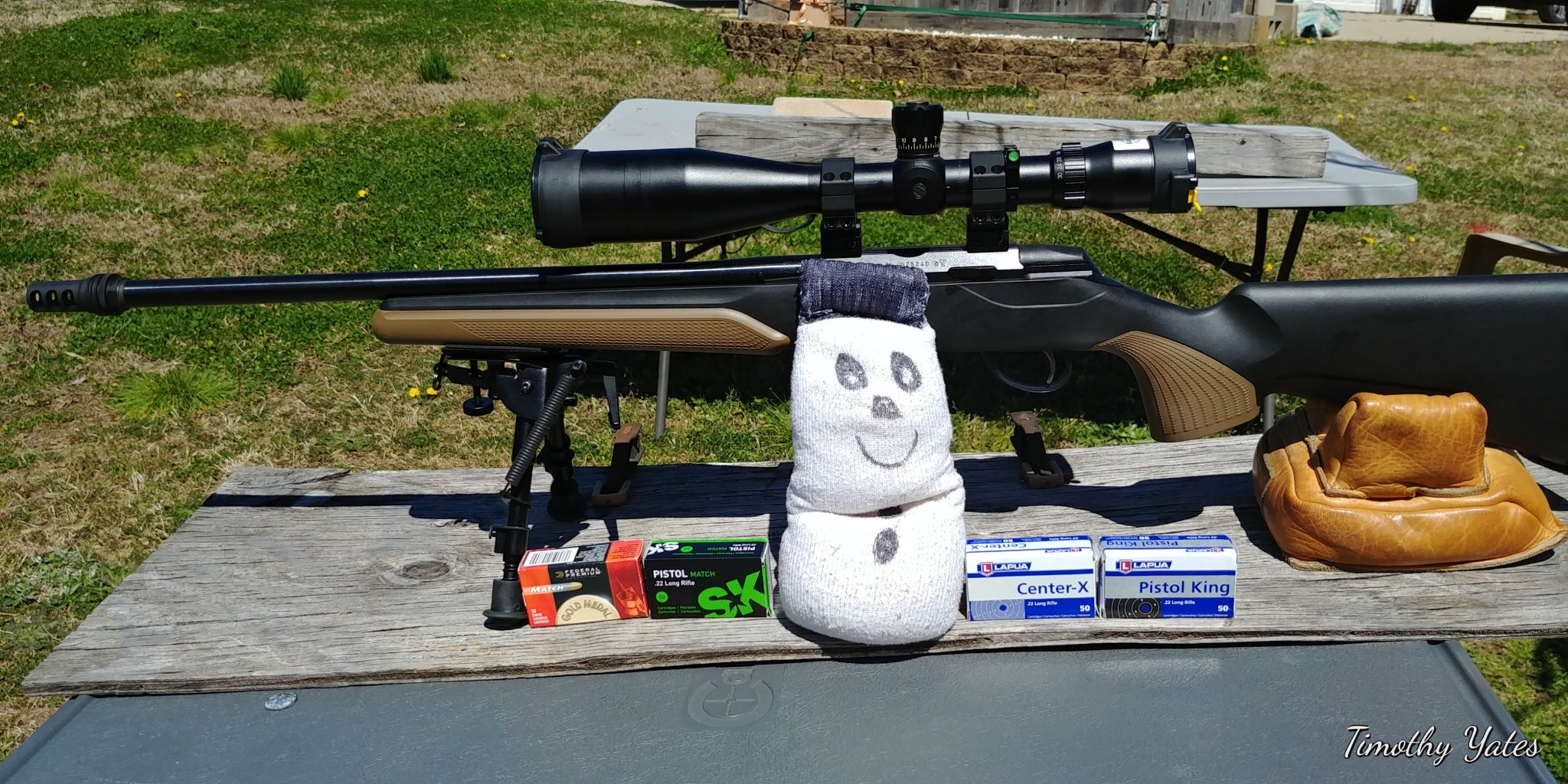

I did notice that I had more FTF with the BA in the KRG Bravo torqued at 65in lbs. when at a lower torque and in the Factory stock I had very few FTF.
Do notice much of an accuracy difference between SK rifle match and center x?Also, I had practically zero FTF until I began to run the Center X.
Yeah....that might give you some bad results ?I have not had a chance to properly test SK Rifle Match. The one time I did shoot it, my recoil lug was on top of instead of in the recoil lug pocket on the KRG.
I had very few issues when breaking in my rifle. I spent one afternoon and put 500rds through it of CCI SV and cheap Federal. Very few issues there. This was all done in the KRG Bravo.
The majority of my issues are with SK + as this is what I have about 3k rounds of and it shoots well out of my CZ455. Also, the 455 has not had a single feeding issue now matter the ammo or how dirty.
I dig the accuracy of my T1X but I don’t want to own a rifle that can’t feed what I want to feed it.
