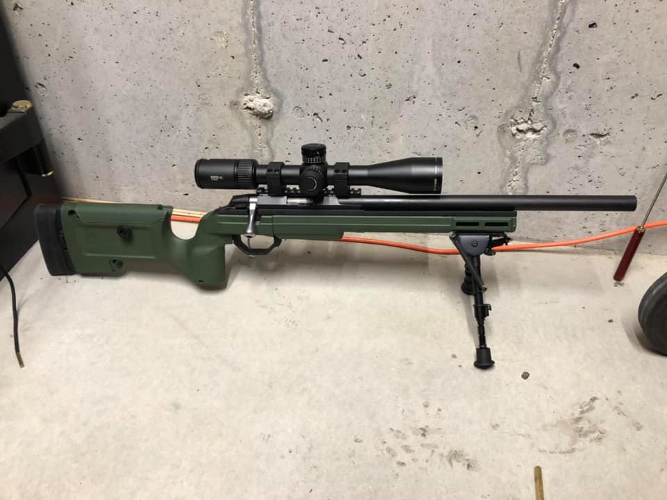

I have acquired a 3rd T1x, "I know, I'm crazy". I got it in a Rock Island Auction a couple of weeks ago. I just wanted to say that I had ejection issues with this one too. Bent the spring several different times and ways and finally got it to where it wouldn't shave lead when feeding and will eject 100% now, based on shooting 450 rounds today.

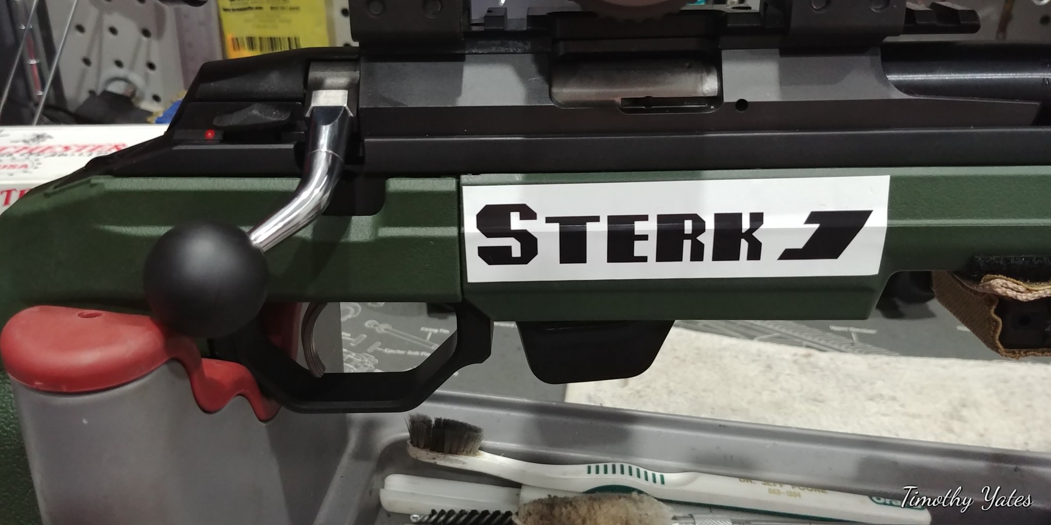

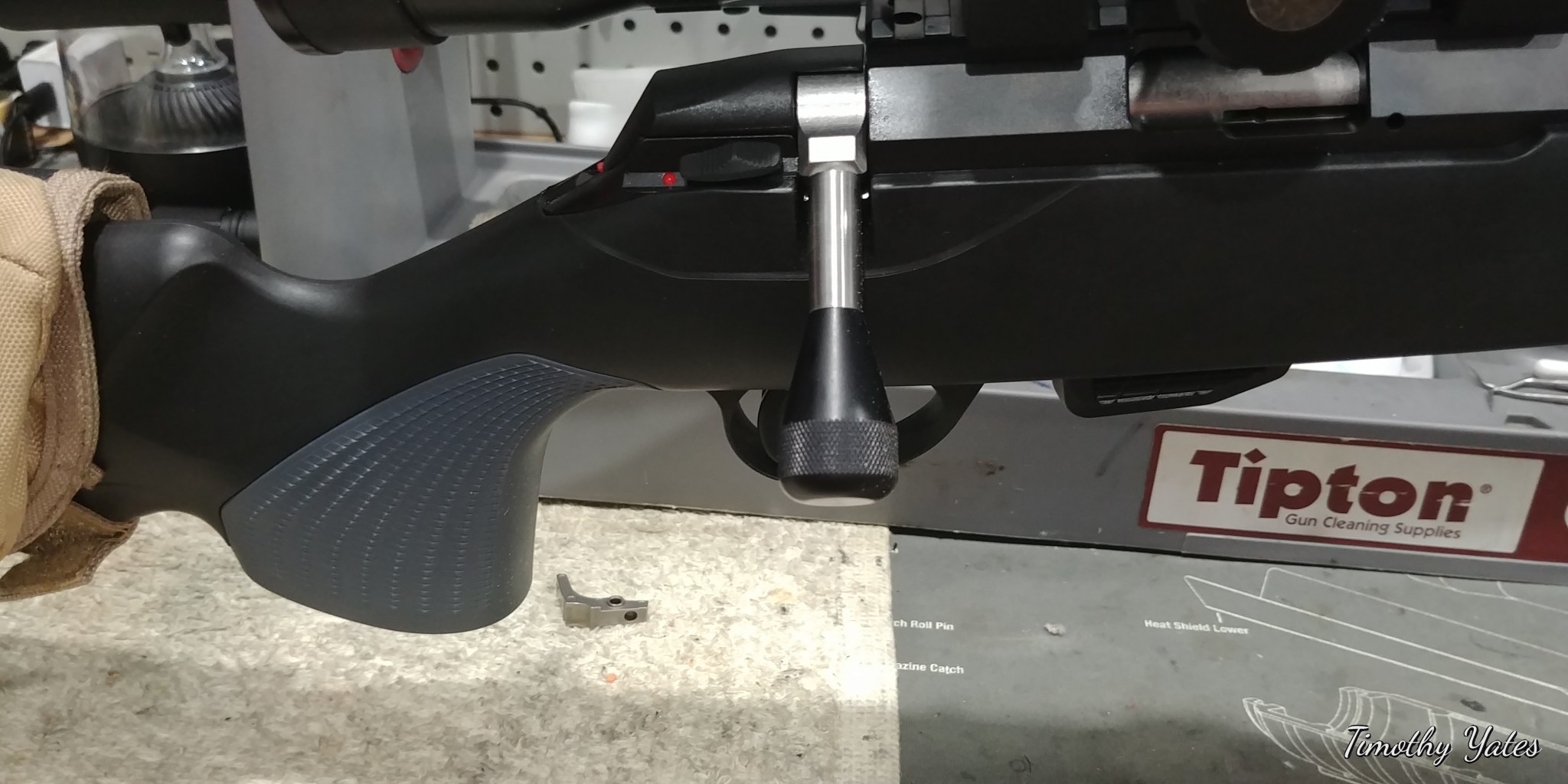

I also just bought a Mountain Tactical bolt handle/knob. I still think Sterk is best but I like to try different things sometimes. For the guy who wanted to know about bolt handles, here are Sterk and DIP.
Good on ya! Both are looking good! :)
I'm sure that my own arm could be twisted into a 2nd Tikka for Sporter Class 22 Bench Rest. Can't shoot sporter class in bench rest with the action in my XLR - would if I could - could go limited though...
As for bolt handles, I'm on the list for a Sterk and I currently have the DIP. The DIP MUCH better leverage than the original/stock bolt handle. I'm "guessing" that with my hand size the swept Sterk could fit me a bit better, but the DIP is a solid choice over the stock bolt handle.

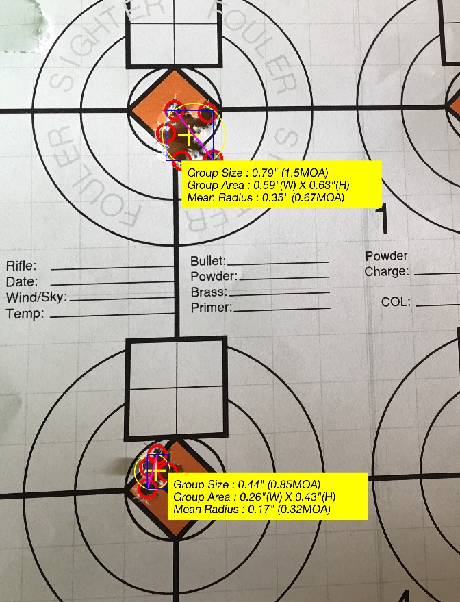

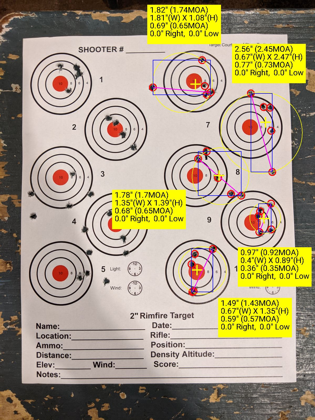

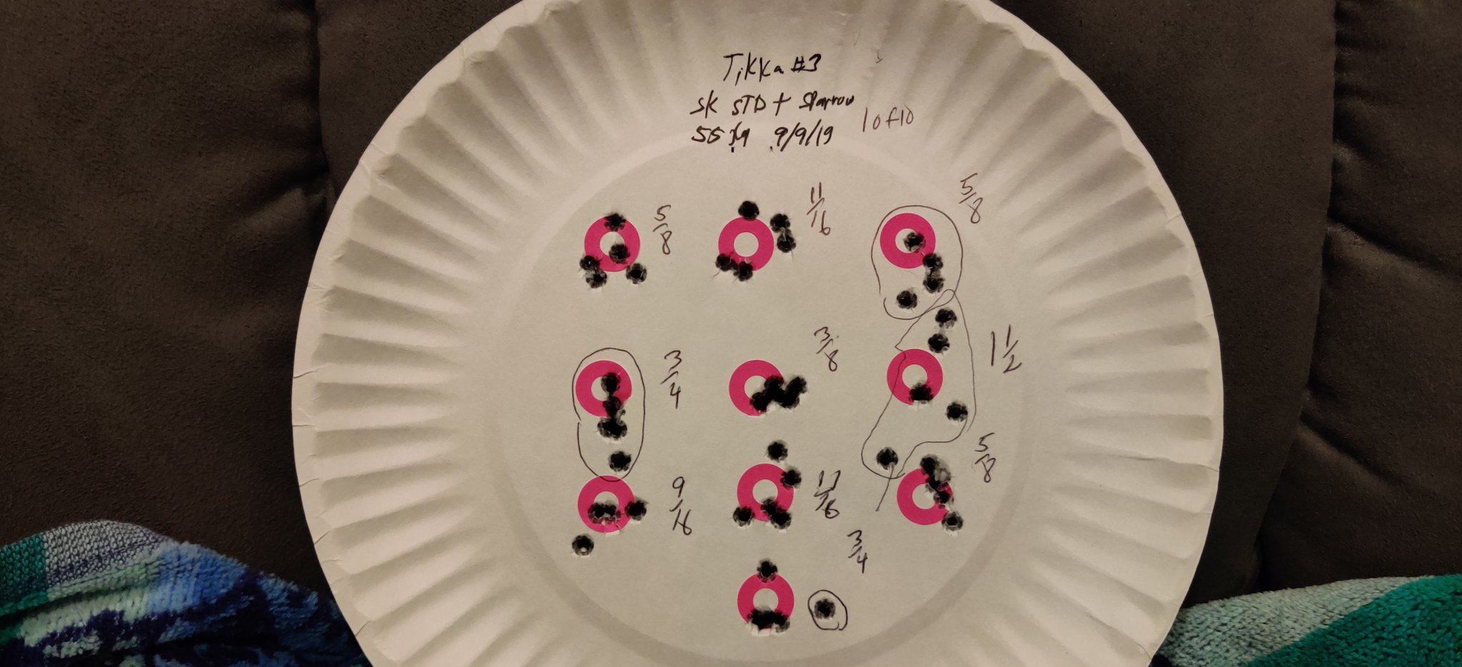

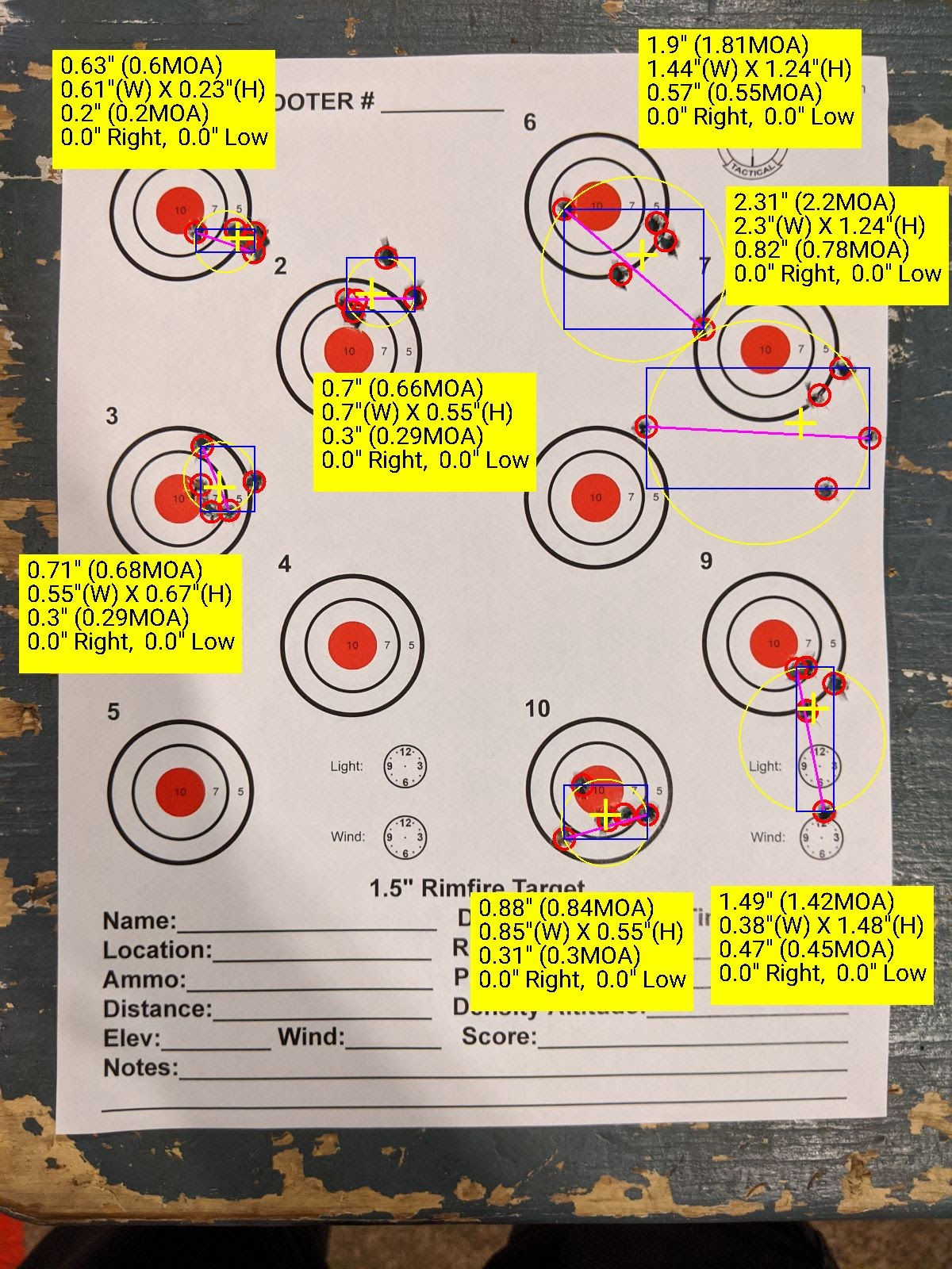

Additional results from yesterday with SK+. Shot some Eley contact but wasn’t impressed with it in my rifle.
Note: these groups significantly tightened up after torquing my action into the KRG at 30in lbs compared to 65in lbs.
Within the first 100rds.
Top left is the first 10rds after getting it back from Beretta.
Bottom group is right after walking steel from 210 to 130yds.
Sub moa at 100, but > 1 moa at 50?
... I'm going to go home and untighten my Bravo down to 30in lbs from the 65 :) Maybe that'll fix my groups :D
There is a video out there of action screw torque tests. Utah Shooter perhaps?
They went from 5 in/lb to 40 in/lb (I think). I haven’t ran any tests to see where my gun shoots best with the Tikka in the XLR, but I’m currently using 40 in/lb.
In the original Tupperware stock, I tried 25, 30 & 35. My rifle shot best at 30 in/lb. Never went any further with the plastic stock as I knew I was going to the XLR Element.
If time allows, I’ll test it like they did in the video, but right now she shoots great.

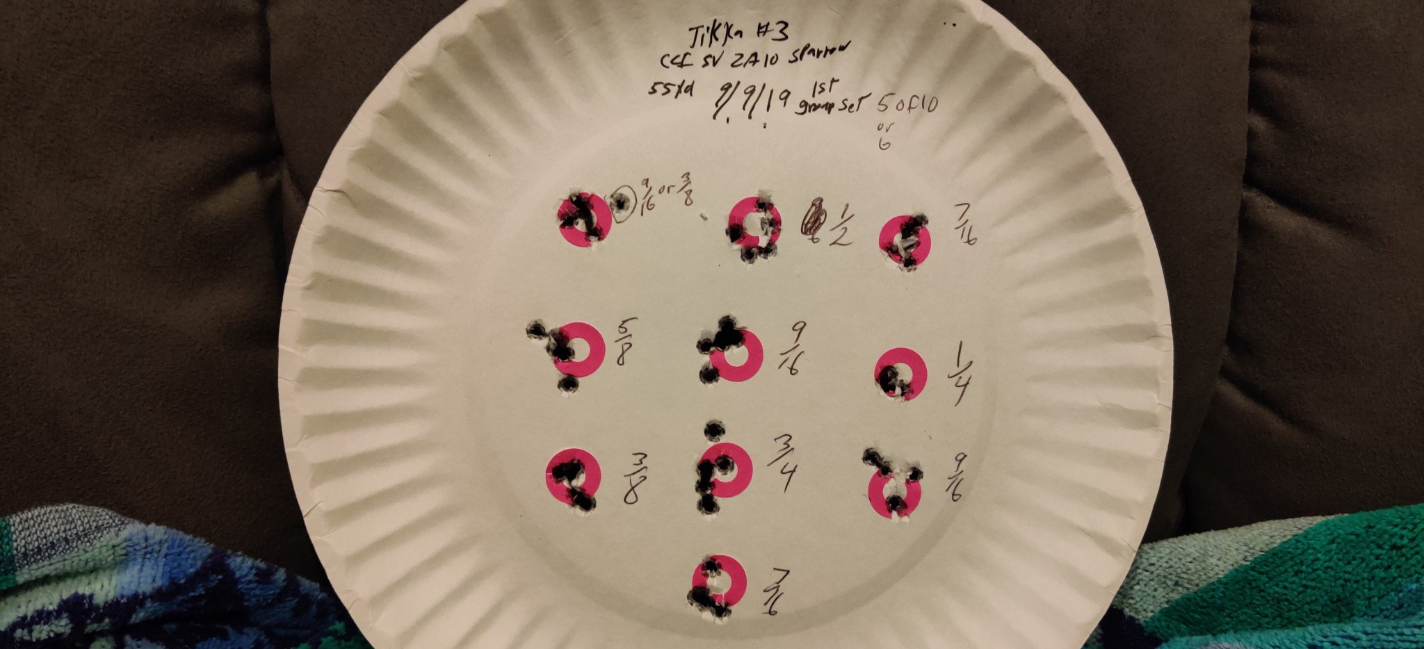

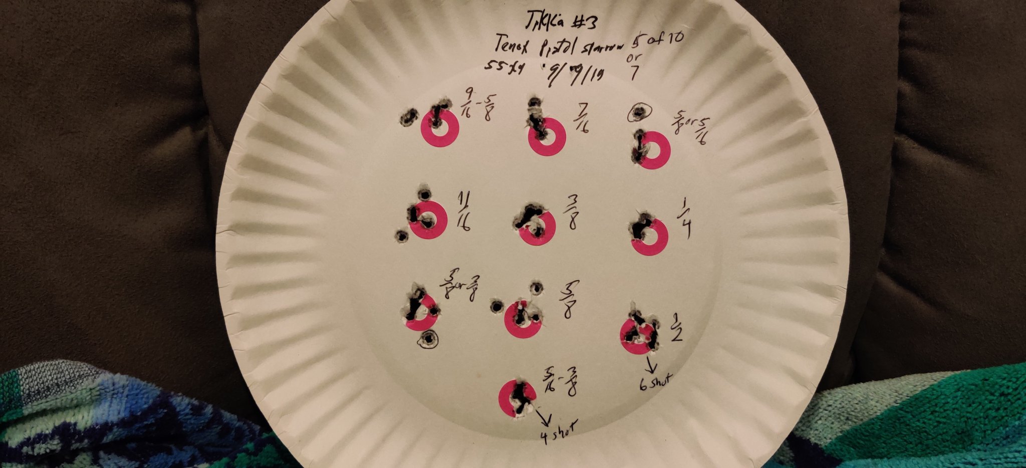

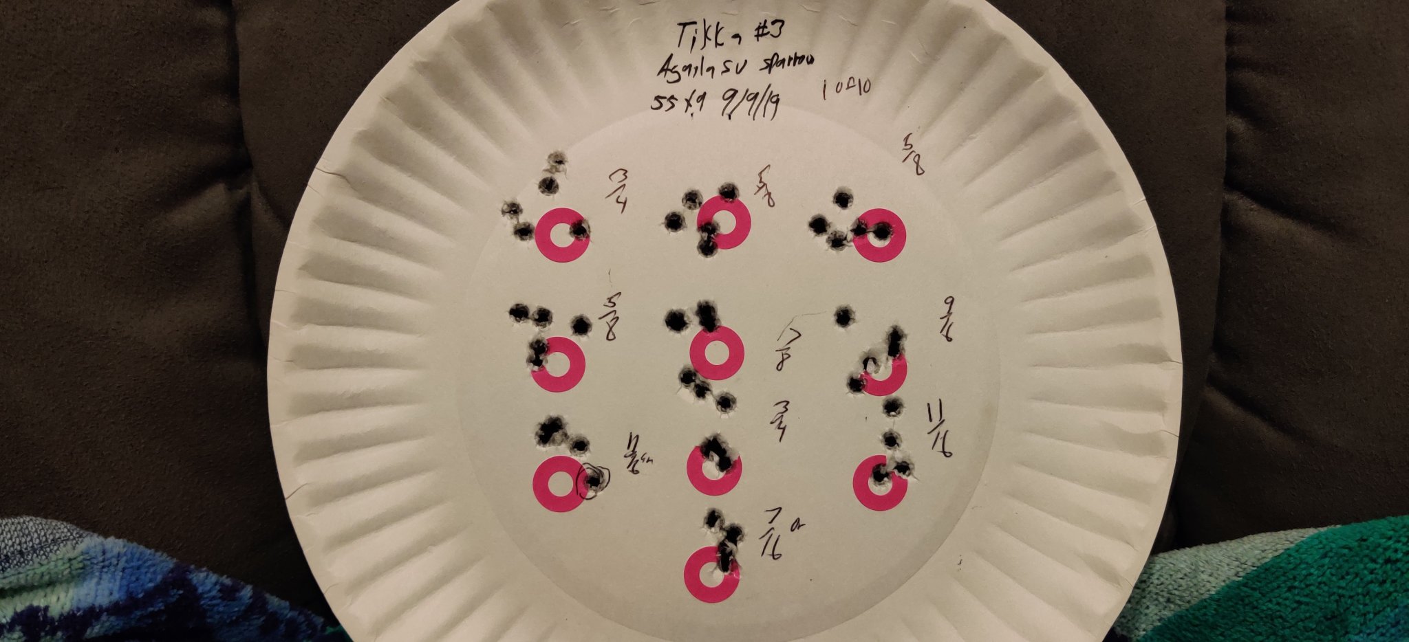

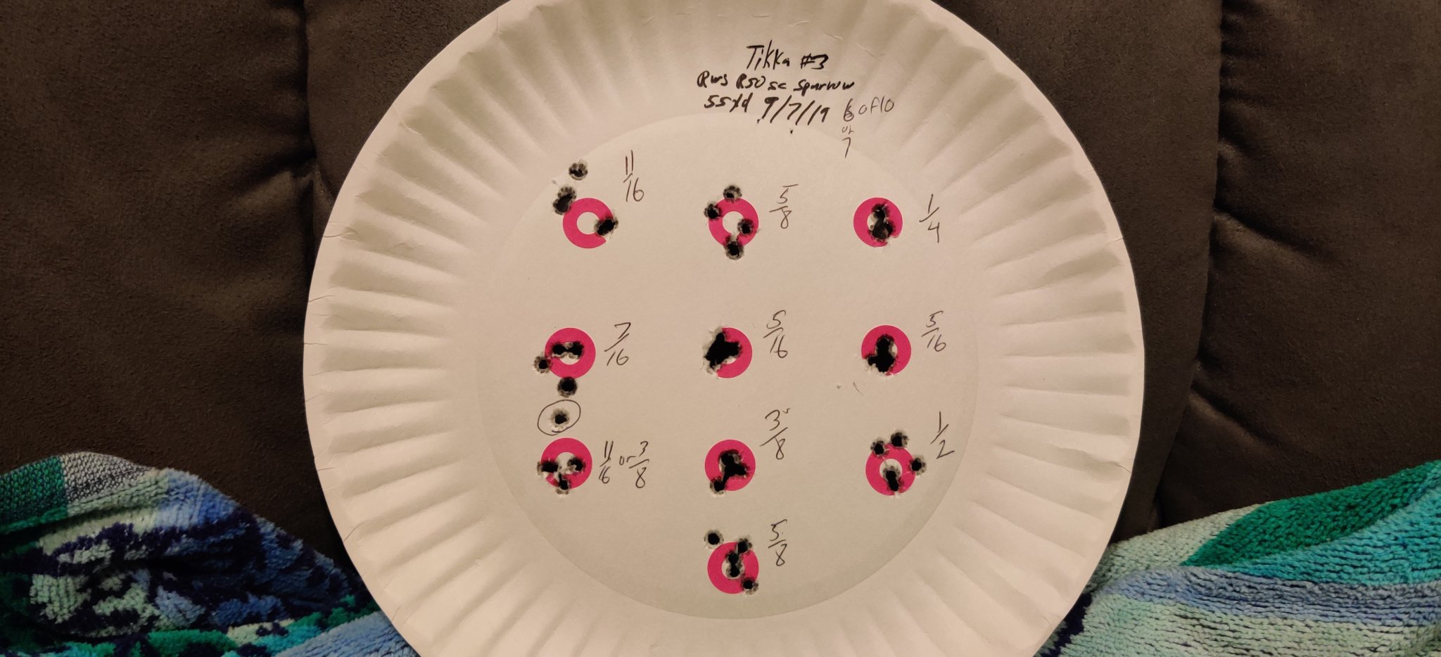

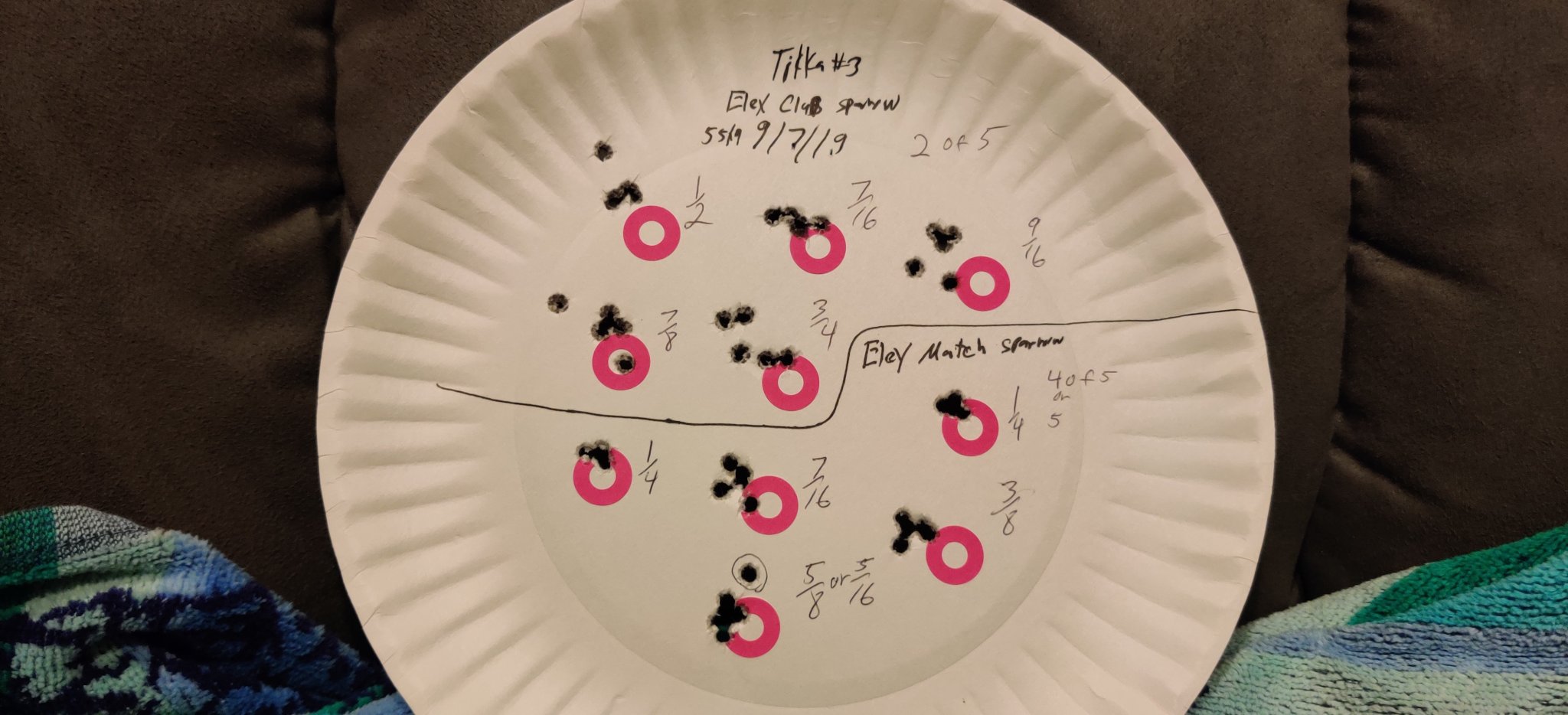

This is a follow up for my Tikka T1x #3 as mentioned above. A couple of days ago I shot this LNIB rifle and had a lot of FTE, probably 50 to 60%. This was the worst of the 3 I have. I started adjusting the ejector to where it would eject but then started shaving lead on feeding and this was a battle so I stopped shooting on that day to fix. I got four ammo types tested before quitting for the day. After messing with the ejector through trial and error, I finally got the Tikka feeding with no bullet shaving and smooth as glass feeding. As you know "or maybe not" live rounds eject pretty good and is not an indicator of how empties will eject, fortunately for me the ejection rate so far has been 100%.
I did put the new Tikka in my KRG Bravo stock because I wanted it to be the best it could be. I start all my rimfires out with a torque setting at 20 in/lbs no matter if the stock is wood, aluminum, plastic or something else. Scope was at 18 power. No photos of the rifle this time as there is really nothing different to show that anyone hasn't already seen.

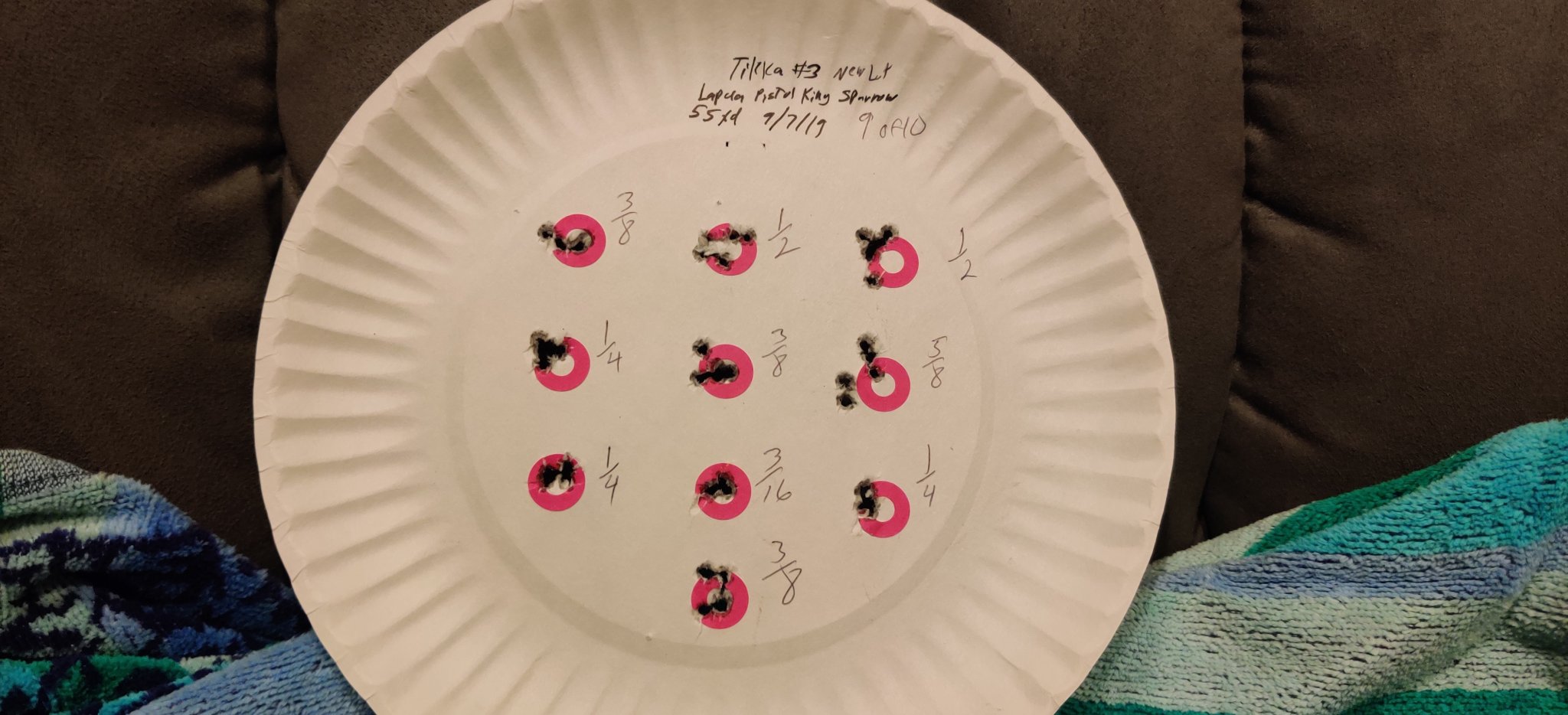

So, here are the accuracy results showing the capability for this T1x. Top to bottom are rated best to worst for each day. All groups were shot suppressed with my Silencerco Sparrow. So far I would rate the accuracy equal to my T1x #2. I'll be putting the Tikka #1 up for sale soon. At some point I'll be putting it on Gunbroker.
Lapua Pistol King was fantastic. Had one bad group that was probably me.
I only had 25 rounds each of the Eley Club and Match. I think it's a good comparison between a $7 box and $12 box ammo for the same maker.
At some point I'll reshoot the RWS R50. I believe it can do better.

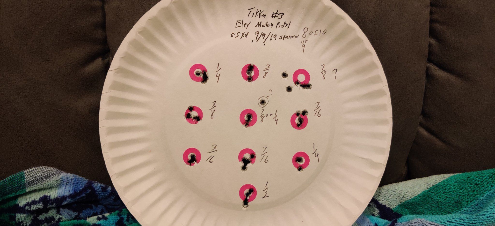

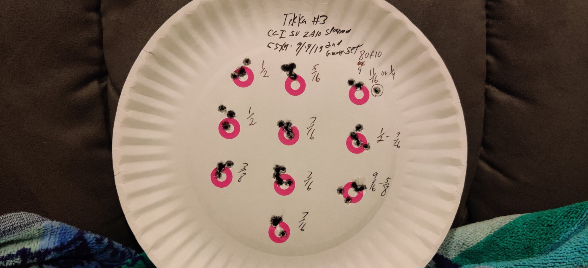

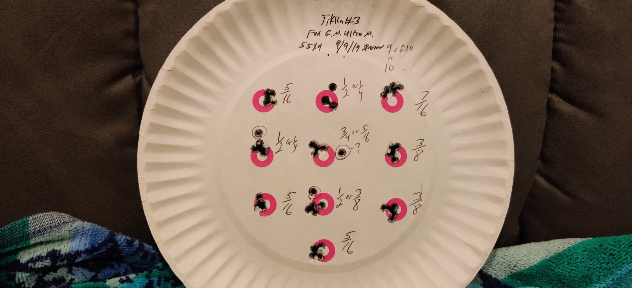

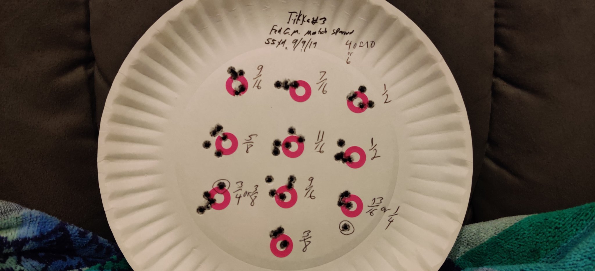

All below were shot today on 9/9/19. Also to clarify the CCI SV 1st group was the first 50 shots tested and the CCI SV 2nd group was the last 50 shots tested. I really thought the Tenex Pistol would have done better. The Aguila just proves you can't take chicken shit and make vanilla ice cream out of it. Chicken shit being the Aguila and Vanilla ice cream being the Lapua Pistol King. The Tikka being the mixer. That's my thoughts anyway. Aguila is "ok" for 25 yard pistol but that's about it for precision work.
Reactions: 013 and littlepod

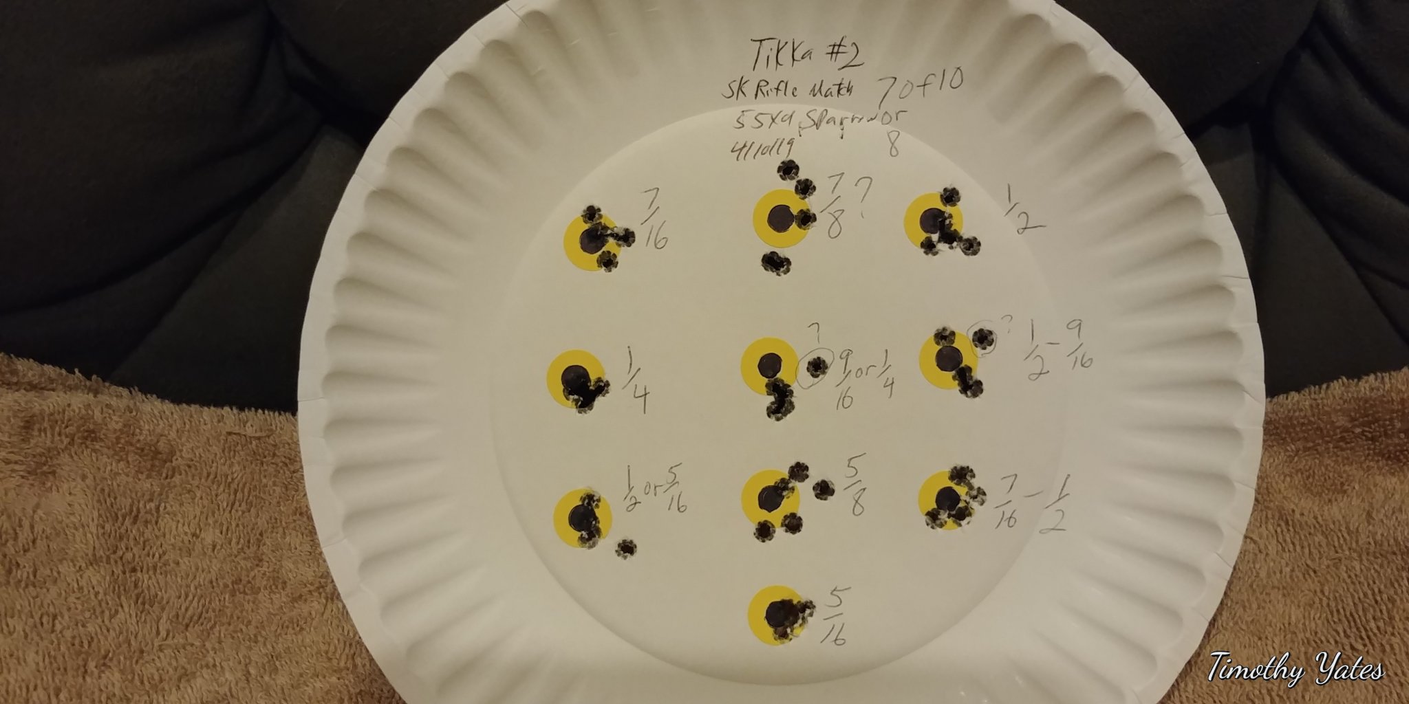

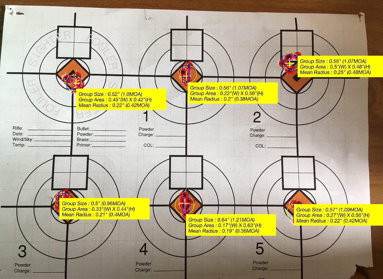

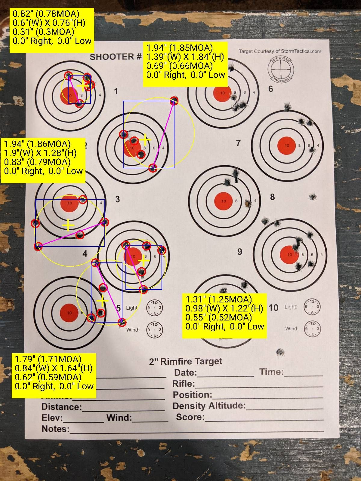

Had about 40 min to go to the range today so I didn't have too much to try things out. Learned a few things... fouling makes a pretty big difference... it takes about 15-20 rounds to tighten up my groups. Unfortunately I didn't have that much time...
My rifle had been shooting CCI SV during the last session about 35 rounds so I ran 5x5 with it. First group was great, then it'd open up, overall maybe not the most consistent ammo in the rifle, possible if I try out a batch of green tag it might be more consistent.
I then switched over to Eley Club. 5 rounds at the 25 yard range to verify zero (0.2 mil low POI), so accounted for that and adjusted 2mil for my 100 yard target.
Groups had random flyers, but then tightened up after another 10 shots or so.. But still my rifle is not liking Eley Club, which is odd.
Then I switched back to my old lot of Eley Target. Last box :( Very first shot, went like 2 inches low and right. But after that, it grouped perfectly fine. I did 3 groups with this lot of Eley Target. I'm going to miss this lot. It's the 3 lots on the left. 0.7" avg.
I then switched to a new lot of Eley Target. The coating on the bullets were different, and bullets were a lot darker too. First two groups were pretty atrocious. I am guessing new lot of ammo, possibly different coatings, need to be refouled? After 10 rounds, my last 2 groups were acceptable. In my last few box to box comparisons Eley Target is performing better than Club.
Next up will be some green tag and eley contact once I order in some contact.

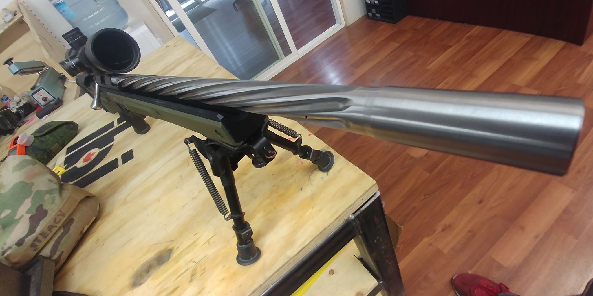

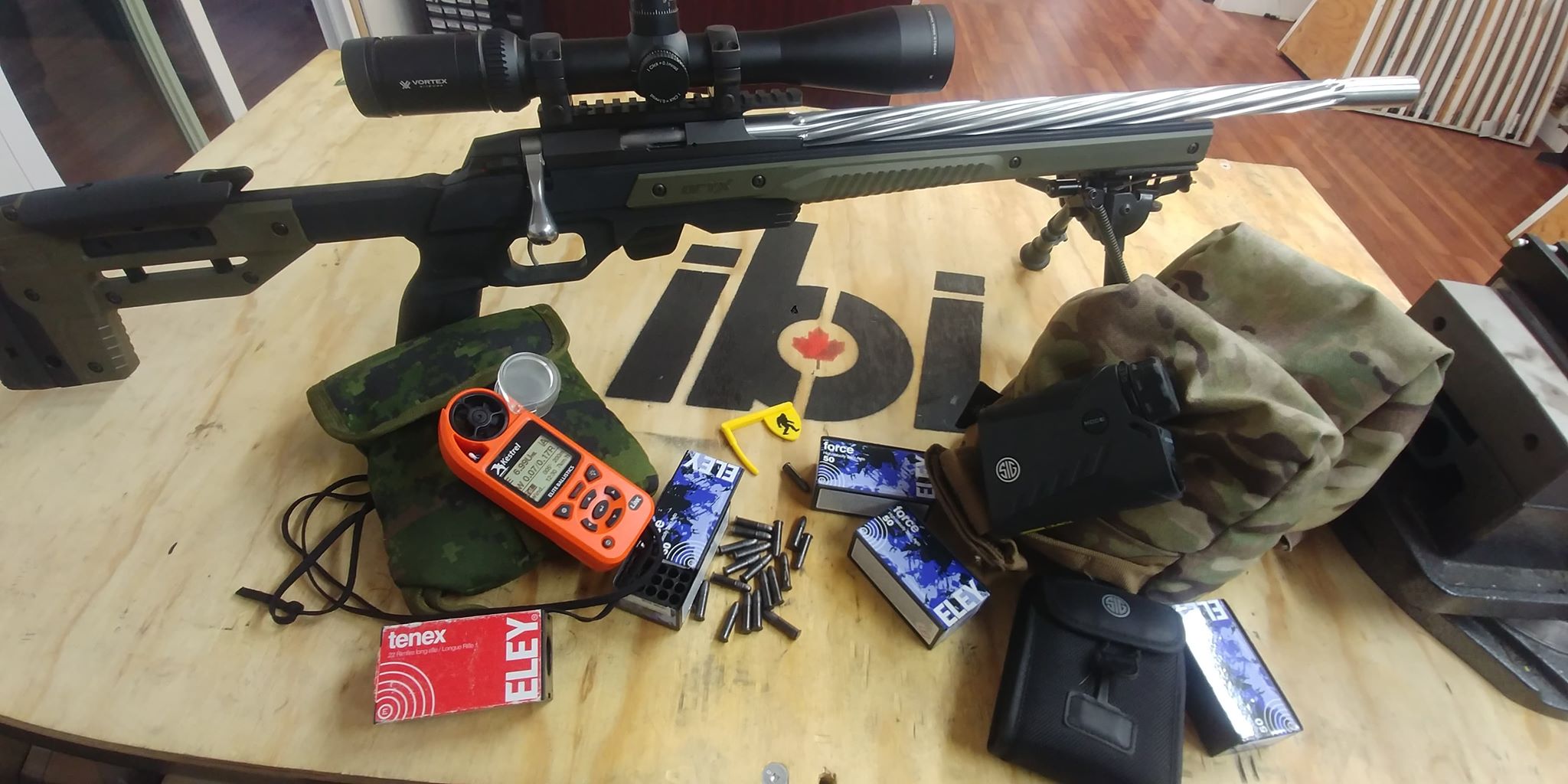

Just got off email from International Barrels Inc and they're just about ready to sell in the US. They asked me what I wanted... which I have no idea since I've never bought barrels before.
If I had bought a Vudoo, people talk about 18" Kukri barrel, which I'm not sure what that means but it's popular. Any advice / recommendations on what kind of barrel profile to order for the Tikka? I don't really want a 16" shorty as I would like to somewhat be similar to my centerfire which is 20-22". I was considering 18". Is it worth fluting the barrel? Seems more of aesthetics / weight, but if I'm looking at making my rifle more centerfire like, then I'd just skip the fluting. I don't need to get rid of heat as 22 doesn't really build that much heat.
It seems like most of the makers I talked to have a barrel between .875 and .92 by whatever length you want. I got a 16” for mine so I can add a suppressor and still have a reasonable length rifle.
I would recommend the higher end SK.

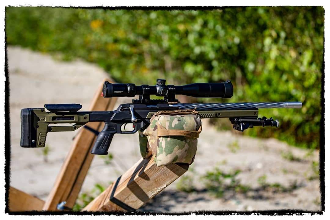

I'm getting a barrel just like this one. According to Ryan, extractor grooves are being cut now on the barrels destined for the US. FYI, they don't thread barrels for muzzle devices. I will be getting the 20" barrel with the Anschutz style fat end. Ryan assures me the fluting will not affect accuracy at all. Here is a copy and paste quote from his email to me, "To the point where if you want threaded you're gonna have to get her done aftermarket. The boys in the shop refuse and I'm ok with that as well. As far as fluted and un fluted we saw zero change. But since we do double stress relieve our blanks its not that surprising."
Reactions: 013
Okay, was fluting extra? I got the price of $319.
Am I going to need to go to a gunsmith to install/properly headspace the gun? I don't mind it not being threaded I guess... leave my suppressor for my 10/22. Someone mentioned how horrible it was to remove the barrel. I wonder if I should just ship my rifle to IBI and have them do it all and ship it back.
What made you choose 20" over 16 or 18. Rimfire velocity wise caps out at 16.5"?
Fluting is $100 extra.
You shouldn't need a gunsmith to set the headspace.
I will soon be removing one of my barrels so I'll tell you how it is. ATM, I have no idea.
I chose the 20" because I wanted to get more for my money. ? No, I chose 20" because it's what I wanted and I believe the 20" will look better in the Bravo stock with the spigot mount on the end.
