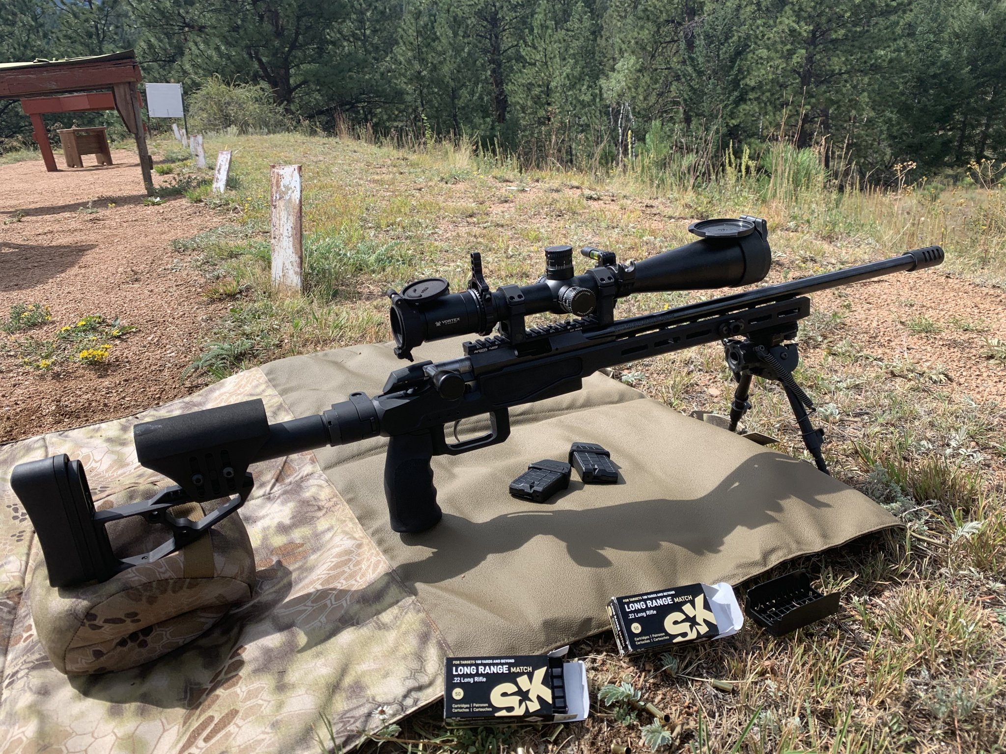

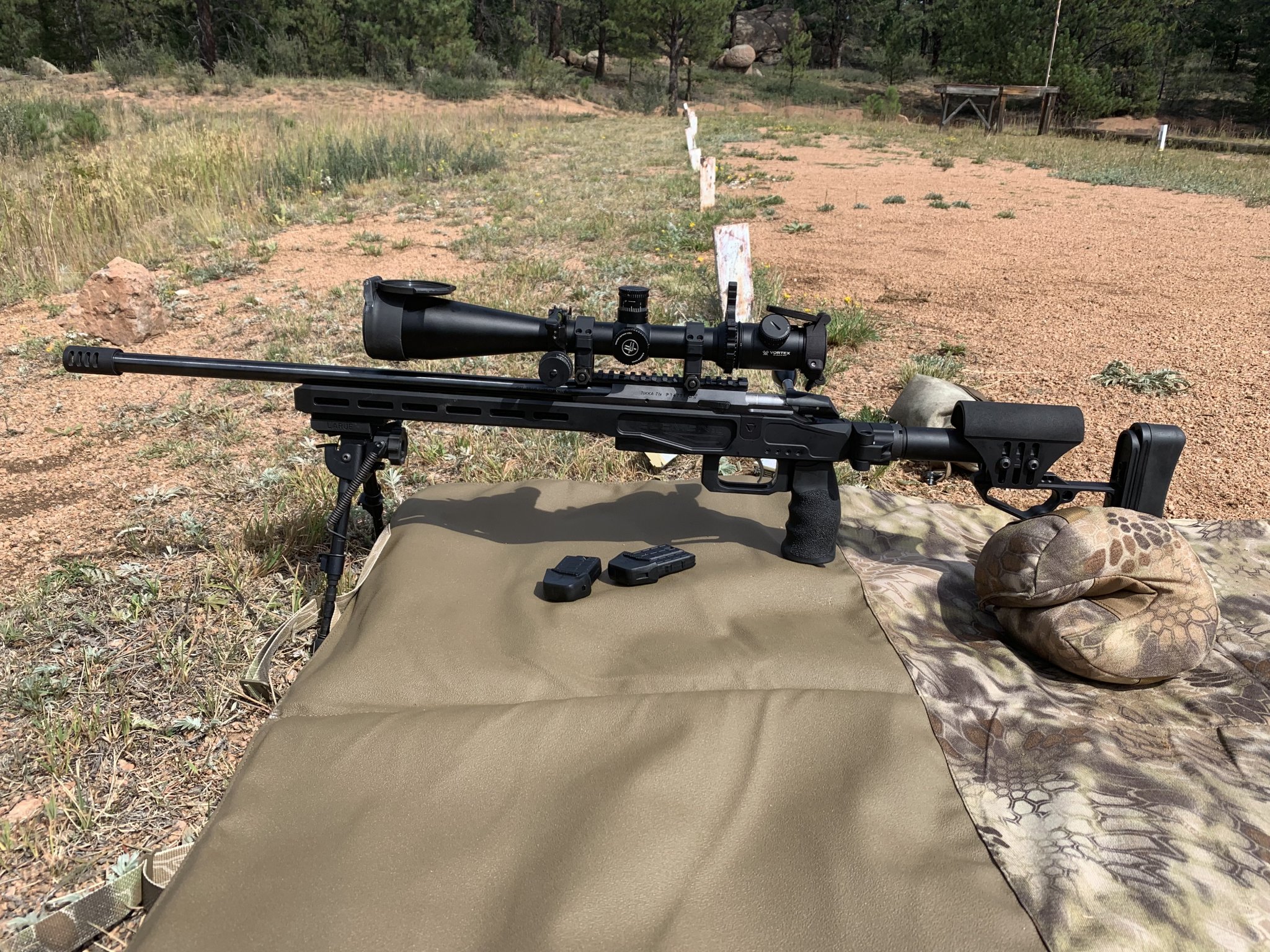

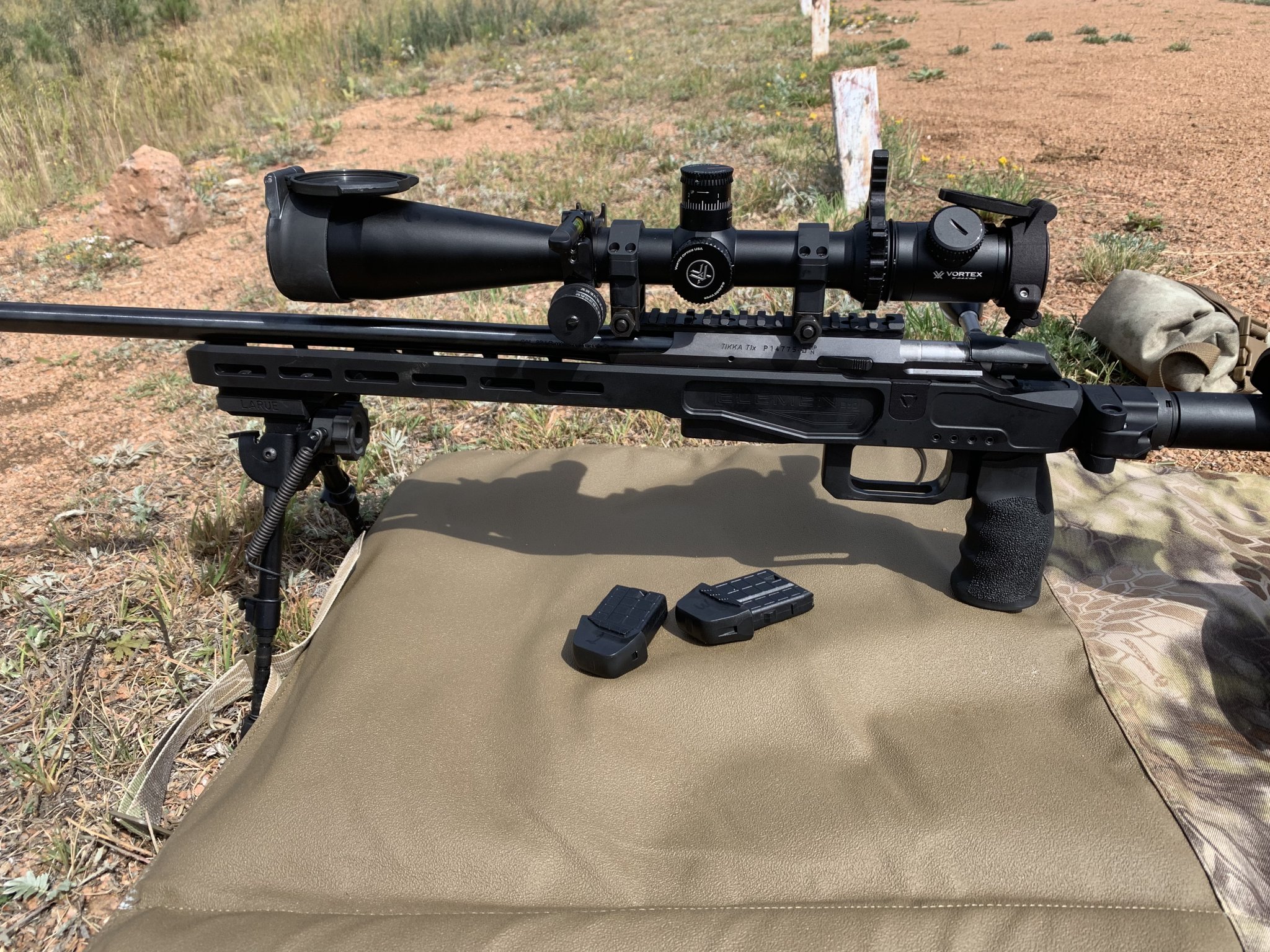

UPS guy finally showed up! .308/22LR Fraternal Trainer Twins!
Pardon the front skewed front scope caps, I didn't notice until I went to edit the pic. Scopes are both MIL/MIL Vortex Viper PST FFP, but the Tikka is wearing the larger glass.
Installed the Area 419 30MOA while I was at it and adjusted the additional 4.44 (went 4.5 Mils) from the original 15 MOA rail. I'll re-zero tomorrow as I'll be shooting & chrono'ing new to me SK Long Range ammo.
Still missing the support side flush cup on the Tikka/XLR, but that'll be here soon enough - one is already on the other side. Missing a pic rail for the tripod, but I may end up going with an Arca Swiss rail on both eventually anyway - for now I'll stay with my Pig Saddle.
Bought a ODG drag bag like my black one so I'm sure which rifle I'm grabbing. For now, they are pretty darn close!
John

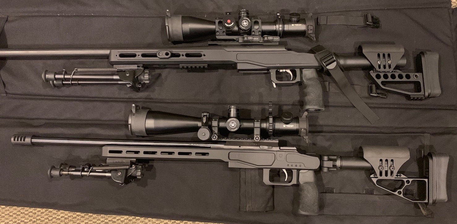

I got a 2 rifle drag bag, and carry my twinsies everytime I hit the range to practice fundamentals on both :) I also upgraded my scopes to be identical and gave my smaller scope to my fiance's rifle. I have yet to go do a PRS match yet, but it looks like the biggest thing around twinsies is to make sure they're balanced the same... so I'd need a much beefier barrel on my T1X.
@littlepod,
Yep, I'm with ya on a heavier barrel. They're not really "identical" yet and may never actually be, so more "fraternal" than "identical" twins. But they are close enough for me right now.
I'll know more about what (if anything) I'll want to change after I shoot them tomorrow. The new XLR Element (Rev 2.0?) has the option for adding weights to get them closer in weight - that is if I don't change out the barrel as originally planned.
I do have a FFP & SFP (otherwise) identical Vortex Viper PST scopes - bought the SFP version for a song a while back - but I almost wish I'd have waited for a FFP version to come available. I may still pick up another FFP and put the SFP on my hunting gun, guess I could sell it too.
I'll likely swap out the bigger glass in time (and put it back on my 6.5) when I build a Vudoo trainer for my 6.5. But that will be sometime next year (or longer). I'll keep looking for a G1 Vortex that matches what I have as they do come available as others upgrade to better glass.
For now, but I need to let my pocketbook recover. Remember, it's a marathon, not a sprint. :)

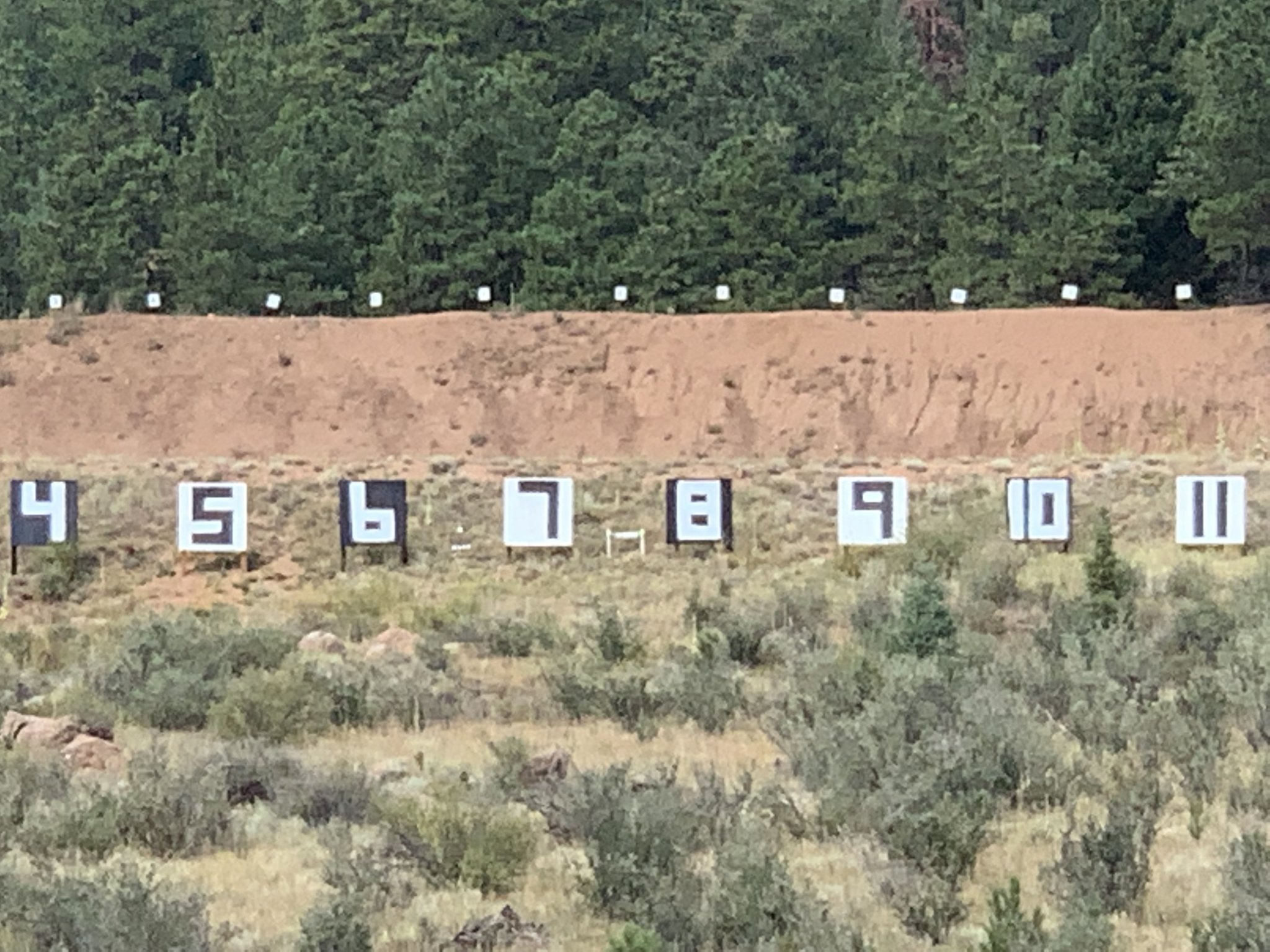

Range day is over! Tikka/XLR did GREAT. Re-zero’d & chrono’d ammo on the 100 yard range, then moved to 200 yards.
Closer up goodness.
Sexy side glamour shots.
This is as far as my camera would zoom. 2” 5 pot steel on the left of the “7” lane marker and my DIY KYL rack on the right.
What it looked like with the naked eye.
Here’s what I can tell about the Tikka/XLR - it’s far more accurate than I am, wind at distance is a bear, and I need to practice.
I cleaned the KYL rack at 50 yards so many times today that I actually got a bit bored with it and moved it to 100 yards. If I watched the wind carefully, I’d clean it there too 9 out of 10 times. Had a few people just watching me shoot a 1/4” spinner at 100 yards - at times, I felt cooler than I likely am. The Tikka/XLR made it that easy today.
HOWEVER, shooting 2” steel at 200 yards is HARD! More like HUMBLING.
In light gusting winds, I was hitting them ~50% of the time and not missing by much - mostly wind read errors on my part too.
Boy, what a fun day at the range,
John
Closer up goodness.
View attachment 7143766View attachment 7143767
