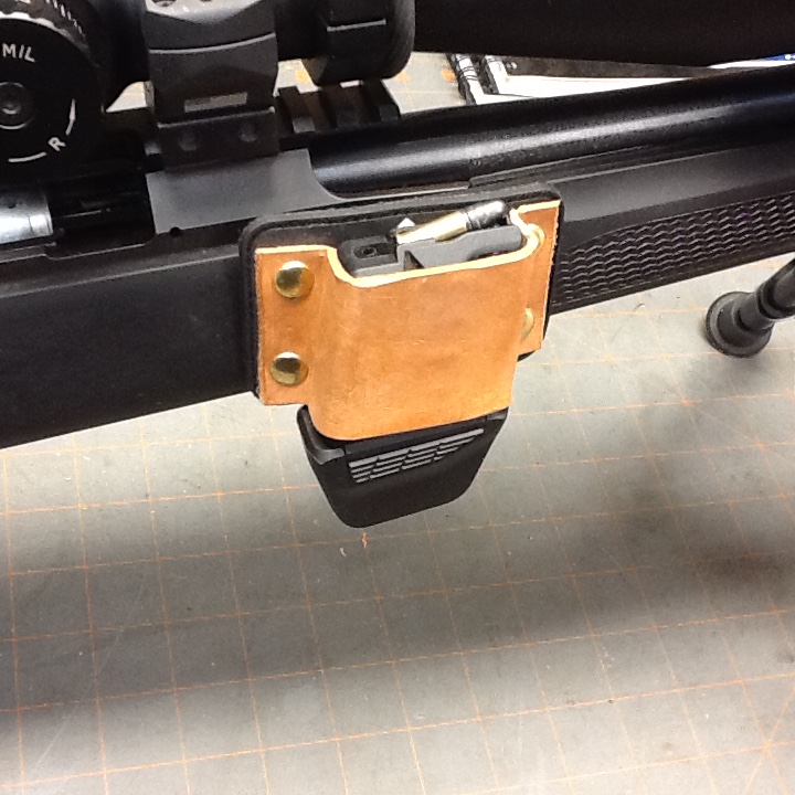

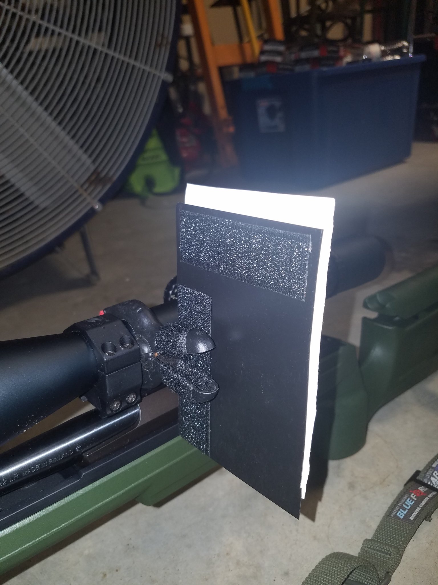

This a DIY mag holder for my T1X. Just some scrap leather, Velcro, and some rivets. I mounted it in this position because it's close to the mag well and in correct orientation. I haven't tried it yet to see if there is enough friction to hold the mag in that position.
If I need, I can mount in the upright position.

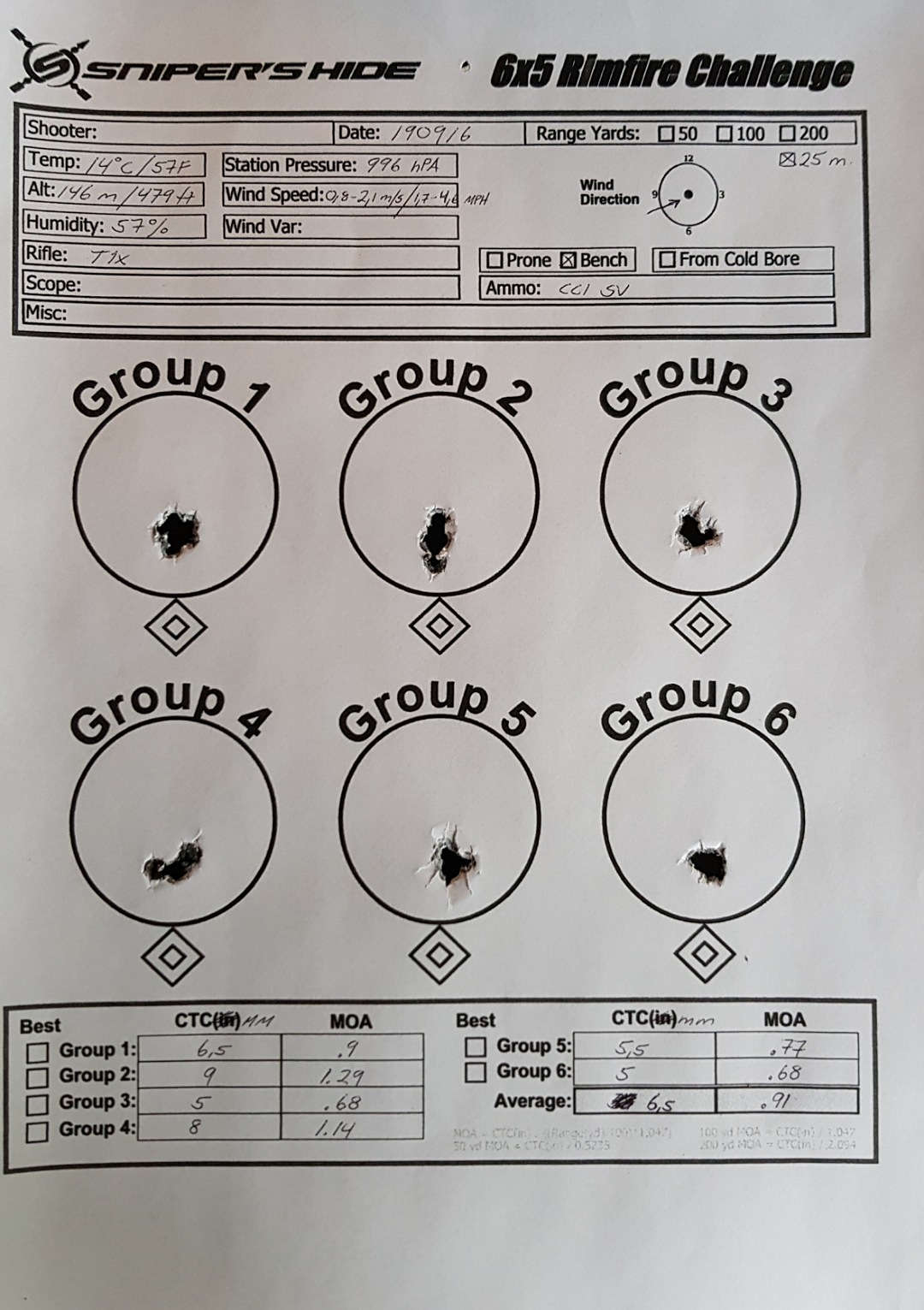

Shot a fairly quick weak side 6x5. Only at 25 meters though, but still sub moa average using CCI SV. Was a little worried I screwed the barrel up, since I hade to re-thread it 1/2-28 for the DIP brake. But looks like she's still a shooter.

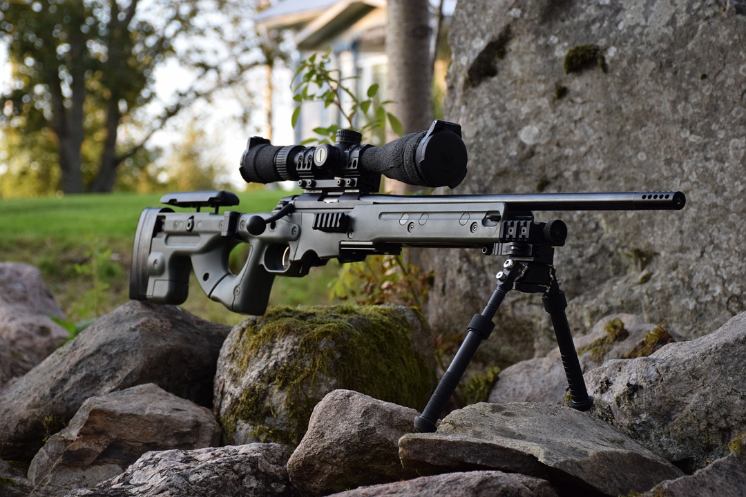

@IntenseImage - I had completely forgotten about the oryx chassis until your picture popped up. It looks great. Are you satisfied with the stock? Any fitment issues?
