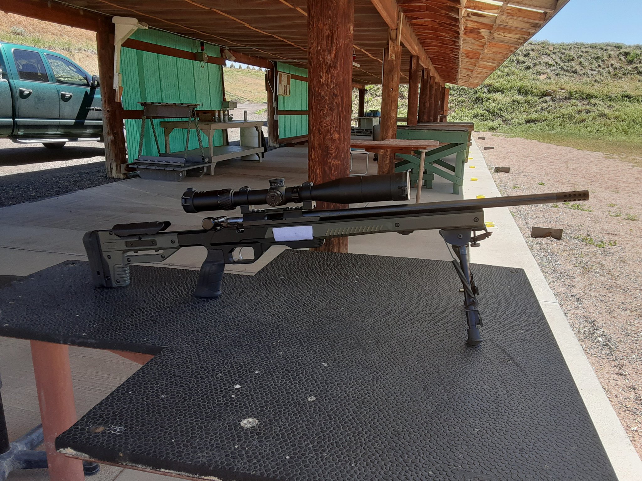

Got her put together. I still need to adjust for eye relief and level the scope.
Talked with Craig at PDC Customs and he is working on a chassis for my Tikka T1x looks like great stuff to me at a reasonable price. I will post pictures when I get it. I have no interest in the company just want to give him a plug, $435 and $485 inlets for 10/22, CZ 452, CZ 455, CZ 457, and Savage M2/93

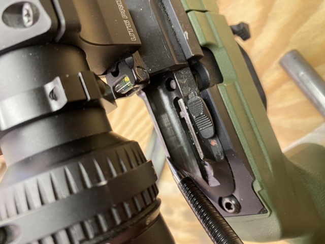

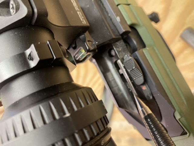

It almost seems like you have drag in the tow locations indicated in the photos. I know if I put any downward pressure on my bolt and I mean even a little it drags there and my bolt would do exactly what yours is doing. Maybe something there is a little out of spec. Does the friction ease up if you lift the bolt knob just a slight amount when you are cycling?
View attachment 7334293View attachment 7334294
Bolt won’t go forward with any upward pressure. Downward pressure it’ll close. It’s actually smoothest with some downward pressure.
My 2 cents - try taking the magazine housing off, this has the ejector spring attached to it.
Last idea - the dowel pin through the shroud - make sure its flush on both sides otherwise you'll feel that getting hit every time it sticks out.

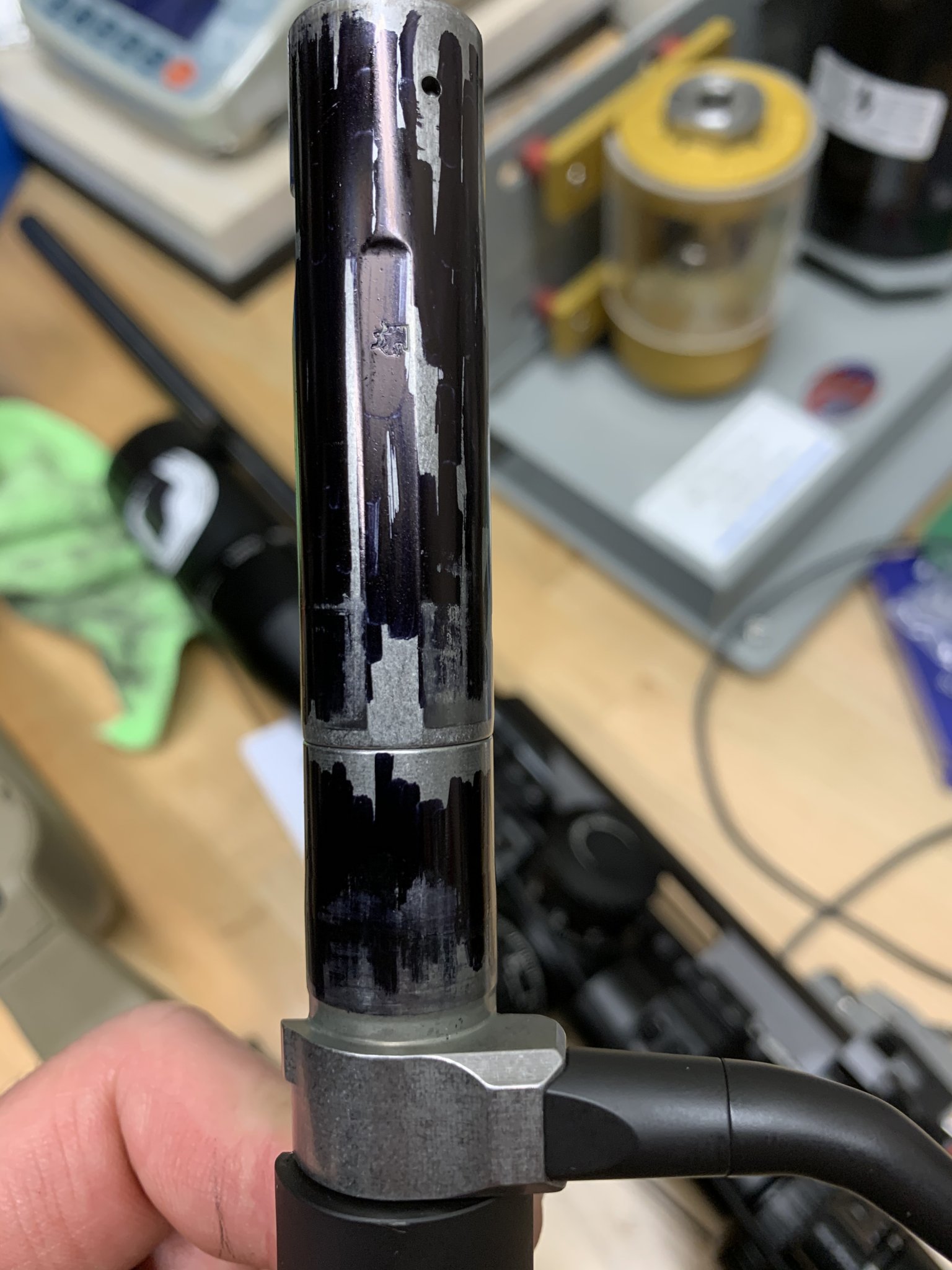

Was much smoother with the mag well out. Very smooth with the bolt release depressed but still a little tough with it left alone. With the mag well back in it’s pretty much like the prior videos. Maybe it’s both the spring and the bolt release. Also made sure the pins were flush.
Definitely see some wear on the bolt where those marks are rubbed off. Not sure if I should try polishing the bolt or just send it to Beretta. Worried that might void warranty?

I removed the Sterk bolt shroud cause I saw one side I could stick a fingernail in and the other I couldn’t and it’s now a ton smoother. Swapped the handle back to factory and while it’s not T3x smooth, so much better. I’m hoping a thousand rounds or so through it help smooth it out more.
Thanks all for the help!

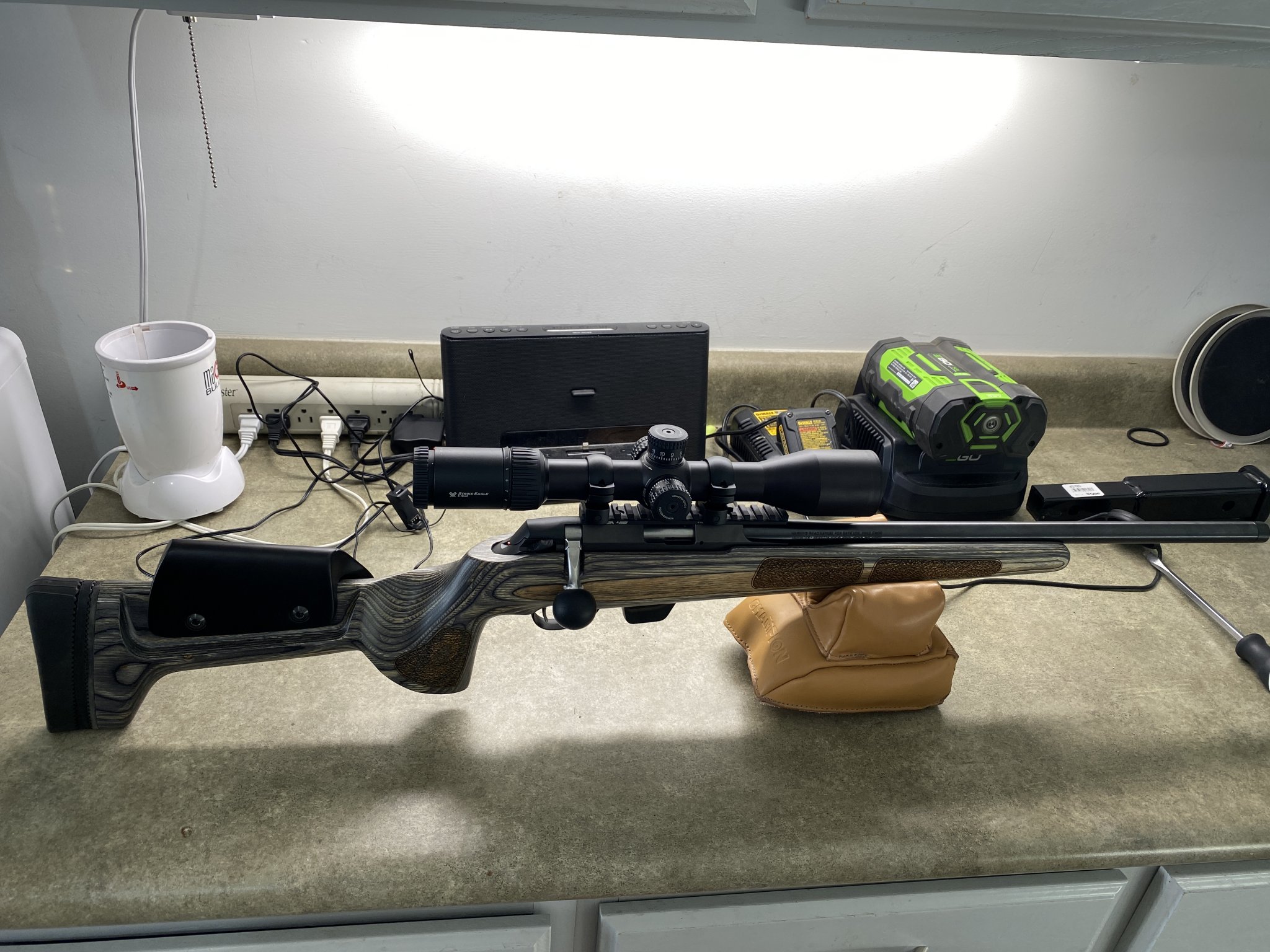

I had a spare rubber bolt knob thingy from amazon and dropped it on till now.
Messy garage counter gets used for everything.
Still have to decide on it I am pulling and getting the barrel cut down or will snag a new barrel from Lothar Walther. IBI probably shoots them best but I want her to have a 16” barrel and IBI doesn’t do that.
first thing is to shoot this barrel. nakoa1 shot it and it seemed to shoot really well so maybe I will just leave it be

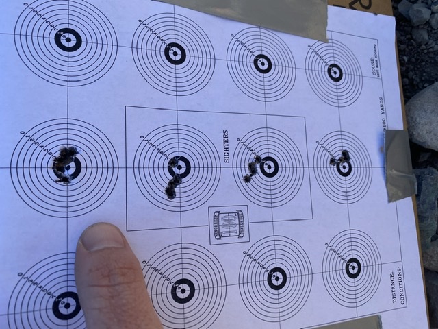

Had a short period to shoot today, so I took the kids out with me and only got to shoot about 30 rounds through the tikka (about 10 shot of bulk ammo to get it dialed in and then 4- 5 shot groups with Eley action)
all but one group could be covered with a dime (51 yards). Not bad for a portable table and a light breeze. The gun is definitely more accurate than I am. Super excited to see if the wife will compete in the nrl22 with it this year.
