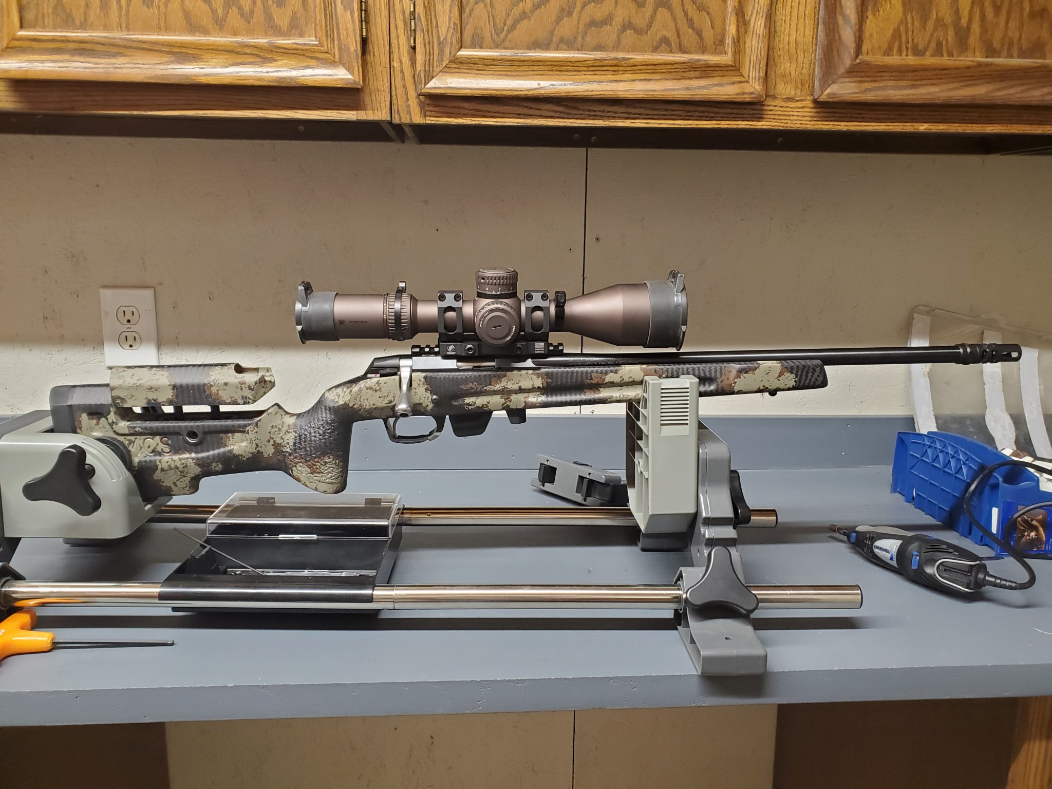

Here is mine that I had mounted. If you get one feel free to pm me if you have questions. It is super easy and very obvious what needs to be dremeled and once the action is mounted, you can't see it.
Damn good looking stick! I’m sure it runs just as good. I appreciate the offer.Hope to have the stock in my hands in a week or two.

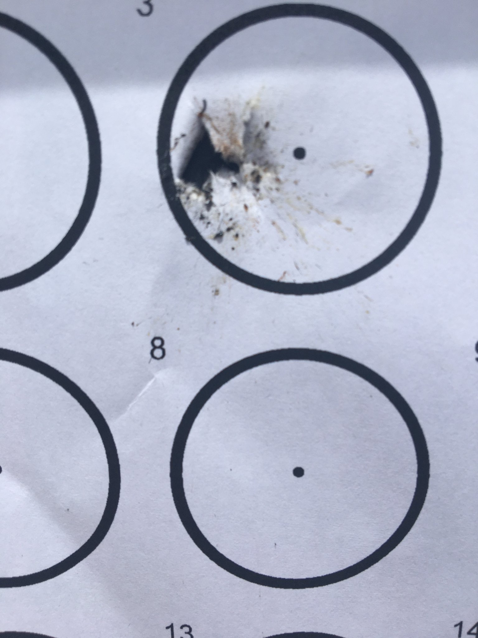

took my bravo t1x out last weekend........one 1/2" hole at 50yds.....right at 1 MOA at 100yds....but at 150yds the thing fell apart and i couldn't get anything going.
I was shooting sk rifle match and lapua center x
That is the same thing I have seen with all my factory barrels. Both my CZ 457 and my T1x when it still had the factory barrel shot really well inside 100 yards. After 100 yards the groups really fell apart though no matter what ammo I was using. Beyond 100 yards is where you really see a difference with the custom barrels. When I rebarreled my Tikka the groups inside 100 did tighten up but beyond 100 yards was the real difference. My Vudoo is the same way. Inside 100 It is impressive but beyond 100 is where the custom barrels really shine.
Oh the factory barrel was a PITA to remove but quite a few guys have had good luck with PB blaster and heat. On the other hand I’ve heard other people who didn’t have any issues removing their barrels. Both of the ones I had were not so easy to remove however. I will say I didn’t just buy a drop in barrel. I took my rifle to a smith and he fit, chambered and head spaced the barrel for me. I just think if you want to get every last bit of possible accuracy out of the rifle custom fit is the only way to go.

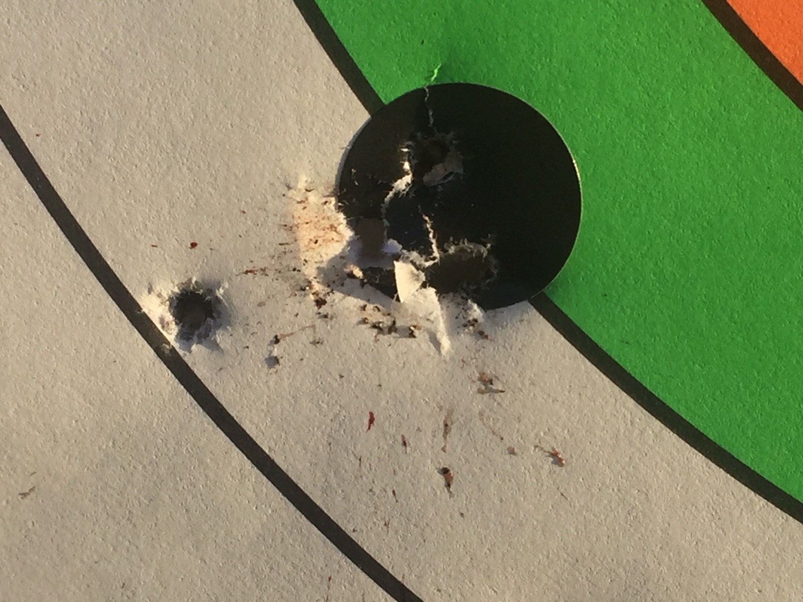

Generally speaking I cut my groups inside 100 in half. My 50 yd 6x5 with the factory barrel was around .4”. After the custom barrel I can pretty consistently shoot right around a .2”. At 100 I average .6-.7”. When I stretch out to 200 yards I have not shot groups but I have a 2 1/2” piece of steel that I rarely miss unless I have a round that shoots really fast or slow. You can’t blame the rifle when you get 30-40fps difference in muzzle velocity though. I have been really lucky and found some really consistent lots of the cheaper Eley ammo and got cases. I did the same with my Vudoo with SK ammo. I found something that shot well and bought as much as I could get my hands on. With the way rimfire ammo seems to be drying up I’m glad I bought it when I did.

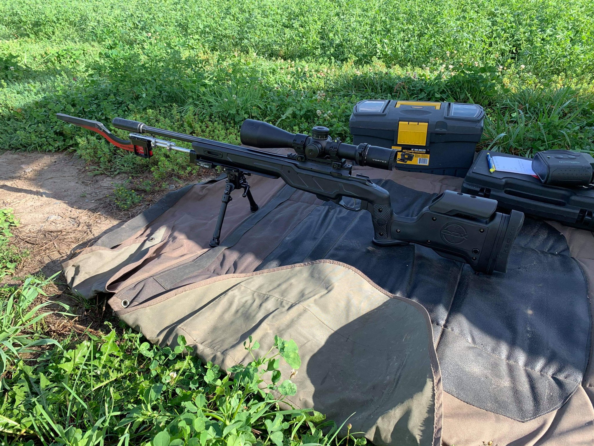

Here my new Tikka t1x in Cadex Nuke Strike EVO stock.
Now i try different Ammo this week look like the Eley match goes very well in this rifle.
But i don't know if the Federal gold medal match HV was a good round to try. Some of you try it.

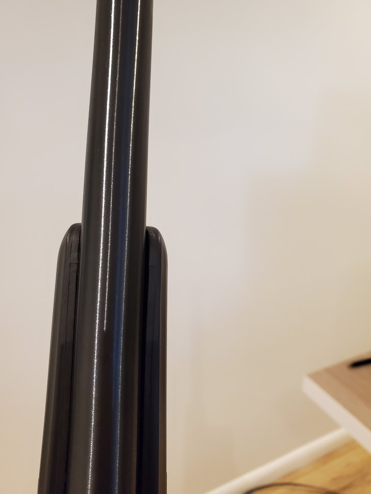

Hey Guys, I am still a noob when it comes to many things surrounding rifles. My t1x (factory stock) has the barrel touching the stock on the left side, and by extension has a sizeable gap on the right side. Is this an issue with action screw torque or is there something else I am missing?
It’s a cheap plastic stock. Chances are it is warped. My factory stock would flex and hit the barrel every time I loaded the bipod. That is why everyone trashes the stock and buys something else. My factory stock stayed on my rifle for about 5 hours. It went to the range once then in the junk pile.

If You force the stock straight and fill the front of it with epoxy I would guess that will fix it. If It was me I would get some lead shot and fill the front with lead and epoxy

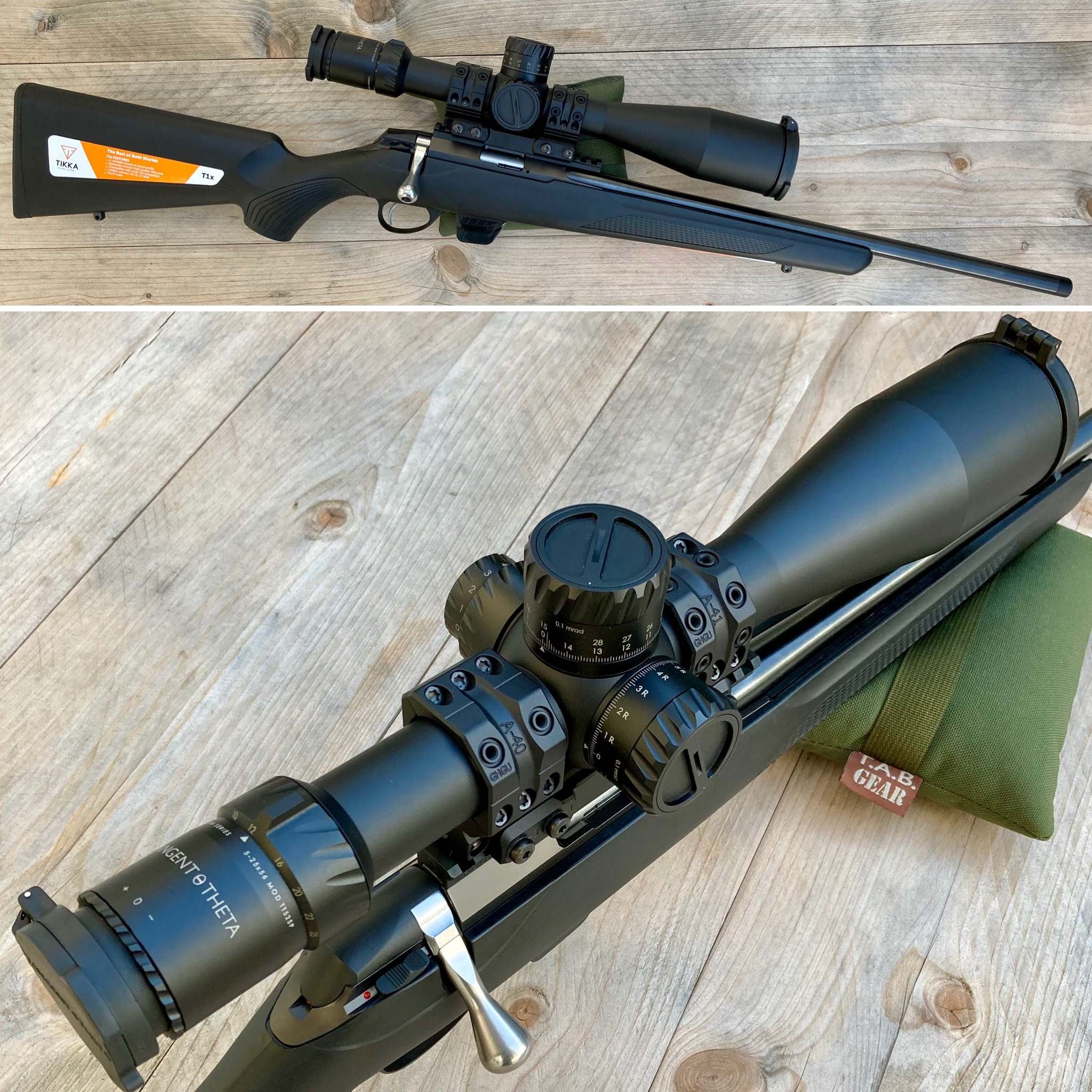

Picked up my Tikka T1x with 20" barrel last week and while waiting for the KRG Bravo chassis and Sterk upgrades I'm going to test it in it's factory configuration :)
Seriously considering getting an IBI 20" barrel but going by what I read in the thread from @Kisssofdeath that is something I'll need to be well prepared for. Maybe even consider outsourcing the fitting to an actual gunsmith ;)
Tikka T1x Barrel Removal thread
The Tactical Ordnance Inc 30 MOA rail from Canada is seriously good stuff though, plenty of clearance near the ejection port.
The Tangent Theta is a bit big for this setup, the looks will improve with the KRG Bravo and IBI Bull barrel under it. Eye relief and ergonomics too I presume.

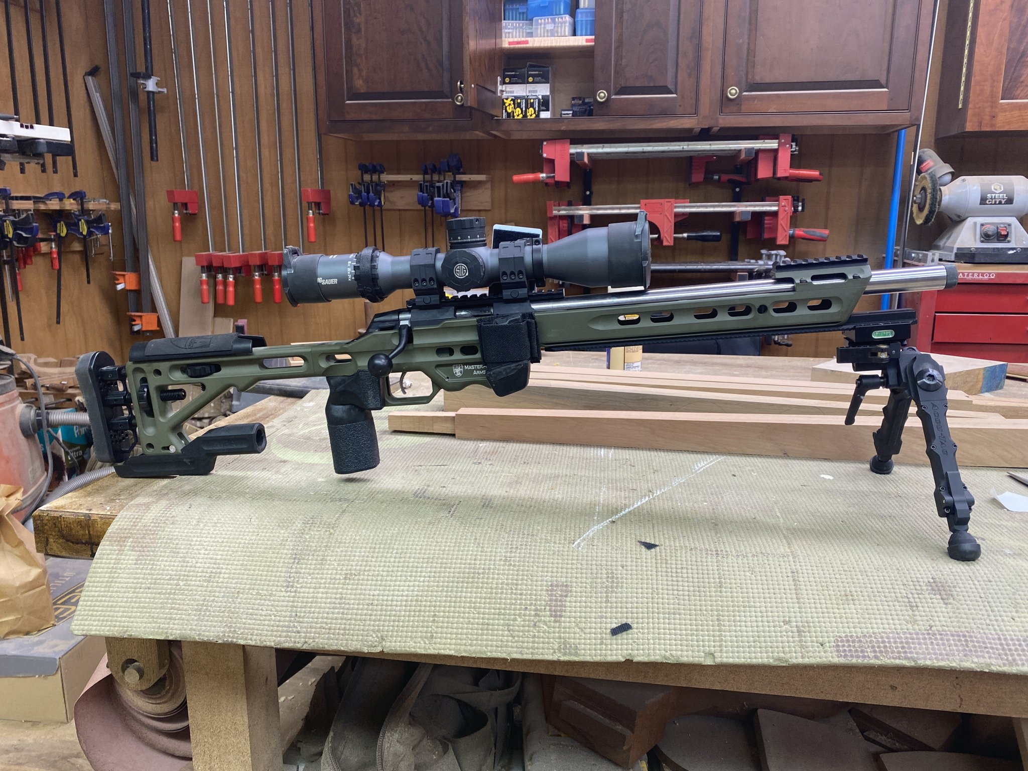

Here is my rifle. The barrel is 16 1/2” a Feddersen blank I had a local gunsmith fit and chamber for me. He used a Manson Eley EPS reamer and head spaced it at 0.041”. The stock in the photo is a MPA chassis for a Tikka T3x that modified to work with the T1x. I moved the barreled action back to a KRG Bravo and put my T3 match rifle in the MPA. For the T1x I think I actually prefer the Bravo. In the photo the rifle has a Sterk bolt handle and knob. I have since changed that to the Anarchy Outdoors bolt handle and knob. It's a little longer which I prefer.
