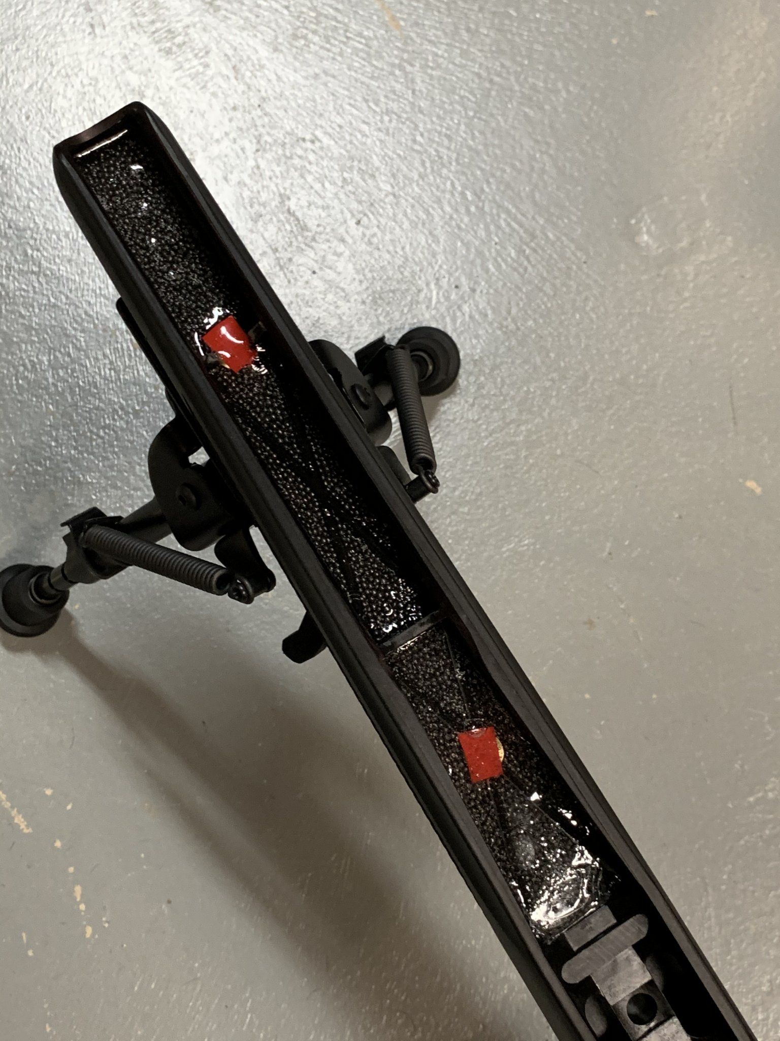

I filled my factory stock with some lead shot and epoxy, it stiffened up quit a bit.

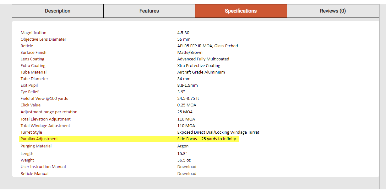

I was set on an ETR but your comment on parallax has me rethinking that. Looking at the sigs specs it states parallax down to 100 yards, does it have any issues going lower than that?
I think that is a typo on Sigs part. The parallax goes down to 25 yards on mine. That said I no longer have the Sig on my T1X. I’ve switched to 5-25 Viper PST gen 2’s on both my T1x and Vudoo. The Sig is a really nice scope especially for the money. It is just overkill for a rimfire to start so I put it in one of my long range rifles. It’s sets on a 223 DMR rifle I shoot gas gun matches with. My Sig has the milling reticle which is easy to use at low magnification when the targets are large and speed is the key. The Viper has a much wider FOV which makes scanning for targets at 10-12x much easier. I also find the reticle I have in both my Vortex scopes much better for holdovers since I rarely dial in a match if I’m engaging targets at multiple distances in a single stage.
The Parallax on the ETR goes down to 25 YDS. I am running a Midas Tac which is also a bit of a cheaper, but still very good option. Parallax down to 10 yards and no issues at all in that regard.

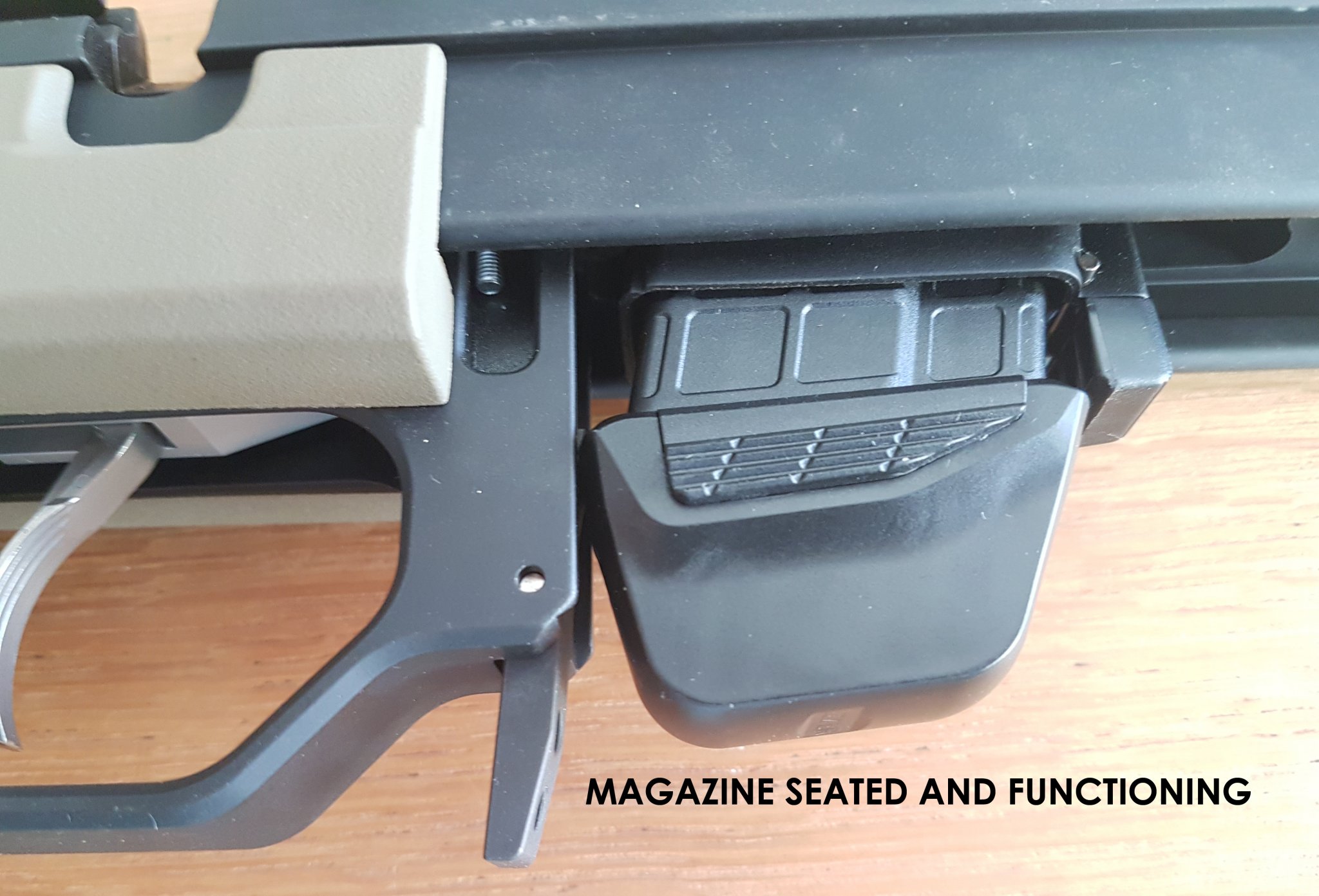

Please can some one post a photo of the Mag well of a T1X in a KRG chassis. with the magazine inserted and of it without a magazine in.
I have a TRG stock that is on a KRG backbone and am hoping I will be good to go to use it with a T1X.

Yes, the parallax does go down to 25 yards on the Ares ETR. The issue with mine was it was almost impossible to get all the parallax dialed out of the scope under 100 yards. Doing it at a match on the clock while shooting at something like a KYL rack where a little error can make a huge difference was basically impossible. I have used a few of the Ares ETR’s and know a few people who have them as well and everyone I know at least complains about the parallax. It may not be the case on all of them however. I also had a Midas TAC. The parallax on that optic was great. Who knows what the issue was. The glass on the ETR was fantastic. I just had issues with the parallax and found the eyebox a little to tight for my liking.

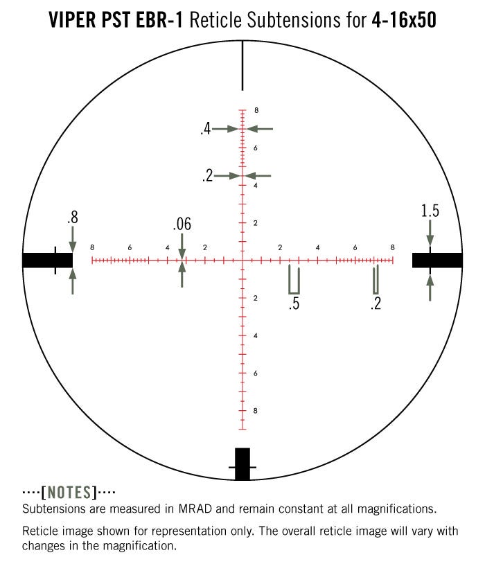

Vortex PST gen 1 4-16x50: satisfactory glass, satisfactory simple/clear reticle, excellent eye box, excellent parallax from 50 yards up with very smooth adjustments, shimmed zero stop

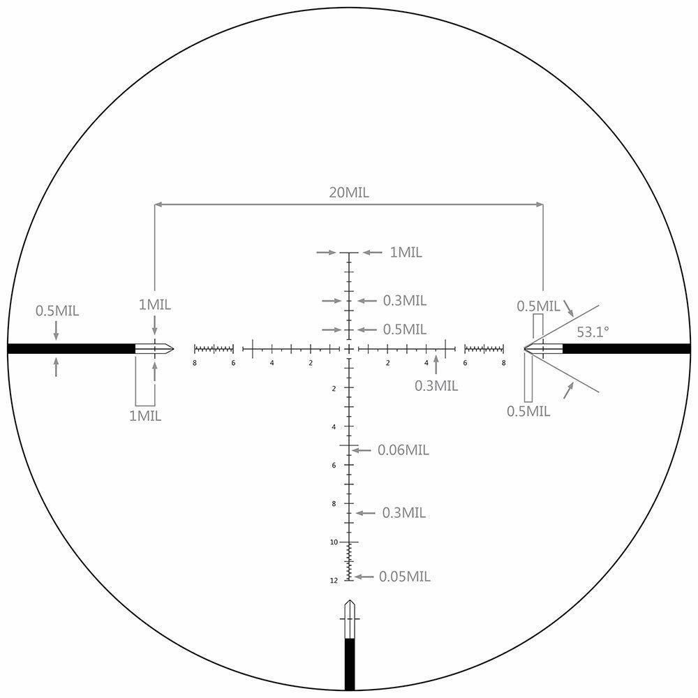

Arken SH4 4-14x50: excellent glass but barrel distortion, excellent simple/clear floating cross reticle, satisfactory eye box, excellent parallax from 10 yards up but adjustment knob is very stiff and far from smooth, solid easy to set zero stop

Arken SH4

Vortex Viper PST gen 1

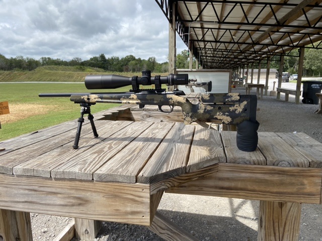

Finally got the Manners in over the weekend. It’s a PRS1 with Gen 2 mini chassis. The T1x dropped right in with only a tad bit of shaving for the bolt release.
Took it out yesterday and it seemed to like pretty much all ammo. However with SK RM I got at least 2 failure to feeds each time I ran a magazine through it. Maybe it’s just me being lazy with the bolt but never occurred with CCI, Federal or Norma.

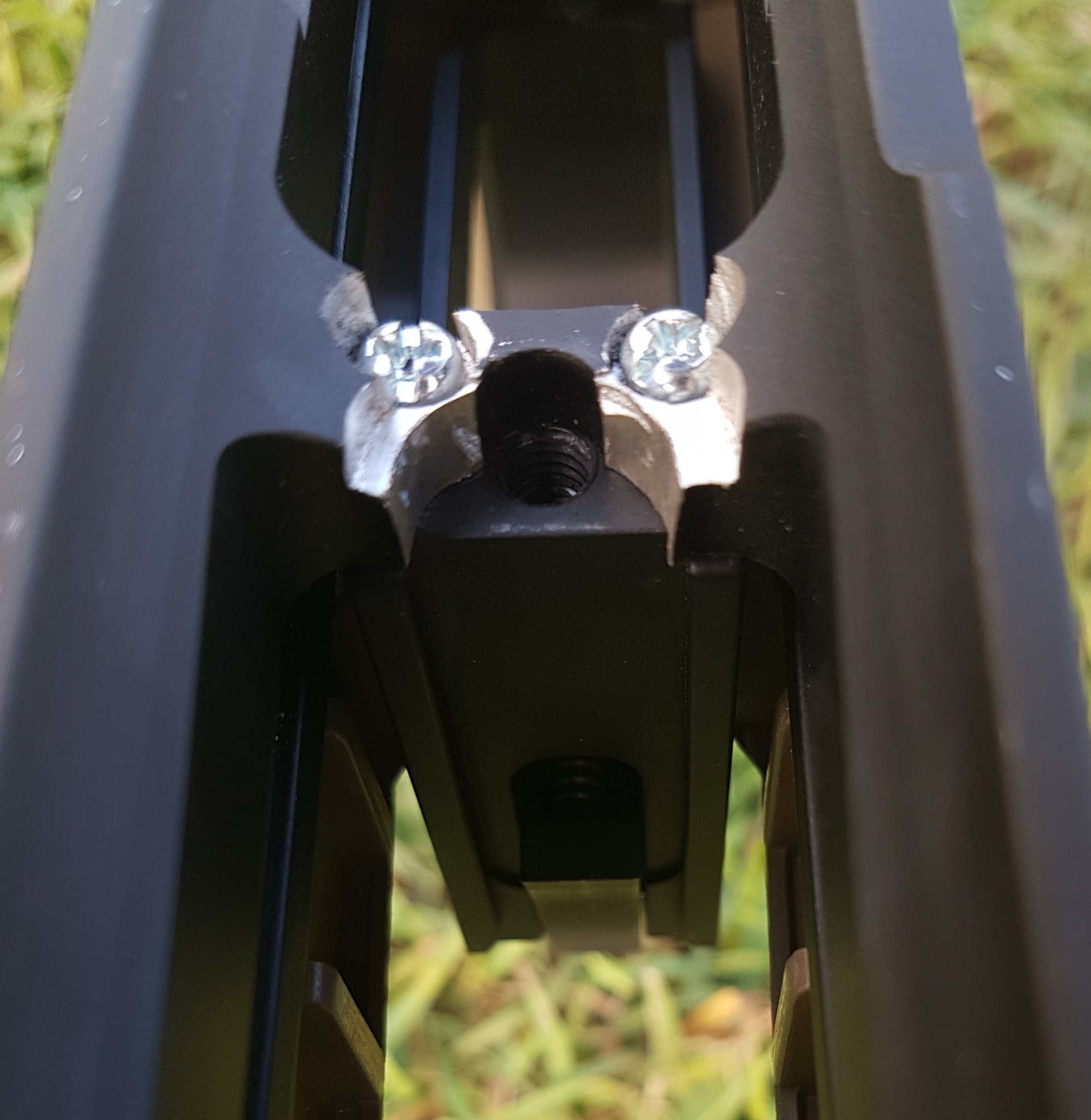

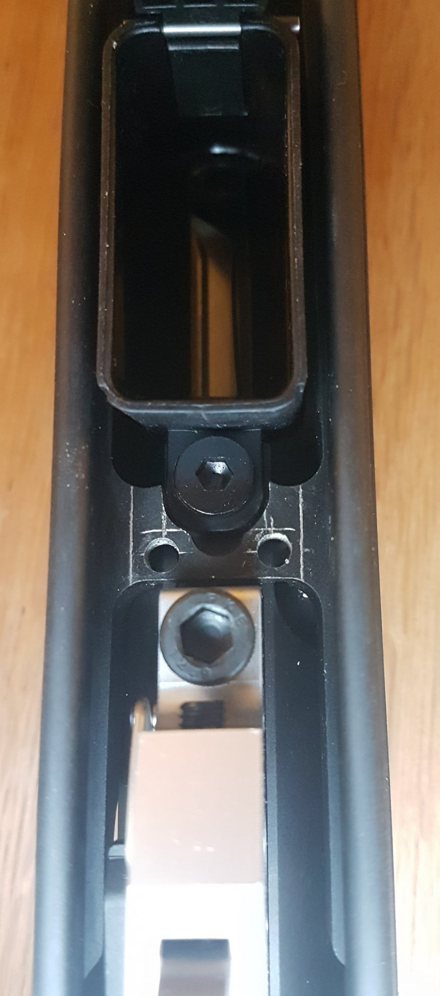

please can you enlighten me as to the minor modification required?
As per my earlier post I have a genuine Sako TRG butt stock and forend with a KRG back bone I’m hoping to use.
it works with a T3 so I’m hoping it works with a T1x
I had to shave about 5mm of material so that the bolt release would move freely. A 30 sec job with a dremel. This was a manners stock. Cannot speak for others.
Reactions: Scotch_egg
With some of the T3 stocks you will need to clear a little area for the bolt that holds the mag well on the T1x. The other common modification is clearing a little area for the bolt release. Both of those modifications are usually pretty simple.
I've posted what's required twice but here it is again - as mentioned you need space for the magazine well screw head. The krg trigger guard needs to be held on by some other way due to the krg screw hitting the tikka mag well screw. I used 2x small m3 screws counterbored so they sat below the tikka mag well screw. I didnt touch the bolt release area and the normal AI mag latch is still in place.

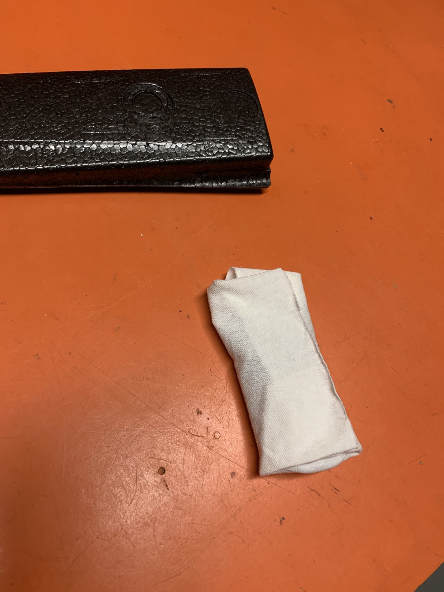

you’ll see in this pic the foam insert that is in the stock from Tikka You’ll need to remove the butt pad. Once you remove the butt pad you will find a plastic grid like waffle spacer. The you just pull straight out with a pair of needle nose pliers. Now you will see the foam piece. Pull this out and now you have a hollow stock. If you have installed a cheek riser make sure to remove the screws as there is a good chance the screws are into the foam.

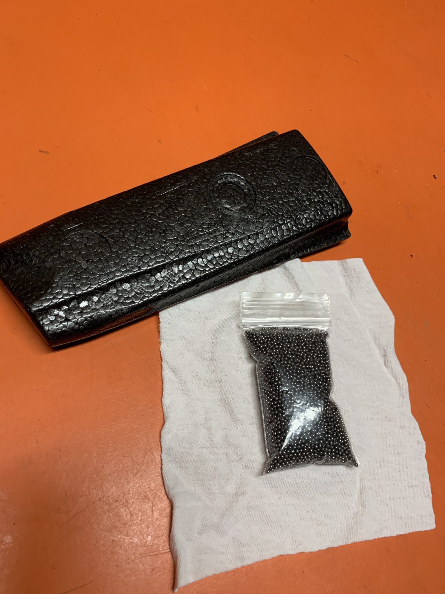

I filled these small zip lock baggies with #9 shot. Each little baggie holds 1 pound. I cut a small piece of rag to wrap the baggie and pushed it all the way into the stock. I followed this for a total of 3 in mine and a total of 4 for my wife’s gun. I find that 3 lbs is a perfect neutral balance where 4 had the rear slightly heavier. My wife likes it a touch heavier in the rear. I filled any open space in the rear with rag pieces and then installed the waffle spacer and then the butt pad. All set.
I did end up changing the screws to torx ( look much better ) for the Titan cheek rest so they are just long enough to properly fasten to the stock but not so long as to cut into the baggies. Total gun weight is just at 14lbs for me and 15 lbs for my wife’s gun

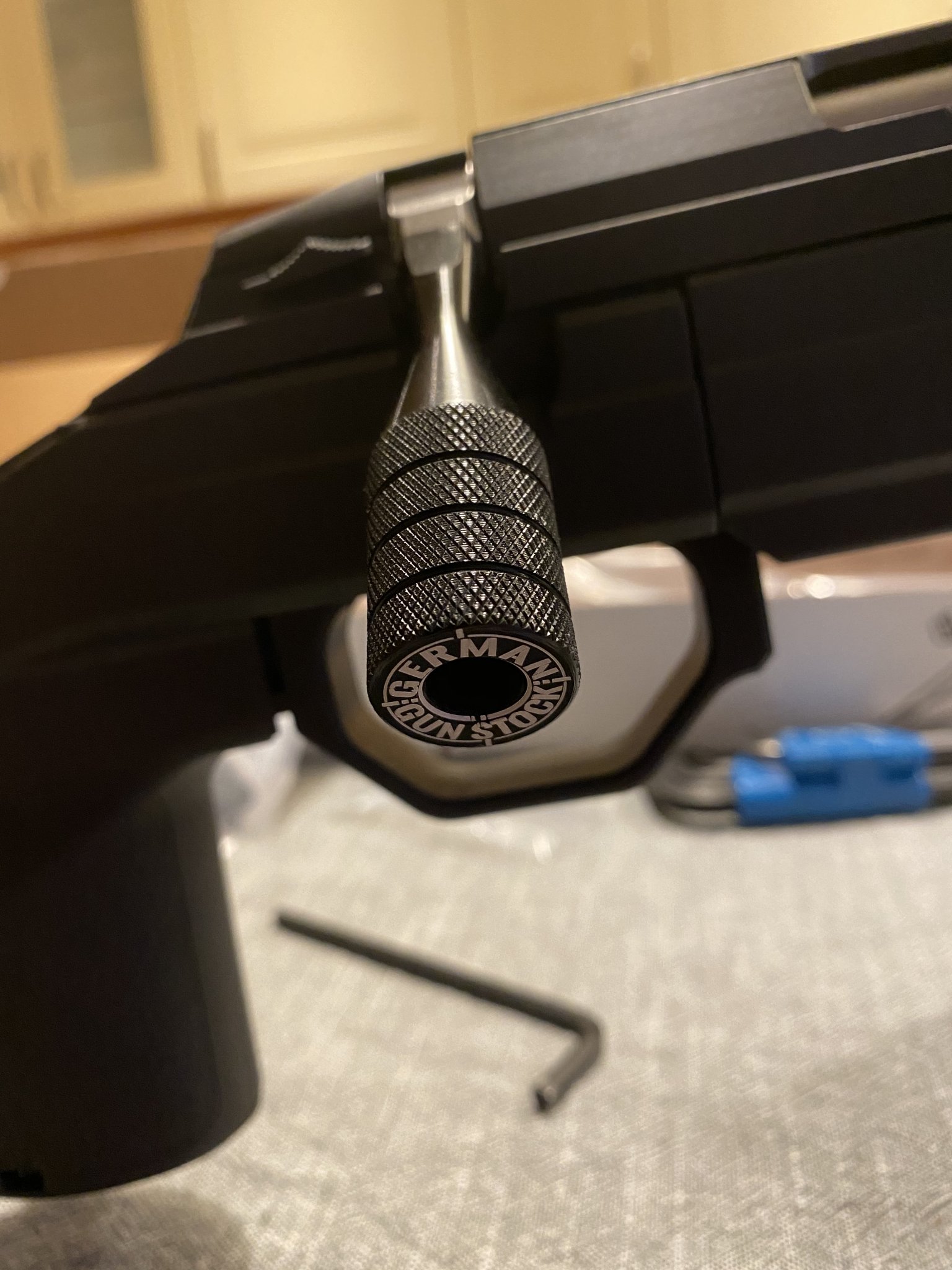

The bolt handle is from "German Gun Stock". They have a killer bolt for the T3x...

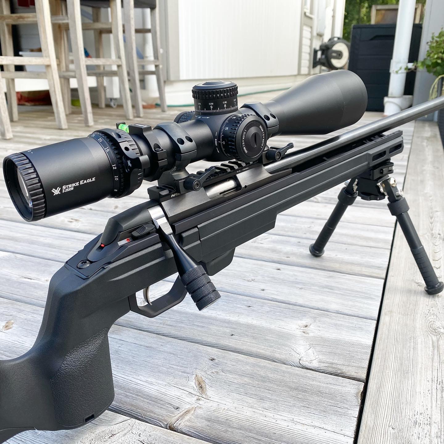

M829. I have only had one short session at the range but so far I really like it. With 25x power it is easy to get out there. The only percieved downside to ffp in general is the reticle being very thin/hard to see on low power in a hunting situation. An illuminated center dot instead of entire tree would be nice!
