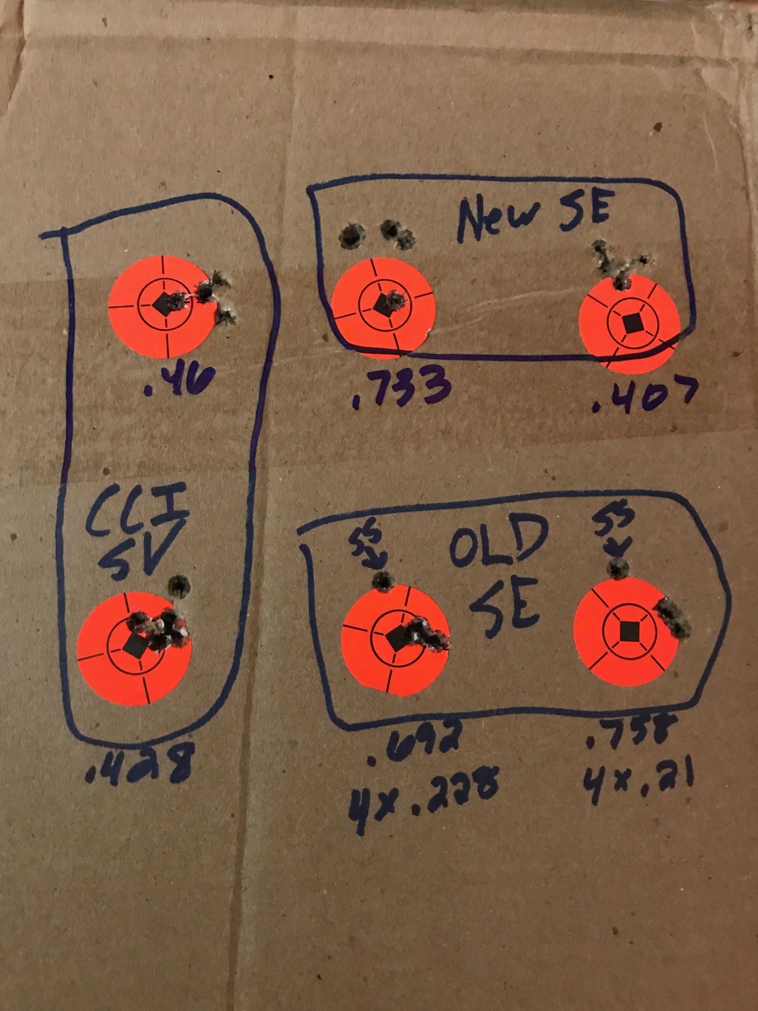

Did some testing and found out my rifle really likes SK Standard Plus. Best groups were with Standard plus and best average if I didn´t count a flyer I caused myself.

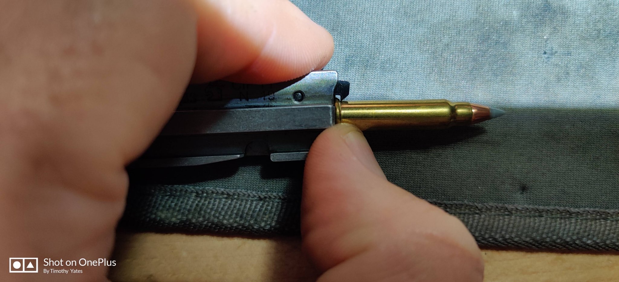

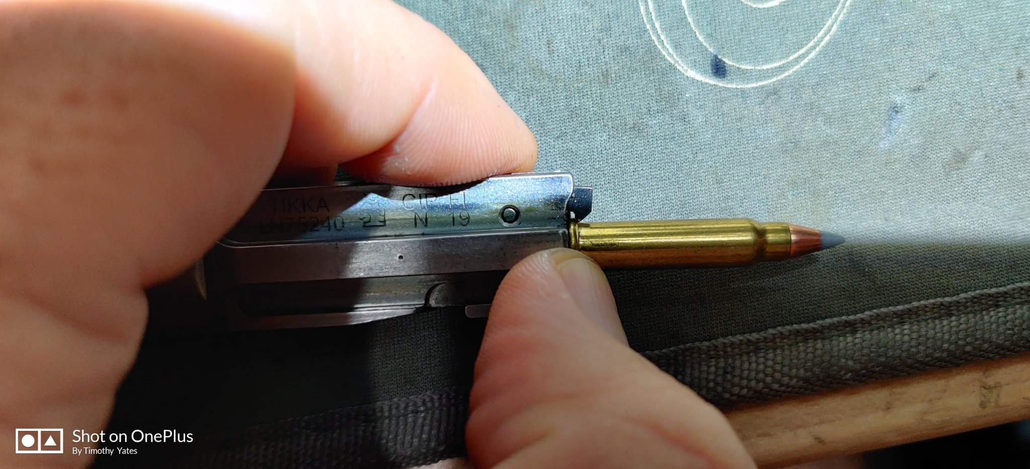

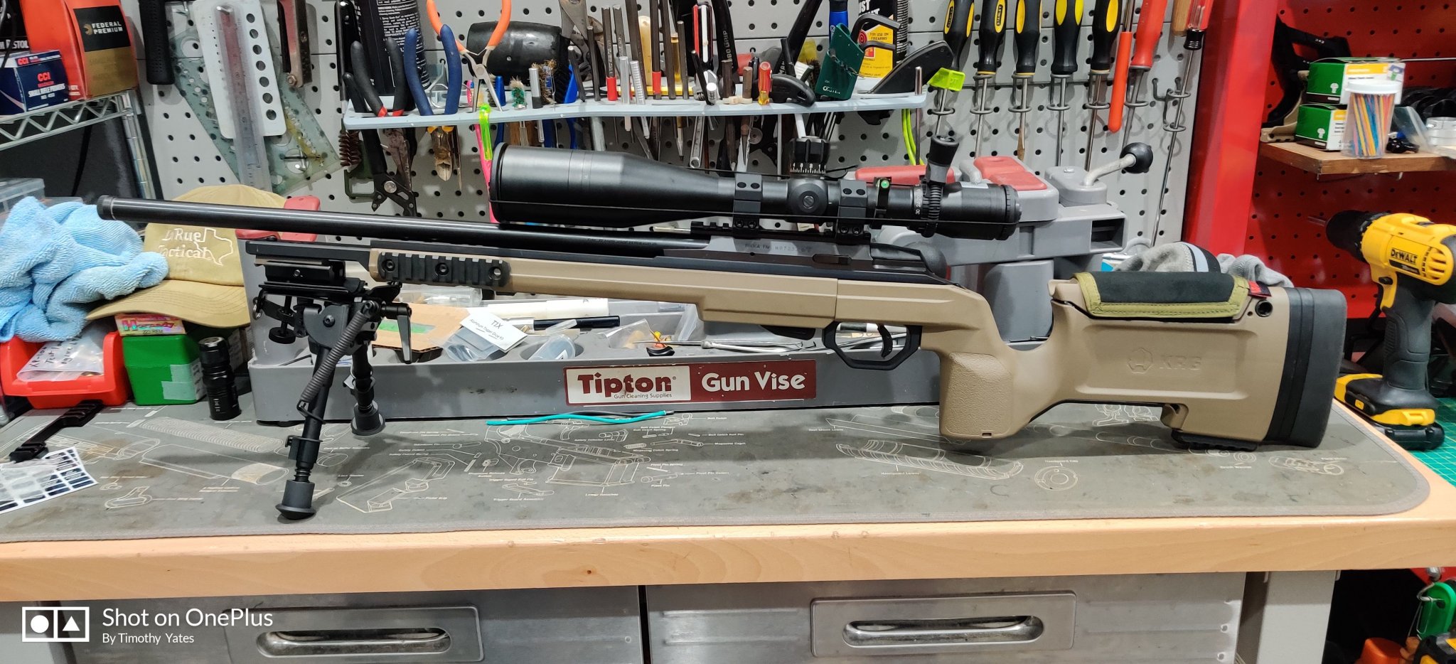

I'm a little late posting this, I actually forgot about it. Today I shot the Tikka T1x 17 HMR with the Tikka T1x 22 LR bolt. Feeding was nowhere near as smooth when compared to the 17 HMR bolt. Extraction and ejection was perfect with the LR bolt in the HMR, feeding was the only issue. I also reconfirmed that shooting the LR with the HMR bolt was identical to using the LR bolt. The reason for the rough feeding is the extractor on the LR bolt is not letting the HMR case rim come up between the bolt face and extractor. This can be confirmed by just doing a visual on the extractors as the difference is evident.
Here's my 22 LR with IBI barrel.
Here's my 17 HMR with factory barrel.
Both

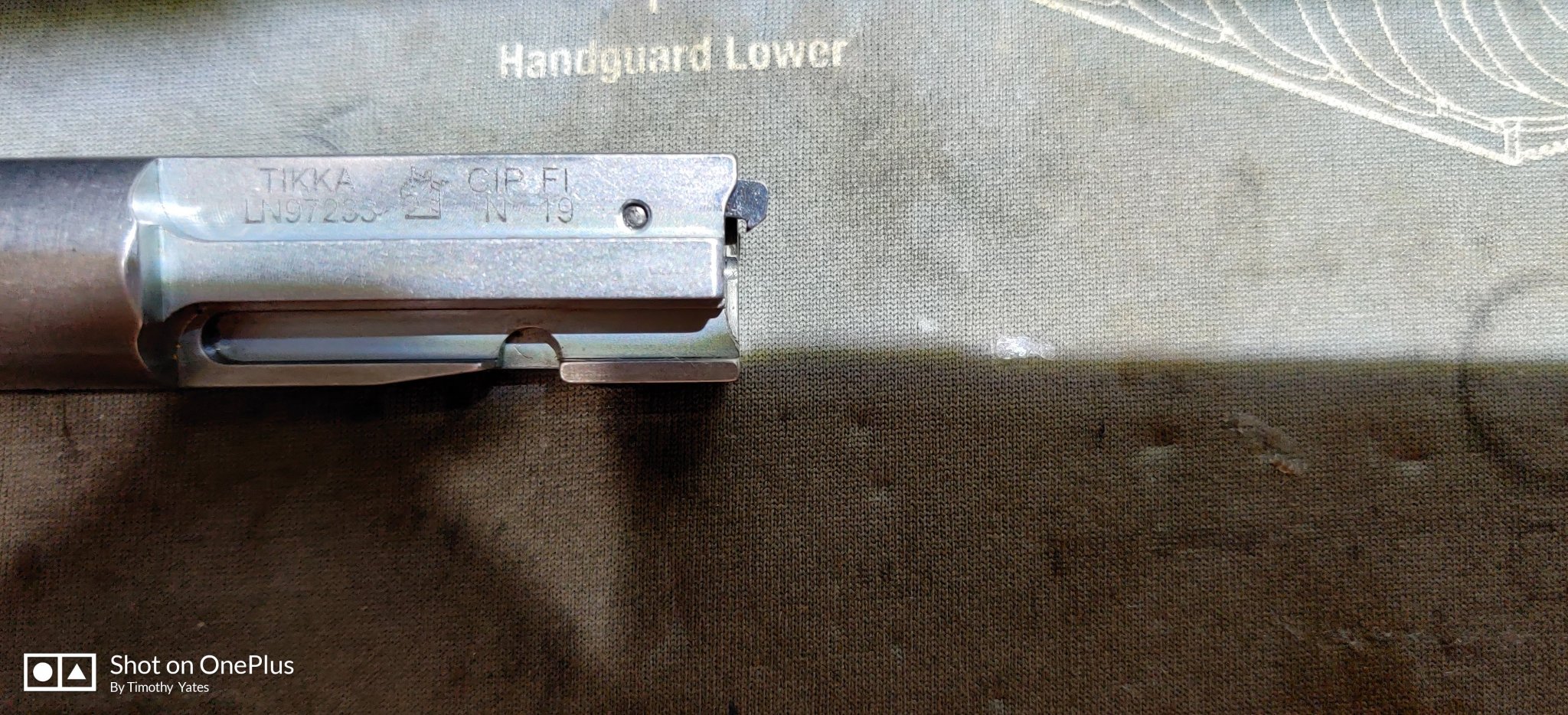

Here's some comparison photos between the two bolts and ejectors. For the most part the bolts are the same. I took measurements and taking into account my measurement errors the bolts are pretty much the same. The extractors are different as adamjma discovered on MGW website.
This is the 17 HMR extractor. Notice the hook is shorter but the gap is wider when compared to the 22 LR extractor.
22 LR extractor.
17 HMR
22 LR
22 LR on top, 17 HMR on bottom
According to this experiment it is my belief that if a person buys a factory Tikka T1x in 17 HMR he can swap out the barrel to a 22 LR and not change the extractor. I would also "bet" that the 17 HMR bolt/extractor would also work with the 17 HM2 and the 22 Magnum.
It is my belief that if a person buys a factory Tikka T1x in 22 LR you could buy a 17 HM2 barrel and not have to change the extractor. However, if a person decided to use a 17 HMR or 22 Mag barrel with an original 22 LR bolt they "should" change the extractor just to save aggravation. Plus, over time I do believe the 22 LR extractor would eventually break.
In the end, take what I say with a grain of salt. Only thing I have really done is confirm that my 22 LR and 17 HMR bolts will interchange.

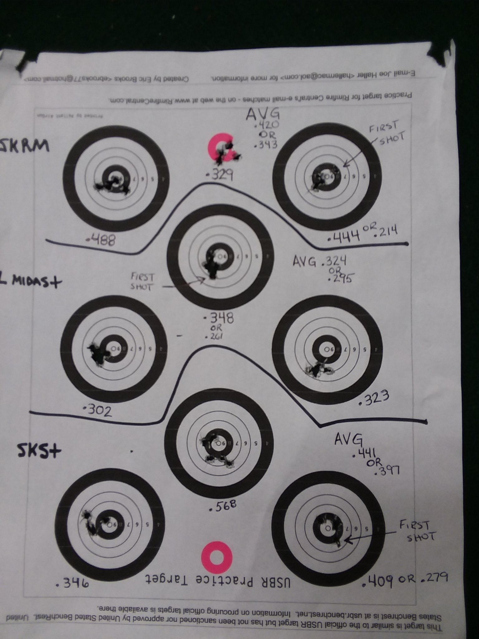

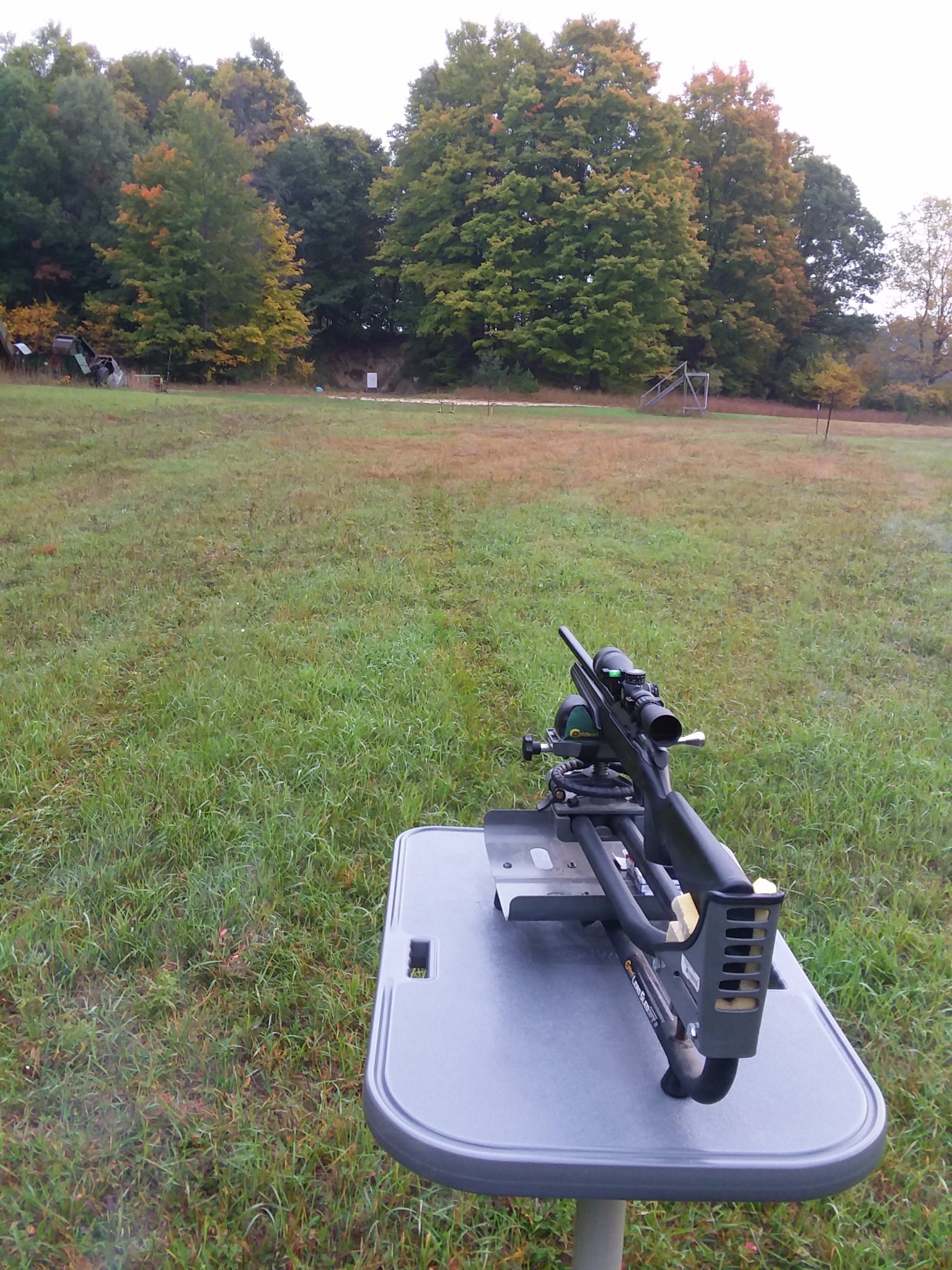

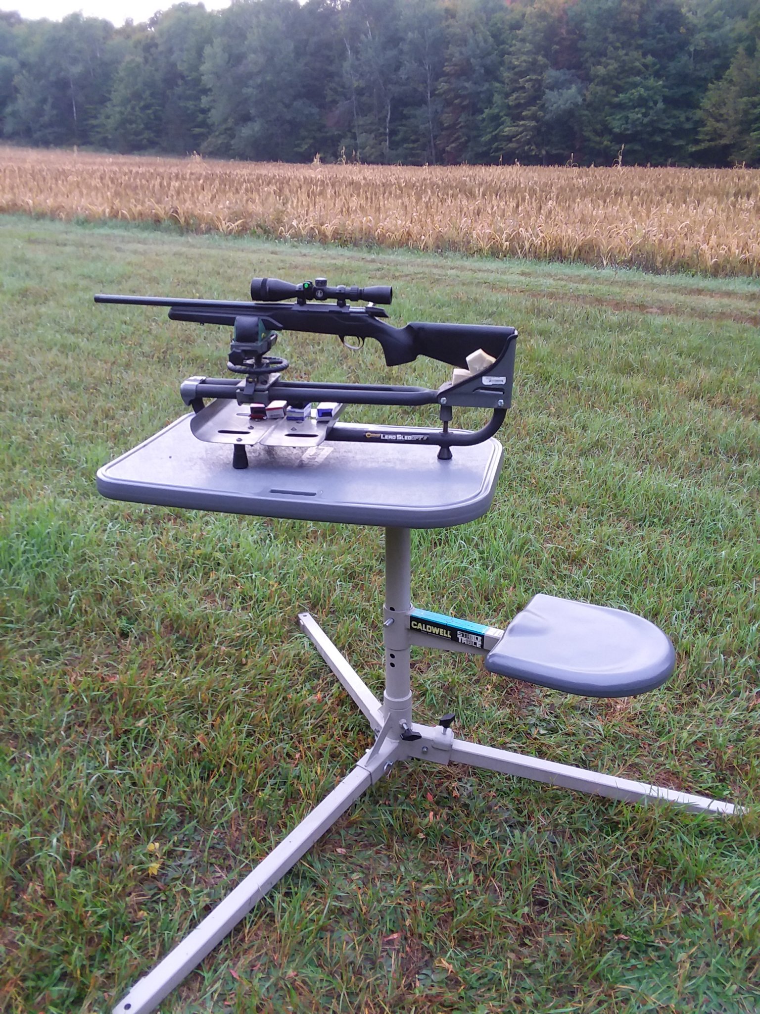

A few quick groups this morning. I didnt have much time. T1X factory stock , action screws @ 25"lbs and Leupold 4-12 AO. It was 60 degrees and nearly dead calm. I just got some lapua midas + and wanted to give it a try. I didnt do anything between ammo types. Just loaded the mag with 10 and moved to the next closest bull. 5 shot groups @ 50 yds from a bench with a rest. This gun really will shoot groups like this all day long. I think all the T1x's will shoot sub moa with decent ammo.
Sniper Student-
Great shooting! Good to hear that the mid to high end ammo are shooting well.
As others have posted, the rifle seems to do well with a variety of ammo and shoot very close to the precision of current aftermarket barrels.
Have you observed whether or not the Midas, SKRM and SK S+ have a bigger difference at 100 yards and beyond?
Cheers and happy shooting.

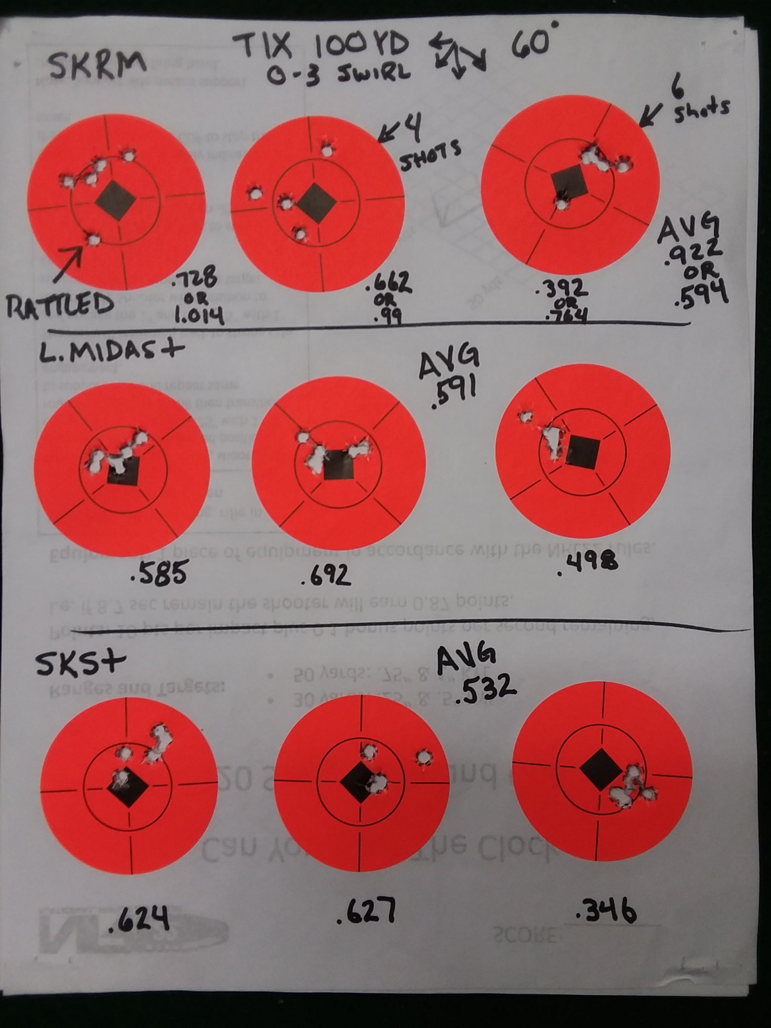

Hey wolf thanks for the 100 yd nudge. I probably wouldn't have got to 100 yd testing so soon otherwise. I had some decent conditions this morning and enough time before heading out to shoot sporting clays. So I moved the bench to 100yds and had a go of it. The rifle match didn't get a fair shake because my son showed up and cancelled on the sporting clays shooting we had planned and then I was forkin pissed , it takes two people to shoot a round of sporting clays. I was still sitting at the bench and had shot the first four shots of the rifle match when he dropped by with the bad news and I just ripped off the fifth shot in disgust. The second five shot group of rifle match ended up only being four shots , I had apparently not pulled my head out of my ars yet and wasn't able to count to five , so the last five shot group of rifle match ended up being six shots. I think I had mostly calmed down for the lapua and standard +. Over all I was completely shocked with what I saw when I got up to the house and put a caliper to things. HOLY HELL!! I have "group therapy session" nearly every morning...22LR + coffee + #1 bird dog = sanity. Good Times Good Times T1X/leupold 4-12 dialed 2 mils from 50 yd zero for all three ammo's
Can't complain about those results. I do find that those target stickers don't give a very precise, repeatable spot to hold on. I use a target I made myself with a grid pattern with a darker center cross to line my crosshairs up on. Helps make sure you are holding on the same exact spot everytime instead of eyeballing whether you are in the center of the circle or diamond. Even just drawing a cross with a sharpie works good. Try to get the lines level so you can level your scope when sighting in. Attached is the target I use. It has a 1/2" grid so you can tell how far off you are without going to the target to measure. The green is dark enough to see but light enough to show small bullet holes.

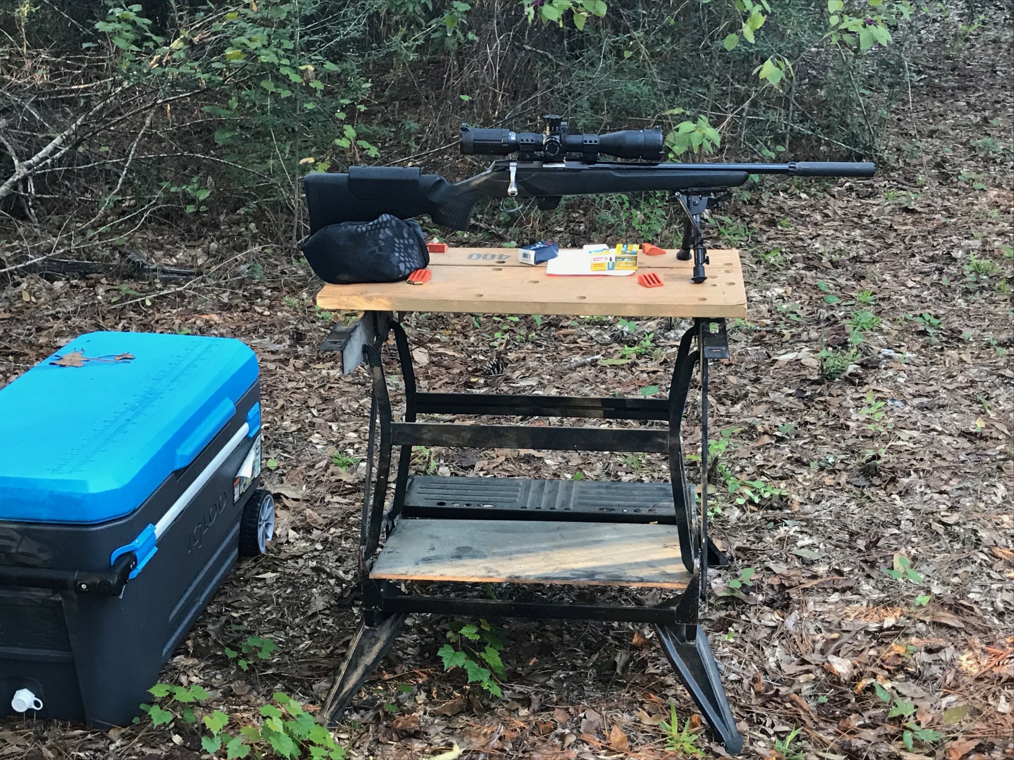

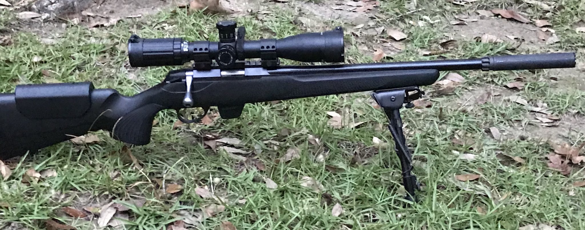

16in T1X came in today. Slapped some parts on it and turned the trigger to 1.25-1.5 pounds. Ran some Aguila SE in the back yard at 25-27 yards. Two of the 10 shot groups. Top shot in the second group was aimed at the inside of the A while sighting in. DIP rail, Victor cheek rest, Tikka vertical grip and recoil pad, 16x SWFA off the 223.
Thanks melglass. Looks great so far. I have really been considering cutting and threading my 20" but it shoots very good as is. I would love to see some 50yd groups when you get a chance. My guess is the 16" will shoot just as good as the 20". At which point I will probably end up buying a 16" model. what silencer is that?
Yea 25 yards don’t tell you much. Prepping the club for hunting season so don’t know when I will get a chance to shoot it farther. Guess I really need to finish the range I started earlier this year. Will end up with 100 yards when I’m finished. Could not stand having a new gun and not putting some rounds down range. SilencerCo Spectre 2
Pulled out the hi-tech bench then cut some bushes to get to 50 and shoot some groups. 10MPH swirling wind just tried to shoot when the conditions felt the same. Both of the Aguila ammo had super sonic rounds and it really killed the Eley primed groups.
