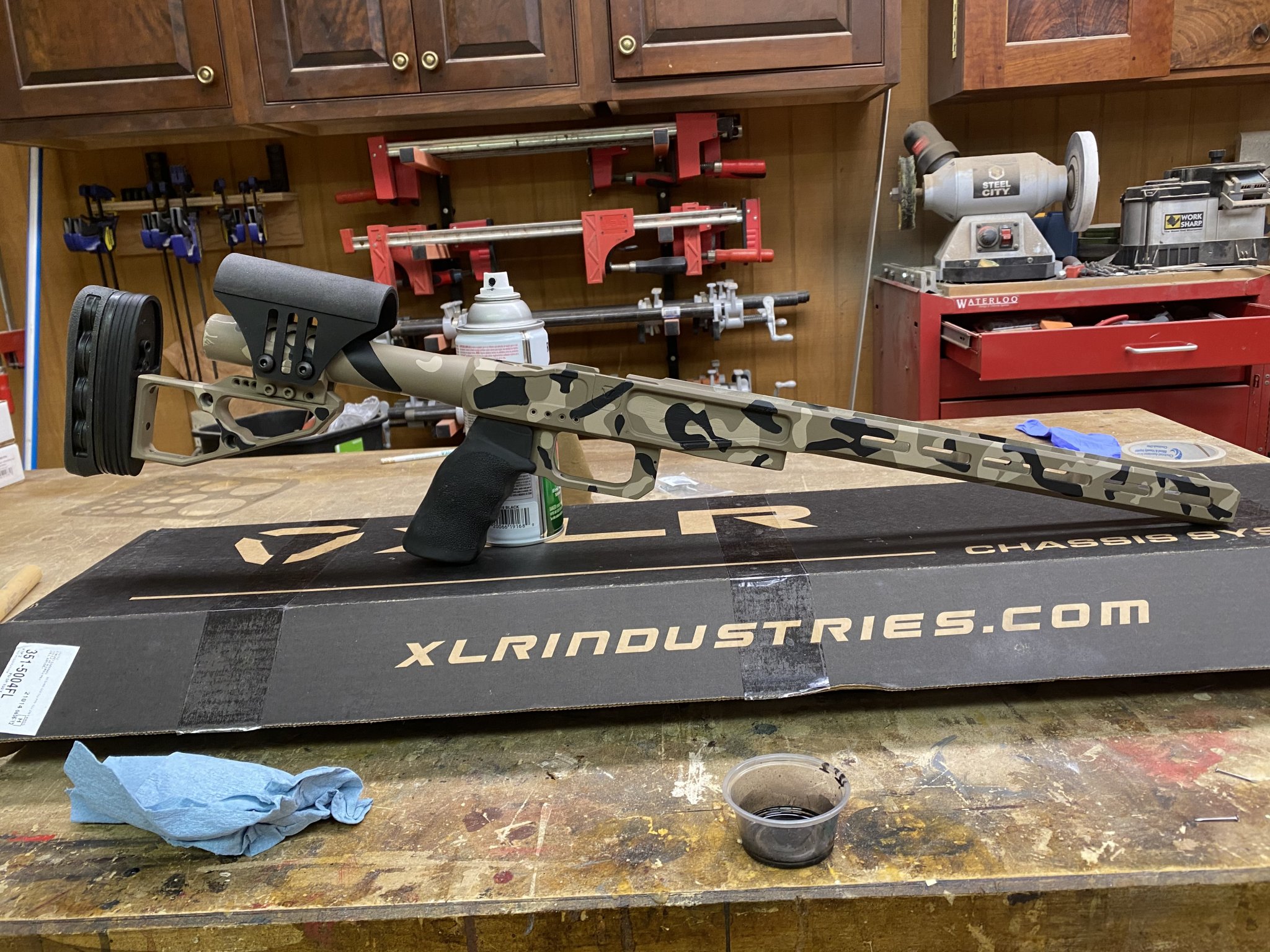

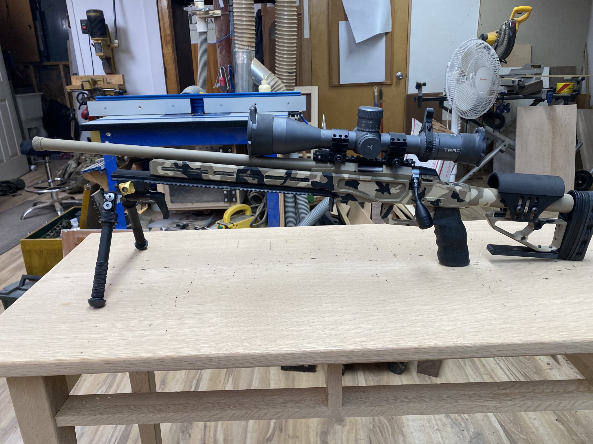

Well everything is on the way. I got an XLR element ambidextrous chassis, a lefty t1x in 17HMR, a new bolt knob, scope rail and trigger spring from Anarchy Outdoors and I have two 22lr barrels I’m having cut for the lefty action. One factory lighter weight barrel and one heavy bull barrel. I should have a lefty T1x in 22lr all together by the end of the week. This rifle is for my son so we will be starting with the lightweight barrel for now. Once it looks like he can manage the weight we will swap out the heavier barrel.

I just finished the Cerakote on it a few minutes ago. I just need to machine the Arca rail and bag rider so I can mount them and it will be ready for the action which should be here Wednesday.

I just finished the Cerakote on it a few minutes ago. I just need to machine the Arca rail and bag rider so I can mount them and it will be ready for the action which should be here Wednesday. View attachment 7557811
