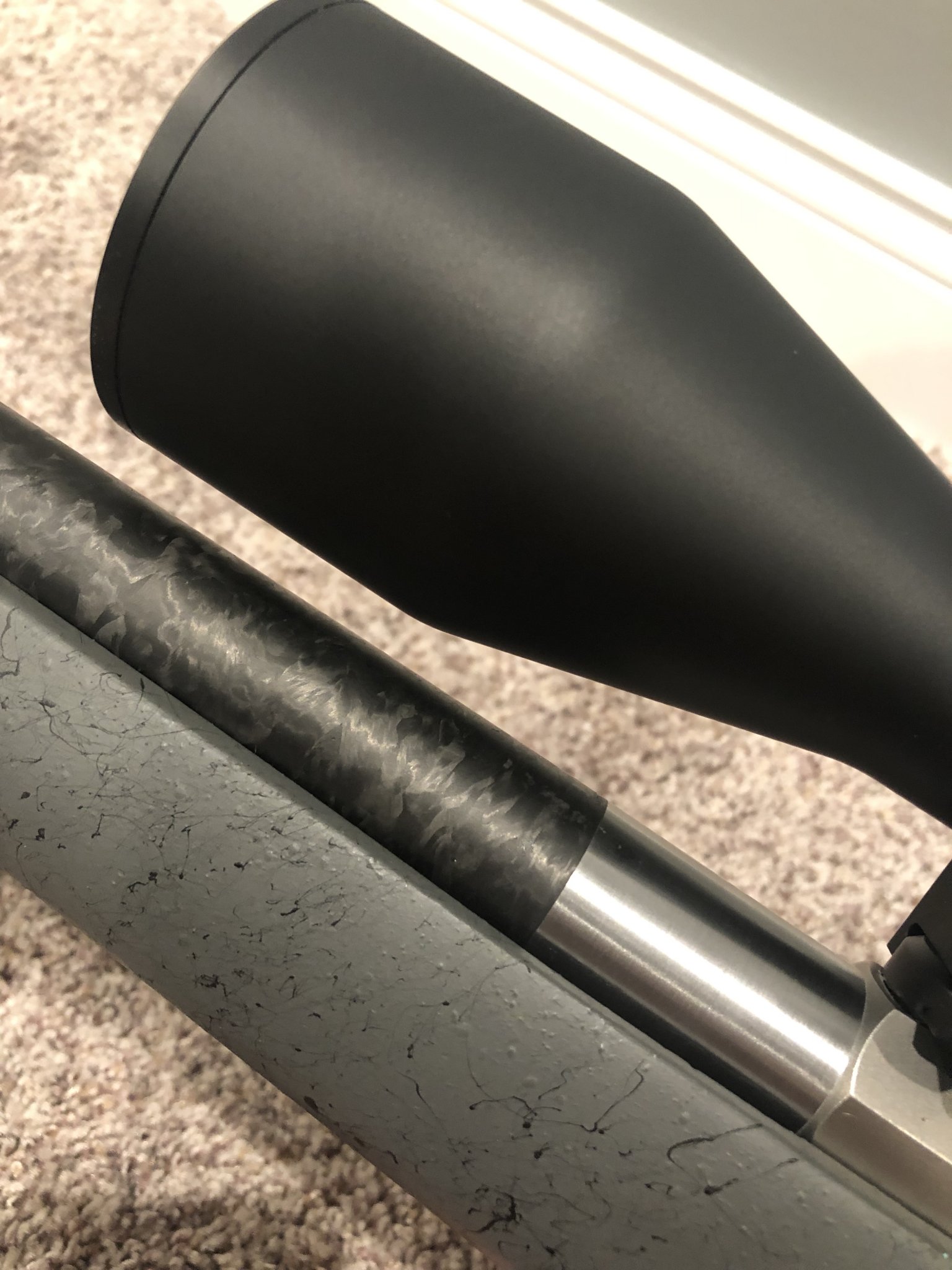

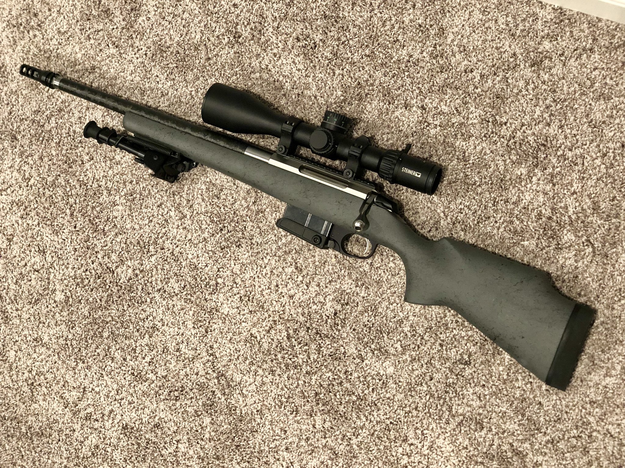

After a 5 month wait, I got my CarbonSix barrel yesterday. 17” 6.5CM, Sendero profile. Will be used with my left hand Tikka stainless action in a Grayboe Terrain, Steiner P4Xi 4-16x, and a Dead air Sandman S.
Hopefully will get the barrel installed and scope mounted this week!
Got this rifle put together tonight.
Put anti seize on the barrel threads, snugged it up in my barrel vise and put the action on at 55ft lbs using a PVA inside rear entry wrench. The barrel slipped and spun right after the torque wrench popped, so that was a good value, ha. Passed headspace check on GO and NO-GO gages. Put on the Dead Air muzzle brake and mounted the Steiner scope.
Will get some pictures up in a day or two, but I really like the feel and balance of this rifle. It’s a handy size that’s for sure. Not necessarily light by most standards, but compared to my Tac A1 it’s a feather.
Well it seems to return to zero and maintain accuracy.

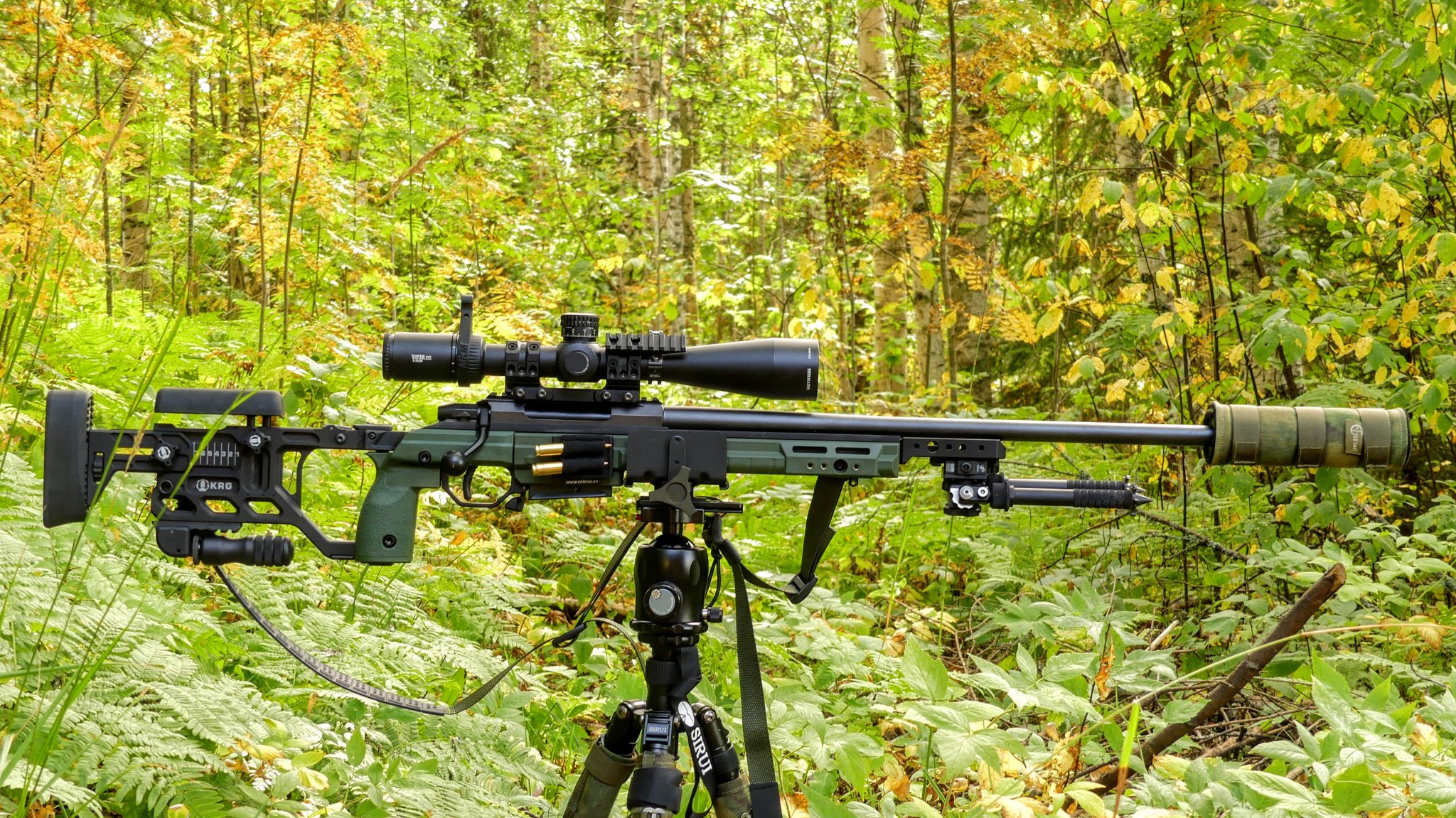

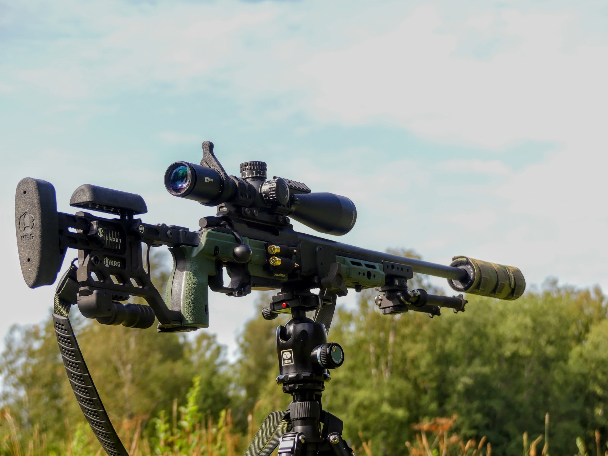

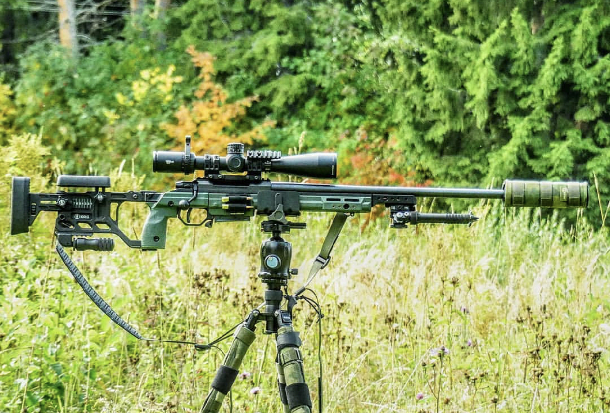

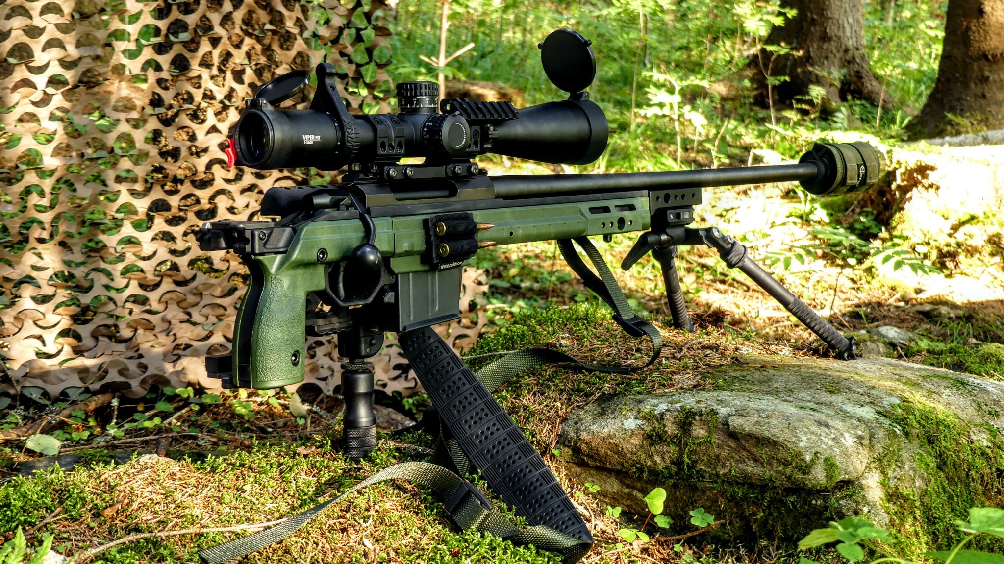

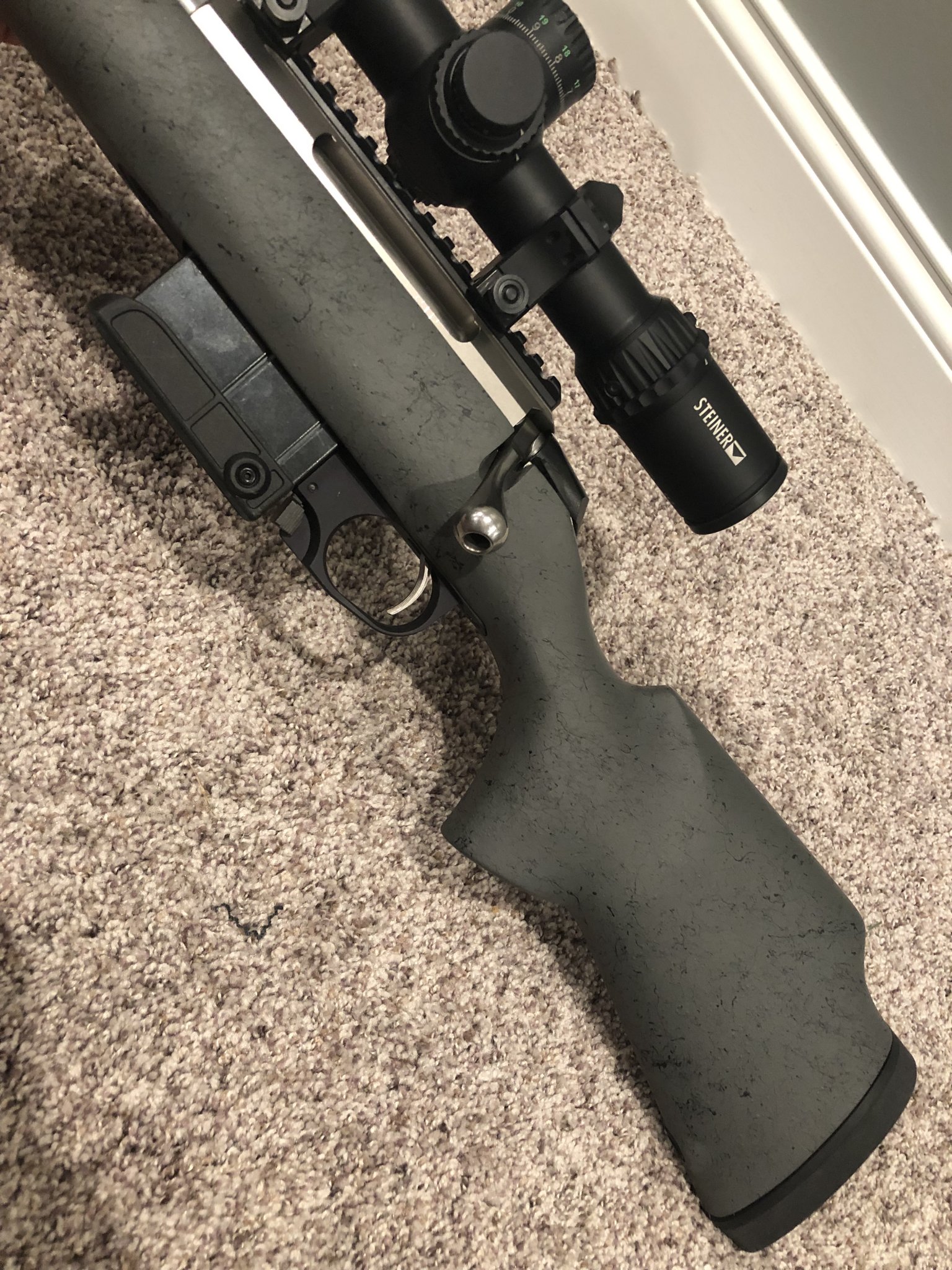

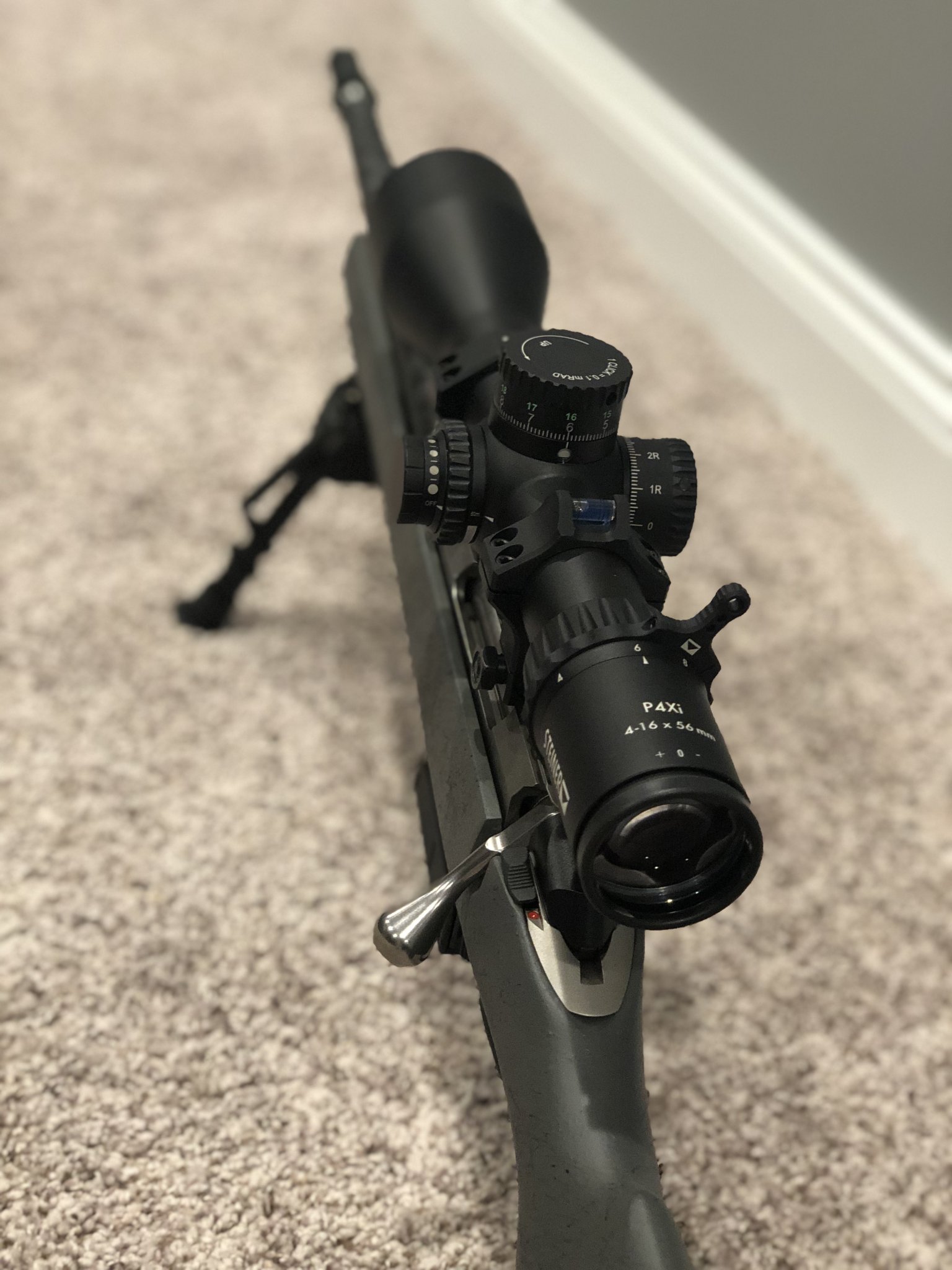

Okay, some pictures of my finished rifle.
Left hand Tikka T3 stainless action, Mountain Tactical short action bolt stop, CTR bottom metal and 10 rd magazine, Grayboe Terrain stock, CarbonSix carbon wrapped prefit shouldered barrel in 6.5CM with Sendero contour and 17” length, Dead Air muzzle brake (Sandman still in ATF jail), Area 419 20MOA rail, Steiner rings, Steiner P4Xi 4-16x scope.
Rifle is real handy, balances great. Not a true lightweight, but a damn sight lighter than my Tac A1. Can’t wait to get this guy zero’d in and see how it shoots.
