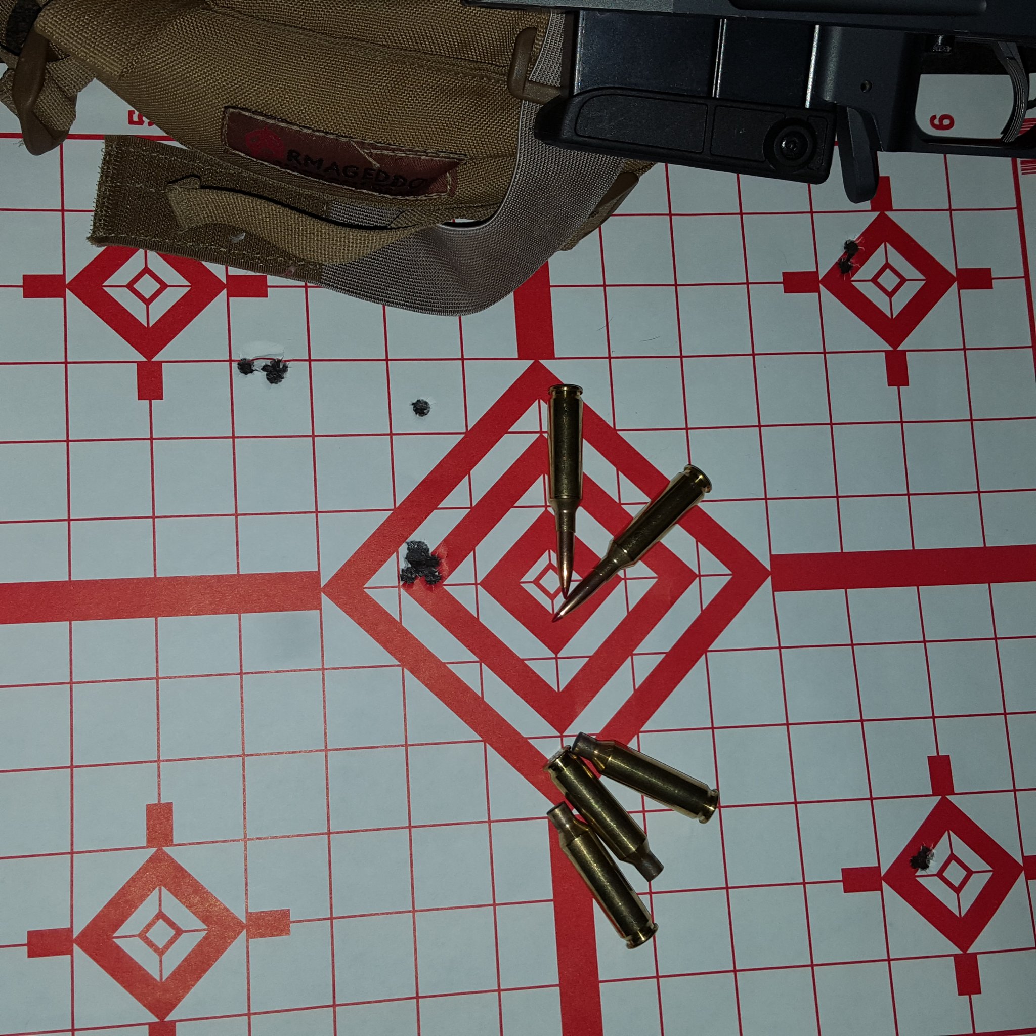

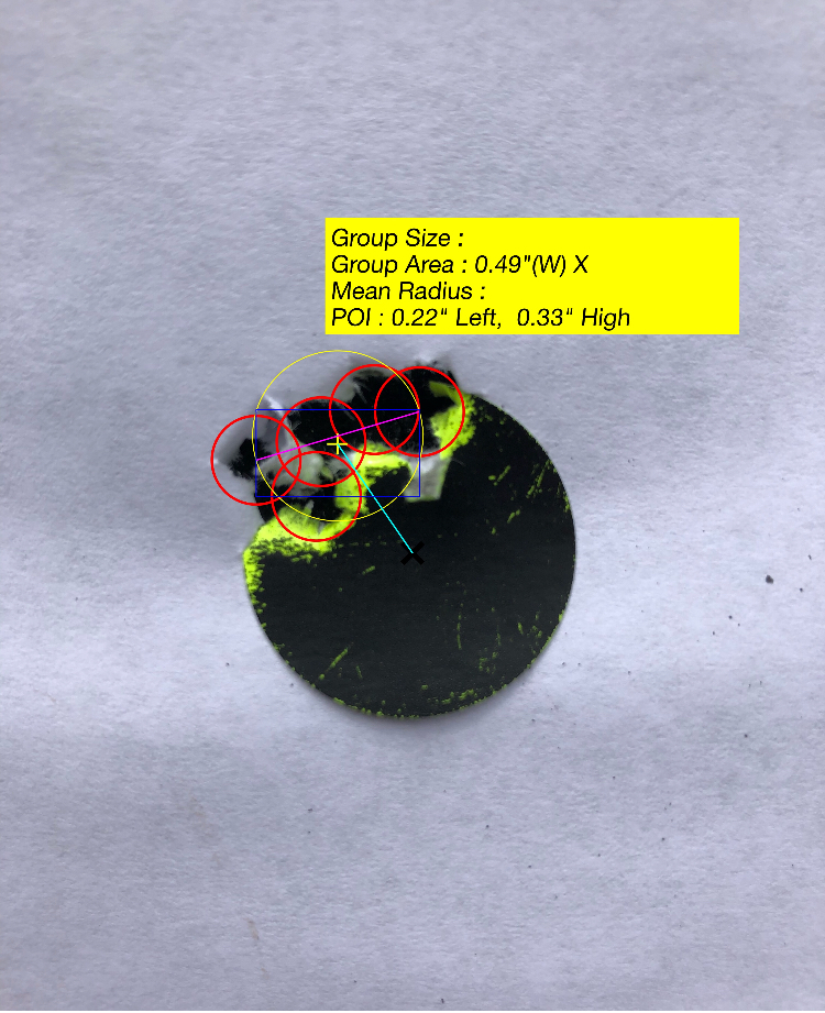

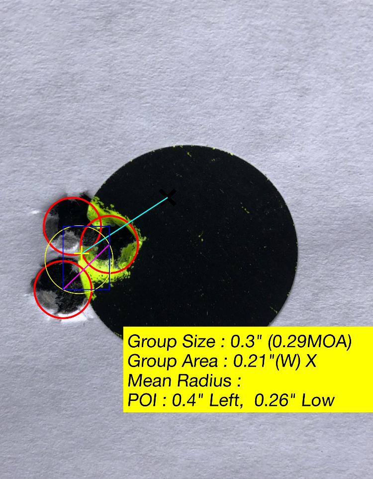

For break in I shot 1 and cleaned 10x, 3 and cleaned 1x, 5 and cleaned 5x, and 15 and cleaned. Barrel cleaned up easily after the 15 rnds, 2 dry patches, 1 wet, 2 dry.
Looks like it has potential, considering this is bulk 55g Vmax loaded in new brass. The 69's and 77's produced similar results.

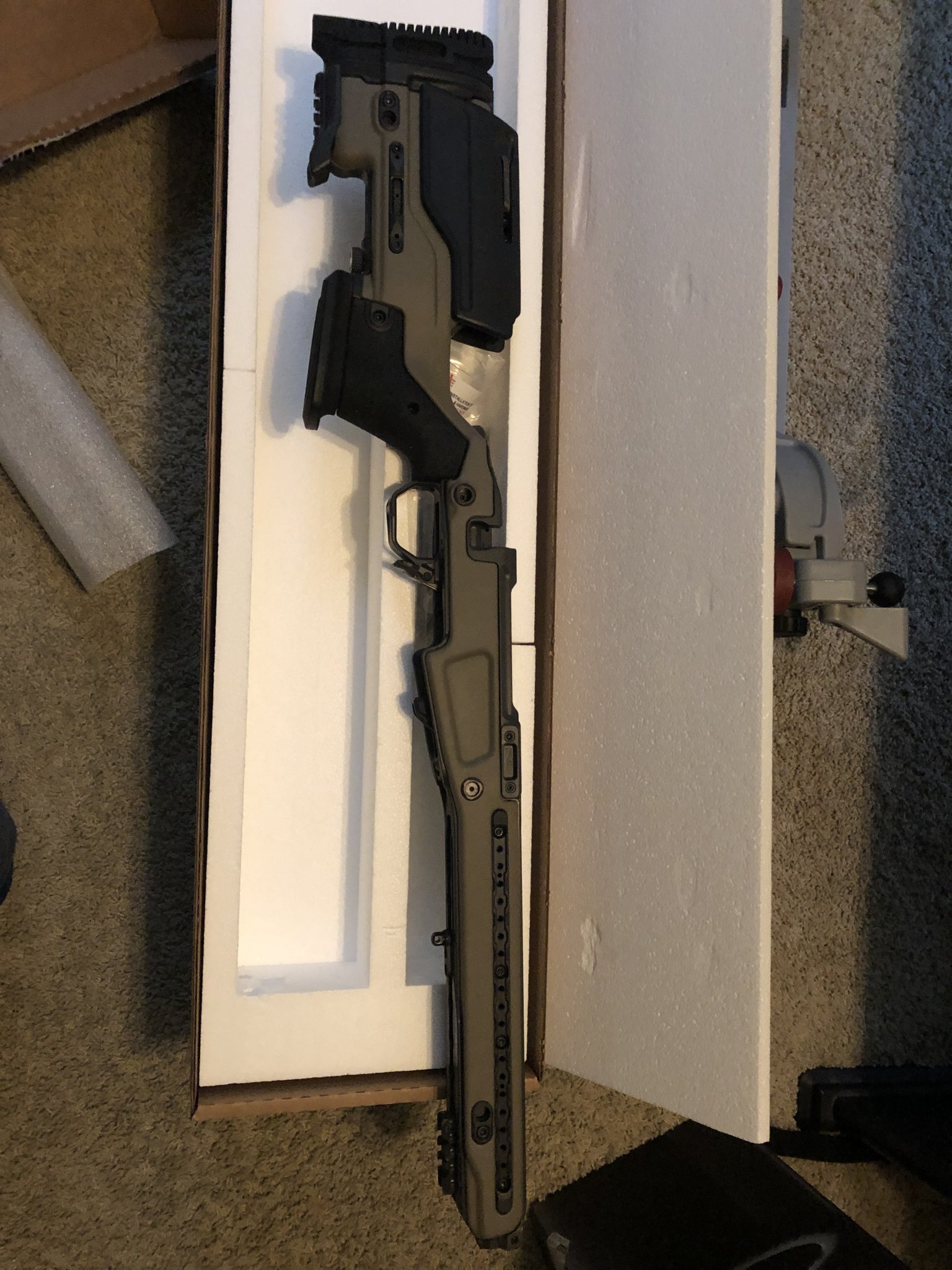

Time to order the KRG Bravo and mags. (y)
