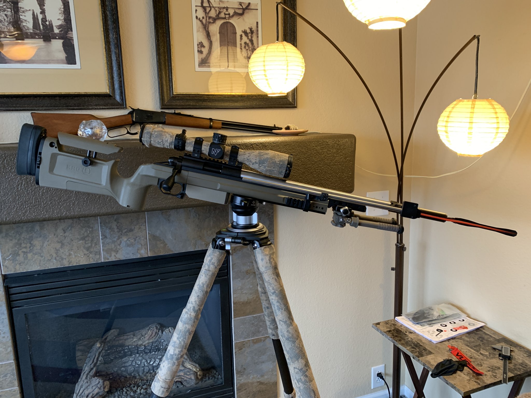

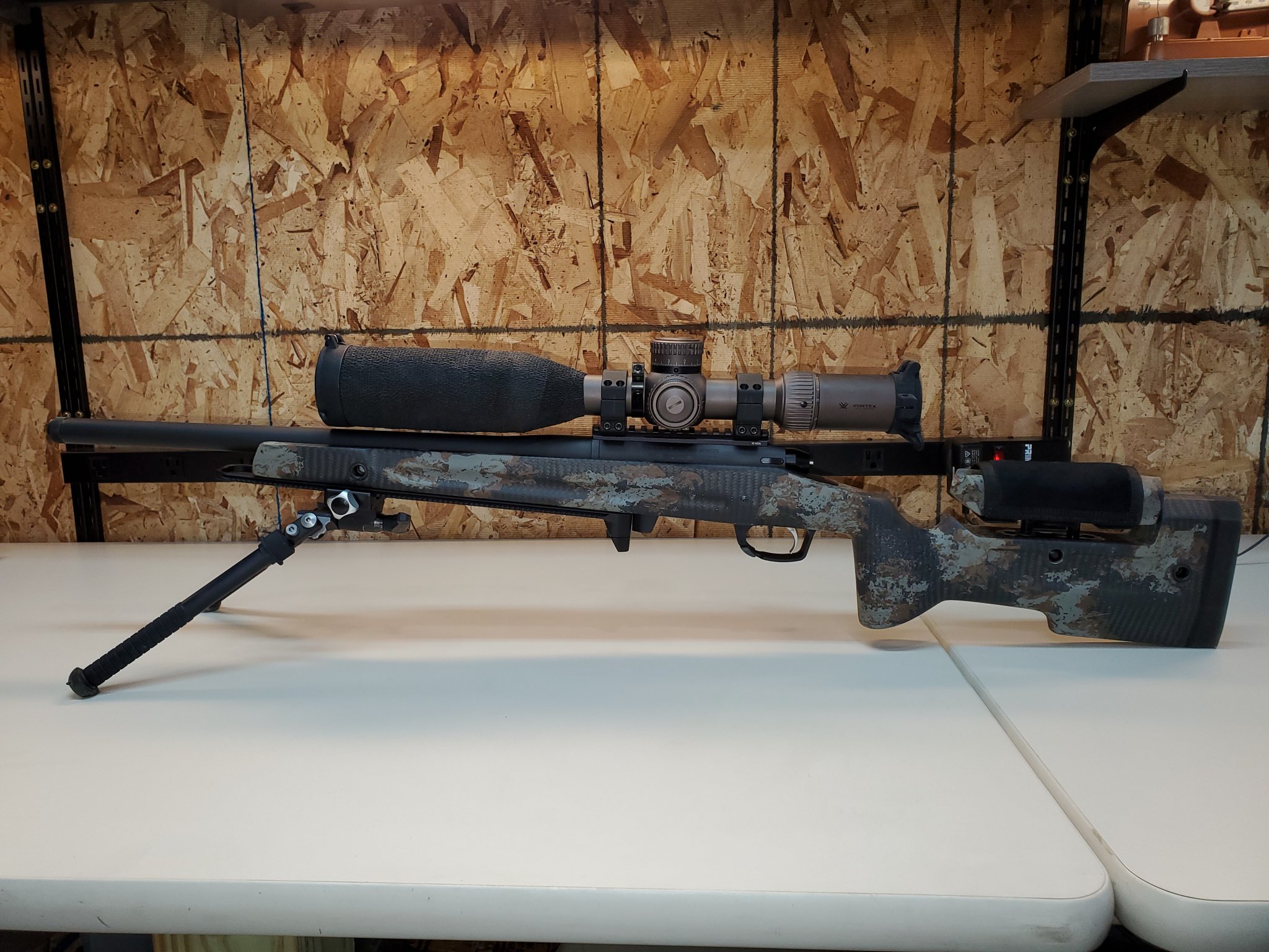

Congratulations. I love mine. Good people at MHSA. What stock/chassis?Well I guess I’ll be post 5001 and state that I just finally bought a V22 with a 18” kukri profile proof barrel from MHSA today!
Join the contest SubscribeCongratulations. I love mine. Good people at MHSA. What stock/chassis?Well I guess I’ll be post 5001 and state that I just finally bought a V22 with a 18” kukri profile proof barrel from MHSA today!
So a little birdie told me AI will be releasing a new chassis by end of year so for the time being I’m gonna run a bravo I think. When I walked in, I wanted to run a aiax chassis and may still. I don’t know yet lolCongratulations. I love mine. Good people at MHSA. What stock/chassis?
AI did have a new R700 pattern AXSR-ish chassis at SHOT Show.So a little birdie told me AI will be releasing a new chassis by end of year so for the time being I’m gonna run a bravo I think. When I walked in, I wanted to run a aiax chassis and may still. I don’t know yet lol
Yup. That’s the one lol I like the ARCA rails built in and interchangeable grips As I’m very fond of the MPA vertical grip. Did they have a price estimate by chance?AI did have a new R700 pattern AXSR-ish chassis at SHOT Show.

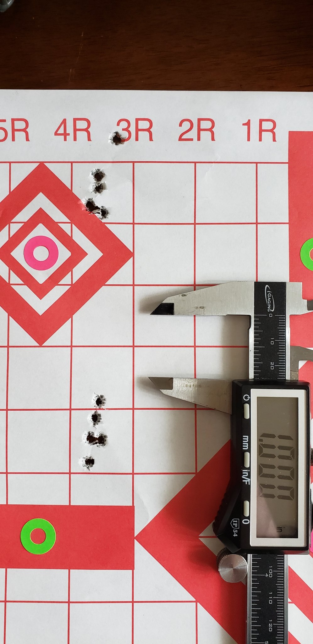

Outdoors, bench, bipod (BT72) and a game changer for rear bag. Planning on heading to an indoor range with a proper rest next days off to see how well this lot of Center X doesIndoors or outdoors? Amazing group either way!

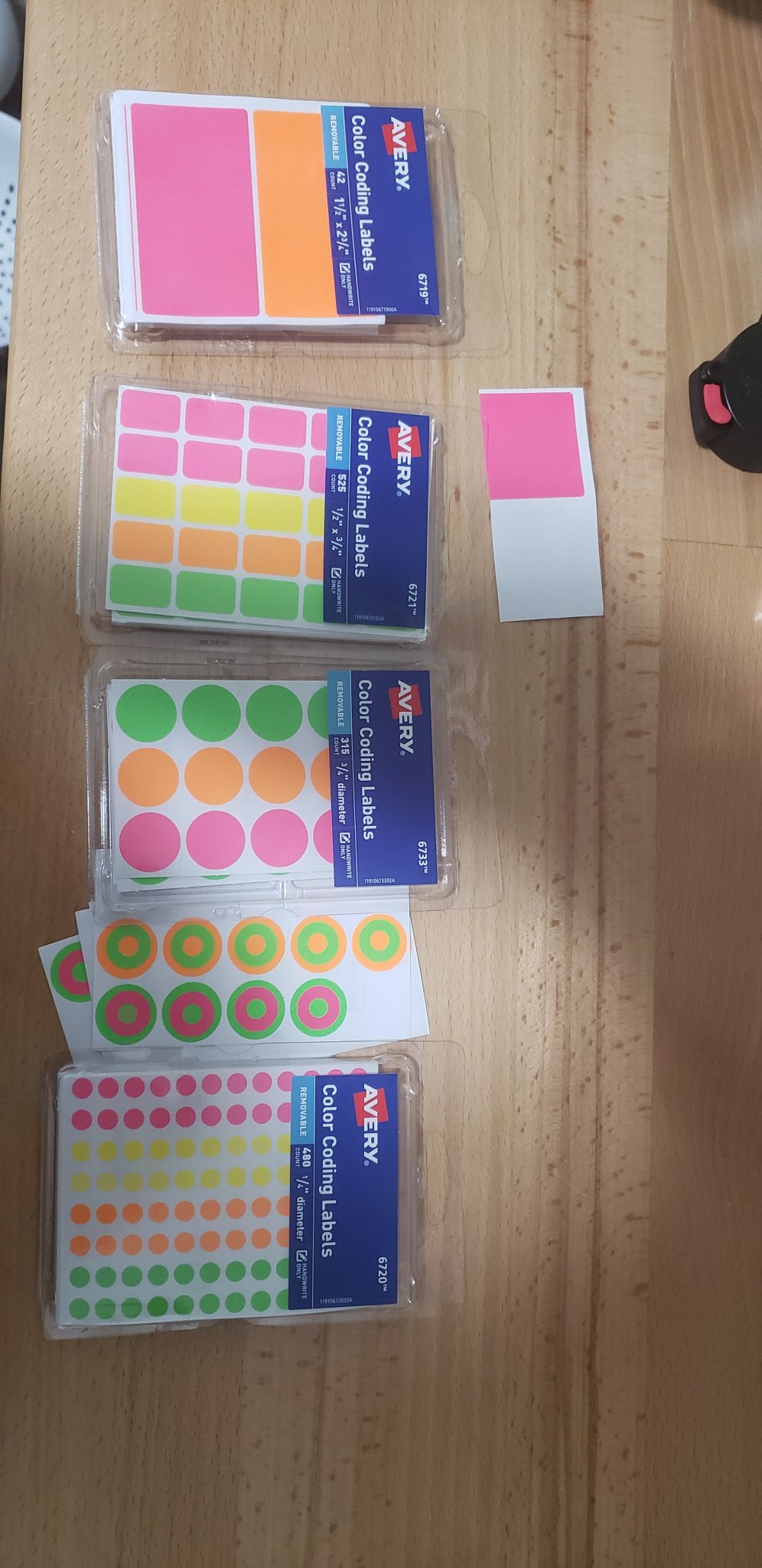

Nice! Walmart for me but I can't imagine any price difference.. give color coding labels a try, my favorite 100 yard target is a hole reinforcer over a 3/4 label.wow nice 4066.5. im starting to sell off some c&r duplicates and misc scraps to fund a new 22, and it will most likely be a vudoo. kinda cool, you are the first person i have seen that shoots at the paper hole reinforcements like i prefer to do. looks like staples brand.

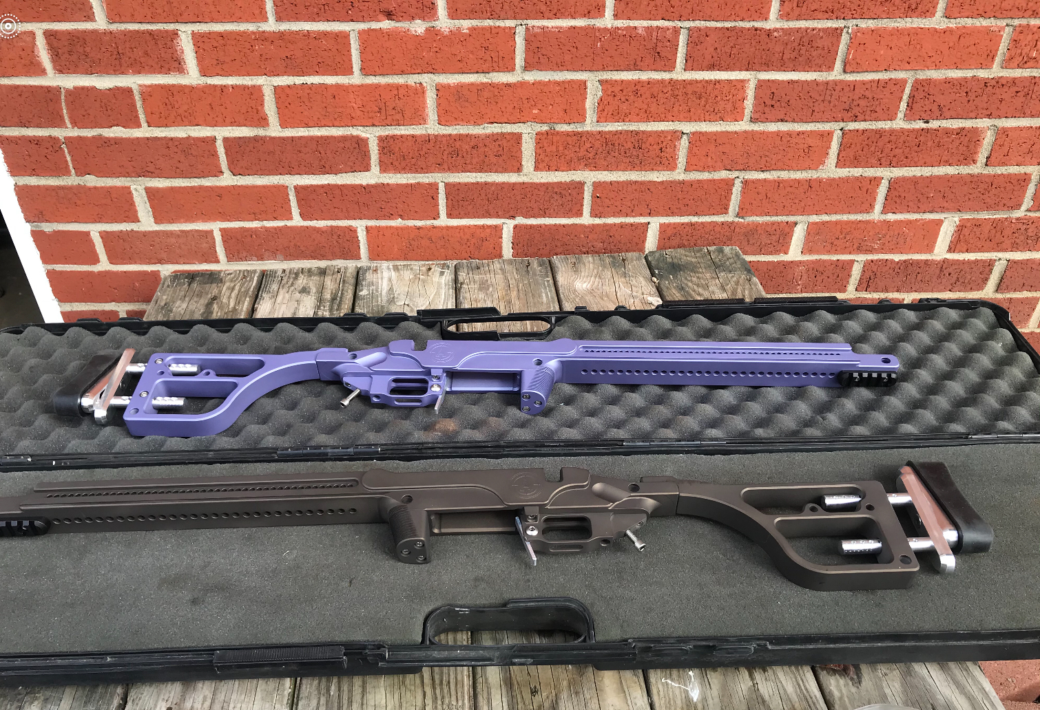

One thing to note on their new AR grip interface. It uses an Ergo grip, but the AR grip tang itself is rotated backwards 10 degrees, so that the Ergo grip is more vertical. The big downside with that is if you bolt on an MPA or MDT vertical grip, it’s going to be rotated backwards as well and essentially be useless.
I Use the sameNice! Walmart for me but I can't imagine any price difference.. give color coding labels a try, my favorite 100 yard target is a hole reinforcer over a 3/4 label.

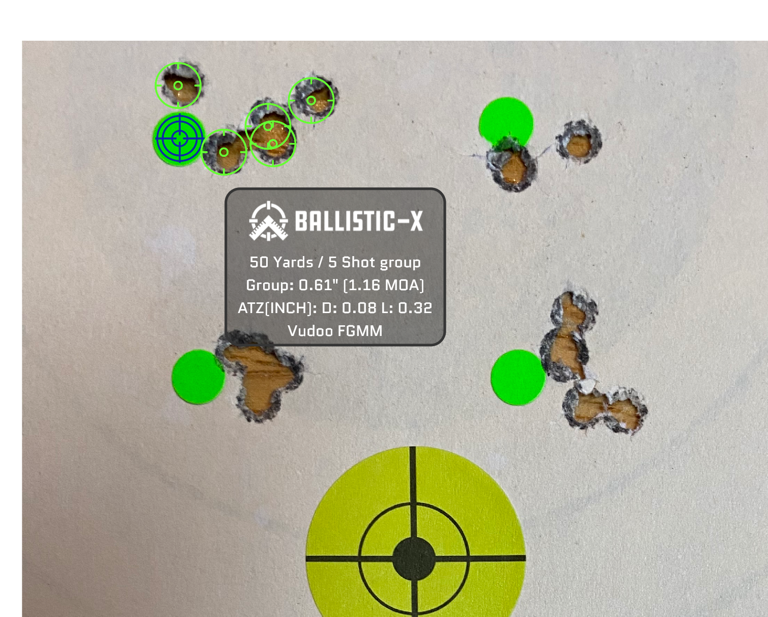

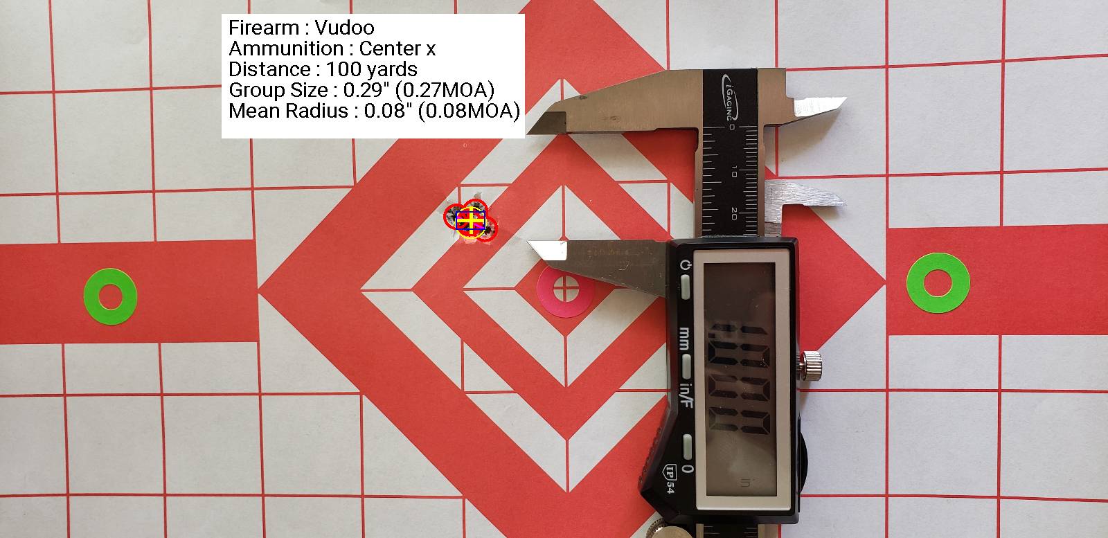

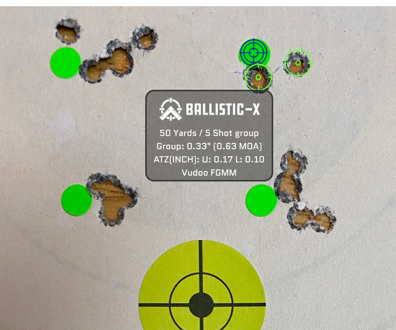

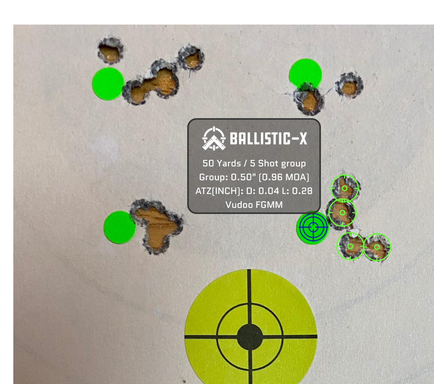

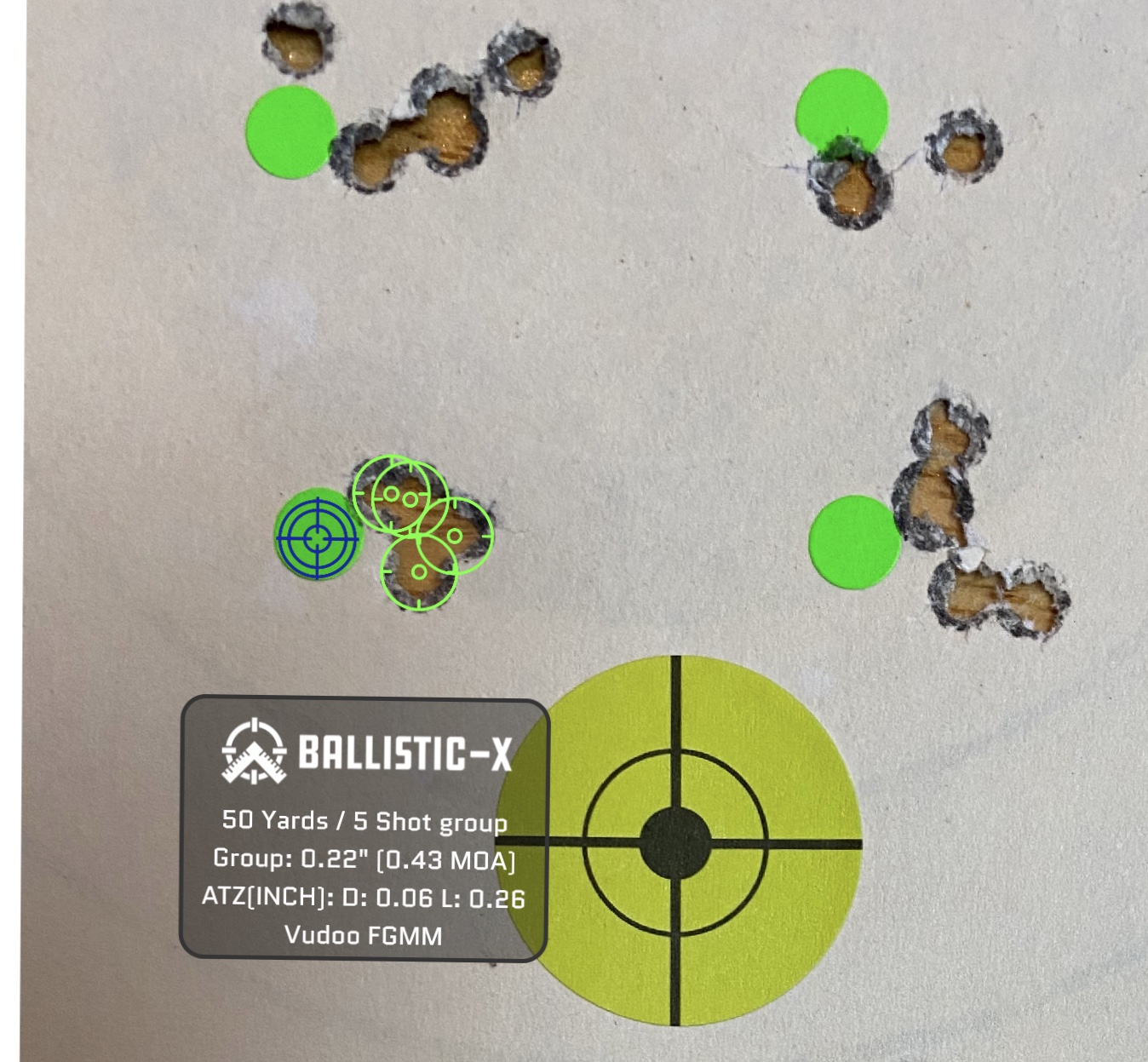

Today I shot the best 100 yard 5 round group of my life, any platform , any caliber... And it was out of my Vudoo.

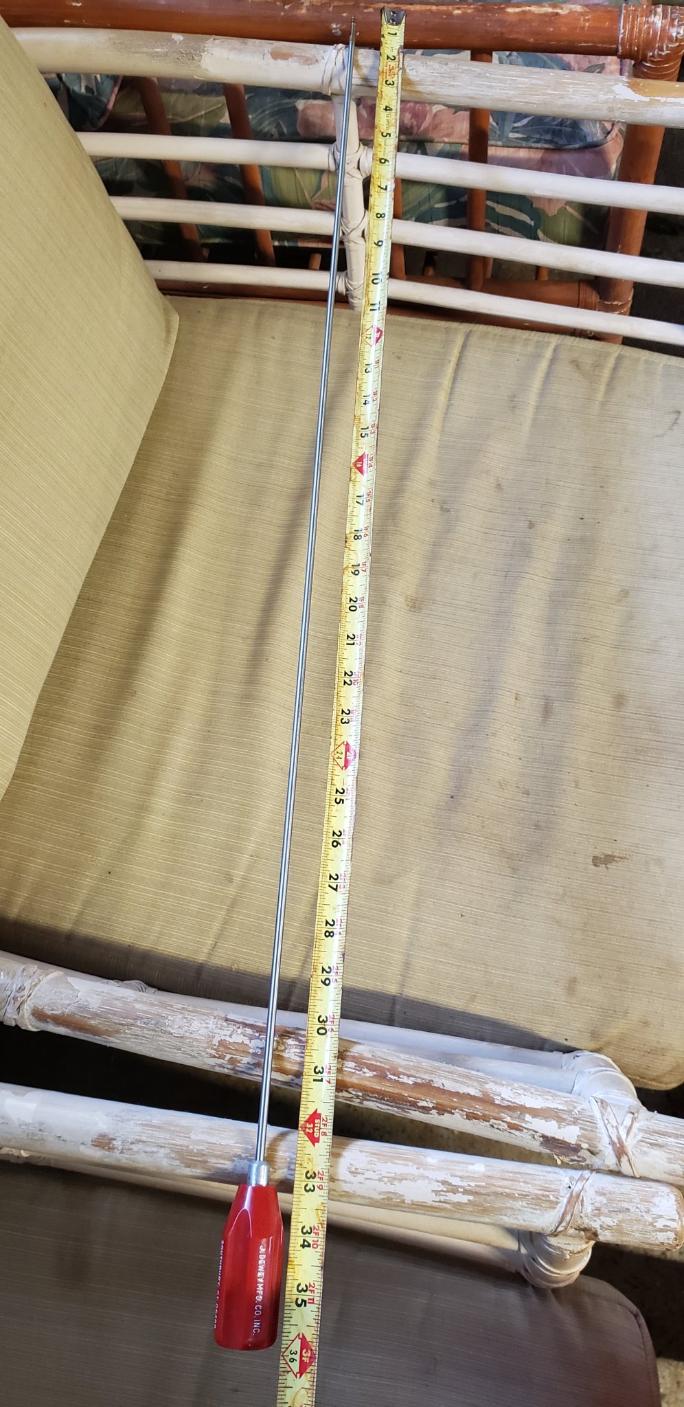

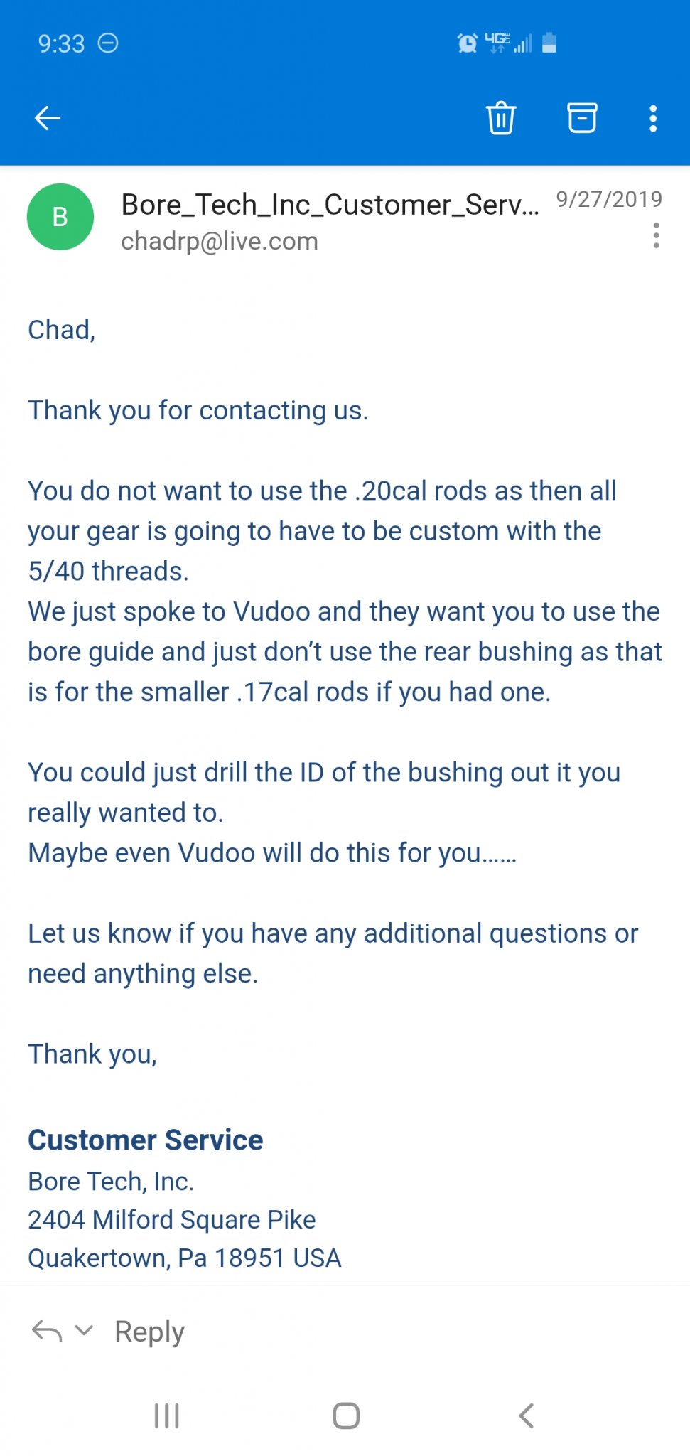

I need advice on cleaning. I purchased the bore guide but need guidance on what size jag, patches, rod, etc. I understand I need a rod and jag that are smaller than .187. But what about brushes and patches. Do I size for .22 or .187?
Not sure if it does any good, but I enjoy the process. Weight then rim thicknessNice shooting! If I may ask, what if your sorting procedure? Just by weight?
I asked Bore Tech the same question last fall and their answer after contacting Vudoo was to drill the bushing to the 22 rimfire size, which is slightly smaller than their 22 centerfire rod to clear the ejector, or not use the bushing at all.I need advice on cleaning. I purchased the bore guide but need guidance on what size jag, patches, rod, etc. I understand I need a rod and jag that are smaller than .187. But what about brushes and patches. Do I size for .22 or .187?
Sweet rifle this is exactly what I’m wanting.I've been waiting since September to join the Vudoo crowd and finally did this last week. Got to put a few rounds on it last night and looking forward to put some more thru it tomorrow.
Thanks!Sweet rifle this is exactly what I’m wanting.
welcome, you will love it the more you shoot itI've been waiting since September to join the Vudoo crowd and finally did this last week. Got to put a few rounds on it last night and looking forward to put some more thru it tomorrow.
I got a .17 cal rod from Montana Extreme (they make some nice stuff) and a .20 cal jag. I found it impossible to push a patch through on a .22 cal jag, but the .20 works fine.So just use .22 cal gear and NOT use the Vudoo provided .187 bushing?
Mostly I'm curious about downsizing to .20 or .17 jag to accommodate a patch or if the .22 jag takes that into consideration?
I was going to get the Bore-Tech rod and their jag and some brushes and patches.
I just used the guide, bore tech 22rf rod and 22rf jag. I will probably eventually drill out the bushing to match the rod so I can use it.So just use .22 cal gear and NOT use the Vudoo provided .187 bushing?
Which 20 cal jag are you using.im also having same issue.when removing bushung and trying 22 rod and jag..even ejector will try prevent itI got a .17 cal rod from Montana Extreme (they make some nice stuff) and a .20 cal jag. I found it impossible to push a patch through on a .22 cal jag, but the .20 works fine.
BoreTech.Which 20 cal jag are you using.im also having same issue.when removing bushung and trying 22 rod and jag..even ejector will try prevent it
I think they just have one .20 jag. I also got some nylon brushes—the .20s are also threaded the same as that Montana Xtreme .17 rod. I’m out of town so I can’t say for sure if my patches are 1" or 1.25".Which and what size patches?
The 20 cal bore tech rod fit vuddo bore guide bushing?I think they just have one .20 jag. I also got some nylon brushes—the .20s are also threaded the same as that Montana Xtreme .17 rod. I’m out of town so I can’t say for sure if my patches are 1" or 1.25".

I emailed Vudoo on what rod they recommended with their boreguide... I used to use a Proshot 20cal rod/jag for the Tikka, 22cal was too tight of a fit in the match barrel.
That I don’t know, I have the 17/20 rod from Montana Xtreme.The 20 cal bore tech rod fit vuddo bore guide bushing?
I'm waiting on Boretech. I've been corresponding with them regarding the vudoo cleaning rod and seems like they are close to a final product. What you see below is from late last week.That I don’t know, I have the 17/20 rod from Montana Xtreme.

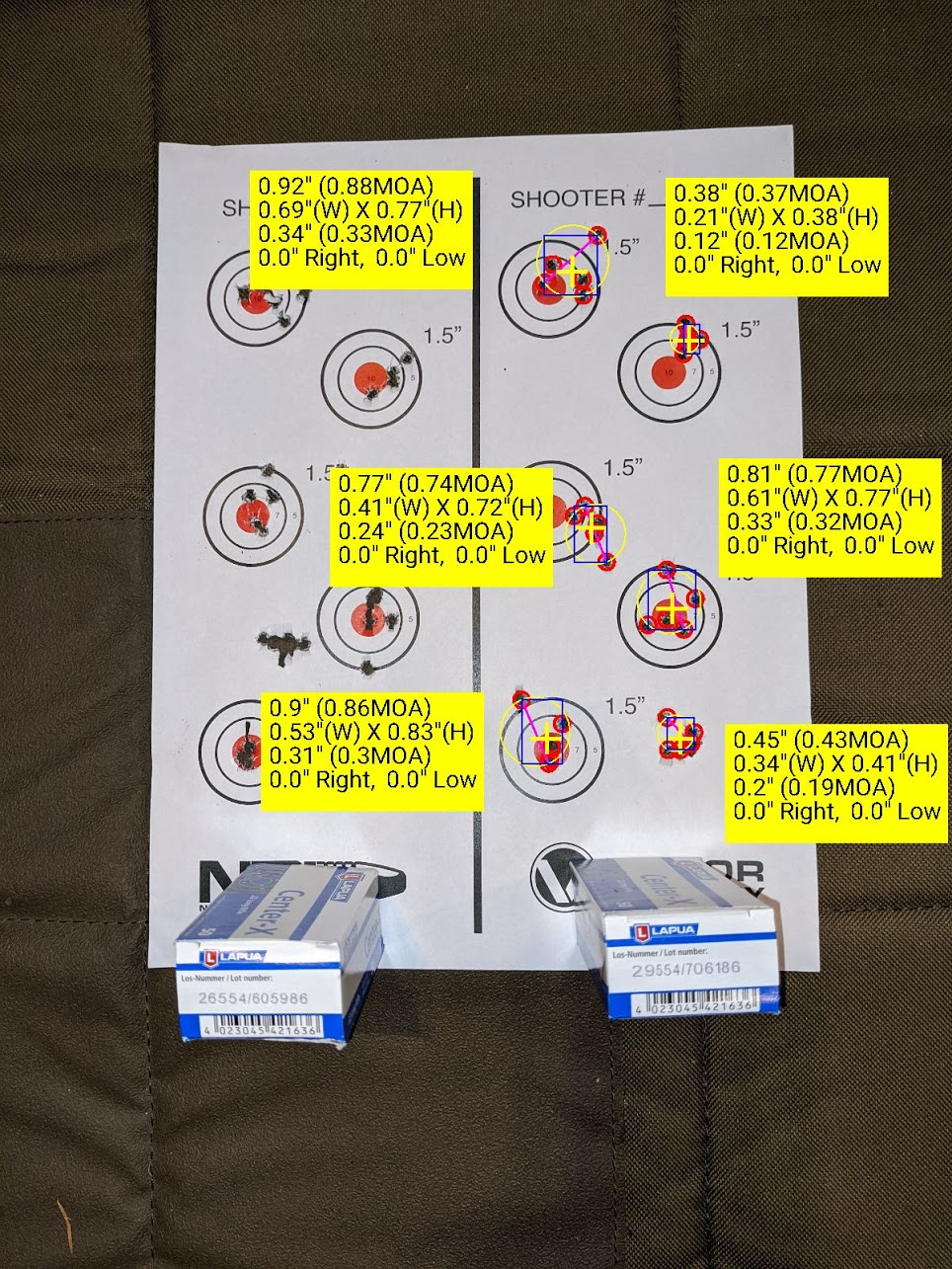

Littlepod, are these groups at 50 yards? Thanks!Nice! Yeh the ES is large though... that would've been a .1" per fps at 200 yards, so you're looking at > 3" group. My friend has been shooting in the 2.5" groups, so I guess an ES of around 25.
This is the lot# I did when I tested with my friend's RPRR and my Tikka IBI. Vudoo comes I think end of this week or early next week! I have 1200 rounds left of this lot to play with the Vudoo.
