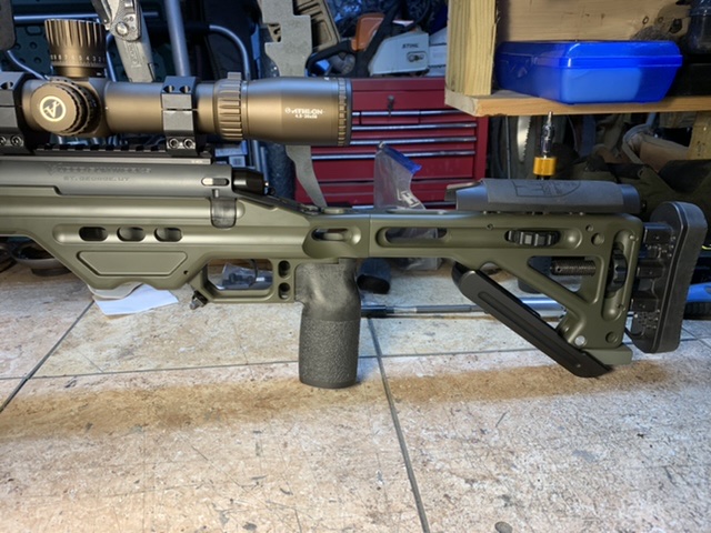

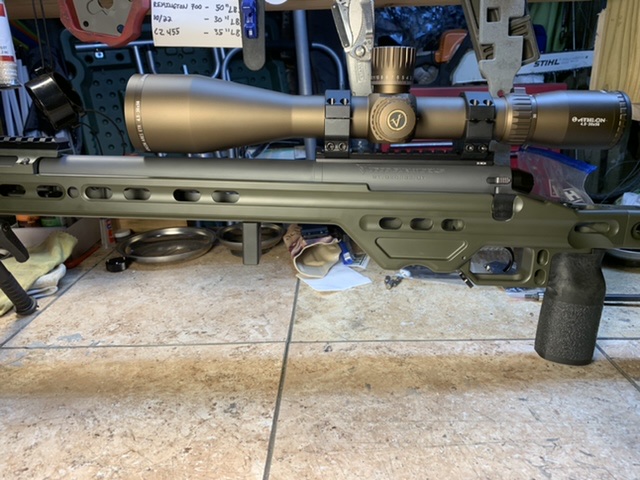

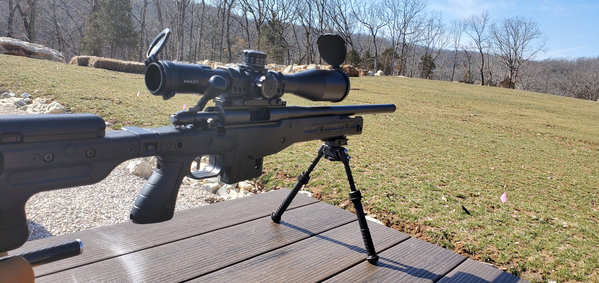

First 100 yard group’s on first day with new vudoo. Less than 50 rounds through it at this point. Rws r50. Shooting to the north with sw wind 15-20 mph.
20” Mtu ace barrel
Mpa ba comp chassis
Athlon Ares etr 4.5-30

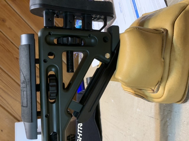

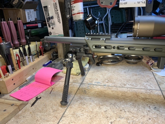

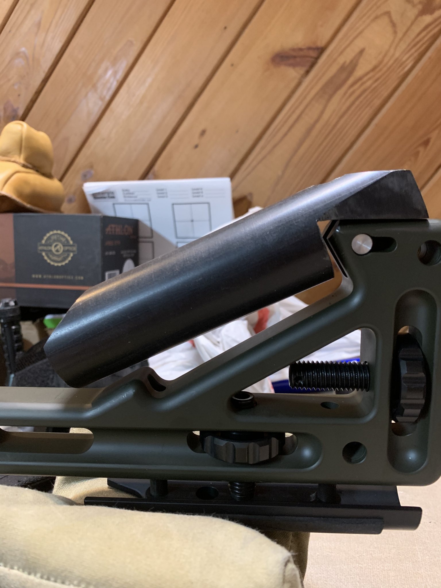

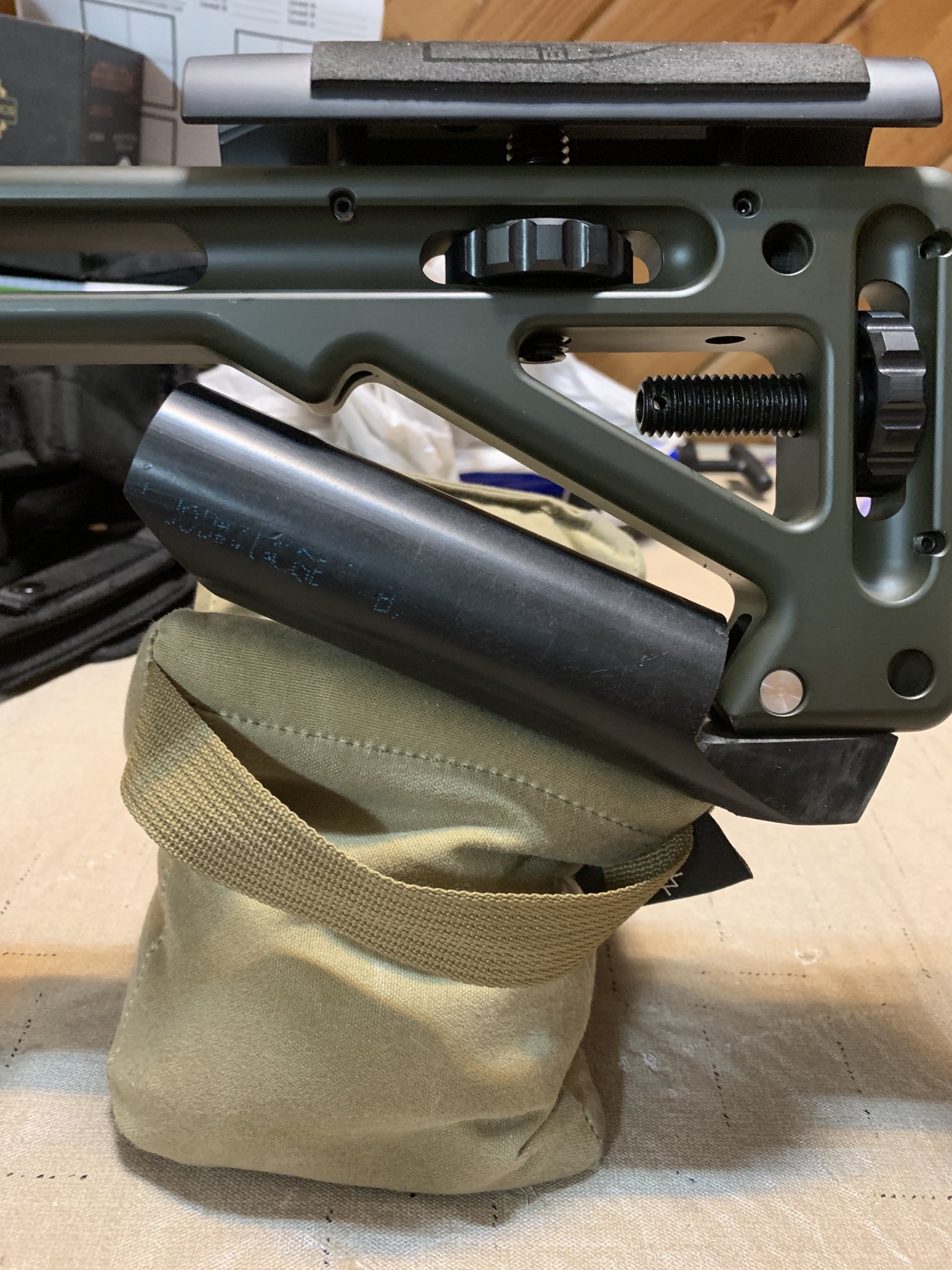

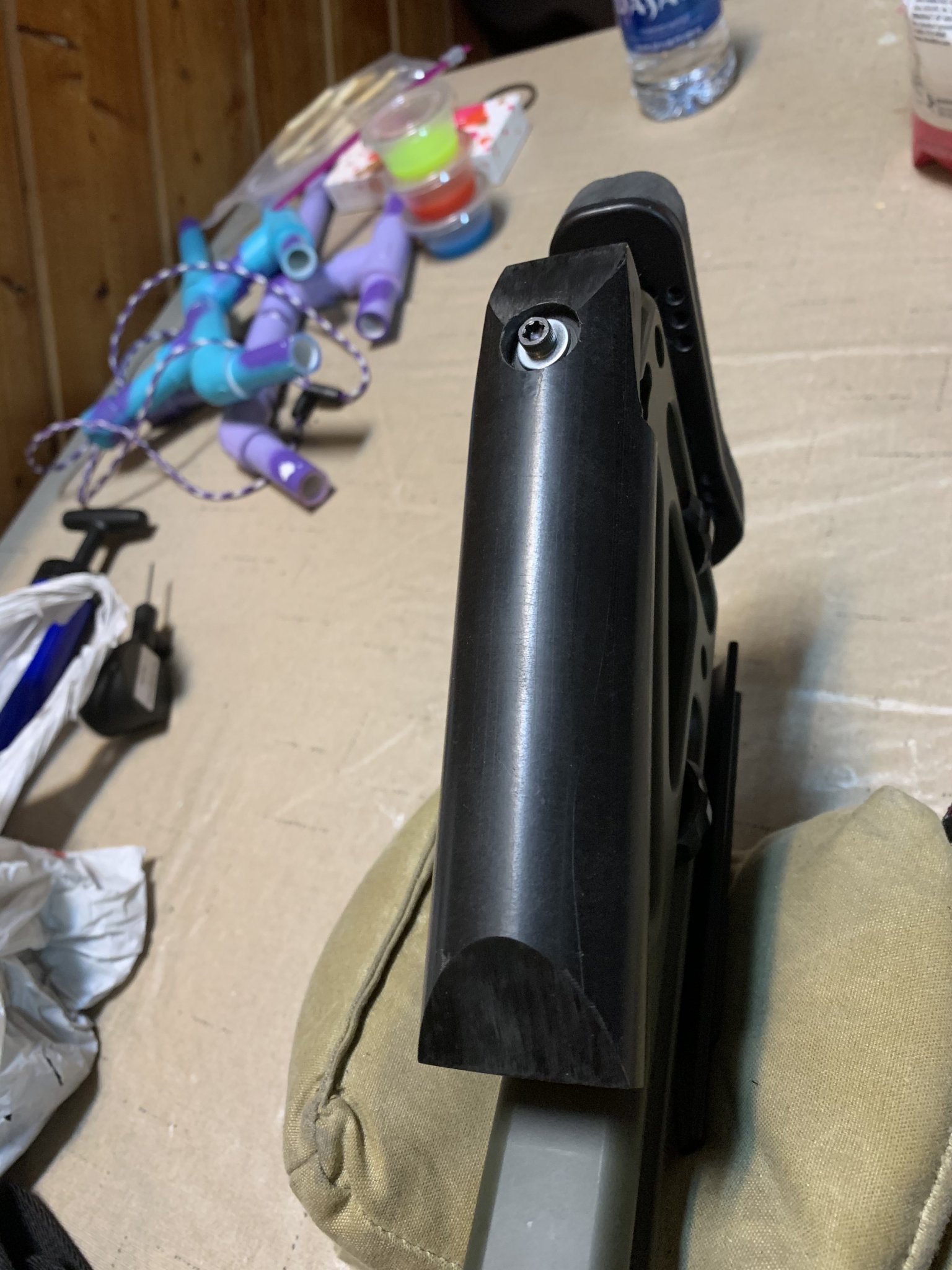

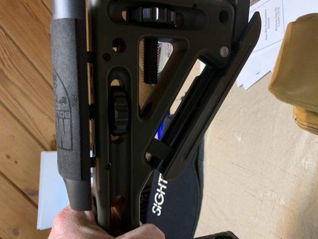

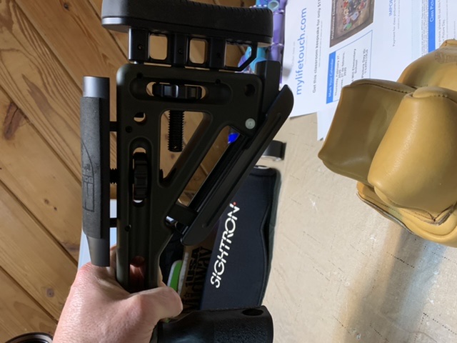

Posted some pictures of my first outing and 100 yard groups yesterday. Here’s some pictures of the rifle and since everyone has seen a vudoo in a mpa chassis I’ll concentrate on my toying around with the bagrider. It’s really difficult to adjust the rifle while shooting off a bench with the original buttstock setup so I am playing with angling the bagrider using aluminum stock. It seems to really help with using a rear bag of many kinds.

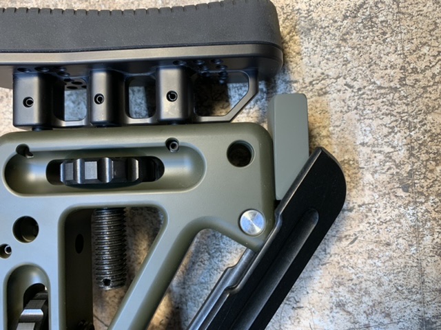

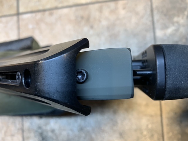

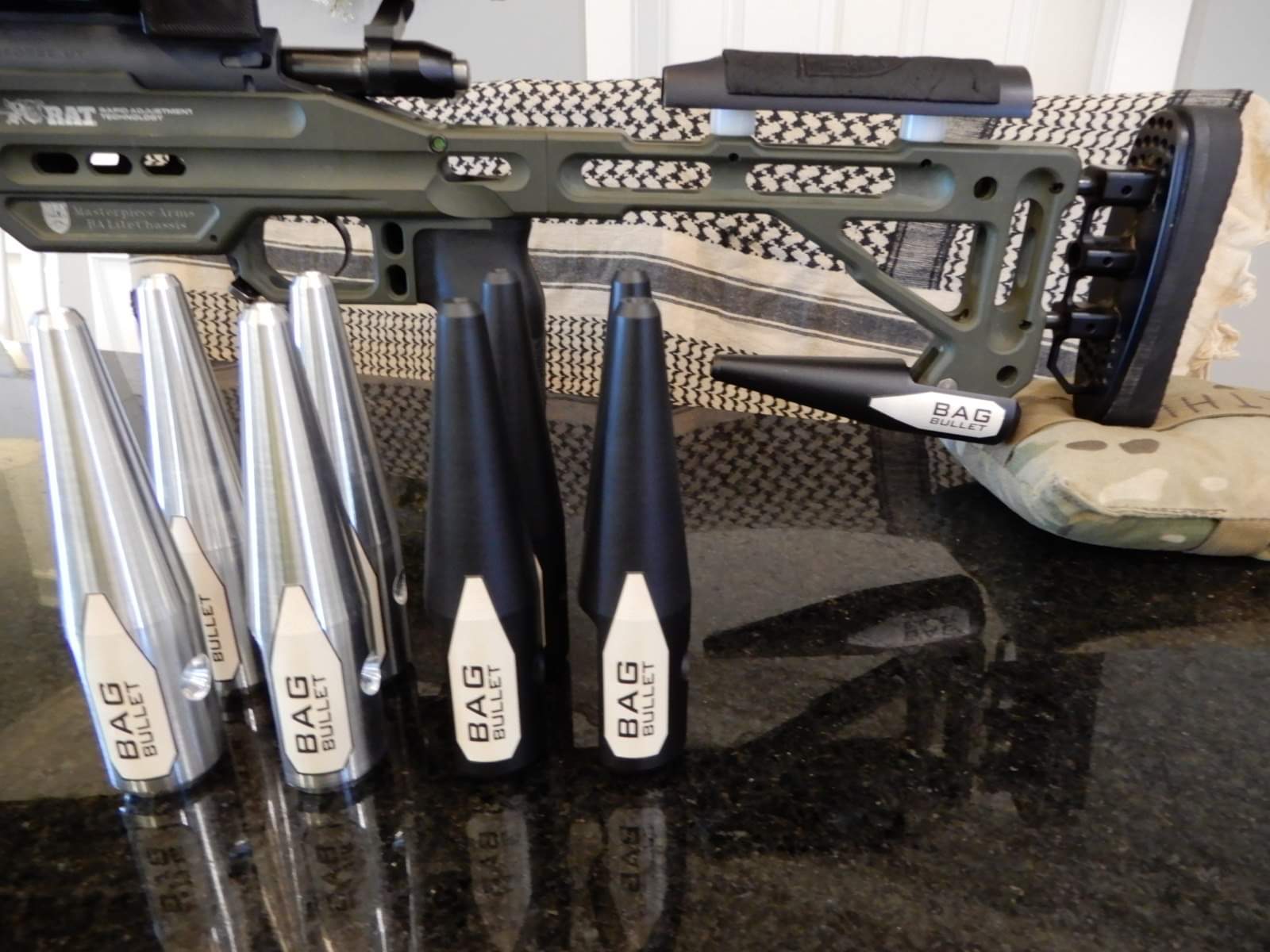

One of the members at my local club makes an awesome bag rider for the MPA chassis. Great dude, solid product. Every guy I know who has put one on their MPA has loved it.
Thanks I saw that. It looks pretty good. I actually tried contacting them on here and there Facebook I’ll try calling the number on their Facebook page. Thanks again

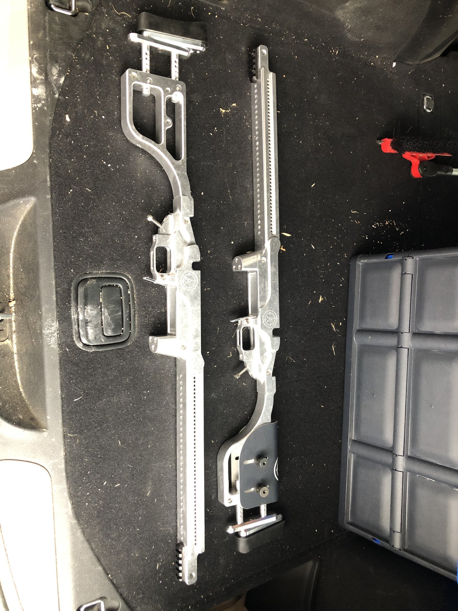

I’m getting ready to call and place an order for a 20” MTU barreled action that I’m going to mount to an AX chassis. Could someone that has the same set up let me know approximately how much clearance there is between the barrel and the forend tube? I’m sure that there’s probably plenty of space between the two but just wanted to check
What length forend is on the AX chassis you plan on using? I have a 16.5” barrel in an AX chassis with a 13” forend and 3/4” of the barrel sticks out passed the forend.
My forend is 13” like yours. I was more concerned with any possible interference inside the tube and the barrel but I did a bit more searching through threads and it seems like the inner dimension of the tube is plenty big for the MTU.
