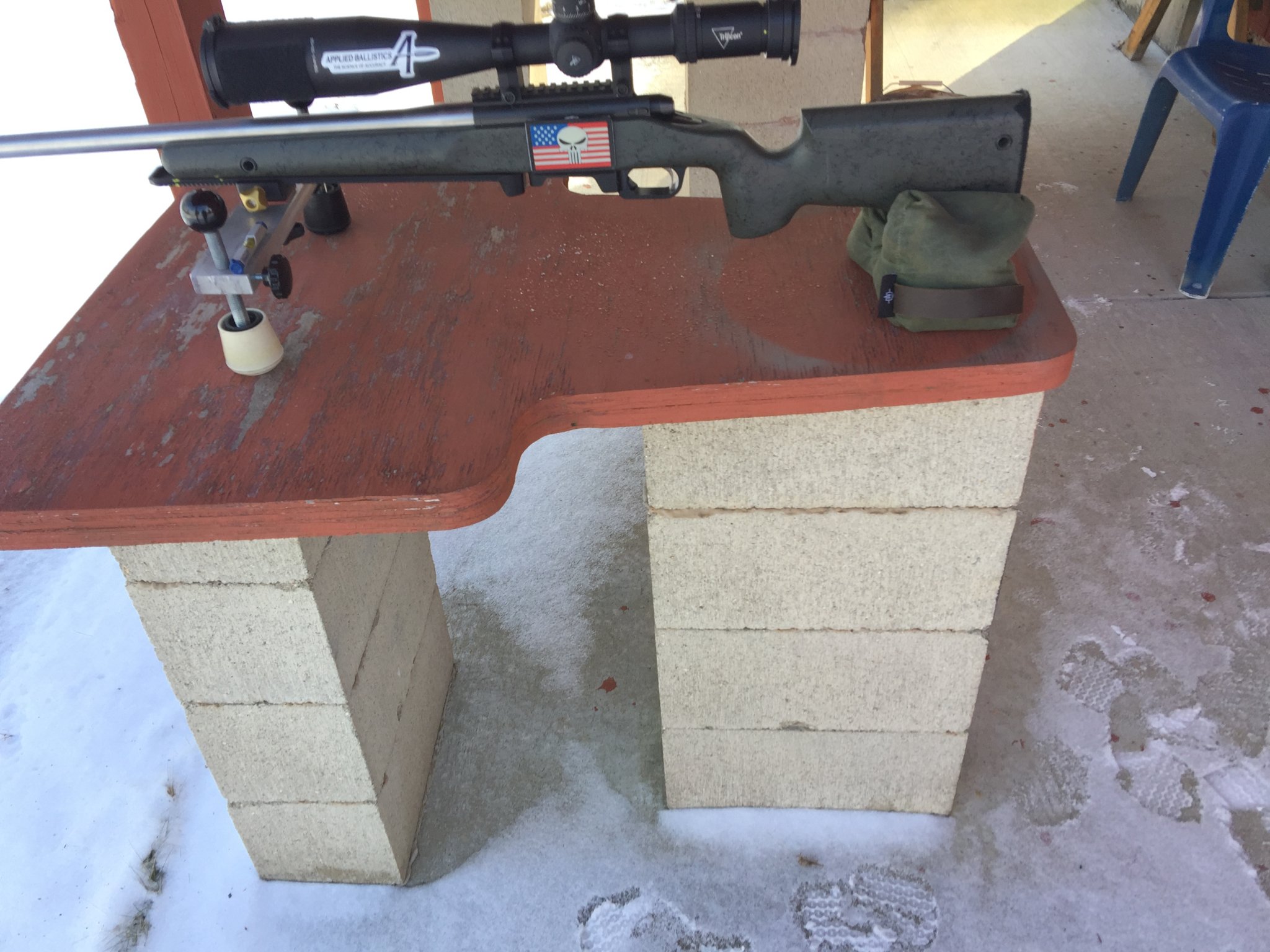

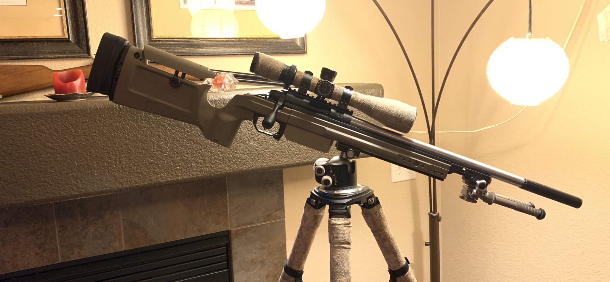

My test platform.

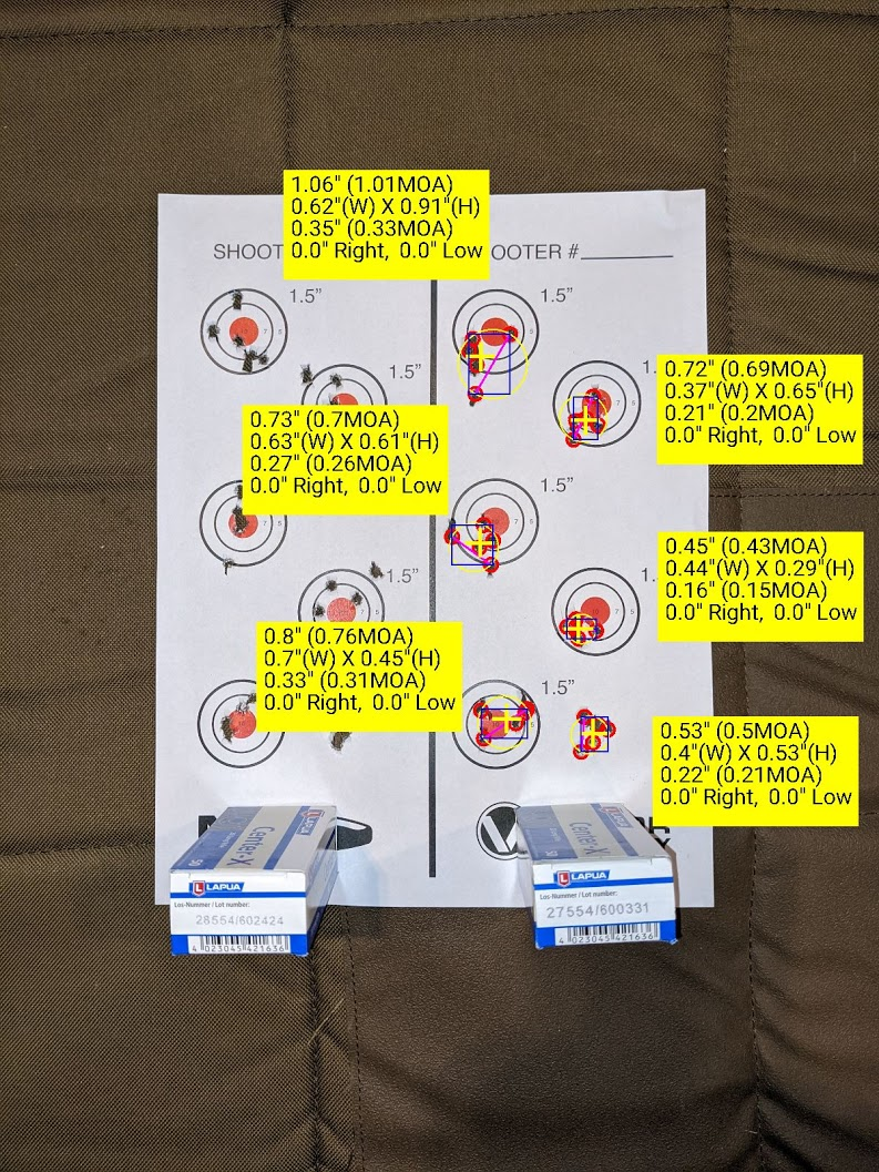

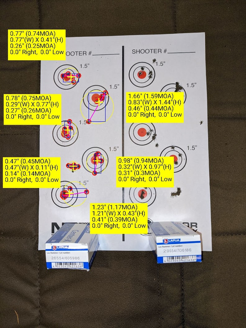

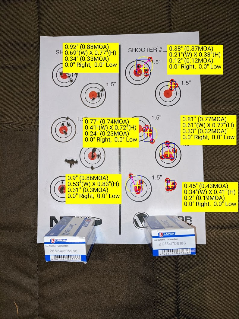

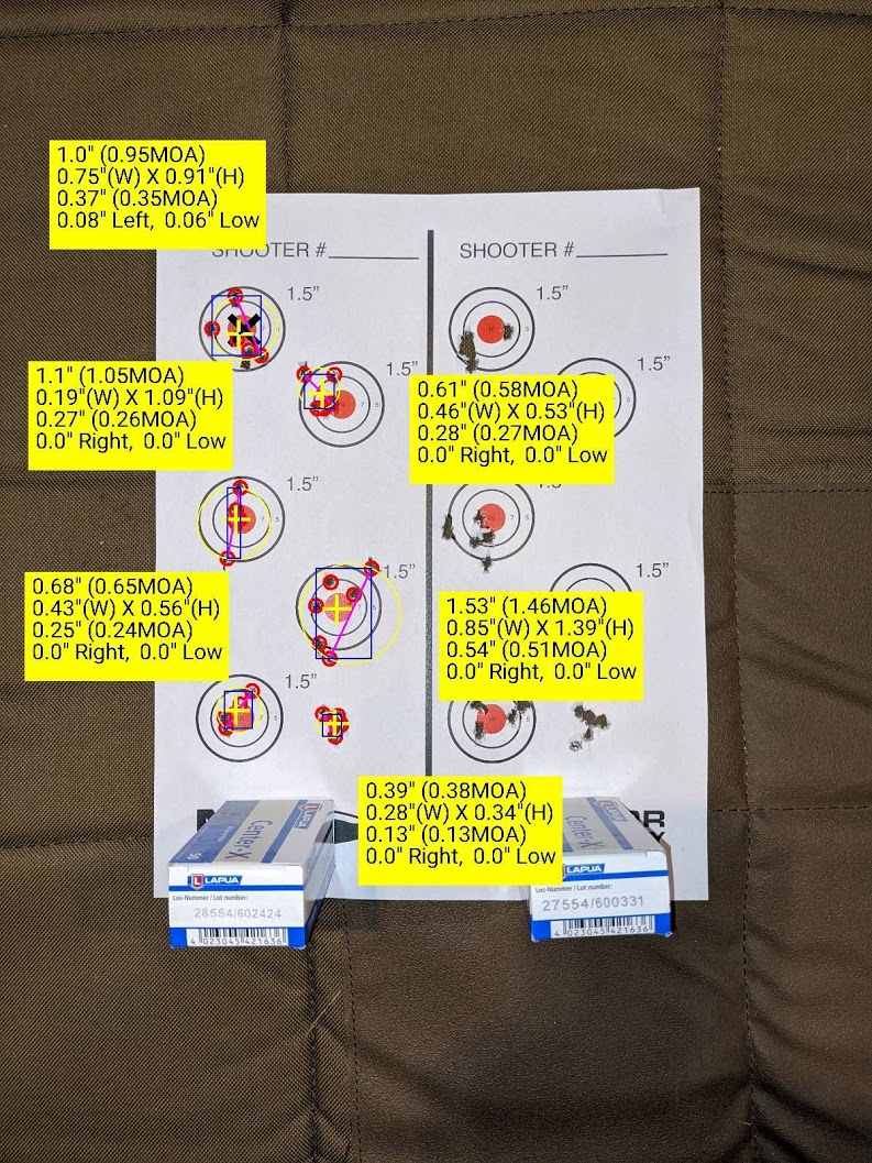

Some sample testing for Center-X, so lot testing does help -
Ran these same 4 lots in a RPRR, and while the overall groups were bigger in the RPRR, it also proved the same ranking of the different lots.
L:
Simple statistical analysis gives for CTCs:
602424600331605986706186
1.001.060.920.77
1.100.720.381.66
0.610.730.770.78
0.680.450.810.98
1.530.800.900.47
0.390.530.451.23
Average0.890.720.710.98
St Dev0.370.200.210.38
Roughly would say are two categories, lots with no outliers, 600331 and 605986, and lots with one outlier, 602424 and 706186.

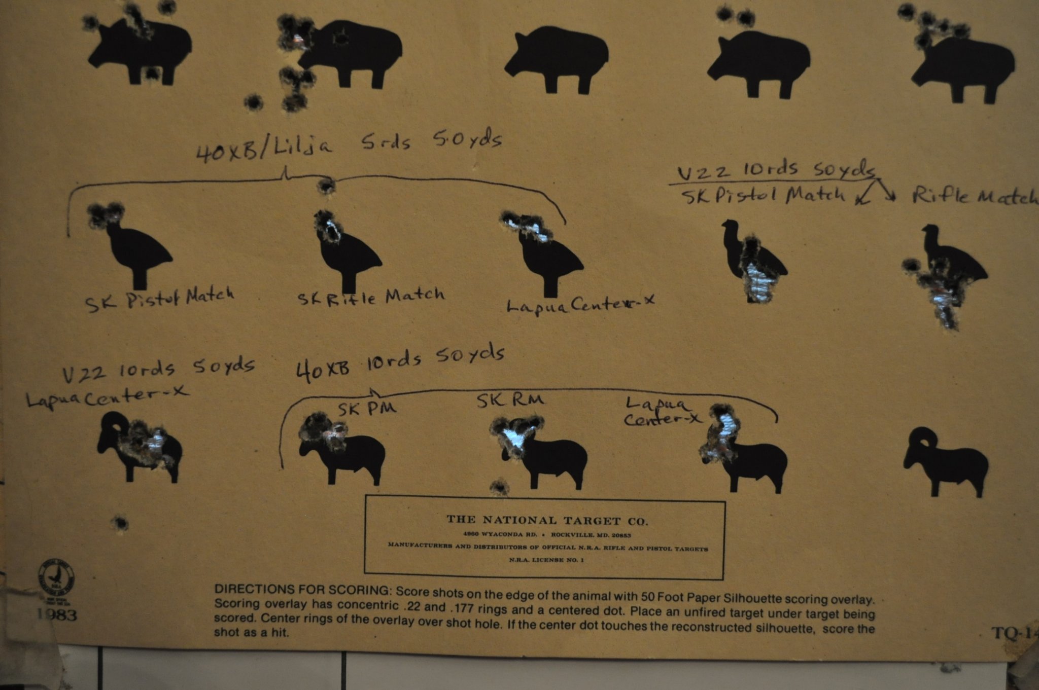

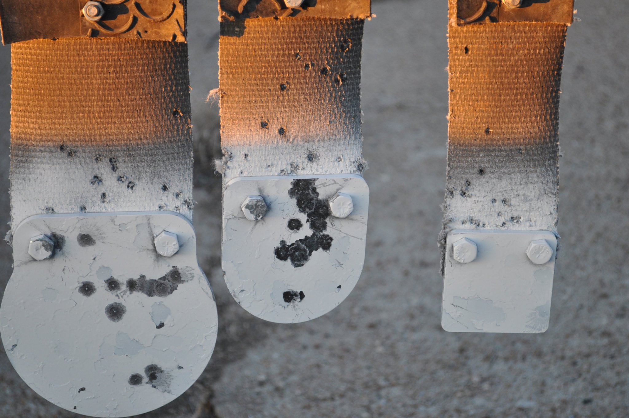

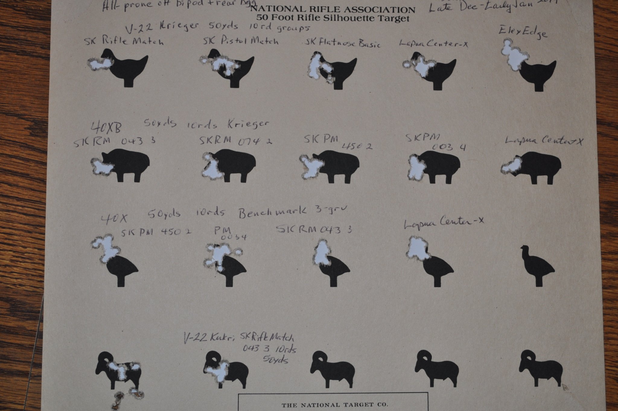

reubenski - I'm attaching a few photos of several paper targets shot at 50yds, over the space of a couple of years, but with the same lots of ammo, and one of a couple of 10-shot strings on steel at 200yds. The 50yd paper targets are labeled as to which rifle & ammo were used. The 200yd steel targets are a 6" & 4" gongs, with SK Rifle Match on the 6", and Lapua Center-X on the 4" gong. They were shot off a fairly stable portable bench with Doggone Good bags, using a CZ457 MTR/Shilen bbl in a VPT Manners stock. I think part of the vertical with Center-X could maybe be eliminated by the use of a good front rest, but I may be full of it; Rifle Match had more horizontal spread, with only a few low hits. Bad part of all this is the space of years between when targets were shot, and not having any notes as to what the conditions were on the days when they were shot. All I know is that I'm glad my rifles will shoot pretty decent groups at 50yds with ammo that's less expensive than Center-X or Midas Plus...lol

2Barrels - I went through about a dozen lots of the SK Rifle Match to find this good one, and when I finally did find it, Graf's was running a dealer special with free freight, so I bought 2 cases of it. OTOH, SK Pistol Match (not the Special) shot pretty darned good no matter which lot of it I tried. If a guy wasn't interested in shooting out past 50yds, plain Pistol Match would be hard to beat without going through a lot of work testing lot samples. At least, that's the way it ran three years ago. Might be different now, for all I know, since I bought 1-1/2 cases of a good lot back then, and haven't bought any more of it since. It doesn't hang in there with Rifle Match, LR Match, Flatnose Basic, nor Center-X out at 100, nor at 200yds, at least, not in my rifles.
