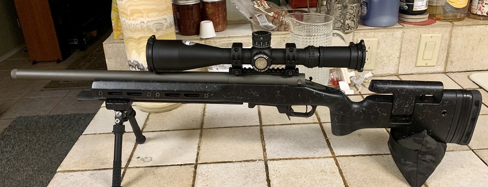

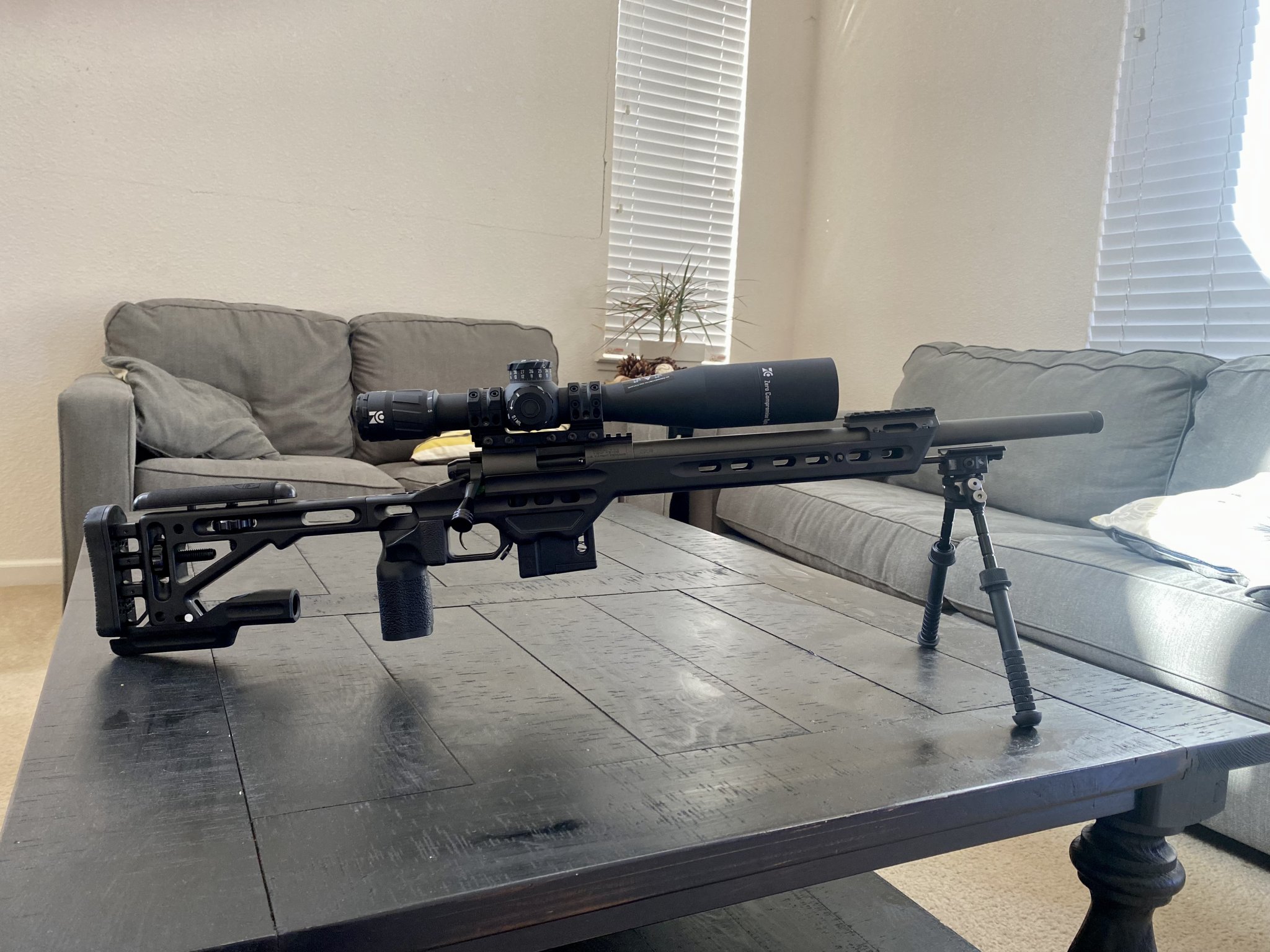

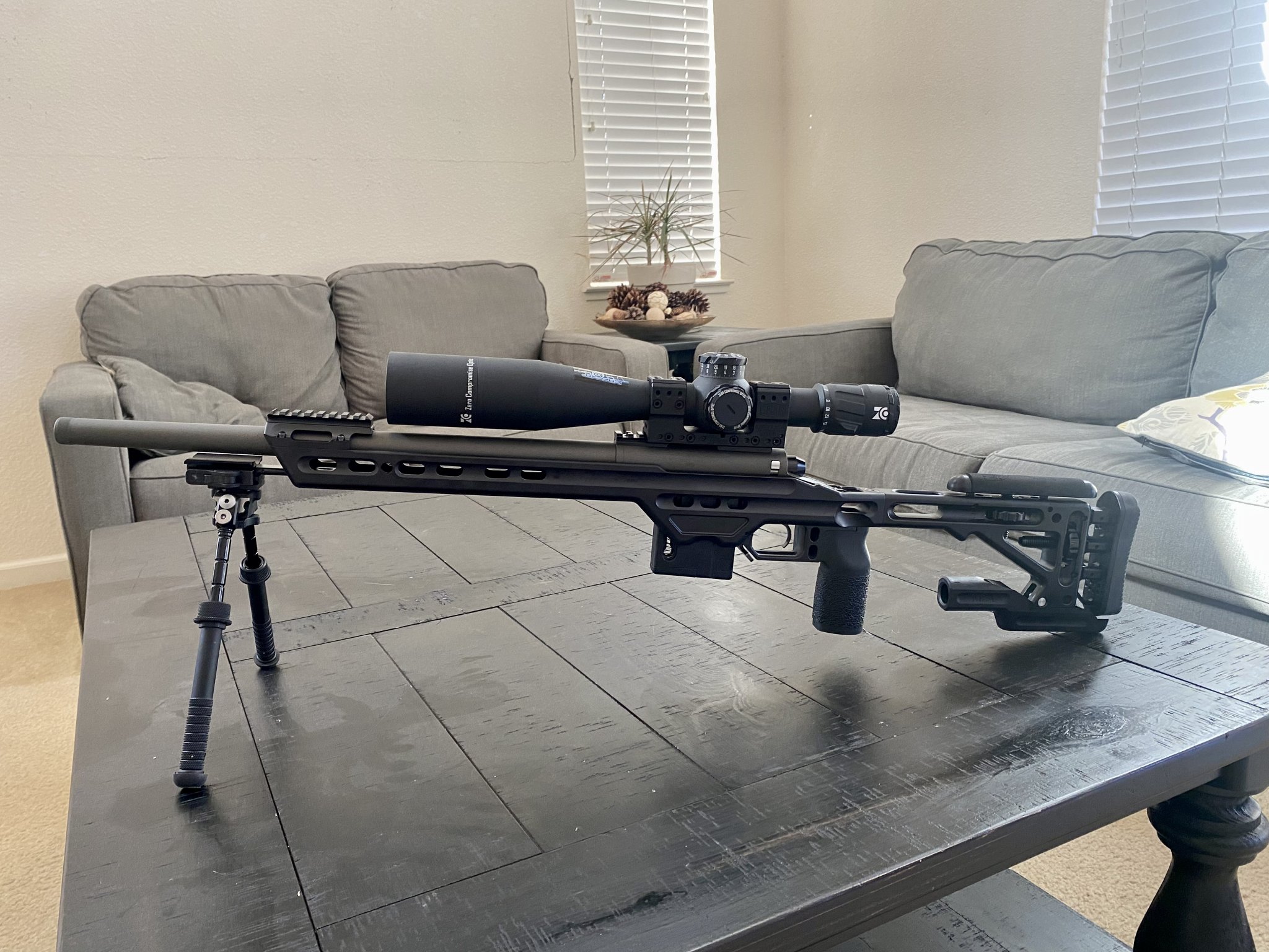

So serious question from an overly paranoid Vudoo owner...
Would y'all move that back ring further back or let it eat? The front one has to say where it is for eye relief reasons but would the gurus of the rimfire realm move it or no? Thank you for the input and let the flaming begin! :LOL:
Any one piece mount (Spuhr, ARC, MPA, etc) is going to have the rings exactly where yours are.

Spread rings. I think scope is far enough back.
Well gents, just wanted to offer a heartfelt thanks for the input and suggetions on ring location. Added about .5" to the LOP (finger is still at a solid 90 degrees and I can stab the mag release no problem) and reset the scope. Got sent home early (Sleeting to beat the band. Gotta love Febuary's in Arkansas) so I had daylight to look out the door to set everything up in a proper prone position. Much happier with where the rings sit and that I am farther away from the scopes "guts" Looks like the scopes center shifted back about one slot so pretty much the same location. One more lousy kitchen pic and I'll stop! :LOL: Time to zero and shoot groups!!!
I followed a lot of the snipers hide training -
1. Positioning of the rifle is now more centerline with the body on the collar bone instead of the shoulder crease.
2. Height of rings as high as possible that your cheek riser will allow to prevent less tilting of the head.
Your rifle is looking great, go out and have some fun!

Vudoo 360 with a 20” ace barrel.

The new Vudoo and XLR Envy Pro go together like peanut butter and jelly :)
That's a long way form the T1x. ;)
Edit: How much does it weigh and how do you like the SendIt level? I just picked one up in the PX and have only used it at the range breaking in brass and working up a load for my 6GT, so I'm just getting used to it. I like that I don't have to look at it to know if I'm level/out of level AND which direction. What sensitivity?
Reactions: littlepod
It weighs 18lbs as pictured. Running 1 internal weight and the externals to get the wider footprint for the bags. You can drop a lot of weight if you remove all the extra weights, get you down into the 13.5lb range I think.
The send-it level just reduces the time and lets me get level really quickly. Pretty brain dead to use. Red means turn the right, and bLue means left. I didn't adjust any sensitivity settings so I'm not sure. I also can see the green light when I'm on support side the way mine is mounted so I can use it. Only downside is forgetting to turn it off and letting it bounce in the back of the car for an hour drive and then the battery is dead.
Nice rifle. Did you go with the 60 or 90 degree? I really want the new XLR C-6 buttstock. How do you like it?
I went with the 60 degree throw to match my Terminus Zeus.
Absolutely love the C6 buttstock. I think it's the nicest engineered one out of all the other ones I've used MPA and ACC. Thumb screws are captured and hold tight. No play in the cheek and LoP. And it's light at only 24oz!
I put a Send-iT on mine too, it's a cool gadget. I left it on the default settings too. Need to get some spare batteries to throw in my range bag.
