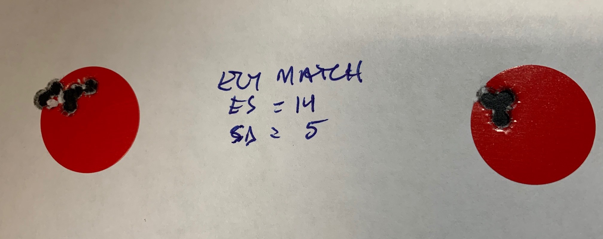

Got to shoot a few groups through my V22 today with 22" Bartlein Kukri profile barrel, bolted into a Manners PRS2 mini chassis stock. The first two 5 shot groups (after 20 fouling rounds) averaged 1081 fps and had an ES of 24. The next 10 rounds averaged 1070 and had an ES of 14 as the bore seasoned for this round. These are the last two five shot groups at 100 yards with this load, fired on an indoor range. The lot number from Ely had this lot rated at 1056 fps. I had bought a couple boxes to try in the rifle and now I can't find anymore of this lot.
That’s really nice. Also jealous that you have access to an 100 yard indoor.
Which elly is this?

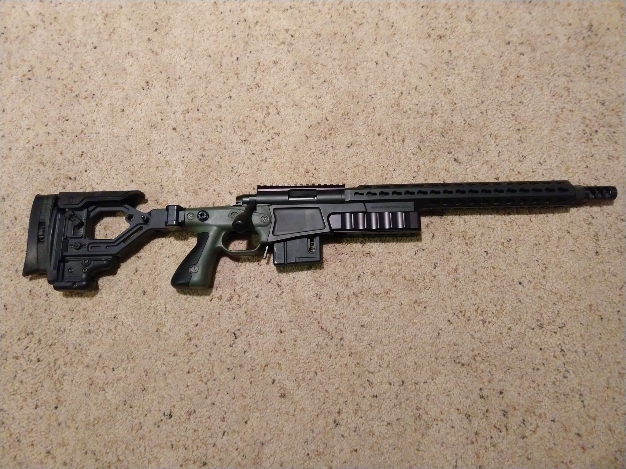

Picked up my Vudoo yesterday, looking forward to getting to the range. It was a great buying experience with VGW no matter how may questions I had they were eager to answer them. The communications are second to none and the build was a few weeks ahead of schedule.

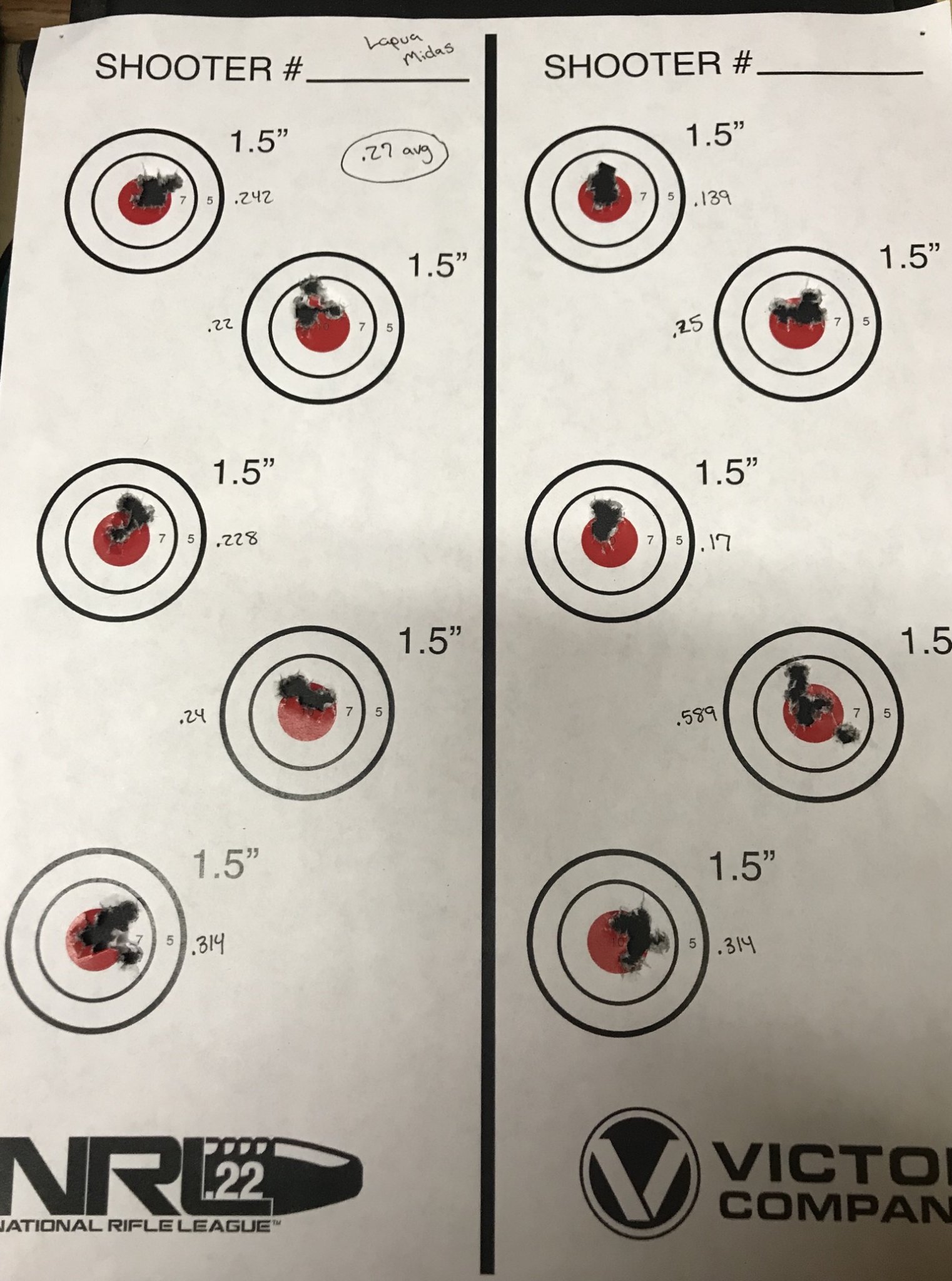

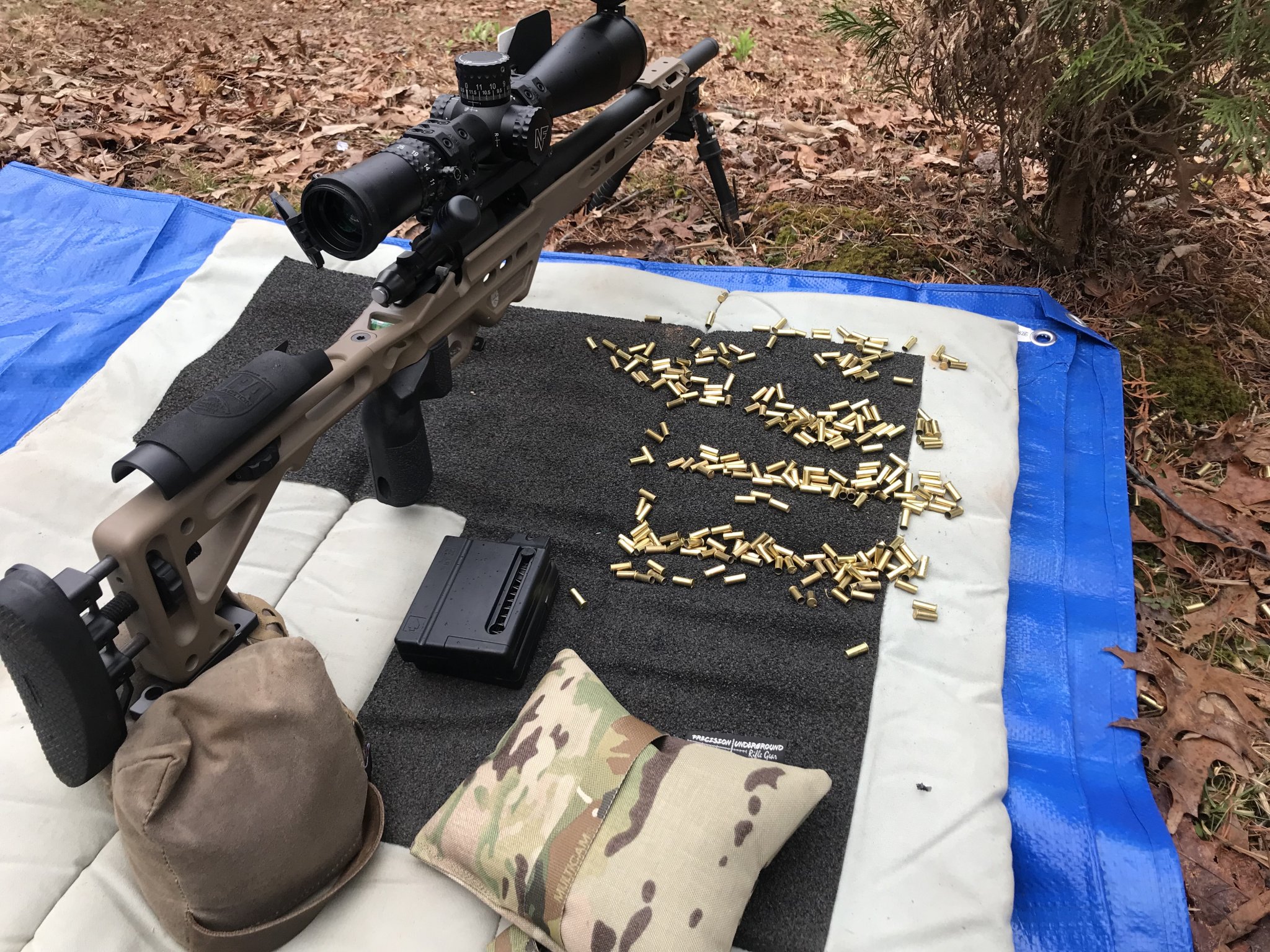

Got mine out today to do some ammo testing. Lapua Midas so far looking the most promising. Shot at 50 from prone off a bipod.
Reactions: t8500shx
im sure everyone got the email, but heres what VGW recommends for ammo:
"Ammo Recommendations:
Eley Tennex, Lapua Center X and RWS Special Match all consistently produce the best groups. However, those are the top of the food chain for quality and price! For half the price we have excellent results with SK Standard Plus and SK Rifle Match. "
I spent all morning at the Lapua Test Center today testing 2 Vudoo rifles. I'll get a review together over the next few days. Right now I'm too tired after my 5 1/2 return trip turned into and 8 1/2 drive because of the winter storm that rolled through the path of my trip.
Reactions: bjay and Sieg
You can add CCI SV in there also as a cheap ammo that shots well. I haven't found a SV type ammo that hasn't shot well at 50 yards.
My V22 has done well with CCI SV at 50/100/200. I've shot it in 100/200 bench rest matches multiple times against guys shooting R50, Midas+, and X-Act and wasn't embarrassed. Maybe the last case I bought was magic..... hoping the other two I have are close.
Best 20 shot groups I've shot at 200 was with R50. Center-X, SK Pistol Match, and SK Std+ also do well. The lot of SK Rifle Match and Tenex I've shot didn't impress me. But I'm shooting outdoors at a range well known for tricky winds so there's always an unknown factor.
